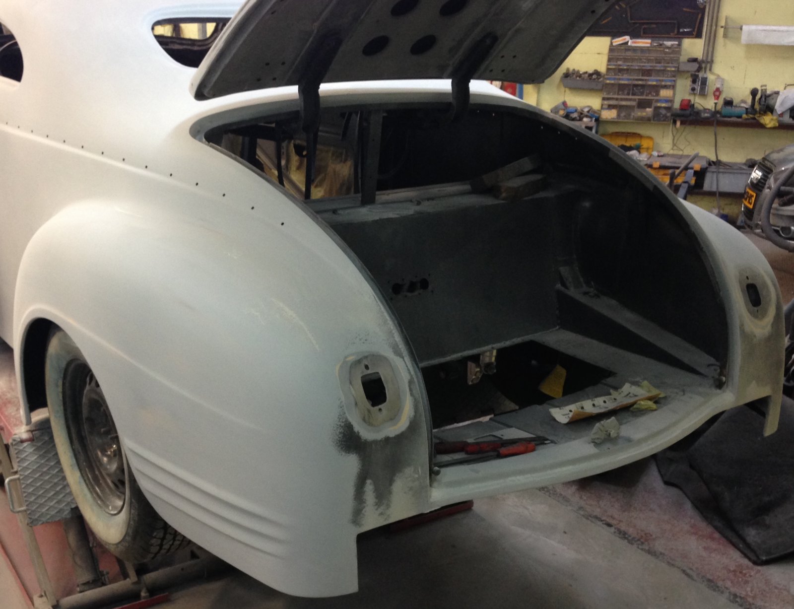

    Update: The taillights are now in place after some measuring, cutting and welding. I've positioned them slightly more outward in order get a better look/balance in the rear fender.
    The only thing left now to attend is the hood, and then, finally, it will be time for the final phase.

    That position for the tail lights looks better,nice work!

    Really really great job. Honestly, the time an energy you've spent on this project is inspiring. Now I'll see if I can explain the following bit. As you know putting our projects on a forum such as this allows for pro's and con's with the myriad of responses given. That said. I only express my two cents as intuition. I'll come right out and say it. I'm not sold on the tail lights. Yea ya. We all have our grips about other projects we see at shows our buddies yards. However, I've gotta say. It just doesn't fit this amazing project. Tear drops are cul. However there's so much movement with your car and bulging culness tear drops don't seem to fit. That said and believe me I wasn't sure if post this but I've followed you for awhile and feel we could be buddies. Alright.

    Thank you for the comments 4rod! And this is why I really like the Hamb. Everyone can comment on a project, good or bad, inspirational or not. Nor will I ever get offended by people who don't agree with something I do. I'll try to explain why I'm sticking with the taillights.....
    I've always liked them. Are they used often? Yes. Probably due to availabilty and good looks. I've moved them further down so that the roundness of the rear fender (when looking side on) is not disturbed. They only become visible from behind, and not in the side on profile. Furthermore, I haven't seen any other taillight that I like. Most are too bulky or just too ugly. A drenched light could offer a solution, but it's not the look I'm after. I feel that the tear drops also fit the flow of the car and are part of a look that I like. And yes, like you said, there is a lot of movement with the car and I feel they complement the car without causing a distraction.

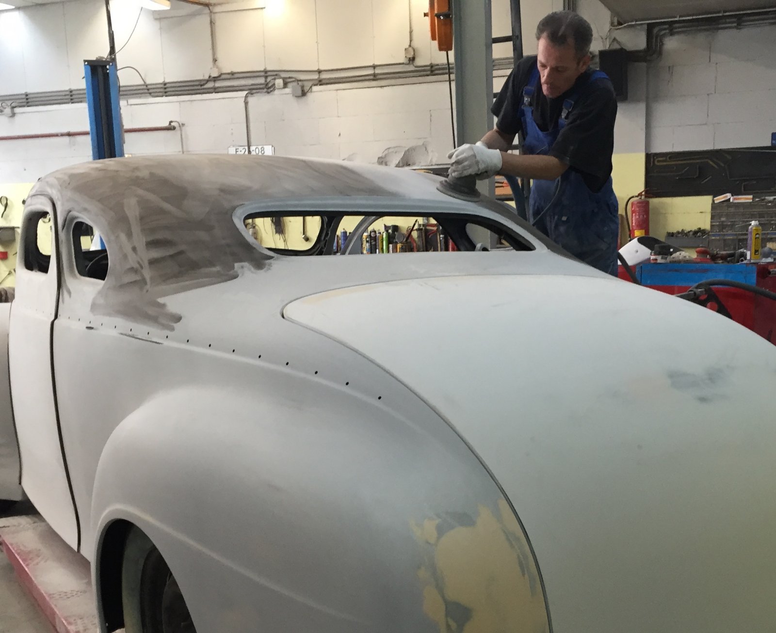

    Another update. The original taillight holes are smooth again and Paulo has been very busy sanding the body with 280 grit. That is now almost done. The only things left on the list are the hood and grill. I know it's been a (very) long time coming, but the end is near!

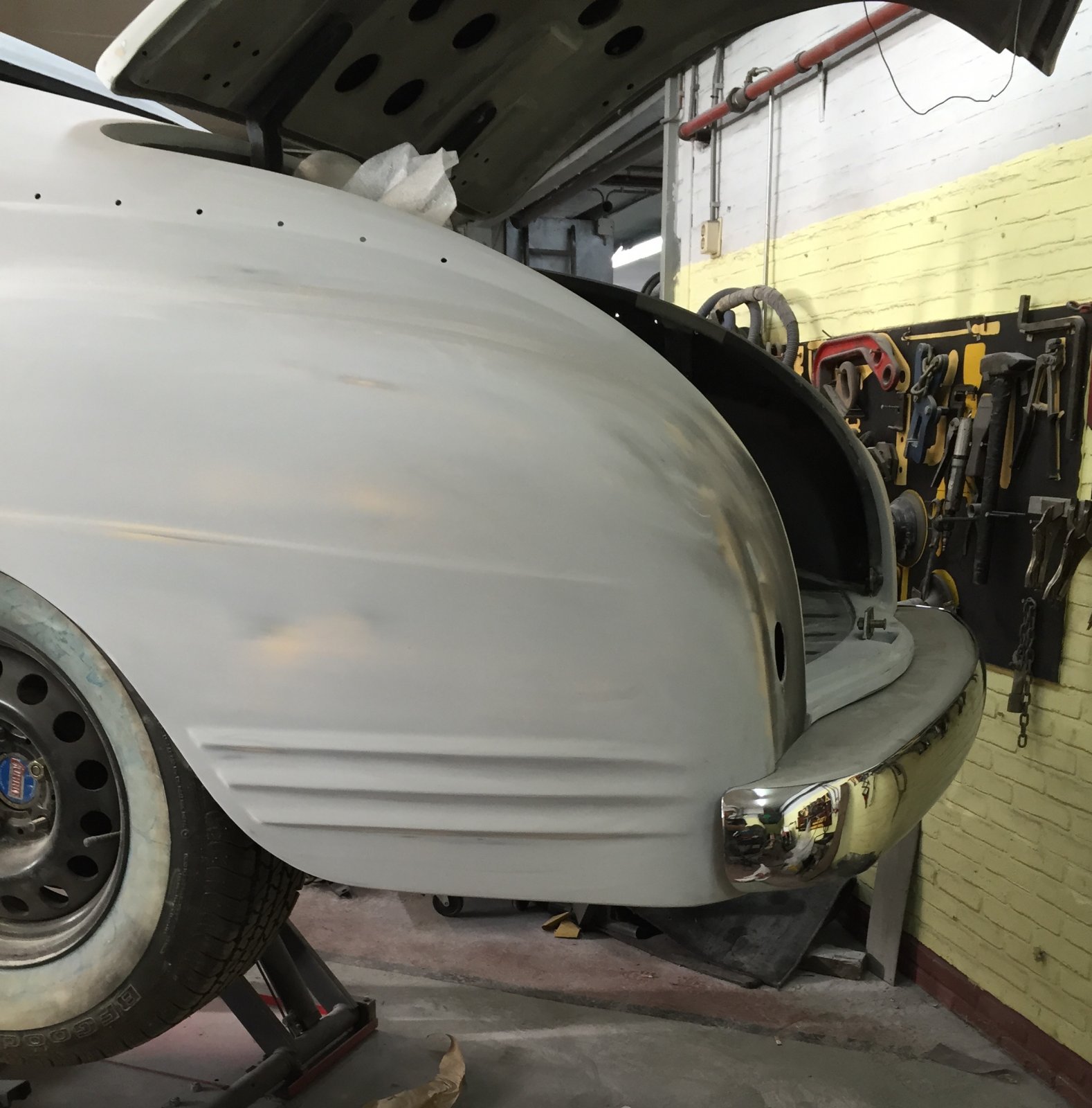

    Update: After cleaning up the holes of the powder coated bumper brackets, it was time to mount them. Then it was time to finally unwrap the chromed bumper! I had of course had a quick look when I got it back last year, but this was the first time I'd seen it completely unwrapped. Only a very slight adjustment to the panel was required and everything mounted perfectly. So all the hours of work and test fitting are paying off!
