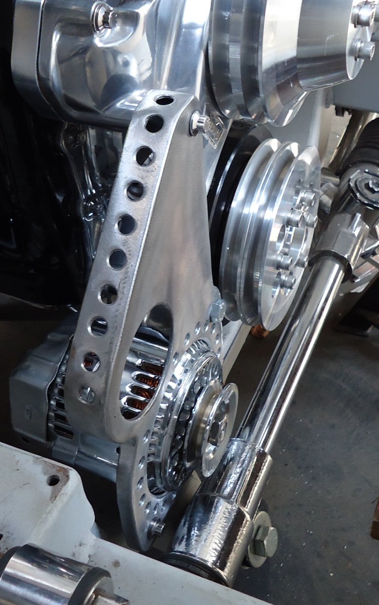

  25. Brand Apart
    Joined: Jan 22, 2011
    Posts: 814
    Brand Apart
    from Roswell GA
    I'm trying to find your alternator and front accessories pictures if there are any, been following for years but I can't remember if you have ever posted pics of them yet
    farmer12 likes this.

  27. farmer12
    Joined: Aug 28, 2006
    Posts: 7,721
    farmer12
    Here you go BA! This is the bracket I made, the hole is for the radiator hose. The bracket has changed only slightly since then. A belt tensioner still needs to be fitted on it as well. Hope this helps!

  28. Brand Apart
    Posts: 814
    Brand Apart
    from Roswell GA
    Thanks Eric, now I remember that awesome alternator bracket. Man it's nice and inspiring.
    I guess air condonditioning is not a big issue in the Netherlands? You are running power steering though I assume, I seem to remember seeing a power steering rack
    Hope you have a great New Years and will be cruising this baby soon(finally)
