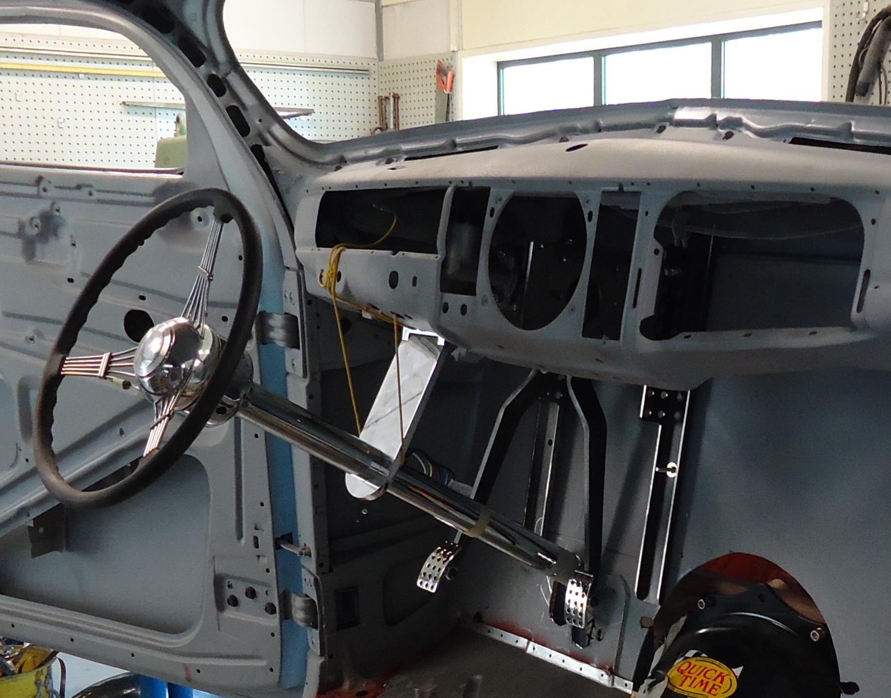

    This could just be the column drop of all time. What are you looking at for drop, 6 or 7 inches? :D

    It may look like a big drop right now, but I stated in post #455 that this is a rough mock up and that the steering wheel will move up another inch. I think the total drop will not be more than 4 to 4.5 inches.
    Also, considering I'm going to slightly re-shape the dash, this will also cover the column drop some more. Don't worry, it will not drop nor be exposed as much as in the photo.

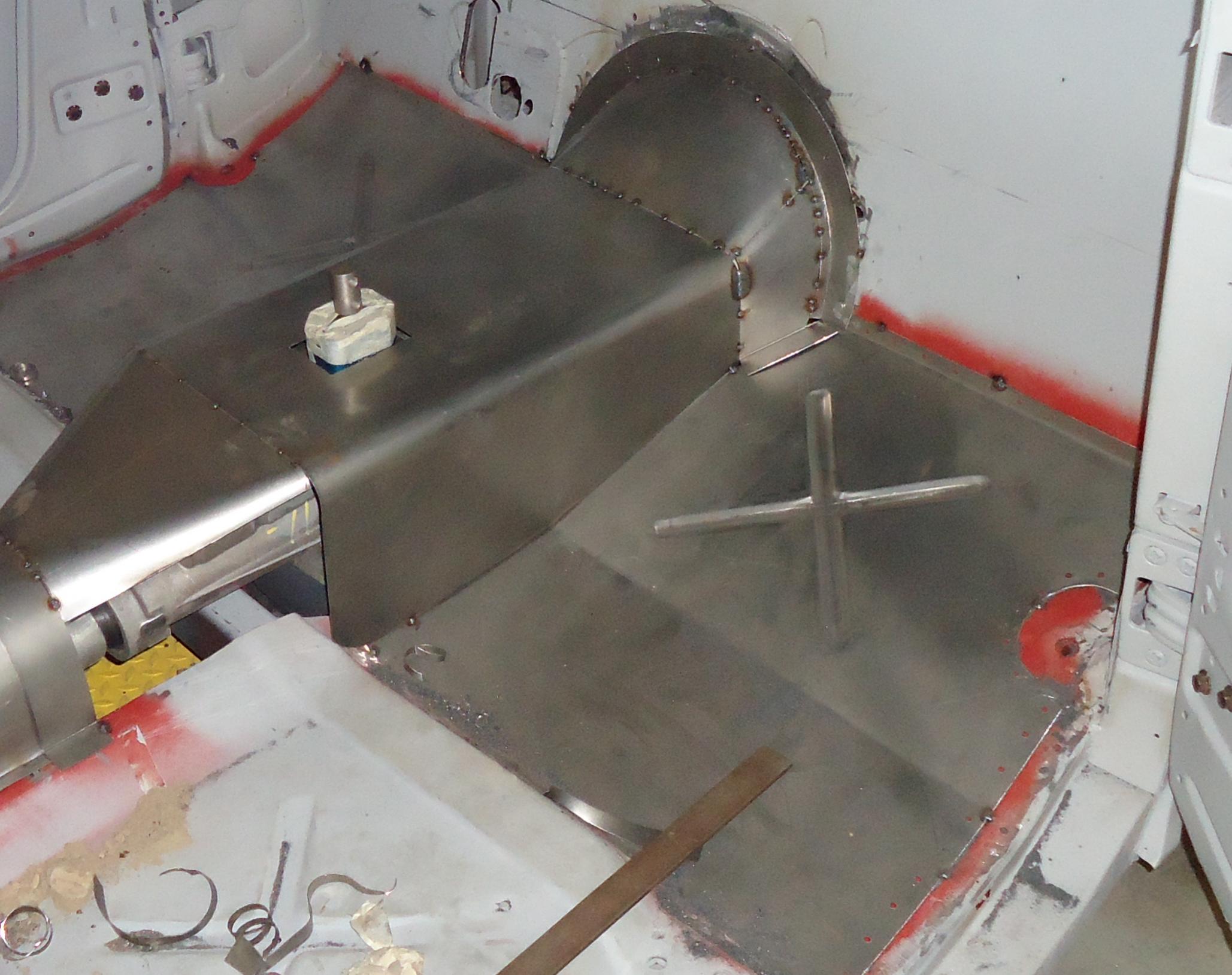

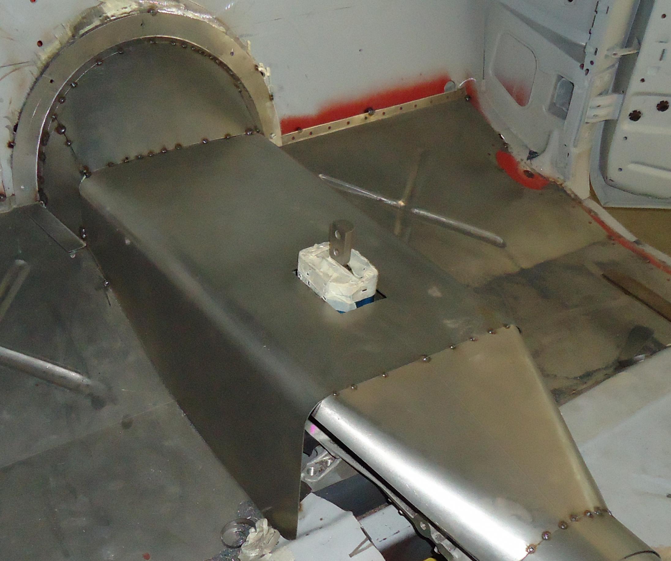

    The right hand foot well is now installed and nearly all of the tunnel. Just some small pieces need to be welded on each side. Didn't make the center section of the tunnel round as I need every available inch in the foot well for the pedal assembly.The whole tunnel will be completely removable for easy access to the gearbox. Should have all the seams welded up this week. Getting there!

    Looking good buddy! Was wondering if you guys have a driveshaft loop or 'cage' surrounding the front of the driveshaft? Hopefully so!

    The driveshaft actually runs over a few frame cross members. Once I know the actual width of the shaft, I'll mount some brackets(or loop) between the frame and the body to enclose the shaft. I know you don't want one of the driveshafts breaking and protruding through the tunnel into the passenger area!

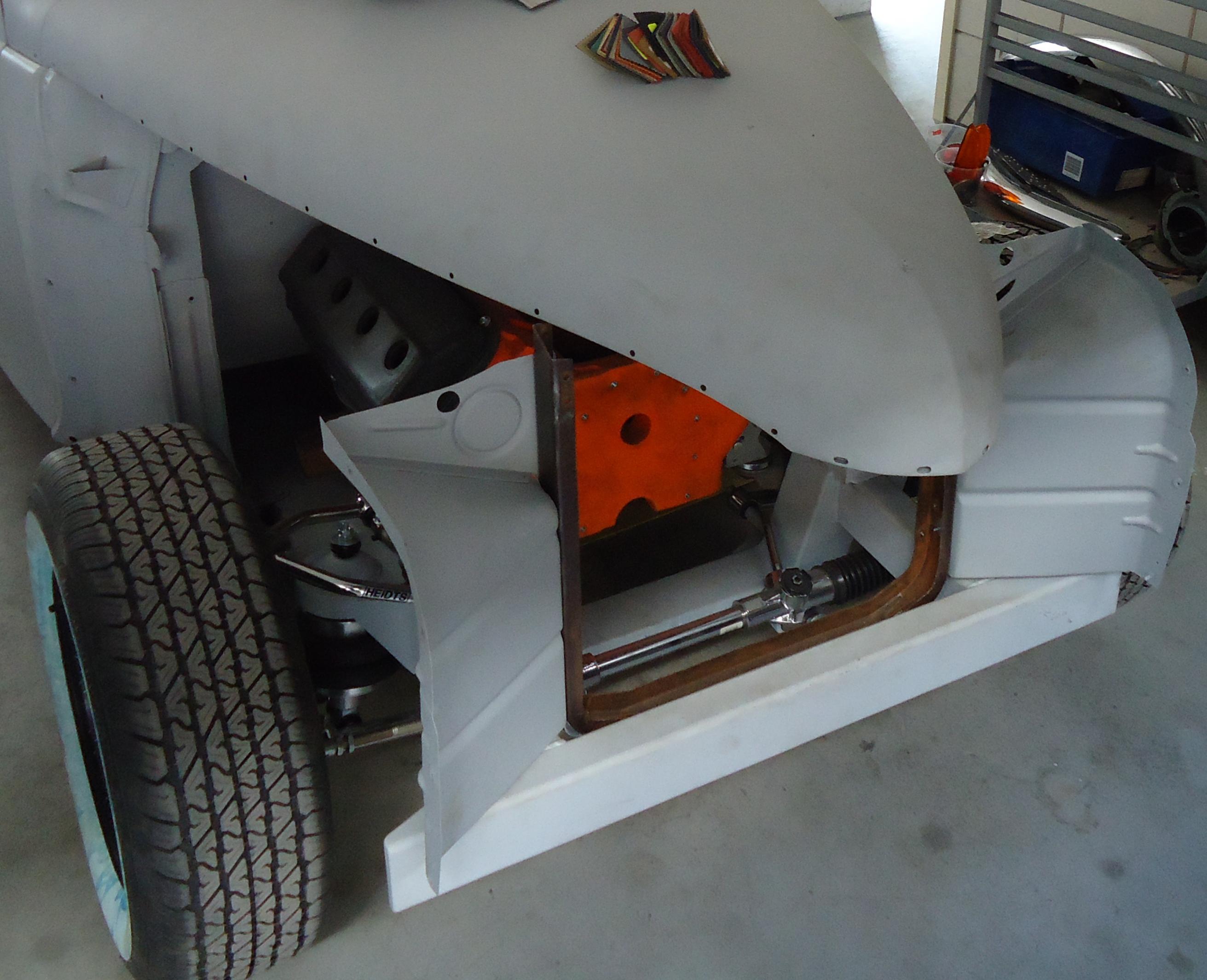

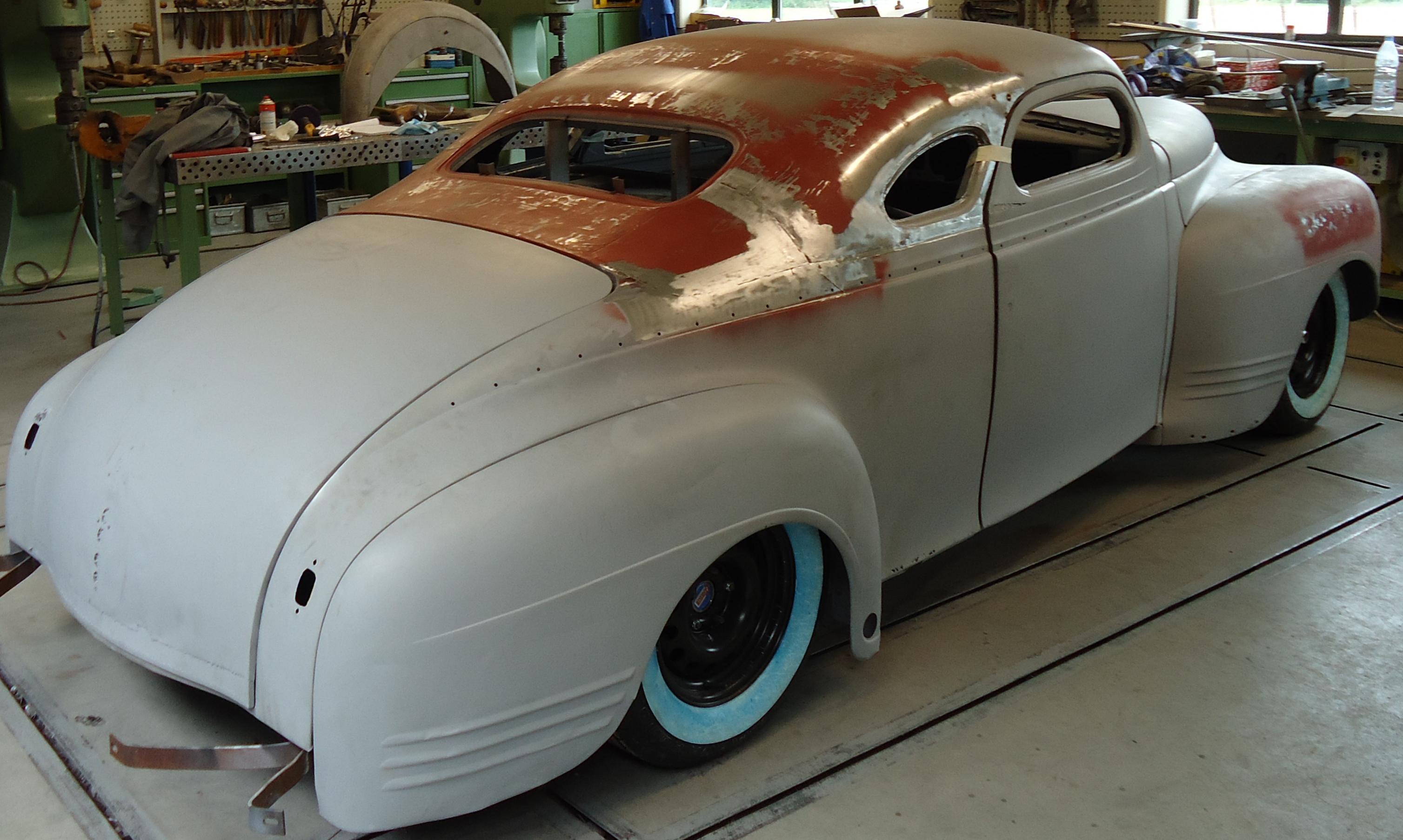

    Pulled the front fenders off the car to try and see how I can line up the front end. Going to figure out where I'm going to place the mounting brackets on the new front end/frame. I want them out of sight but still easily accessable.

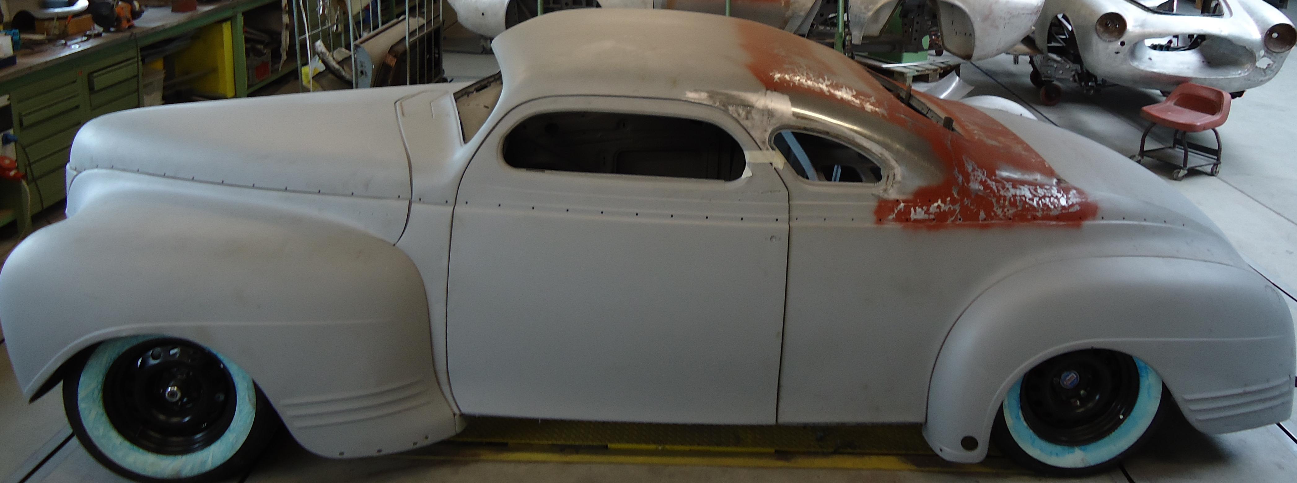

    Drewfus, thanks for the compliments. There will be no driprail/ gutter. I won't be using this car as a daily, just for cruising and maybe drive it to a few shows. It gets pretty wet here in winter time, so she'll stay inside till the sun appears again. I want a "clean" looking car with only some minimal chrome trim along the sides and front. Also going to weld most of the fenders to the body in order to erase any distracting lines on this in my opinion great model/shape.

    Just fınıshed the tunnel today, once agaın ıt all took longer than expected. Goıng to start work on the metal surroundıng the doors now.(from above the door to the headlıner.) Unfortunately forgot my camera today, but wıll have more pıcs early next week.

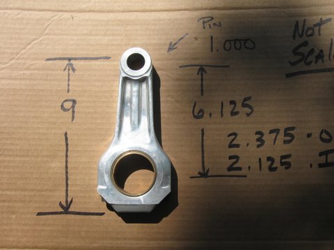

    would you like a aluminum hemi connection rod for your steering column drop?

    Sounds interesting. Got a pic? Trying to visualize it....

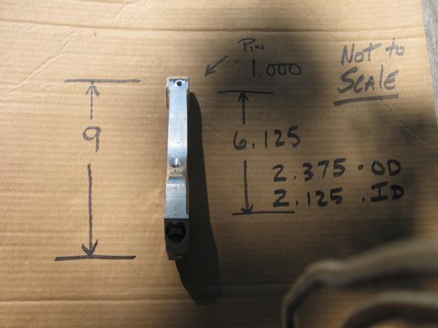

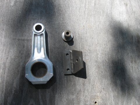

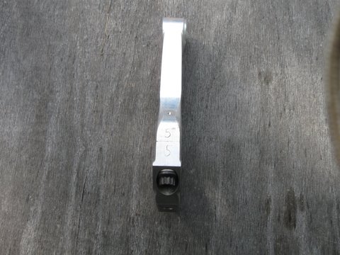

    Wayne just send me these pics: aluminium Hemi connecting rods to be used as an alternative to my standard column drop. Certainly is something different don't you think!

    cool go with it make it work !

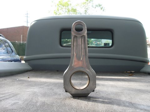

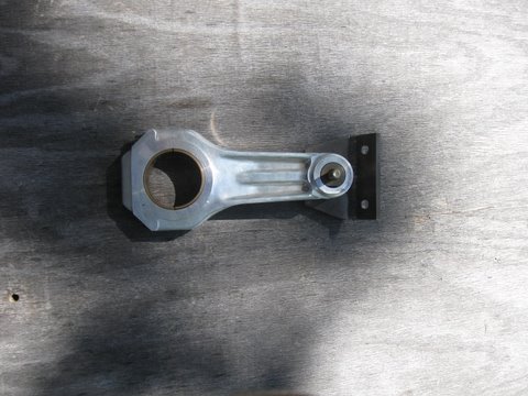

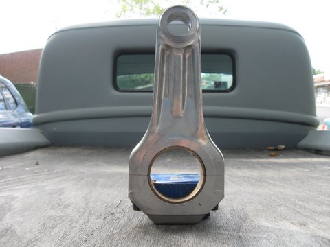

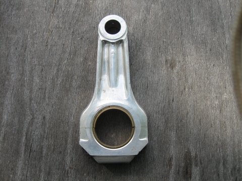

    Just got more info from Wayne regarding the measurements of the Hemi connection rod column drop. I think this will work fine.
    Here are a few pics, including one of Wayne (hope he doesn't mind), who's generosity is second to none in providing this for free. This is the true spirit of the Hamb, wow, what a community! I'm glad to be part of it, that's for sure. Thanks Wayne!:D
