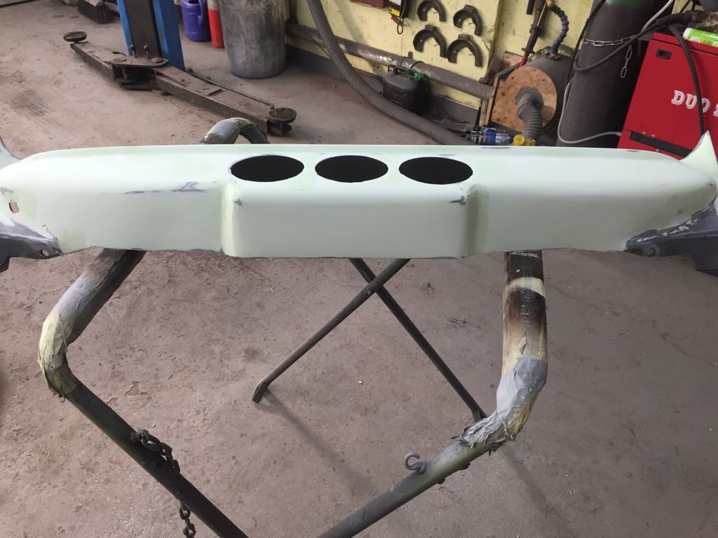

    Meanwhile at the paint shop.....the dashboard is nearly ready to receive some colour.

    Dashboard has been painted, came out looking great. While my painter is busy painting, I'm getting ready to install the Airride compressor/components.

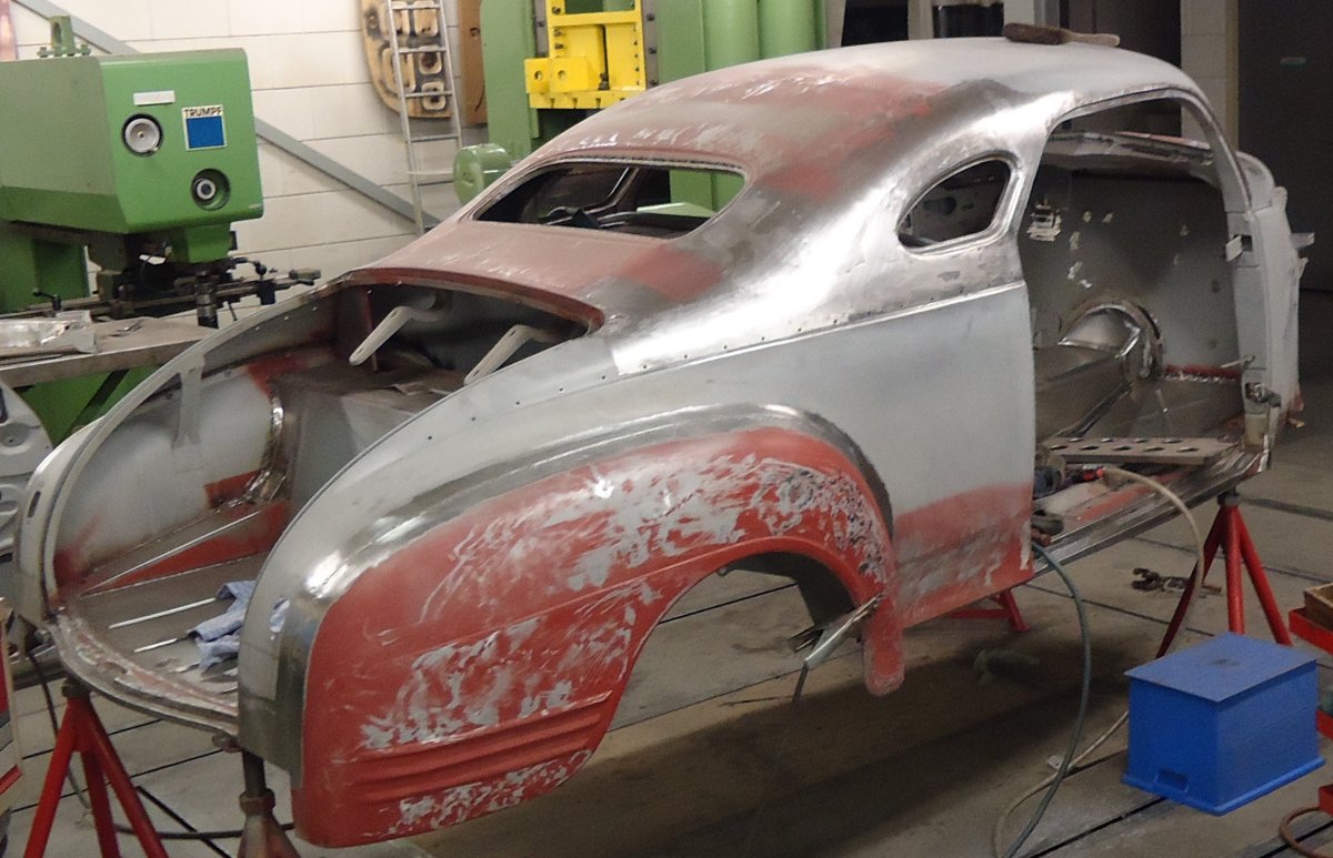

    That picture I reposted shows 1. the roof section that is joined and leaded (at the factory) to 2. the quarter, that 3. has the body line and trim holes along that 'E' part of the light reflection, which they then welded 4. the rear fender to and filled the seam. Look at that reflection and realize every part is a compound curve made of 70+ year old sheetmetal in 3 different stampings. Oh, and it was chopped too!
    He bought it chopped, but had to fix it. Here's a pic from page 6, I think, when it was first stripped. Now look at that reflection![​IMG]

    The above picture is indeed how I discovered it. (underneath the bondo). The picture below shows how it turned out after replacing all the (spliced) metal and using lead for the final stage in order to get the lines perfect. Quite a change.....

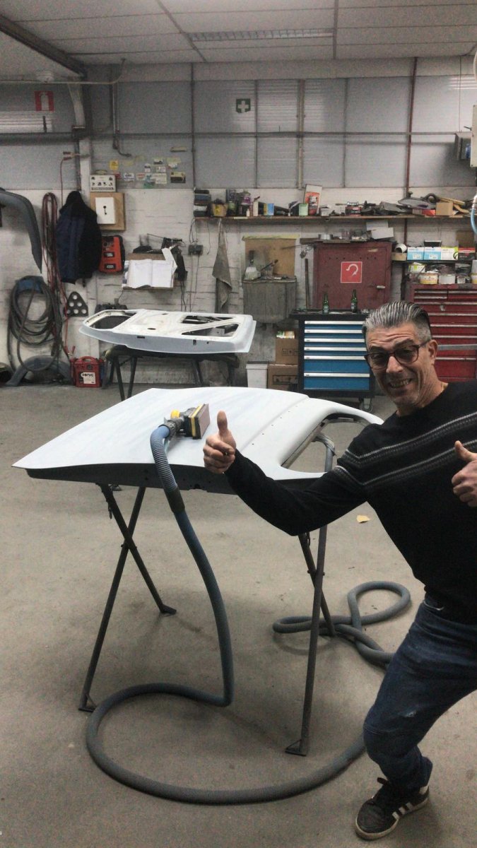

    They sure did! Just got a picture from one of the (Portugees) guys doing his magic on the doors and deck lid. This will all be painted this week.

    farmer12, I didn't want anyone to think that the roof I reposted was UNDER that gorgeous finish, just how much work was put in!
    Your picture shows the work much better! I should have searched more to find that one.

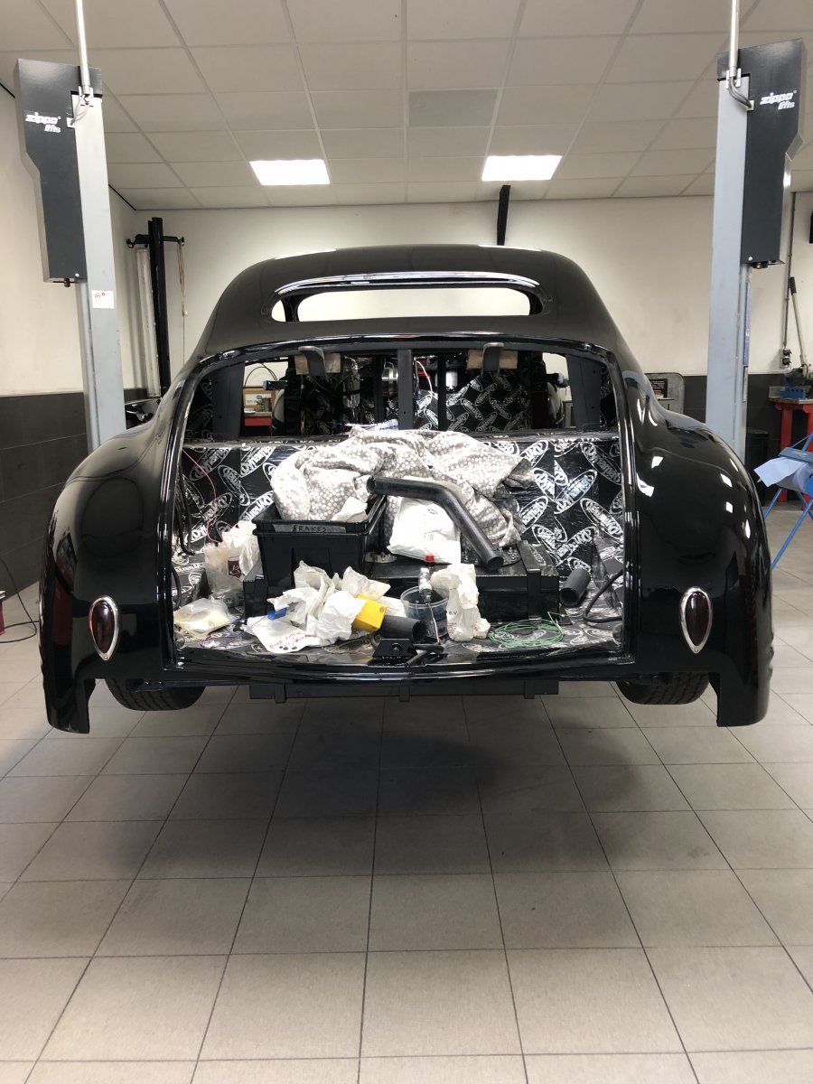

    I'm probably the only guy that will spend nearly two hours fitting two taillights on a car....continuously mounting/dismounting, adjusting etc until perfect. But hey, it's done.

  25. Car
    Joined: Nov 22, 2011
    Posts: 83
    Car
    from the desert
    "Perfection" should be your middle name!;) Great work as usual.
