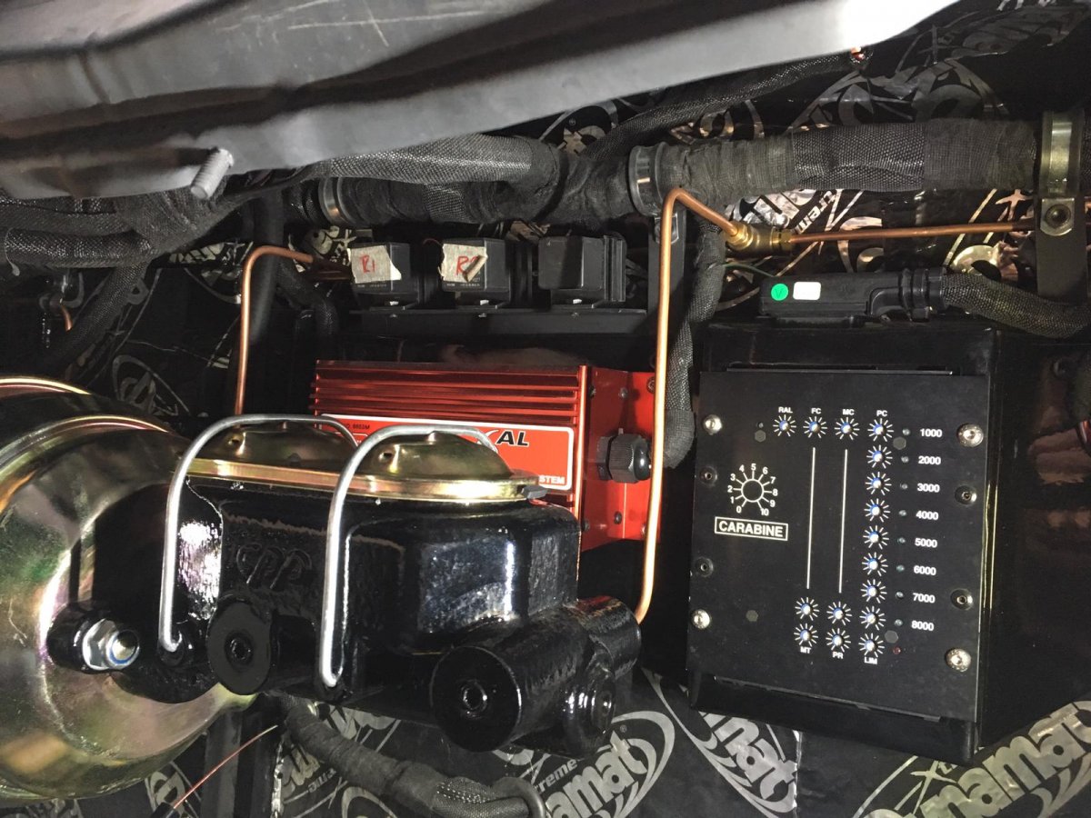

    Even though it's a little overdue....here is a progress report from the last few weeks. It's not that I've been sitting still....just haven't been on the H.A.M.B.
    All brakes/lines and ac***ulator are now connected and the hydraulic clutch now works. The separate vacuum pump for the brake booster is also working now. Those that may remember: I decided not to use the vacuum from the engine because I didn't want a hose through the firewall. A separate vacuum pump now resides in a part of the ch***is.
