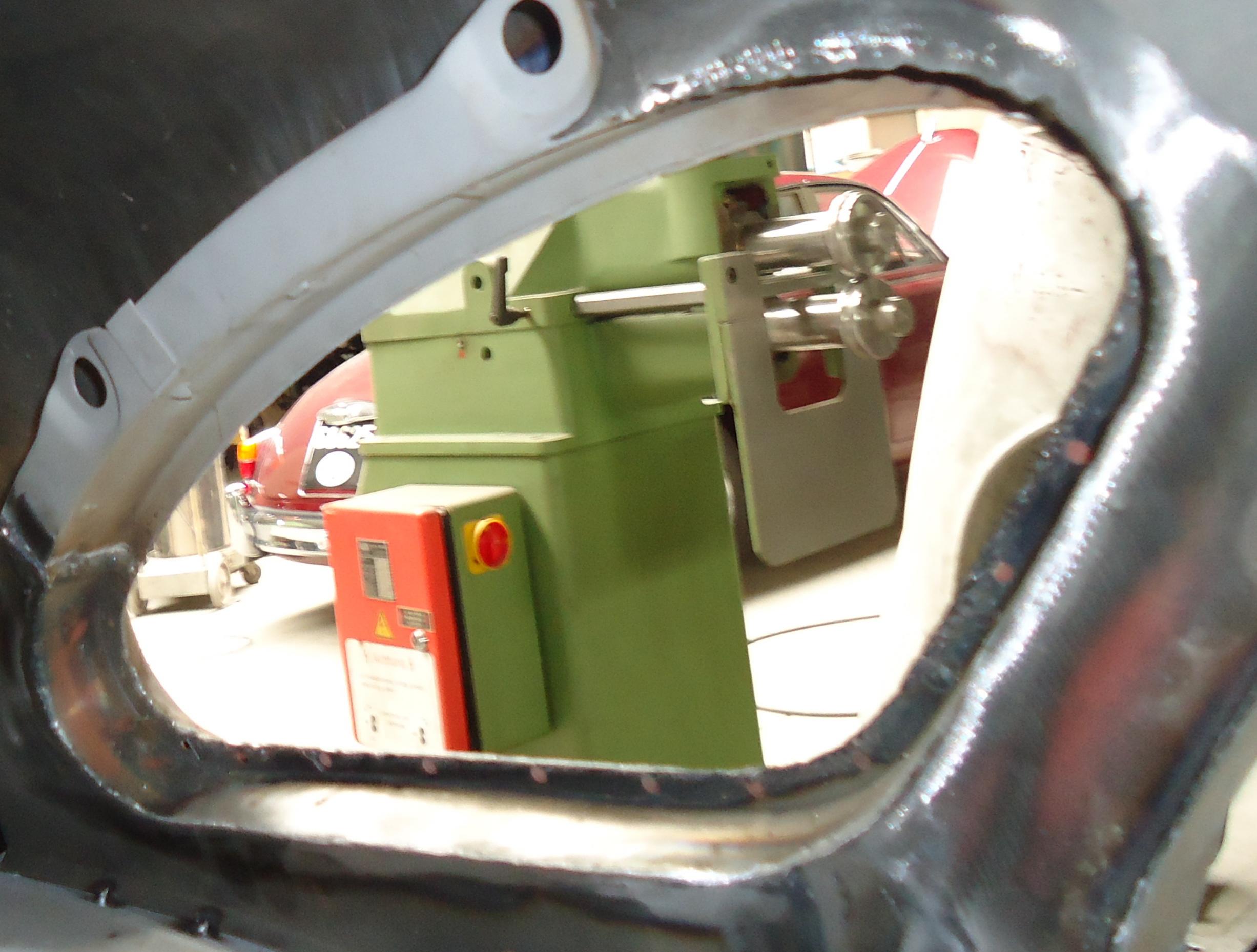

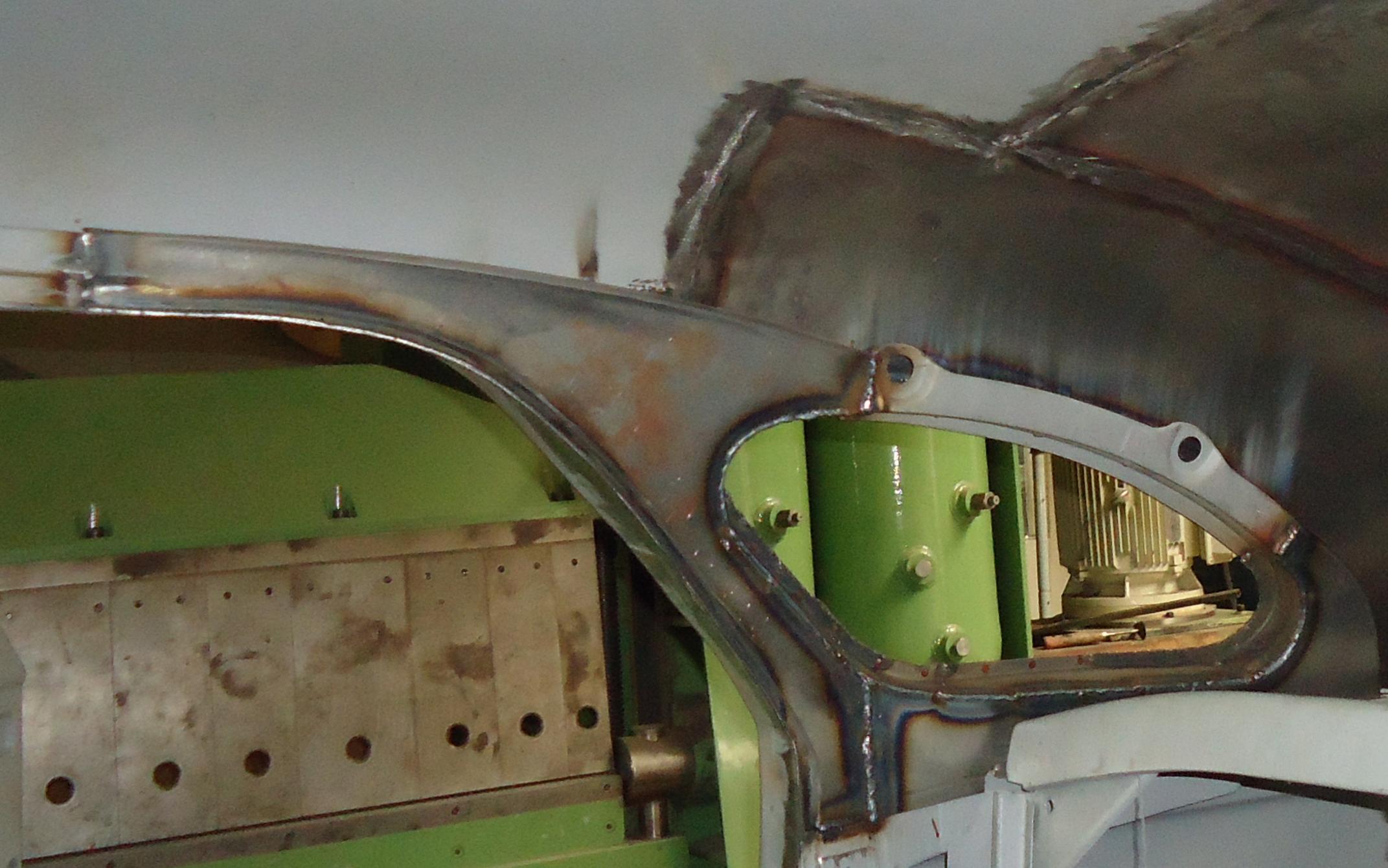

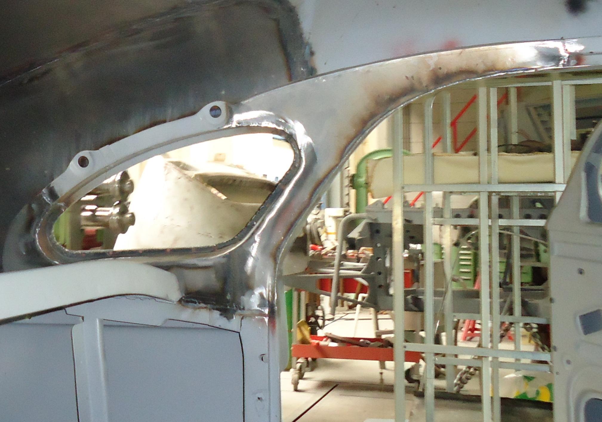

    Finally had some time (together with Martin) the last few days to work on the inside of the b-pillar and surrounding area. New steel has been fabricated and welded into place, strengthening the whole area including the roof. Final smoothing of the welds still need to done but the stiffness is back in the b-pillar.

    Here are a couple of pics from the outside. Welds still need to smoothed but you get the general idea.

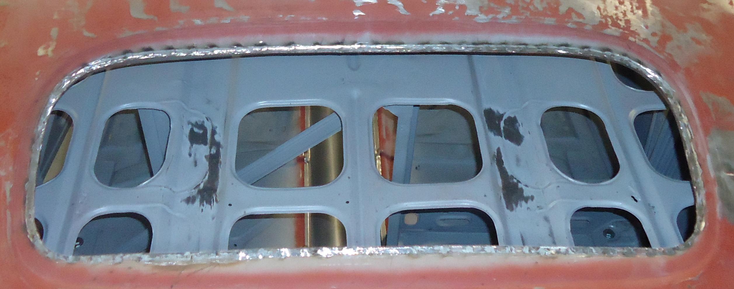

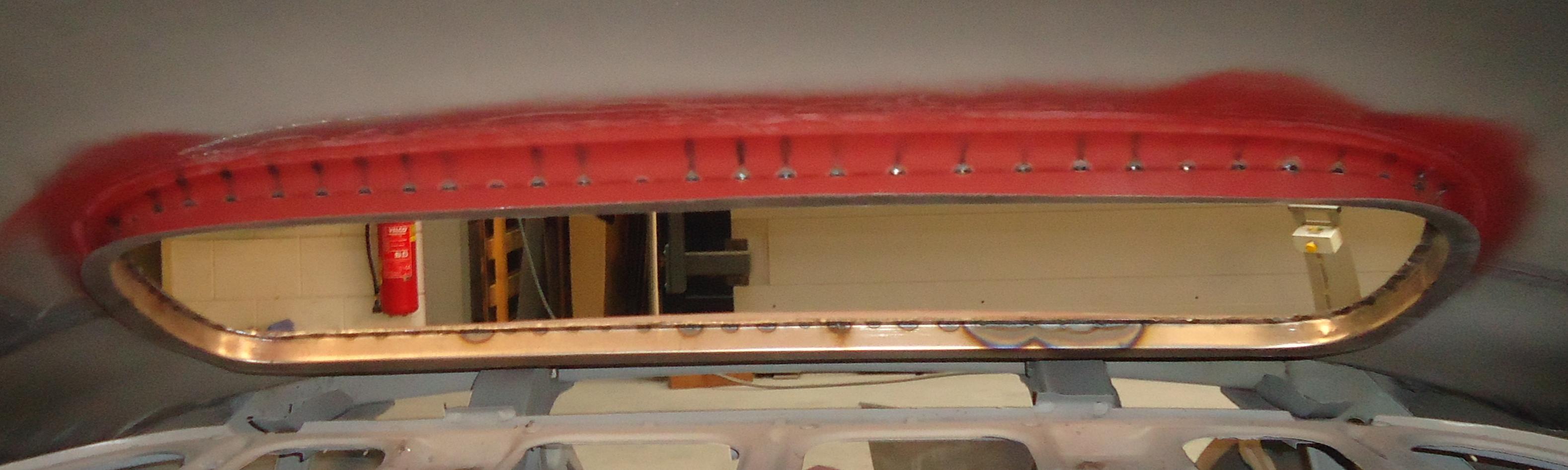

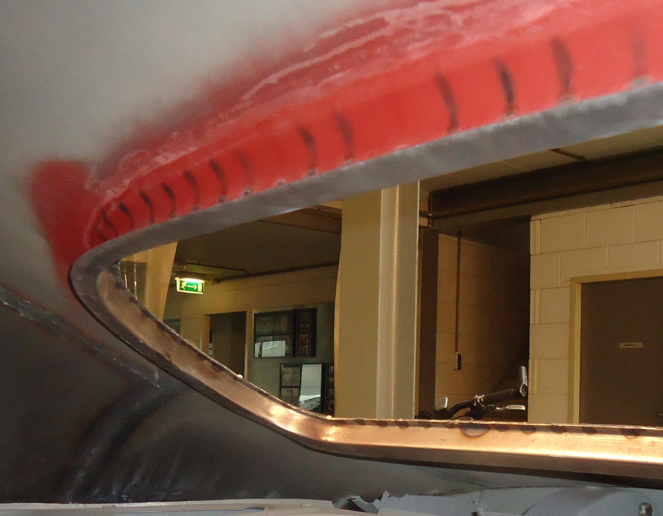

    Just got home from working on the car all day. First, here are some pics of the rear window which has been completely replaced as it was in quite a bad state with regards to rust.
    Sorry for the elongated pics, but had to reduce them in order to post them here.

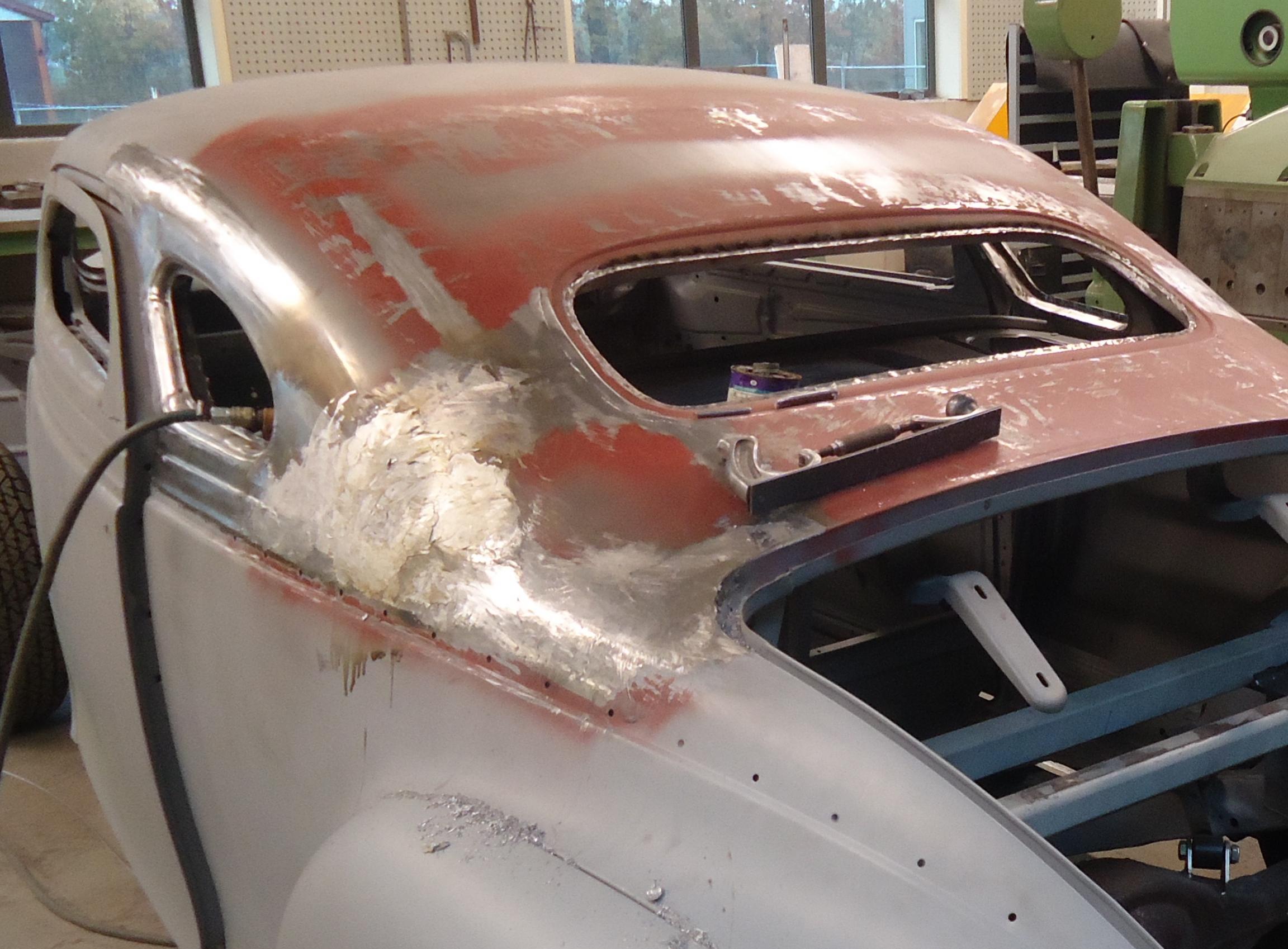

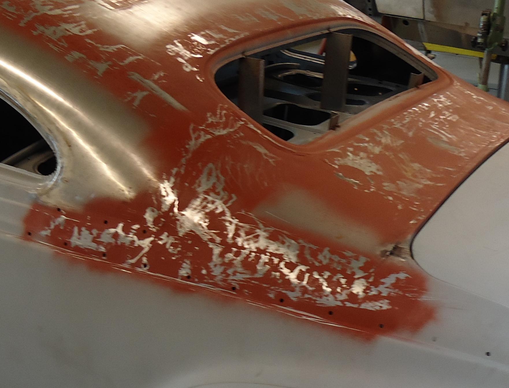

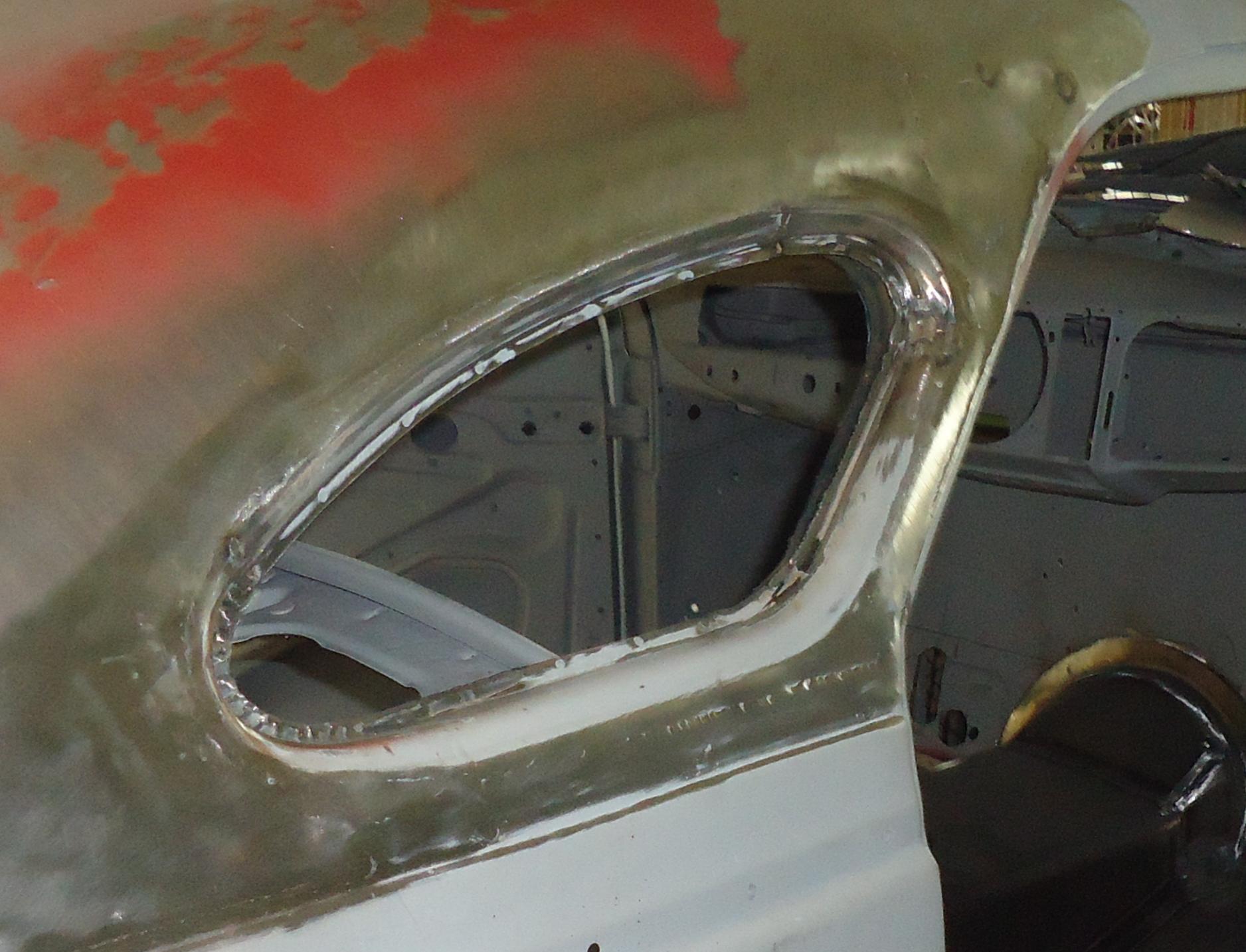

    Well it was finally the first day for me to start to learn about leading. Went over to Martin Dijkhof this morning and got a two hour lesson from the man himself. The first pic shows the old situation. Even though it looks ok in the pic, there were a few low spots which had to be tackled. I want to use minimal bondo on the car, so smoothing the body with lead was the option I went with. Also started filling the belt line after welding the trim holes. What you see in the pics was my 6 hours of work progression with some final filing and sanding to done tomorrow. Once this part is completed, I'll move on to the b-pillar area and the driver door.
    I'm starting to get the hang of leading, but I'll certainly improve as I gain more experience. It was a great day for sure!

    Terribly difficult, no. But I did have a good teacher. The most difficult part I thought was working out when the lead is at the right temperature. If not hot enough it won't budge, too hot and it will flow like water. When the lead is applied to the metal surface (which also takes practice), heat the lead for a few seconds and feel with the wooden "spoon" if you can move it. If not, apply a little heat and try again. Remember that the heat will stay in the lead for a little while. Patience is what it takes. The filing part isn't too difficult either, just use your hands a lot and feel the contour. Once again, patience is required, but you can learn it.
