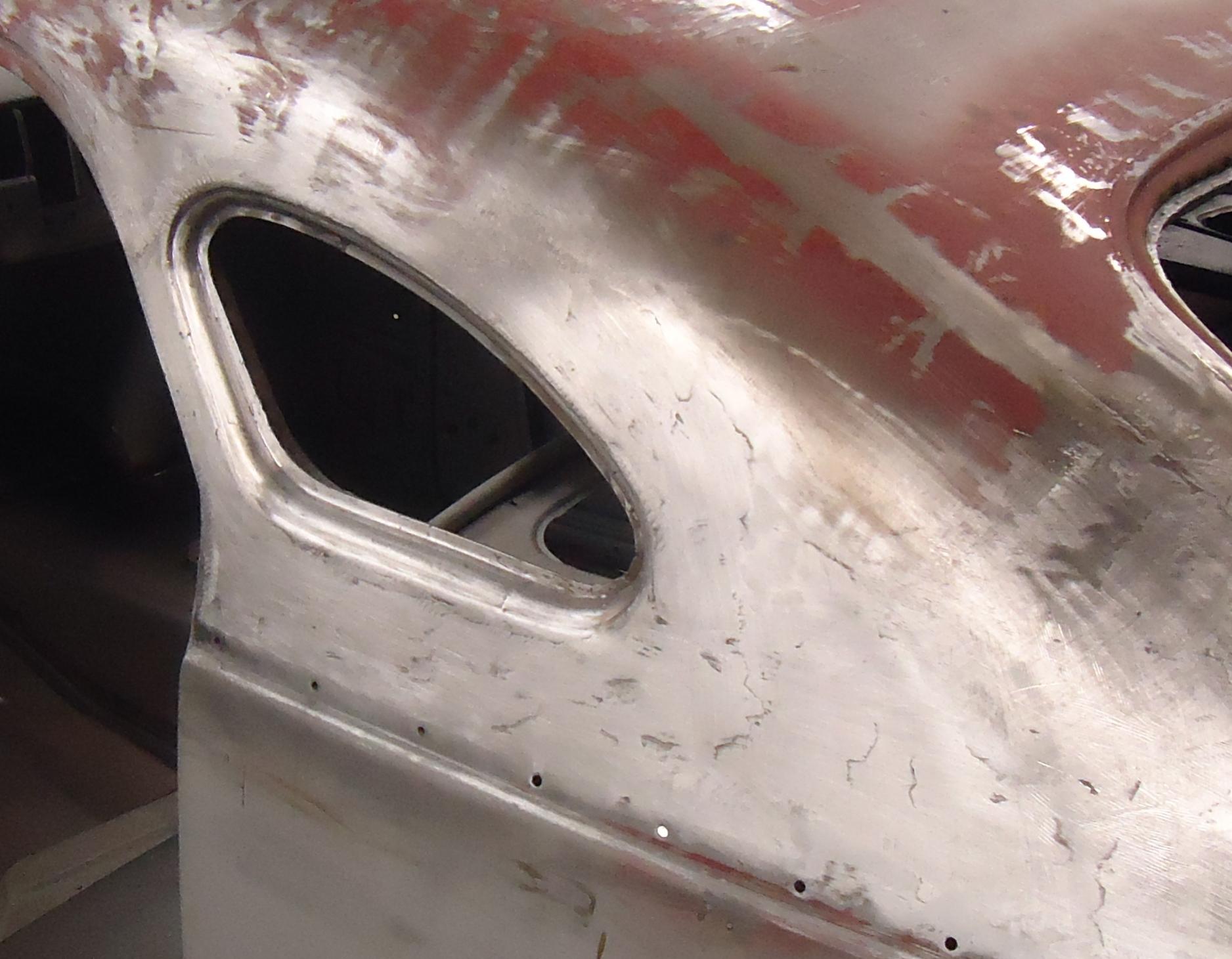

    Started the lead work around the b-pillar today. The concave form just under the roof line required a quarter inch of lead in order to get it flowing the way I wanted to. I sanded the area where the roof line meets the b-pillar and small window.
    The plan for next week is to smooth out the rest and finish the area inside the small window. From there I'll start the other side of the car, which will hopefully go a little quicker as I gain more experience.

    The pic shows most of the leading done, with the area above the window being smoothed with sand paper.

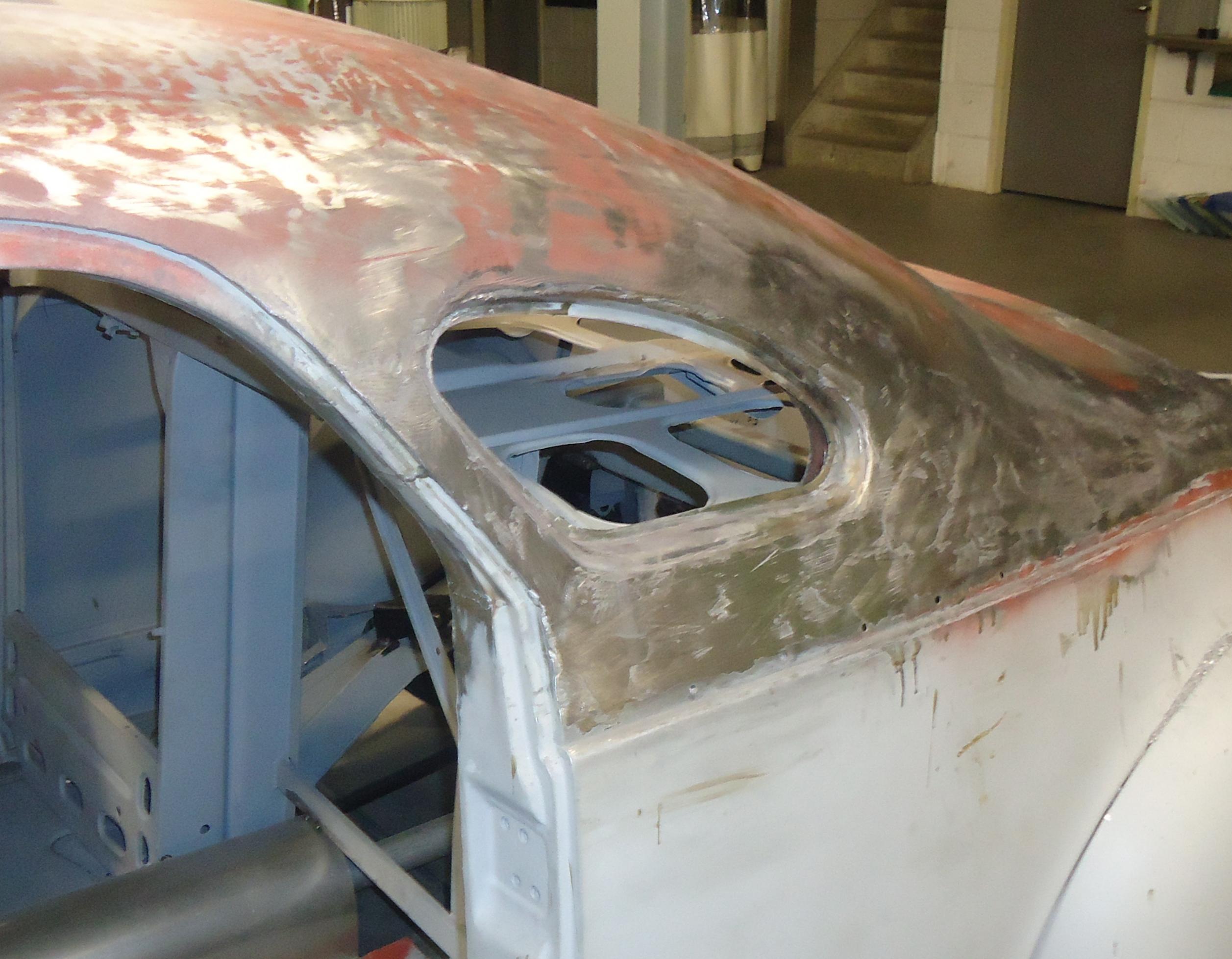

    Finished the driver side around the b-pillar and smoothed/sanded it all. Will tackle the door later. Going to move to the other side today.
    I've learned a lot regarding leading the last few days and now have the confidence/experience to do the other side all by myself. This should go a little quicker this time around.

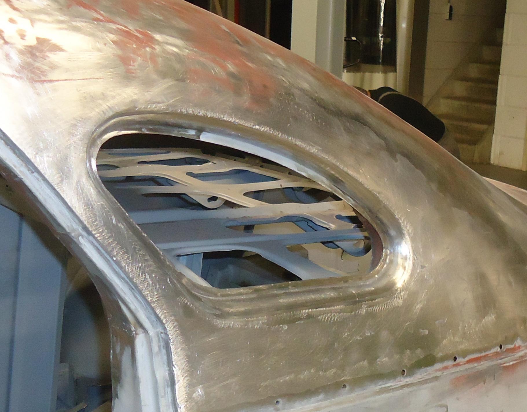

    Here are the pics.

    Thanks robleticia! Here's one more side profile shot. To get to this stage, it probably took me about 20 hours of work, but well worth it I think.

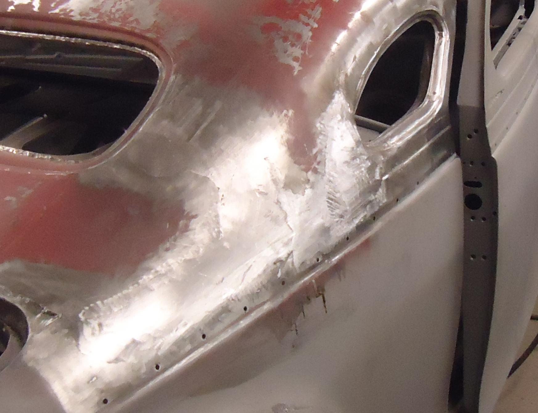

    Got started on the p***enger side today. Spend the good part of 6 hours cleaning the to be leaded area, applying the paste and lead. Will continue again tomorrow, hoping to get most of the area around the b-pillar and small window done.
