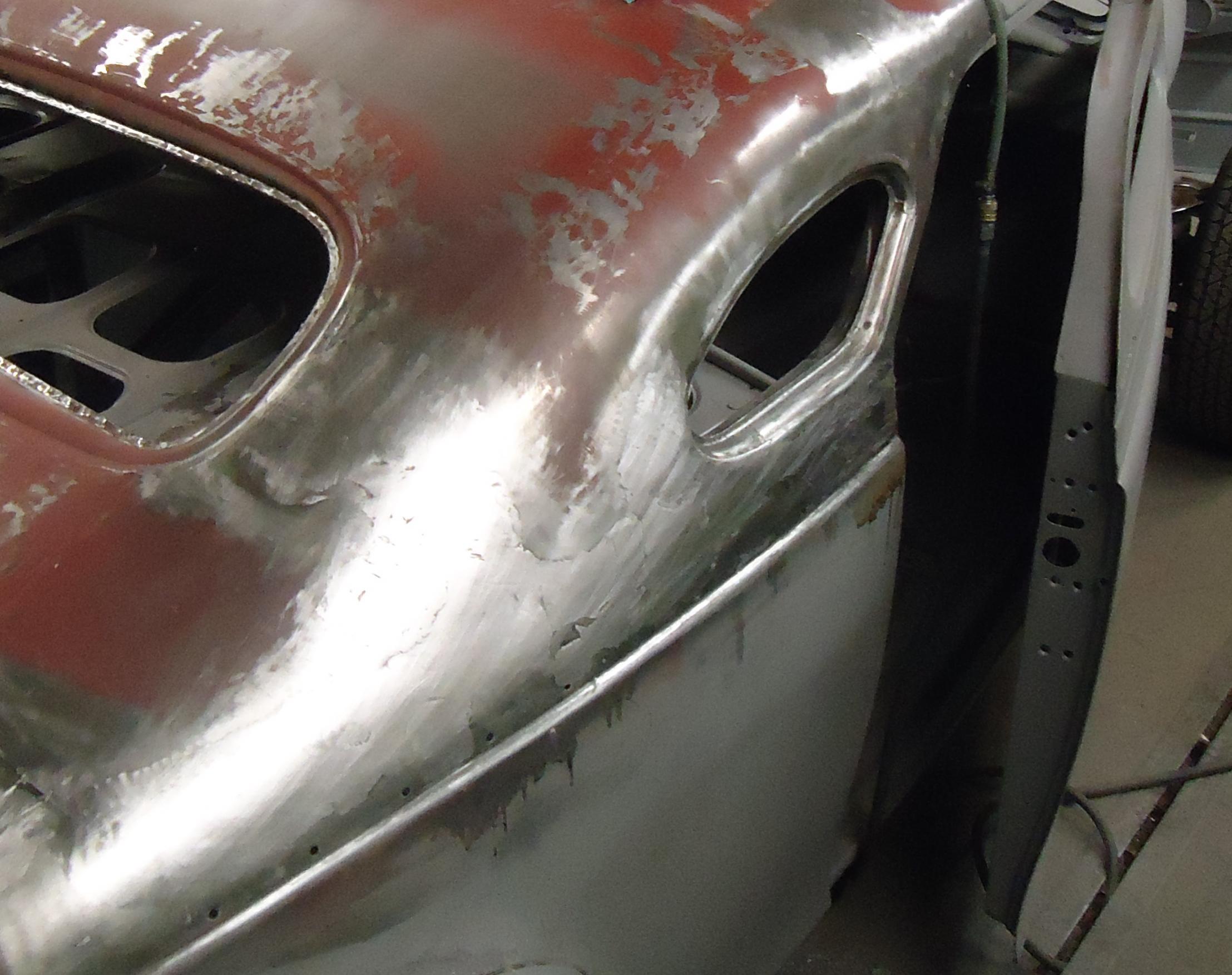

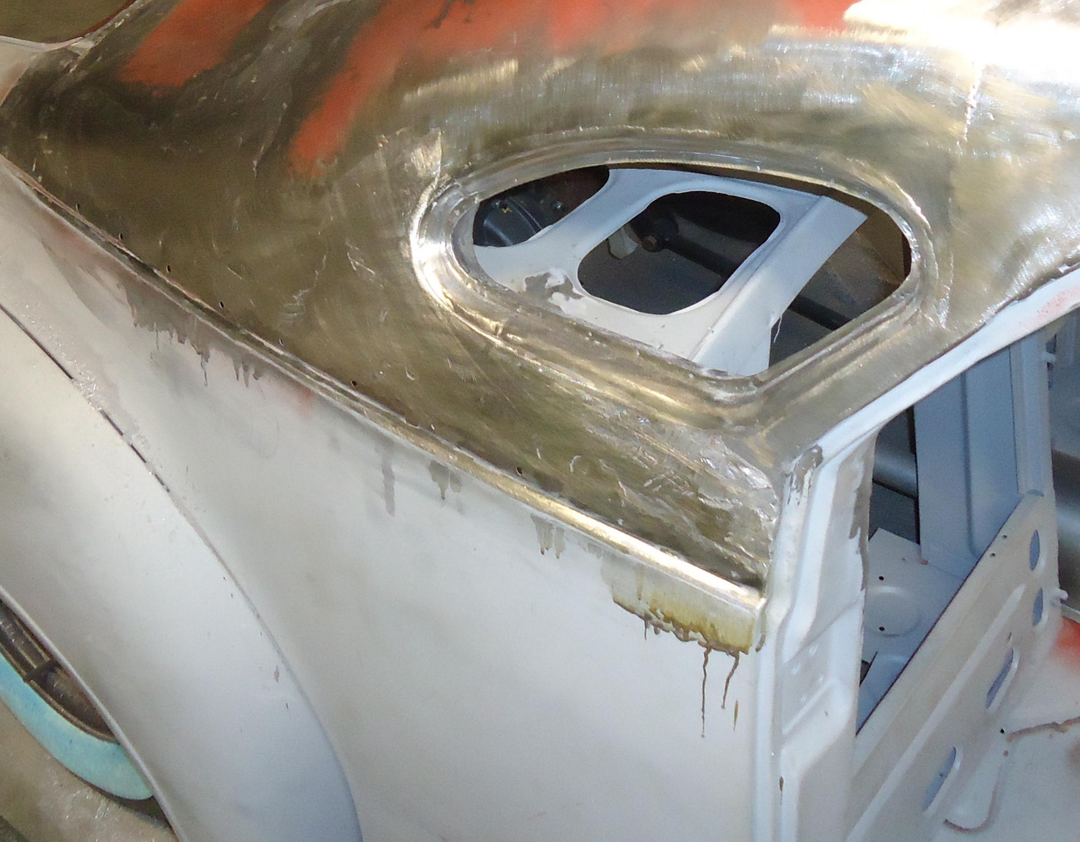

    Continued leading the p***enger side today. Moved from the trunk area towards the front, halfway up the c-pillar and all along the bottom of the small window, getting rid of the belt line. Getting there.....but it sure takes a long time if you want to get it close to perfect.

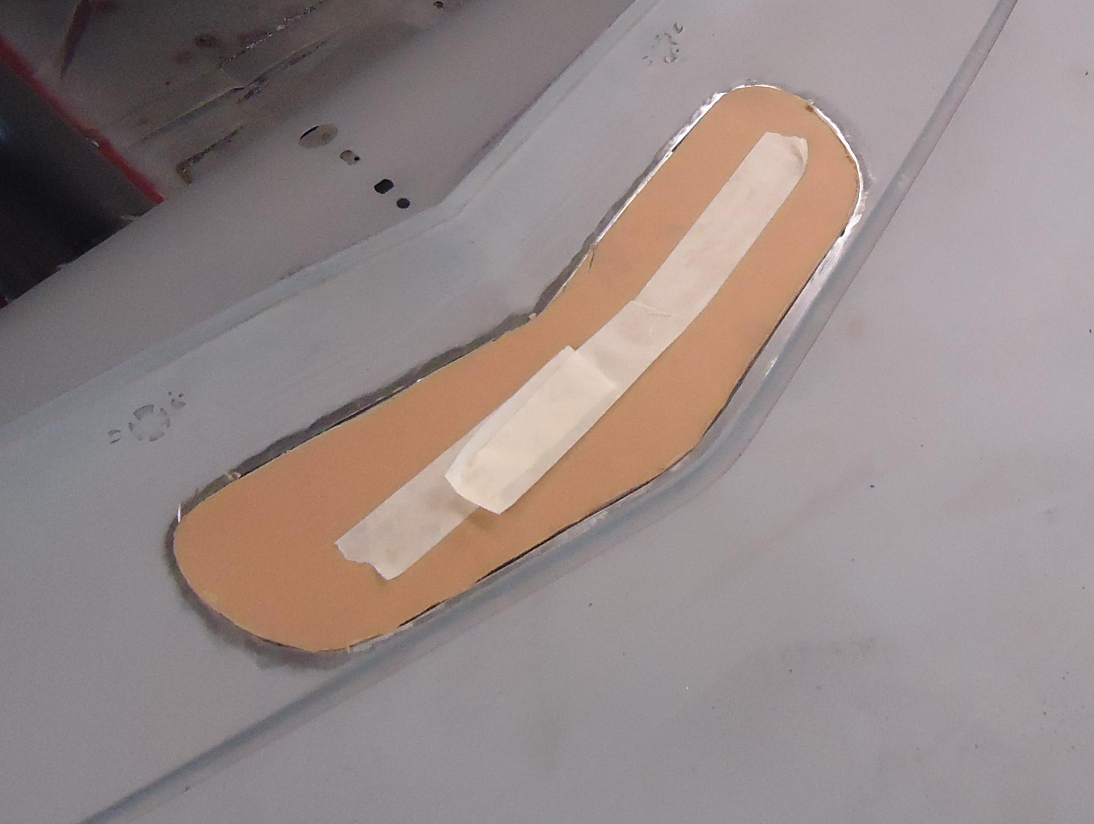

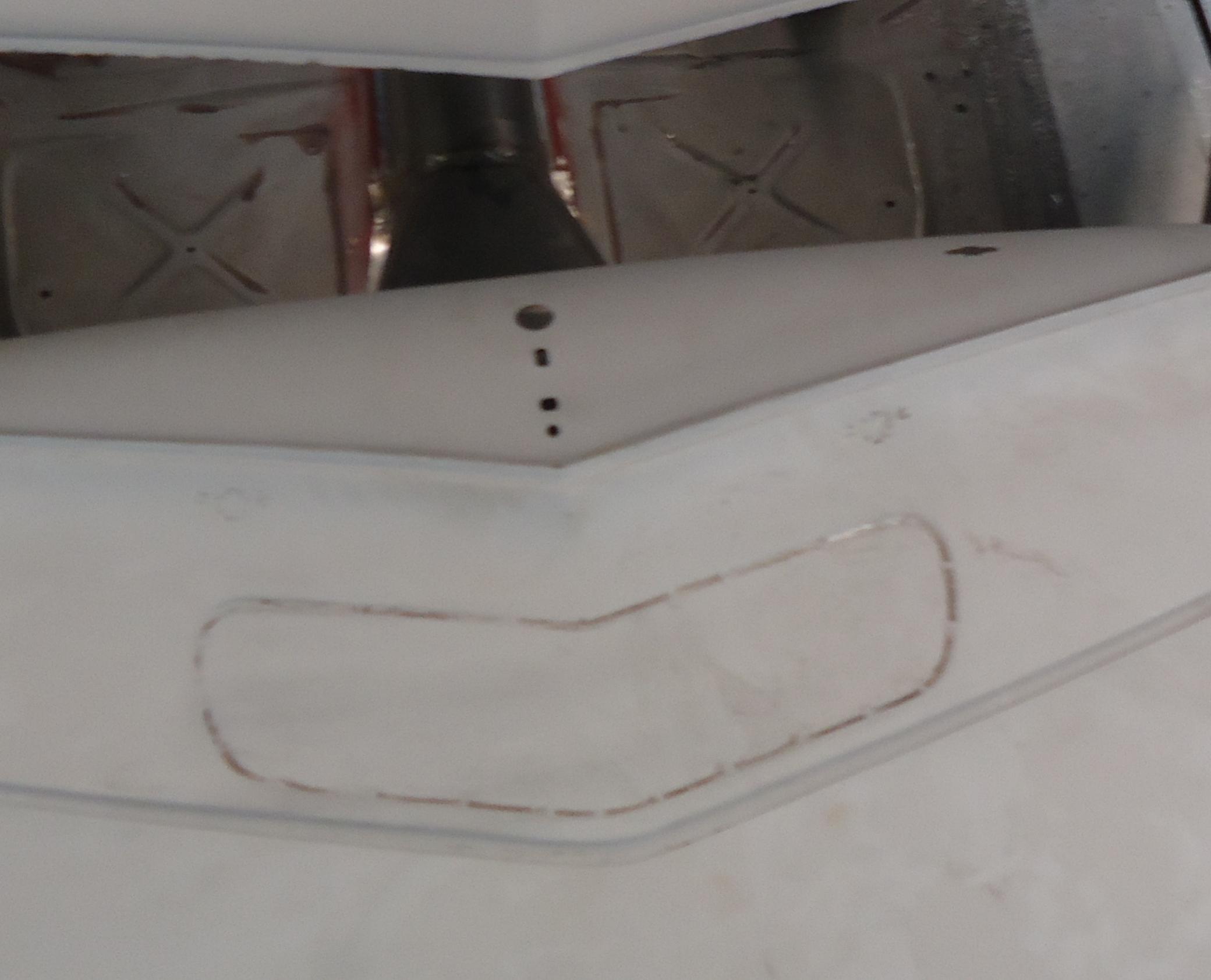

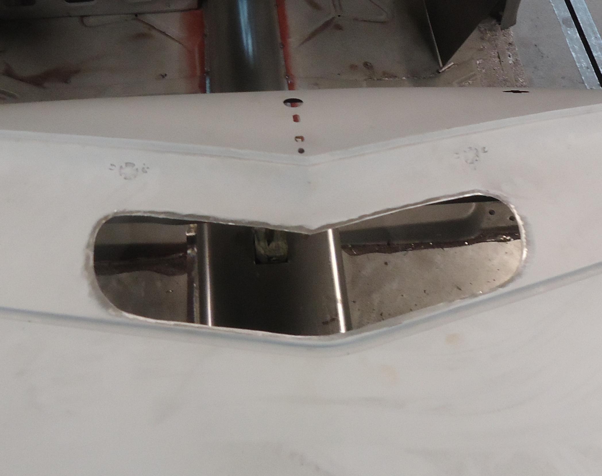

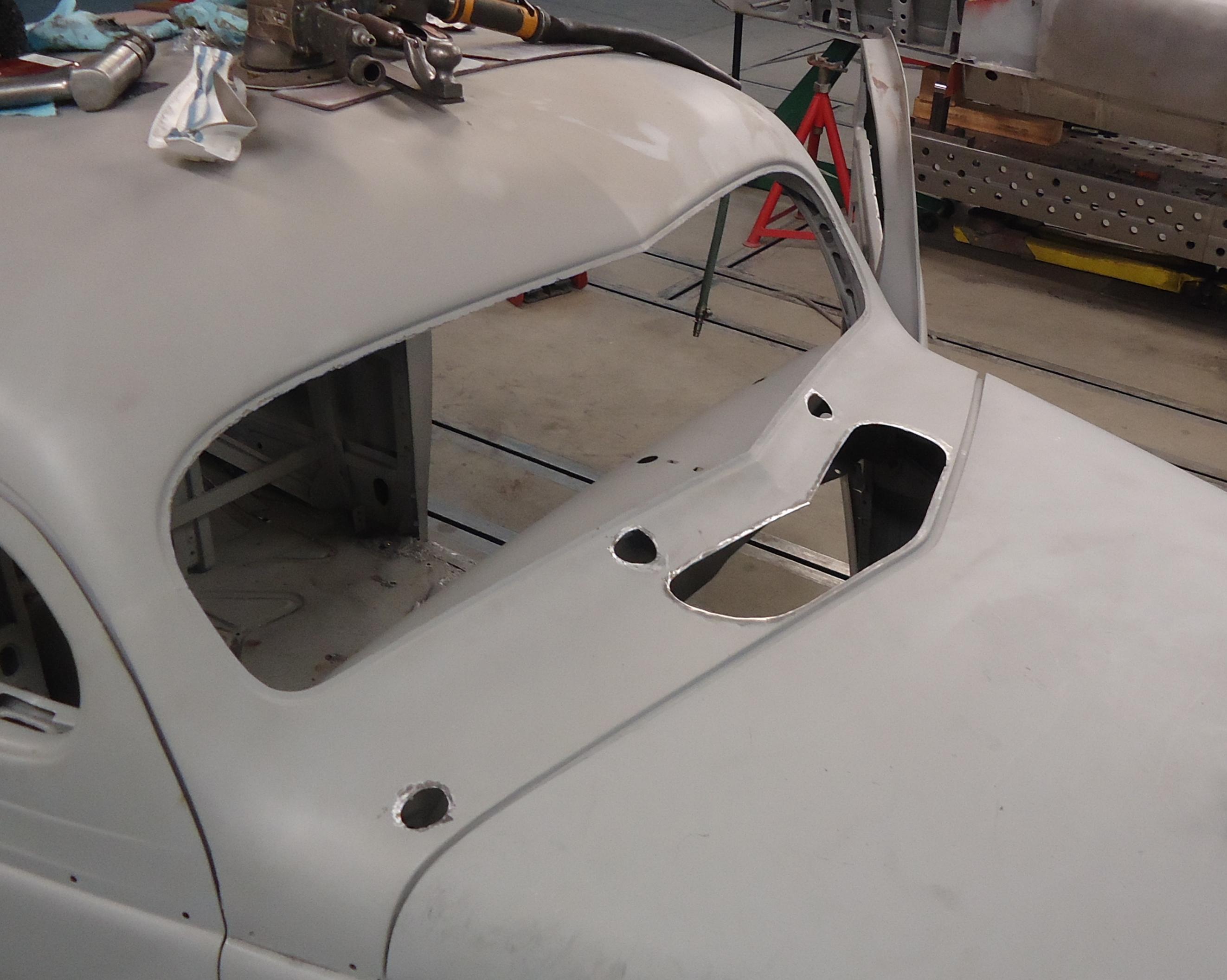

    Considering I was out of lead today, I thought I'd start work on the top part of the cowl. Initial idea was to only remove the old air intake, but along the way I decided to also remove the old wiper and antenna holes. After careful cutting I made a template for each of the holes out of thick cardboard. The wipers will be repositioned later and I have no need for an antenna hole. Next step is to cut the metal using the templates.
  9. farmer12
    Joined: Aug 28, 2006
    Posts: 7,723
    farmer12

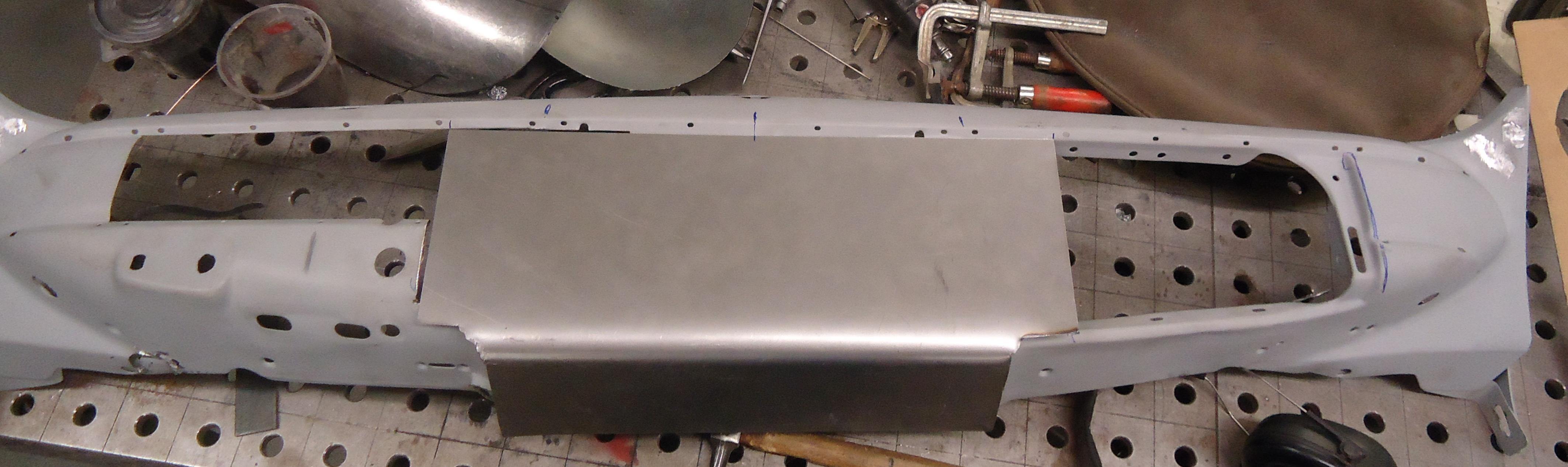

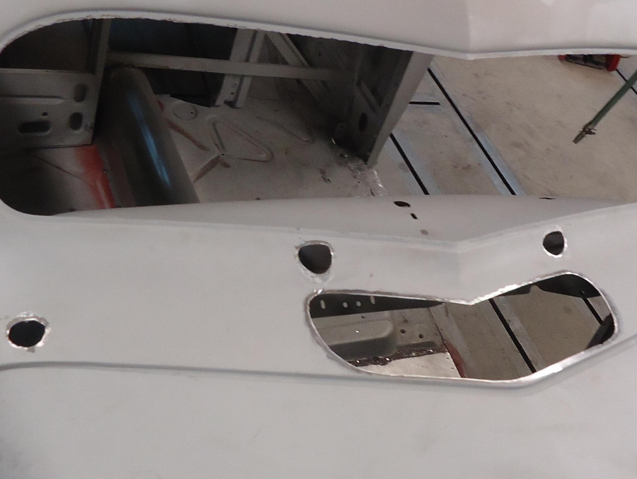

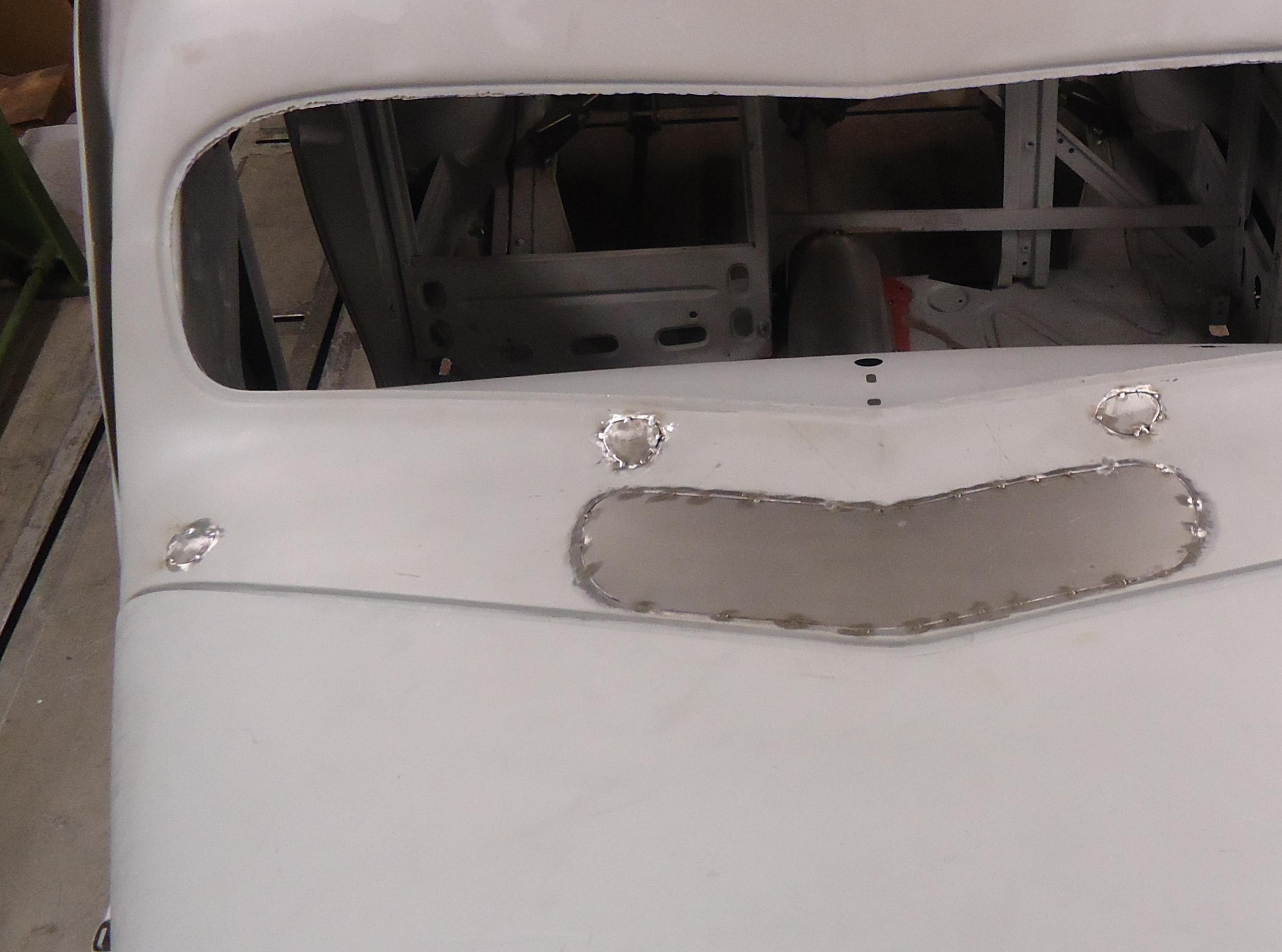

    I cut out all the metal pieces required using the cardboard templates. A little bending of each piece was required to get the correct shape in order to follow the contour of the cowl. Tacked all the pieces into place and ground down the welds. Will remove the dash next week so I have better access from below and do the final shaping and welding. Pretty happy with the progress today!

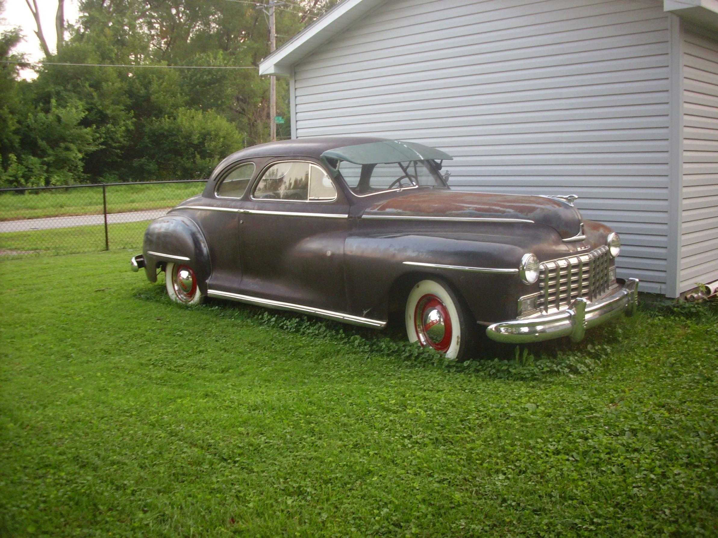

    I have a 1947 dodge a tad bigger 5 window than yours and a 383 in the shed......Hmmmm, maybe some day!:)
  14. farmer12
    Posts: 7,723
    farmer12
    Yep, it never seems to go quick enough for some reason. Patience is the key I think. Would be good if you'd show some pics of your Dodge! And yes, its still morning....in the land of winter.
  15. Frankie47
    Joined: Dec 20, 2008
    Posts: 1,877
    Frankie47
    from omaha ne.

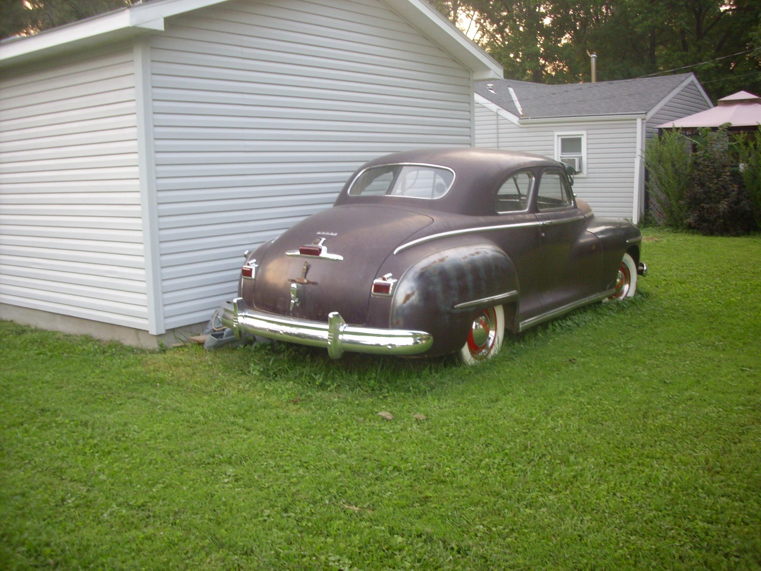

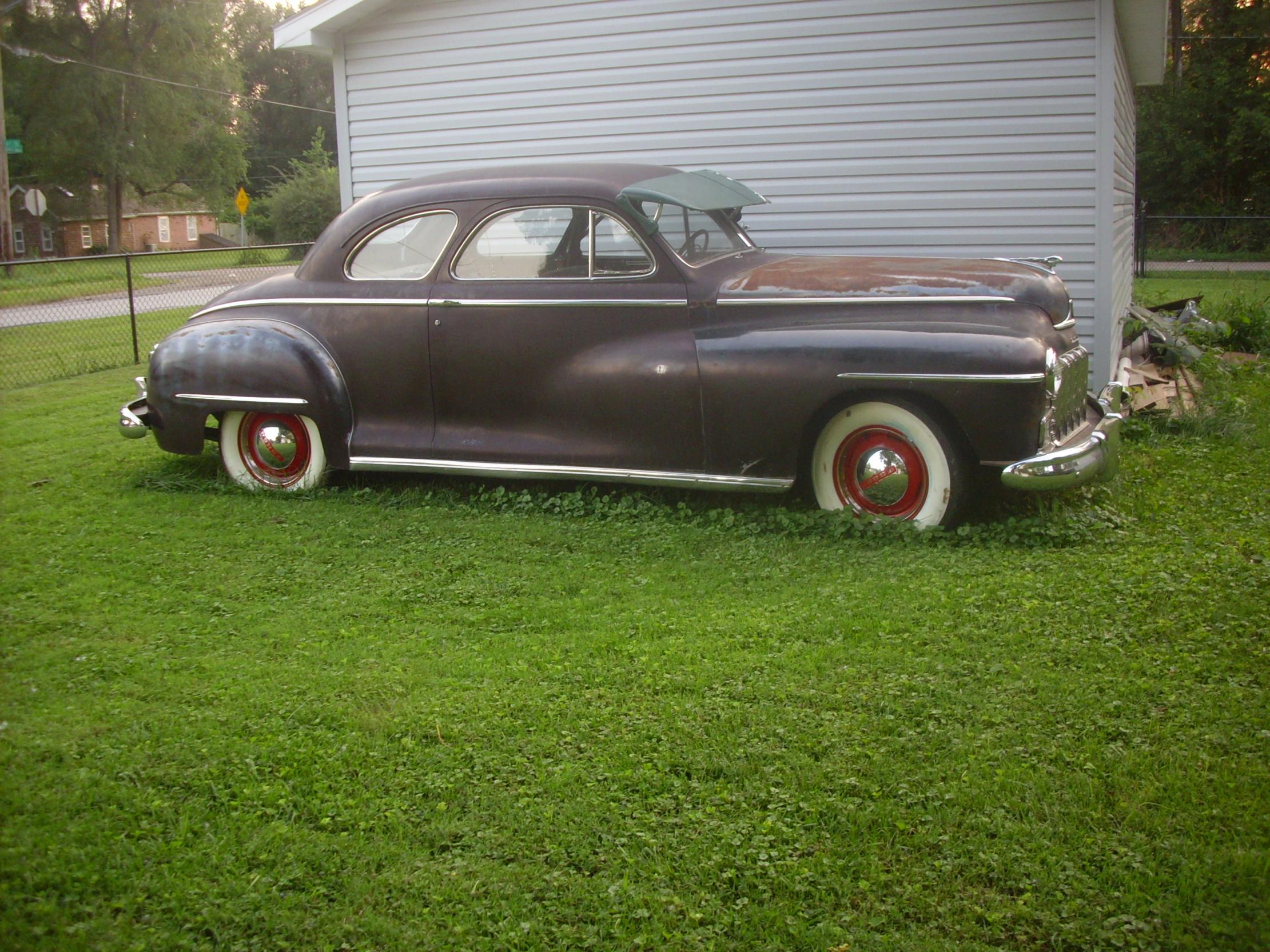

    My coupe and my parts car:)
  16. farmer12
    Posts: 7,723
    farmer12
    Wow, that looks like a great project! You could make something really nice out of this one for sure! Good luck with the build and let me know when start a build thread. (always willing to learn!)

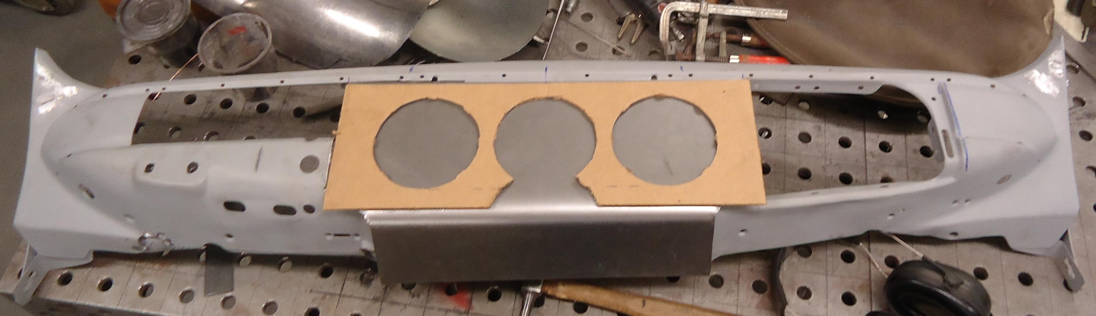

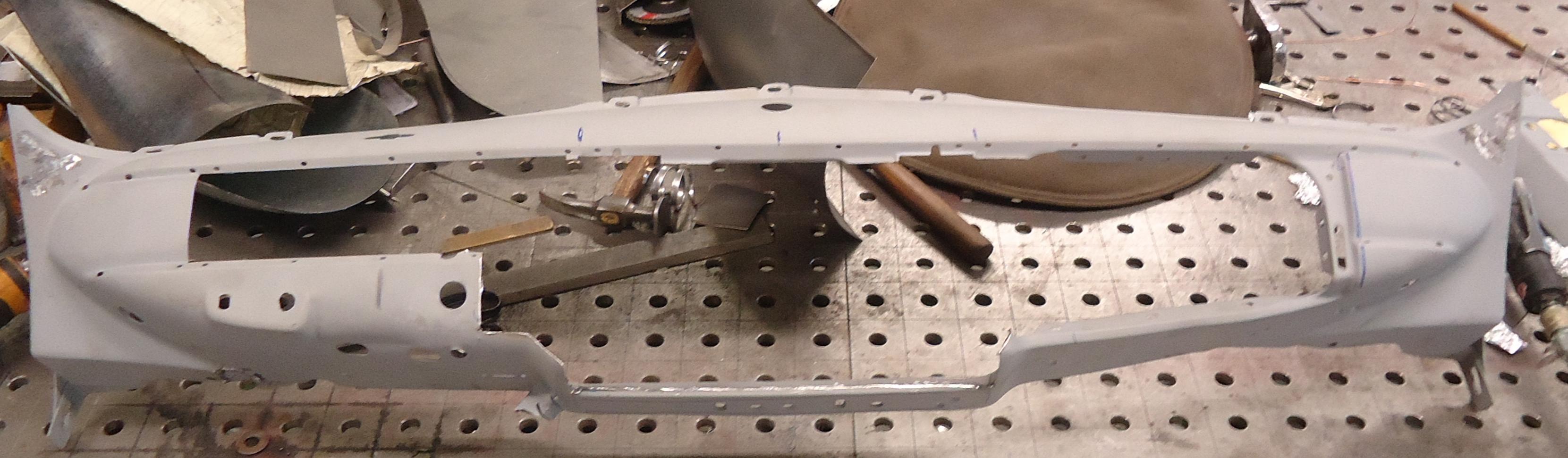

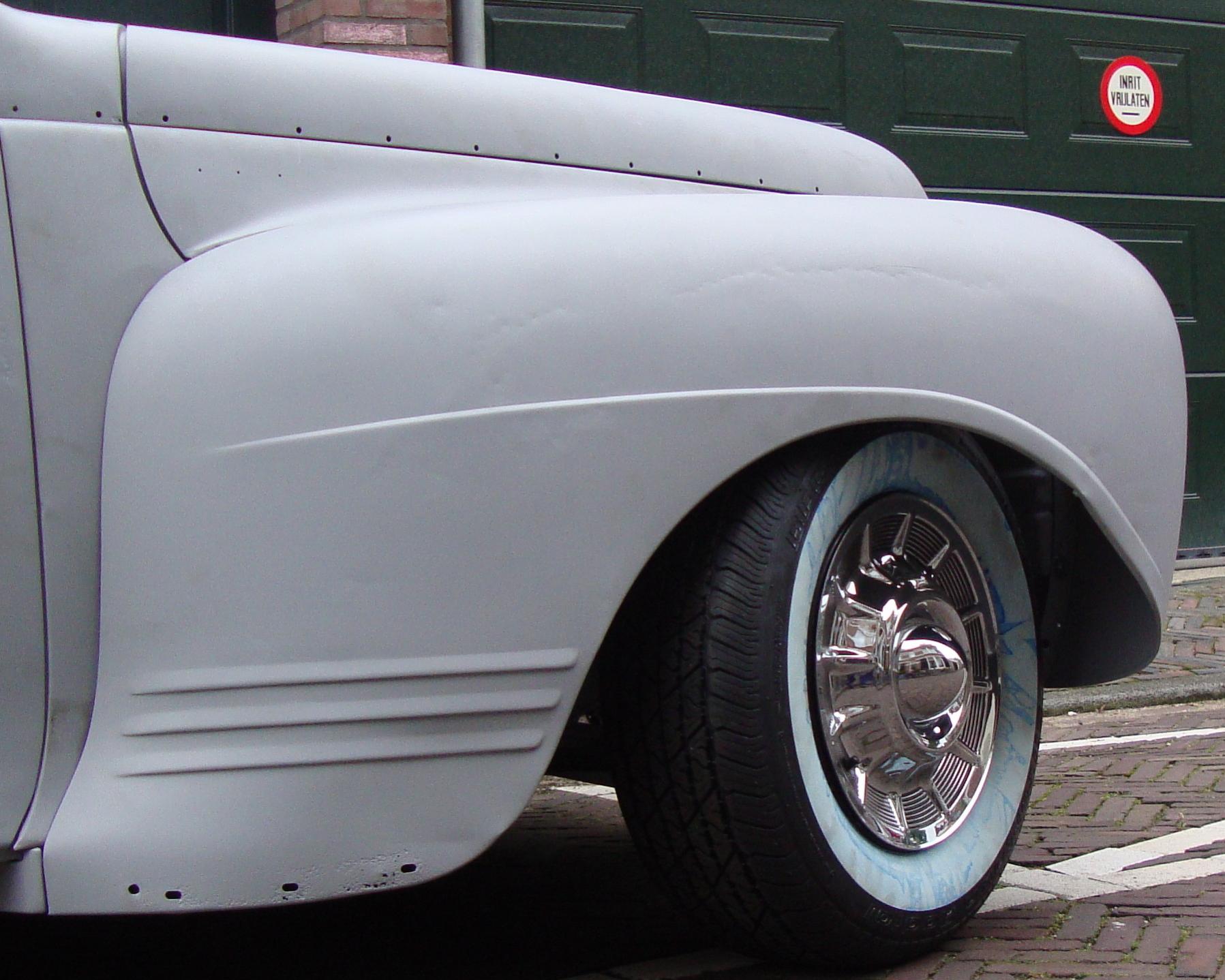

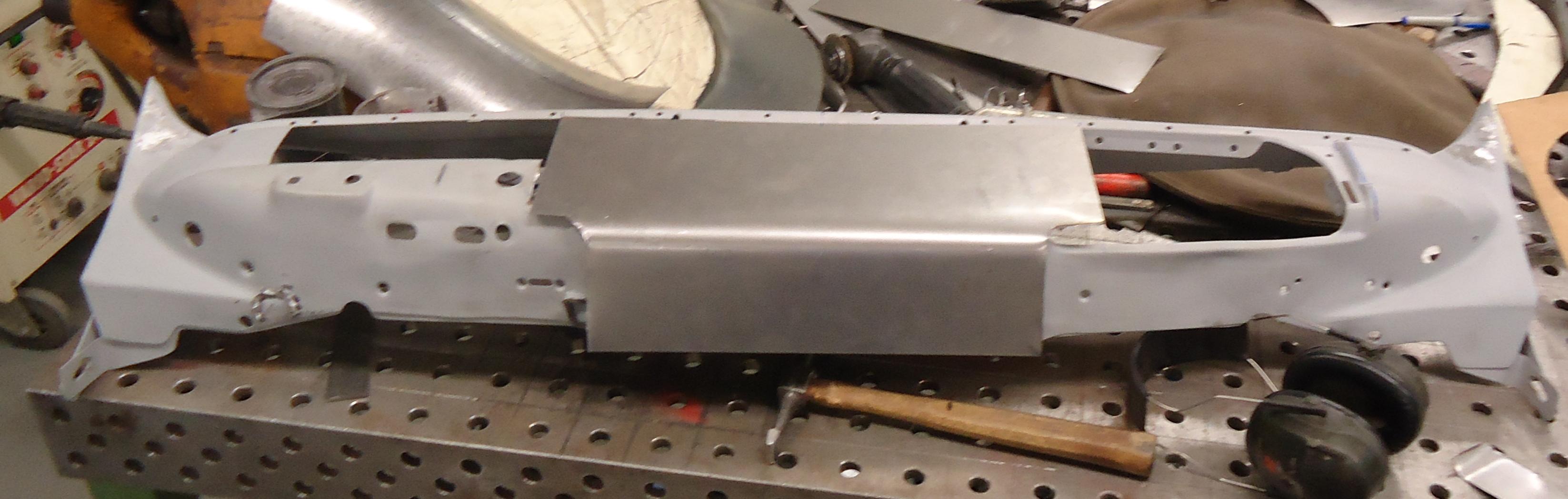

    Started work on the dashboard today, as the ordered lead had not arrived yet. I'm trying to retain the overall shape of the dash but require a flat area in the middle to install the 3 big gauges. Not going to use the glove box. So on either side of the gauges it will be smooth, toying with the idea of bringing back the 3 lines on the fender here.
  24. I wish I had photoshoping skills...I like your idea of incorporating the 3 fender lines into the dash. My only thought on this is since you plan on putting the guages in the middle, you could make the dash symetrical in regards to the area to the right and left of the guages (the rectangular area on the left could be duplicated on the right). This would allow space to put the 3 horizontal bars on each side of the guages.
    Of course, having the 3 horizontal bars under the guages would look really good but it doesn't look like you have much room to play with under the guages to put the horizontal bar.
    Just a thought.
  25. farmer12
    Posts: 7,723
    farmer12
    Thanks Hivolt5.0! Yes, thats the idea, to bring the 3 fender lines on each side of the gauges. And yes, I'm going to make each side symmetrical. Sorry, I probably wasn't too clear in my description. Your thoughts were mine exactly. Thanks for the input! Eric

    This is kinda rough but it may be close to what you have in mind. I brought the inside edges of the fender lines vertical and re-contoured the ends of the dash to flow a little better with the outside tips of the fender lines. Couldn't find a decent set of gauges to throw in there. If you'd like some adjustments let me know.
    [​IMG][​IMG]
  29. OahuEli
    Joined: Dec 27, 2008
    Posts: 5,243
    OahuEli
    from Hawaii
    Here's a shot with Hivolt5.0s idea of the bar under the gauges. They had to be moved up a little but it might work.
    [​IMG][​IMG]
  30. farmer12
    Posts: 7,723
    farmer12
    Great work OahuEli ! This is pretty much the look I'll be going for, perhaps with only a few minor adjustments. Thanks for your time and effort. Eric
