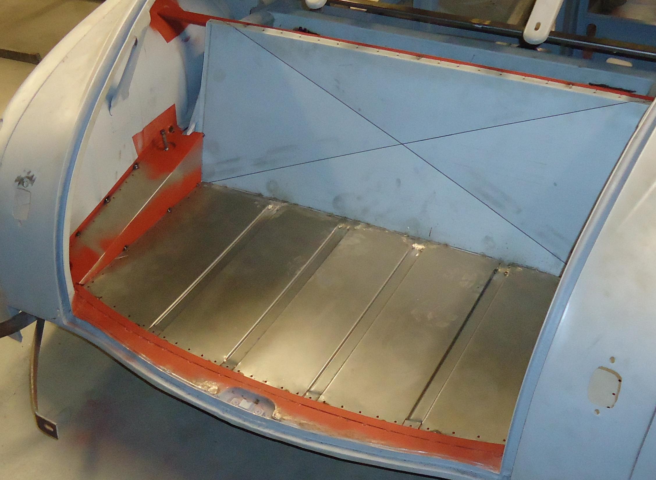

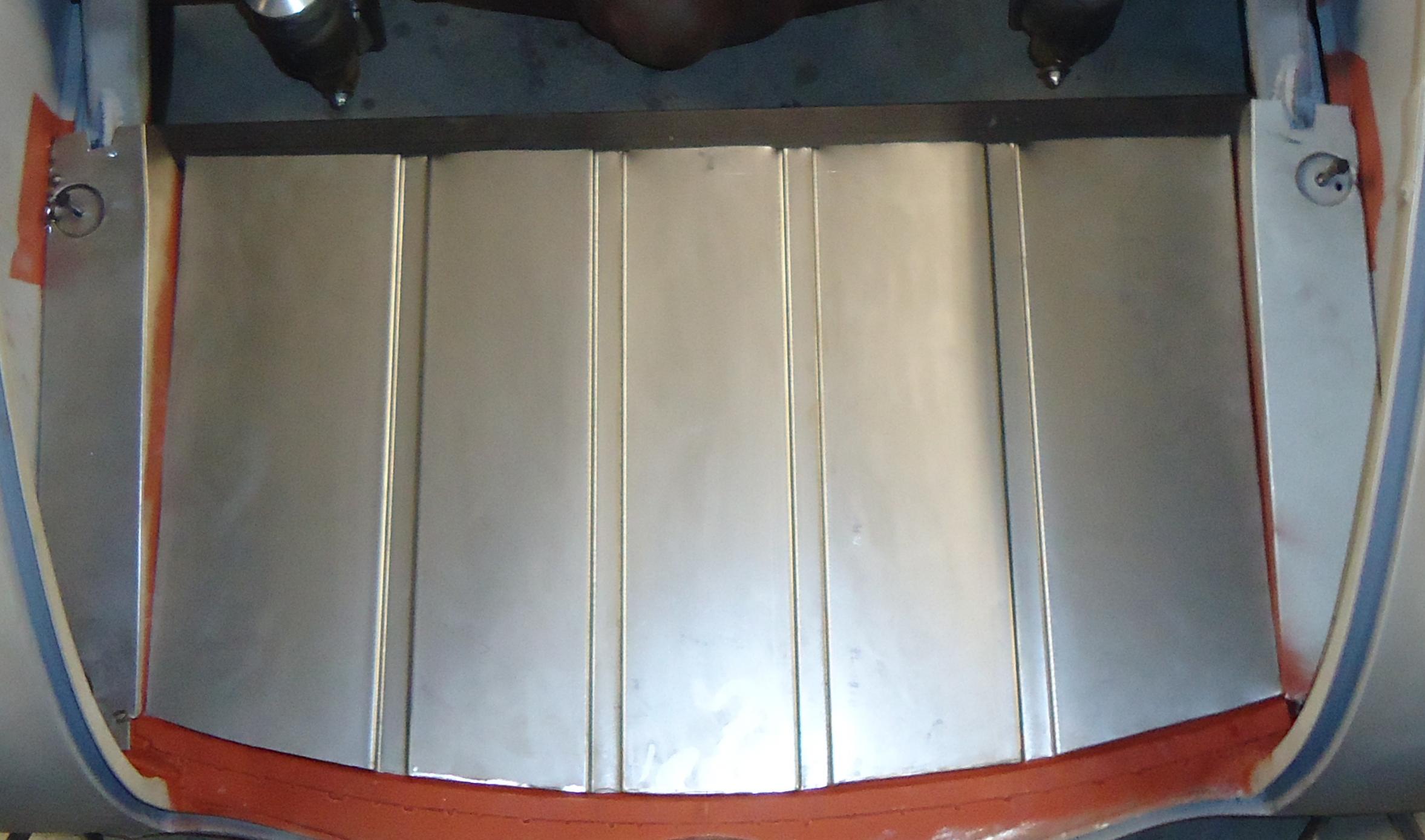

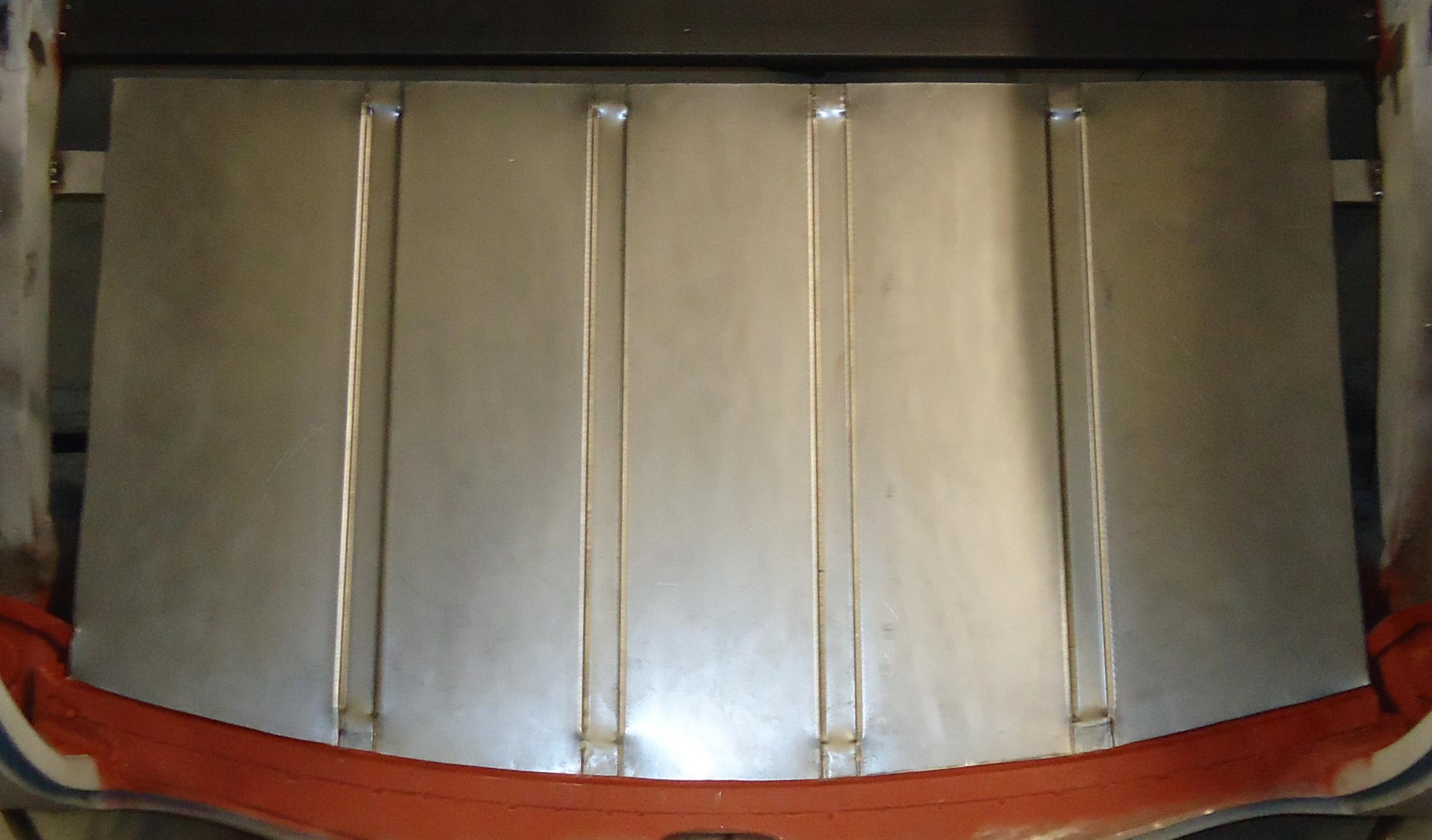

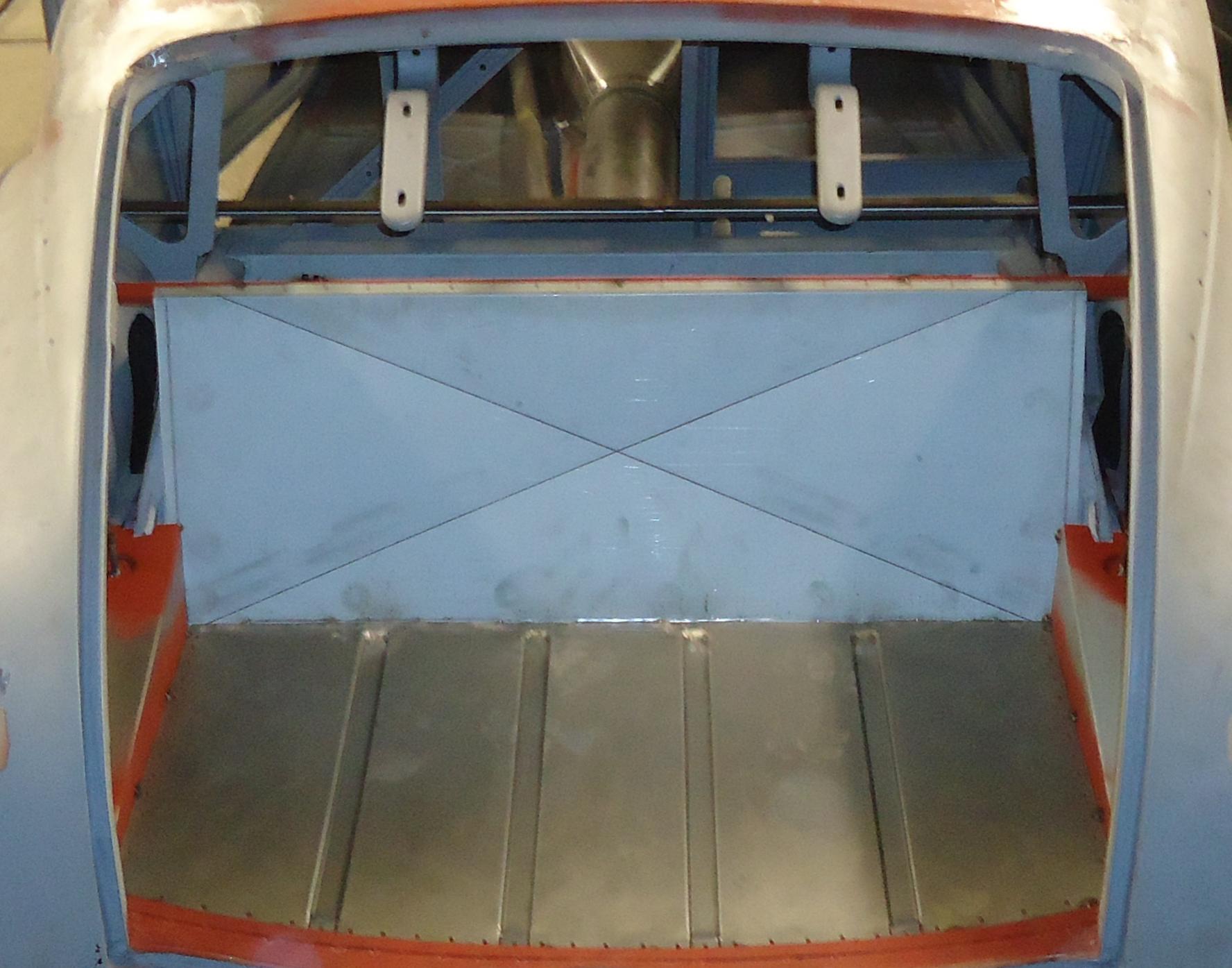

    Started off this morning by milling a few round pieces to act as a support in between the two brackets. Then cut a sheet (slightly oversized to allow for shrinkage)and stamped lines into it together with Martijn.(Martin's son). Then got all the tools out a shaped it into a trunk floor. Its still sitting high in the front and rear due to the stampings. I'll be grinding and welding them next time to create a flat surface and eliminate it from waving.

    Wow,thats a nice trunk pan!

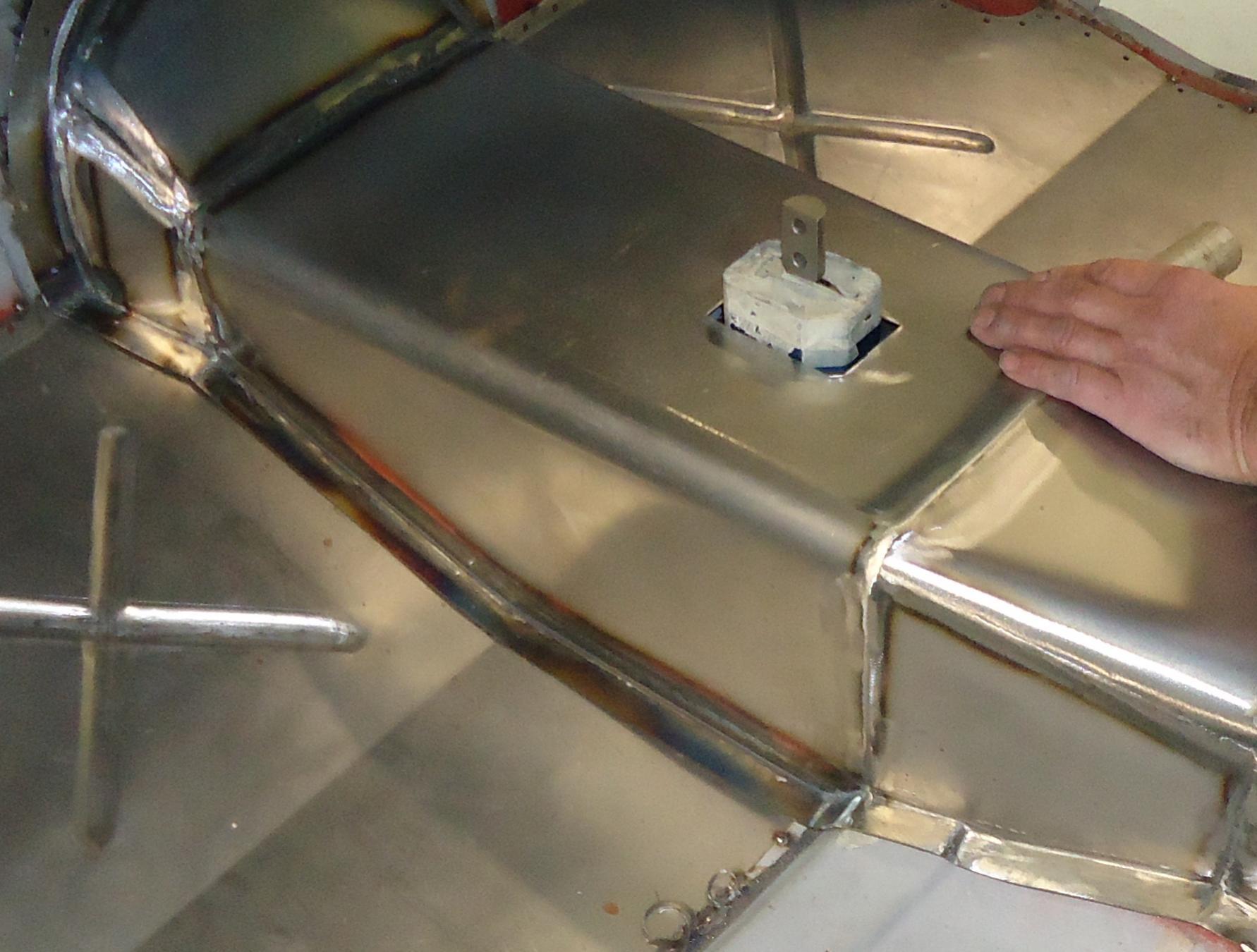

    Today I made incisions on either side in the trunk floor so its able to lay flat. Hammered it into shape, welding it tomorrow. Also trimmed the floor even more, happy with the result now. Also bent a strip of 1.5 mm to act as a support above the c notch to ensure a rigid structure.

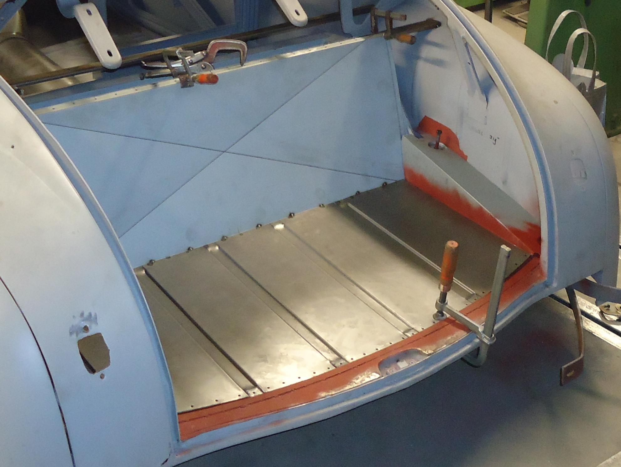

    Got a lot done today! Fabricated a piece to go along the trunk side of the c notch. Measured the angle at which the lips needed to be bent and made a slight cross in it to prevent it from resonating. Then drilled holes in the lips and then test fitted both sheets of metal. Then tack welded it in place, took it out again and spot welded the bottom. Should be finished with the trunk area tomorrow. Yes!

    Started off this morning re measuring: the cross bar above the c notch was a little too high for my liking. It also seemed to "pull" up the trunk floor slightly. So decided to grind the welds, take it off, modify and lowered it 11mm. Then test fitted it all again. Much better. Took out all the parts again, punched holes for the spot welds and treated the "never to be seen again" edges with an anti rust primer. Next: final test fit before tacking it all into place. Can't wait!

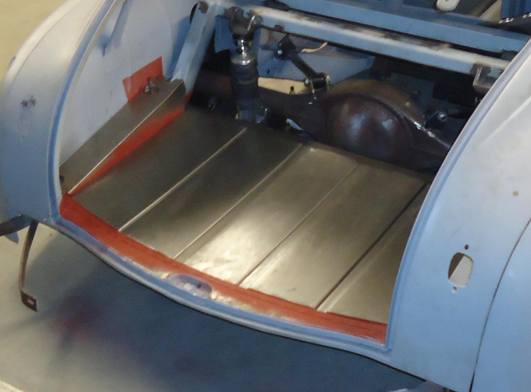

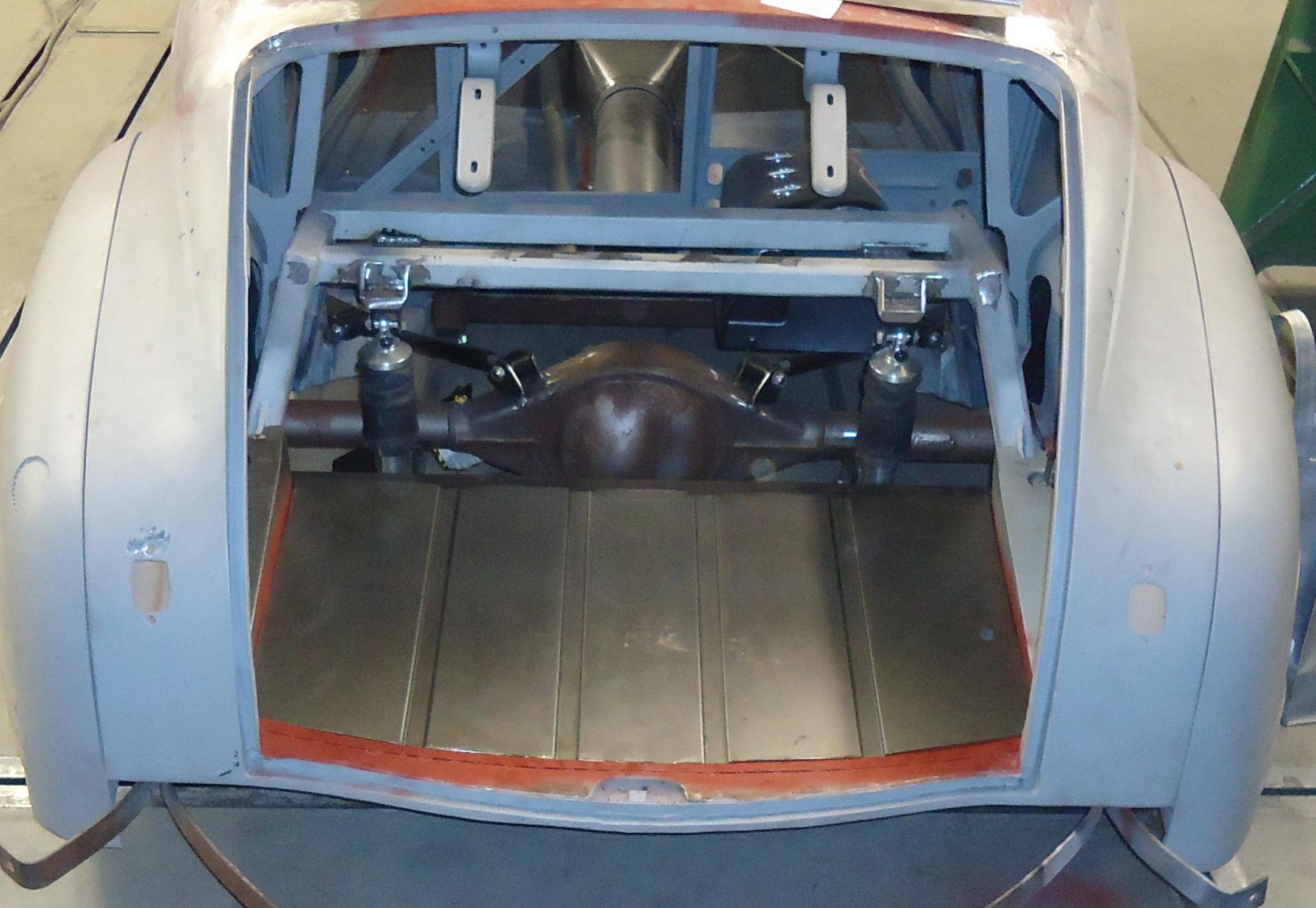

    After a test fit and a few minor adjustments, I finally tacked it all into place. Even stood in it and it held my 90 kg body without any problems. Yes, it's done! Final TIG welding will be done by some friends. Going to start around the c notch tomorrow. You won't believe how happy I am, now that this is done! Don't get me wrong. I enjoyed it immensely, but it just took a long time to fabricate and modify all the different parts. YES!!!

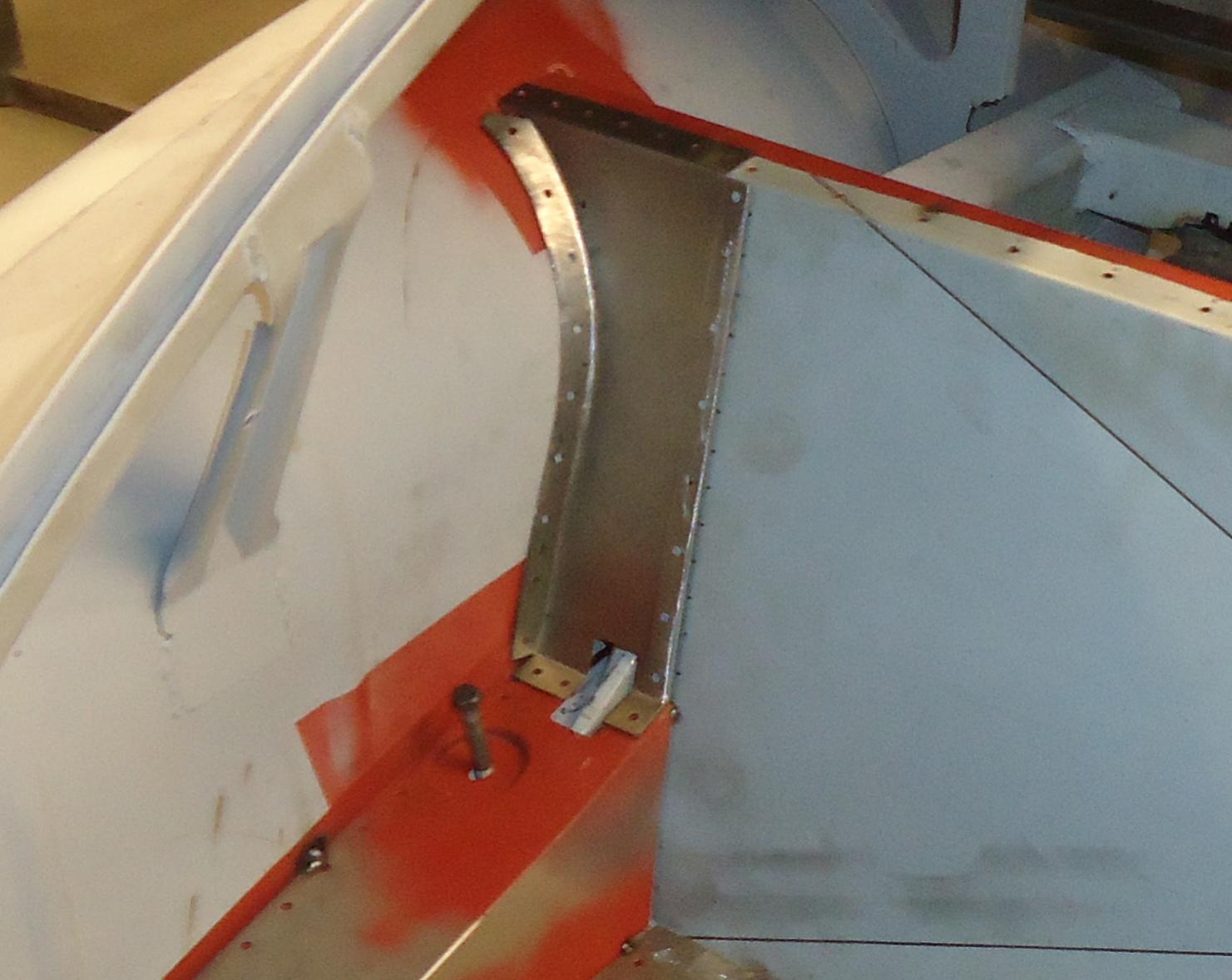

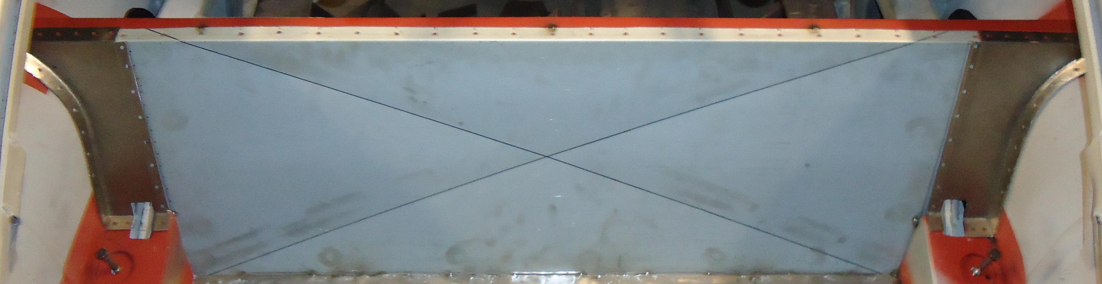

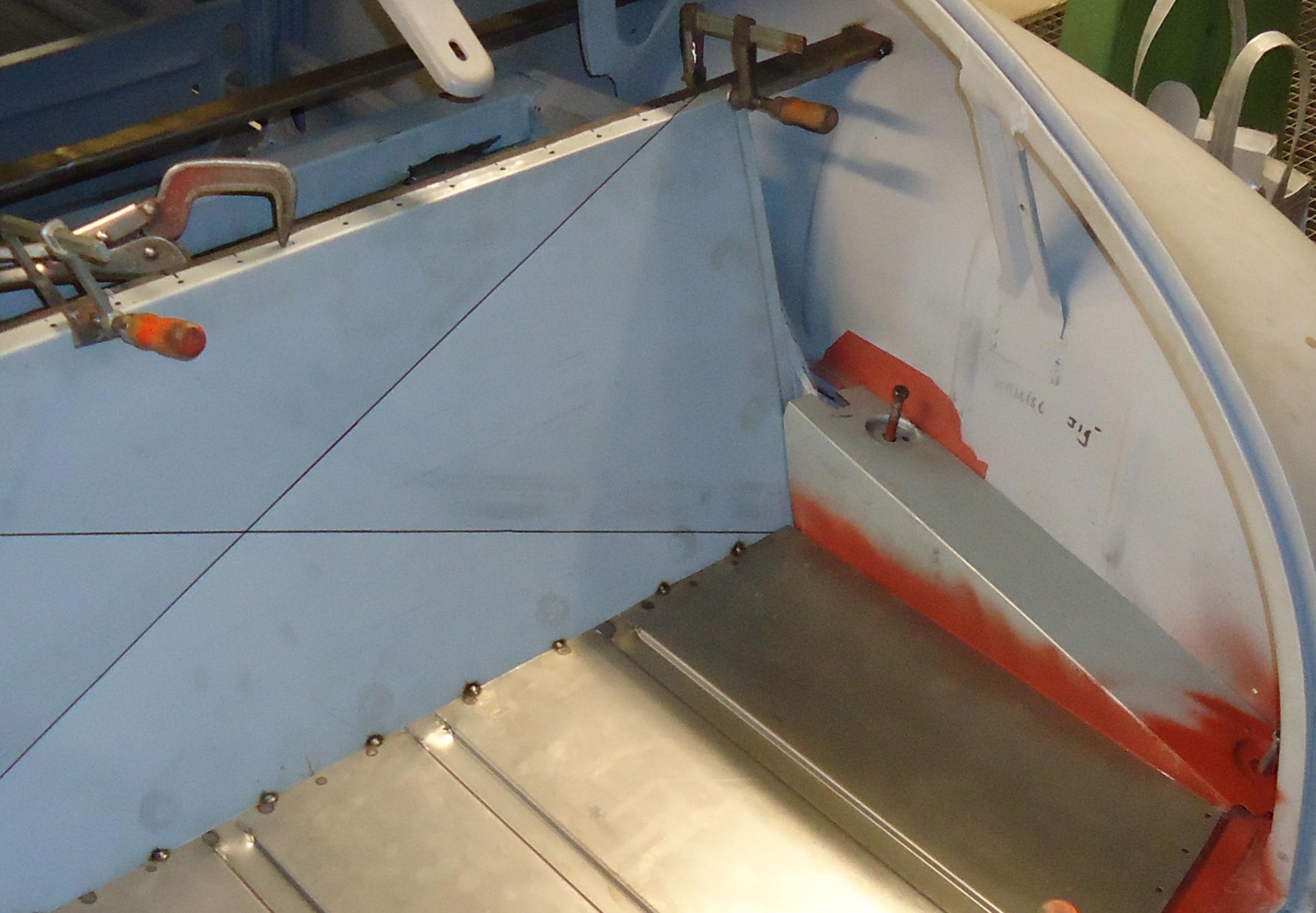

    Even though my initial plan was to close the top part above the c notch, I decided to close either side if the vertical panel first. Fabricating and the thinking process took me most of the day. Progression is continueing at a good rate at the moment. Here are some pics.
