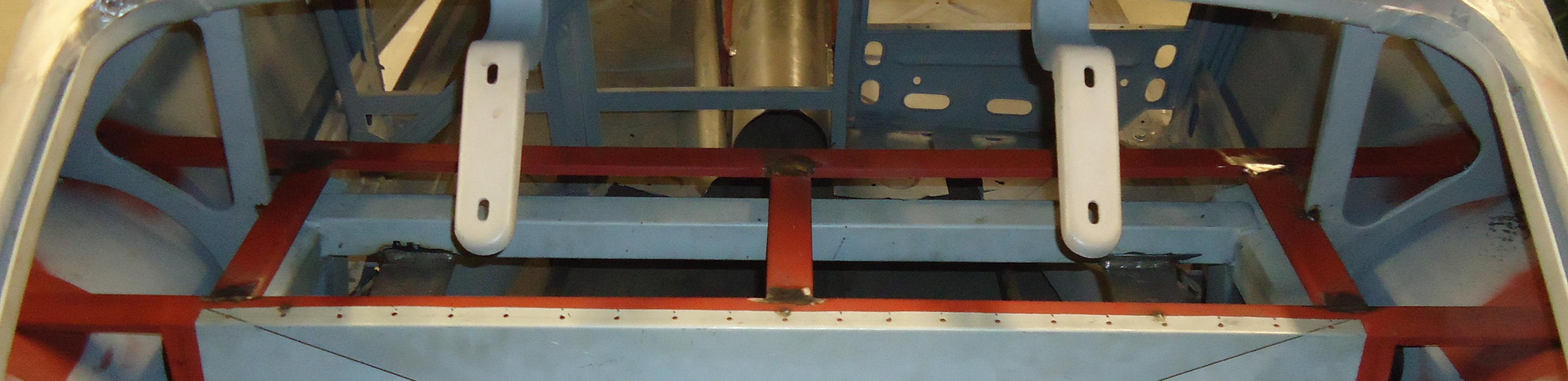

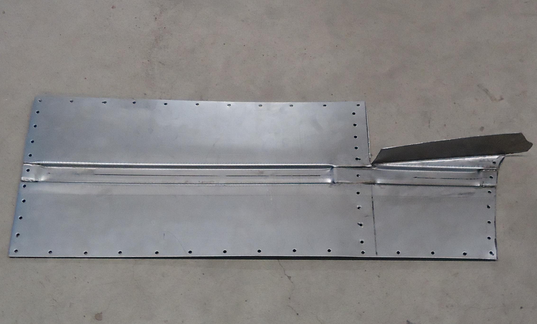

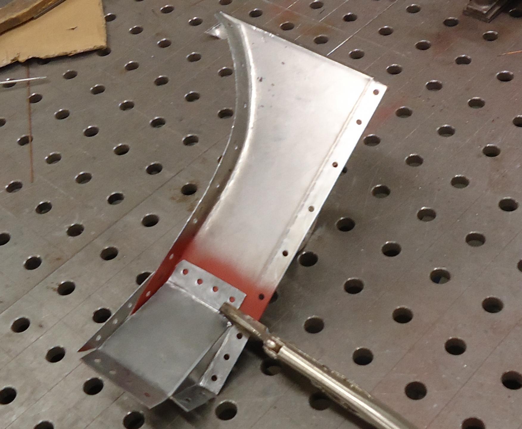

    Today I fabricated the pieces to cover the two small holes uncovering the ch***is. The initial plan was to fabricate a simple u-shape but decided against it. I fabricated pieces that will intergrate with the already made side panels,for a sturdier and cleaner look.

    Made a ladder type frame above the c notch, in order to be able to close it with sheet metal. Also indented two pieces to stop it from resonating. Tomorrow I'll do final fabrication and fitting. Will have it all in place by the end of the day. (I hope)

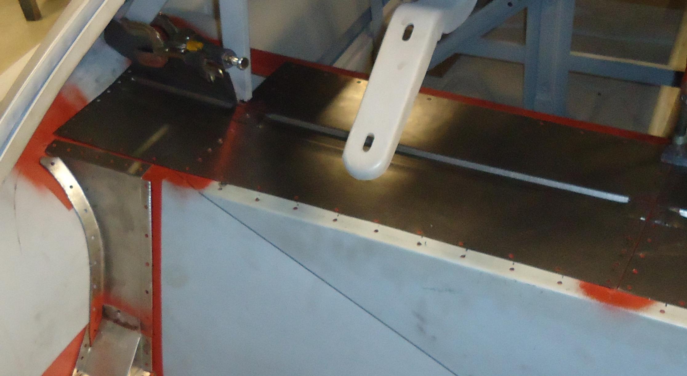

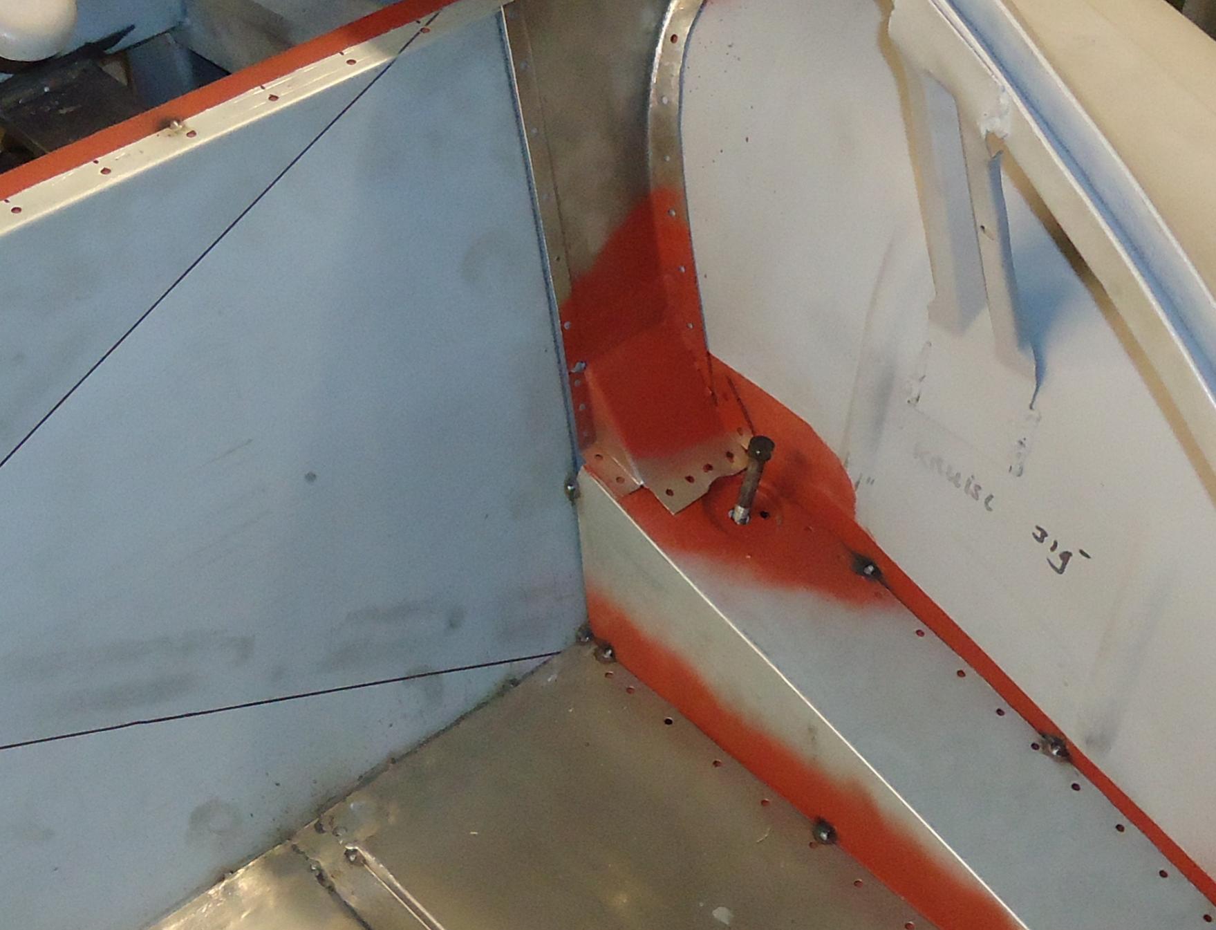

    Finished off the two top panels today. I just clamped them losely in place for the pics awaiting final spot welding, hopefully next week. I'll be working on the car again next wednesday when I'll tackle the area below the hat shelf. I'm still wondering if I'll move the frame behind the driver forward in order to create a bit more space for the fuel tank and airride set up. I'll have a few days to think about that I guess....
