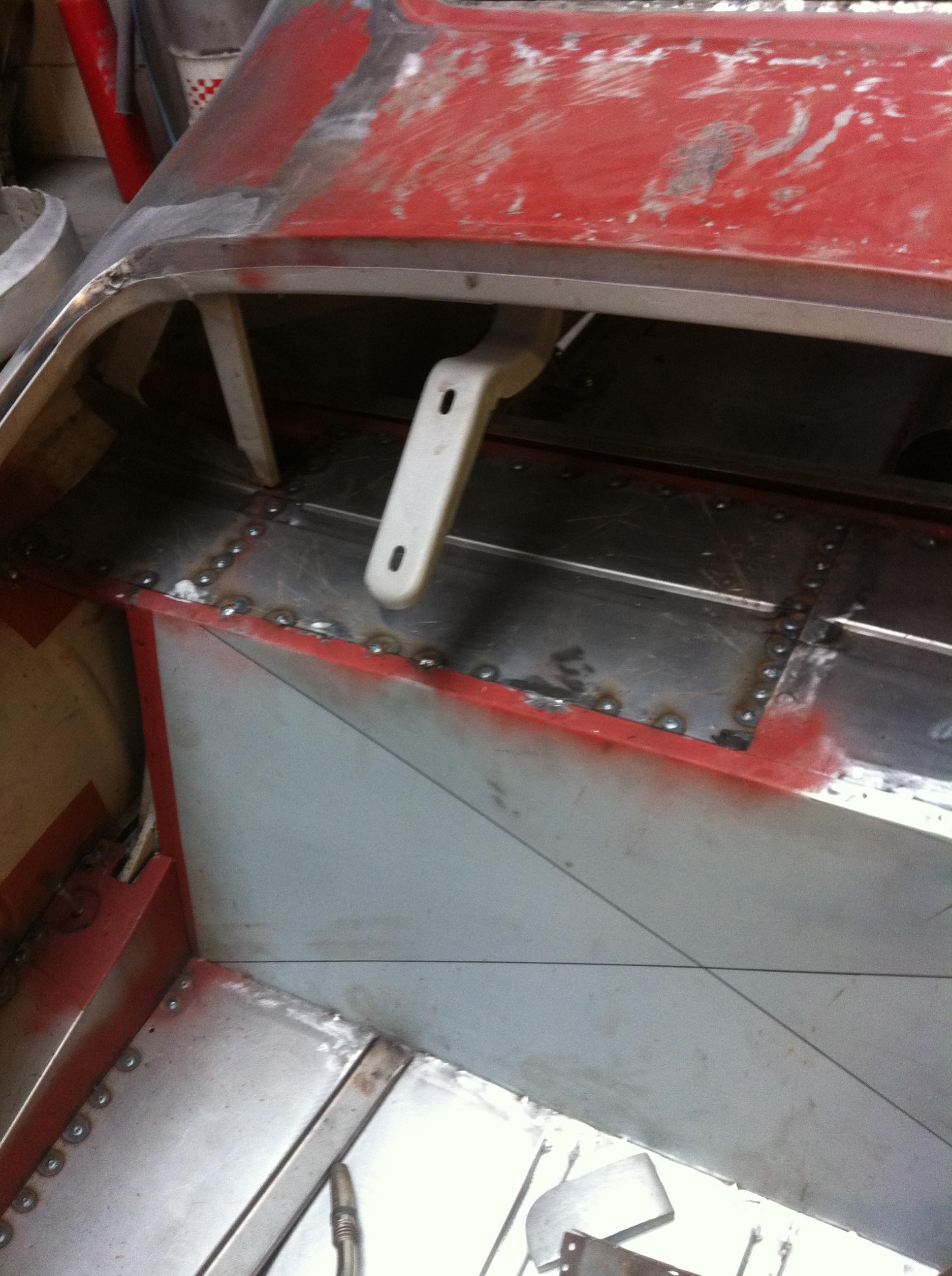

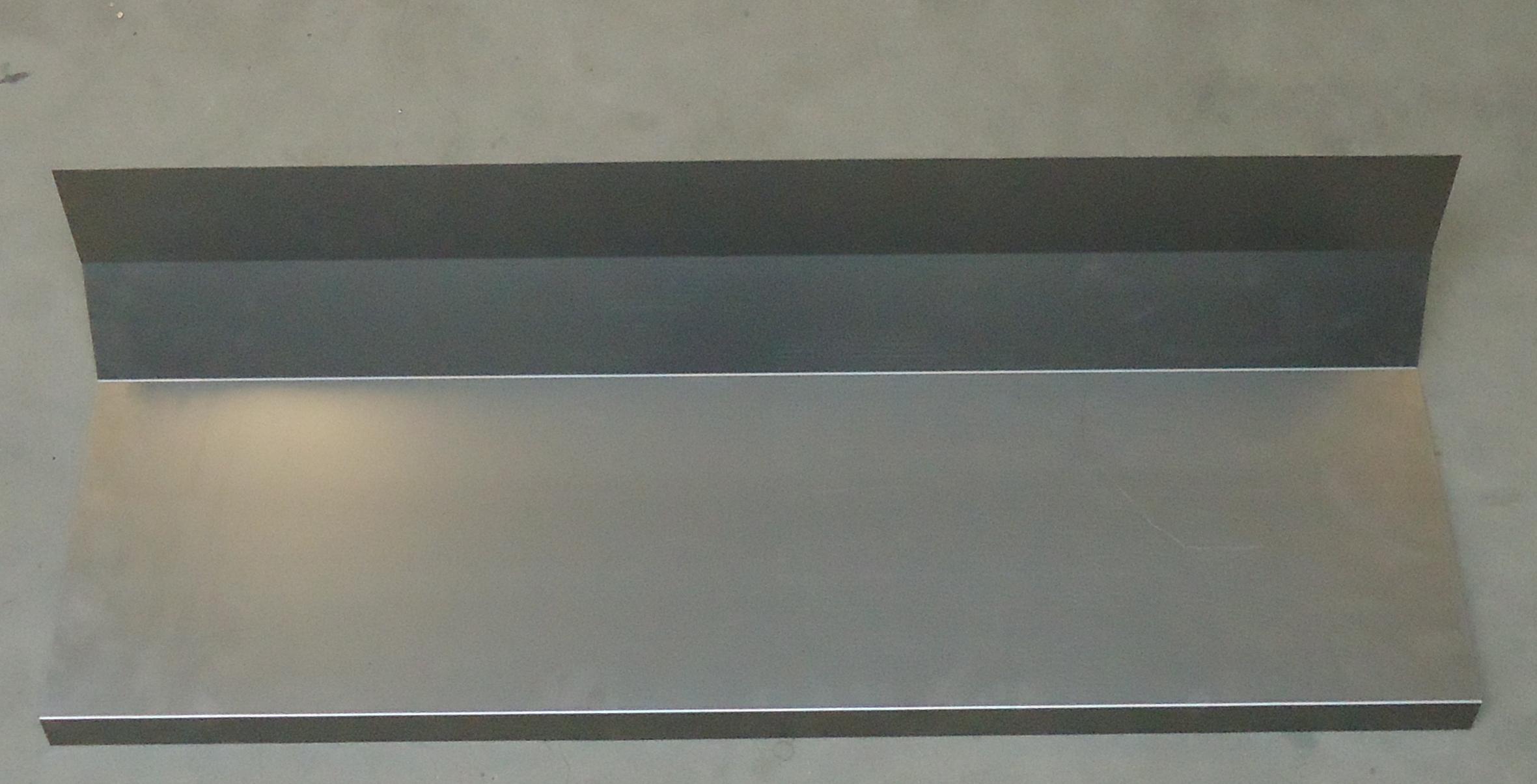

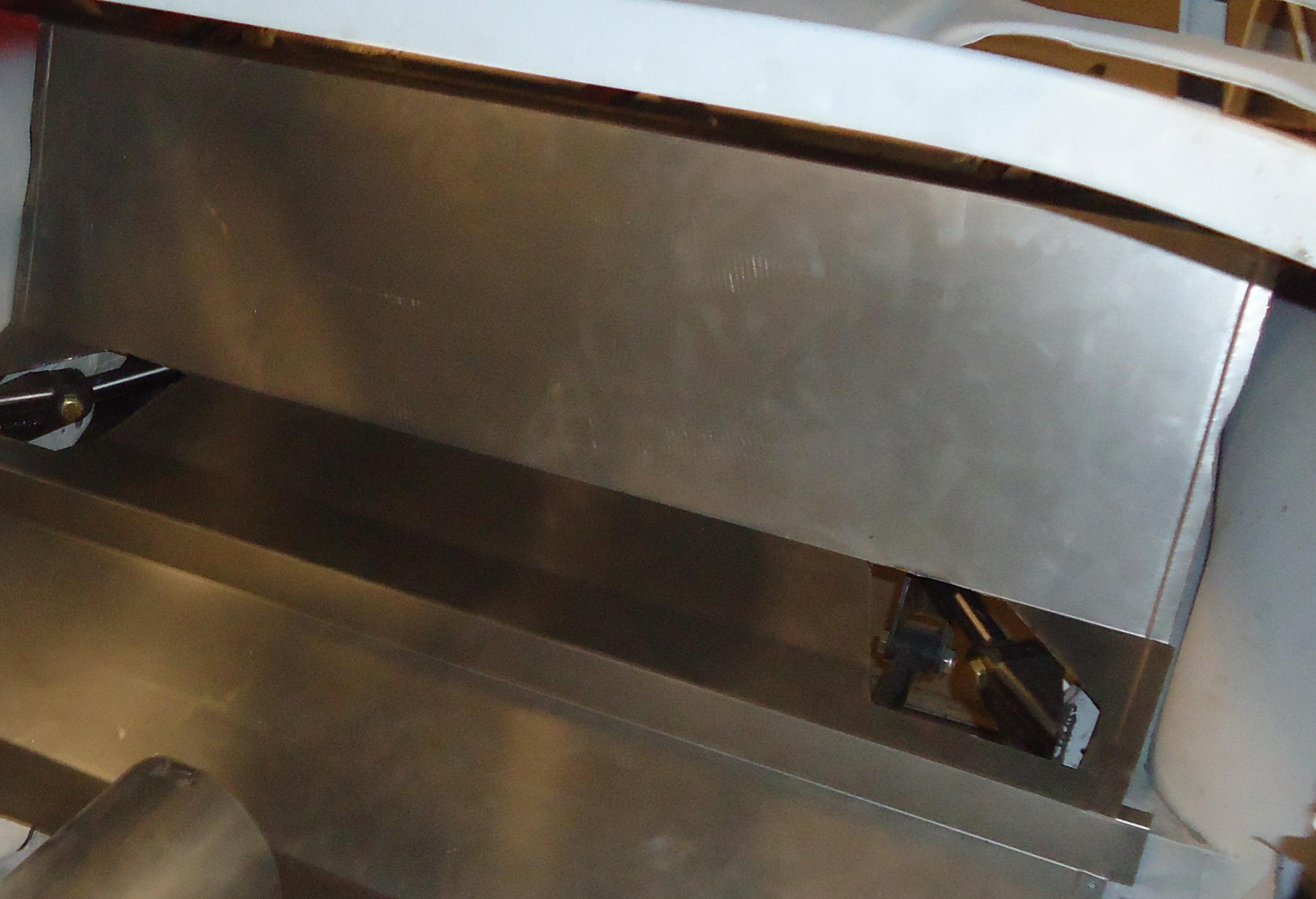

    Next on the list was to close the area below the parcel shelf. In order to create extra room there, I decided to cut out the bracing behind the driver and move it forward. This creates an extra 6 inches of room. Instead of using the bracing again, I'm going to fabricate a new frame. For now I'll leave it open for easy access until the floor is welded in place.
    Then it was time to measure the area and fabricate the first part up to the c notch.

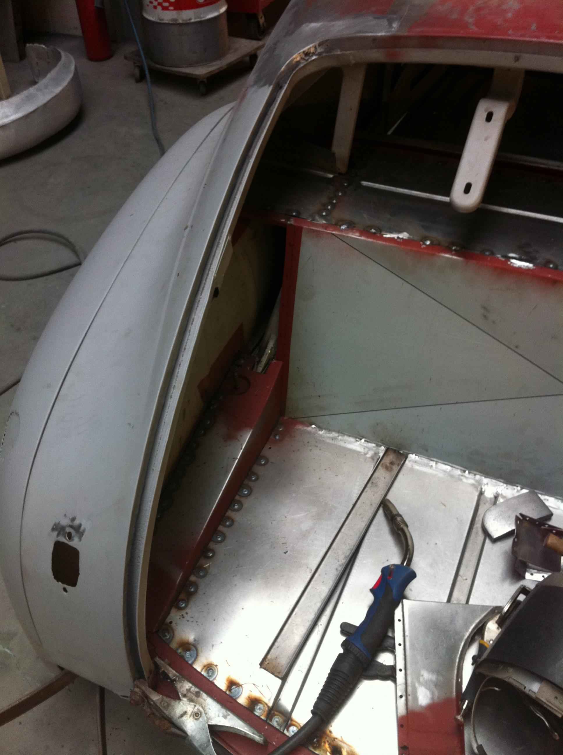

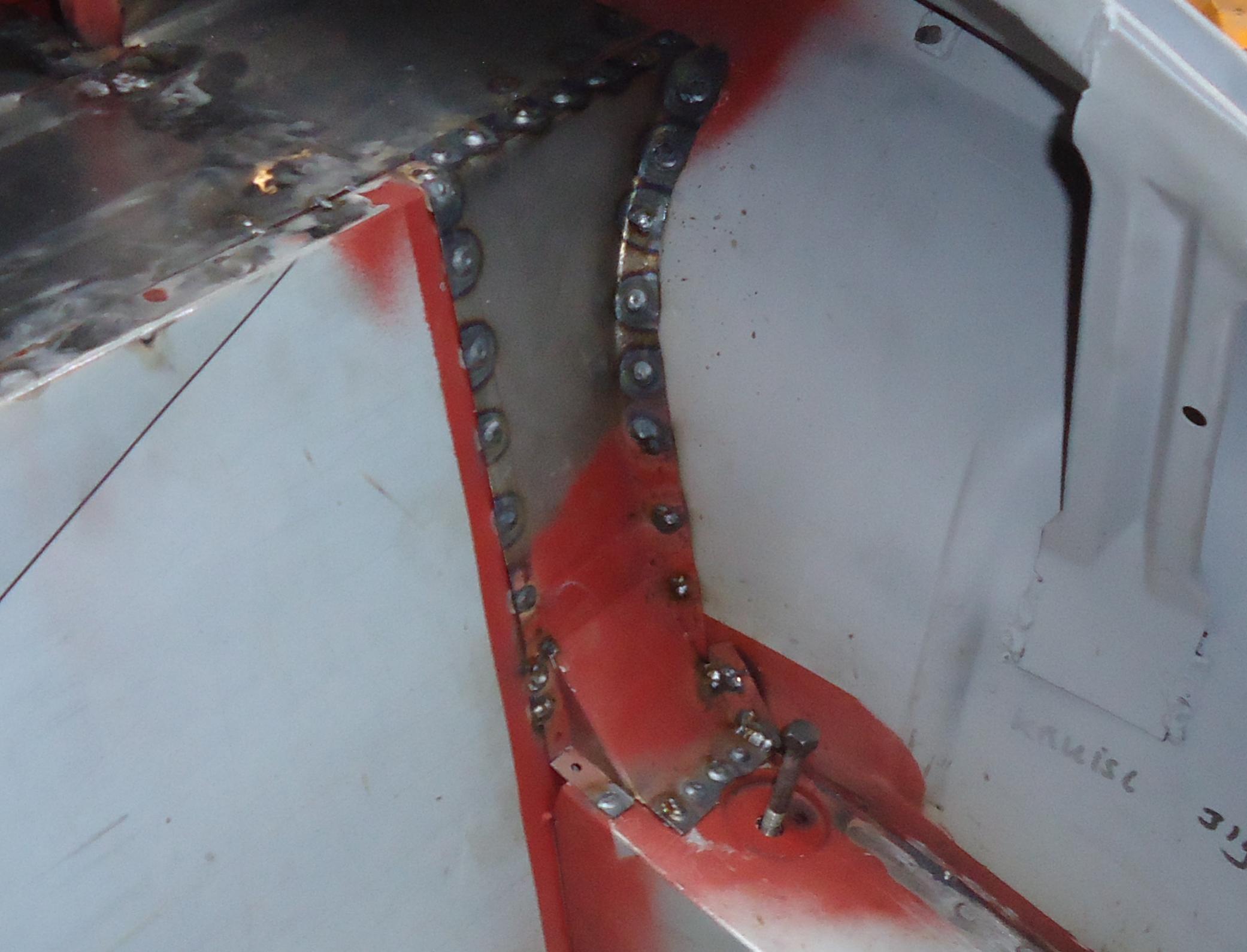

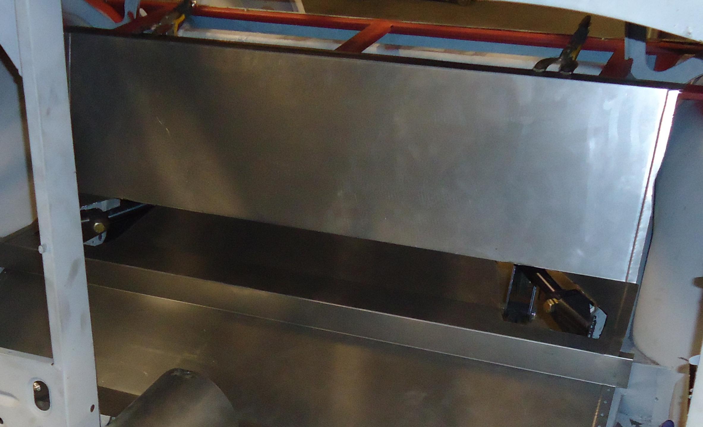

    Test fitted the panel. I made a lip facing downwards so it will slide underneath the existing floor. The remainder of the tunnel I'll make later when everything is welded in place. Before anyone mentions it, the top brackets of the 4 link will be properly braced and welded, once the body is off the ch***is.
    Tomorrow I'll work my way up on the c notch. Things are moving at a fast pace now. And enjoying it!

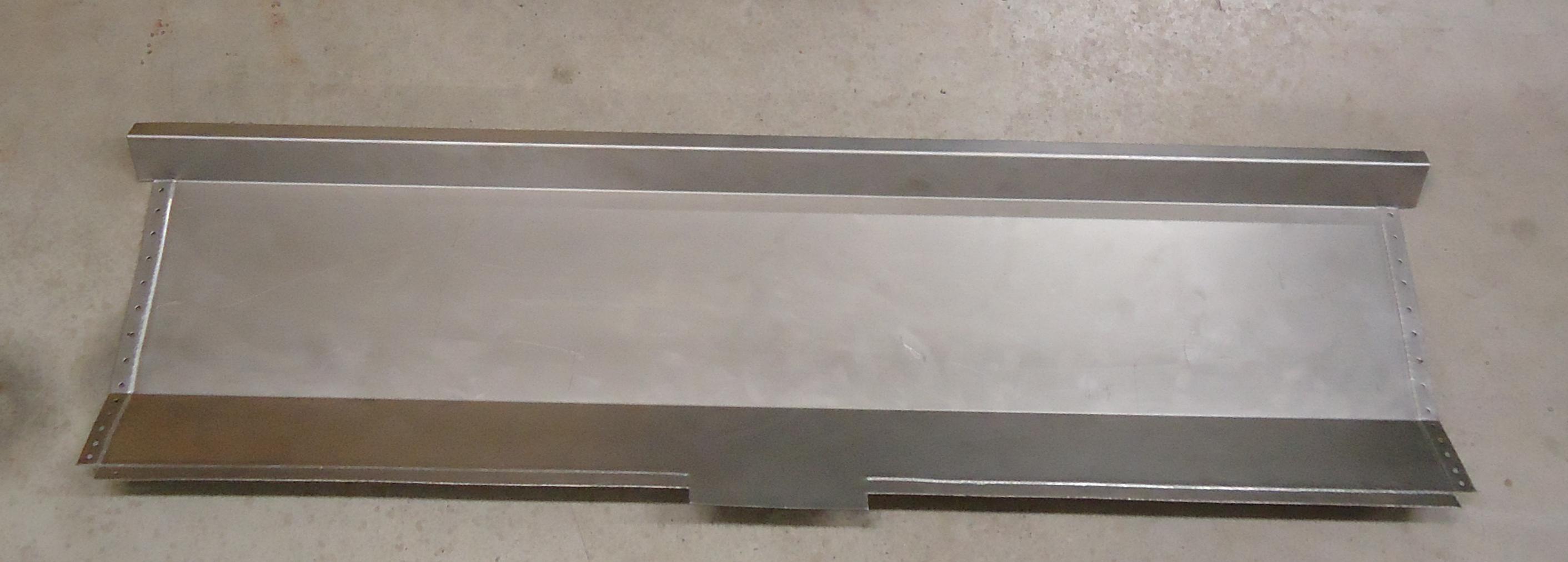

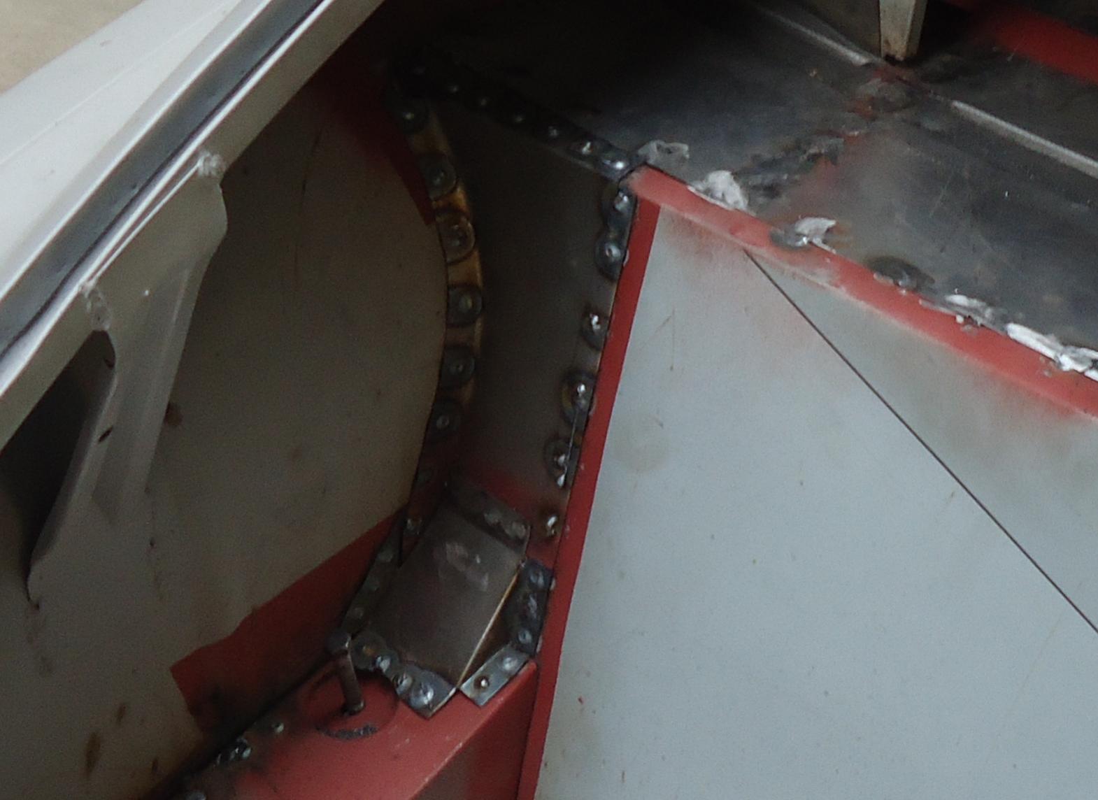

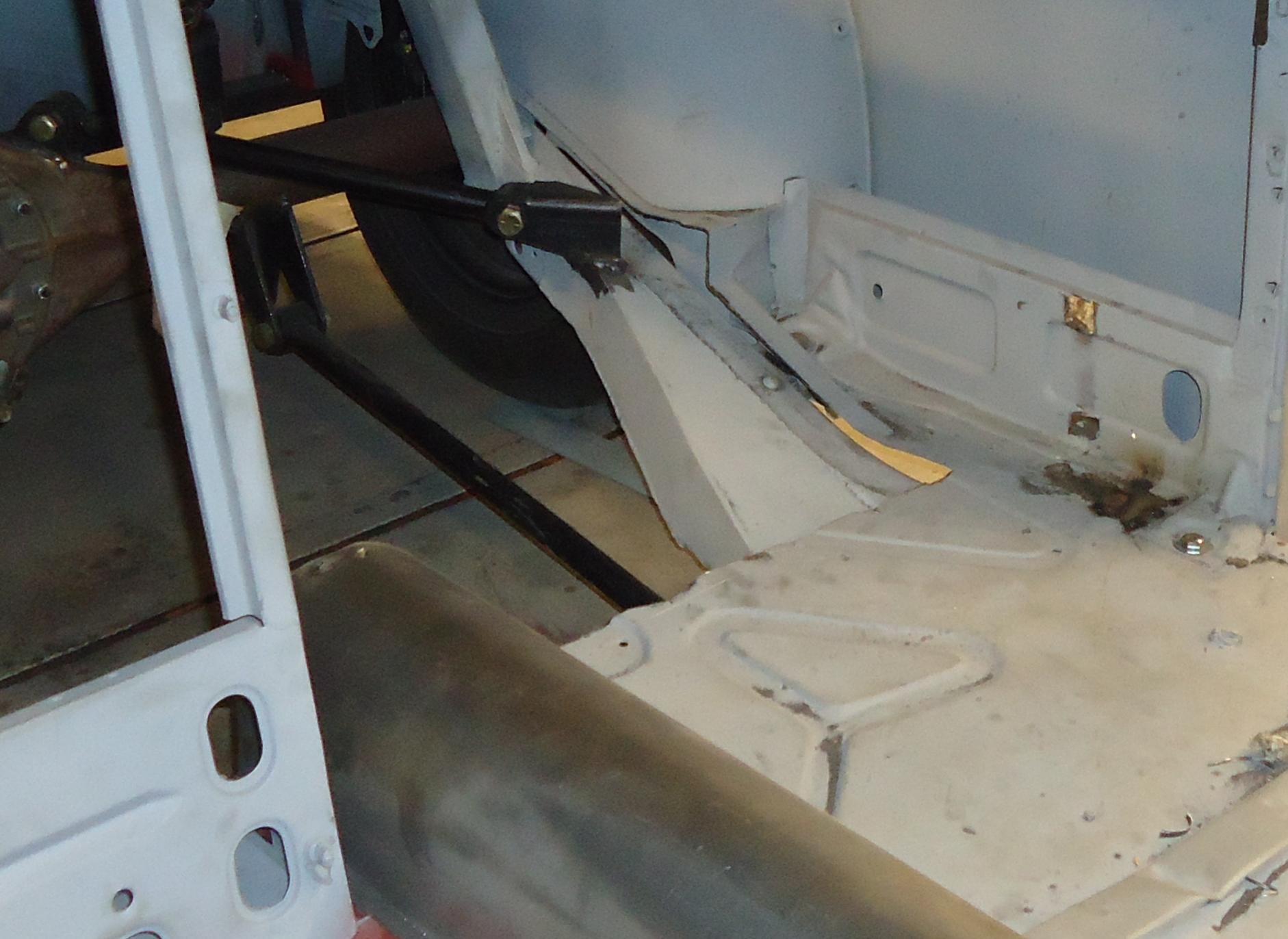

    Anyway, back to the order of the day. Started off the day by jacking up the car and having a good look/measure how I'm going to make the next panel. Major concern was the upper bars of the 4 link and how to incorporate them in the panel. Initial plan was to fabricate two panels, but decided against that. So I climbed in the car and worked out a plan of attack. Last pic is of the part I made. Only need to get it to fit properly now.....:rolleyes:

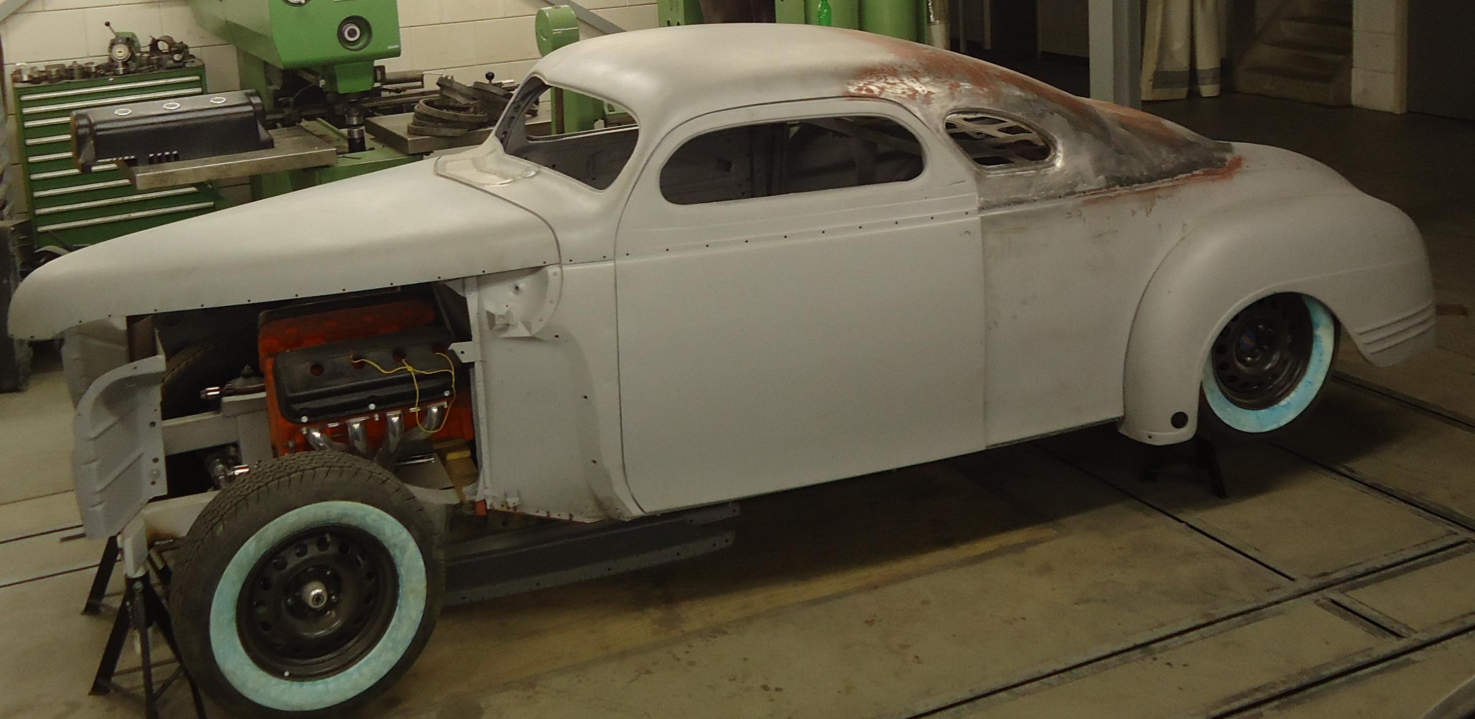

    Thanks drjones96. The car looks a bit funny with front wheels hanging down and no side steps, but I see you get the general idea.

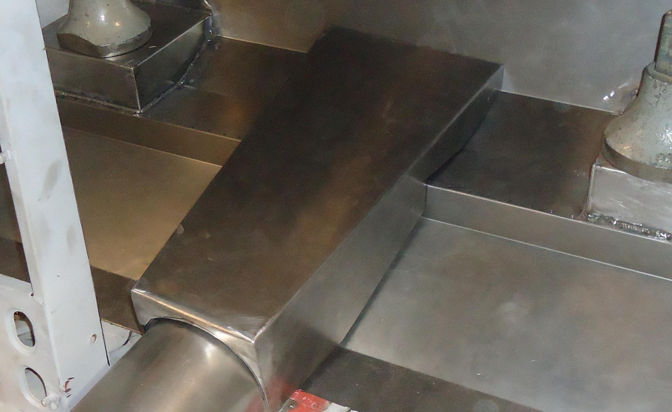

    After indenting all the edges and a lot (I mean a lot) of test fitting and grinding, I finally got the panel to work. I've cut out two sections for the upper 4 link bars, so I can always unbolt it without having to take the body off. Next week I'll fabricate some metal to cover the holes. Then I'll have to make the remainder of the tunnel. Hope to have this all done by the end of next week.
    After 3 days of more than 30 hours of work, it's time to take tomorrow off. Back to my regular job for 4 days on sunday. Glad I'm almost done with the inside sheet metal. It was a lot of work but worth it in the end!:D

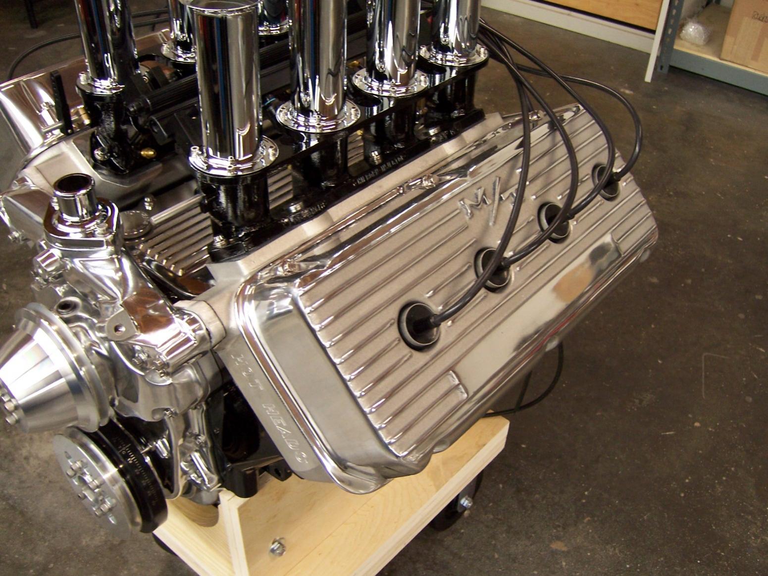

    Thanks gunwanted for the comments. The only other video I have of the Hemi is a 20 minute camshaft break in session. Not sure if anyone wants to look at an engine at 2000 rpm for 20 minutes.............:rolleyes: But I hope to have the engine in the ch***is this spring, and as soon as it's fired up, I'll post the link. I can't wait either! Here are at least a few more pics of the engine.

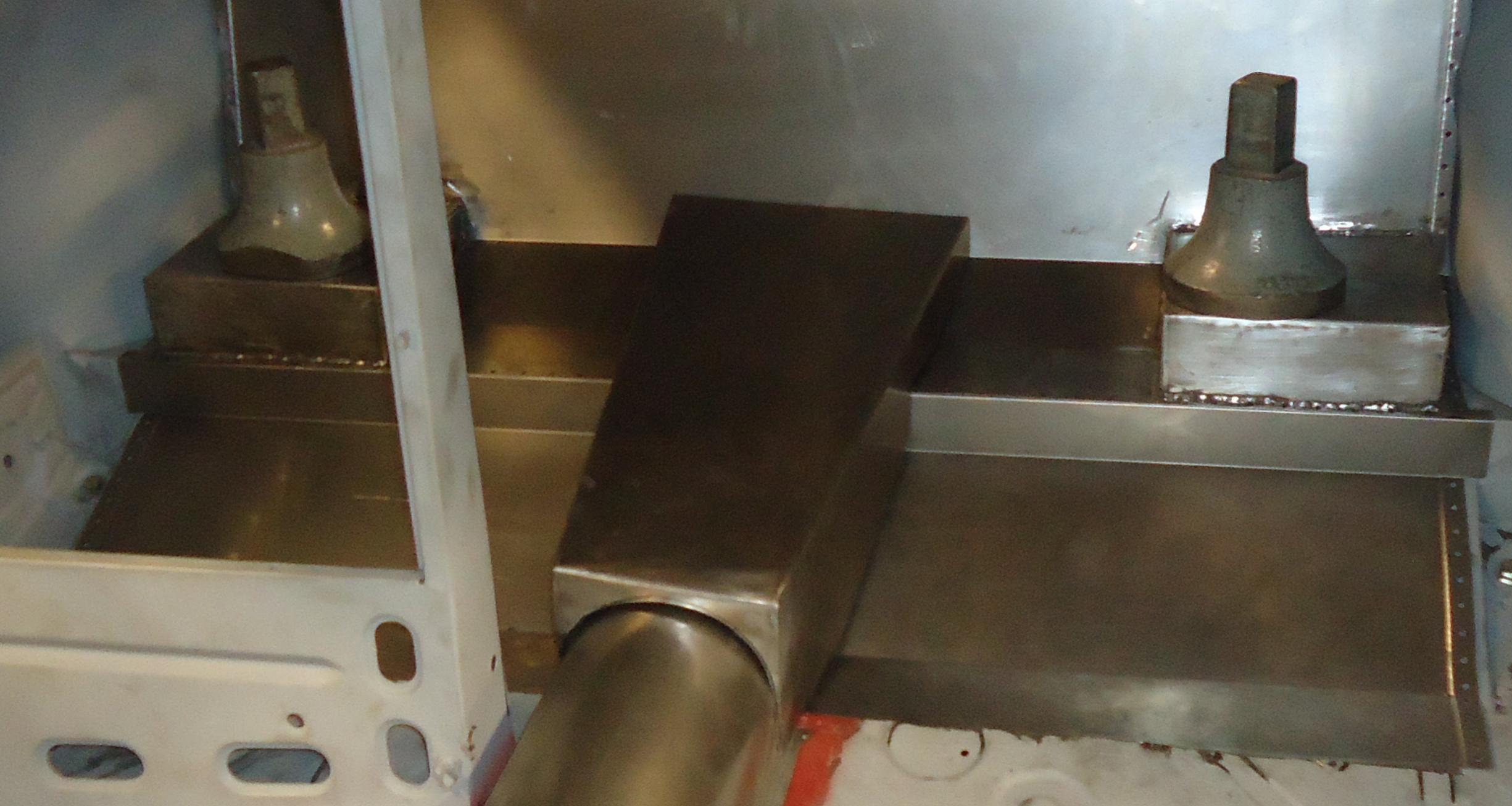

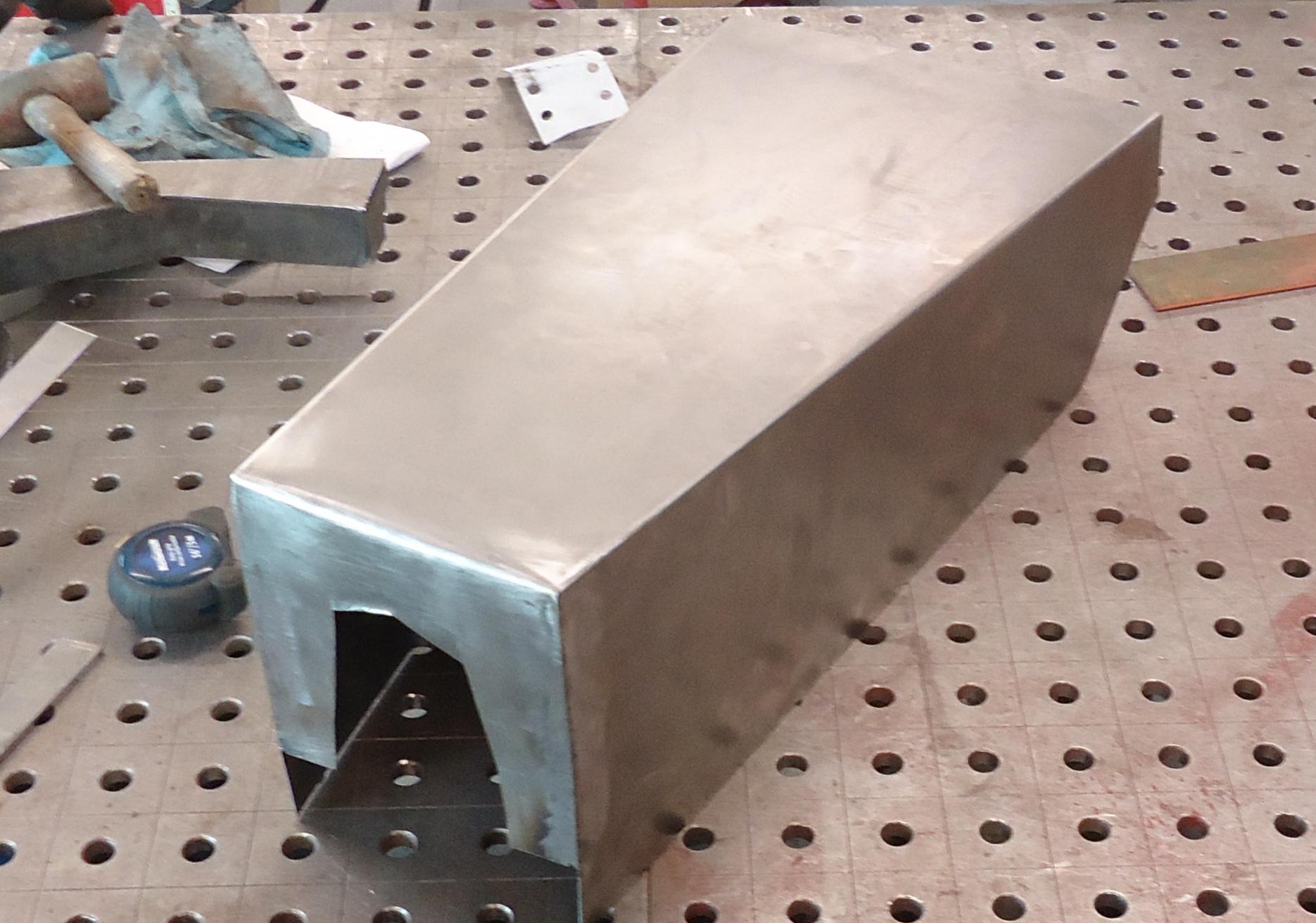

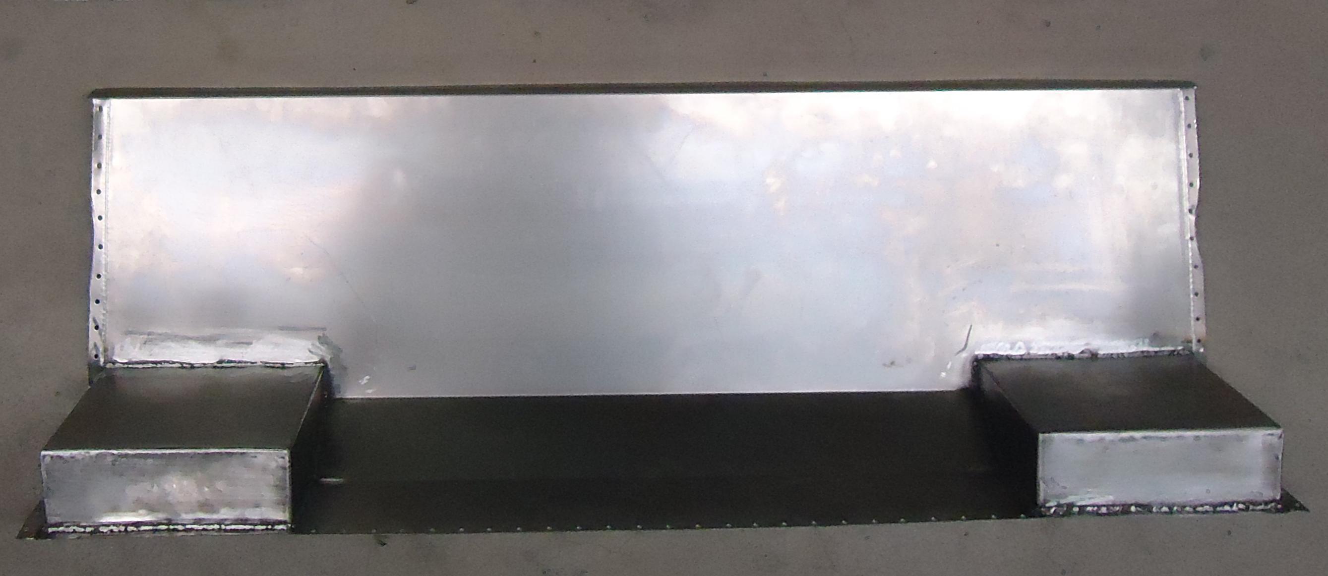

    This morning I started fabricating two "boxes" to cover the top hinges and arms of the four link. Initially I'd cut a fancy shape to follow the bar, but I'm going for a square box. This will also give me an easier mounting area for the fuel tank and brackets that come along with it. First pic is of the original cuts. Then welded the boxes in place, ground the welds and then cut the excess overhang sheet metal inside the each box. Came out looking good.

    Here's a pic of it all in place in the car. Tomorrow I'm going to finish the remainder of the tunnel. Then it's time to weld up all of the trunk and interior sheet metal, before fabricating a few small pieces.

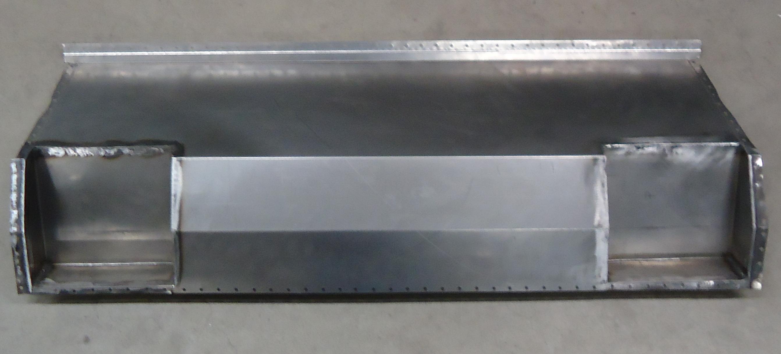

    Today I fabricated the last piece of the tunnel. Decided to make a flat surface, so it will be easier later on to mount the brackets for the airride and fuel cell. After the initial fabrication, I made a profile out of some s**** metal, in order to get the correct angles and lengths. The tunnel is in, but not welded in place yet. I first need to weld the floors before I can do the final adjustment/welding of the tunnel. Came out looking great, even if I say so myself.;)

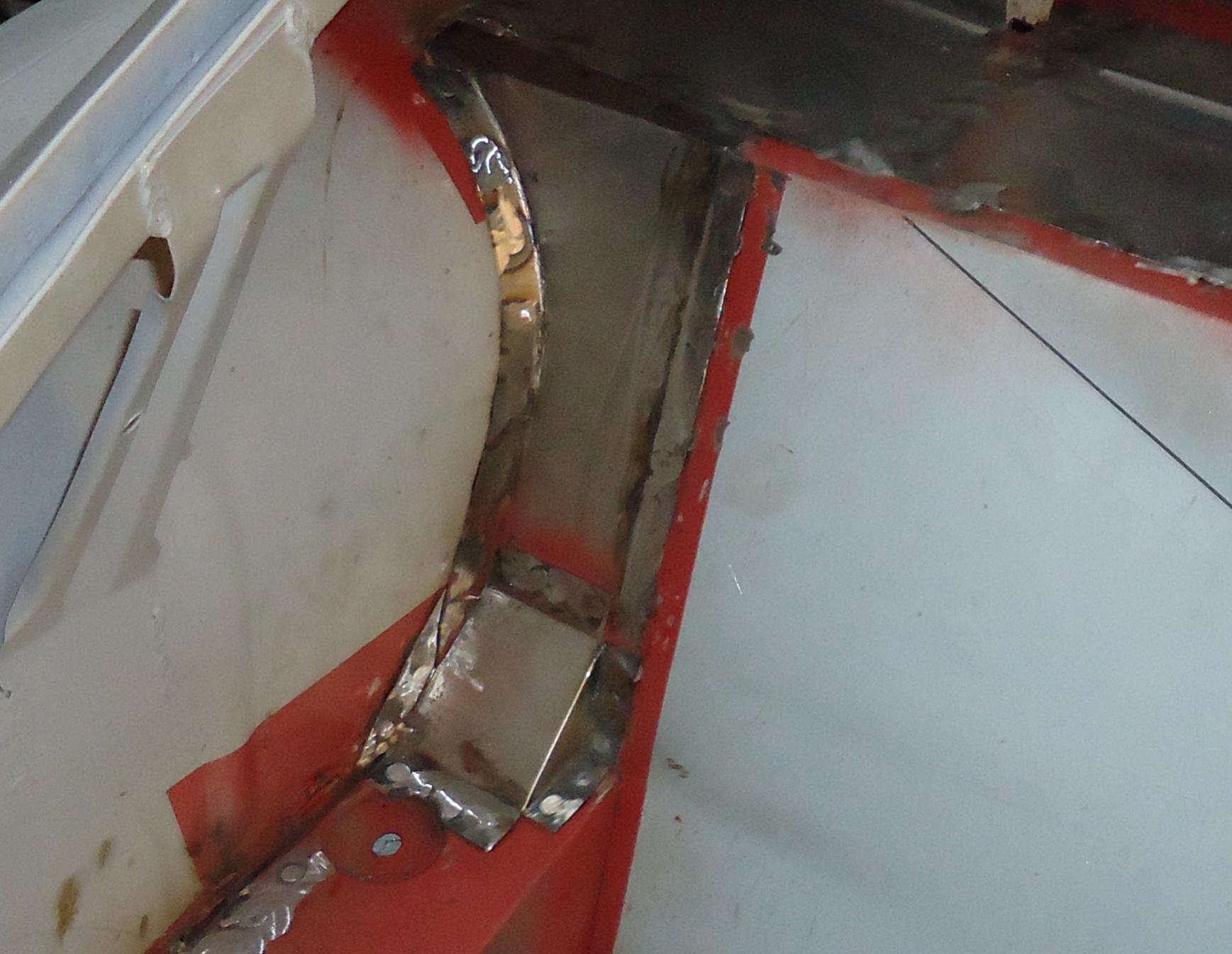

    Started today and flattened out the old floor pan where it meets the new sheet metal. Punched a lot of holes and started welding. Then moved to the adjacent sheet and welded that too. Ground it all down and moved to the trunk. Got started on the upper part and spot welded it into place. I'll be working on the car again on friday and hope to get most of the welding done. Things are moving forward!

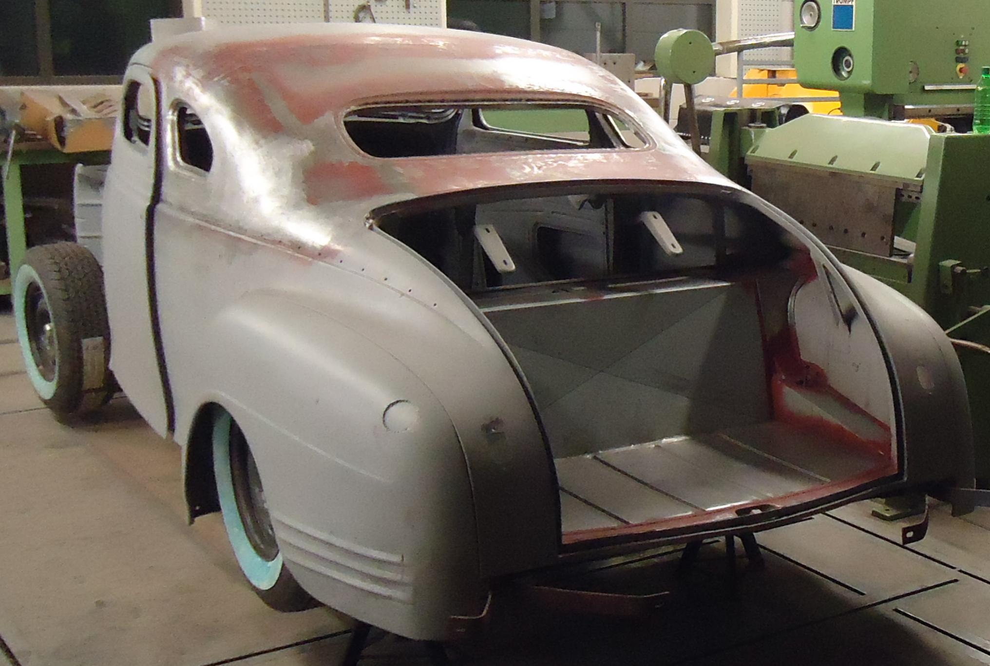

    Here are a few pics of the car in its present state.

    Lots of spot welding today. Finally got the hang of it! Then started grinding the welds. Will finish all the interior welding on monday.

    Spot welded the side pieces of the trunk. Then grounded down the welds. The trunk is finished!:)
