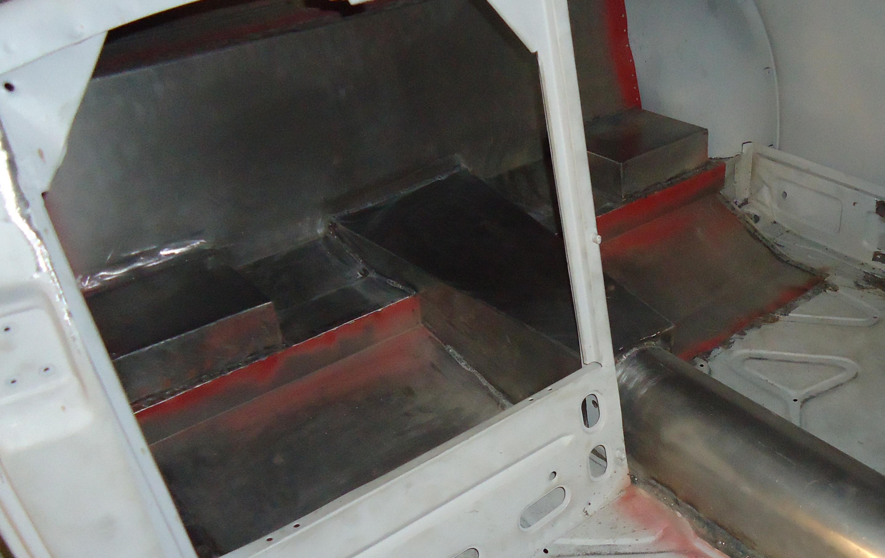

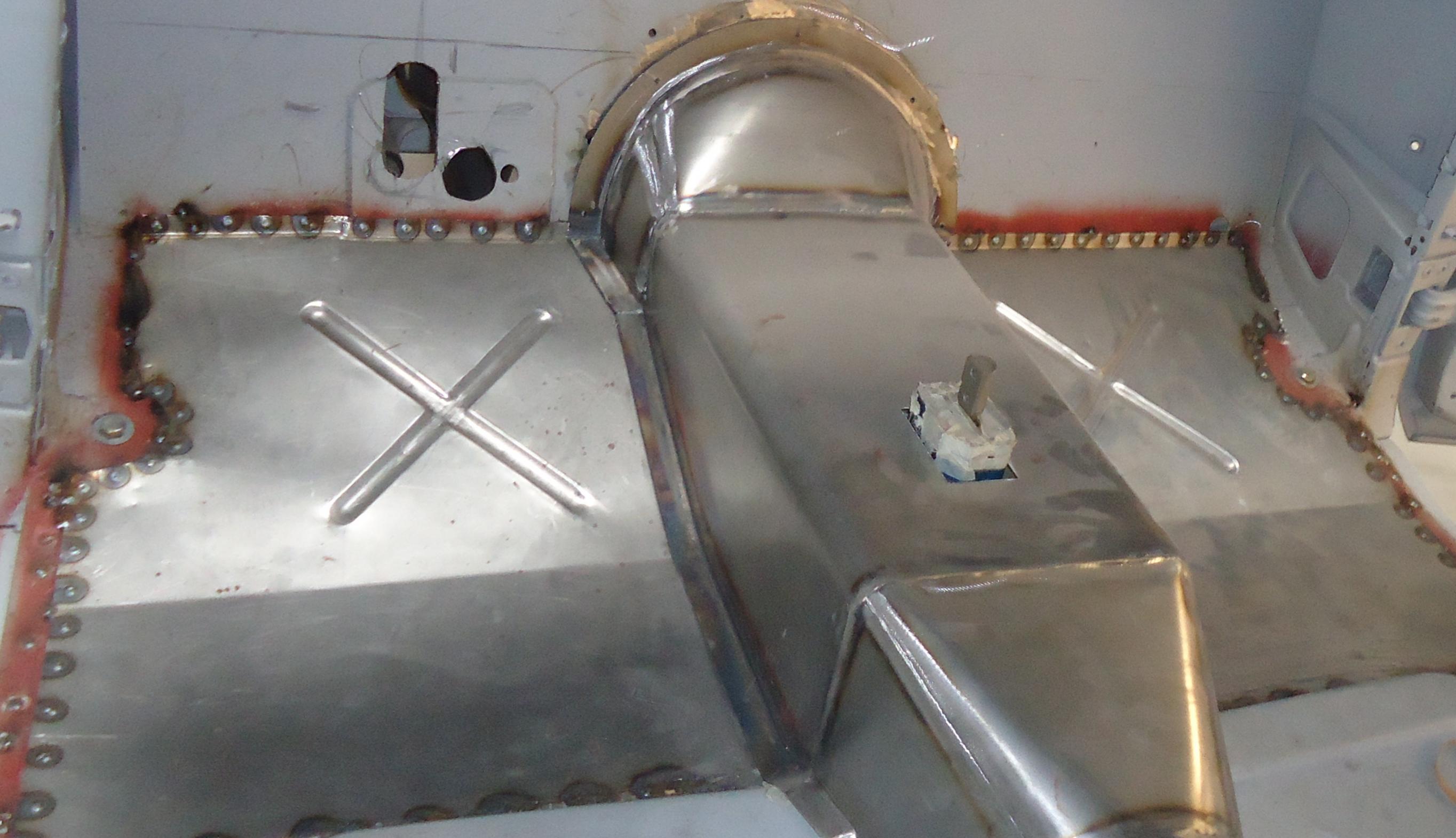

    Back to work on the car this morning. Spot welded the footwells and lower cowl. Next I'll grind the welds. Considering I have the whole week off, my intention is to finish the interior metal work by the end of the week.
  14. farmer12
    Joined: Aug 28, 2006
    Posts: 7,723
    farmer12
    Here's a couple of pics after grinding the welds. Exciting stuff I hear you say....

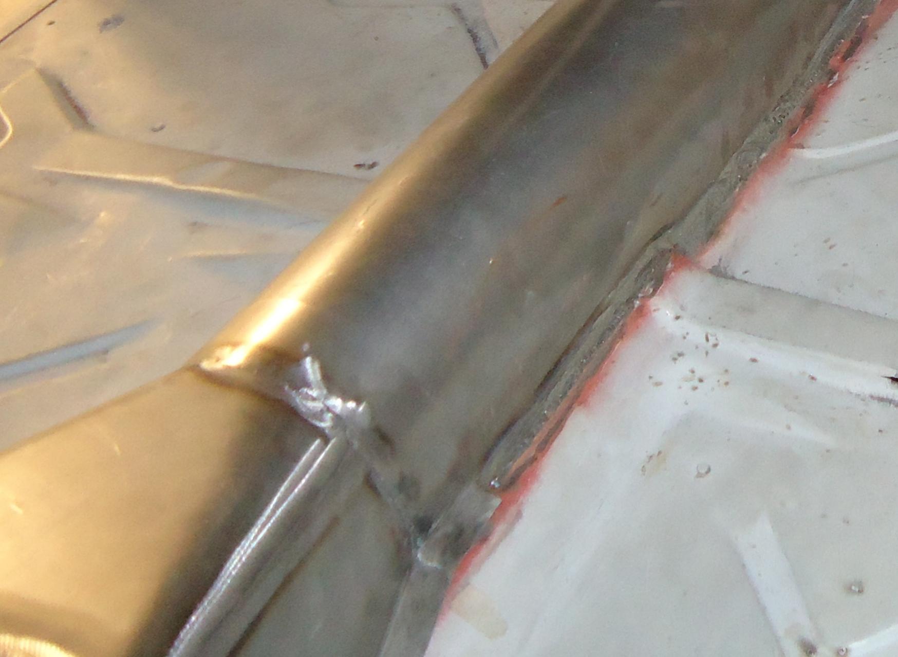

    Today was welding day. I made some final adjustments to the tunnel, hammering it into place so it would follow the original floor better. Then welded it into place and did some of the usual grinding. Next on the list was the rear of the tunnel. It took me literally hours of fitting and grinding to get it to sit right. Spot welded it first initially, then welded the whole thing.
    Once the body is off, I'll cut the floor from below, exposing the inside of the tunnel. All in all, got a lot done in 10 hours or so.....

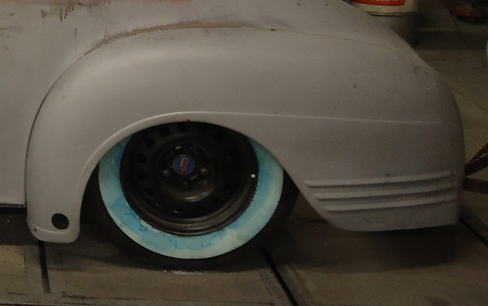

    Here's a pic I shot yesterday. Still playing with the idea to install dropped spindles in the front.....I guess I'll wait until I have the front fenders and grill on there, before ordering.

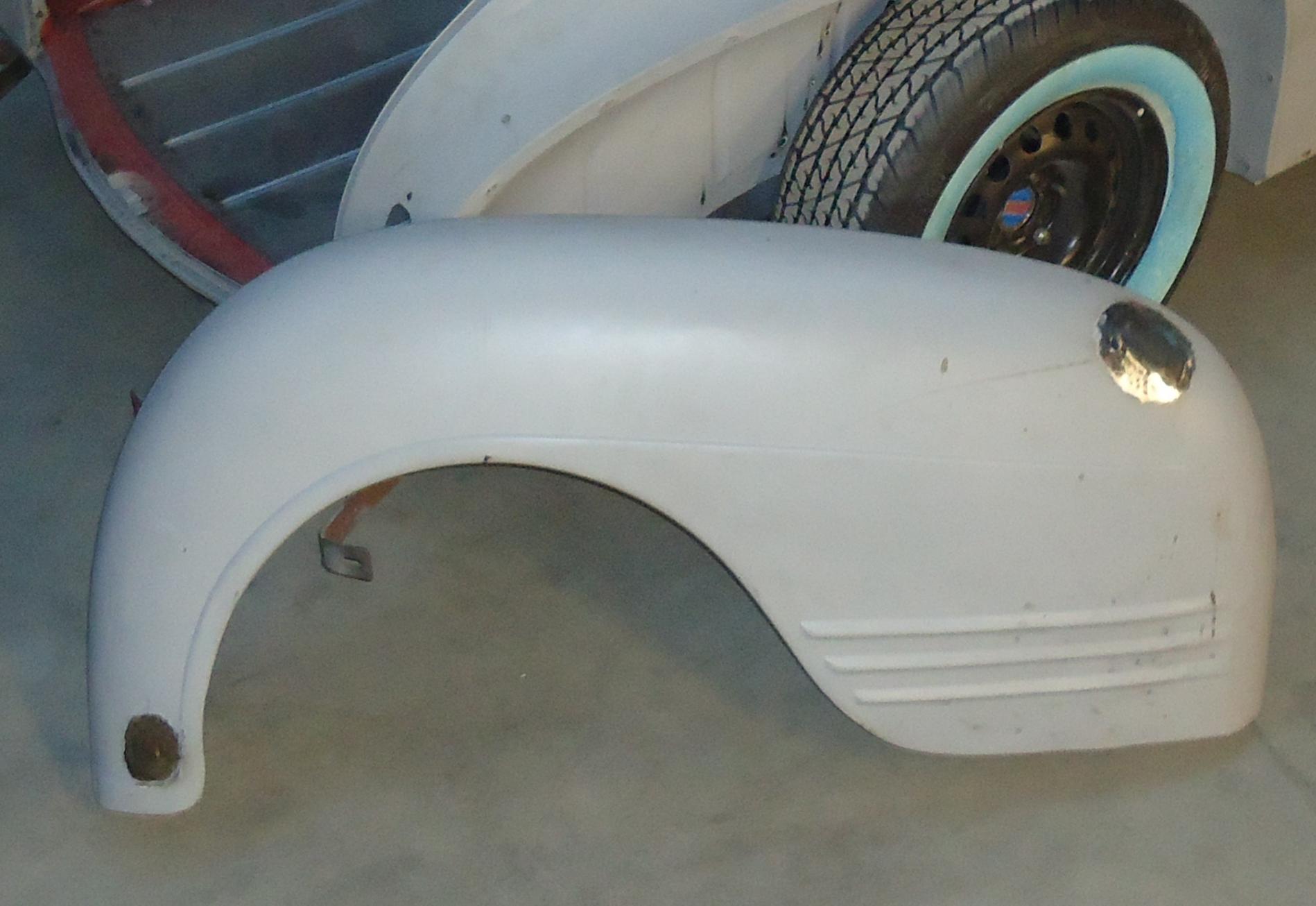

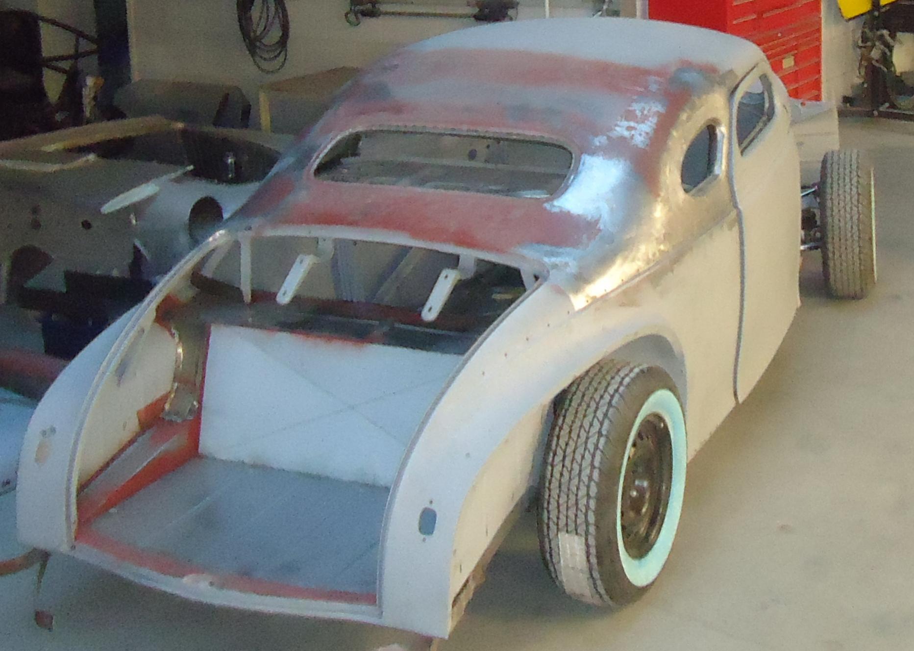

    Cleaned up the cowl/wiper/antenna holes, inside and out. Then proceeded to take the rear fenders off, in order to fill a few holes. The left rear fender, apart from a hole in front of the wheel where the exhaust came through, also had a badly welded patch where the fuel cap used to be. I have cut out some sheet metal and shaped it. Then welded it all up and did the grinding bit. I still need to hammer it into shape a bit more, (due to slight warping from welding) and will do the other fender tomorrow.
