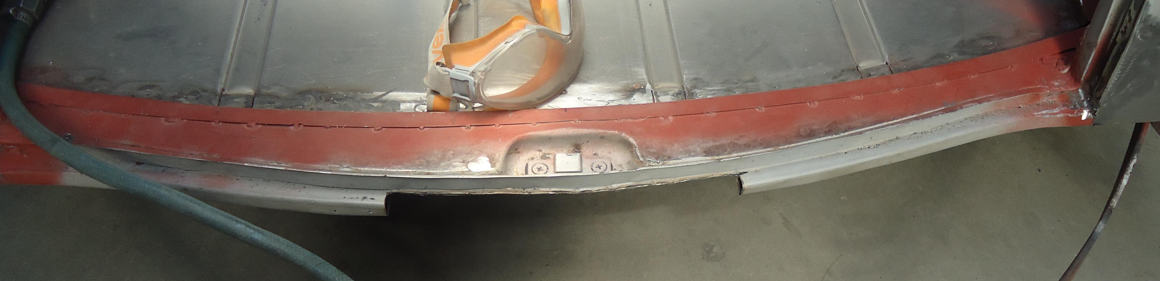

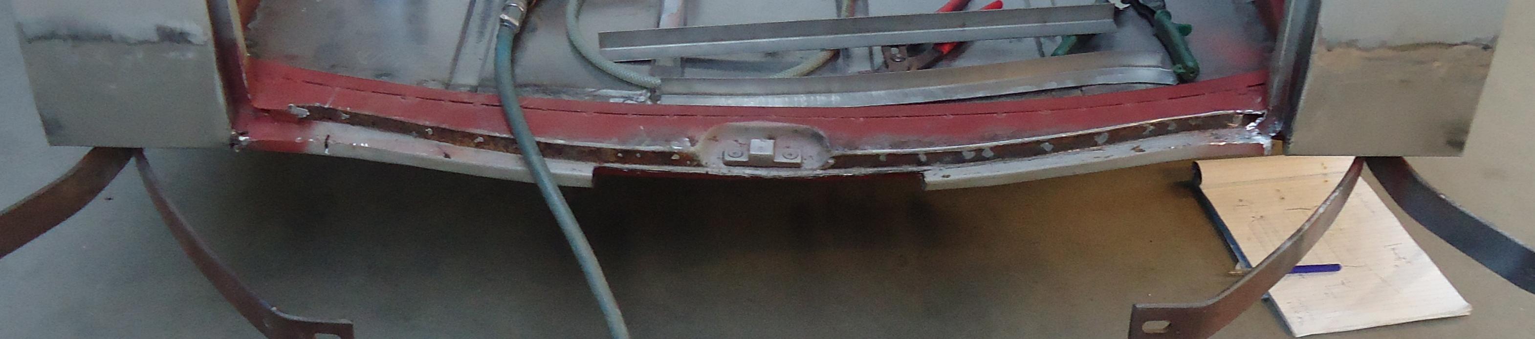

    The plan for today was to just replace a small piece below the deck lid.........well, that was the plan. After cutting it out, I found a thin vertical piece as well, which later on will hold the rubber stripping in place. Why don't I take that off as well, I thought. Damn.....rust behind it. If there's rust here, there's bound to be more in each corner. Change of plans then. Rip it all out and start fabricating boy!
    Nothing would bug me more than knowingly leave hidden rust on the car. Will finish it off tomorrow.

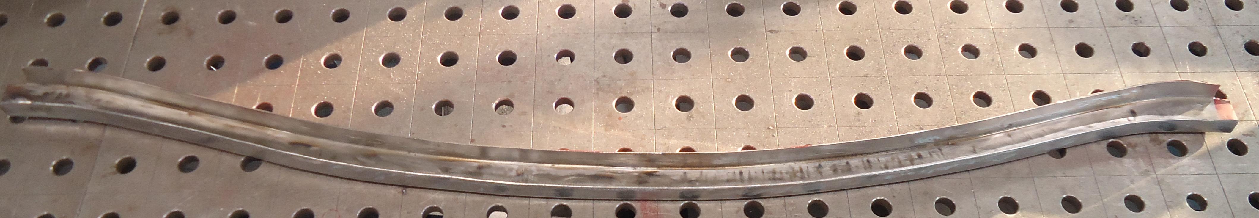

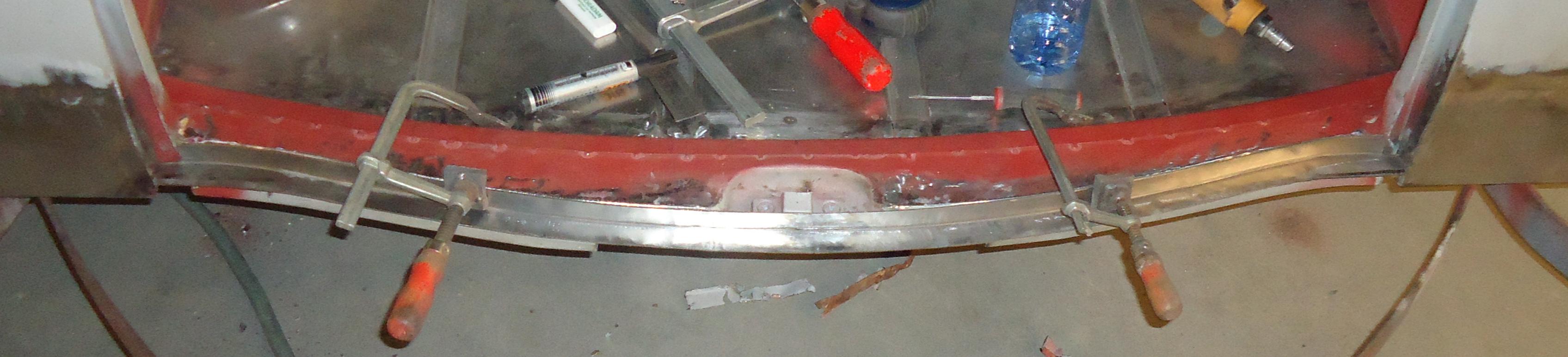

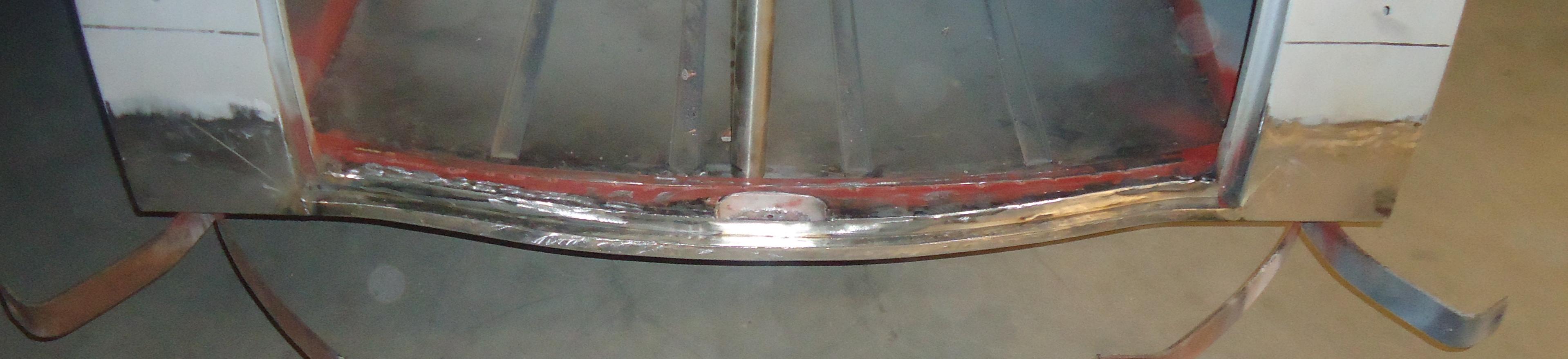

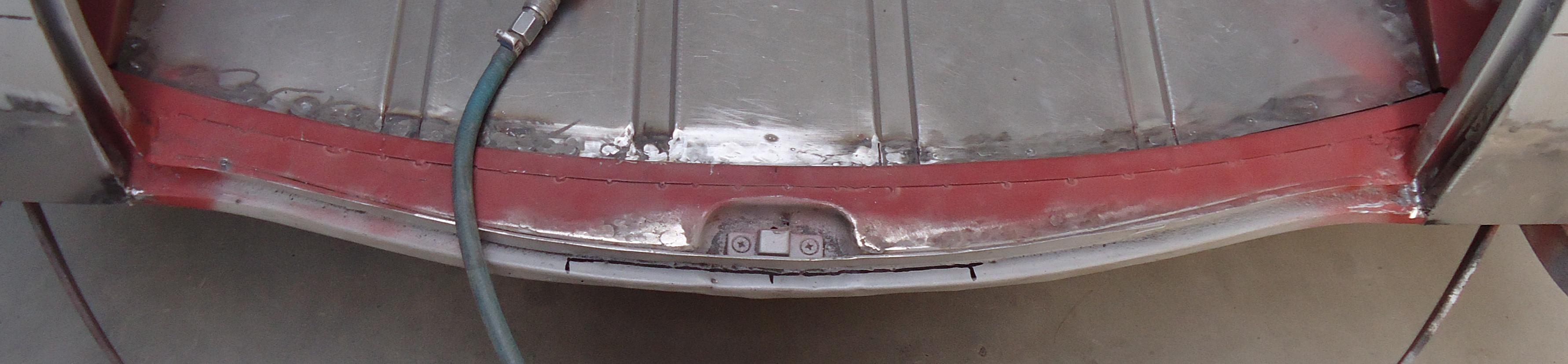

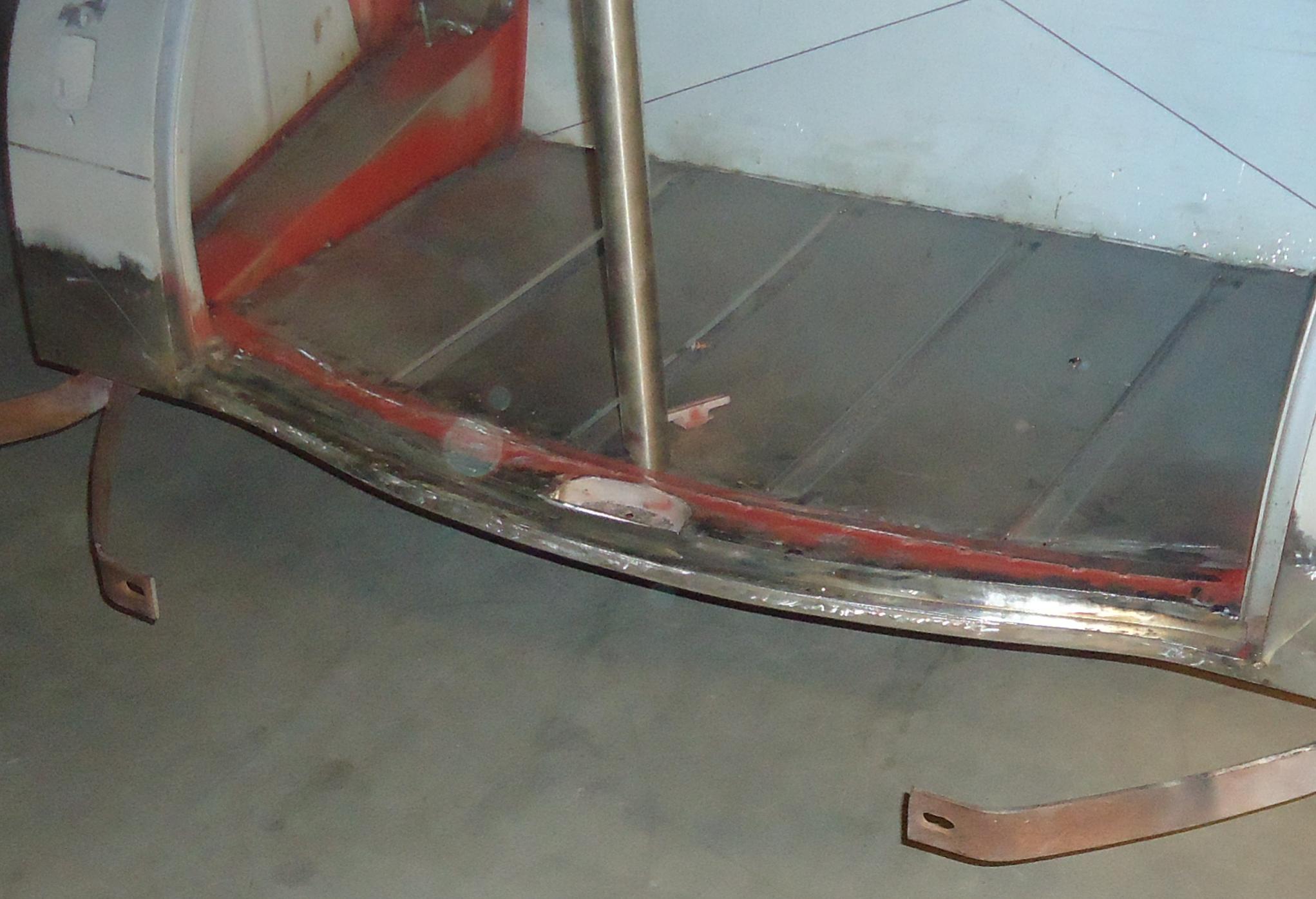

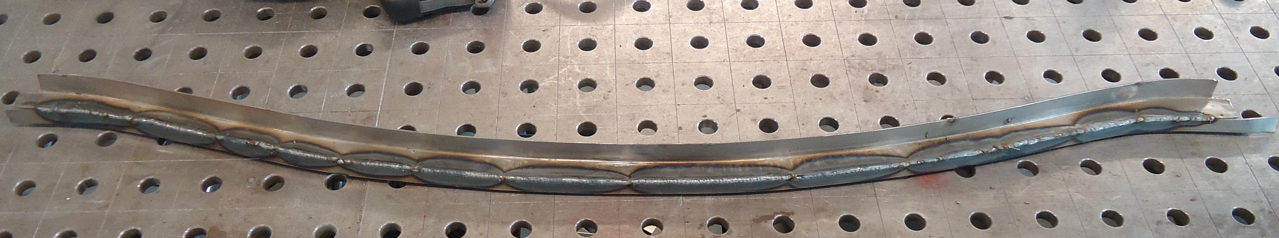

    As promised, I finished of the lower piece below the trunk lid. I started of fabricating a second piece to form the u shaped profile. Then welded it all and ground it down. After quite a few minor adjustments, I got it to fit nicely. Then also welded this up and did the usual grinding.
    I have also mounted the trunk lid to ensure the lines were good. Found out though, due to some previous poor rust repairs on the bottom of the trunk lid, it has changed the bottom line of the trunk. Considering I still have to repair the lid, this won't be an issue, as I'll make it fit the contour of the new lower piece.

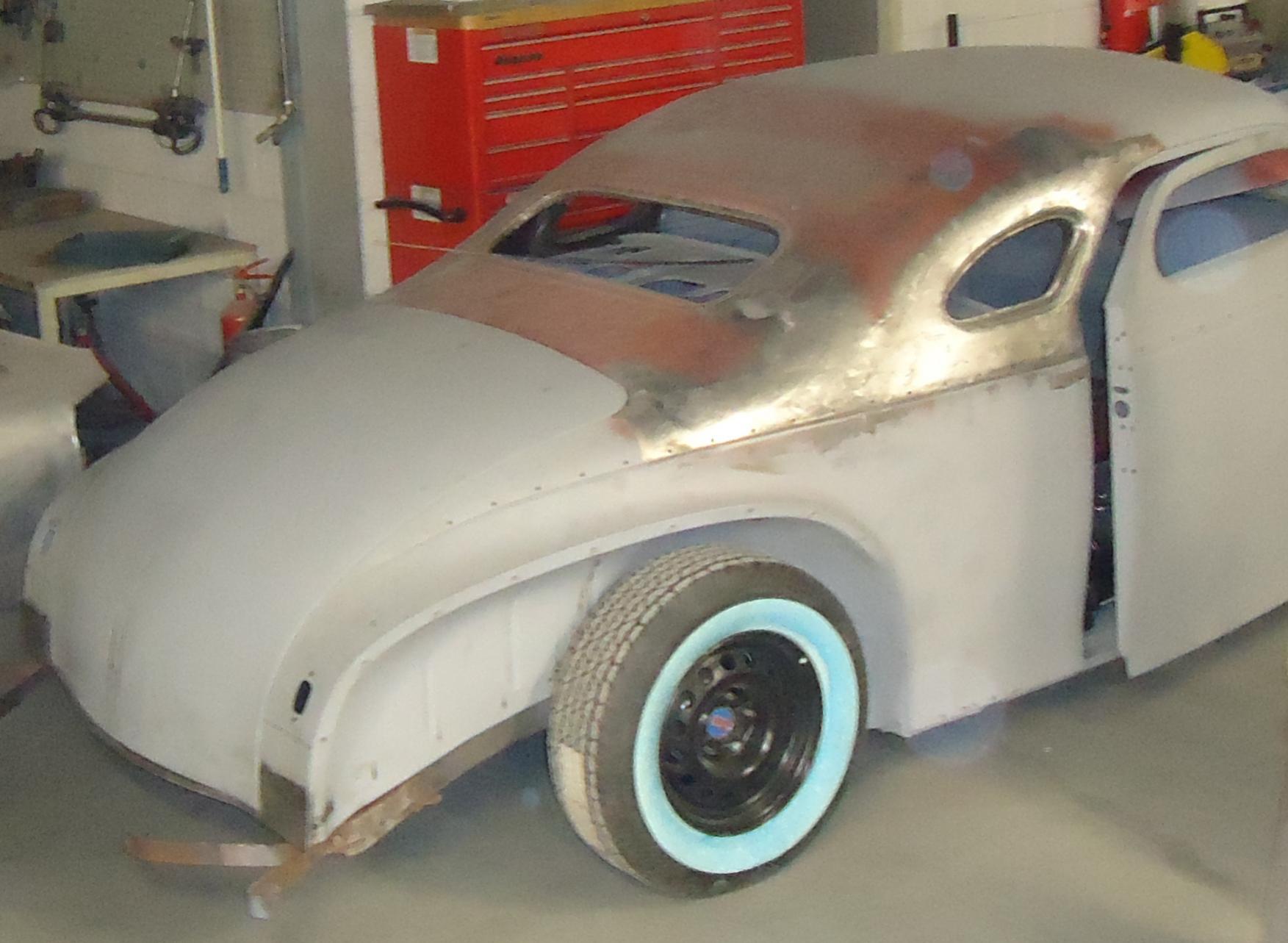

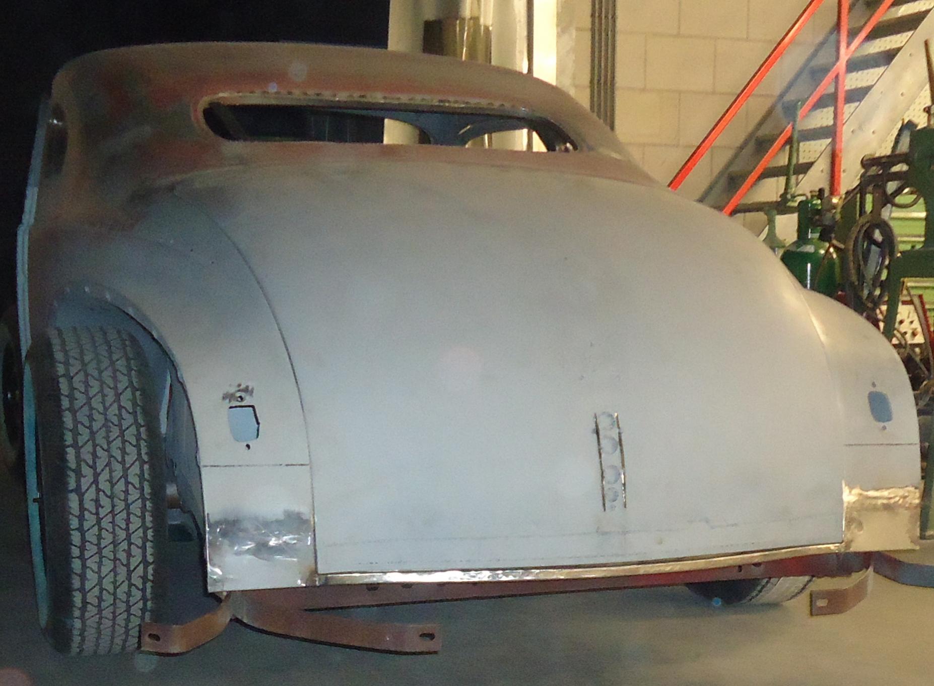

    Here are a couple of pics with the trunk lid on. You can notice that the bottom of the trunk lid doesn't line up perfectly but this will be rectified when I start work restoring/modifying it.

    Nice job ! But you gotta throw that p*** rear fender on and take the same pics again, I love the flow of the *** end of your car !

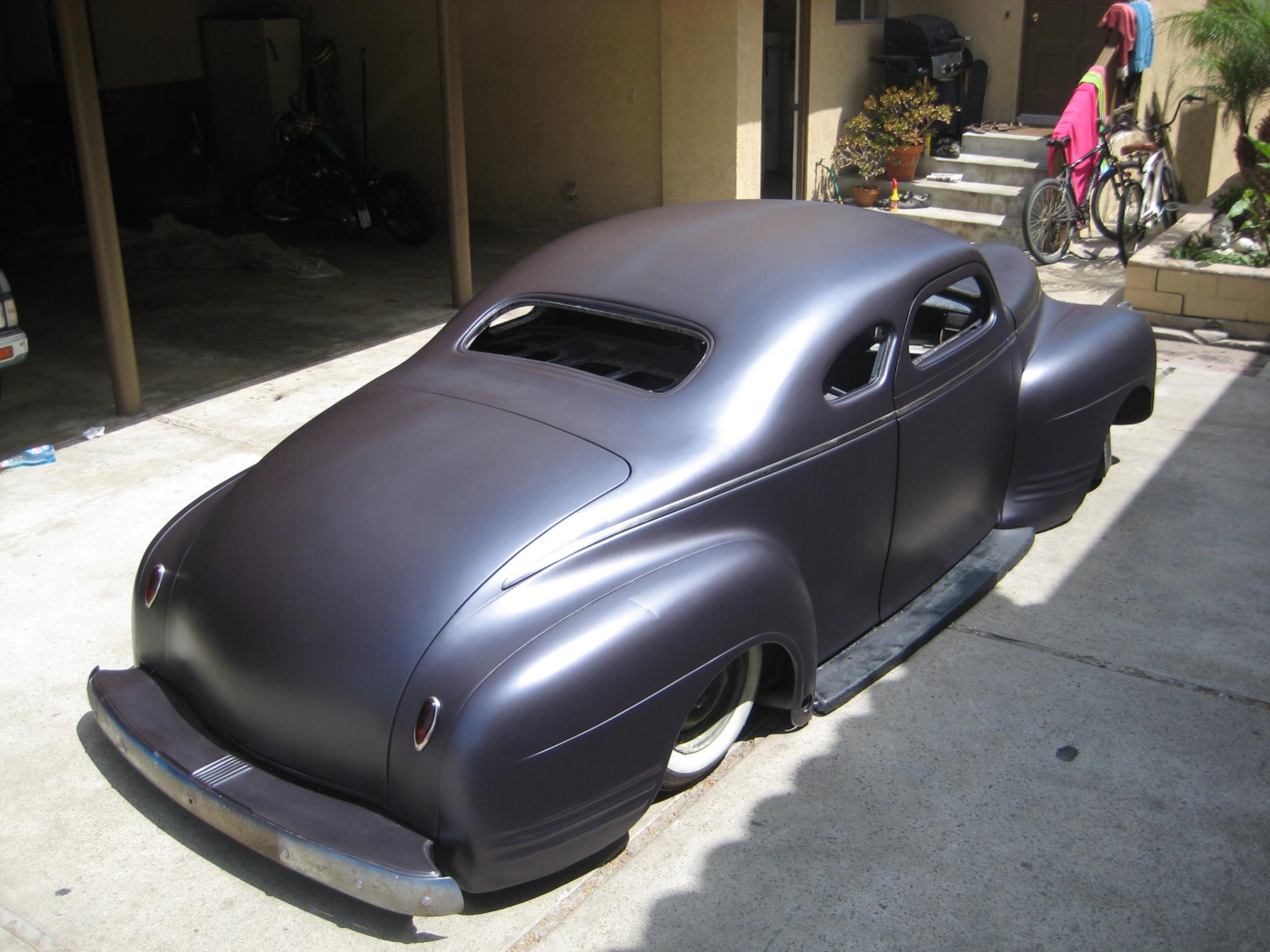

    I think tucking in the bumper is a good idea, gives it a more streamlined look. Here's what it could look like.
    [​IMG][​IMG]
  25. farmer12
    Joined: Aug 28, 2006
    Posts: 7,723
    farmer12
    Thanks OahuEli, that's getting close to the look I like. There are 4 minor adjustment I'd make.
    1; widen the splash pan to where the rounding of each outer panel starts.
    2; cut each side of the bumper, so the vertical line of each panel is followed when looking at it side on.
    3; get rid of the bumper bolts.
    4; smooth the splash pan in the middle.
    And last of course re chrome the bumper.
    Thanks for your input Eli, it's much appreciated.
