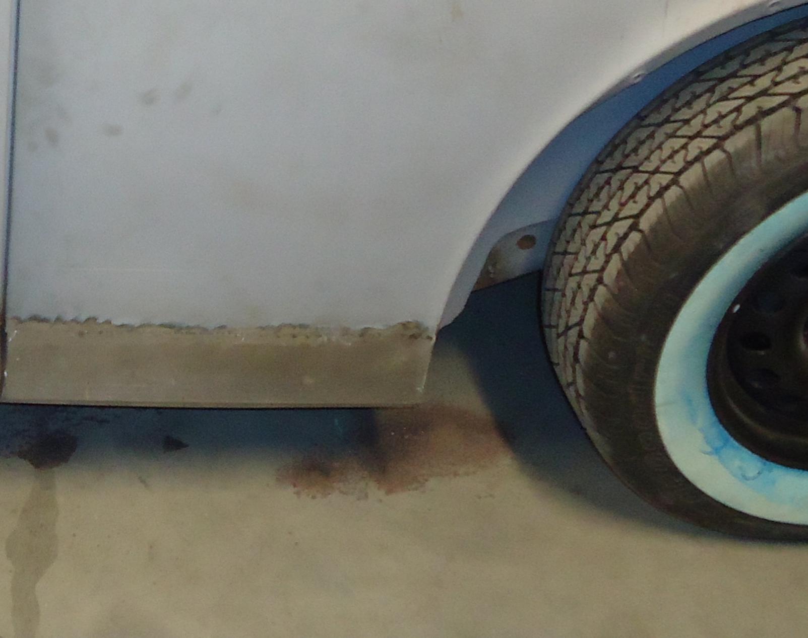

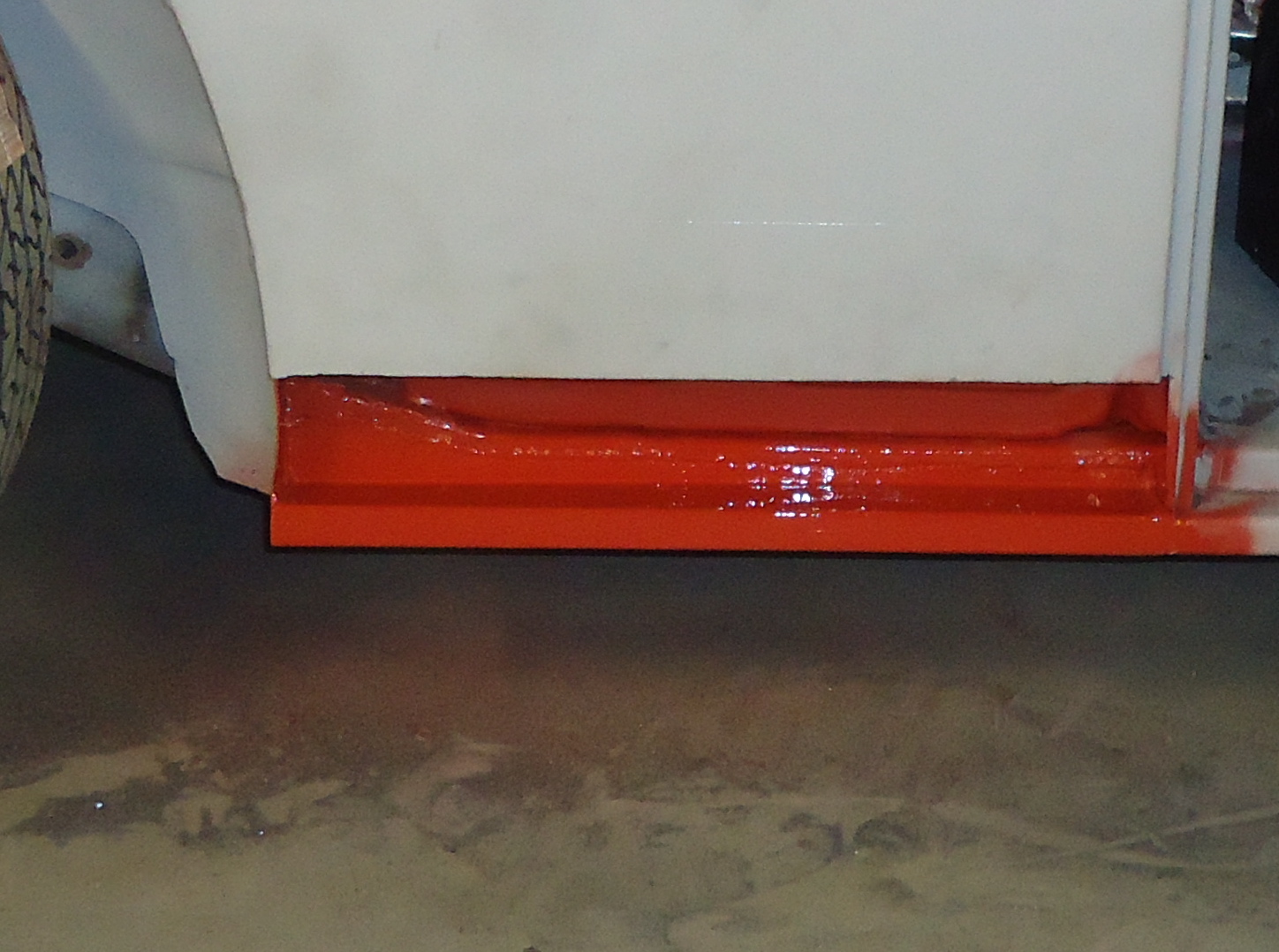

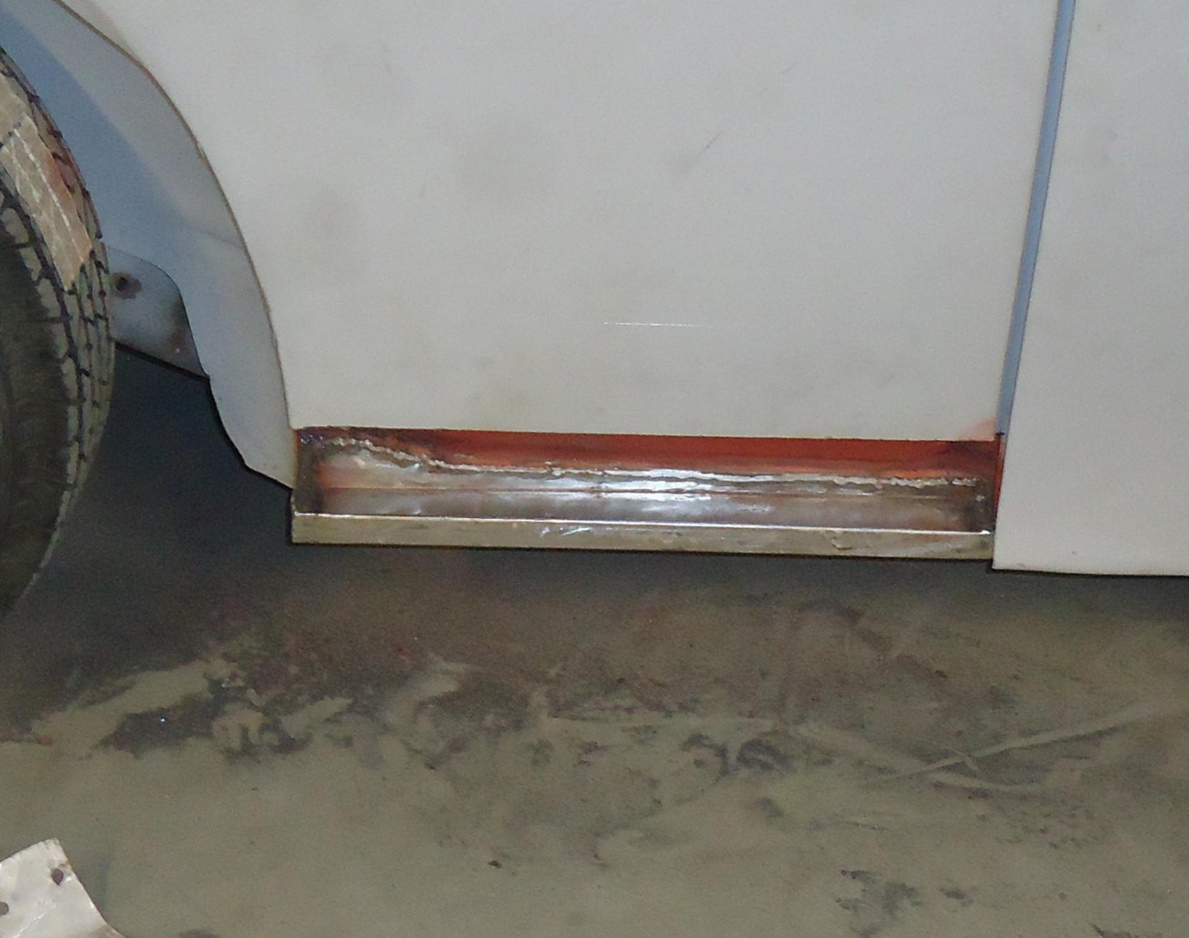

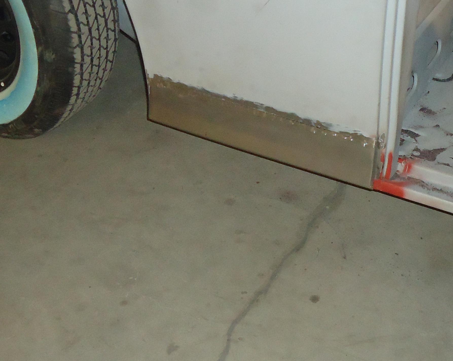

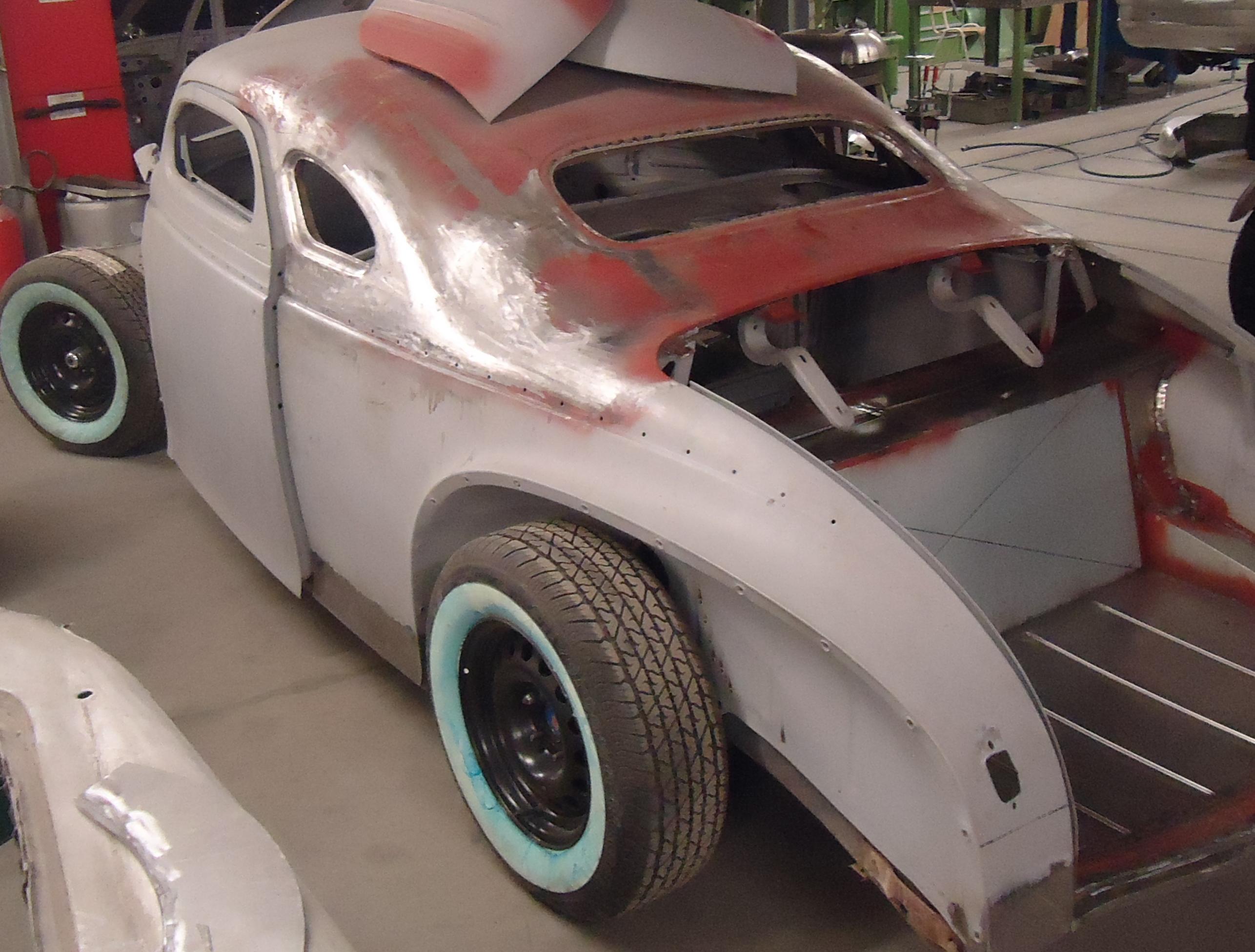

    Just spent the last 9 hours working hard on the p***enger side lower area. After measuring where I was going to cut, I got the old grinder out and attacked the metal. From behind the outer skin came more rust, so the job became a little more complicated than initially anticipated. May as well do it right while your at it. Fabricated a piece made to size and welded it in.
    All in all a lot of work for something you'll never see again.......at least I know it was done properly!:)

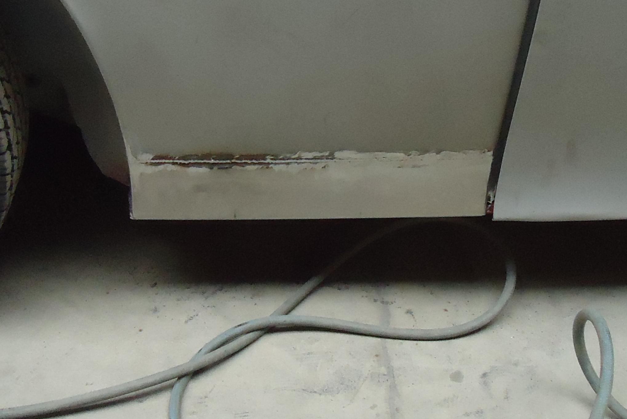

    Started on the drivers side this morning, and things started positive as I had problems taking the outer skin off. This means little rust, I thought. After sand blasting the area I was only able to find one small pin hole. Cleaned that up, welded it and ground it smooth. Then applied some primer. Yes! This has saved me about 5 hours of fabrication!
    Tomorrow I'm going to make the outer skin.

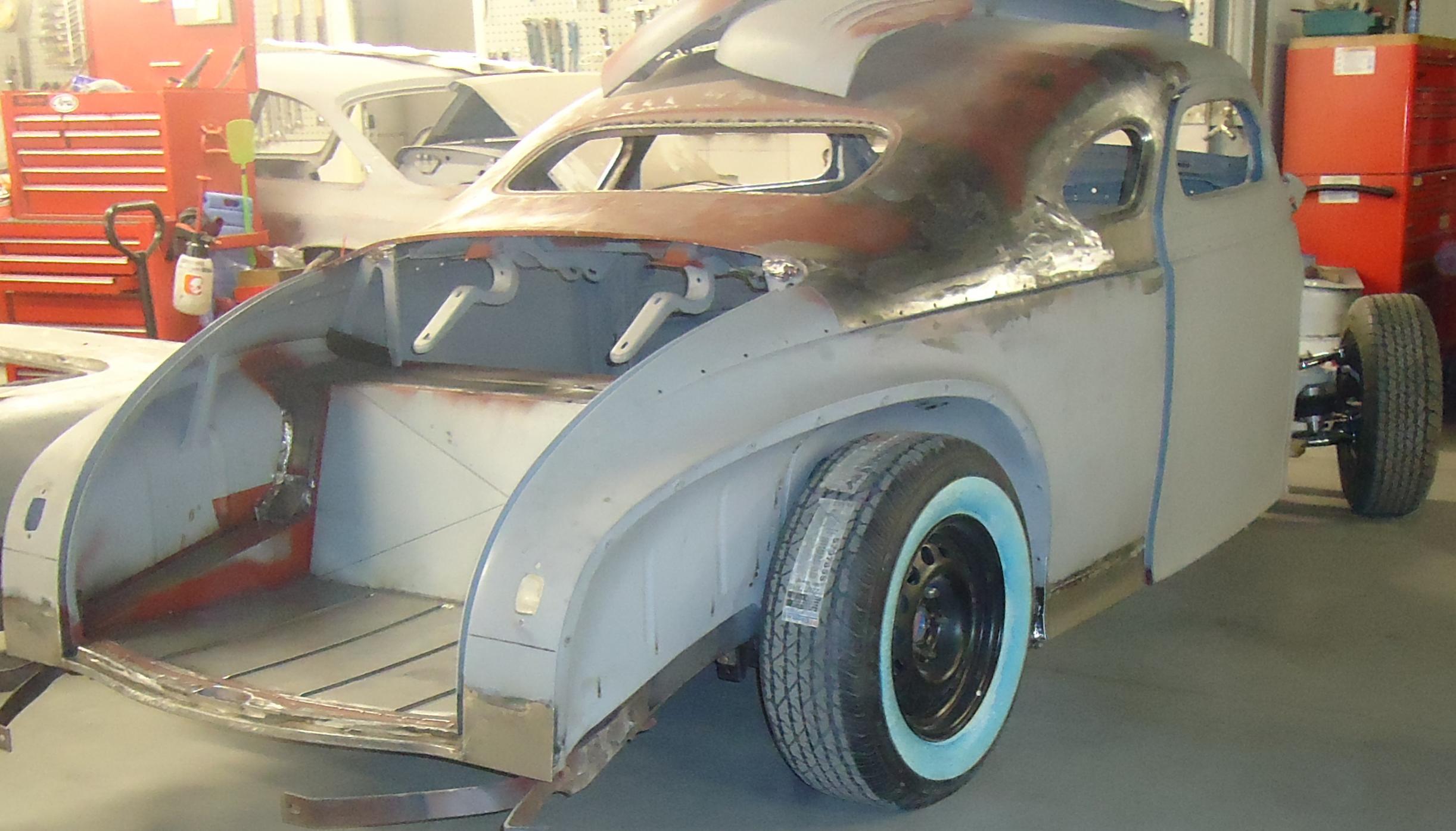

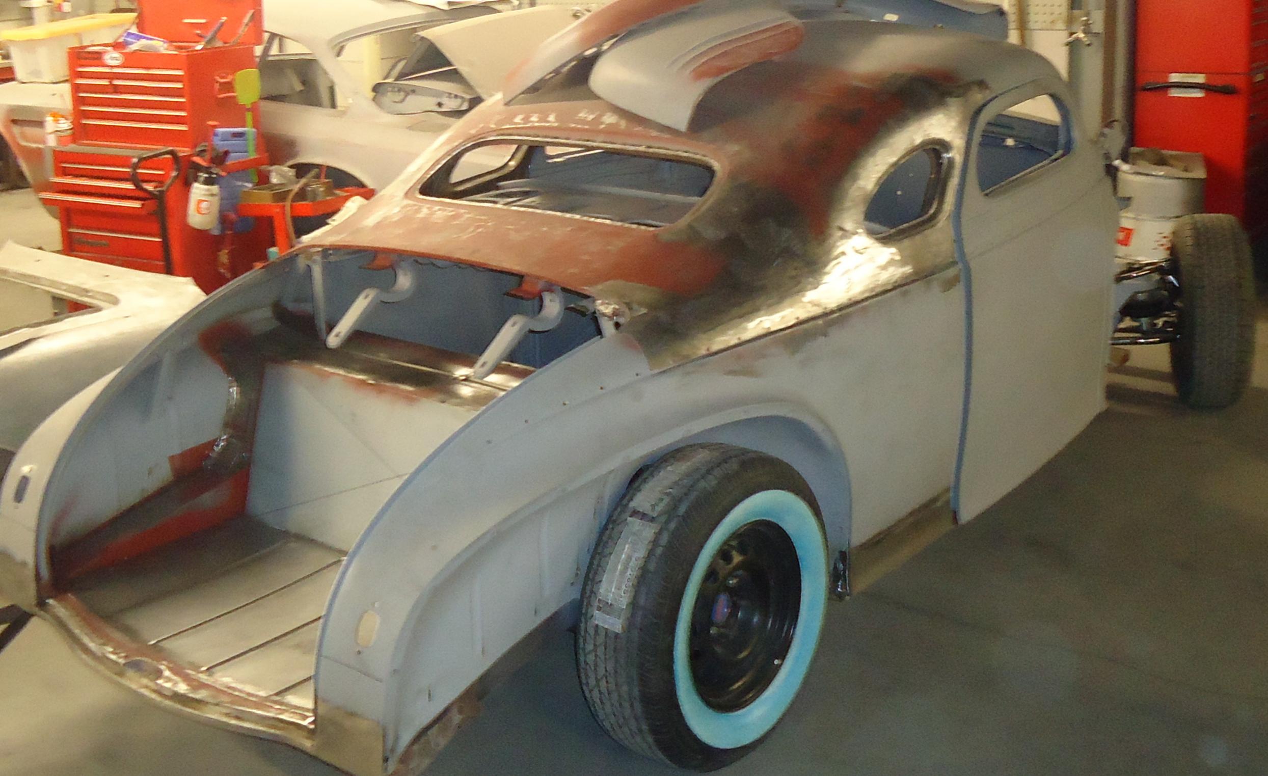

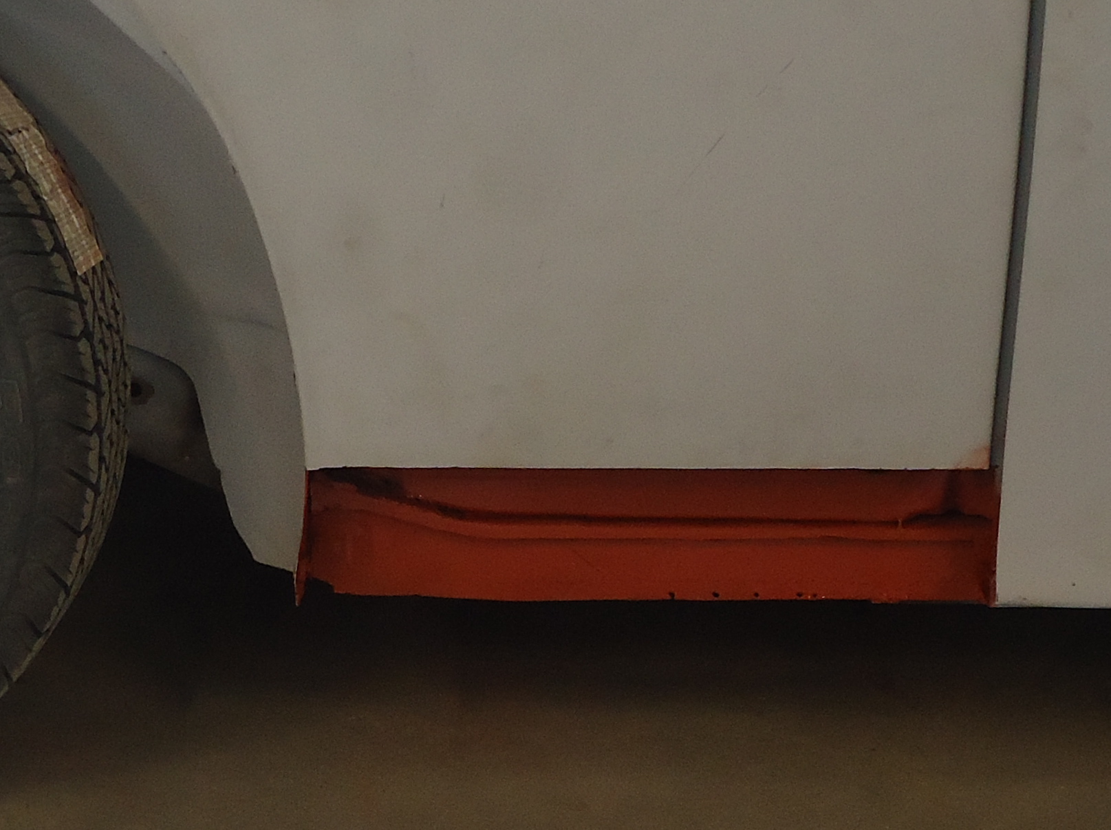

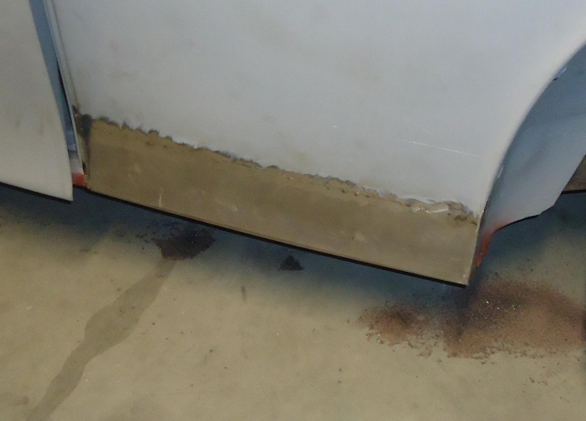

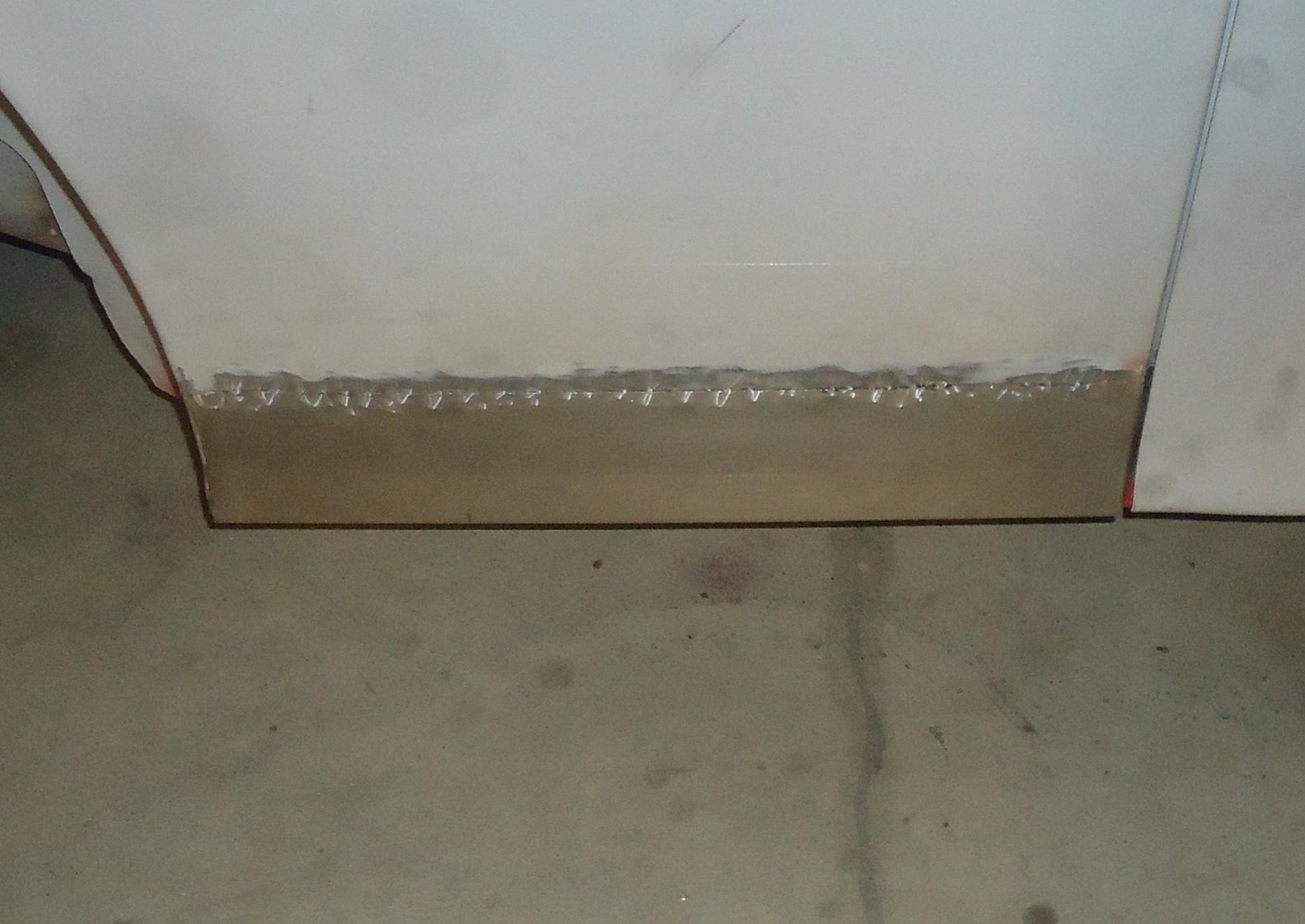

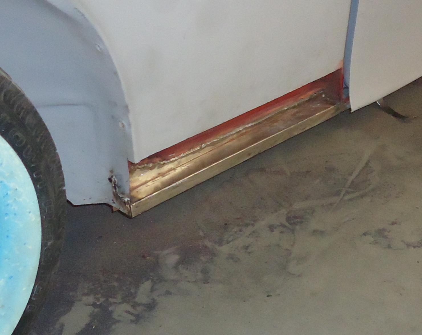

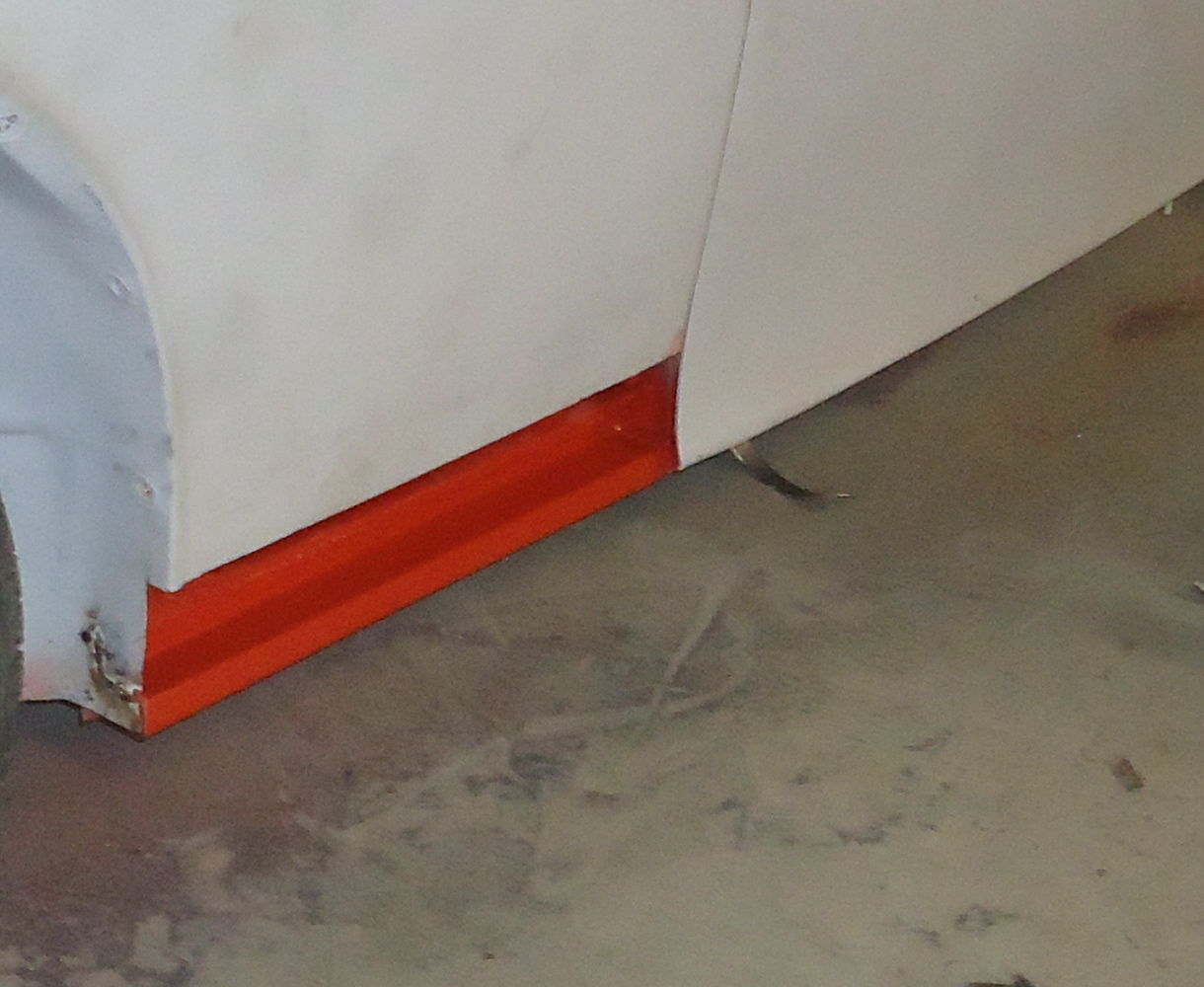

    Wow what a day! Spent the last 10 hours measuring, fabricating and spot welding. The first photo shows the initial shape I started with. Pic 2 and 3 show the before and after shot. I just don't understand why people would just add on the bondo and cover areas like this. (or what was left of it). Tomorrow I'll do the final hammering and weld it all up. A very succesful day all in all.

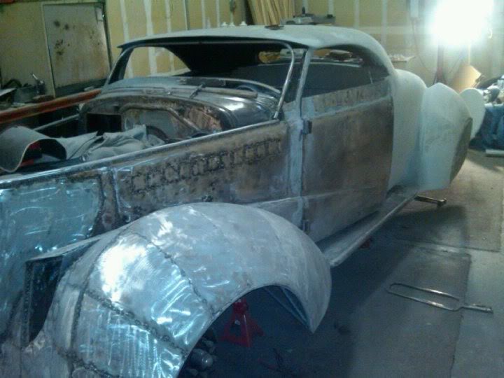

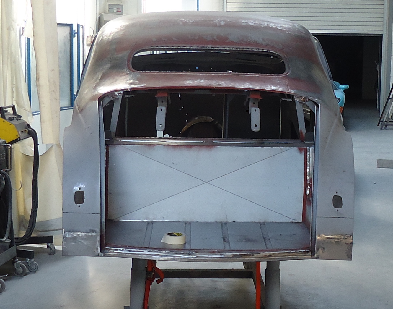

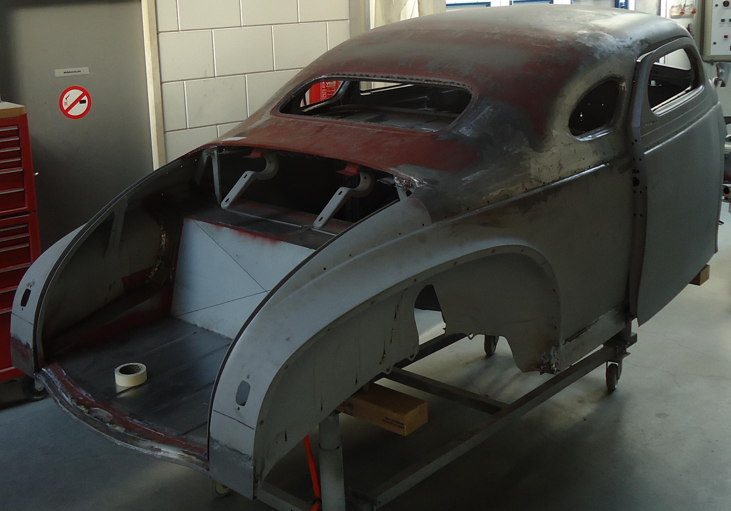

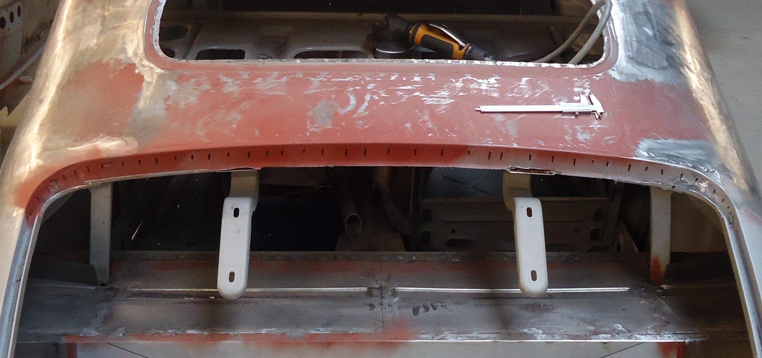

    Started welding up the lower sides. Then decided it was time to replace the upper part of the trunk gutter which was quite rotten in place. Just cutting it out properly took me the most part of the afternoon. Never realised, but it actually supports the parcel shelf and the trunk spring/hinge mechanism. Glad I'm replacing it!

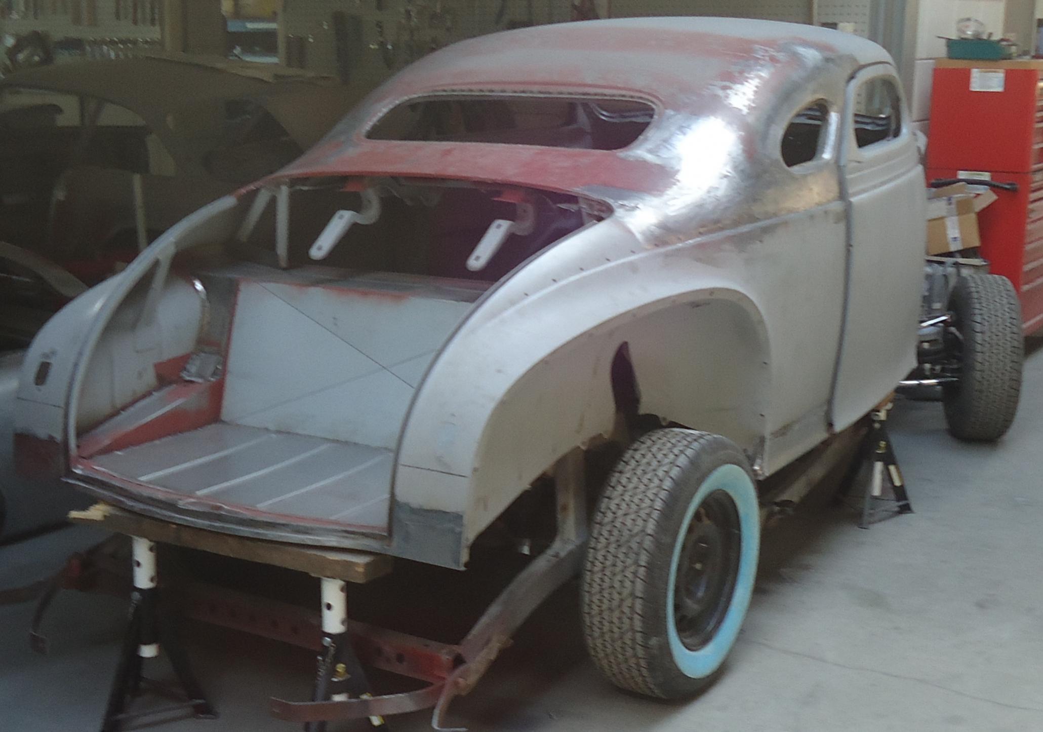

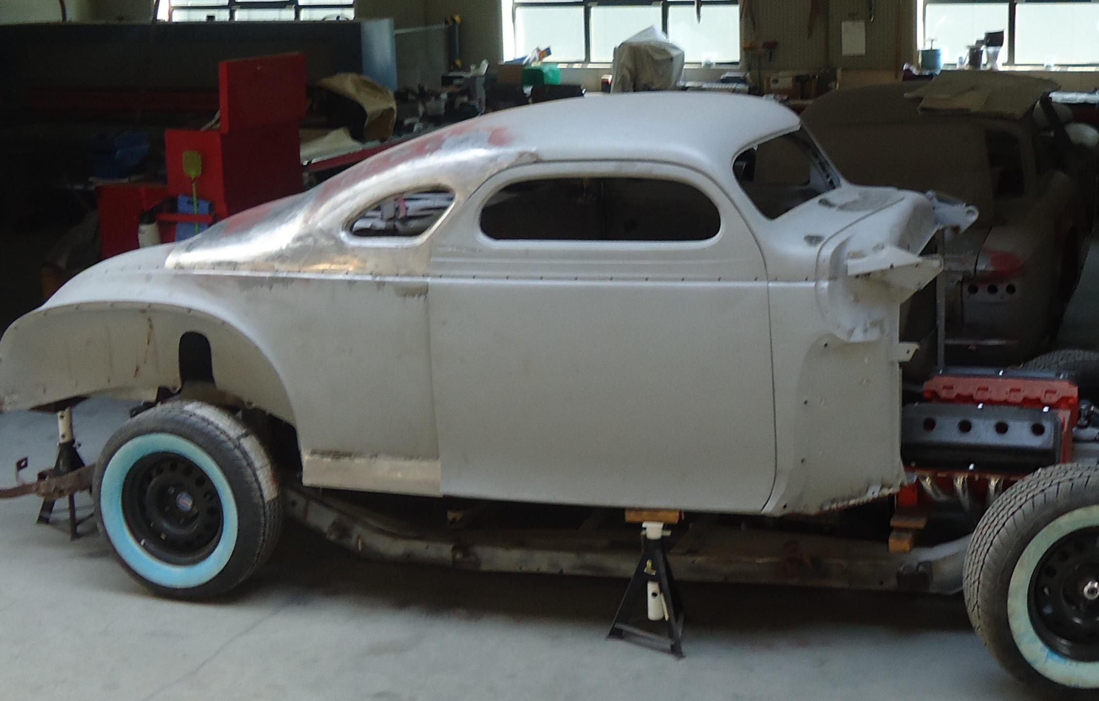

    Here are just a few pics of what the car looks like at this moment.

    Eric, how do you intend to get those trunk hinge springs back on? I've not taken mine off because I was afraid I'd never get them reinstalled. :)

    Haha, funny you mention that. When I took them off to get sand blasted and primered, I did try to re install them by myself. This does not work! It's going to be a two man job, but I figured if they came off, they must get back on. I'll try to fit them back on there once the gutter is in place. I'll keep you posted!

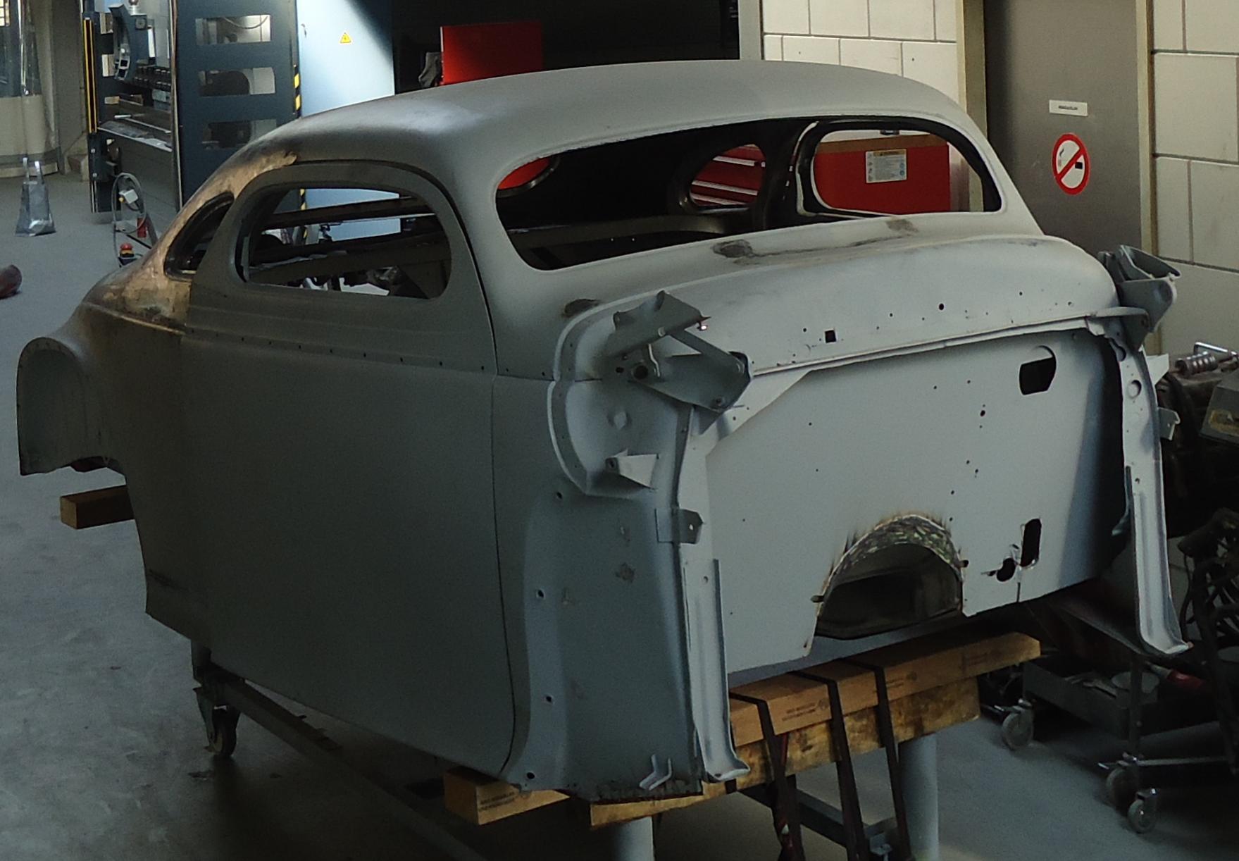

    Well today it was time to lift the body off the ch***is. Jacked her up in the front and rear in order to clear the c-notch and the transmission.
  28. farmer12
    Joined: Aug 28, 2006
    Posts: 7,723
    farmer12
    It took 4 of us to lift the body off and place it on a cart. This will give easier access to finish off the last welding necessary. Will have the ch***is back in my garage this week and this will give me the opportunity to finish off the final welding.
