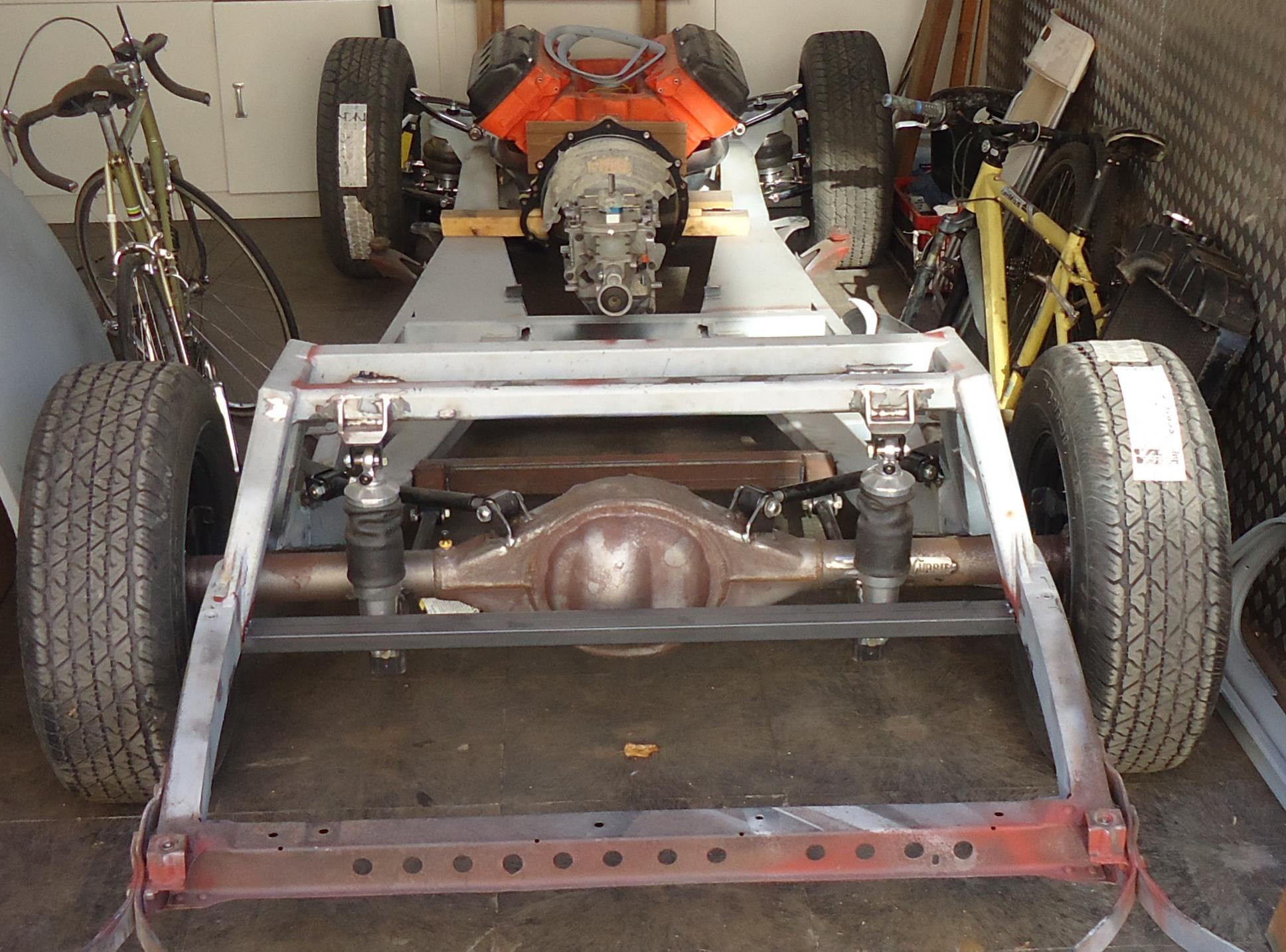

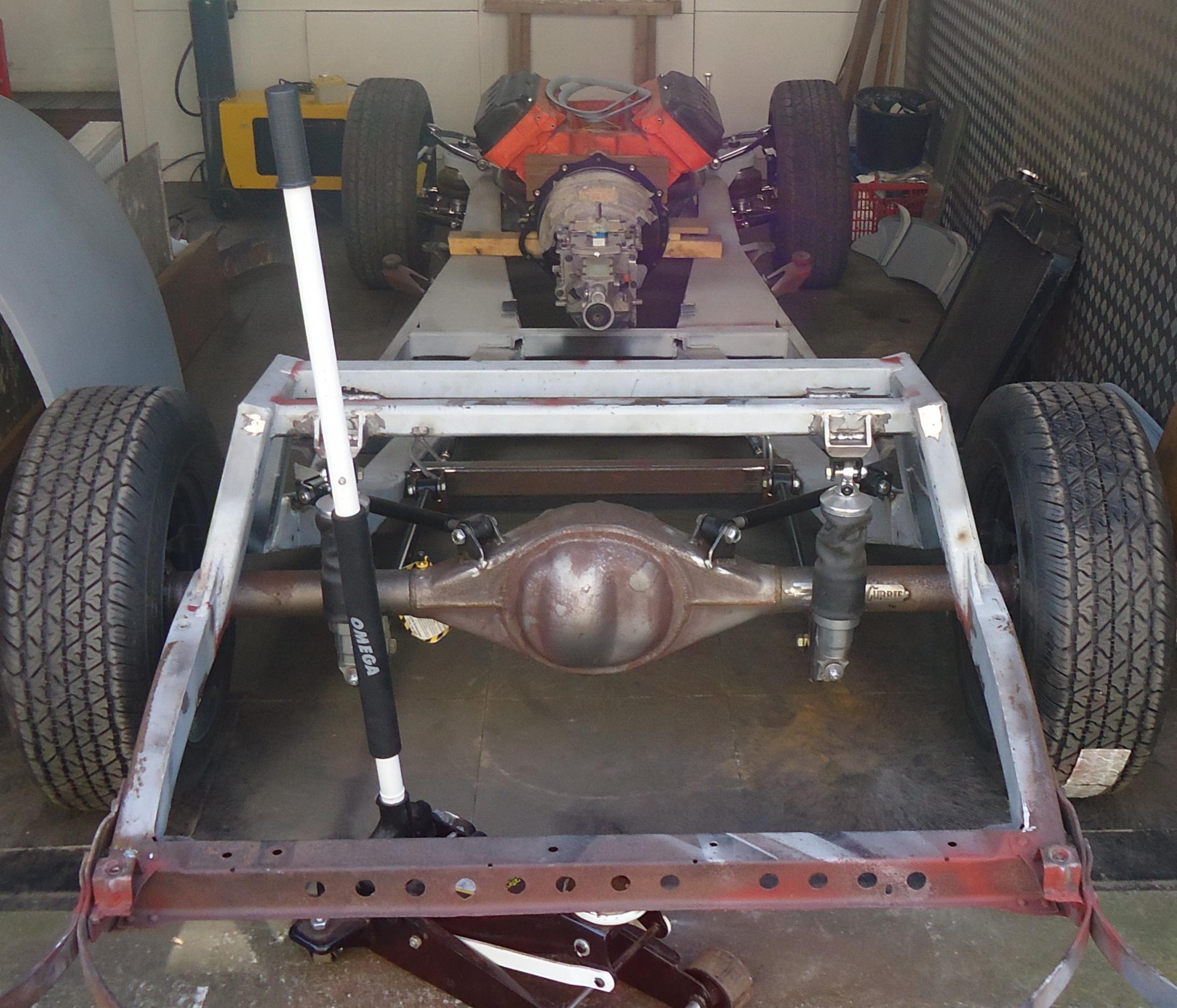

  9. farmer12
    Joined: Aug 28, 2006
    Posts: 7,724
    farmer12
    Got the ch***is back in the garage......now it's time to clean up all the other stuff surrounding it, giving me a bit more room.

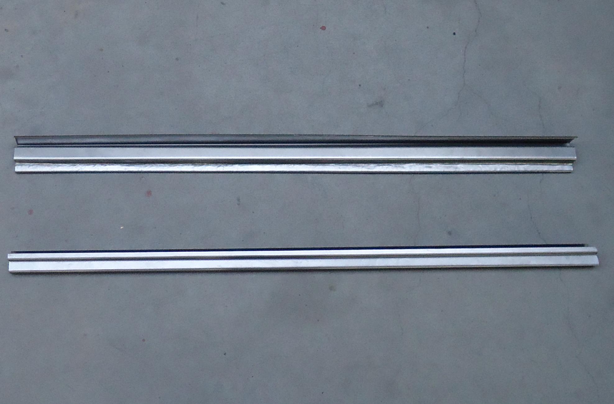

  10. farmer12
    Posts: 7,724
    farmer12

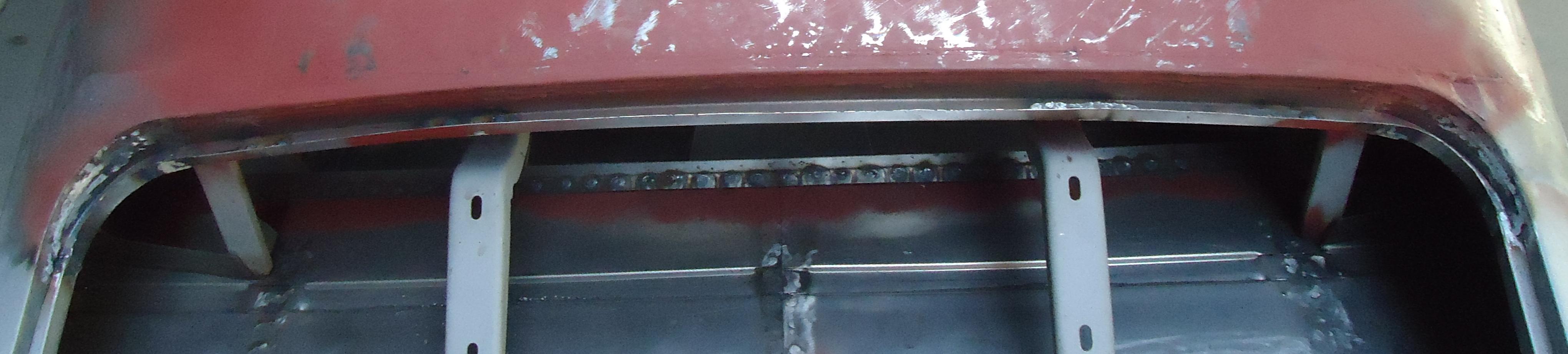

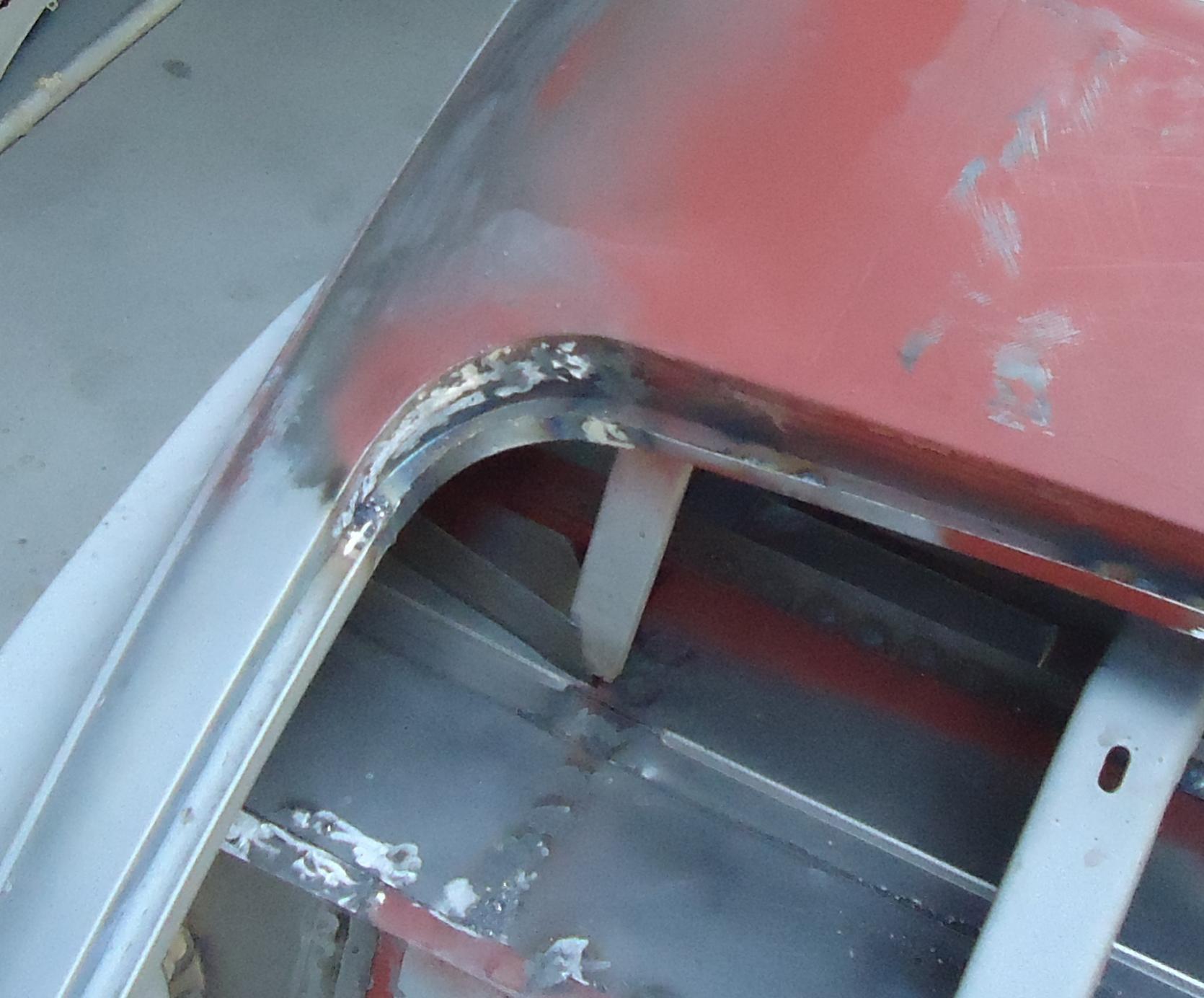

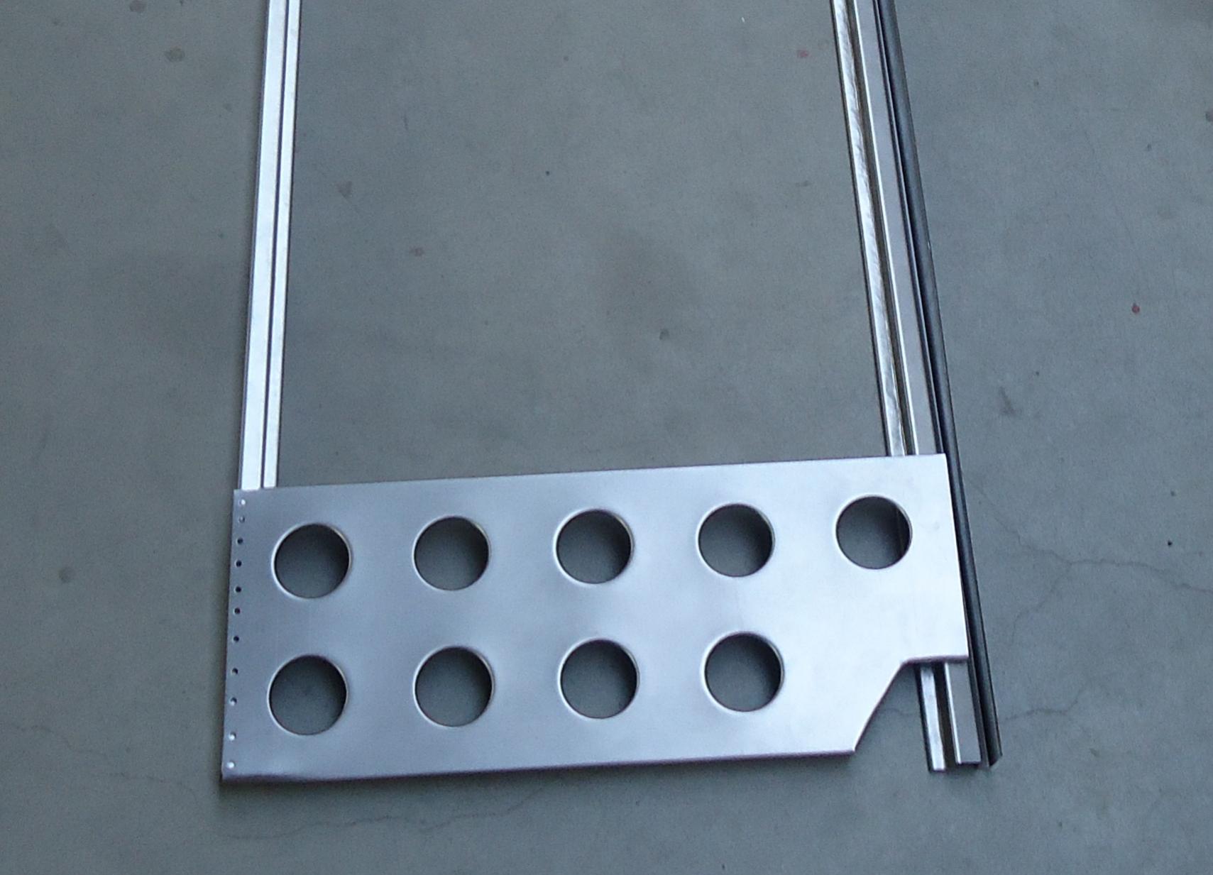

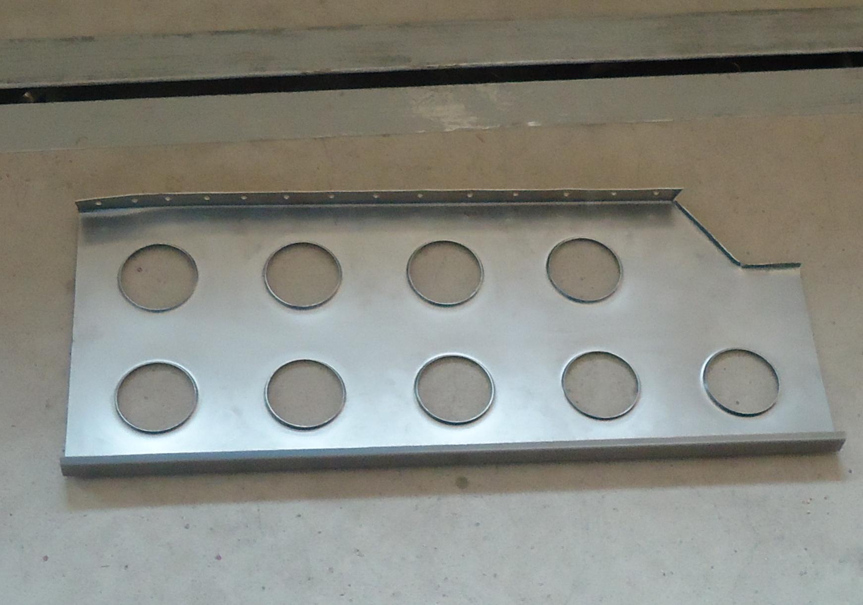

    Got back to work on the car again today. I needed to strengthen the hat shelf on the drivers side. This space was originally used for the spare tire. Started off by replicating the two uprights which are on the p***enger side. Then fabricated the lower horizontal piece. This actually came out so good, that I'm now thinking of making one for the other side as well........The last pic is where it is loosely positioned in place, just to give you an idea.

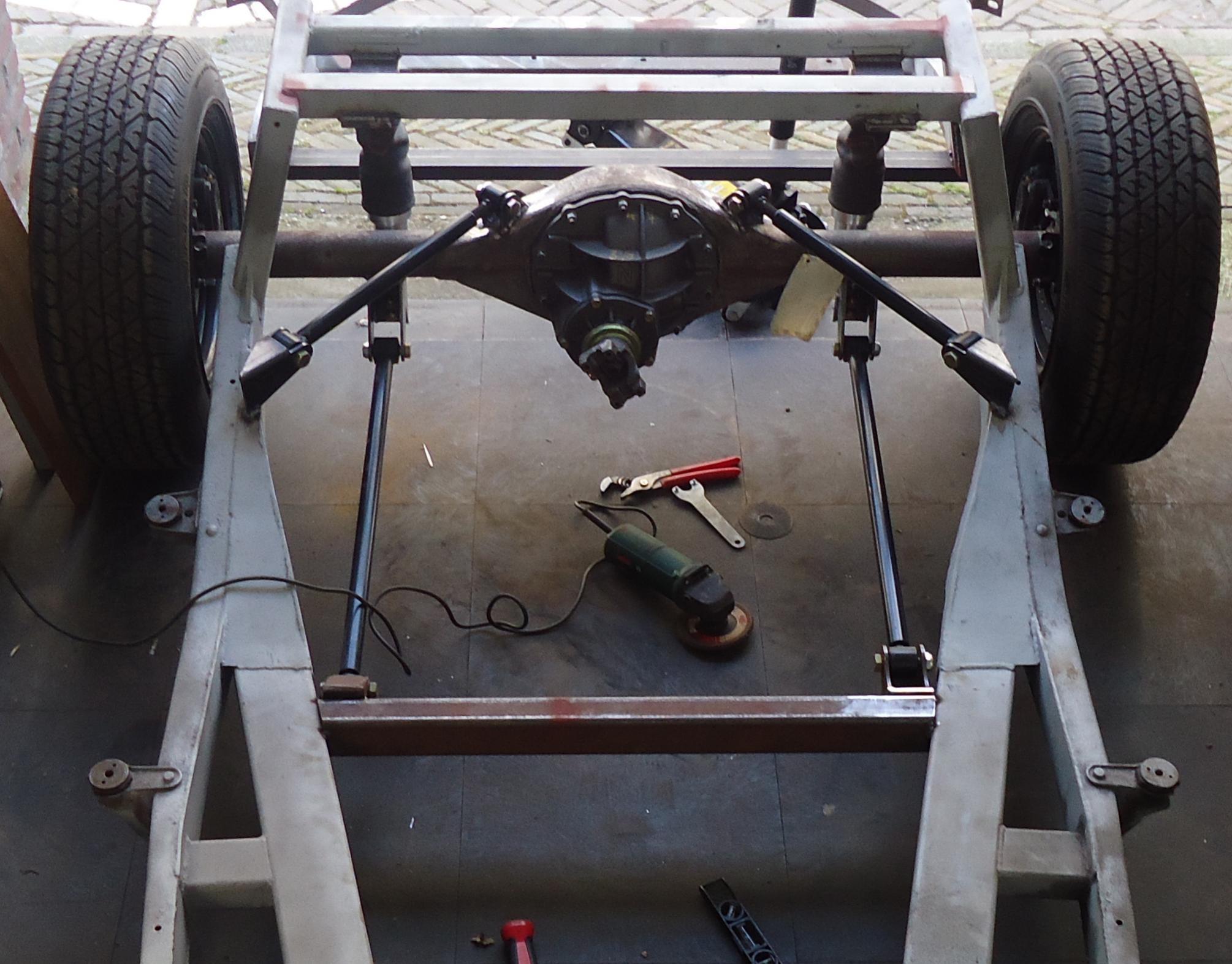

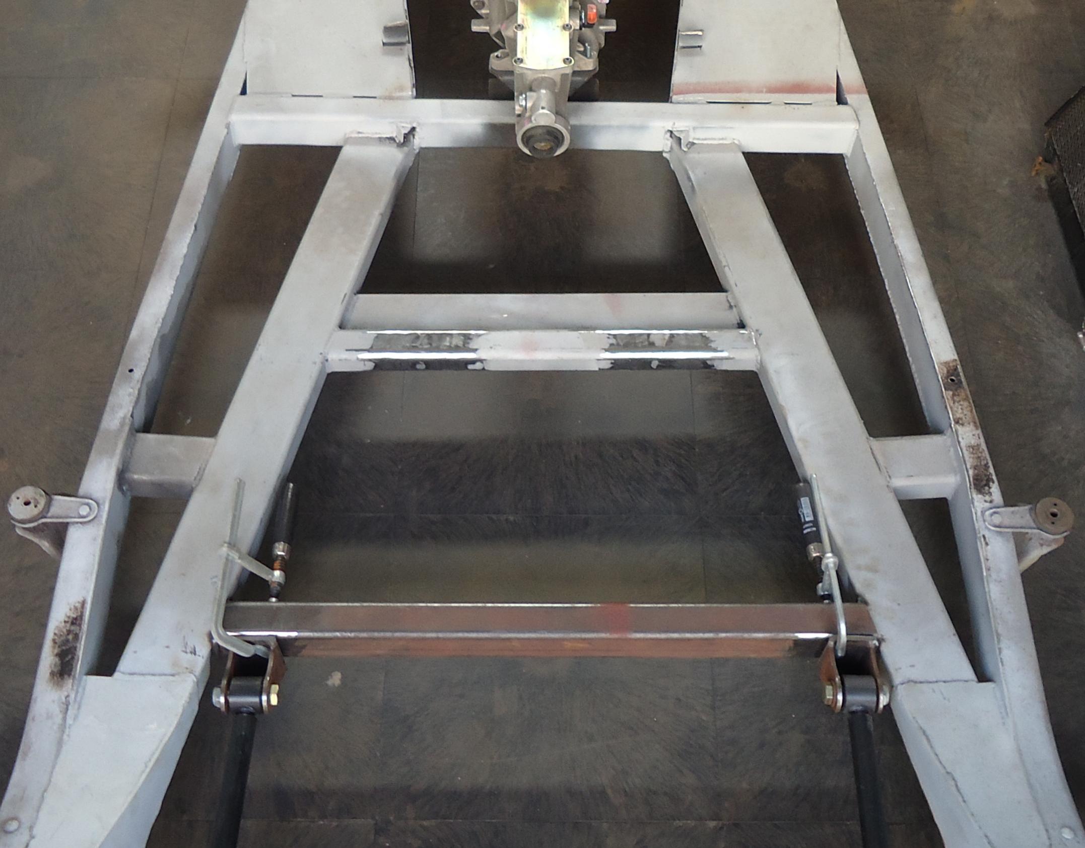

  17. farmer12
    Posts: 7,724
    farmer12
    I wanted the car to sit even lower in the back, so I moved the air rides to its lowest position. Considering I needed to change the mounts of the lower parallel bars of the suspension, I cut through the welds. I've decided to turn them upside down, which therefore will require boxing the top and cutting a piece out of the bottom, so I still have access to the bars from below for adjustment. While I had the grinder out, I got rid of some big old welds on the bar in front of the present mounts.

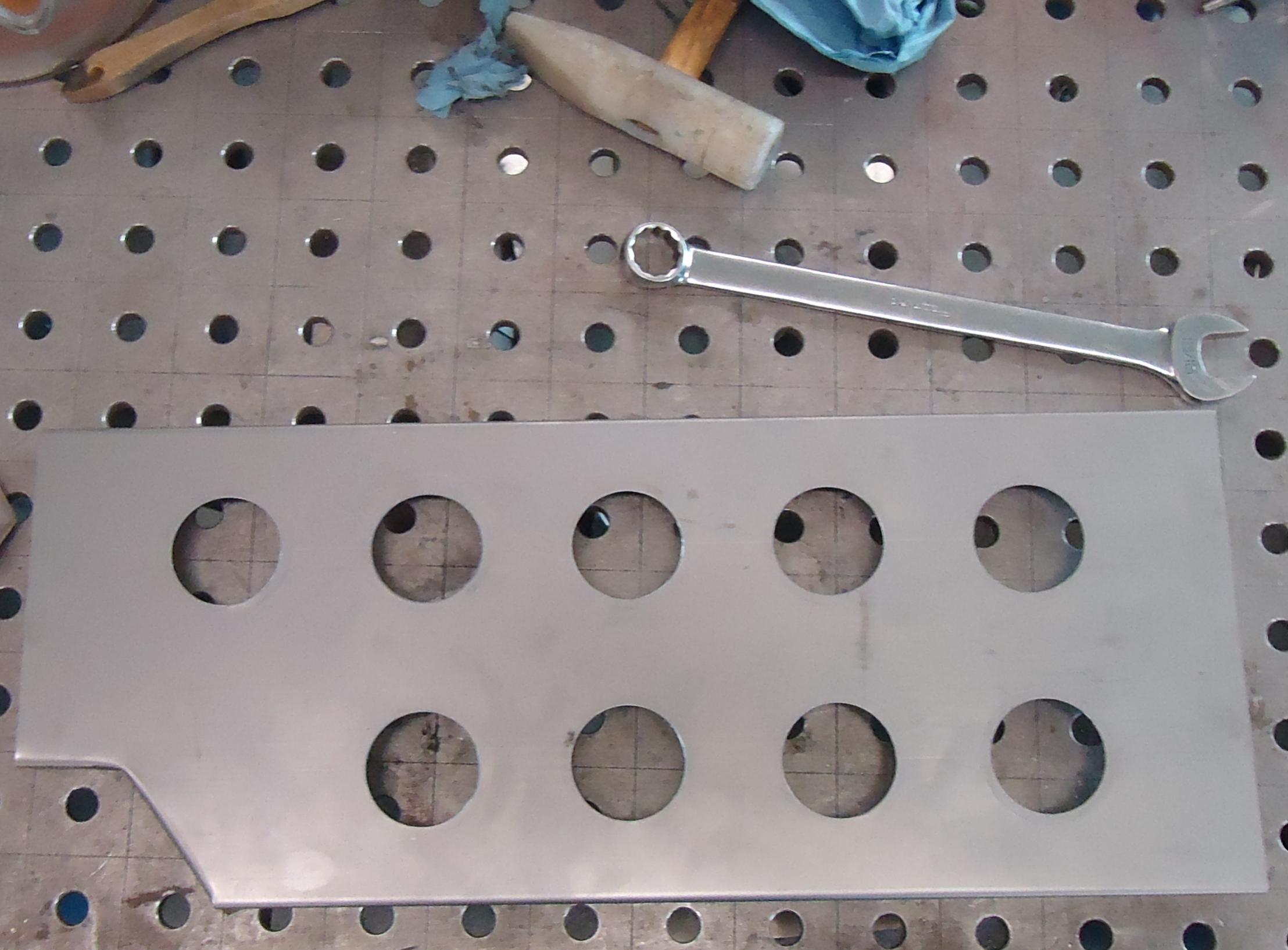

    Posts: 7,724
    farmer12

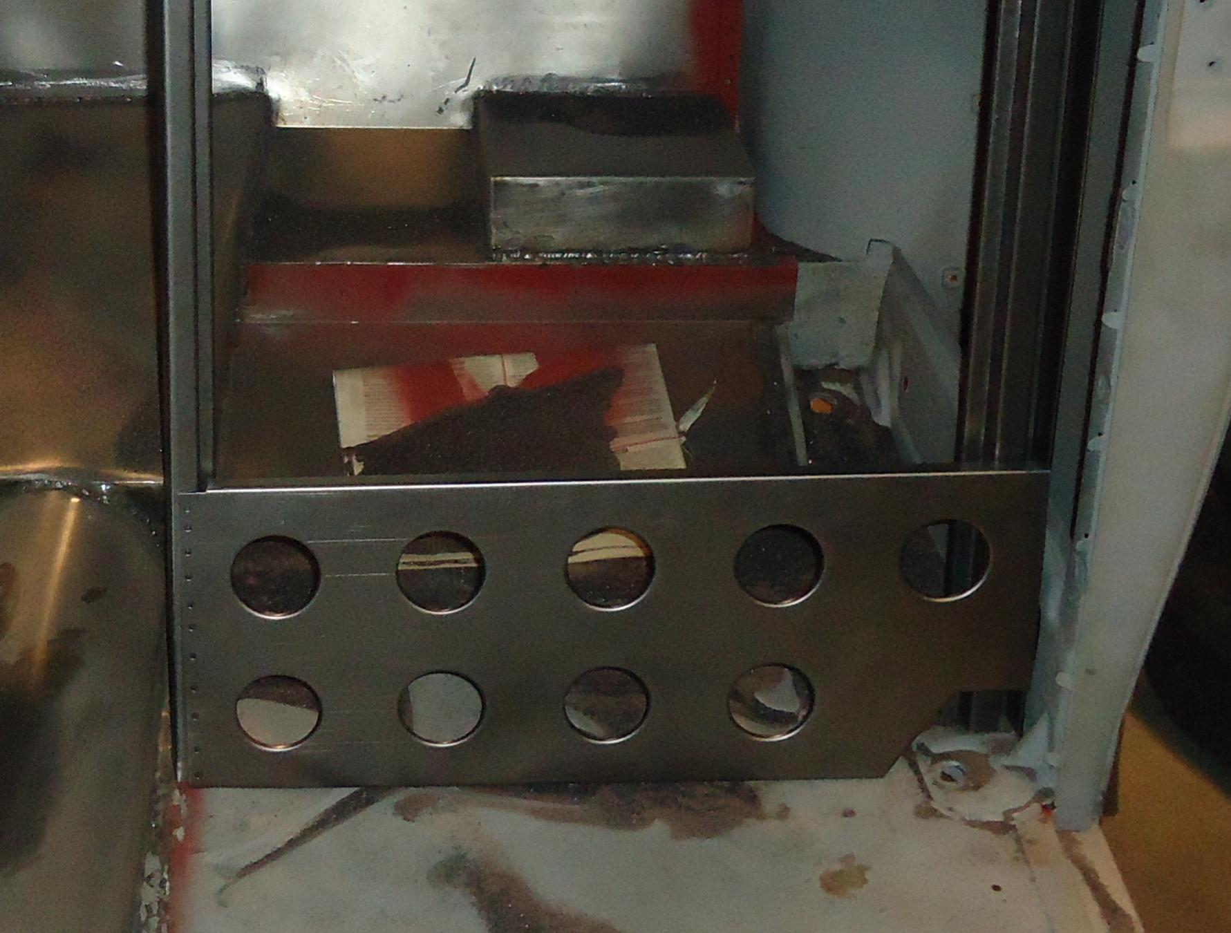

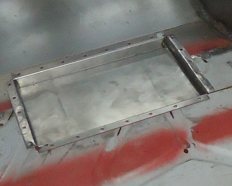

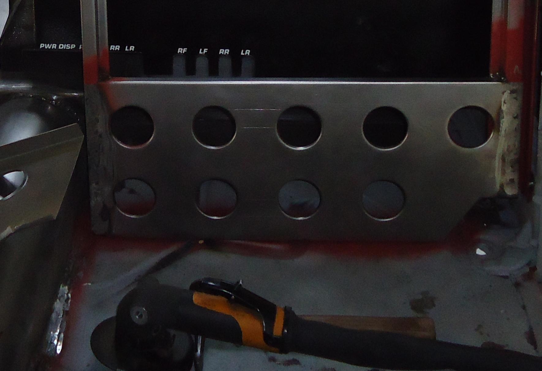

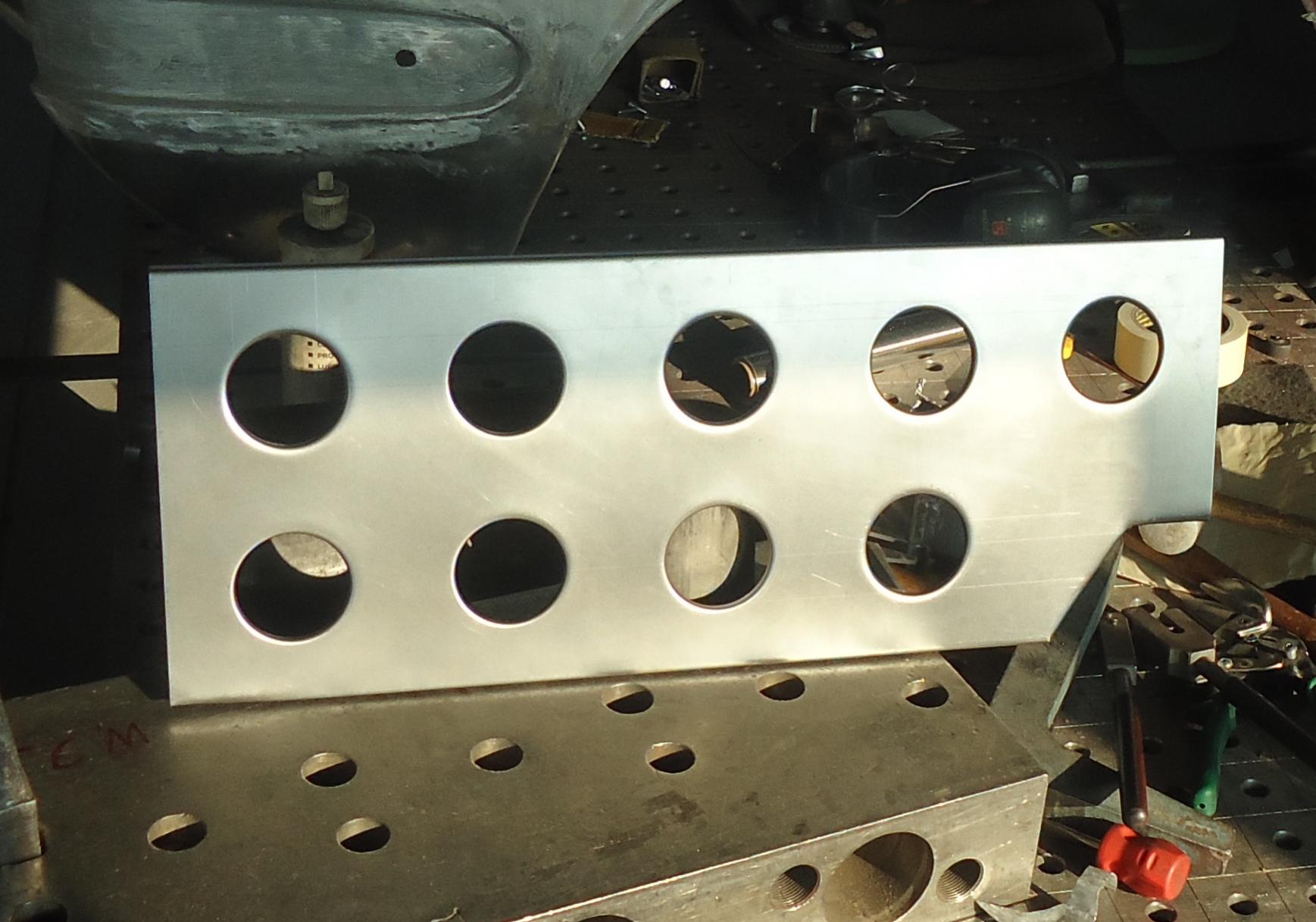

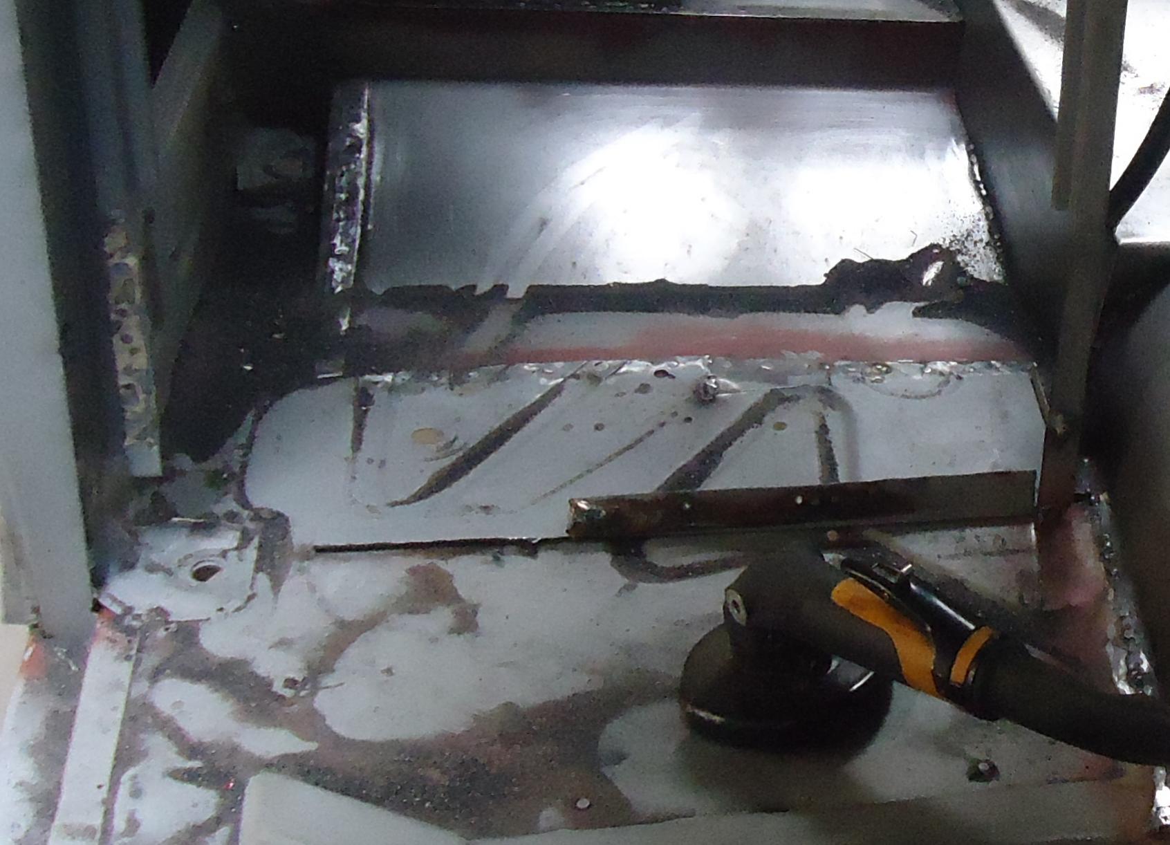

    Today I fabricated the p***enger side panel, located behing the bench seat. I cut out the original piece and started to clean up the old spot welds. Behind this panel I'm planning on placing the battery, for which I'll make a tray which will sink in the floor about an inch. Tacked the drivers side supports in place, with final adjustment to be done next time.

    farmer12
    Final welding was done on the drivers side panel. I actually jacked up the sheet metal slightly from below to create a good and sturdy weld. Then made a battery box. The battery will be sunk about 1 inch into the floor. Welded it all up and ground it all.
