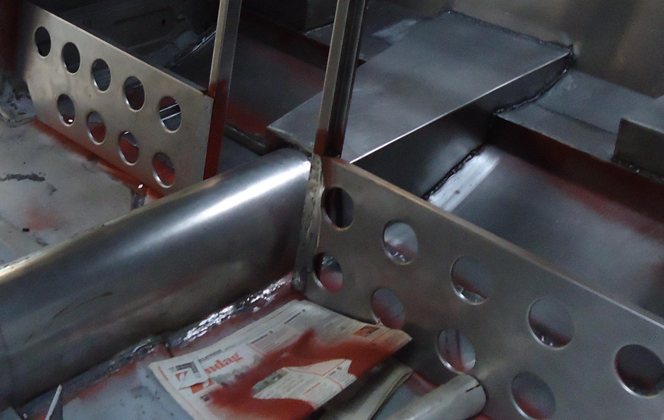

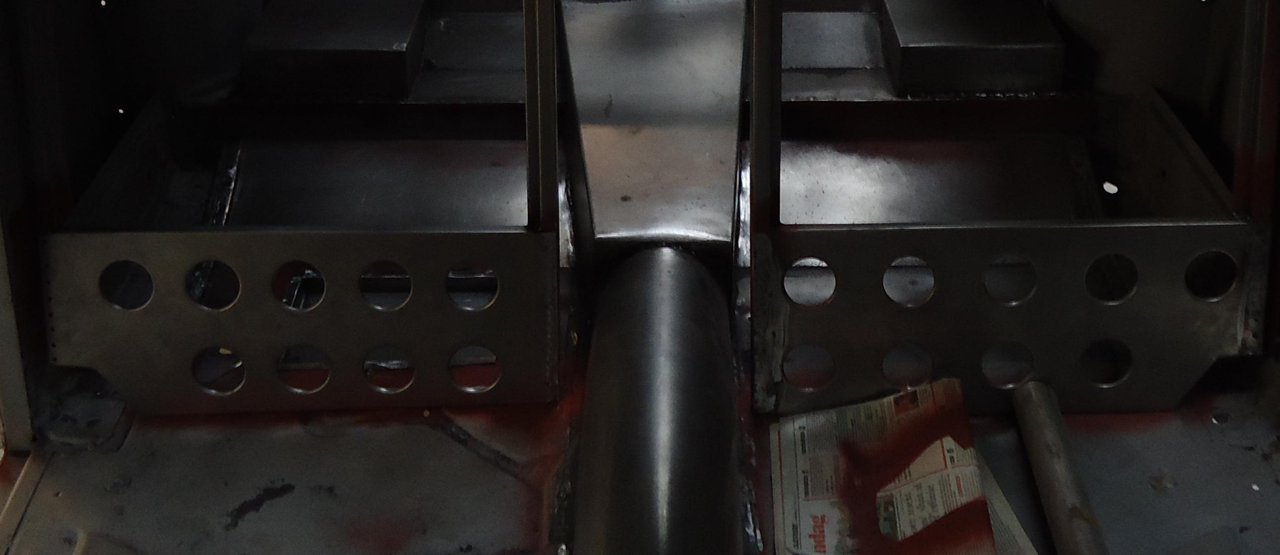

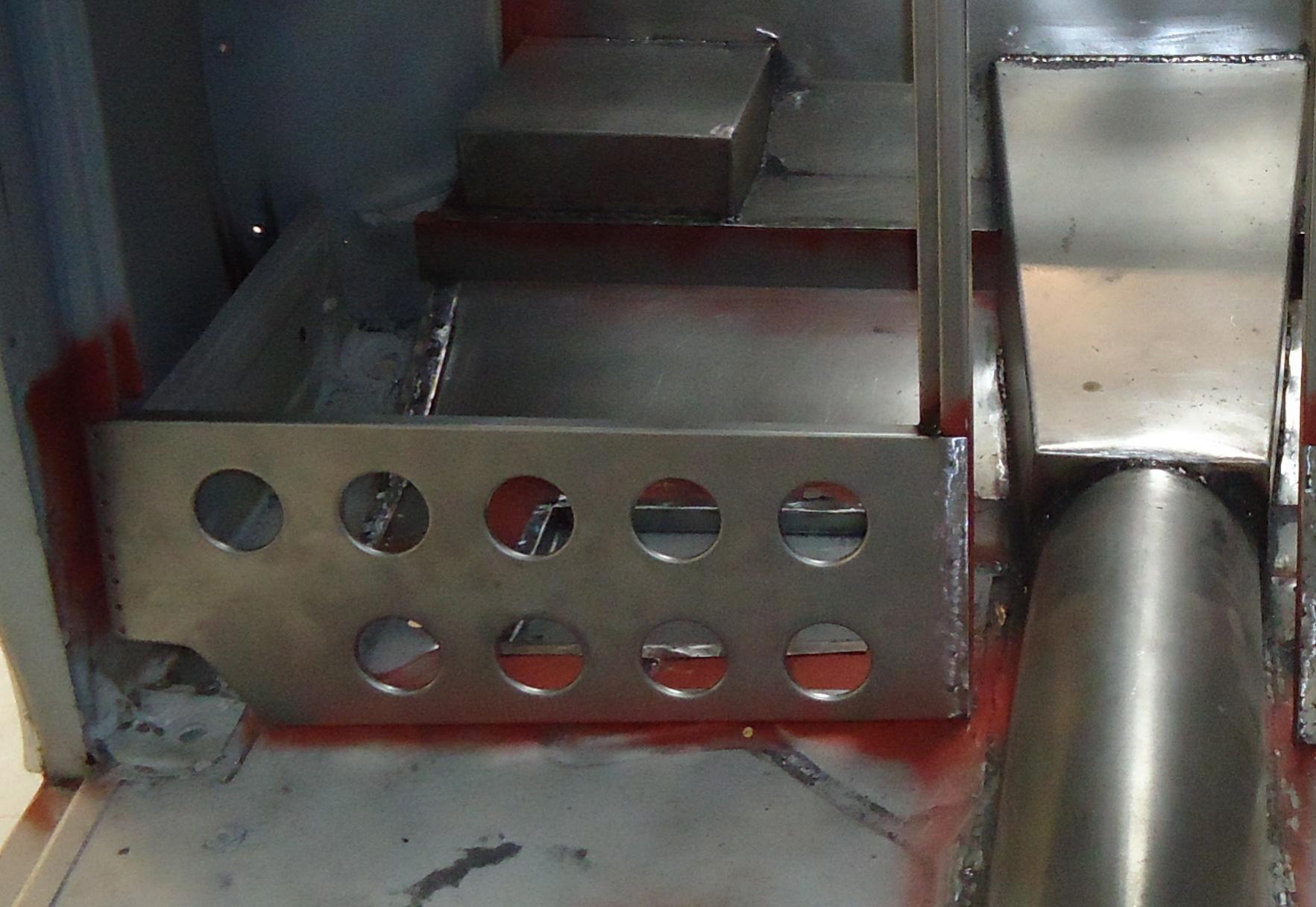

    I tried to position the panel in place with a little m***aging and finally got it to fit. Unfortunately I'll have to wait to weld it all up until I have time again, and that won't be until around May 10. Some people have to work for a living you know..:eek:

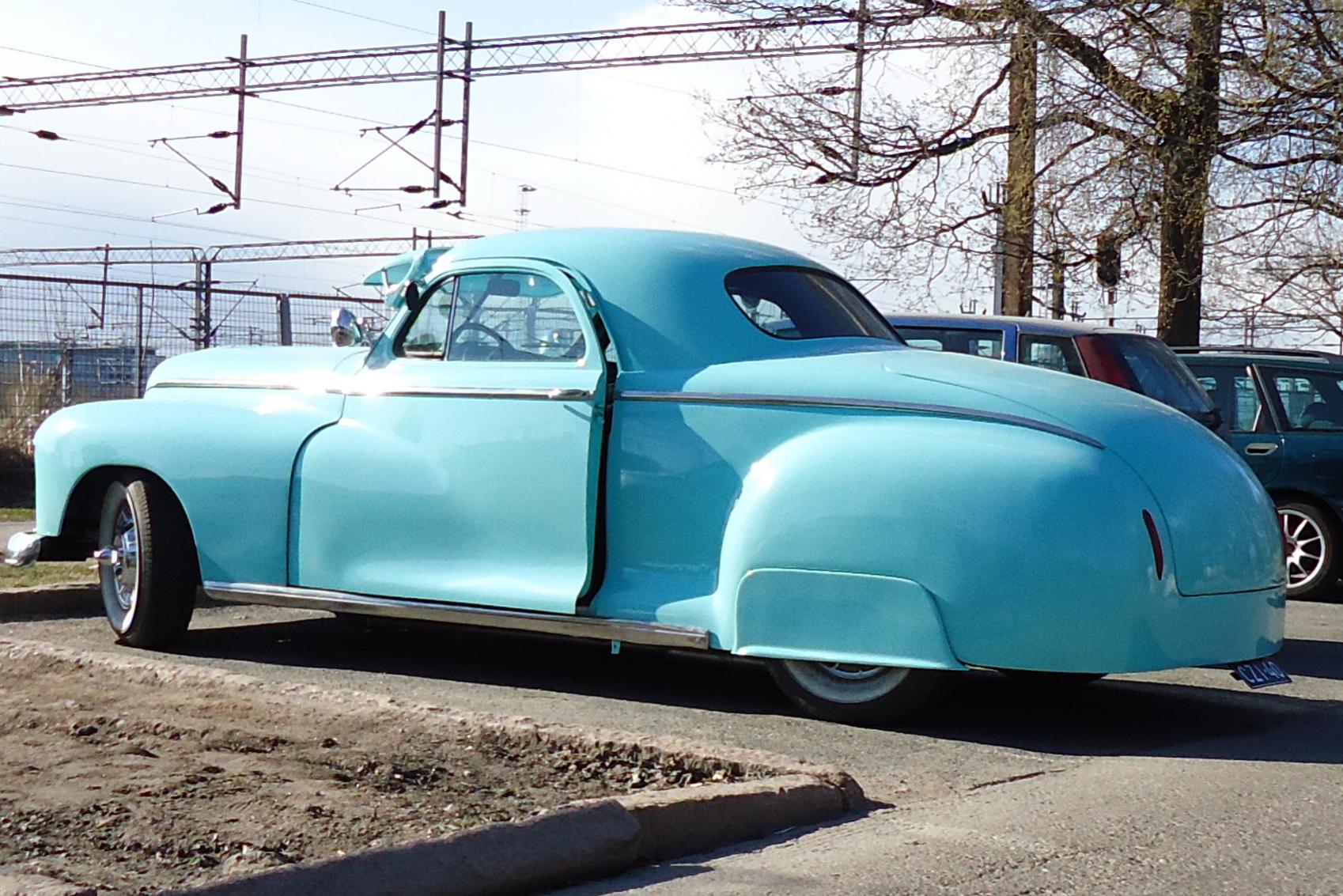

    Just got back from Helsinki after meeting up with fellow Hamber Pasi yesterday.(COra1/1 here on the Hamb) What a great guy! He even went to the trouble of picking his car up 30 miles away just so I could see it. His 46 Dodge coupe is one fine car.
    After a beer, we checked out his beautiful car. He took a lot of time answering my questions and explaining the modifications he has planned in the future. He then proceeded to take me and my buddy Frank for a ride through Helsinki. Thank you once again Pasi for going to all the trouble. It was very nice to meet you and good luck with the planned modifications. Here are a few pics, that's Pasi on the left. I got to tell you, it feels good to be part of this Hamb community!

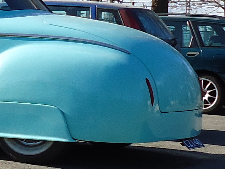

    What are the taillights in Pasi's 46? Glad to see guy's like us fixing these old mopars and being able to learn and bounce ideas off each other.
  17. farmer12
    Joined: Aug 28, 2006
    Posts: 7,724
    farmer12
    I believe he said the taillights are from a (modern)Lancia. Correct me if I'm wrong Pasi.

    Or maybe from modern Fiat,i've seen that someone used them in his ride in here.I hope to meet you at next time you are in here,at this time timing was just horrible.

    It could have been a Fiat Bravo, now you mention it. I'll let you know next time I'm in town!

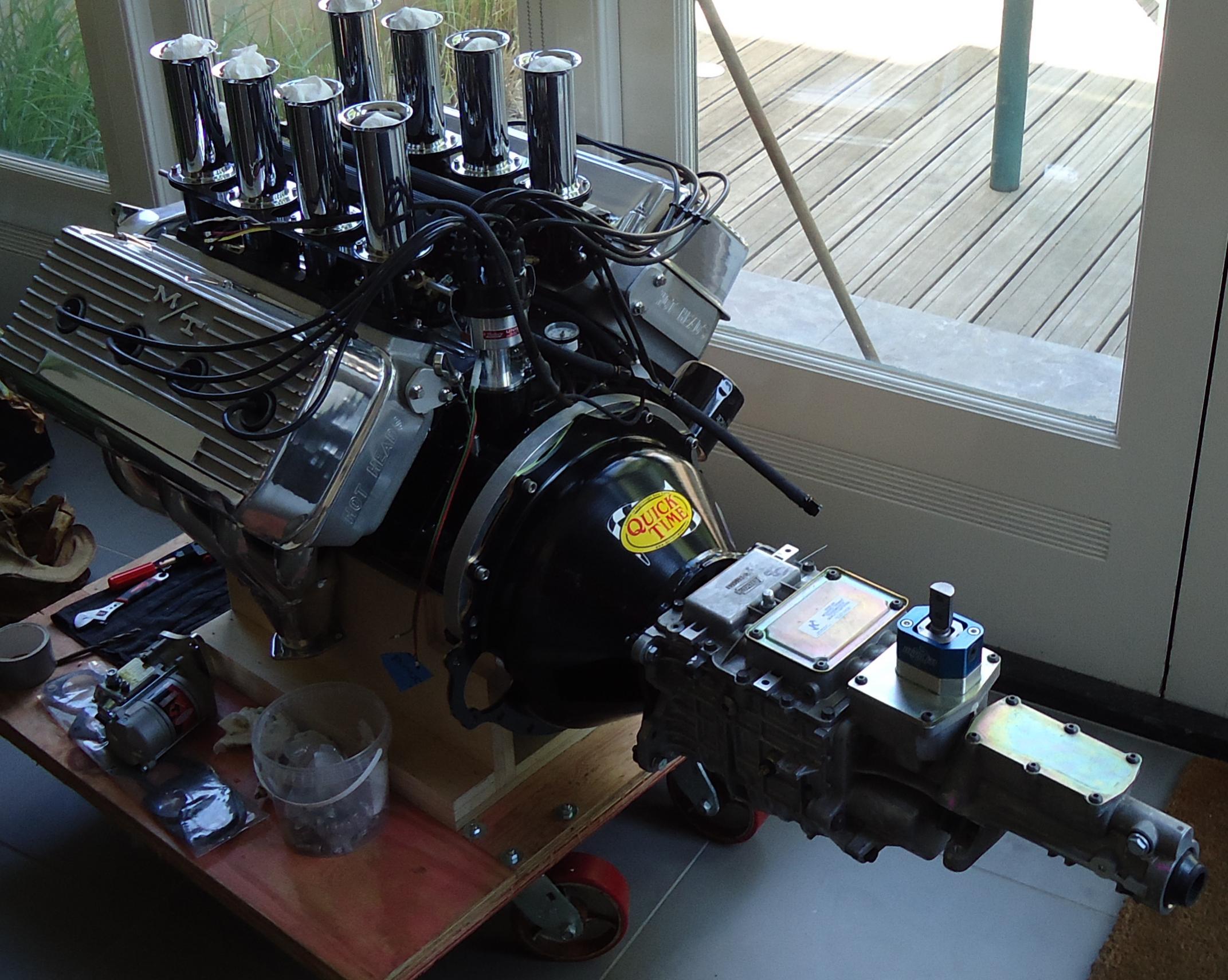

    This week won't show too much progress as the wife has to work all week and I'll be looking after the kids. Working on the body again next monday.
    While I'm at home anyway, I decided to take the ****** off the mock up engine and bring it inside the house.......luckily the wife is very understanding!

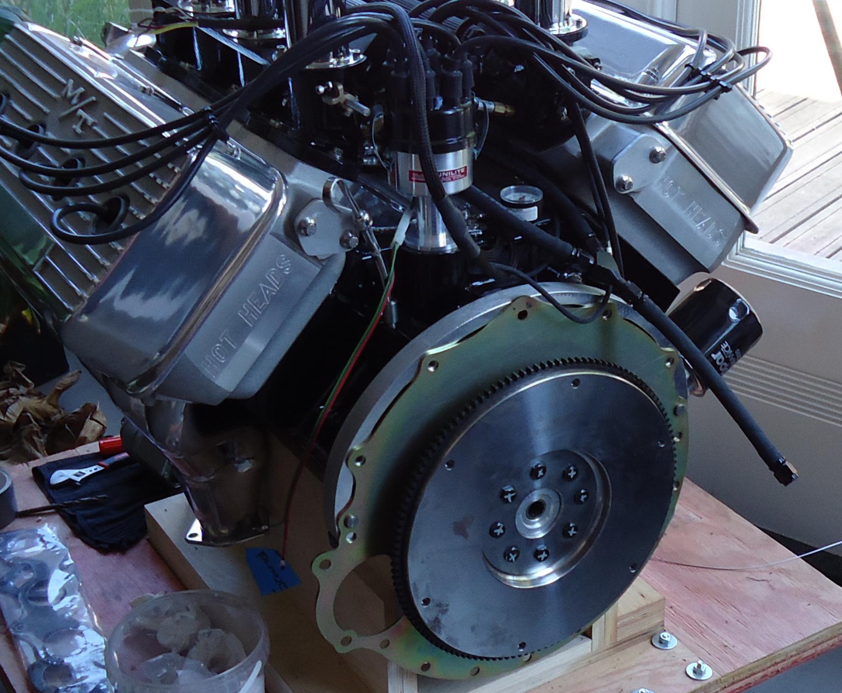

    First removed the flywheel and installed the ****tershield plate. Then re-installed the flywheel. This did not go without a hitch. I had to get the nuts on with a spanner (open side as the closed side wouldn't fit). The nuts kept falling off, so used chewing gum to hold it in the spanner. This worked out great!

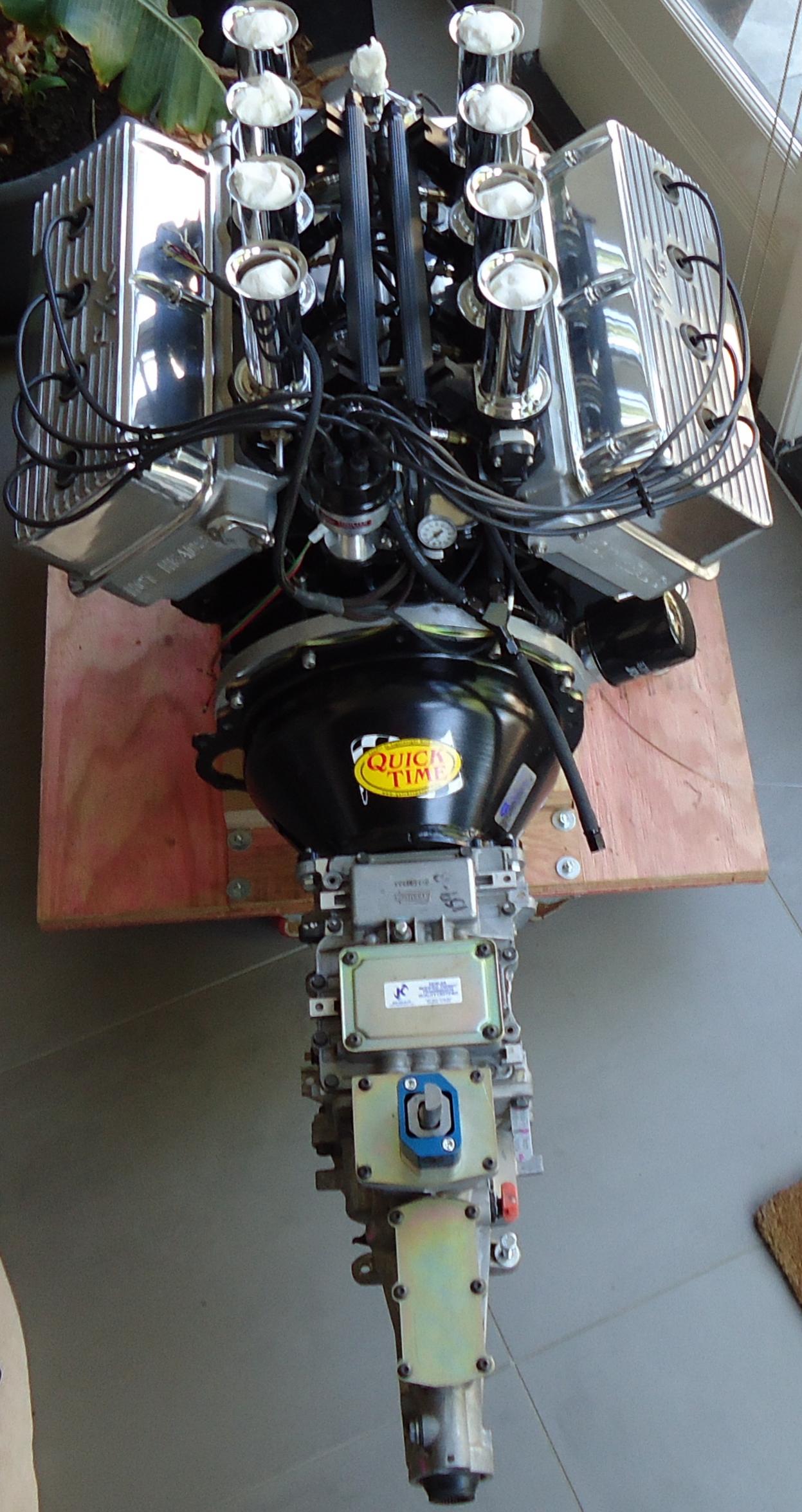

    Next was the installation of the bell housing. No problems here, but there are only 4 bolts which go into the engine. I was expecting one or two more bolts to go into the adapter plate at the bottom. Is this normal?

    Warm, warmer - you are right guys, the taillights are from Fiat Bravo, originally situated horizontally.

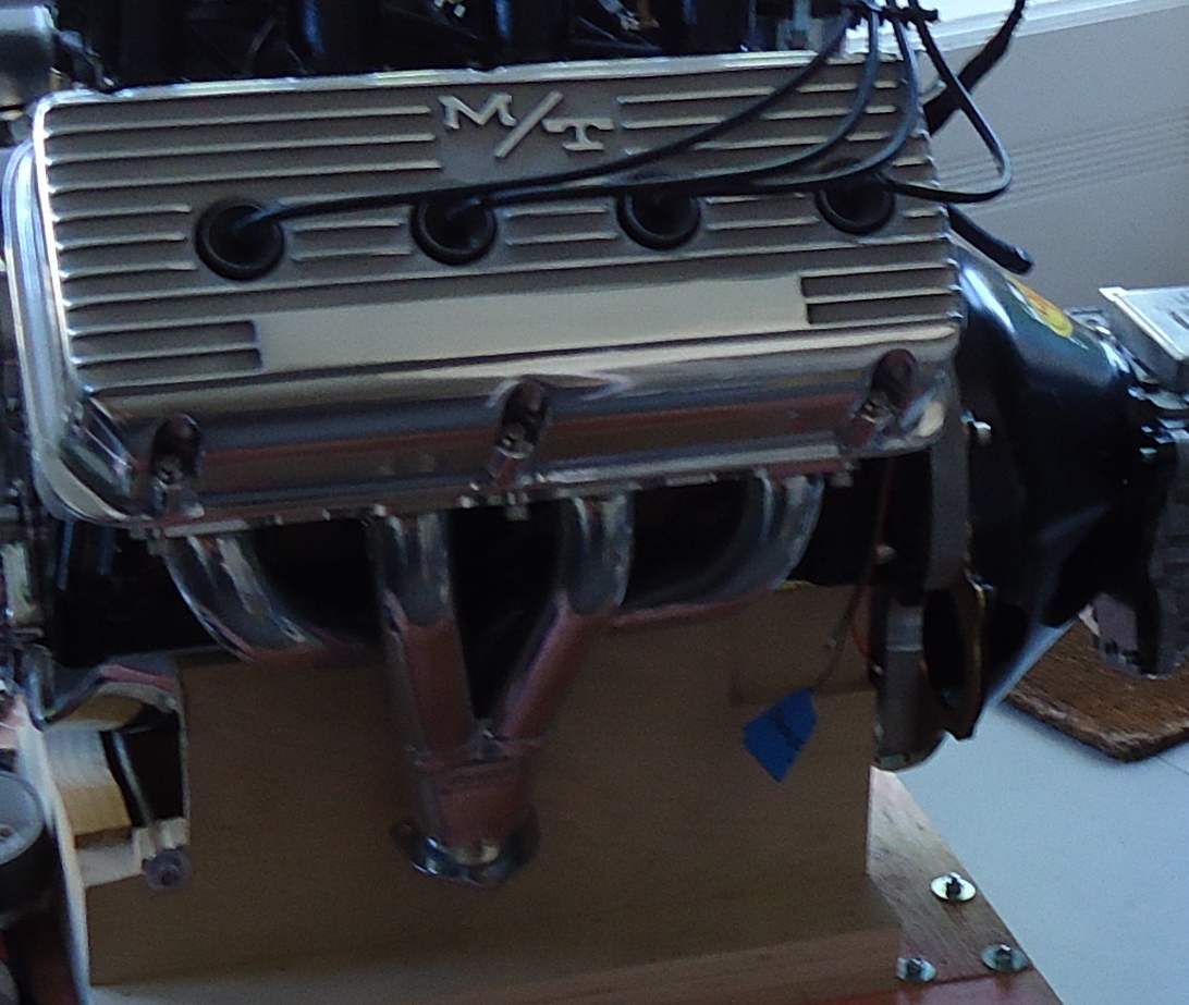

    Finally got the Tremec 600 lined up and bolted it on with the help of two of my kids. They screwed the bolts in while I held it in place. Damn these things get heavy after 5 minutes! Bolted the left hand side header on just to see how they'll look.
