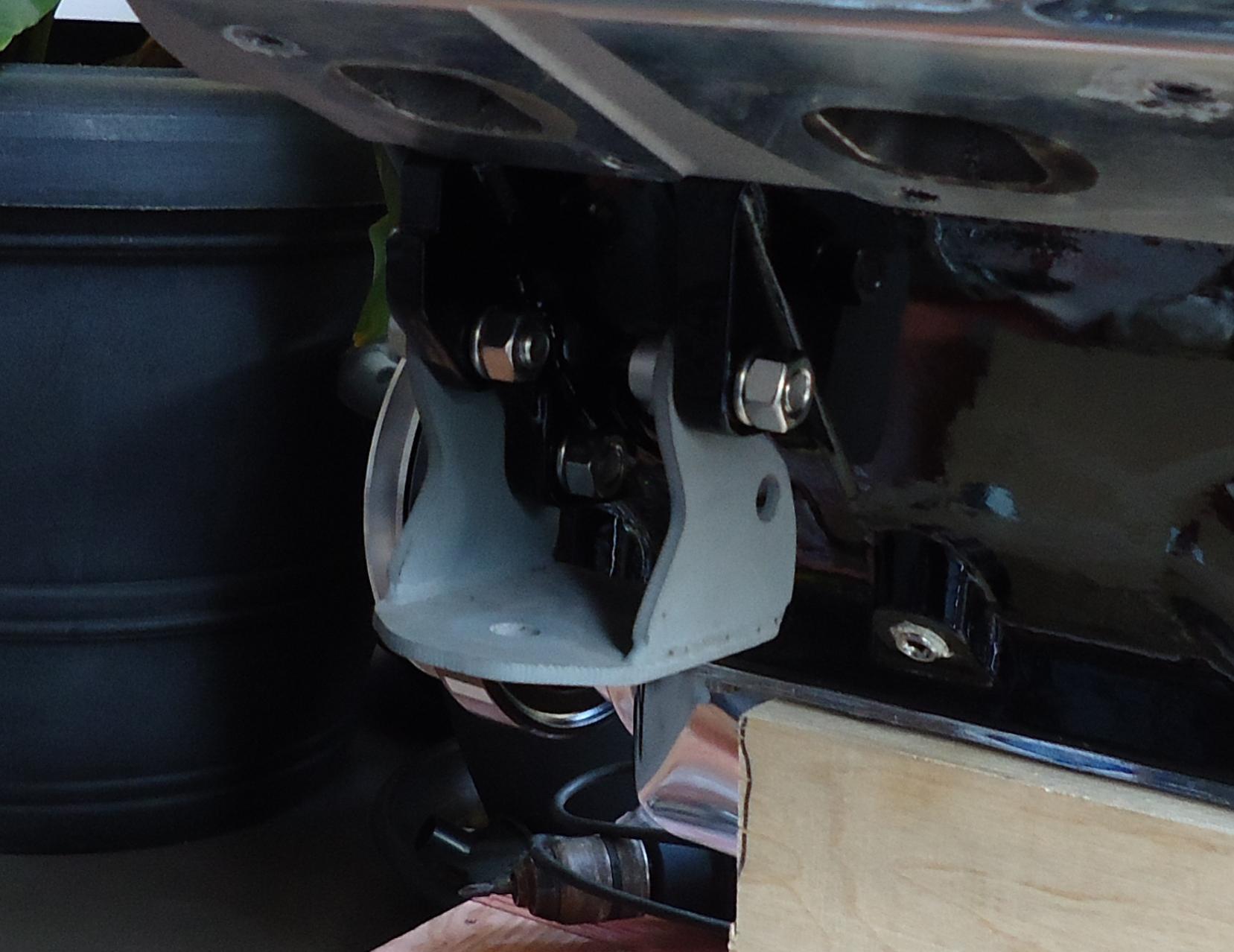

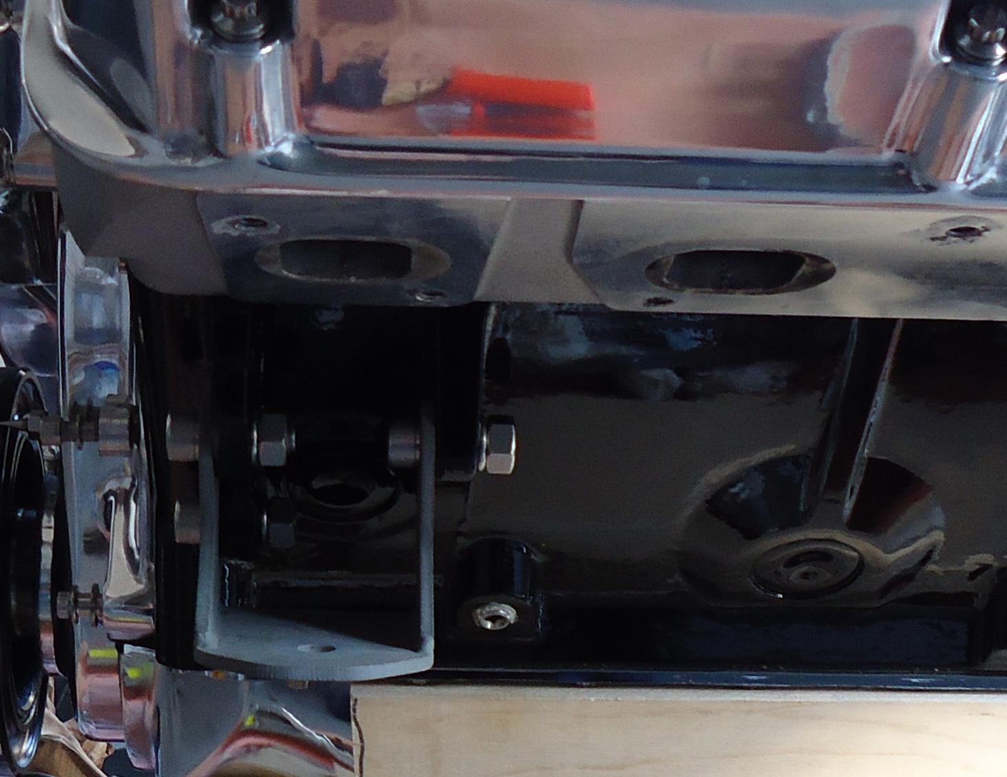

  7. One thing to note on the motor mounts. If you're using 'through bolts' that go through both block tabs (front to back), be very careful about how you tighten them. You may want to use a nyloc nut - so you don't try to tighten them to hold a lock washer. Just snug them up and go a bit more - not too much.
    The best way is to use shorter bolts that only go through one block tab - such that you have bolts on both sides - that can be tightened. The reason is that it is very easy to put one long through-bolt, tighten it up and break the ears/tabs off the block. Many an early Hemi block has been screwed up by this . . . just wanted you to know if you were at this stage!

    Thank you Bored&Stroked for the advice. I got the engine mounts and bolts through Hot Heads, and yes, they supplied separate bolts instead of long ones. These guys have been there before.

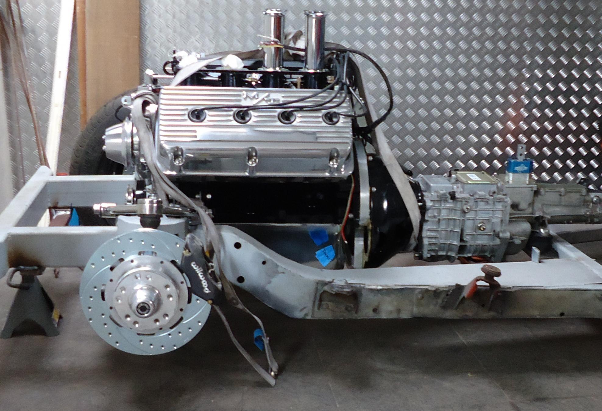

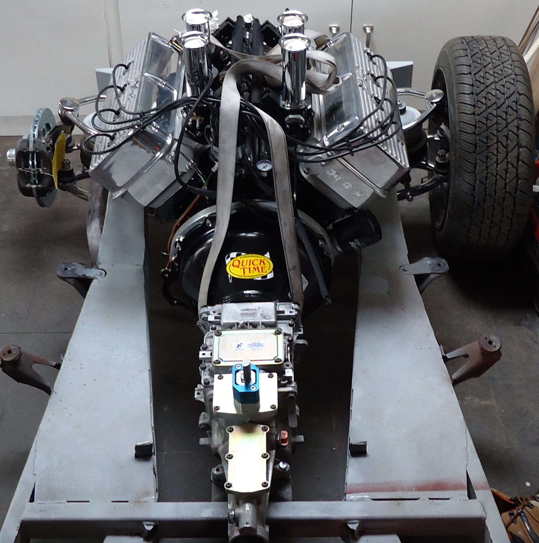

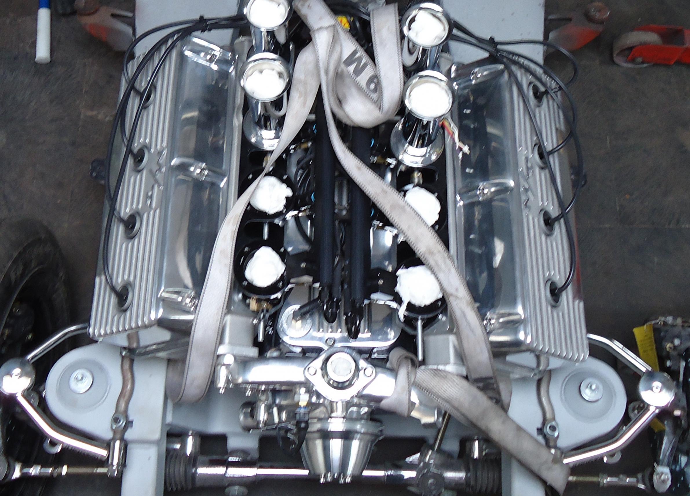

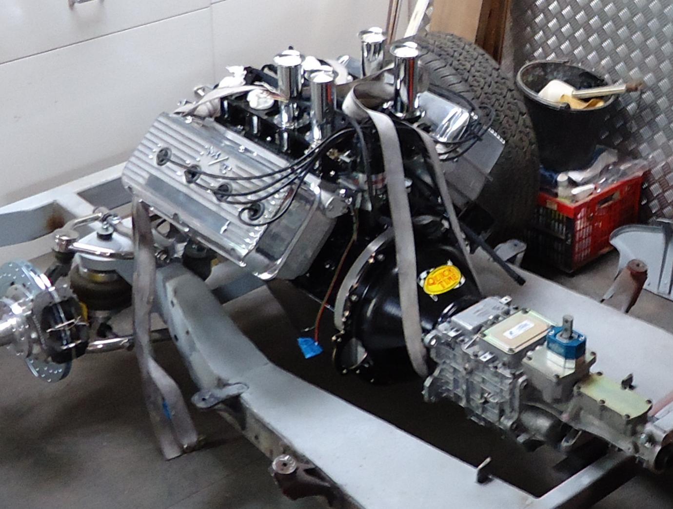

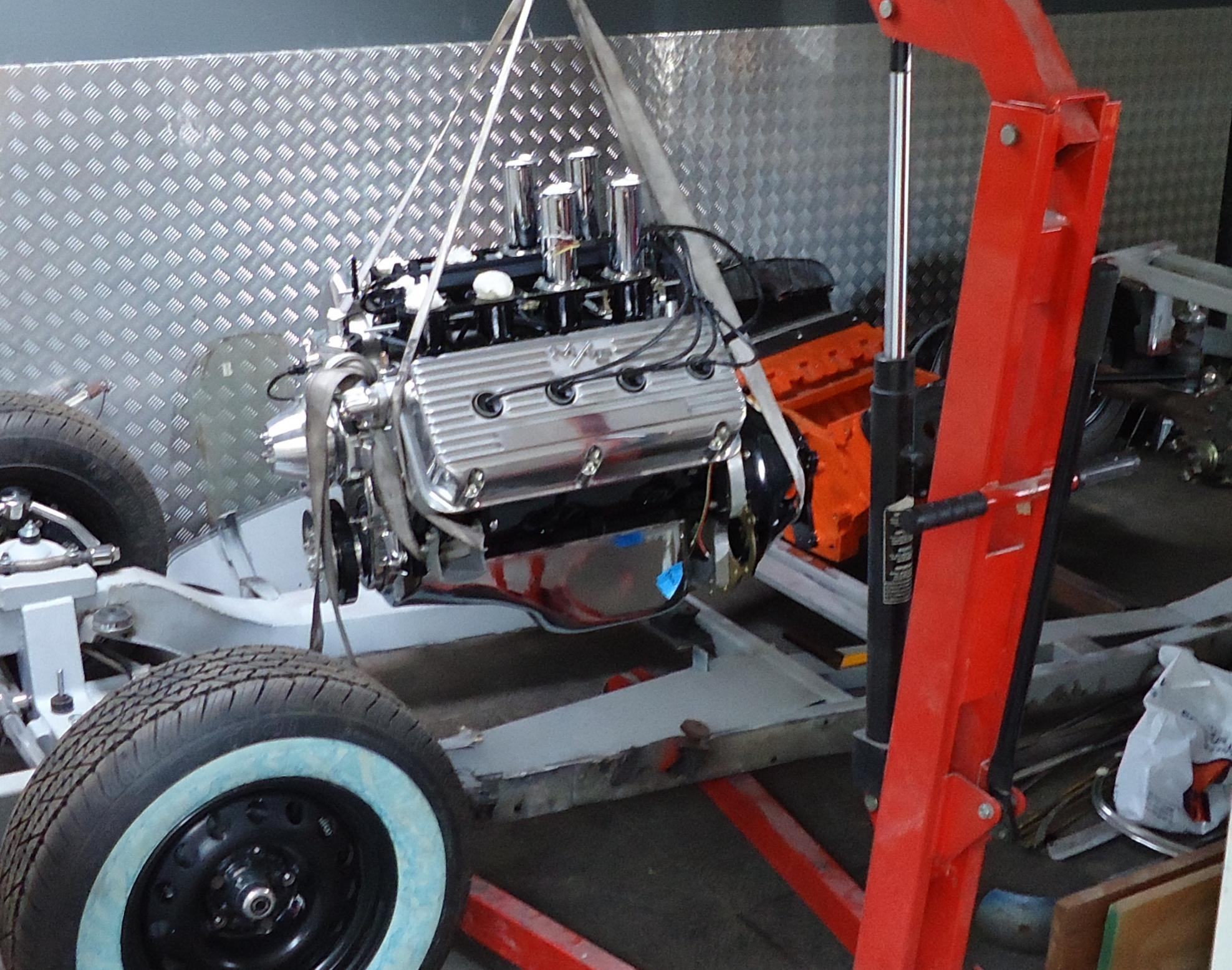

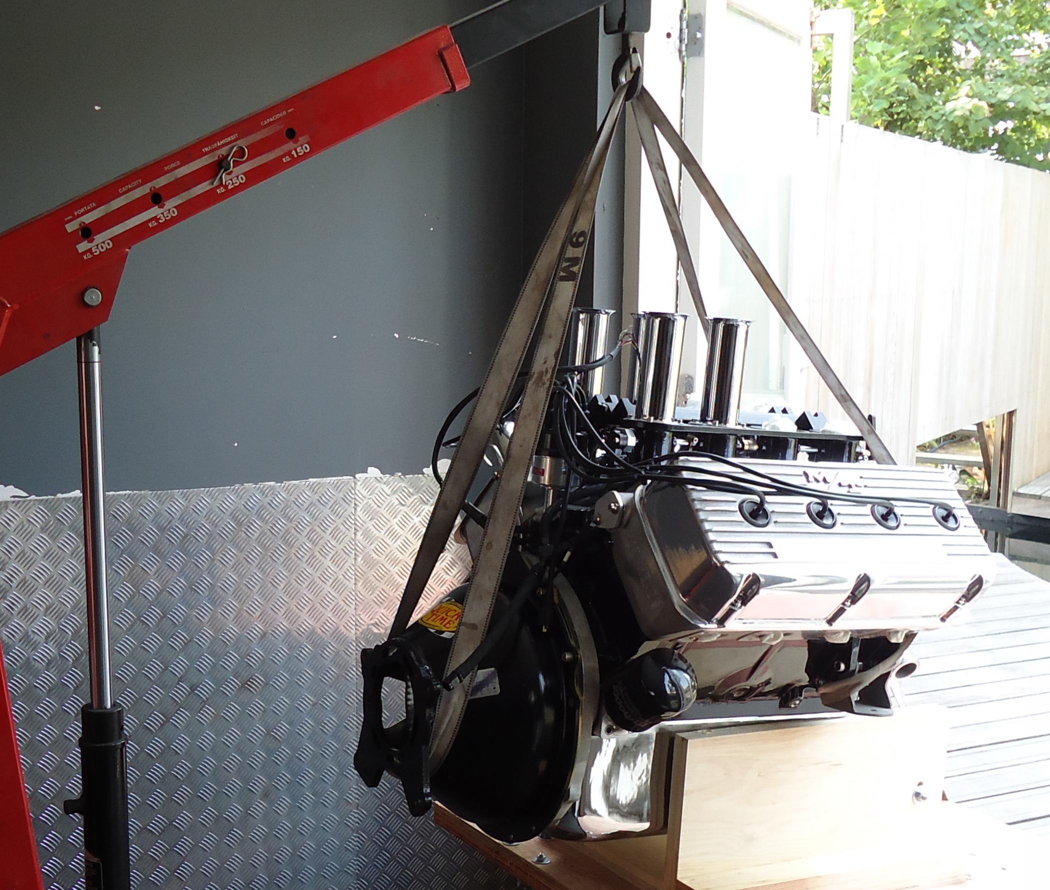

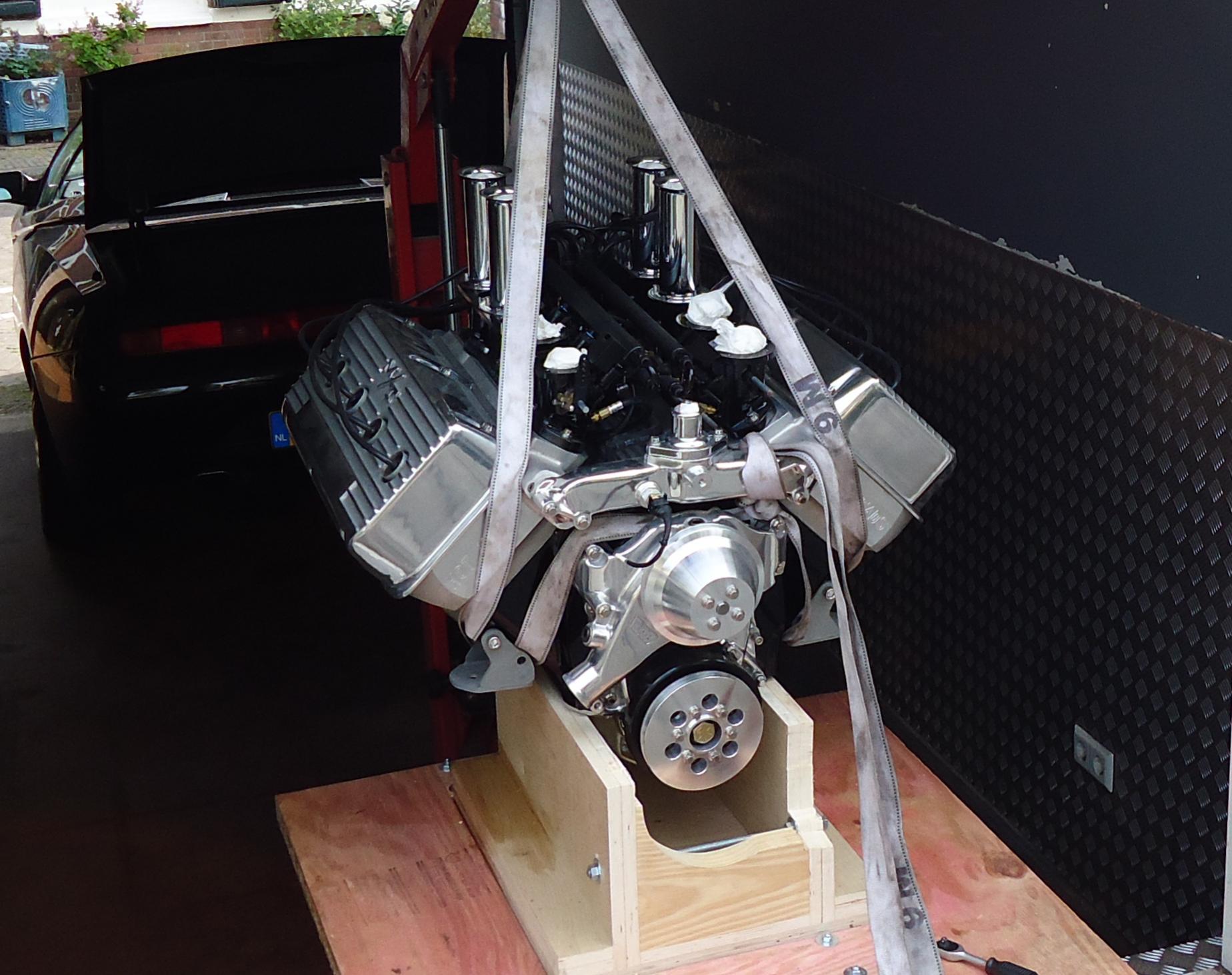

    Well today is the big day! Going to move the Hemi from inside of the house into the ch***is. I've must have measured a million times when installing the engine and gearbox mounts, it just has to fit. My brother in law Han came over early this morning to give me a hand.
    There is a 2 foot drop into my garage when coming through the garden, so we fiddled around with some wooden supports and got it inside. Removed 4 of the chrome intakes and took off the gearbox to prevent it from swinging. Then moved the crane to above the ch***is......looks like I'll have to remove the front wheel to get it in the right position.
  12. The suspense is KILLING me!...:D
  13. And what a day you choose Eric, Holland is the warmest place in Europe at the moment and you are struggling with 800 lbs.
    Good luck and keep us updated.:)
  14. farmer12
    Joined: Aug 28, 2006
    Posts: 7,723
    farmer12
    I know, I know, but this morning I had the mobile crane AND my brother in law to help, so we got started at 08:30 while it was still cool outside. More progress pics soon...
  15. farmer12
    Posts: 7,723
    farmer12

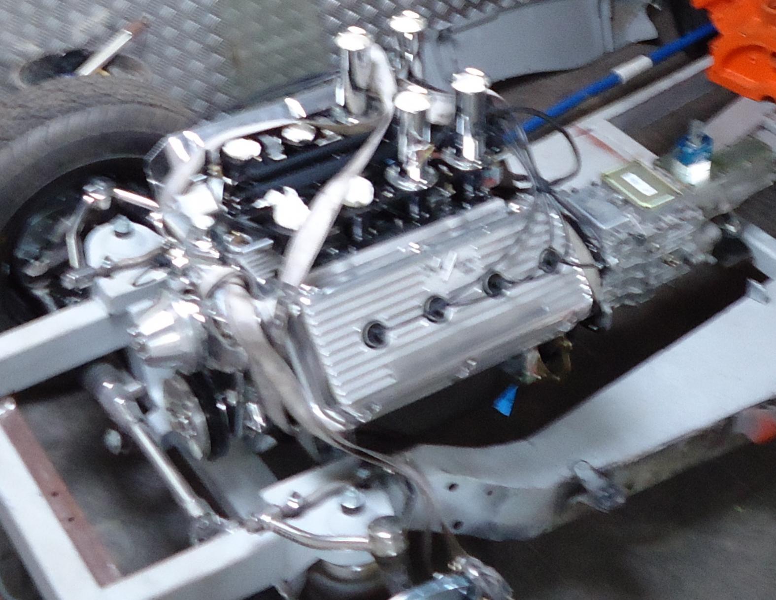

    All right, part two of the installation! Took the left front wheel off to get the mobile crane placed correctly. Lowered it all down carefully, lining up the engine and gearbox mounts. Without any force, got all the bolts exactly in place. YES! A perfect fit within a millimeter tolerance. Am I glad I spent countless hours measuring and measuring. This has made it all worth it and has been a perfect day!:D:D:D
    After taking a few pics, we hoisted the engine/gearbox out of the ch***is again and moved it back into the house. (for insurance purposes) Enjoy the pics!!:D

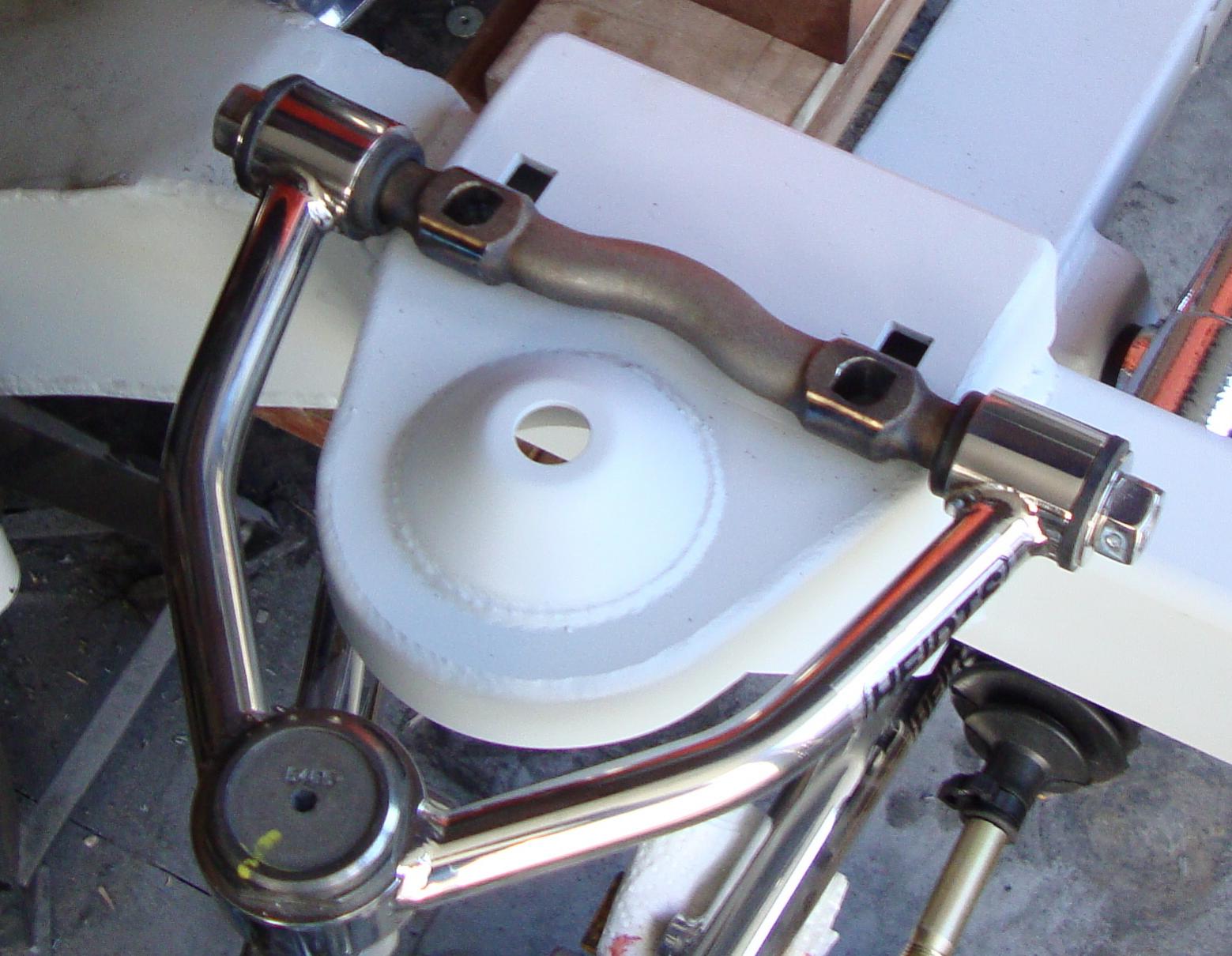

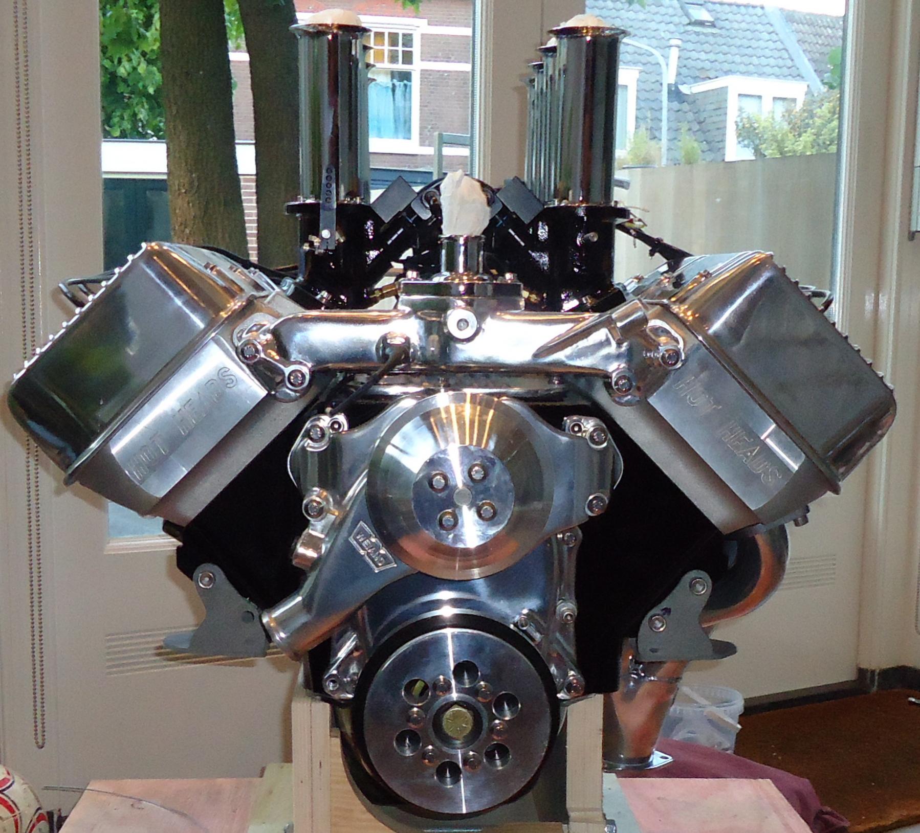

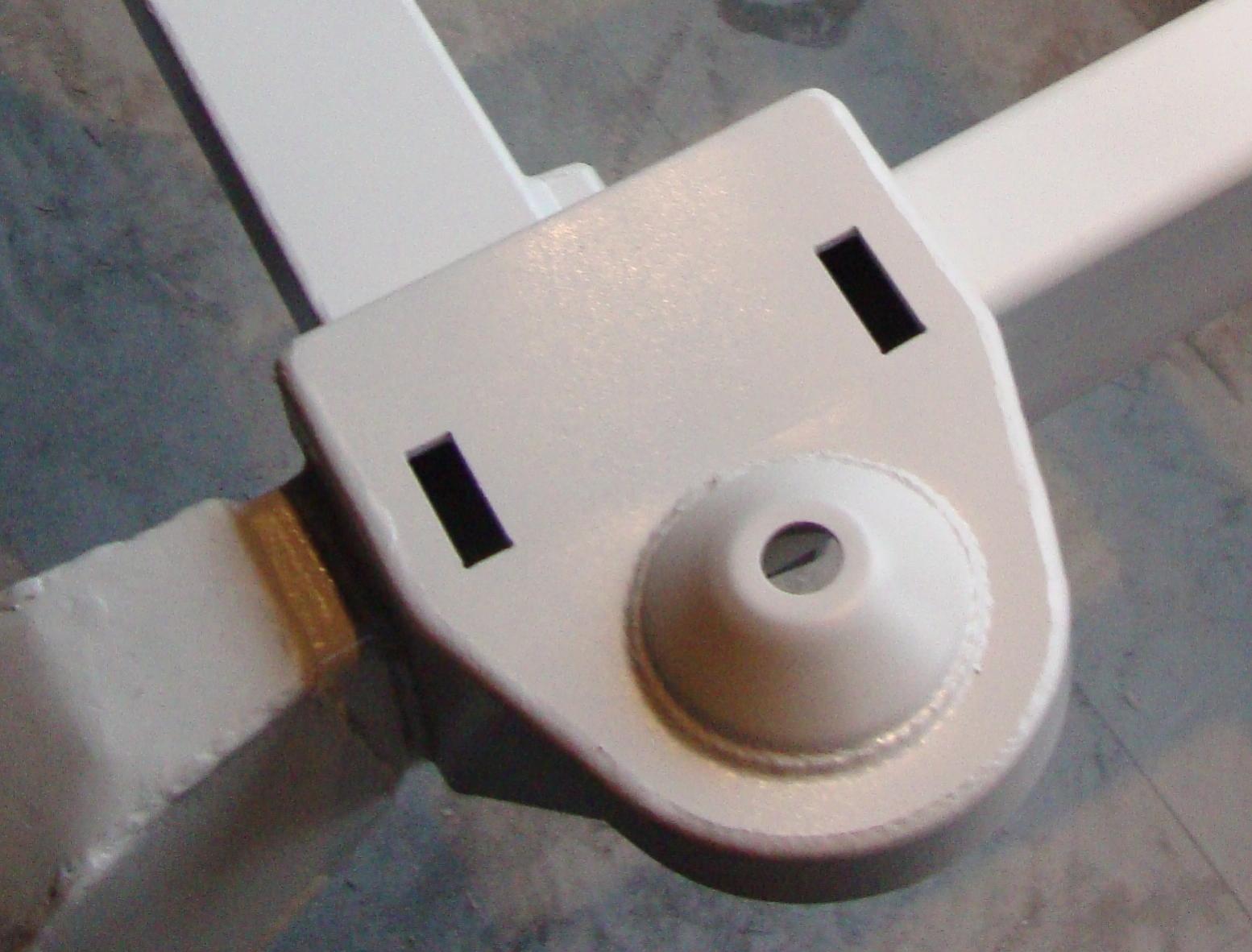

    Congrats on a good fit Eric. I do have a question for you, I was looking at picture four, specifically the upper A-arm of your suspension, and was wondering how you are going to adjust the camber. Is that bracket bolted vertically or are my eyes playing tricks on me?

    Thank you OahuEli! I've dug up some old pics of my build for you. The "top hats" have slots in them where the bolts protrude through. Here you can adjust the camber. Hope this answers the question.

    Cool, I've never seen that setup before. Must have missed the pic from the earlier post, or I'm suffering a case of age induced cranial flatulence. :rolleyes:

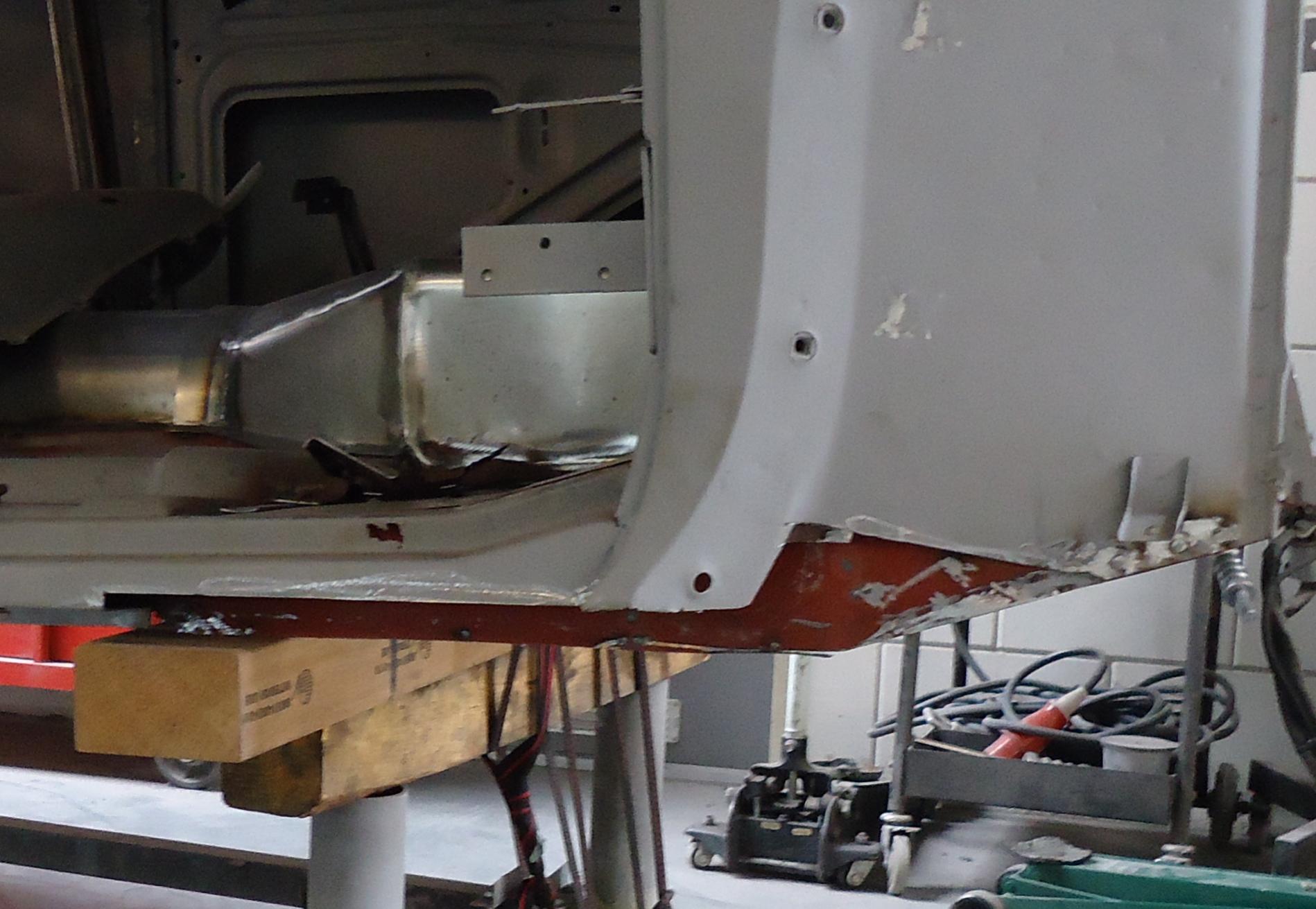

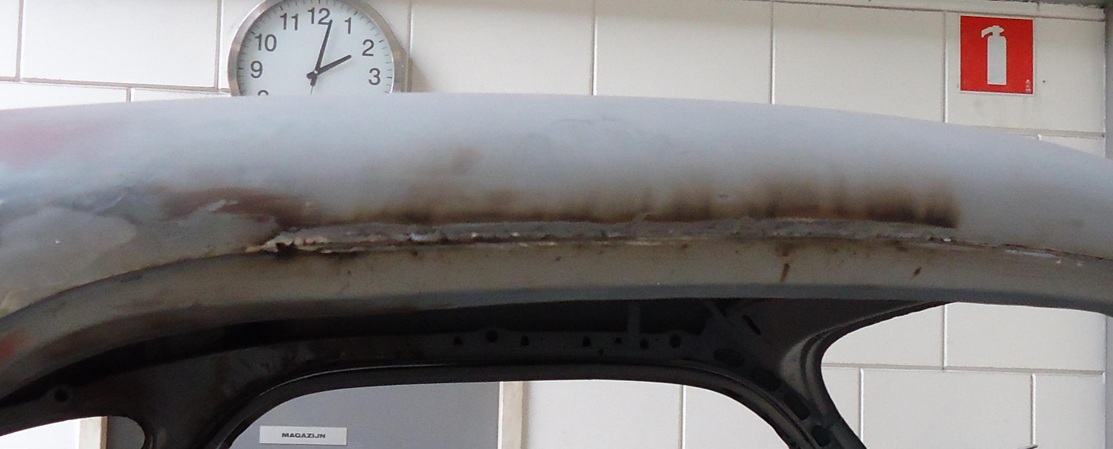

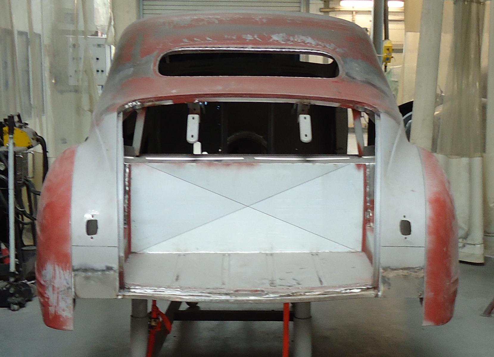

    Didn't have much time today to work on the body, but got the right rear fender mounted. It will need some minor adjusting before I can weld it on.
    My buddy Martin had done a little work as well. Welded up the roof line above the p***enger door and started cutting away a part of the rotten lower cowl. I'm actually thinking of buying this part, together with the rocker panels from the Plymouth doctor. This should save me a lot of time........still thinking what is wise.
