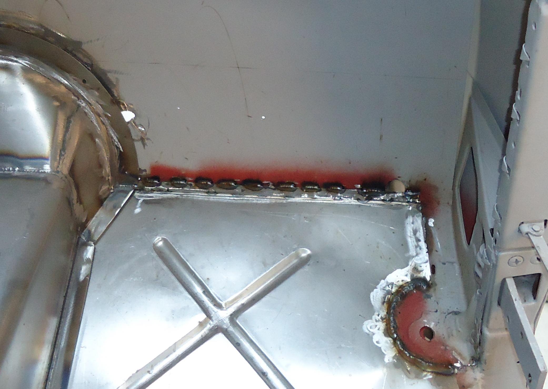

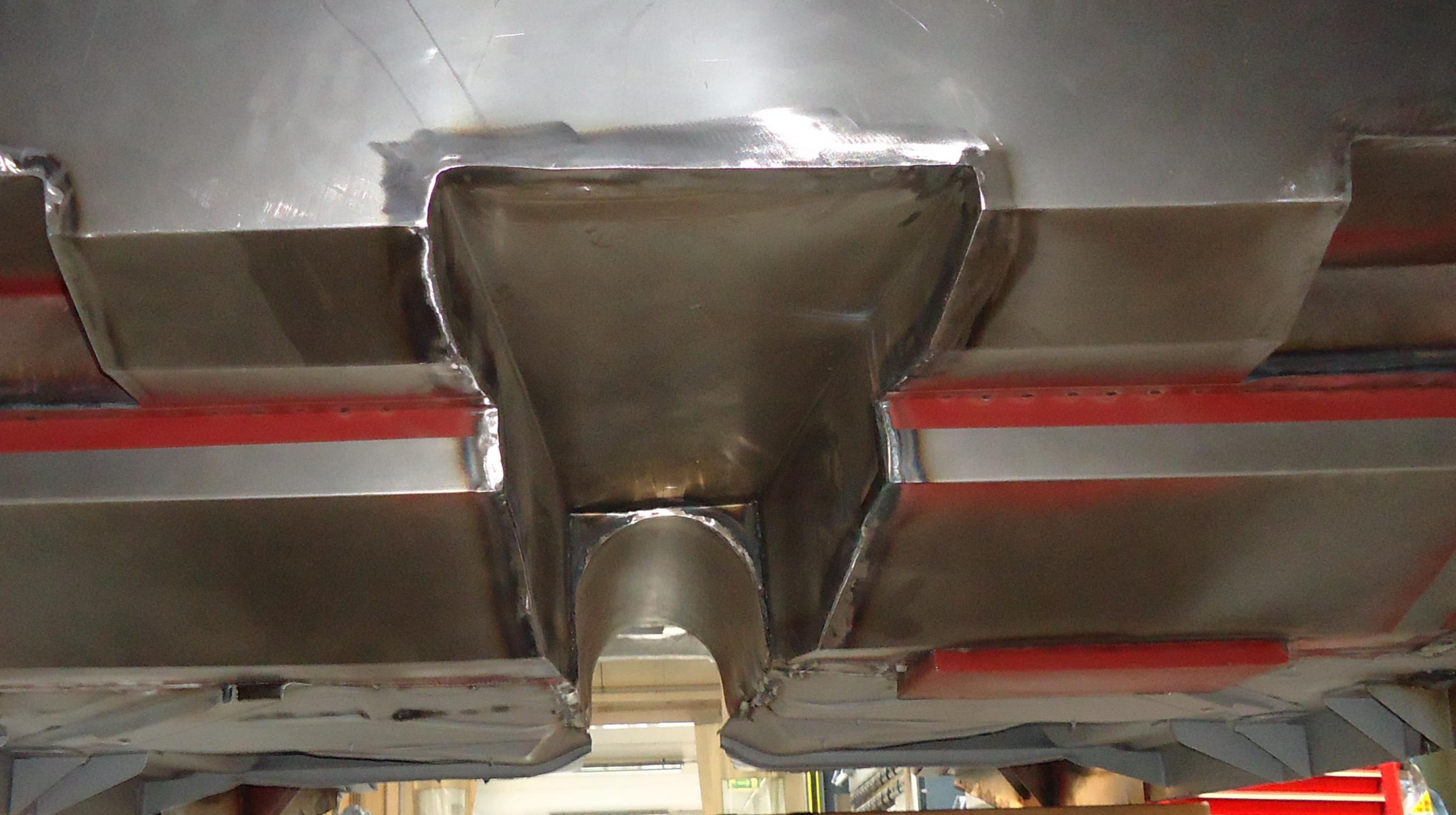

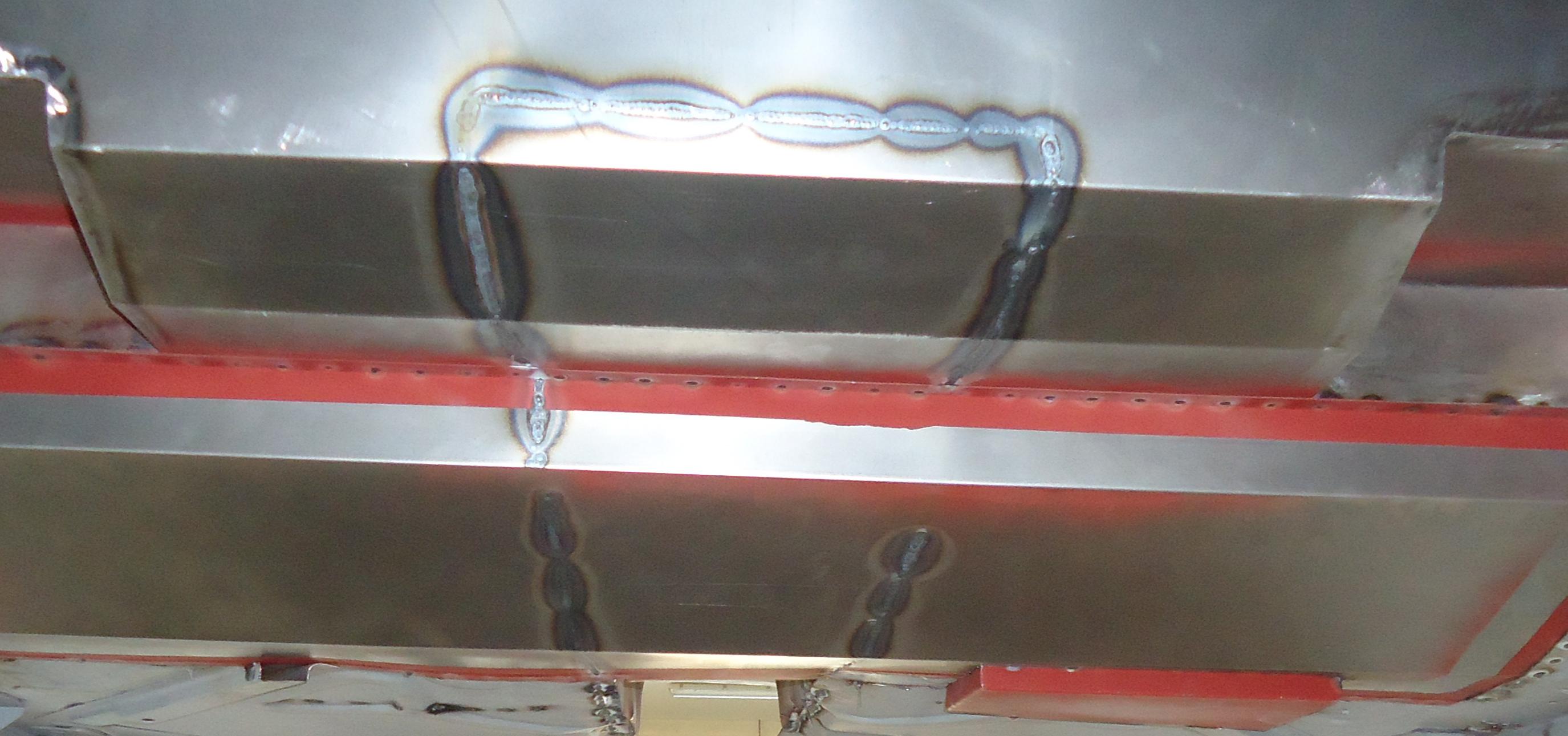

    Got busy on the underneath of the car. There still was some metal to cut out where the tunnel will be. Did some final welding and ground it all smooth. For some reason my photography skills aren't the best today, they're all slightly angled. But you get the idea.

    Spent the rest of the afternoon welding. Both foot wells are done and I gone through most of the tunnel area again, just to strengthen it as a whole even futher.

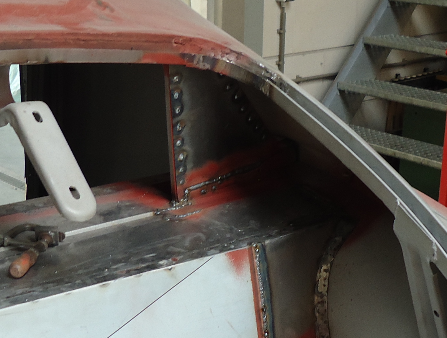

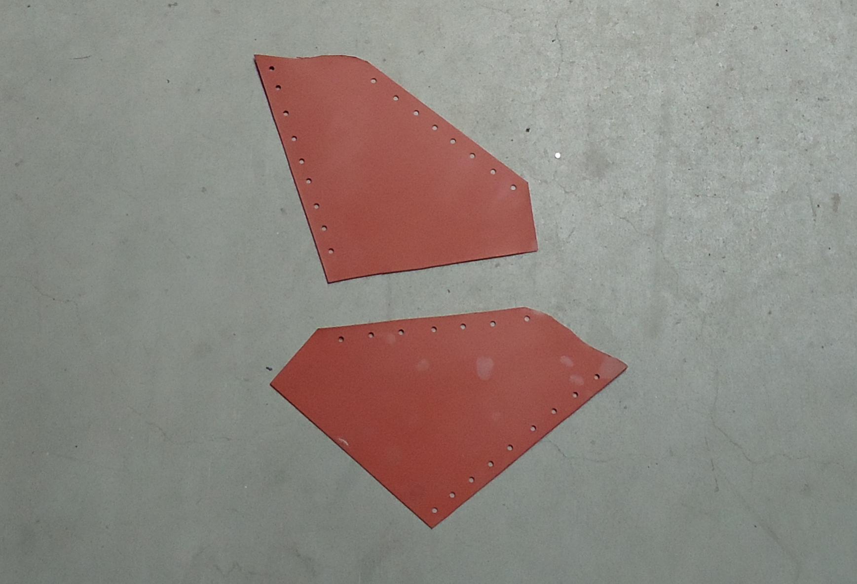

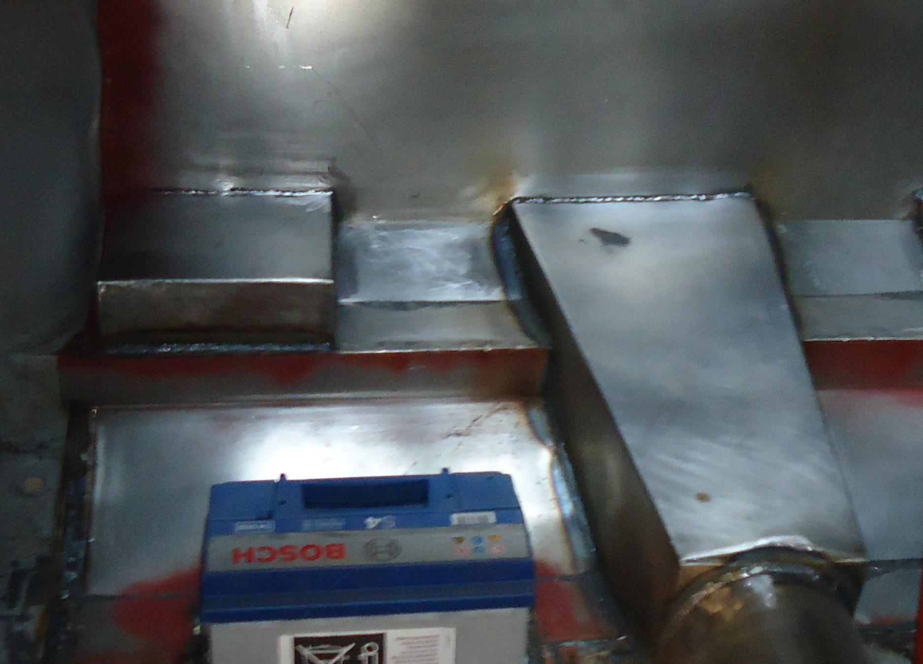

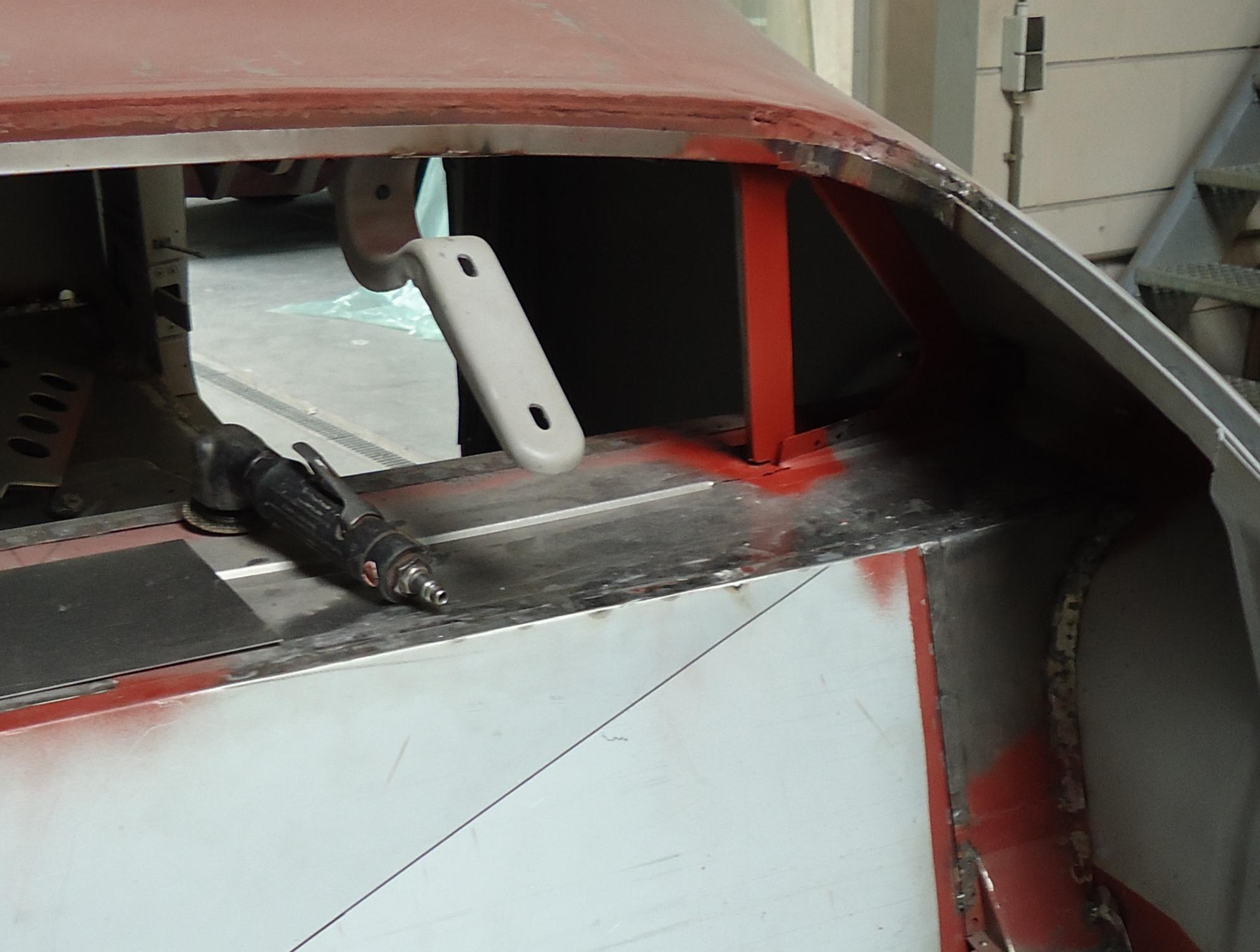

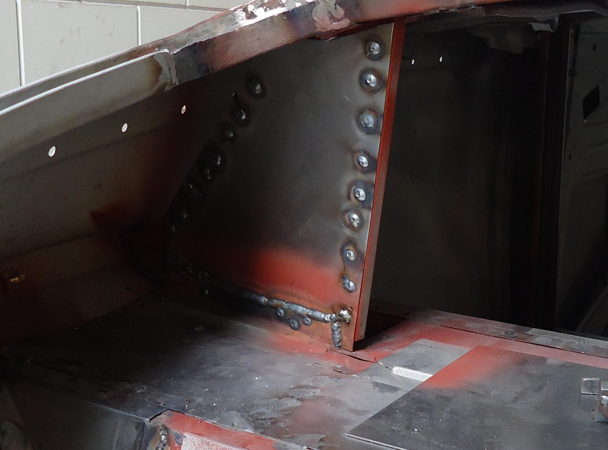

    Considering I want to make the body as solid and integrated as possible, I fabricated some pieces to strengthen the triangular bars located between the top of the body and the c-notch. The sheet metal I had previously made on top of the c-notch was still loose and this gave me a good opportunity to weld it all together.

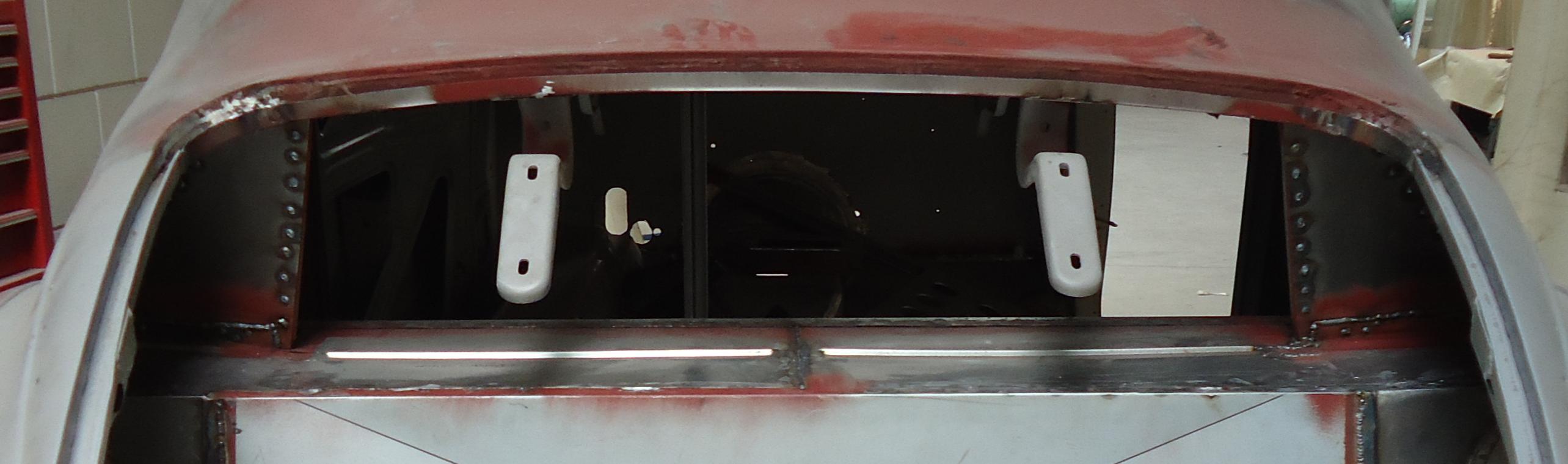

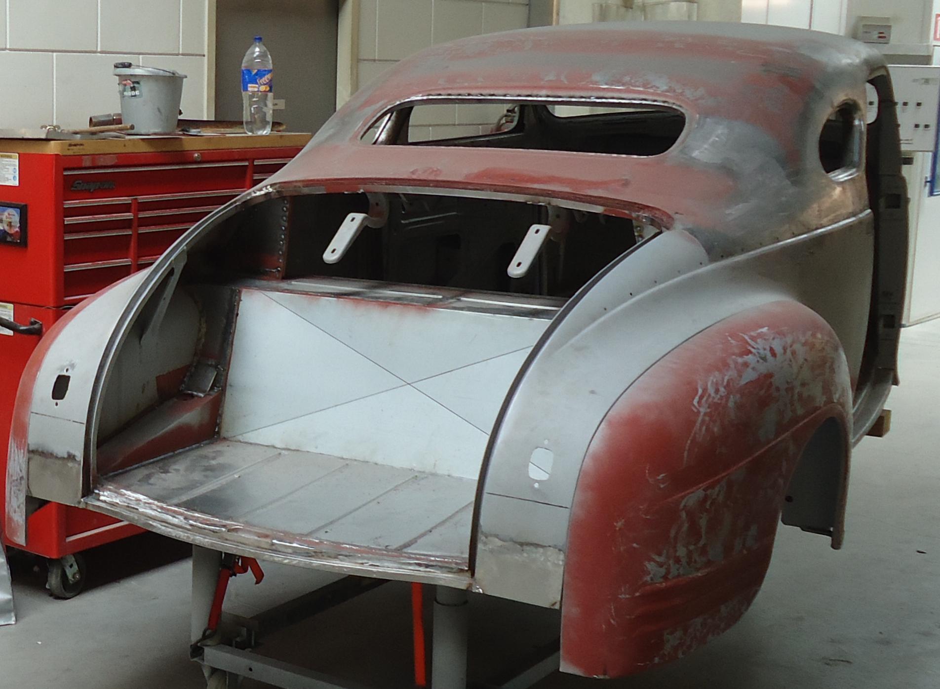

    Finished off the left hand side as well. Also did a lot of welding in the trunk area. I hope to finish all the welding and grinding in the trunk next time I have a chance to work on the body, which will be late next week.

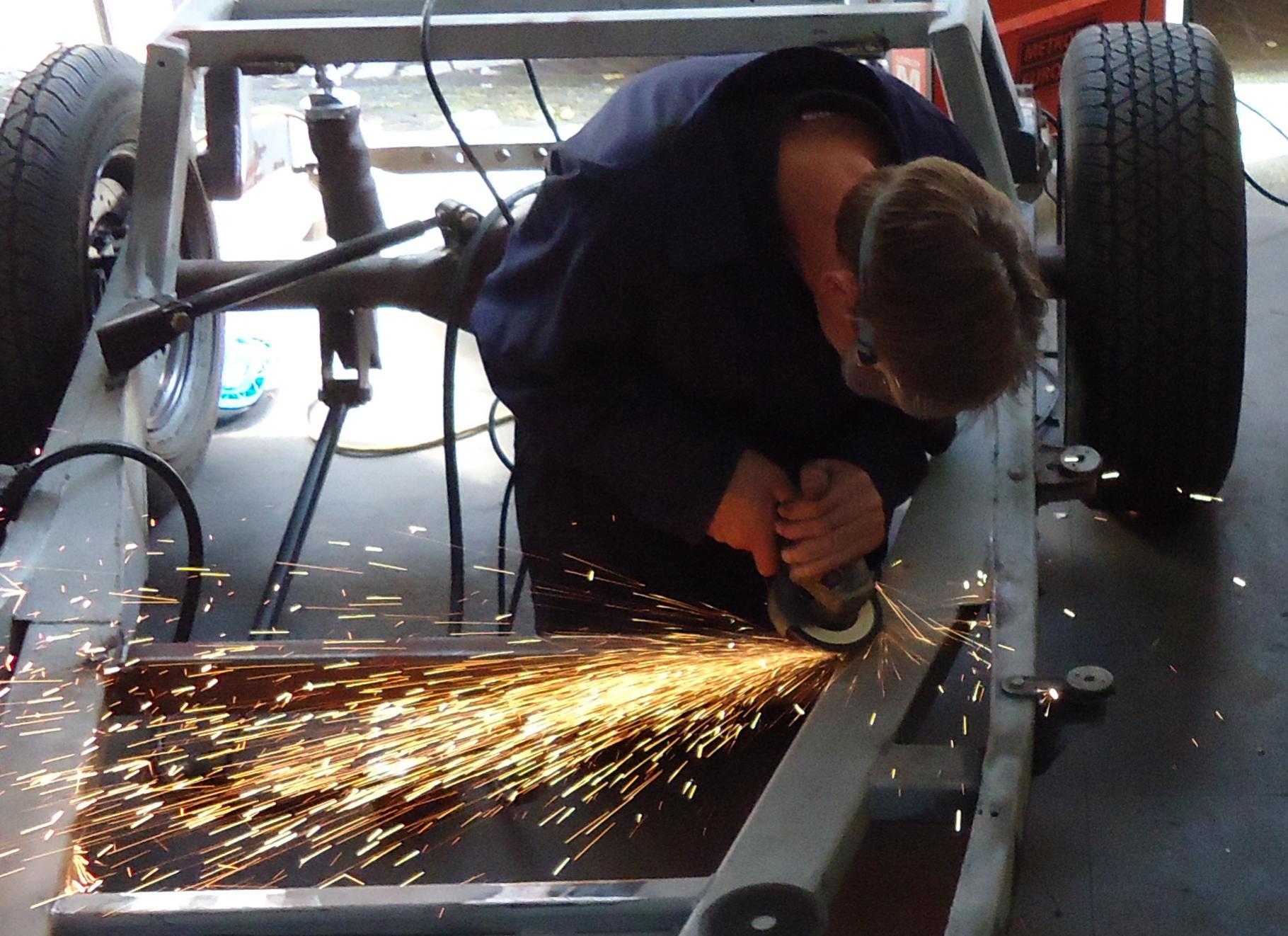

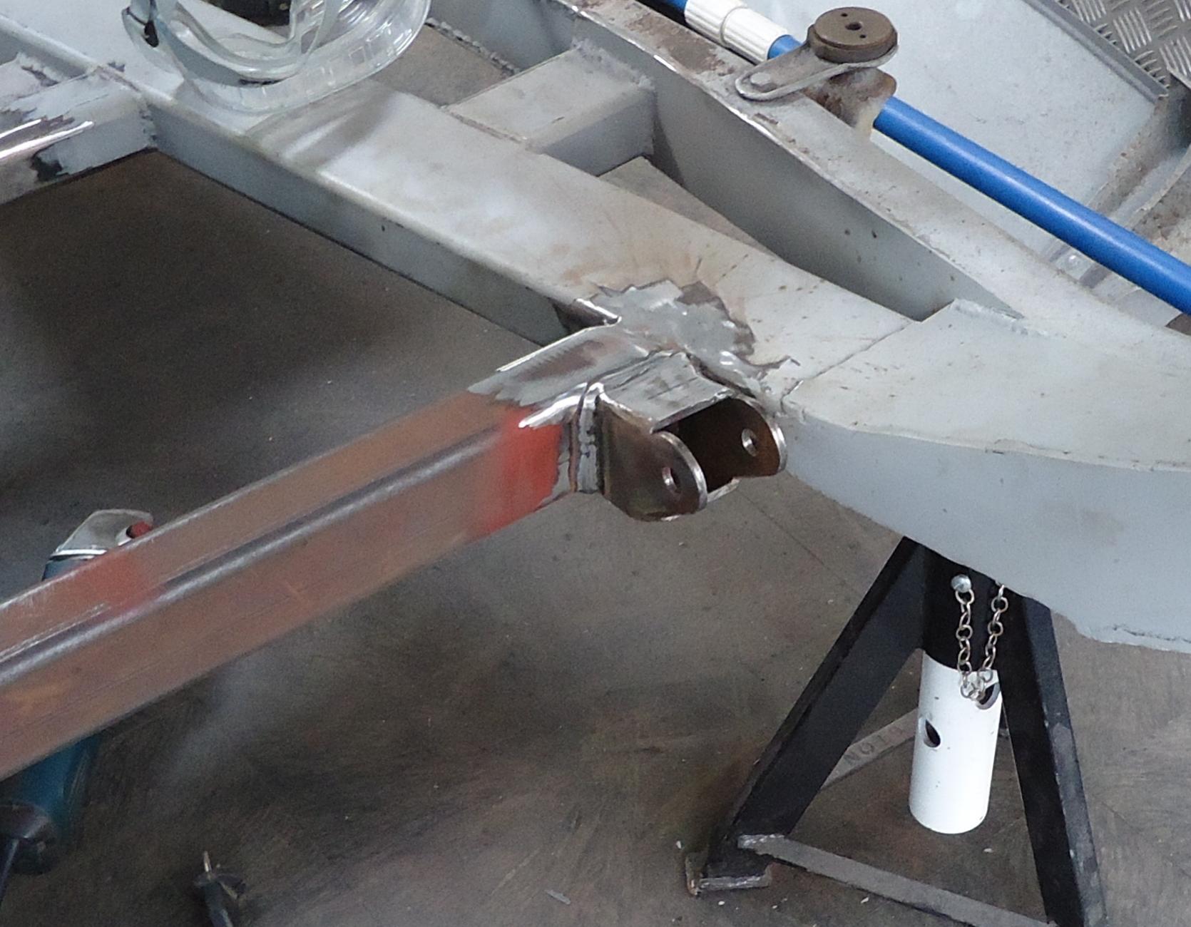

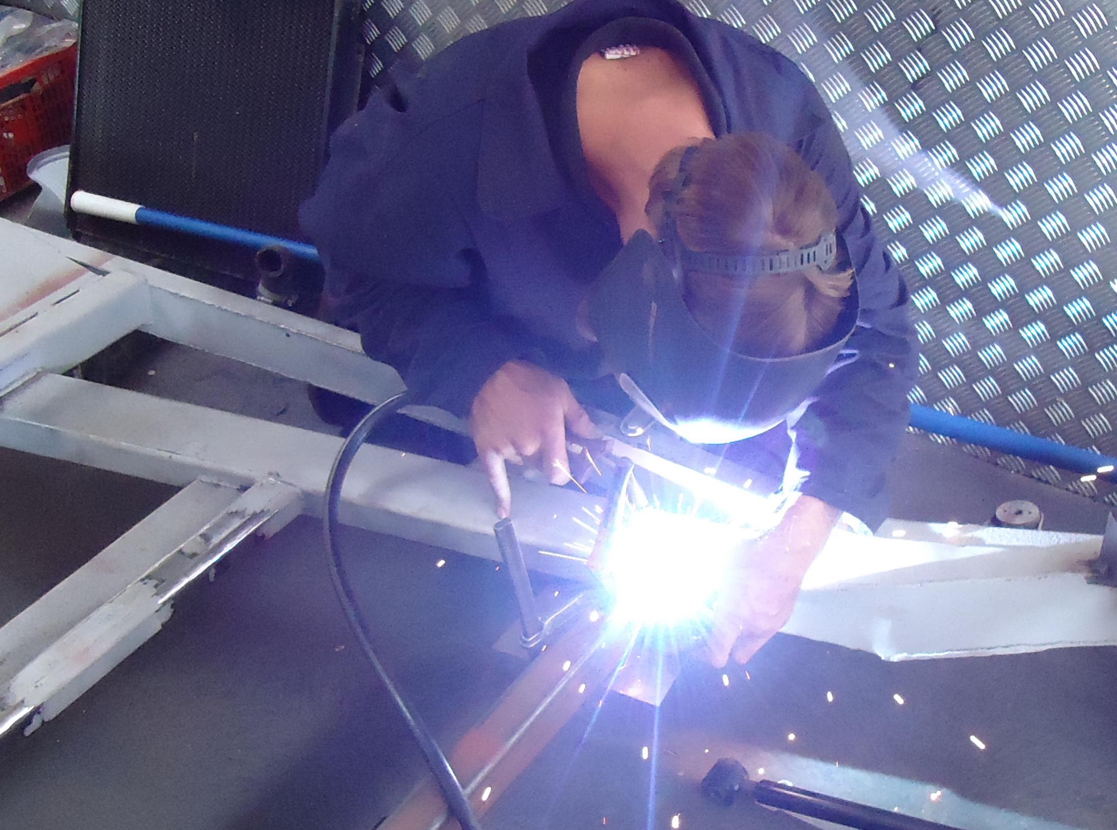

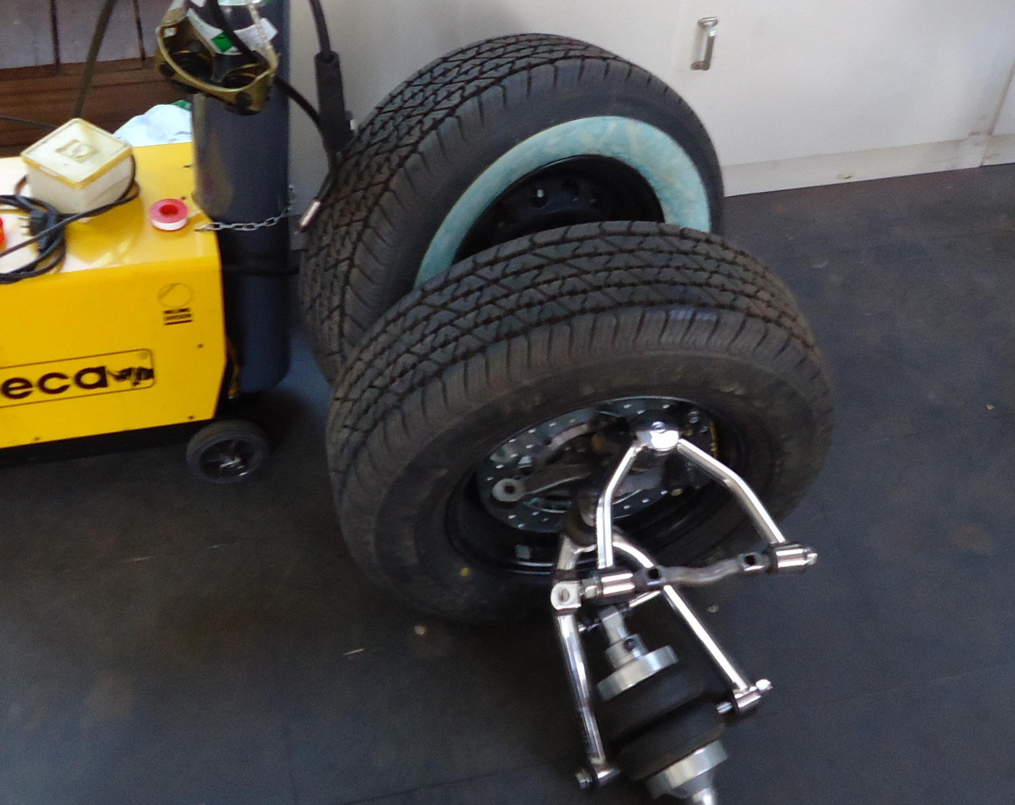

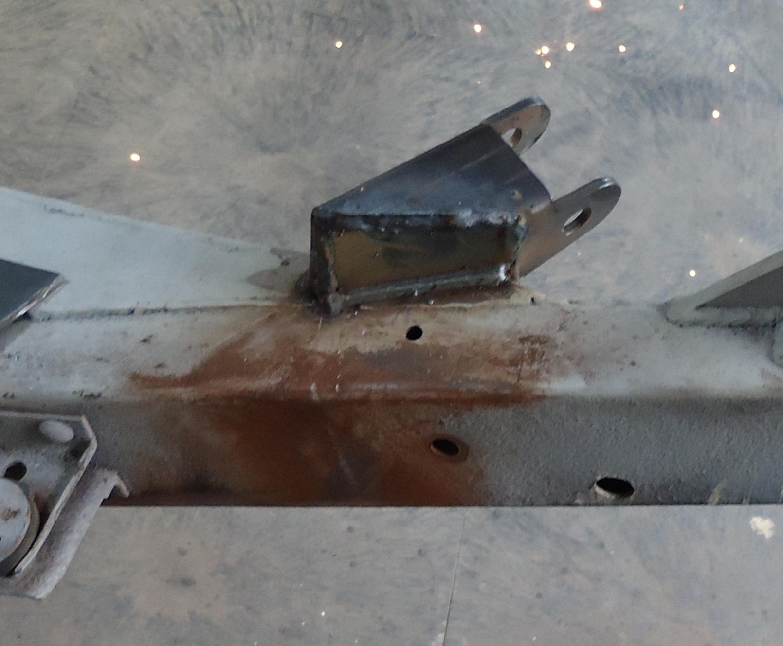

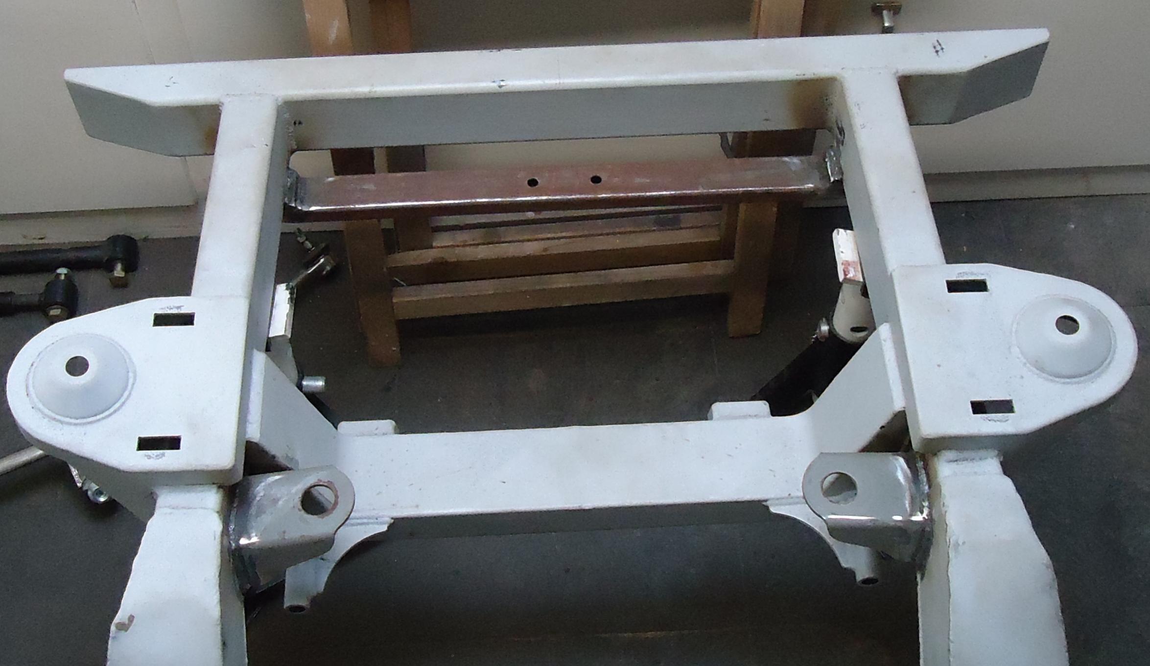

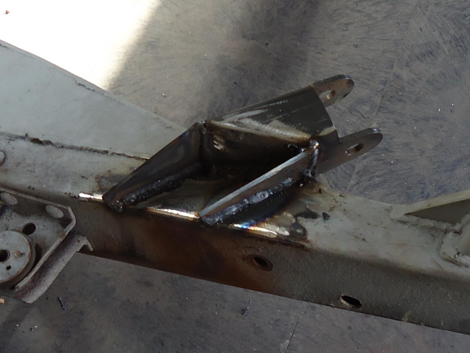

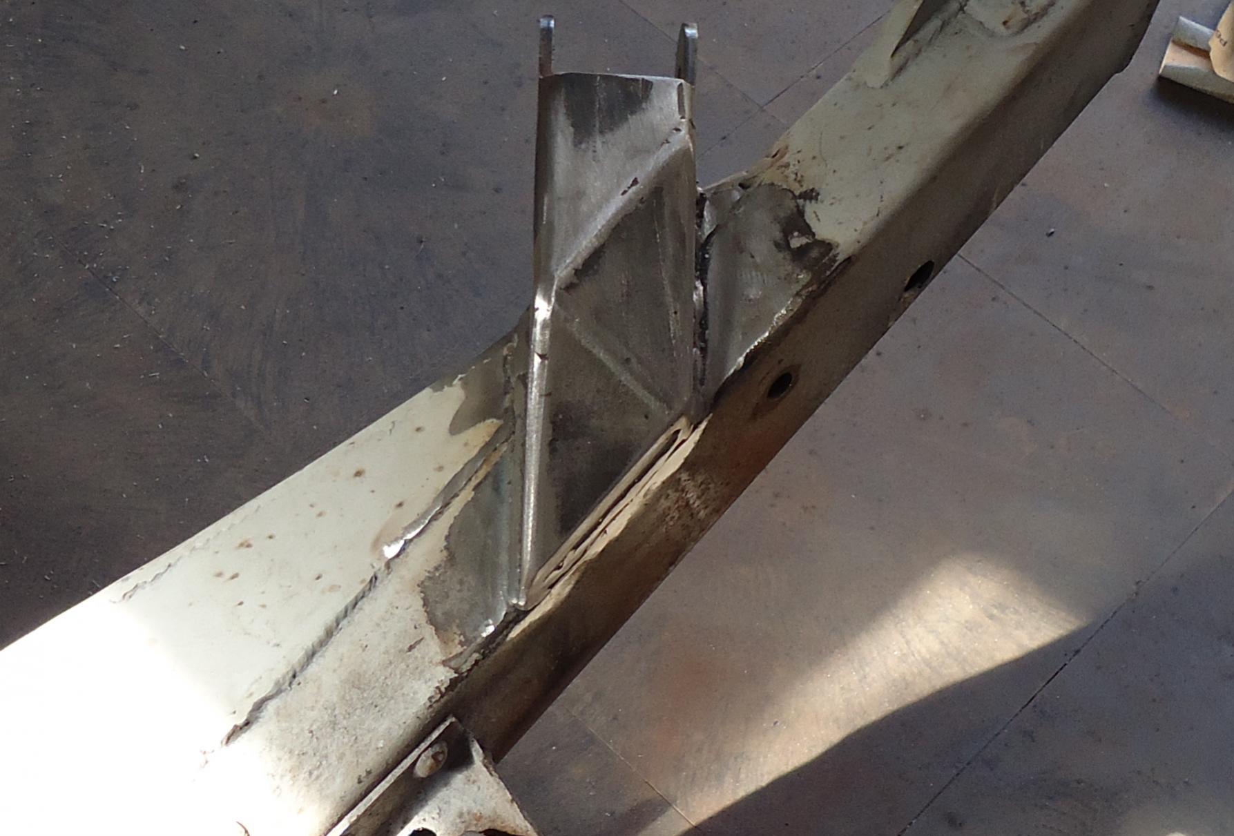

    Got up early in order to get maximum time in the garage. First I took all the front suspension off, then my buddy Jaap came over for some serious welding. We've re-designed the lower brackets of the four link so we could invert them while still being able to drop bar for adjustments. The new position will also give me better ground clearance as they were too low initially.

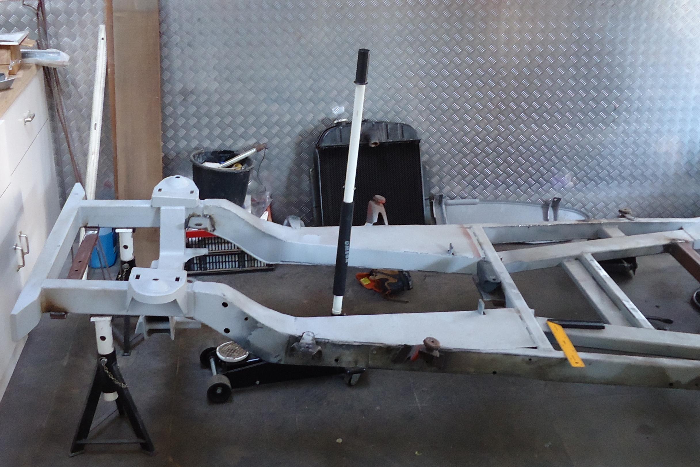

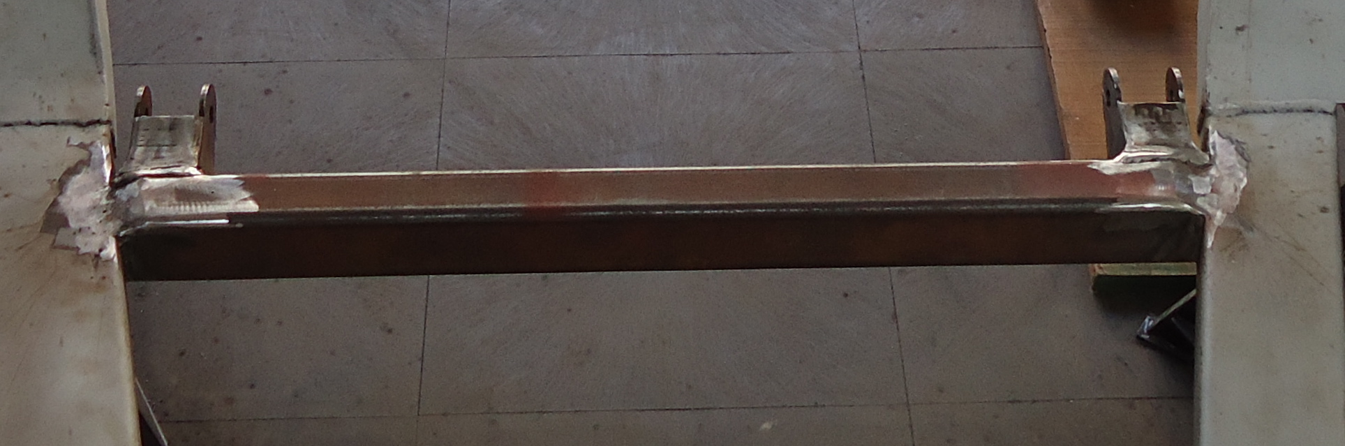

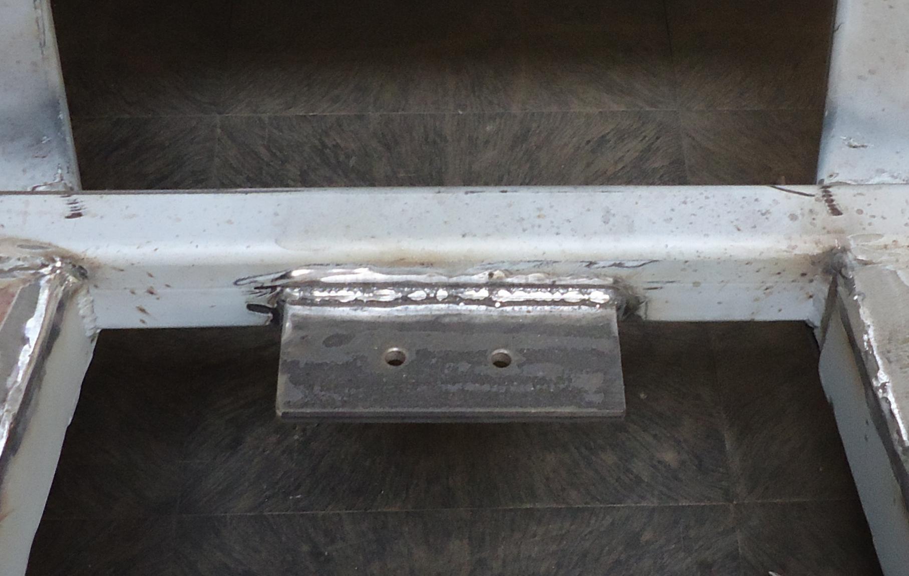

    Next on the list was to finish welding off the engine mounts, transmission mount and the radiator support.

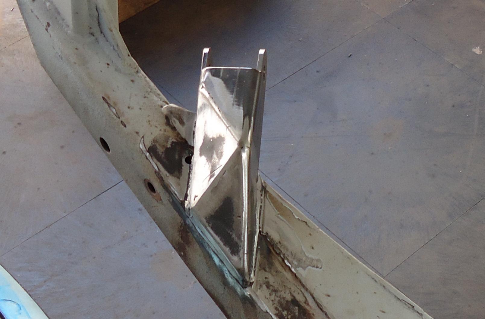

  29. farmer12
    Joined: Aug 28, 2006
    Posts: 7,723
    farmer12

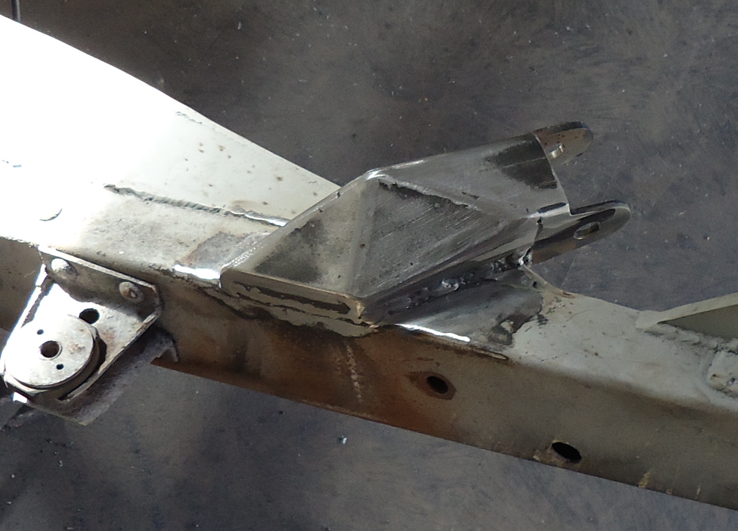

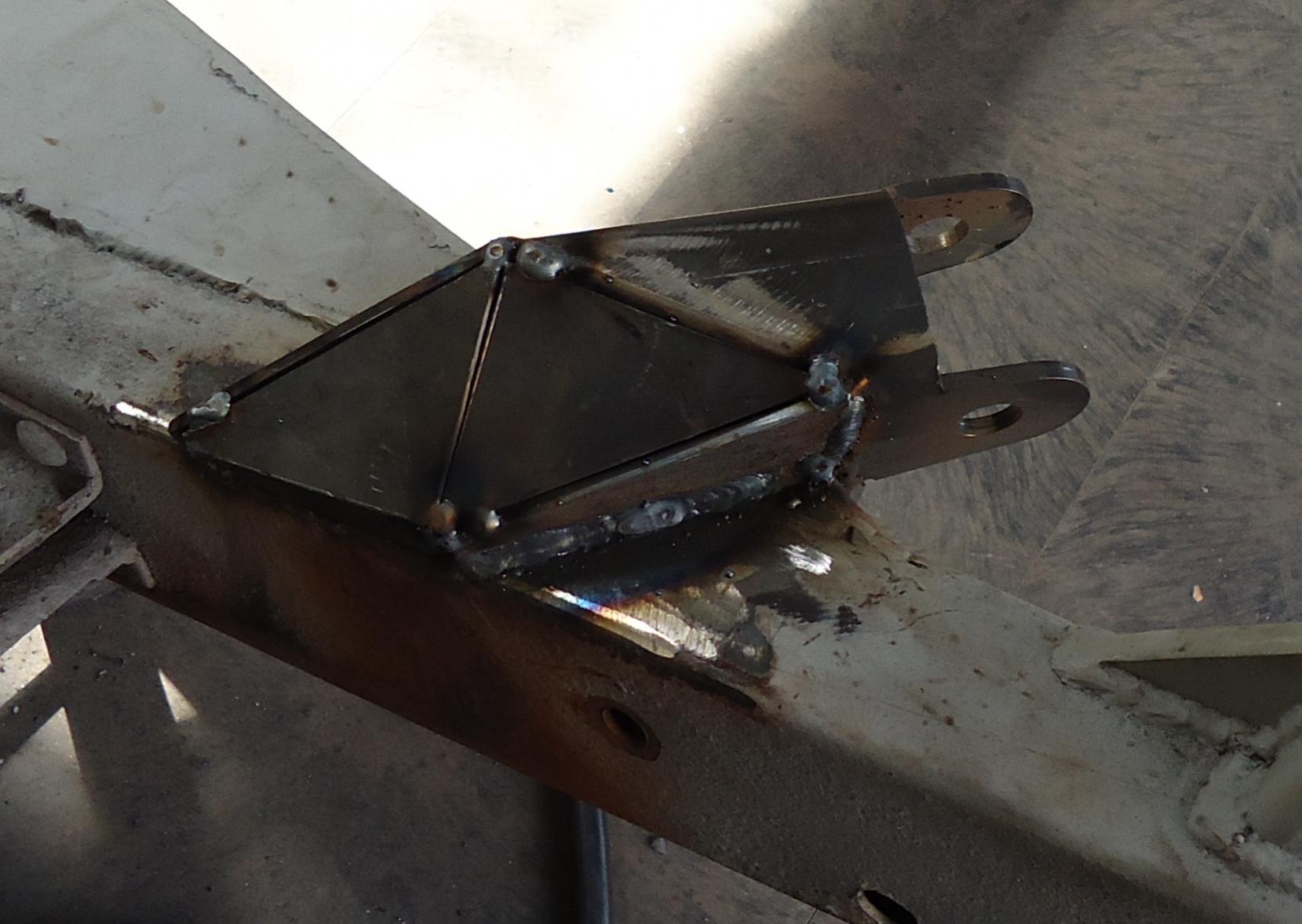

    We've just finished up the upper supports for the triangulated 4 link. They had been tacked into place for mock up purposes. Jaap and I spent about 20 minutes figuring out the best way to box it in conjunction with a sloping frame. In order to get maximum support and strength, we decided that longitudinal bracing would be the best way to handle the forces the rear end will give. Then we cut some metal and made triangulated roofs for both sides. The pictures don't do the artwork any justice.....
