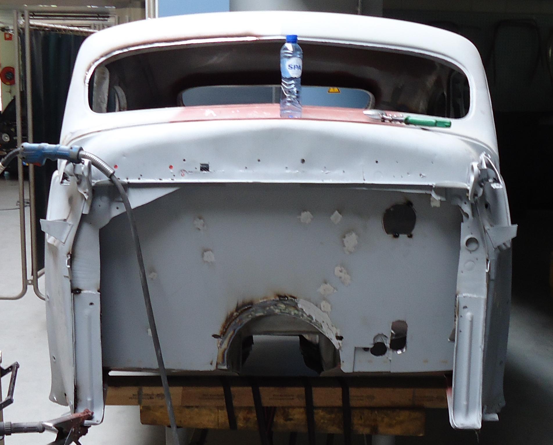

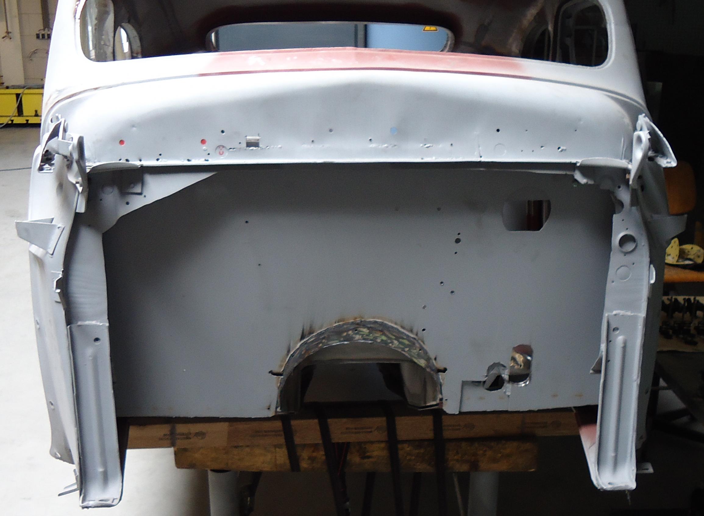

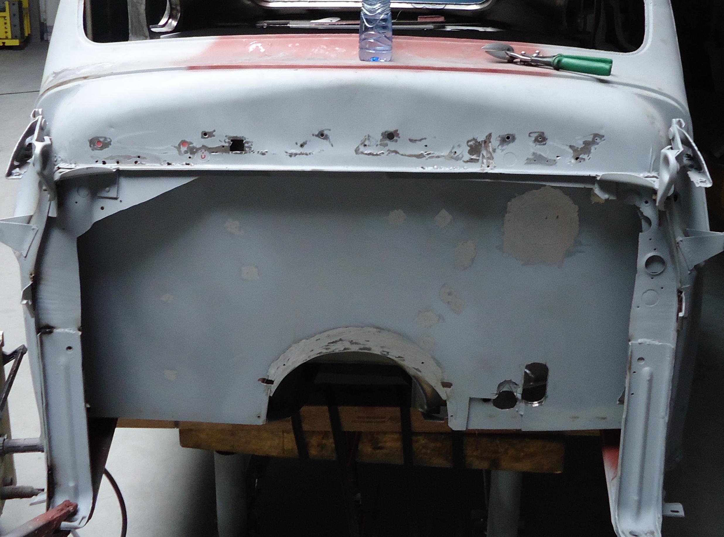

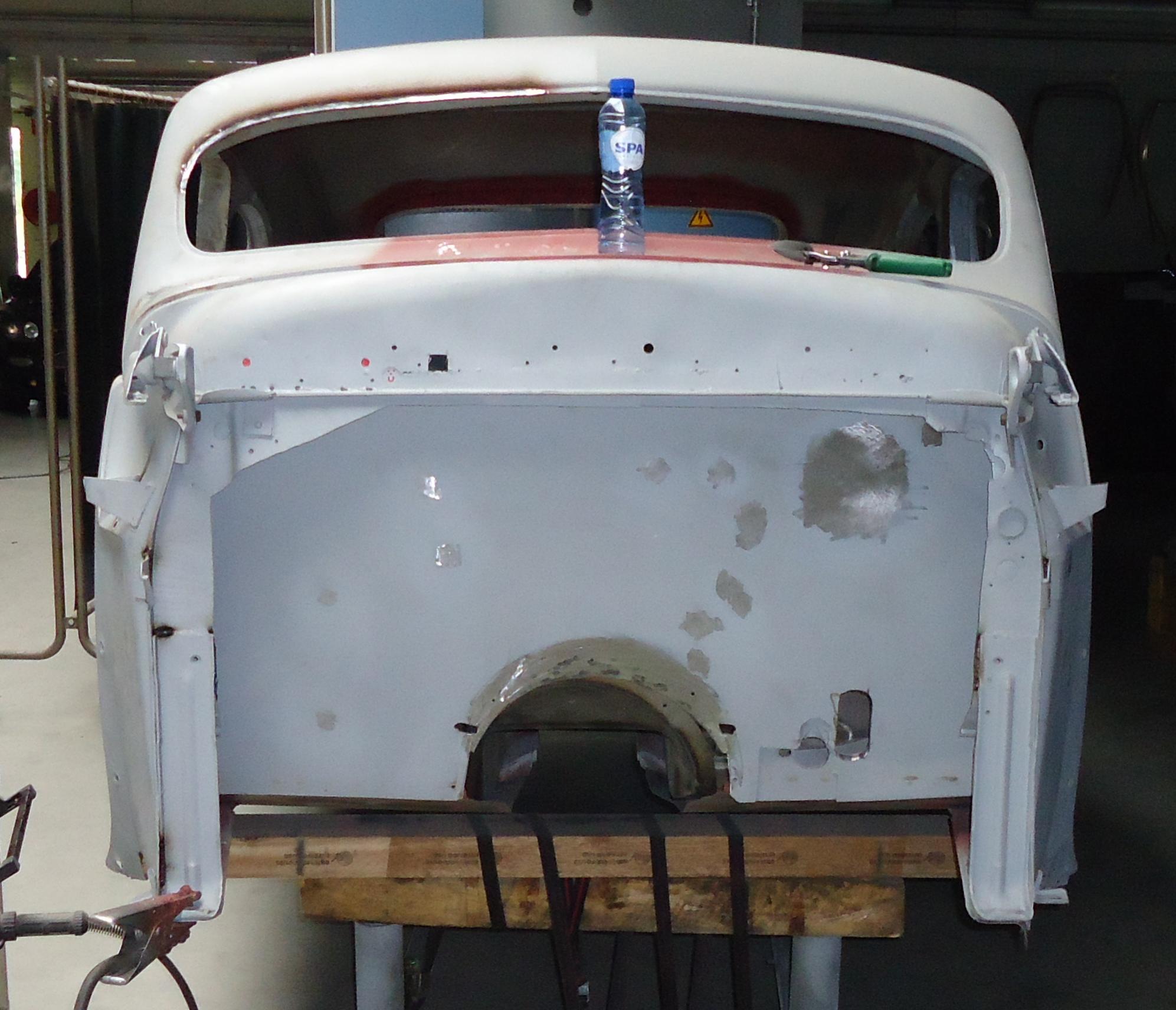

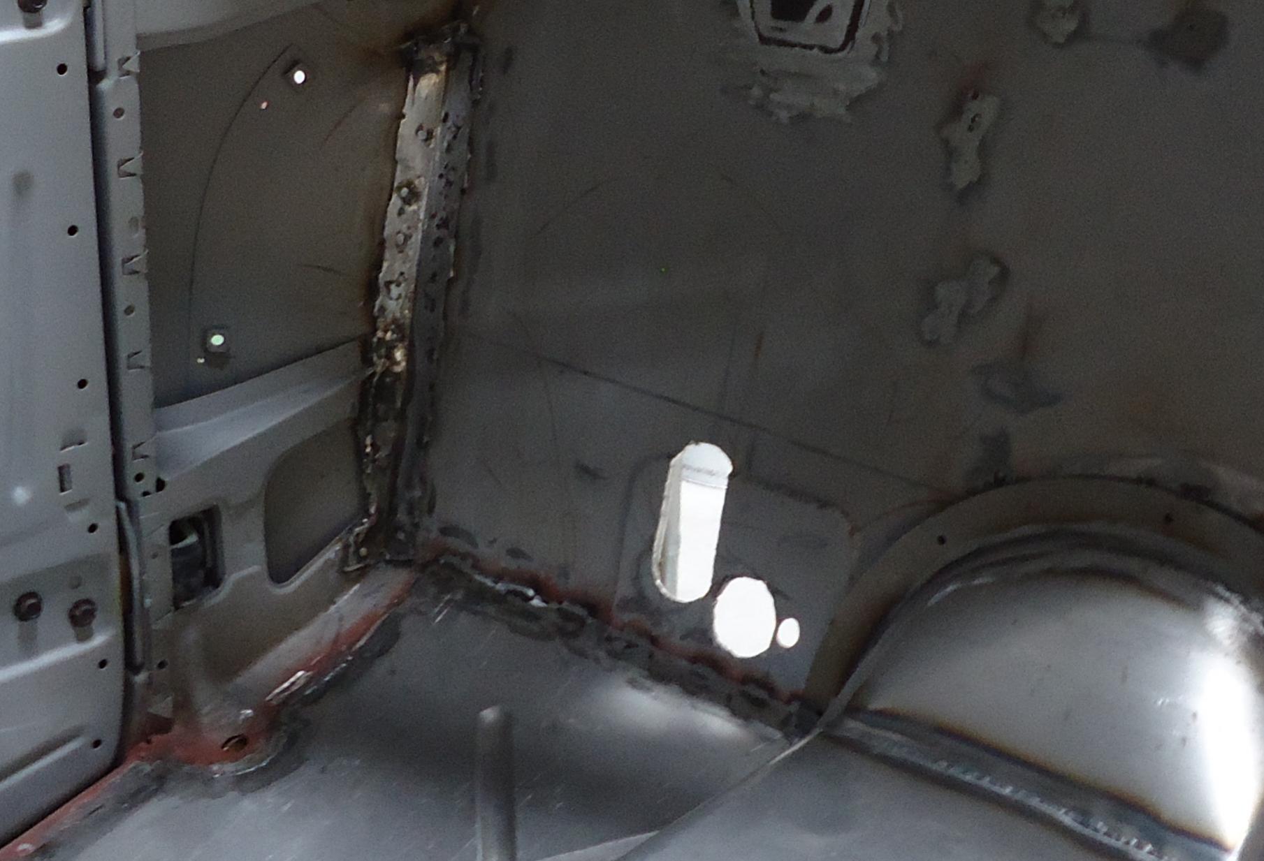

    Started off this morning doing some more welding in the trunk. Then moved to the front of the car and started welding up the holes in the firewall. Also cut one larger piece of metal and welded that in place.

    Thanks Hivolt5.0. No it's not the original firewall. The previous owner "fabricated" this one, it's 2.5 mm thick, so very sturdy. The set back is approximately 2-3 inches. It's thick enough for me to mount my 90 degree pedals, so I decided to keep it in place. Considering this firewall was there during my engine mock up sessions, I'll keep it where it is. Further modifications are on the way though.....

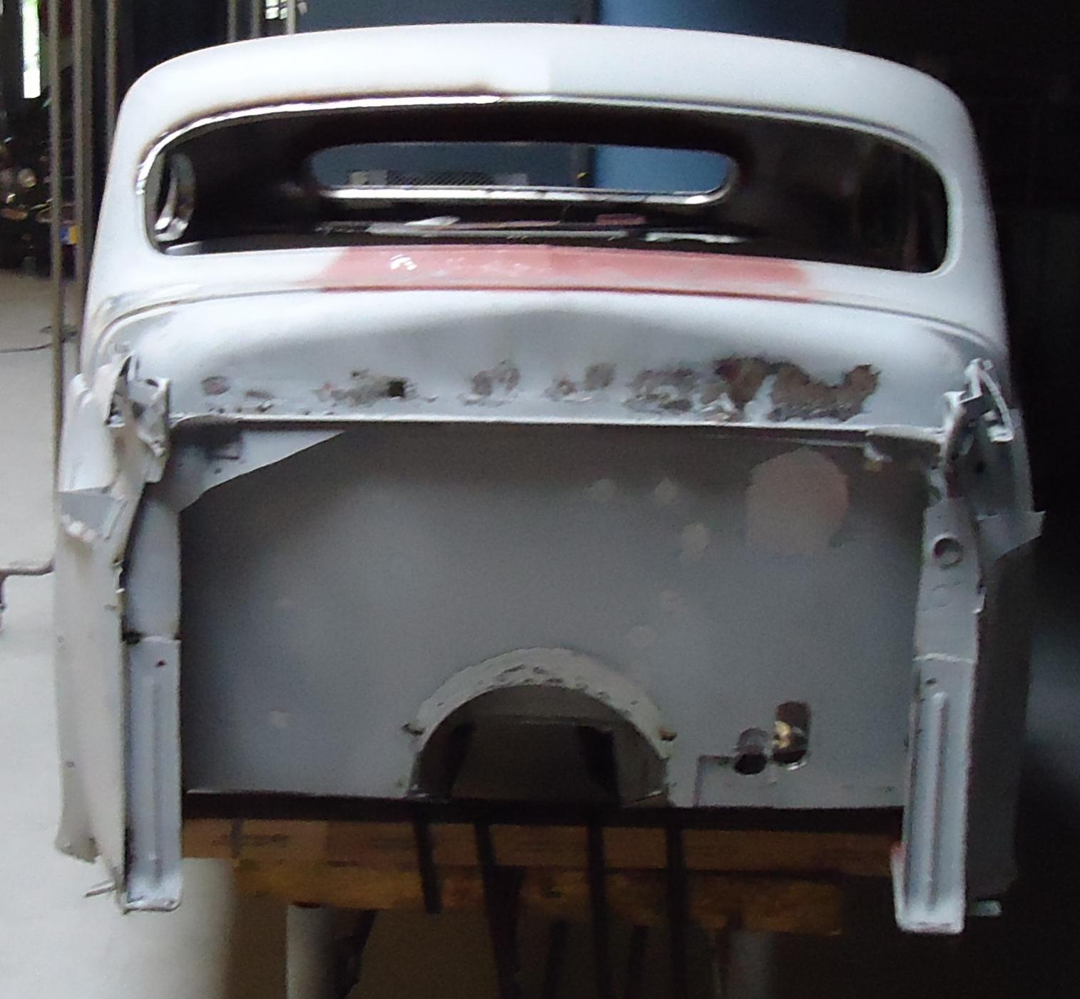

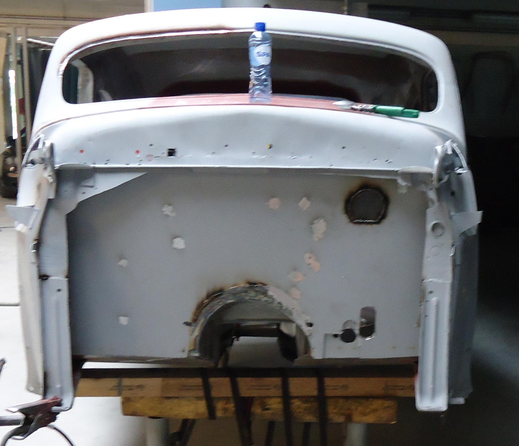

    Next was to clean up the welded plate. Started to weld the holes above the firewall. This area is in fairly bad shape, so I'm going to think about how I'm going to tackle this. Maybe I'll replace it completely or make another panel in front of it which will then bend around the horizontal piece below it. Haven't decided yet....Also started welding/cleaning up the tunnel entrance.

    2,5mm thick firewall!
    Before i read your answer,i was wondering why there are not any beads on that firewall,not wondering anymore:D
  9. farmer12
    Joined: Aug 28, 2006
    Posts: 7,723
    farmer12
    That was my initial reaction too. Why such a thick firewall? But after evaluating everything, I realised that it may just come in handy. It's thick enough to mount the steering column drop and the pedal set. It will also give me the option to mount other things behind the dash without any concerns. Also, by having a smooth firewall, all the attention will go to the Hemi. (a lot more important!:):D)

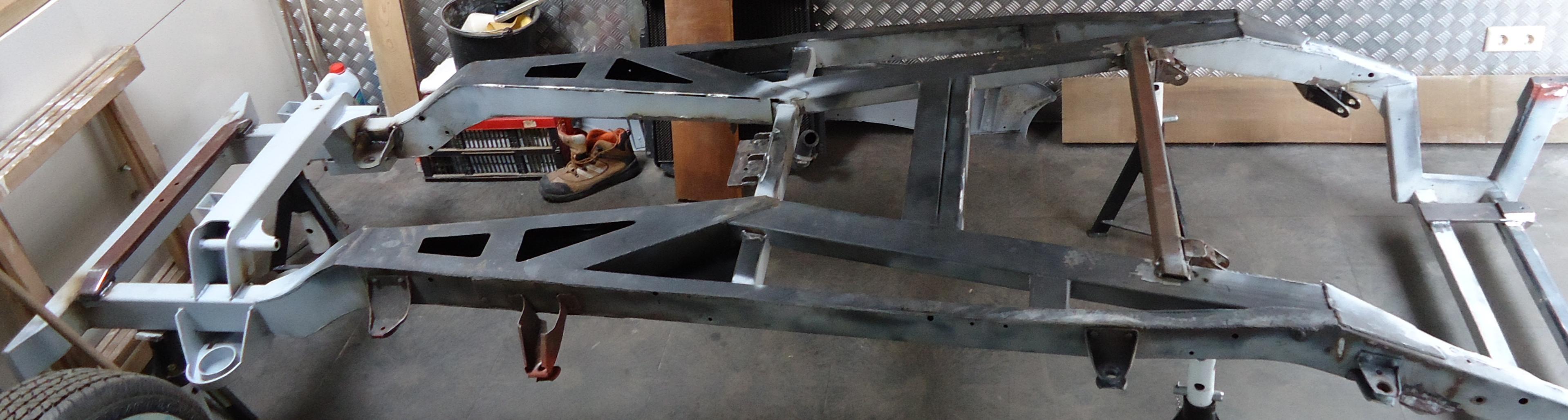

    Got a chance to work on the ch***is this morning. Flipped her over all by myself without any damage.:eek: Took me a while to find the balancing points, and with a little careful thought, anyone can do it! Going to finish off the last welding/cleaning up underneath this week so I can start making plans to have it powdercoated next month. Decided to have the frame powdercoated black to coincide with the black Hemi block.

    I'll take some pics side on of the firewall to show you the set back.
    In answering your last question, it's a simple no. The plan was to take it apart, drop a Hemi in, build it up, paint, upholster and drive. I've never regretted taking it to the next level though, not for one single minute. It's given me a lot of pleasure, especially on the fabrication and thinking process side of things. I've learnt to be patient and have become an avid measurer. This is probably the key in combination with good planning. Do it right the first time has become somewhat of a motto for me. Even if it means taking a lot of time to accomplish this.

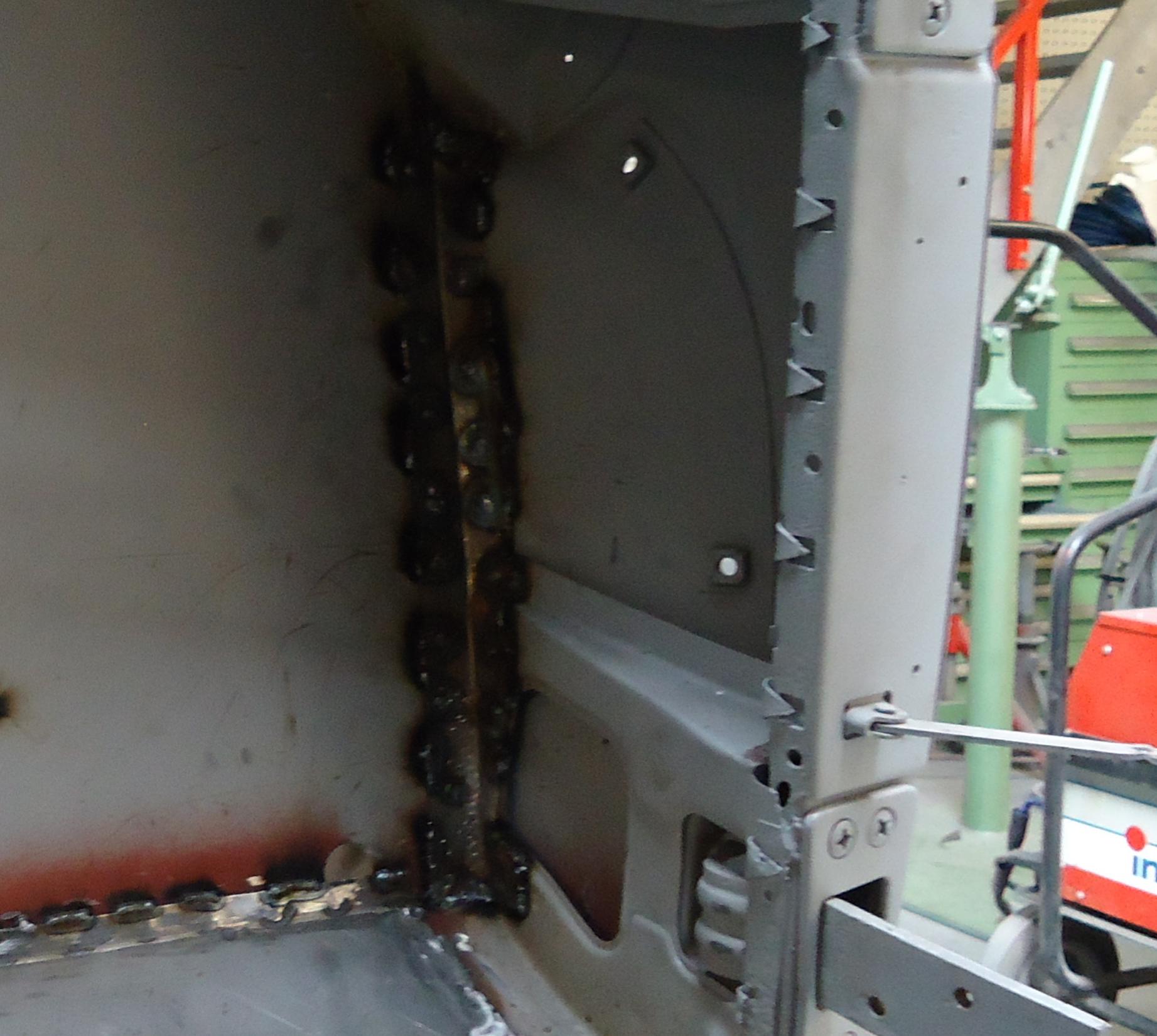

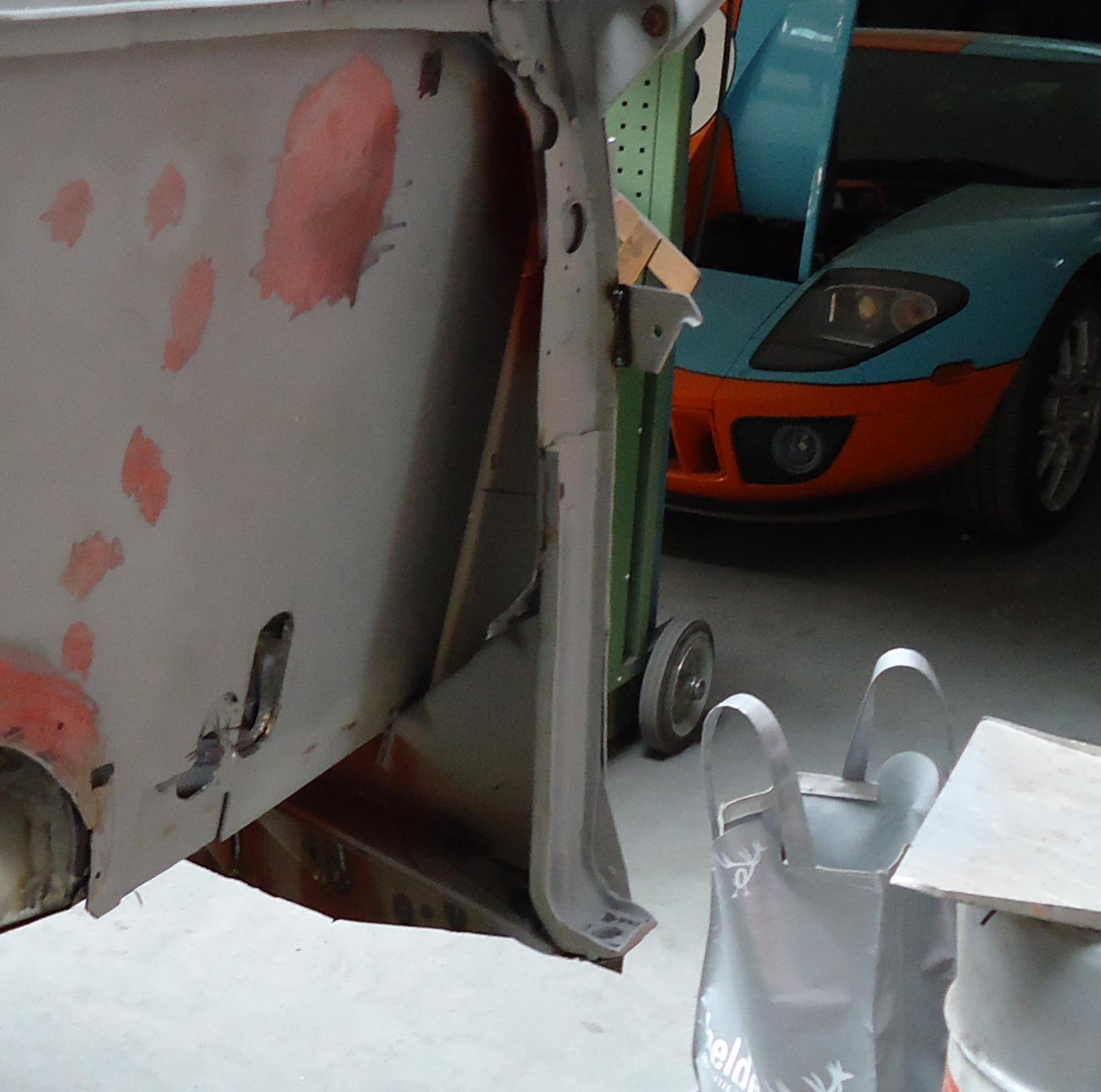

    It was time again to go and do some real work again today. There are quite a few gaps around the firewall so it was time to fabricate and weld. In the first pic you can see the gap from the outside. Considering I want to be able to hear music while I'm driving, it's necessary to get the cabin sound proved. Later on, I'm going to cover it all with Dynamat and carpet. Got both sides done.

    I'm guessing thats your daily driver in the background of the first picture. No?
