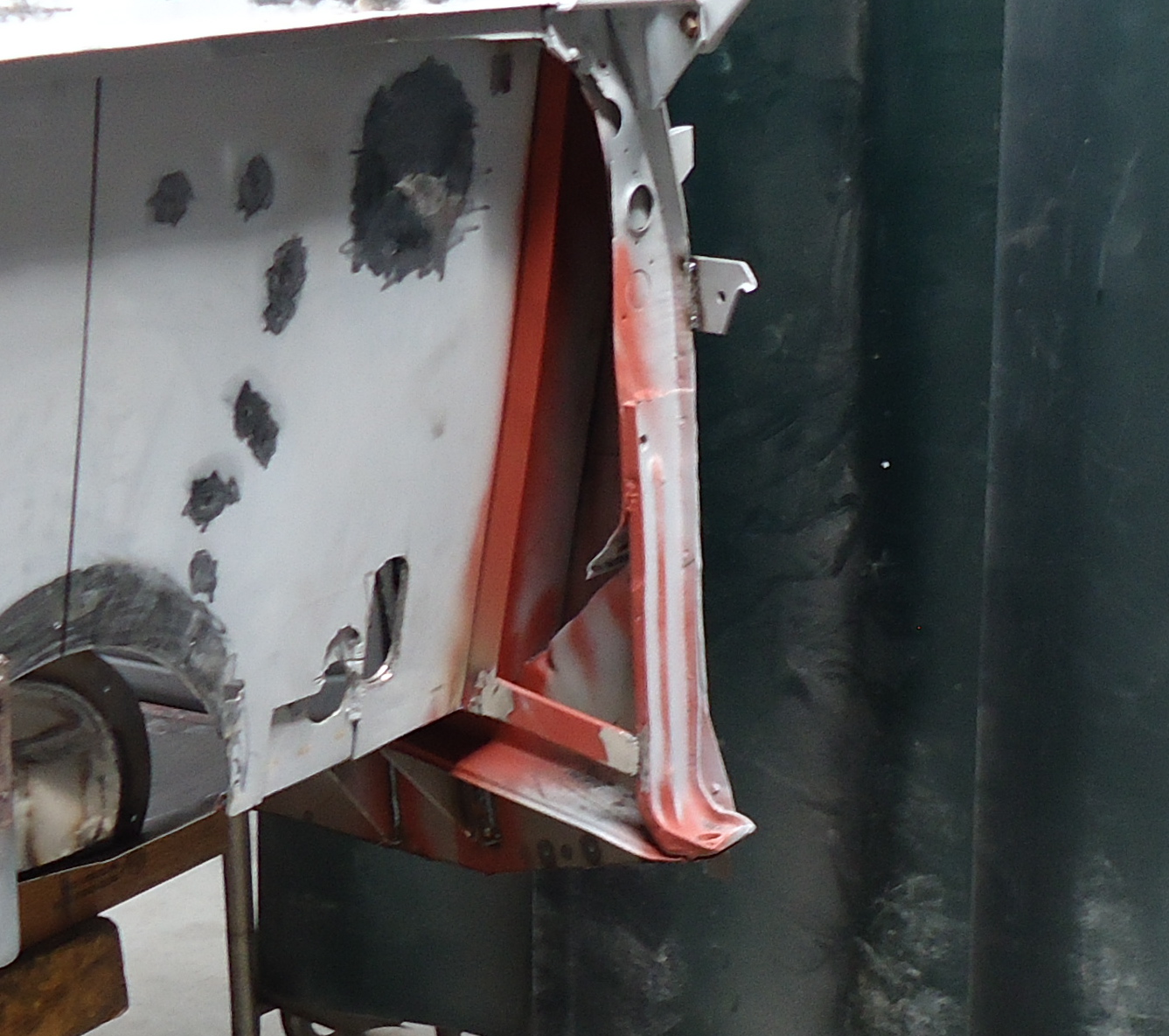

    When posting that pic, I knew someone would comment. hahaha It's one of Martin's customers car, he bottomed out on the race circuit. The frame is bent and a new piece will need to be welded in. An expensive day racing........

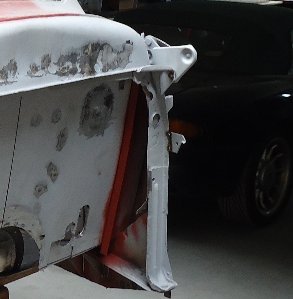

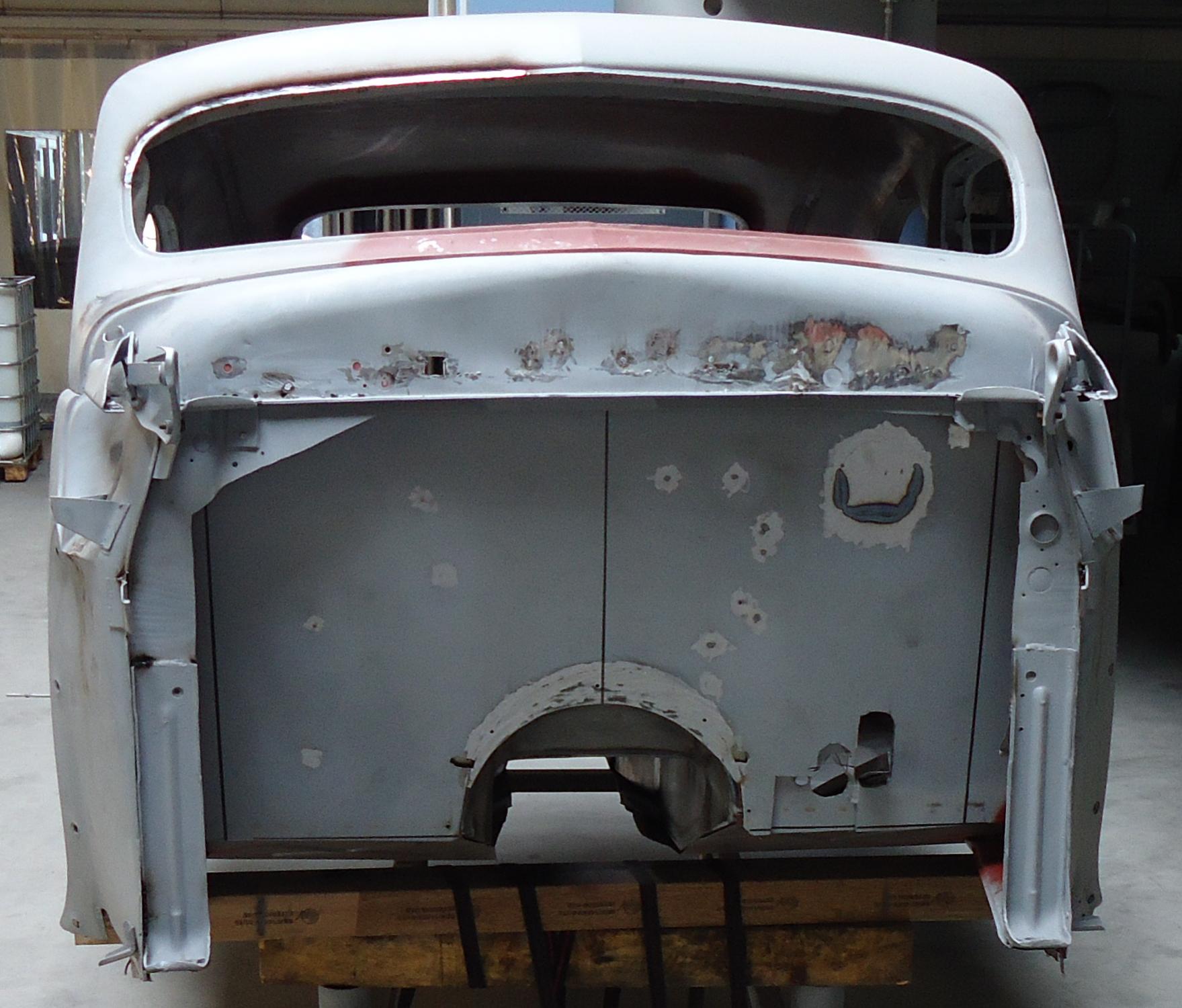

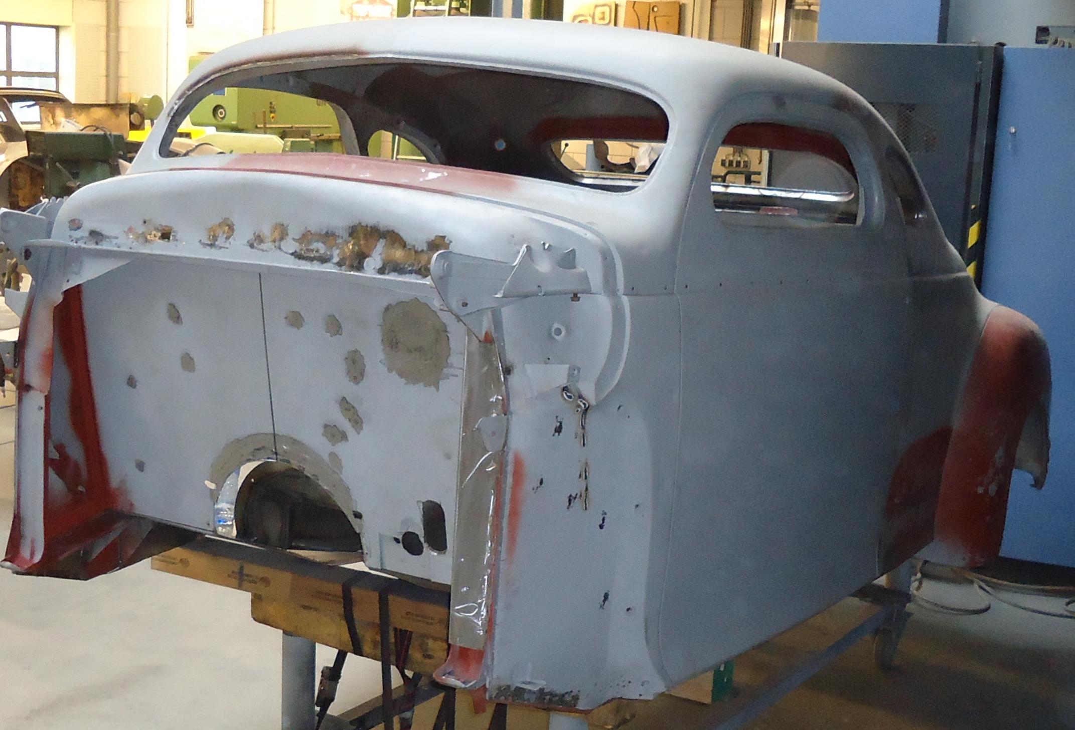

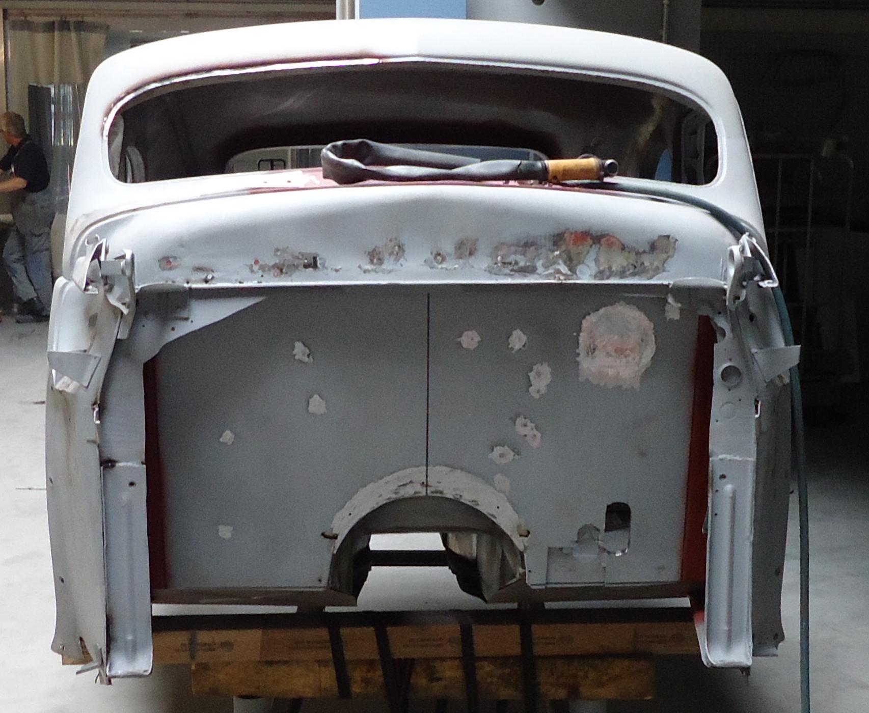

    Started drawing some lines on the firewall. I want to start fabricating some panels tomorrow in order to close the sides. I want it to look clean when looking into the engine bay, also giving me some hidden space to run wires and brake/air lines. The plan is to run the panels perpendicular to the firewall. Update will follow tomorrow.

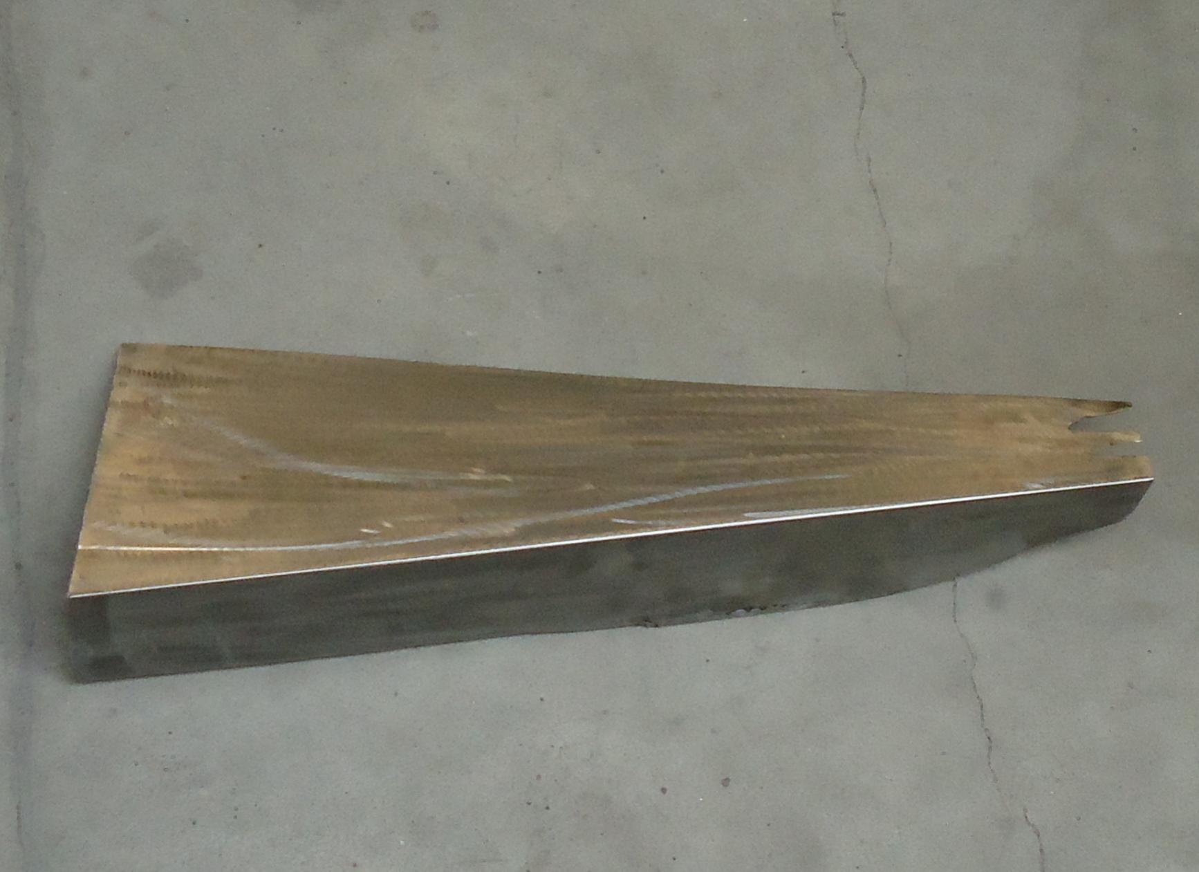

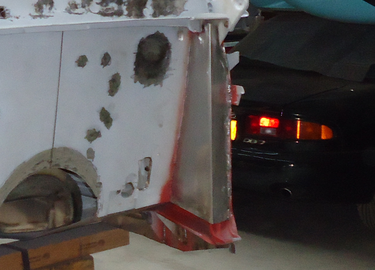

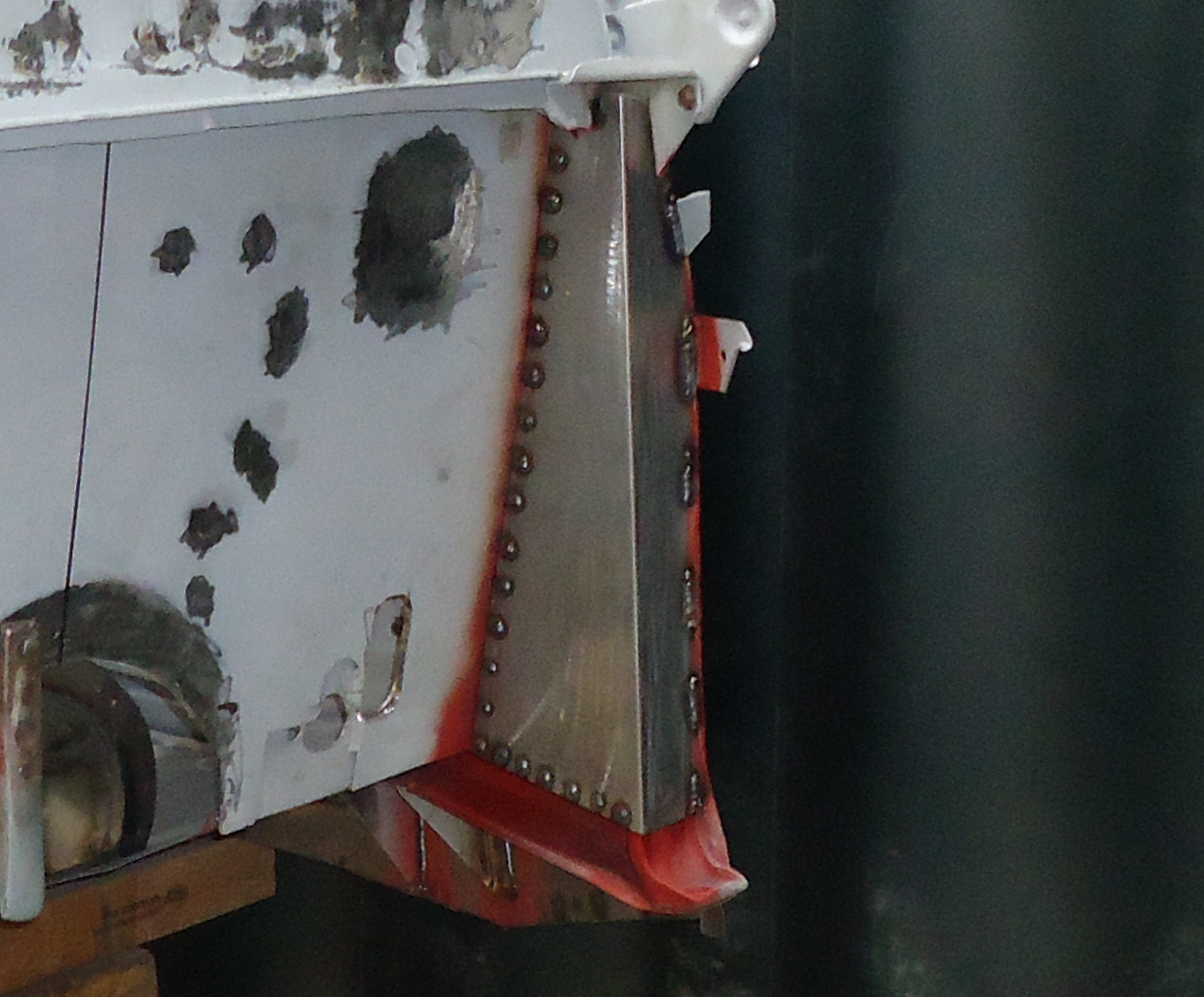

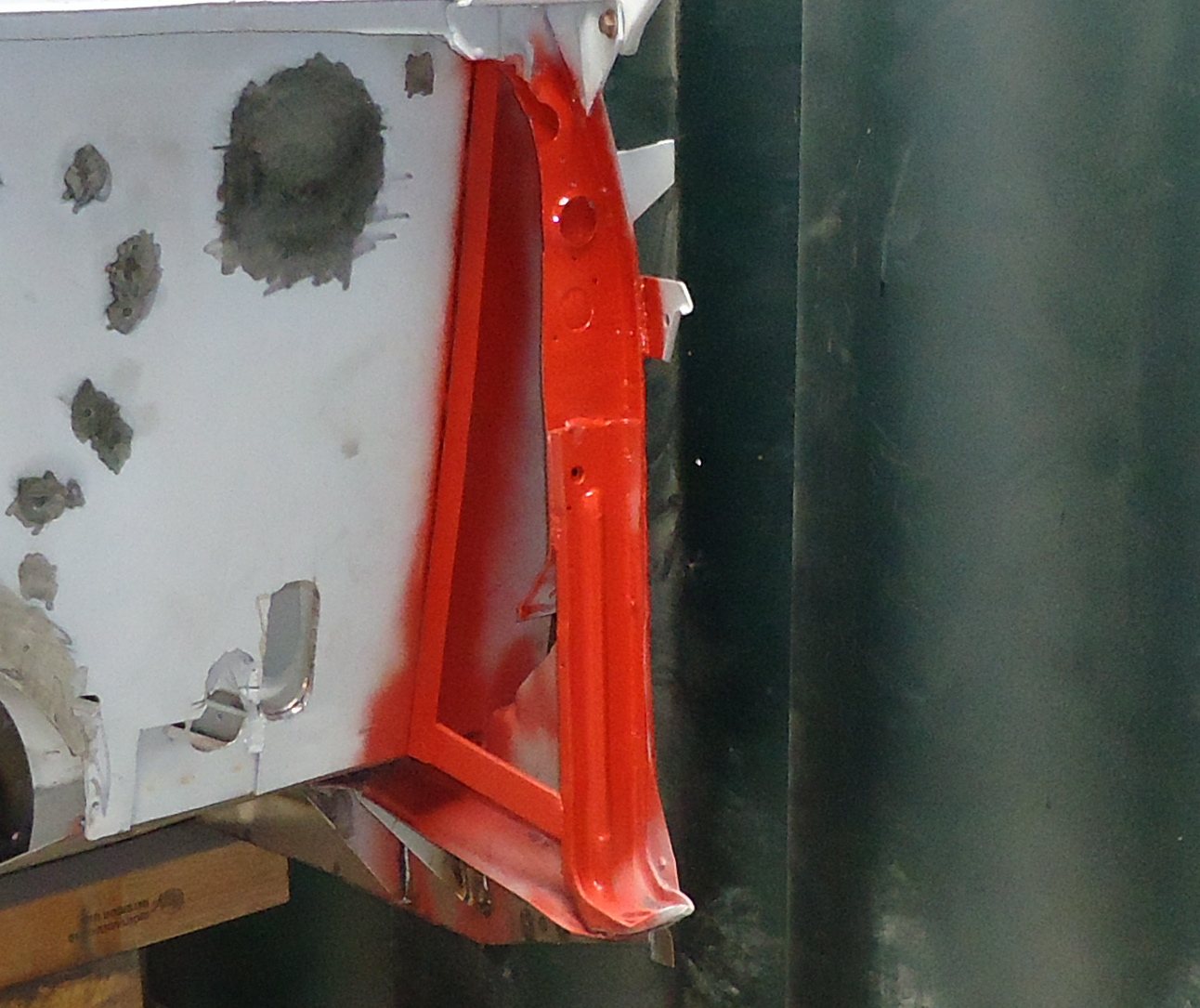

    Just got home after a full day at the shop. The plan is to cover the sides in front of the firewall for a clean look and also giving me some hidden room to run wires etc. I fabricated two upright pieces and two small horizontal pieces to give the large cover some support. Welded these in place and painted them with red primer. Then made the drivers side cover and kept on grinding and filing until it fitted exactly in place.

    part 2: Got the side panel installed in the proper position. Then punched holes along the firewall side and the lower horizontal piece. Welded it all up and ground it all. It actually came out better than I anticipated, even if I say so myself. Going to finish the p***enger side next week.

    Looks good! What sheet metal tools do you have? From what I can see in your work, it appears you probably have a sheet metal shear and brake?
    You do great sheet metal work. I need to get practicing if I'm ever going to be that good. :D

    Looks good Eric. I was wondering about the top area where the new panel meets the cowl, maybe add a rounded, curved piece to blend with the rest of the curves on the car?

    Thanks Tex***peed. For this part I only used a shear for the initial piece by cutting the maximum metal required. Then used the brake for the 90 degree bend. From there I cut it by hand using metal scissors until it fits. This part takes a couple of hours, finally using a grinder for a good fit. Good tools are certainly the key, combined with patience.
    It always seems that time flies when fabricating. I made the braces for both sides and fabricated/installed the driver side panel, all taking around 7 hours in total.(including coffee/smoke breaks and thinking time). The best part is always at the end of the day when you can step back and look what you've accomplished.

    Thank you for the photoshop OahuEli. Yes, the plan is to finish it with a rounded piece like you suggested. First I need to strengthen the hood bracket support on both sides and the the plans are to fabricate a horizontal piece to cover the firewall "driprail". Once that is done I'll do the curved pieces.
    I was actually expecting you to make a comment regarding the db7 in pic number 2...:D

    I thought it was a Mazda.:eek:

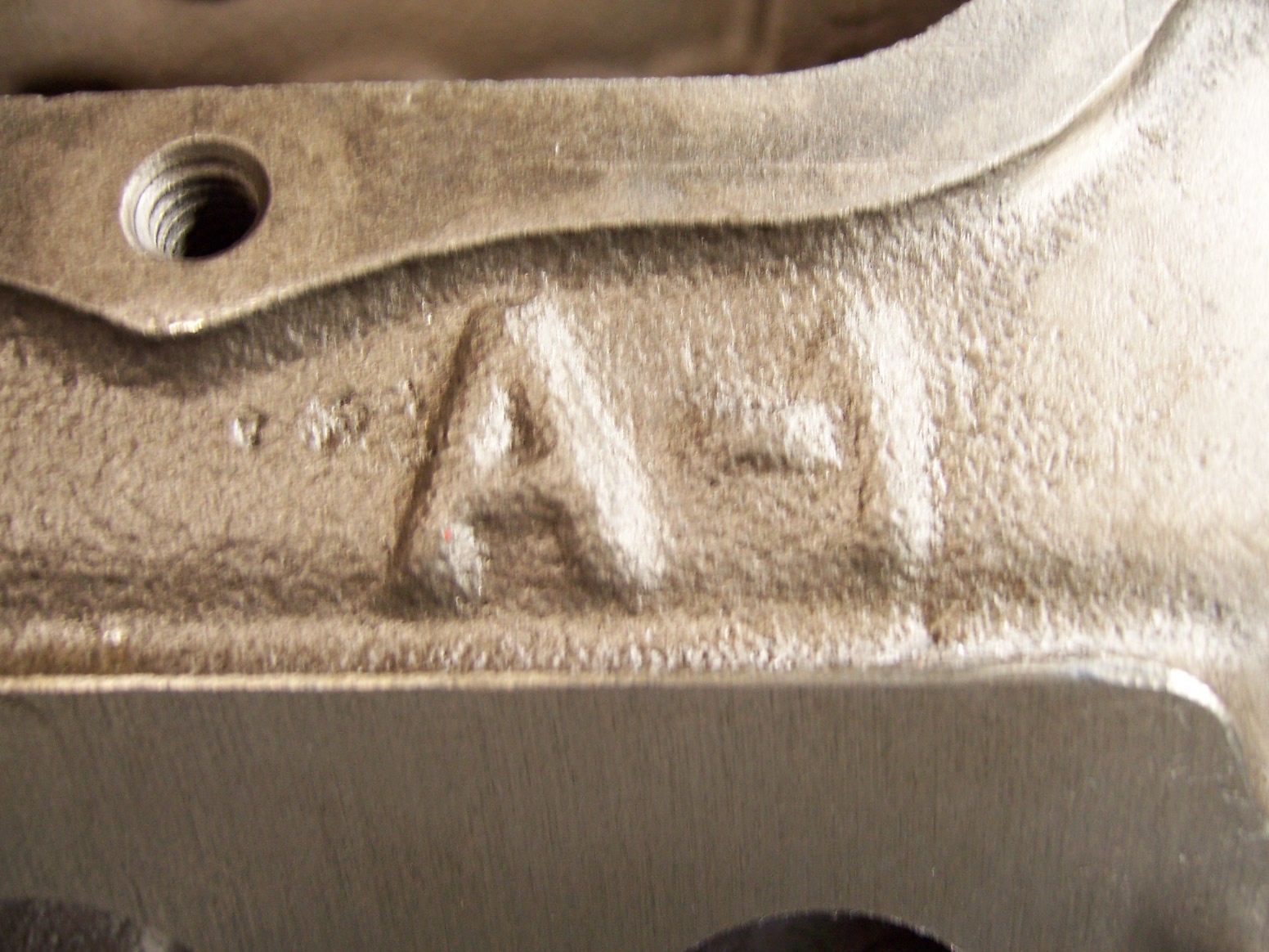

    I see that you are coming along quite well. I will have to steal some of your firewall ideas...LOL We have a bit of a set back on my build, my Fabricator is ill. I found a couple of engines, a '58 392, and a '09 5.7 with 300 miles on it. Can't decide yet. Perhaps you can tell me where the "A" code is on the 392? I'v got a 58C3710, it is from a '558 Imperial. My concerns are room for the headers with that Elephant block. Do you have room between the frame rails etc.?

    Thanks powhatan42! The A-1 is cast in the block on the driver side. (between the head and valley pan, near the distributor.) btw, the 392 is a "whale" and the 426 is an "elephant". Didn't know that either until some Hambers pointed that out.

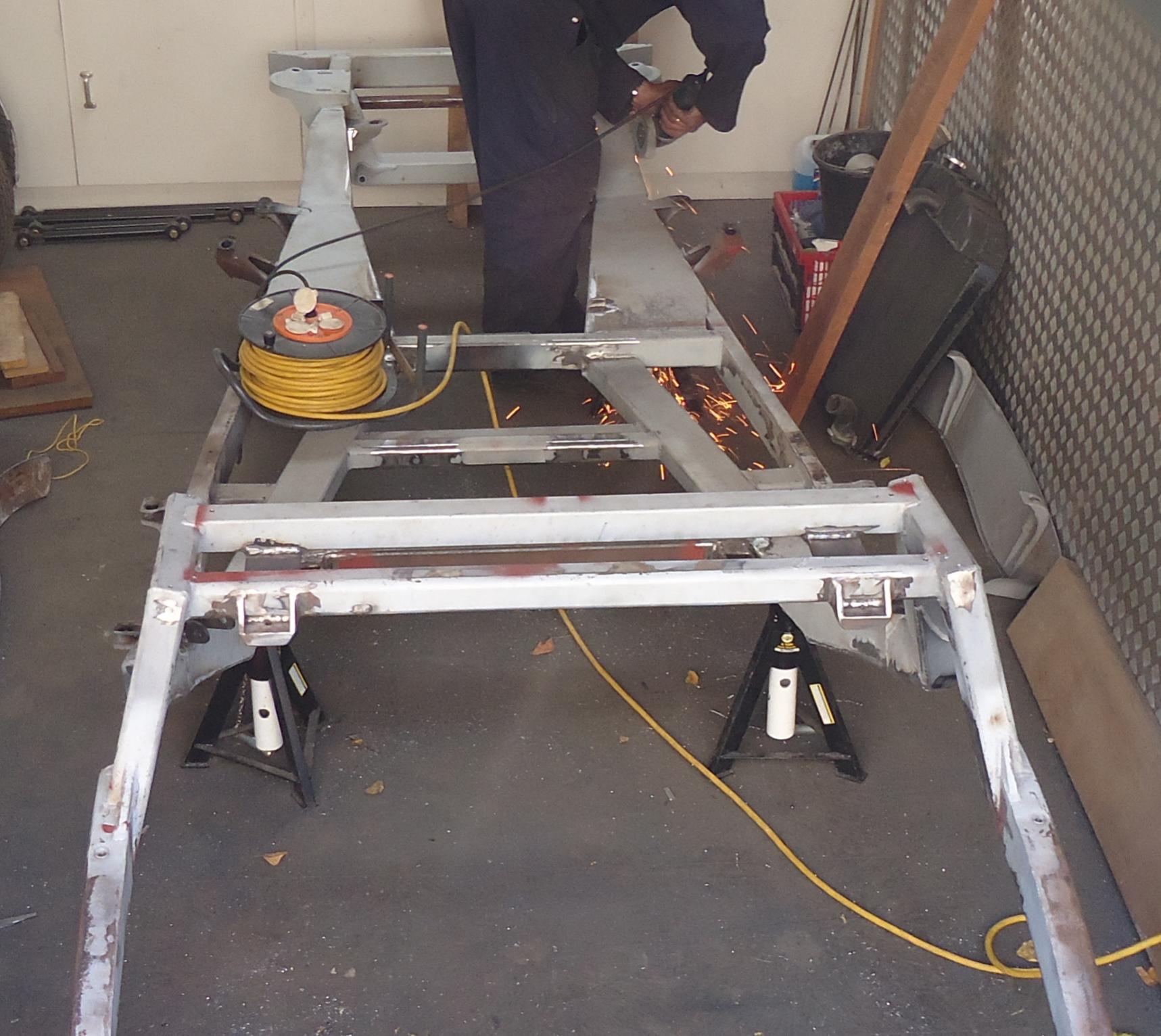

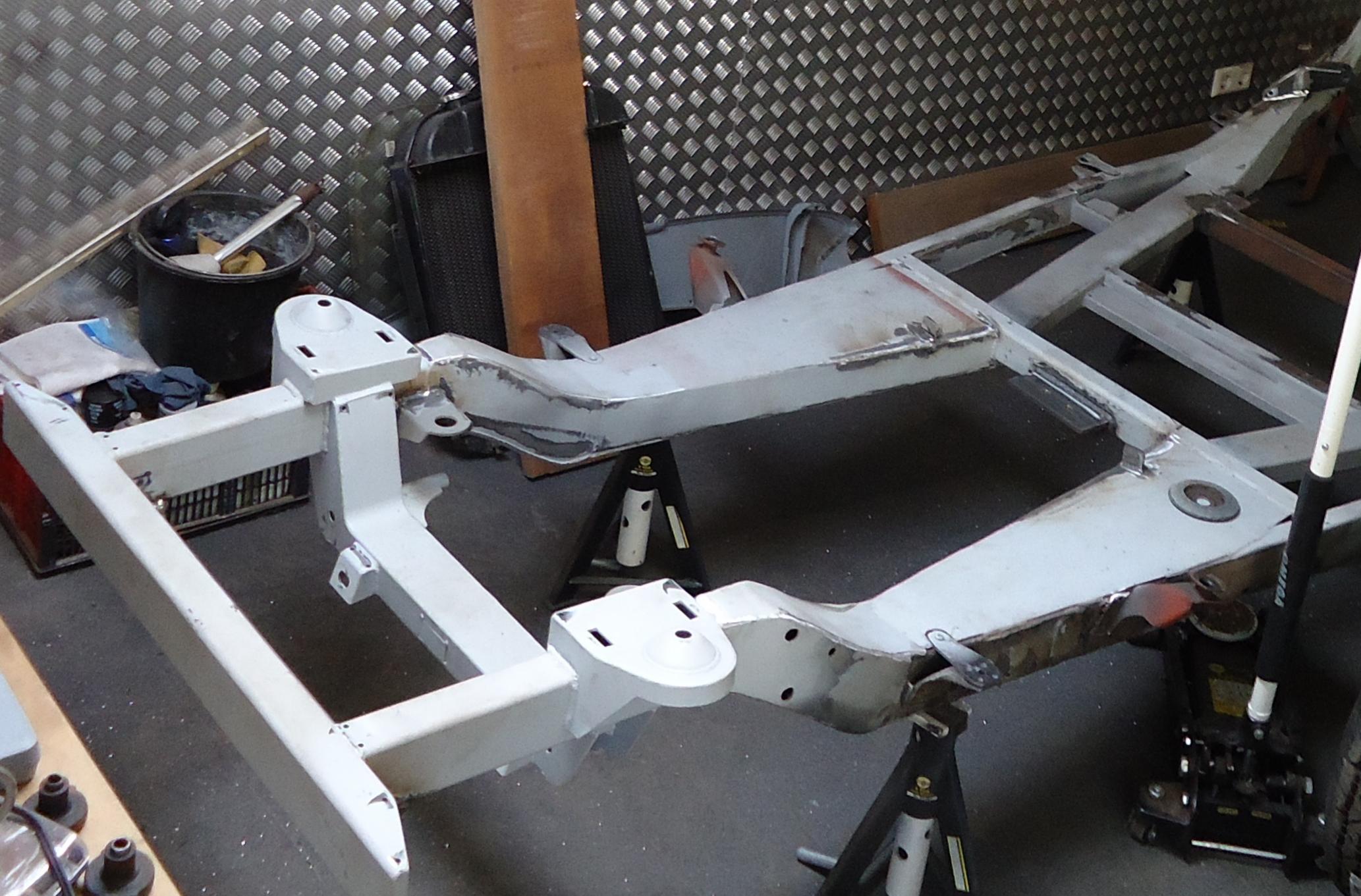

    Got back to my own garage today and did a little fabrication/welding/drilling on the ch***is with my buddy Jaap. It's turned upside down at the moment, giving easy access to some areas needing to be tackled. Started off on the area in front of the c-notch. Here some tubes and welds come together, creating an ugly sight. Created a template for both sides and welded it on.

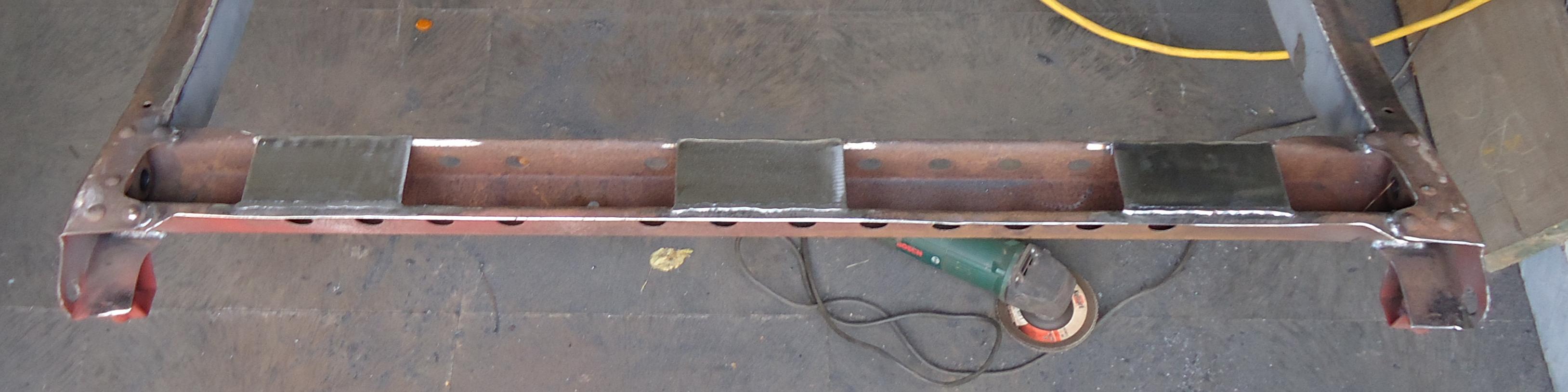

    Then it was time to partly box the rear cross member. This will give added strength and also good mounting points for the exhaust later on.

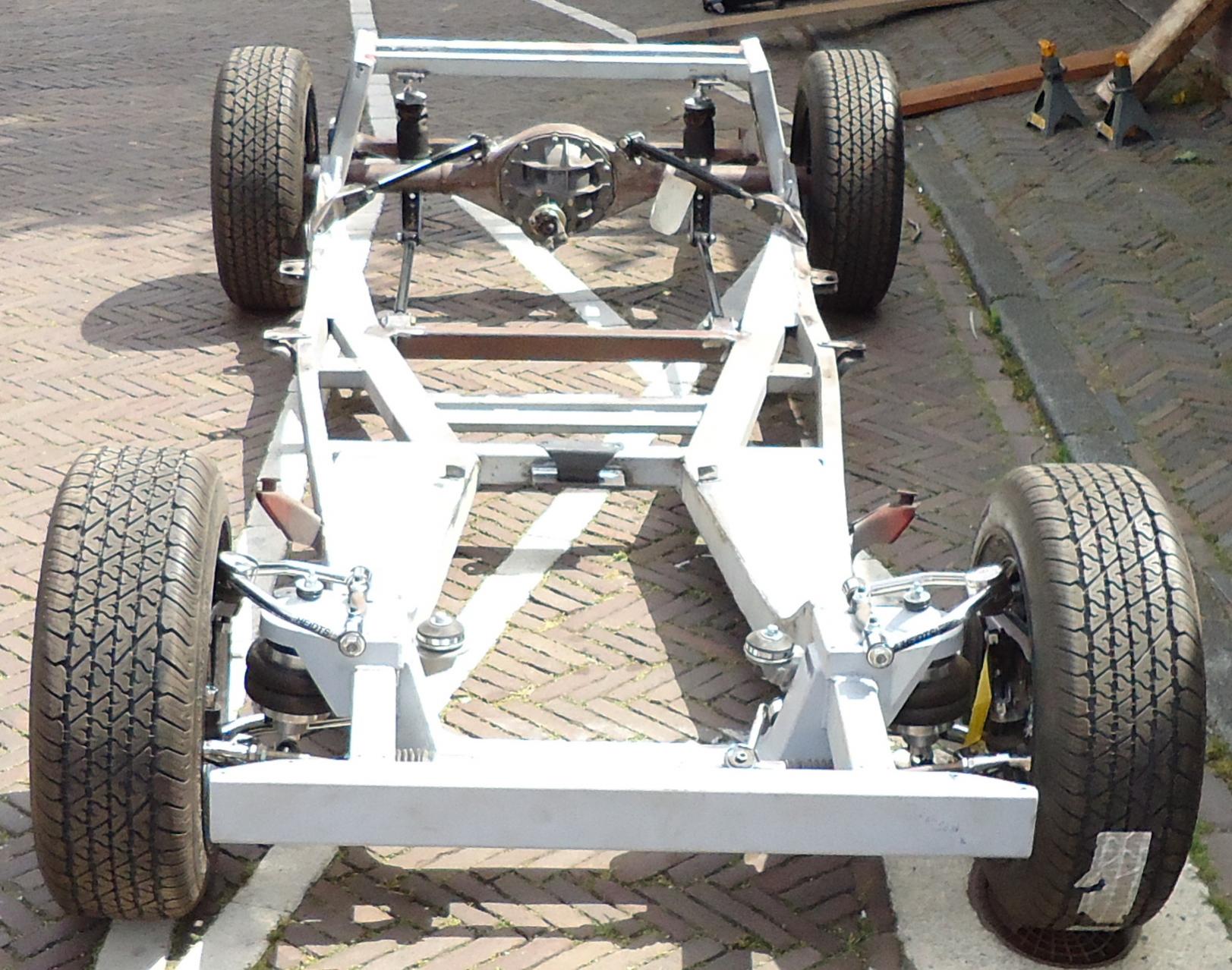

    Next on the list was to finish all the rough edges on both sides of the ch***is. Jaap and I then got to drilling holes. Lots of holes. After doing the underside, we flipped the ch***is right way up and drilled some more.....The ch***is will be zinc coated, requiring holes for the zinc to enter and holes for air to escape. This way, zinc will penetrate into the cornes inside each tube. The plan is to have the ch***is powdercoated after the zinc work is completed.

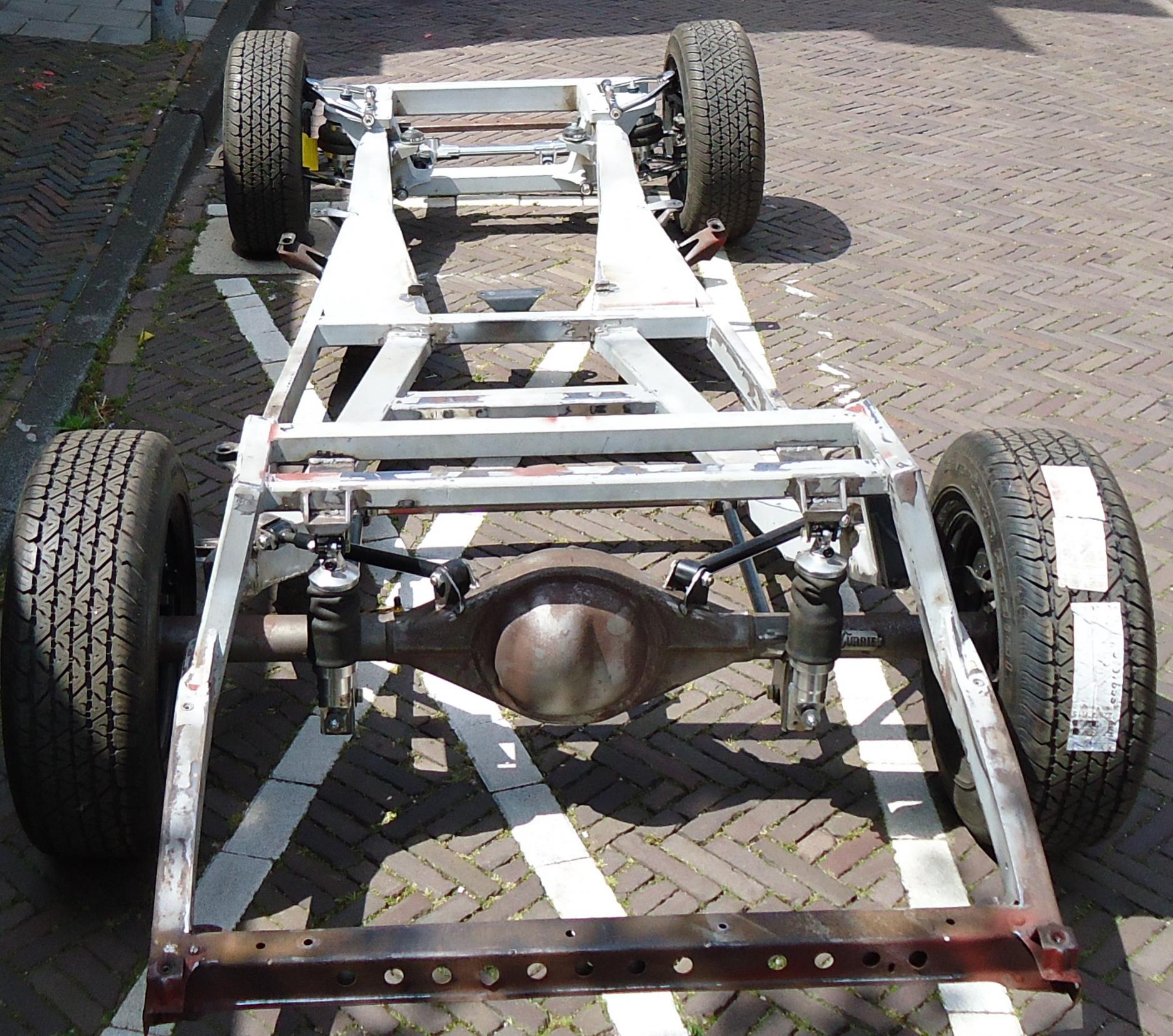

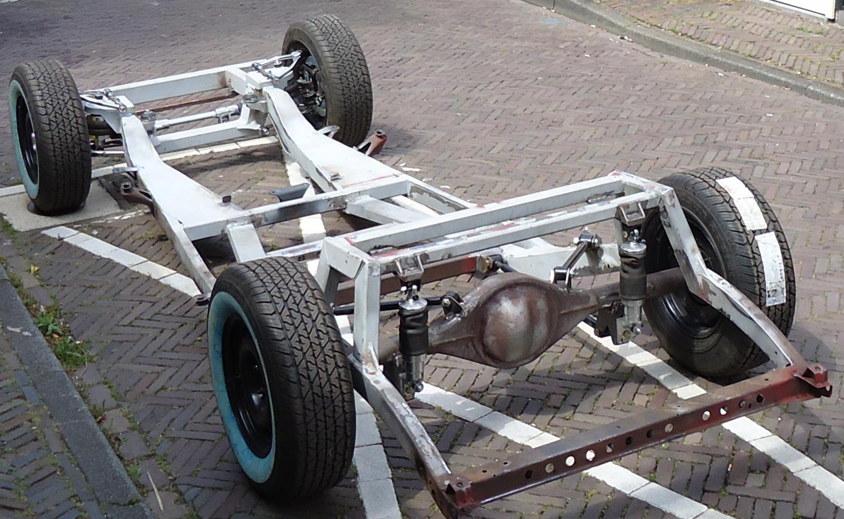

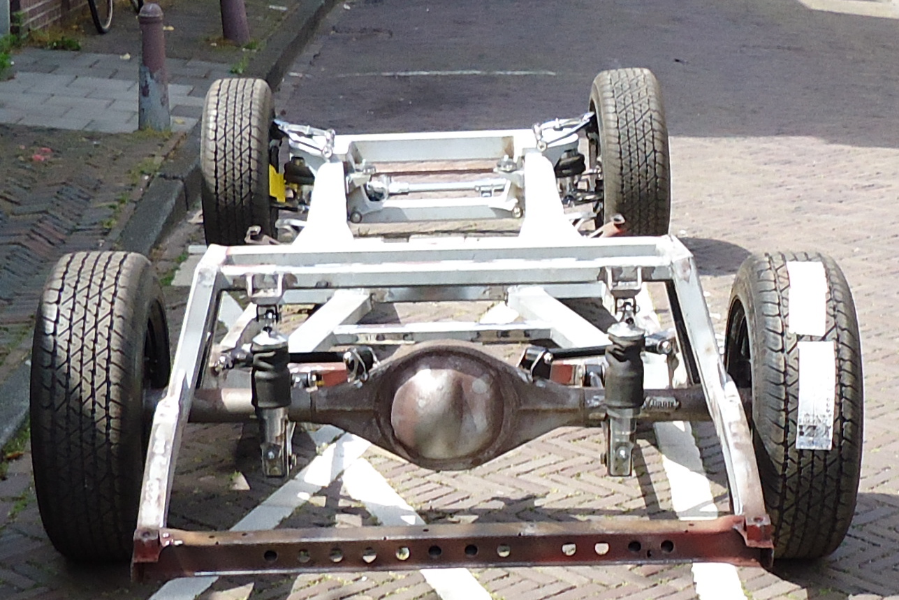

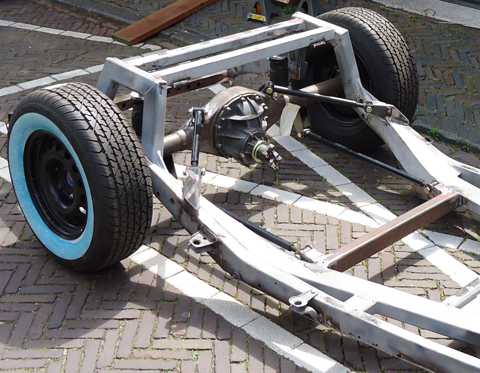

    Done something today that I'm getting quite good at: installing the front and rear. I wanted to clean up the garage floor and at the same time turn the car around. A good opportunity to take some photos outside.

    Wow, fast work, and nice job. What gears are you running in the rear end? You will have to put it back together after the powder coating. Well you will know the car inside out for sure. Nice to see it on all fours.

    Thanks Glenn! I'm using 3.70 gears in the rear. I calculated that at 70 mph in 5th gear I'll be doing 2200 rpm.

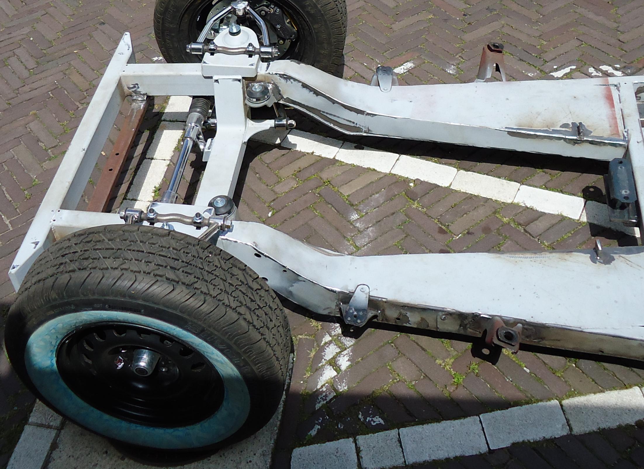

    Thanks LabRat! Considering I'm about 10 miles from the coast, I'd hate for the ch***is to rust from the inside out after a couple of years under the influence of salt air. Would be a shame after all the hard work. So zinc dipping was the best option, then I'll have it powdercoated. (2 step) This should give me all the required protection.

    Here are a few more shots of the ch***is from this afternoon. Last picture shows it back in the garage. Now I'm going to think about where I'm going to run the wiring/fuel lines/air lines etc.

    Looking really good, how low will the ch***is drop drop with that air suspension, or does it go up from whereit is in the photo?

    Eric, those tires look pretty good, what size are they?
  29. farmer12
    Joined: Aug 28, 2006
    Posts: 7,723
    farmer12
    The tires are from Coker and are 225/70r15 on all 4 corners.
