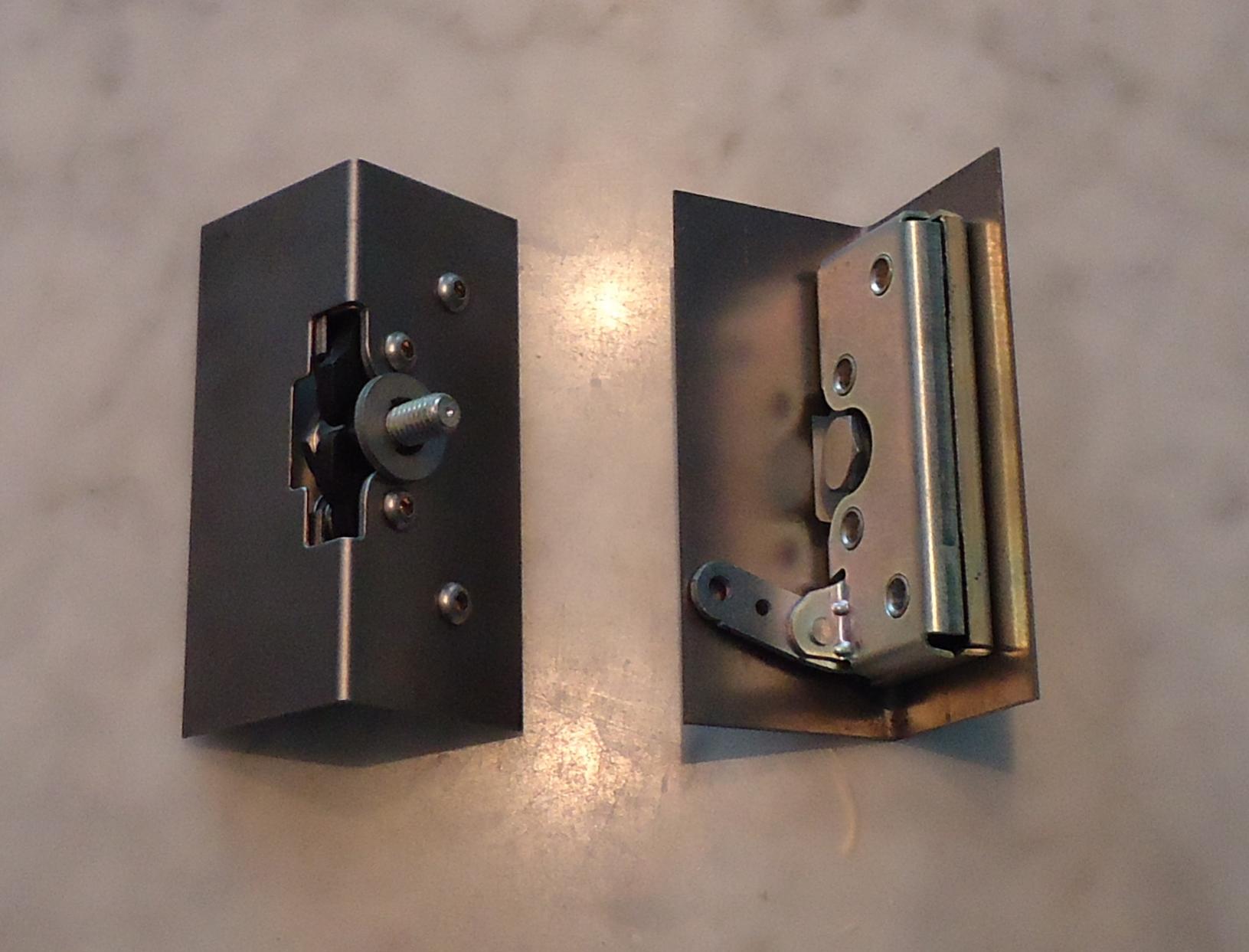

    I'm not planning on suicide doors, just a good solid locking mechanism. I'm also planning new locks for the hood and deck lid. Post some pics when you have the mock block in the ch***is. Here's a pic of the Bear Claws I picked up a few weeks ago.

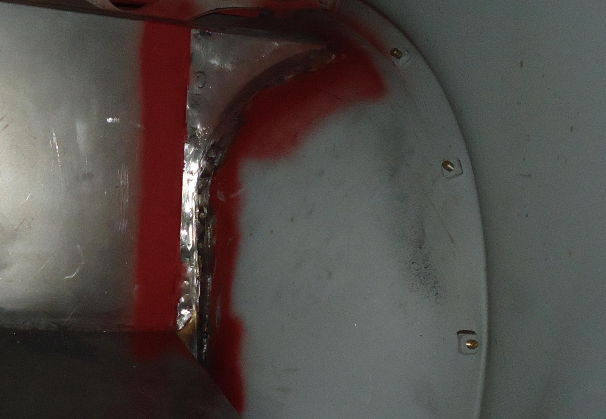

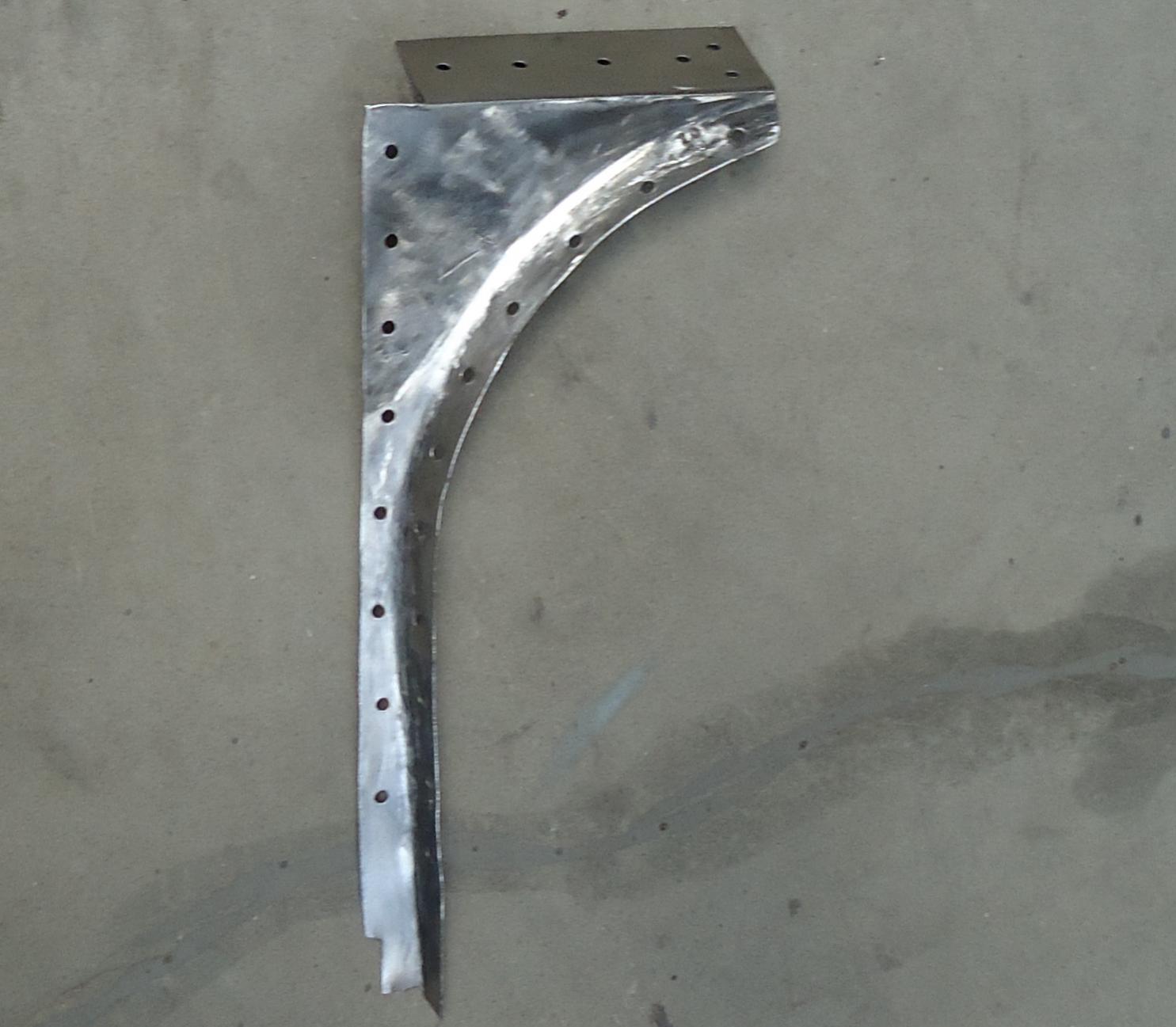

    It was back to the shop again today. Finally! This time I fabricated the driver's side panel on the c-notch cover. Not very exciting, I know, but it had to be done....Welded it in place and ground it down. Also cleaned up some welds in the trunk. Things are going at a steady pace (but never fast enough). Going back to the shop on monday to continue.:)

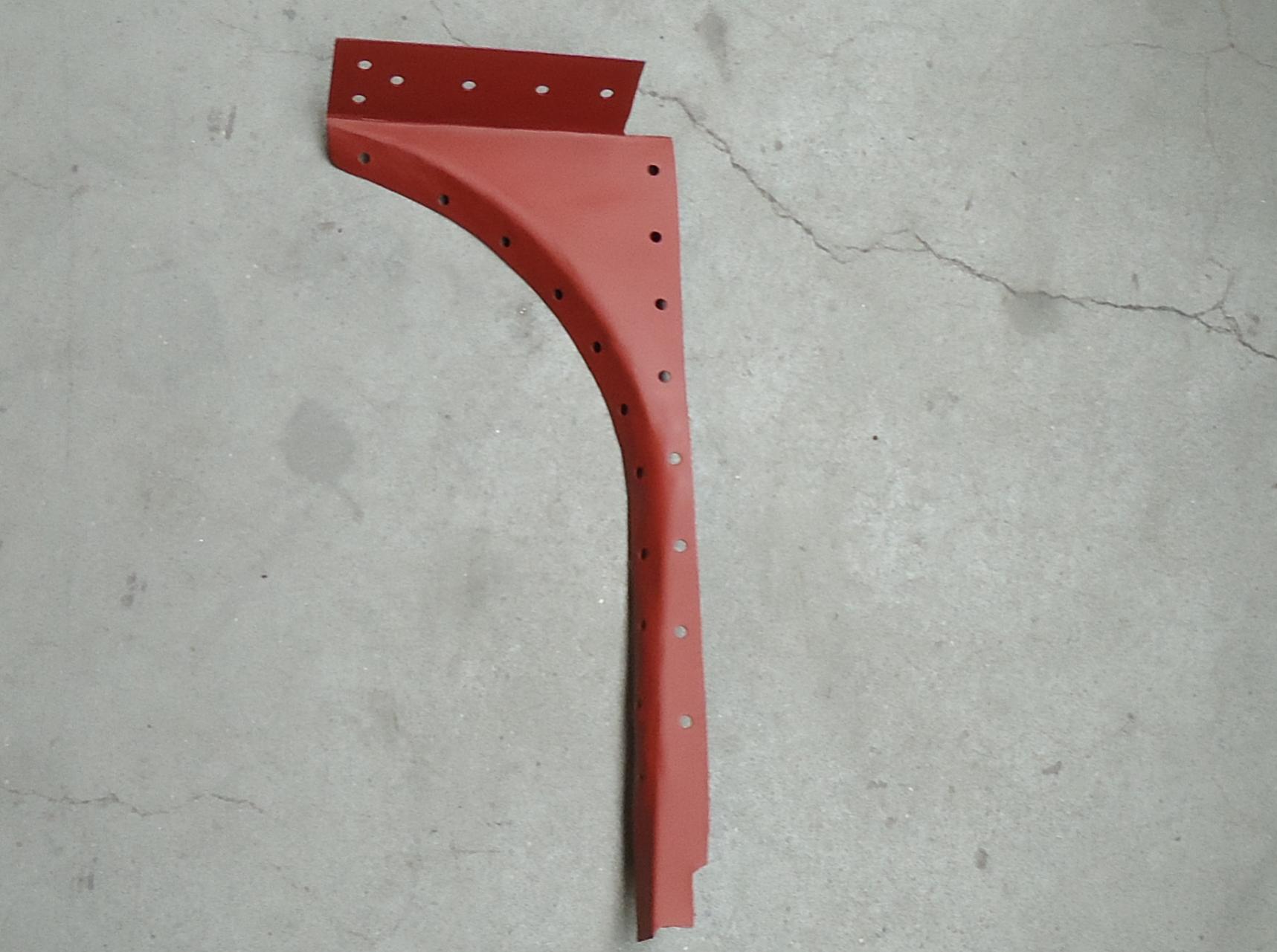

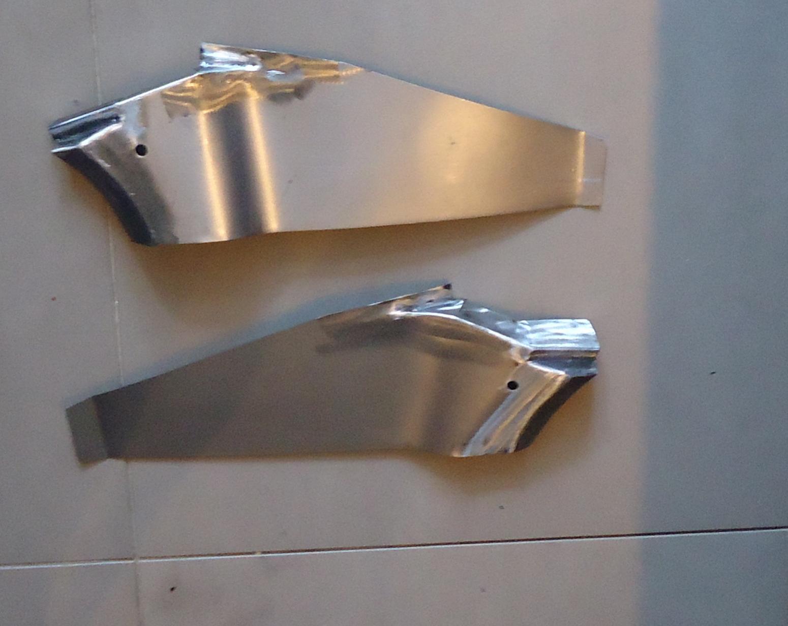

    After waiting for quite a few weeks, I finally received my parts from the Plymouth Doctor. I ordered both inner and outer rocker panels, and the lower cowl repair patches. From what I can see, it looks good, but of course won't know for certain with regards to fitment until I weld them into place.
    Usually I make all of my own parts, but this falls into the catagory of time/money management. Once I've welded these parts into place, the car will be rust free! :cool:

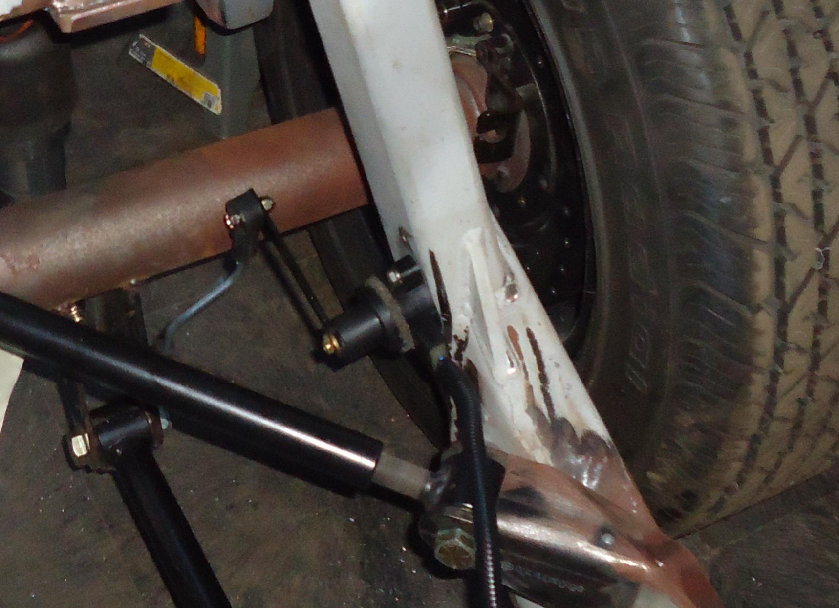

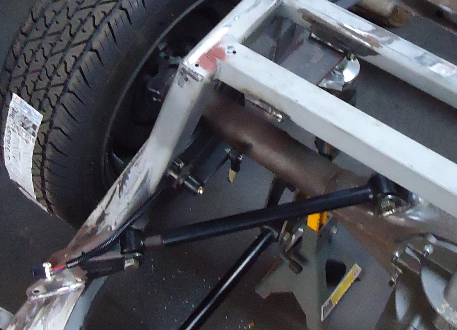

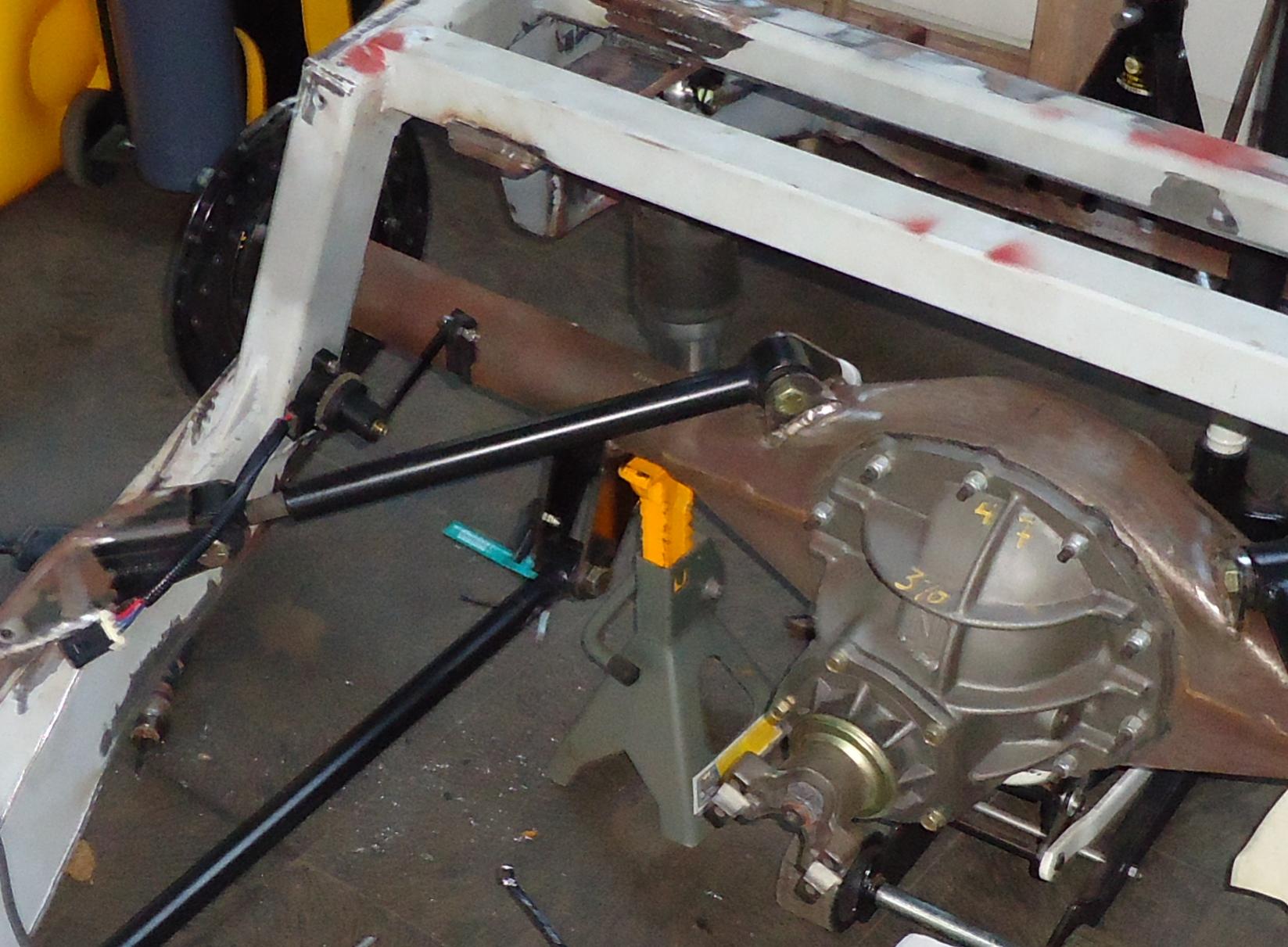

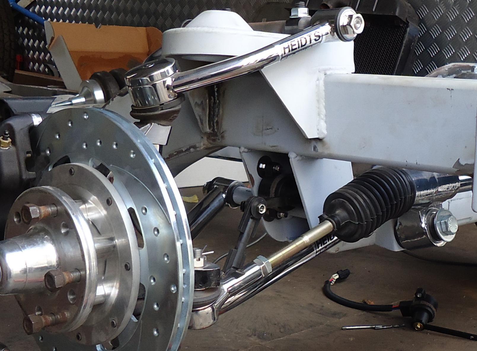

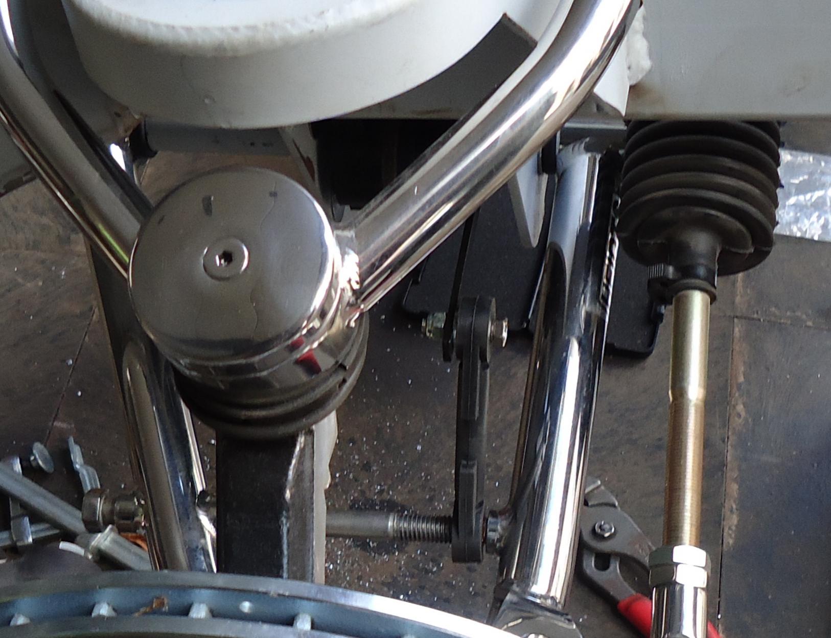

    Considering I had the afternoon to work on the ch***is, I thought I would try and figure out the best location for the sensors of the air ride system. After spending quite a while trying different positions, I decided to mount them on the c-notch. Here I will get decent travel, therefore I should be able to regulate it optimally. The mounting point for the bottom pivot point is going to be the bracket of the parallel bars of the triangulated system.
    First I marked the position on the c-notch, drilled the holes and threaded it. Next was drilling a hole in each of the lower brackets, which meant having to take the wheels off for better access. Then had to bend the arm of the sensor slightly due to the angled c-notch. Then "s" shaped the connecting rod. Tested the system by jacking the ch***is up and down and all worked out fine. I love it when a plan comes together!:D

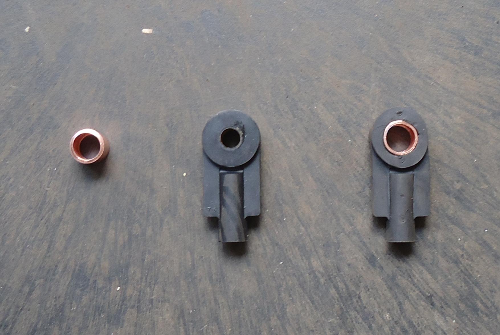

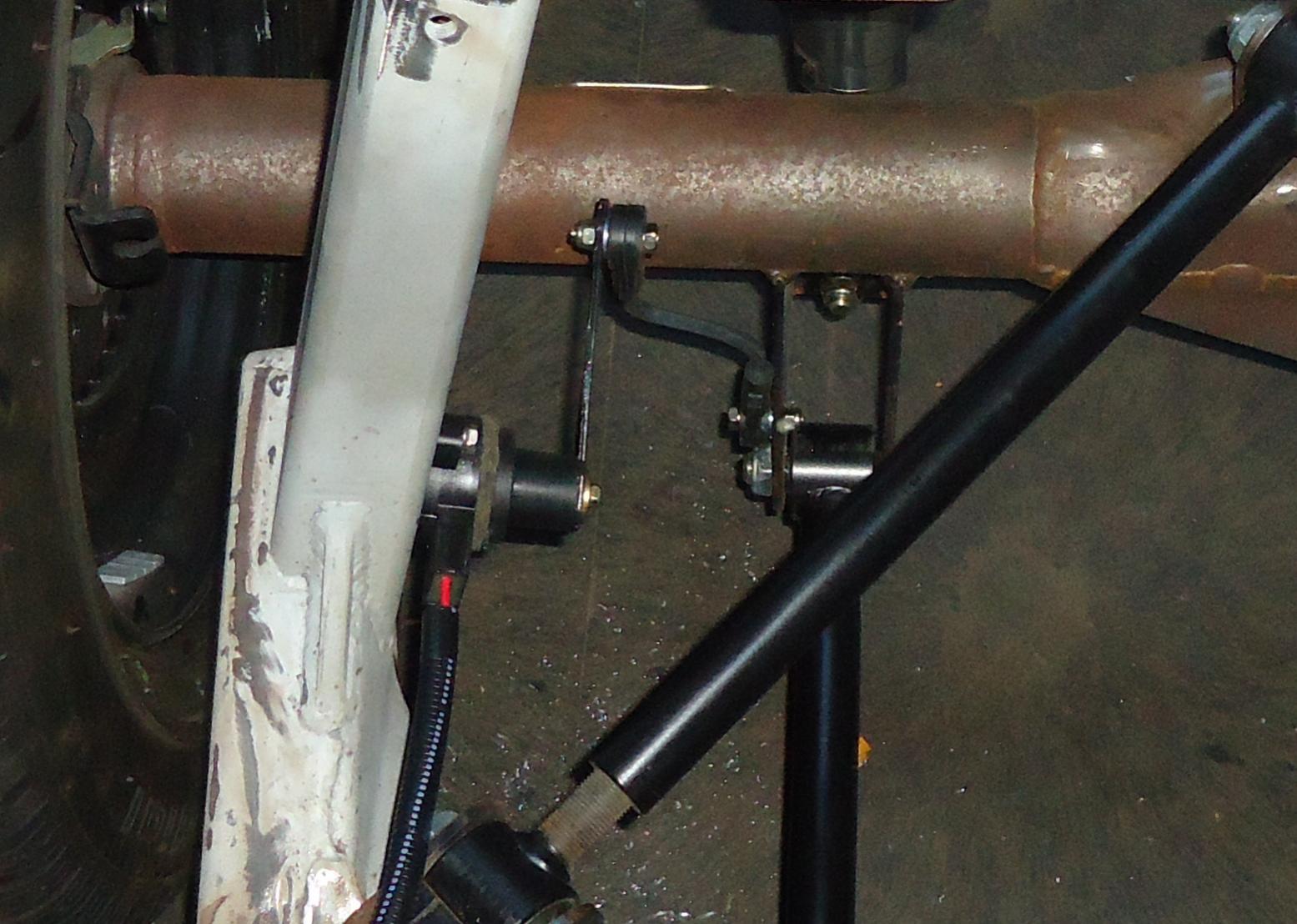

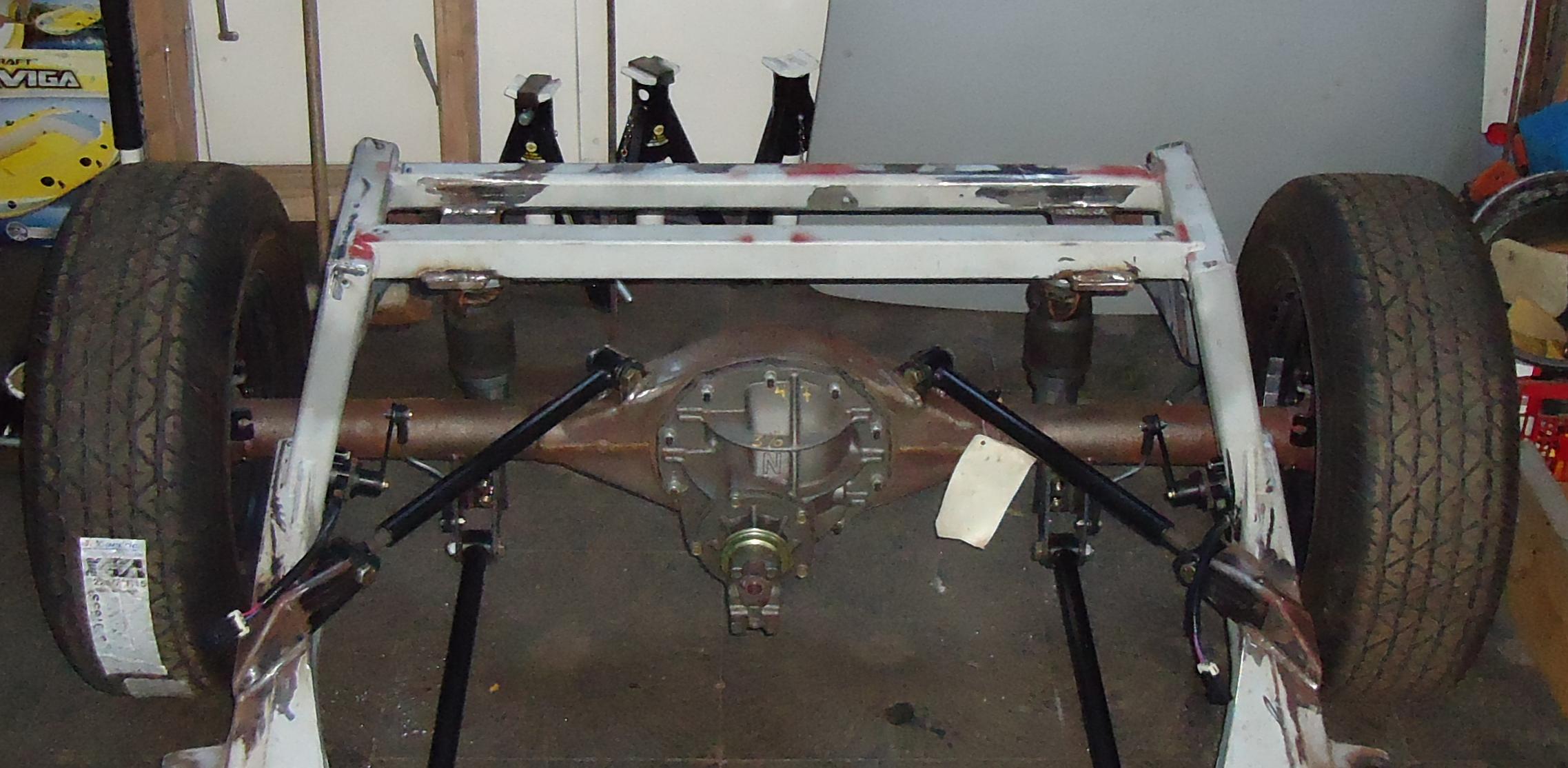

    Somedays everything comes together perfectly. Today wasn't one of those......I must have spent an hour or two just trying to figure out the best postion for the airride sensor. Clamping it in place, raise and lower the ch***is making sure everything clears.....again and again. Finally found a nice hidden spot inside the cross member.
    Next challenge was finding a mounting point for the arm. Thought of drilling through the lower suspension arm but opted against this. Finally thought of using the lower bolt holding the airbag in place. This meant increasing the radius of the rubber mount. Cut some copper and fitted it in there.
    I still need to fine tune the set up, but at least it's in place.........after 6 hours.......
