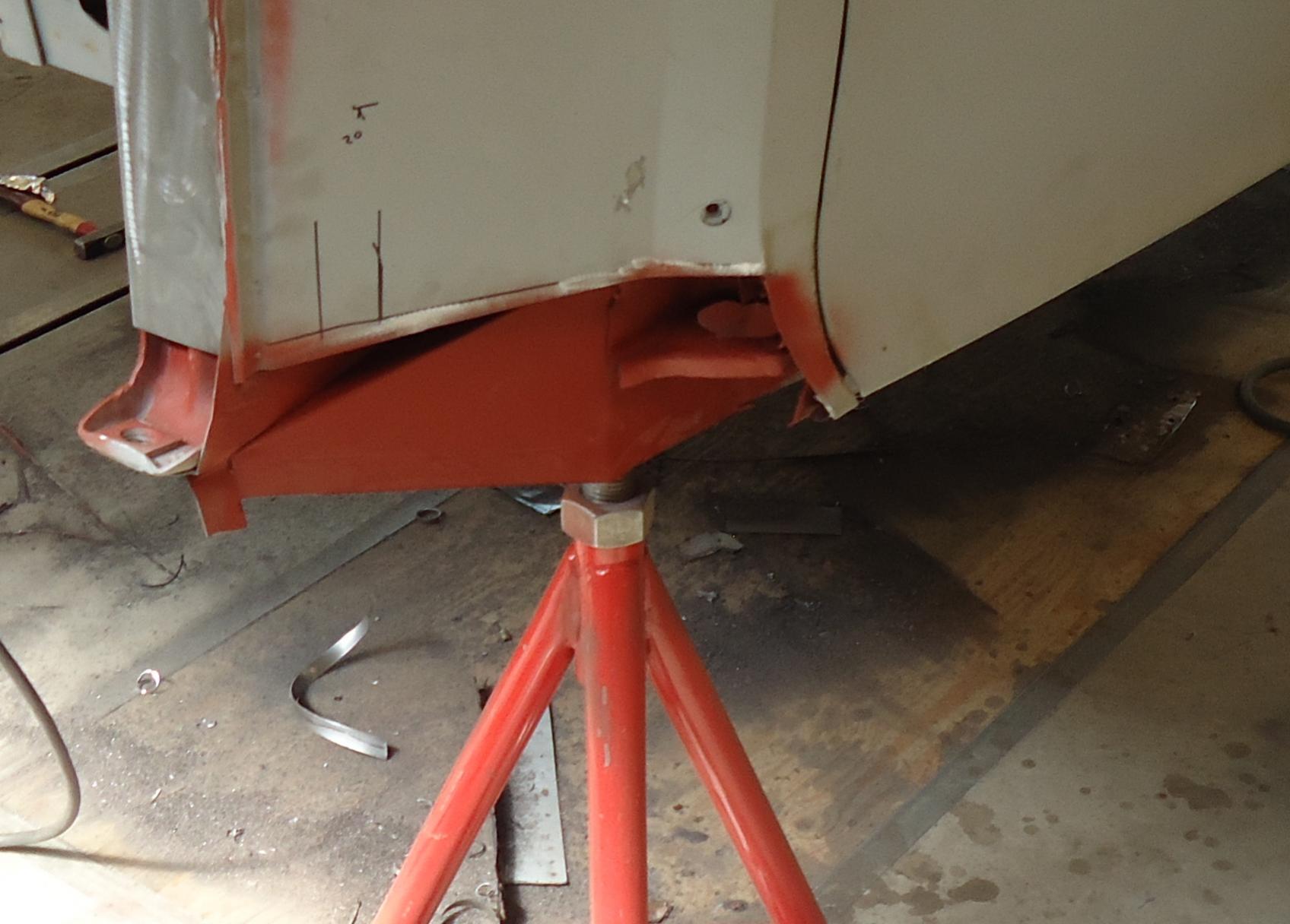

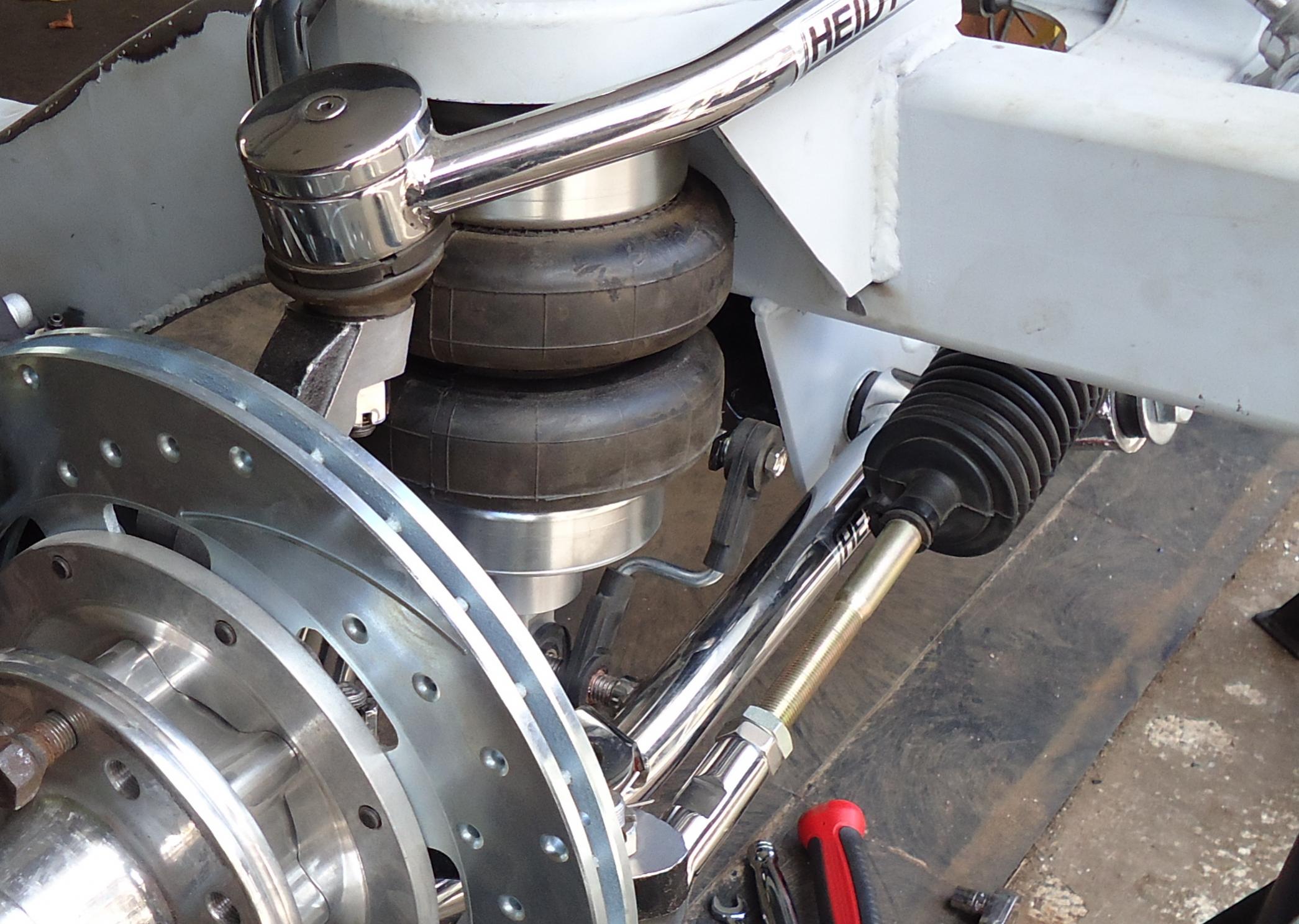

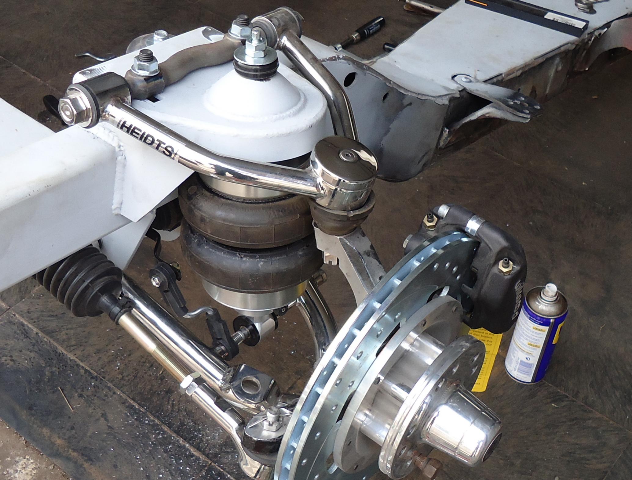

    Finished the right hand side sensor set up, after bending a rod and fine tuning it all.
    Next was the driver's side. This only took me about 4 hours to do. Nearly half the time it took me to figure out and complete the p***enger side.
    All in all happy with the progress. Back to bodywork on monday.:)

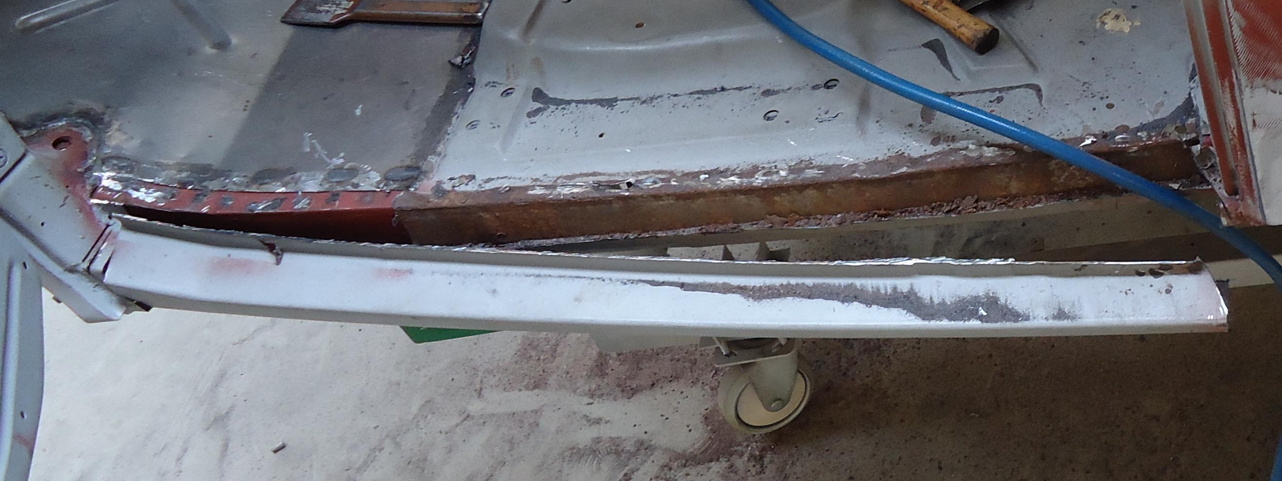

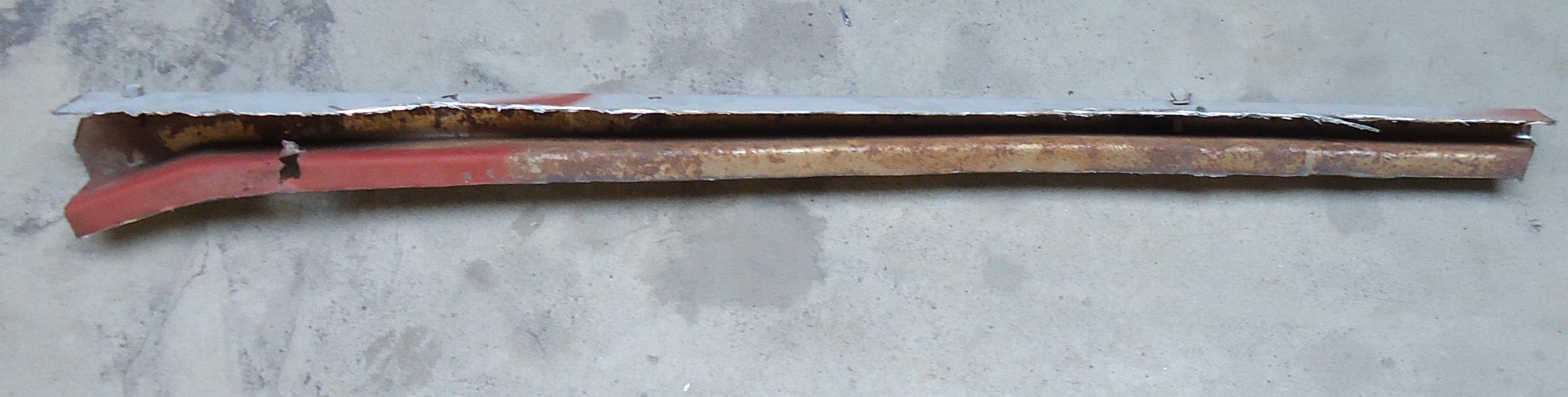

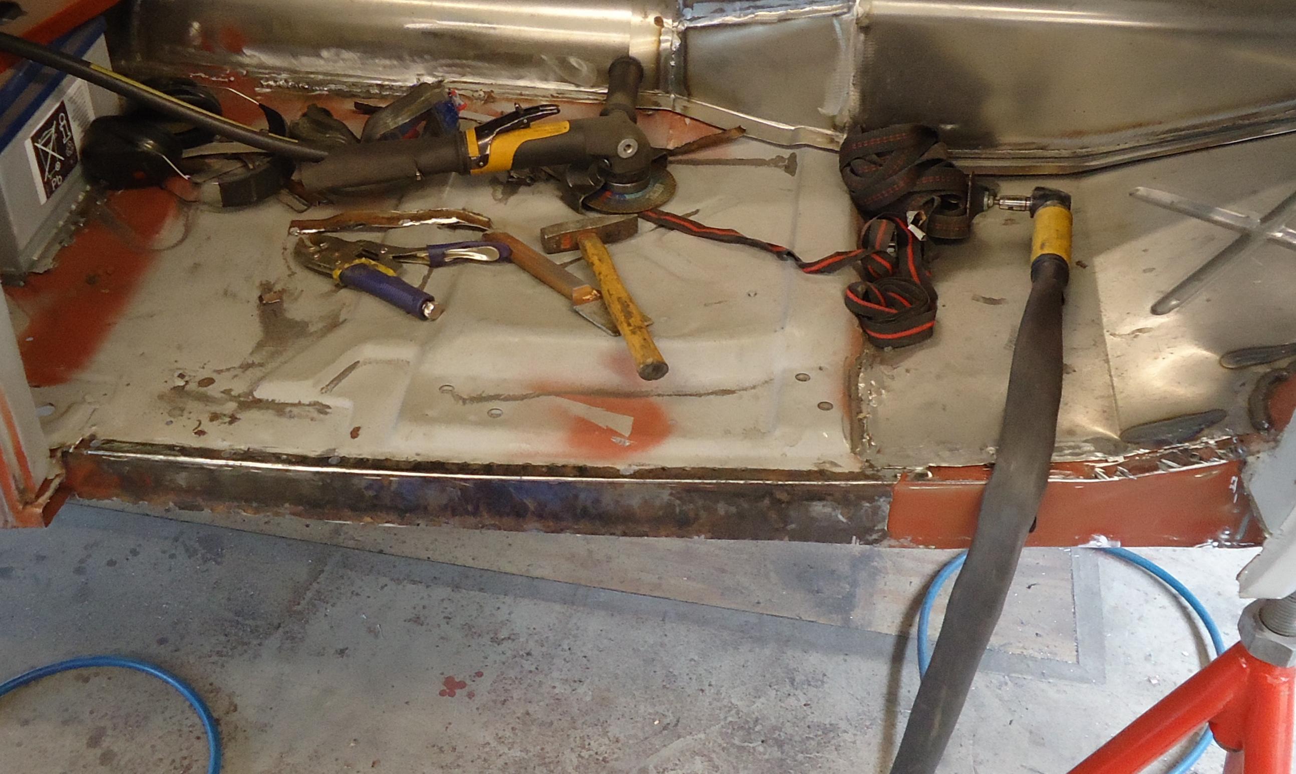

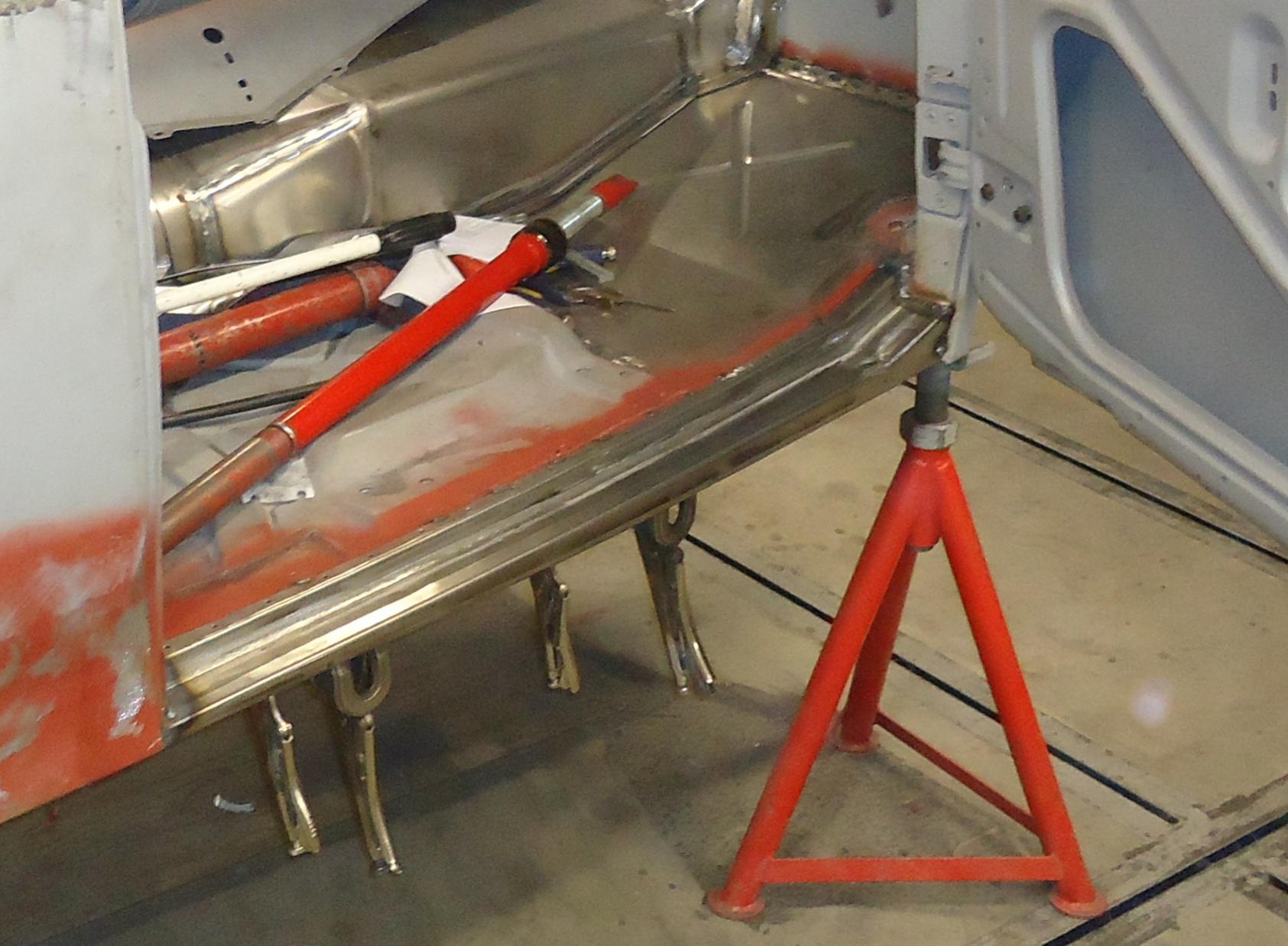

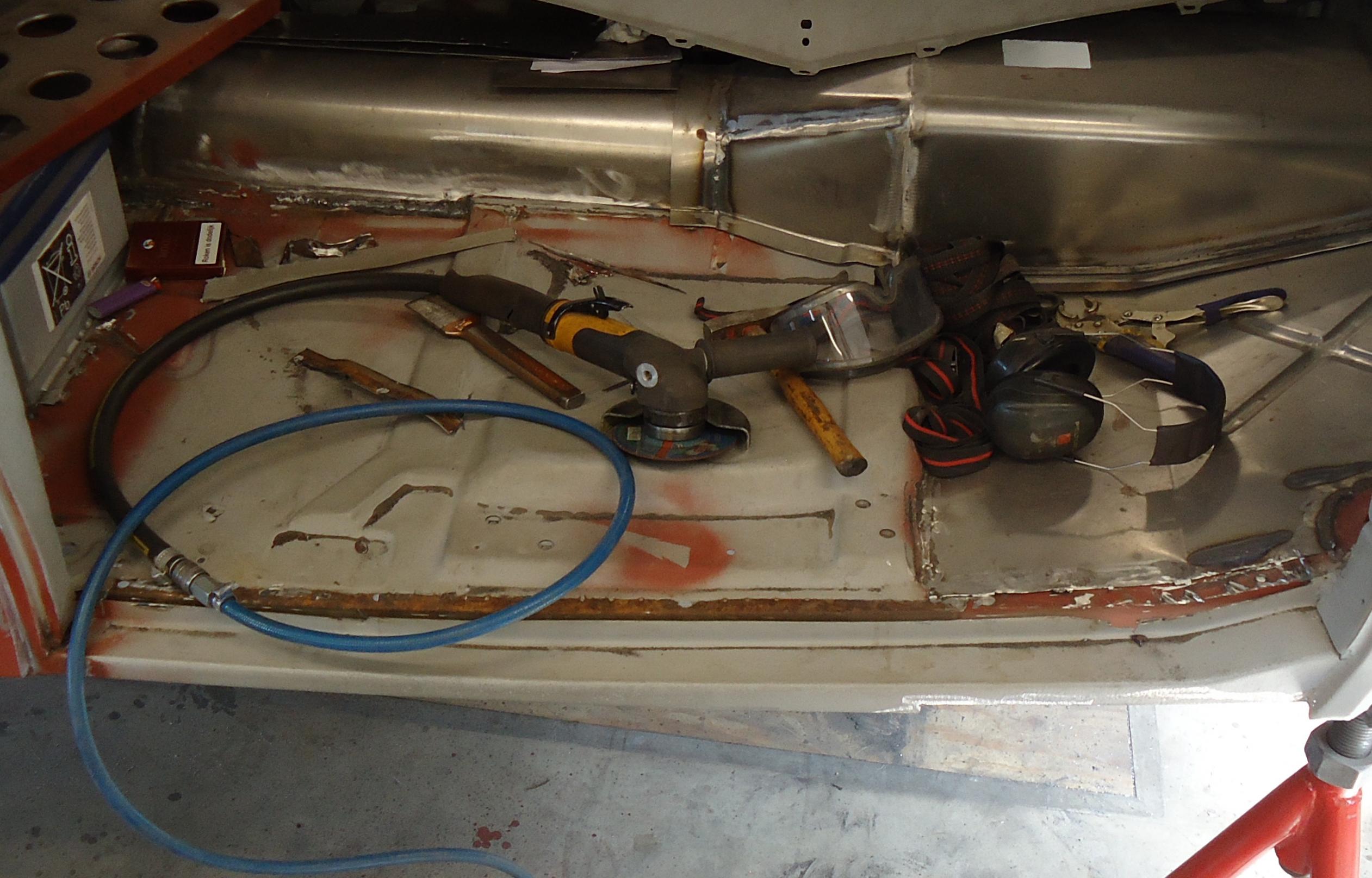

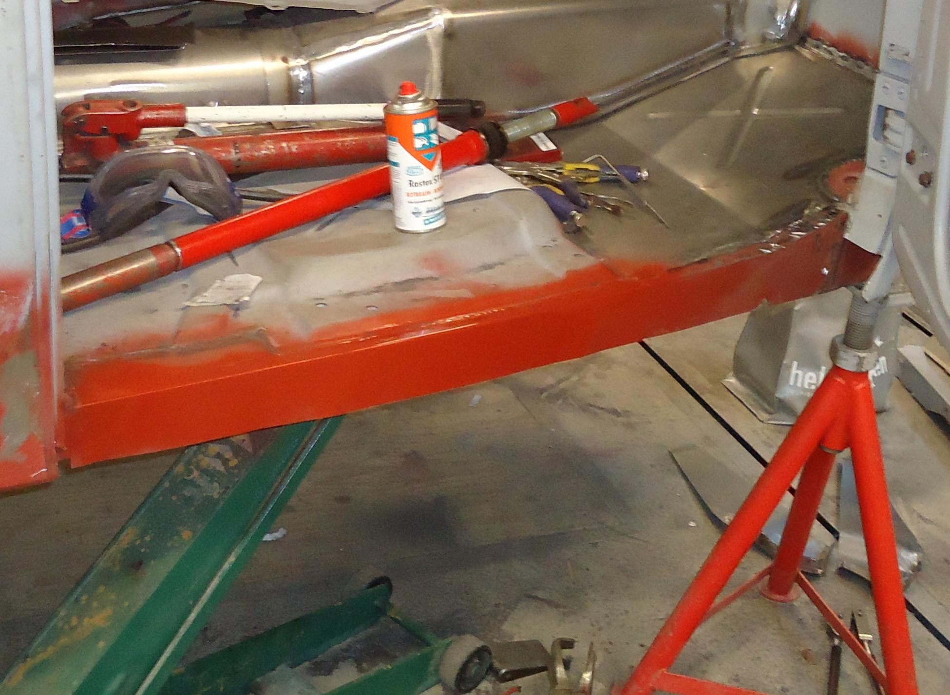

    It's rocker panel time! Like I have stated before in this thread, I ordered a new set of rocker panels from the Plymouth Doctor. I was hoping for a test fit today, but ran into a few things.
    First of all, it took me twice as long as anticipated to cut through the old spot welds. Second, I did not like the look of the inner panel, so this will be replaced as well. Now I do have an inner rocker from the Plym Doc, but considering the floor area near the rocker is not perfect, I'm going to fabricate something tomorrow to incorporate the two. Things always take longer than you think.....

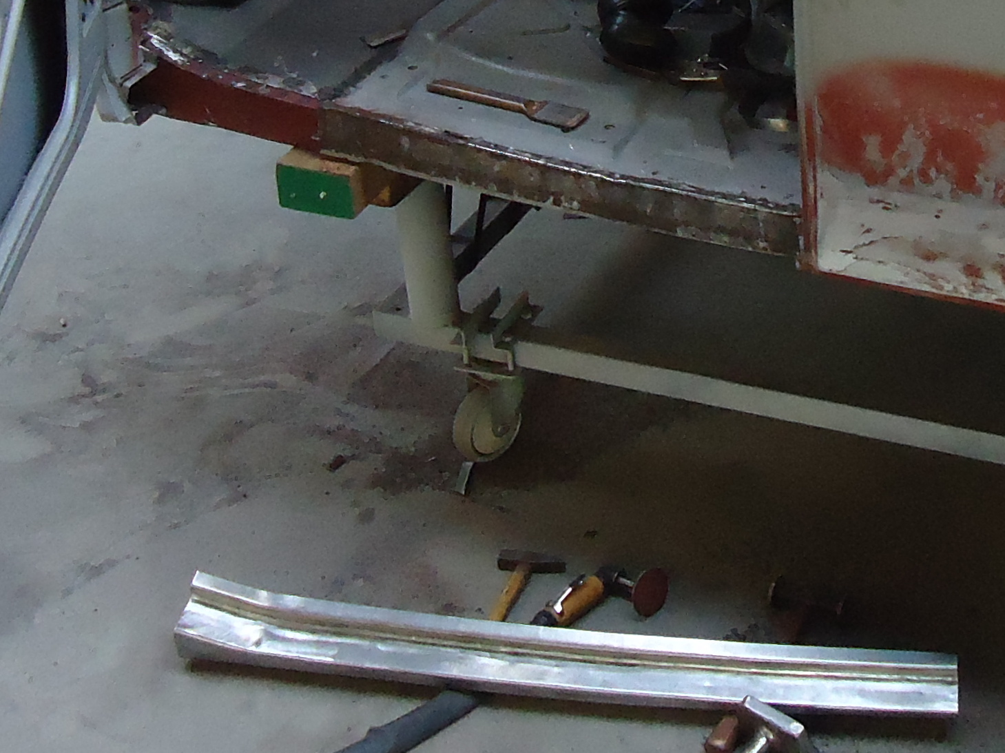

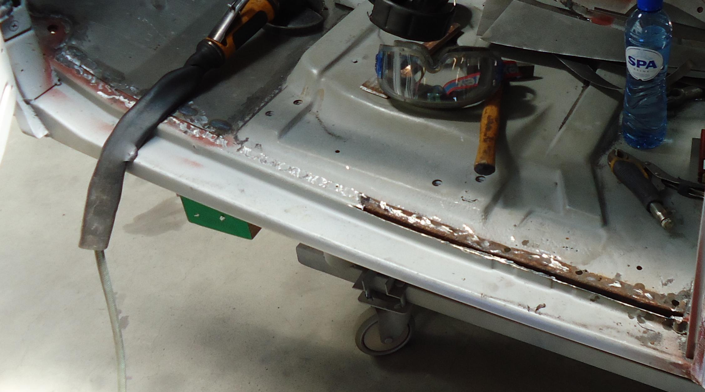

    Couple of more pics. The new rocker panel waiting to be installed. With a bit of luck, it will be welded in place by tomorrow night.

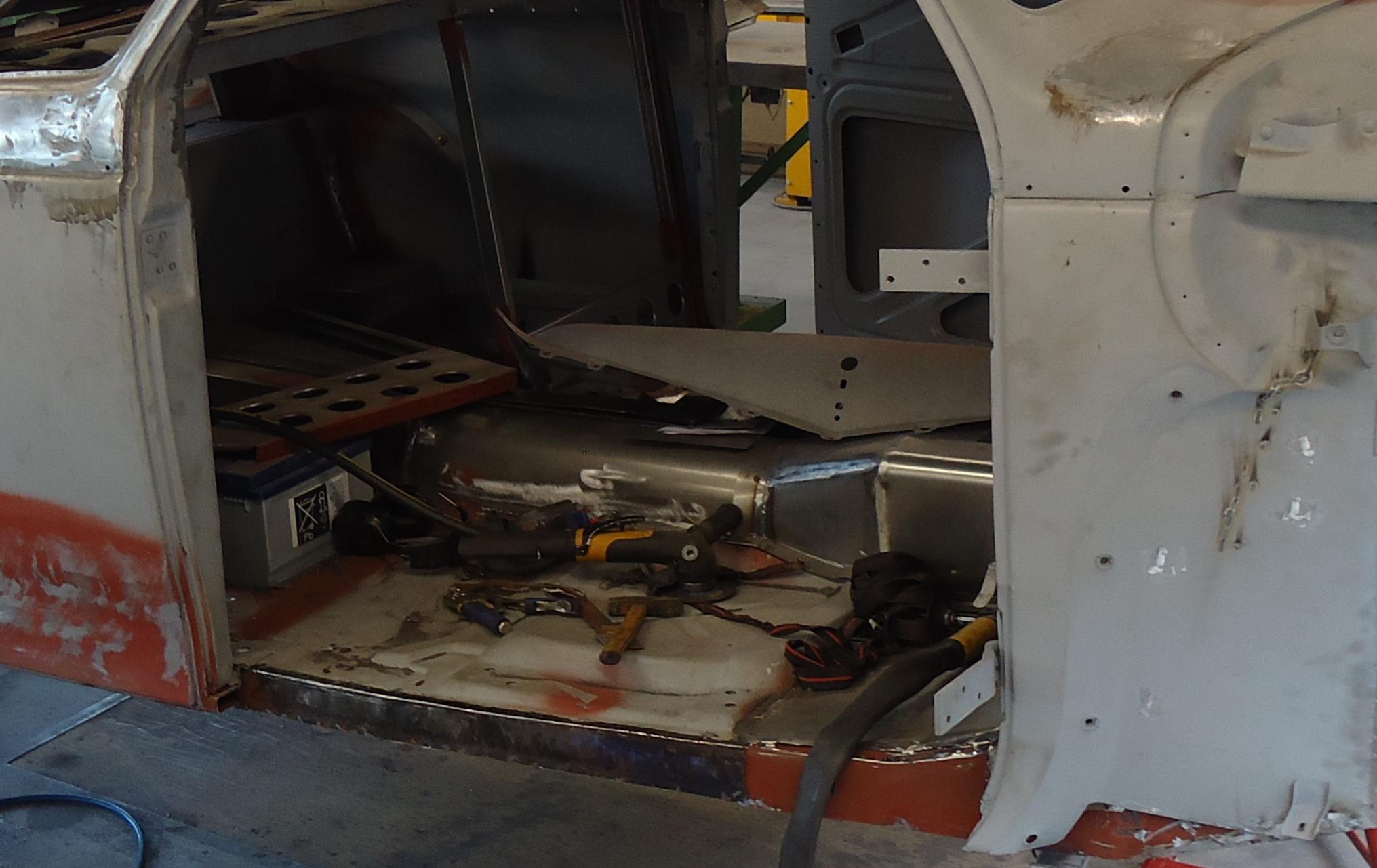

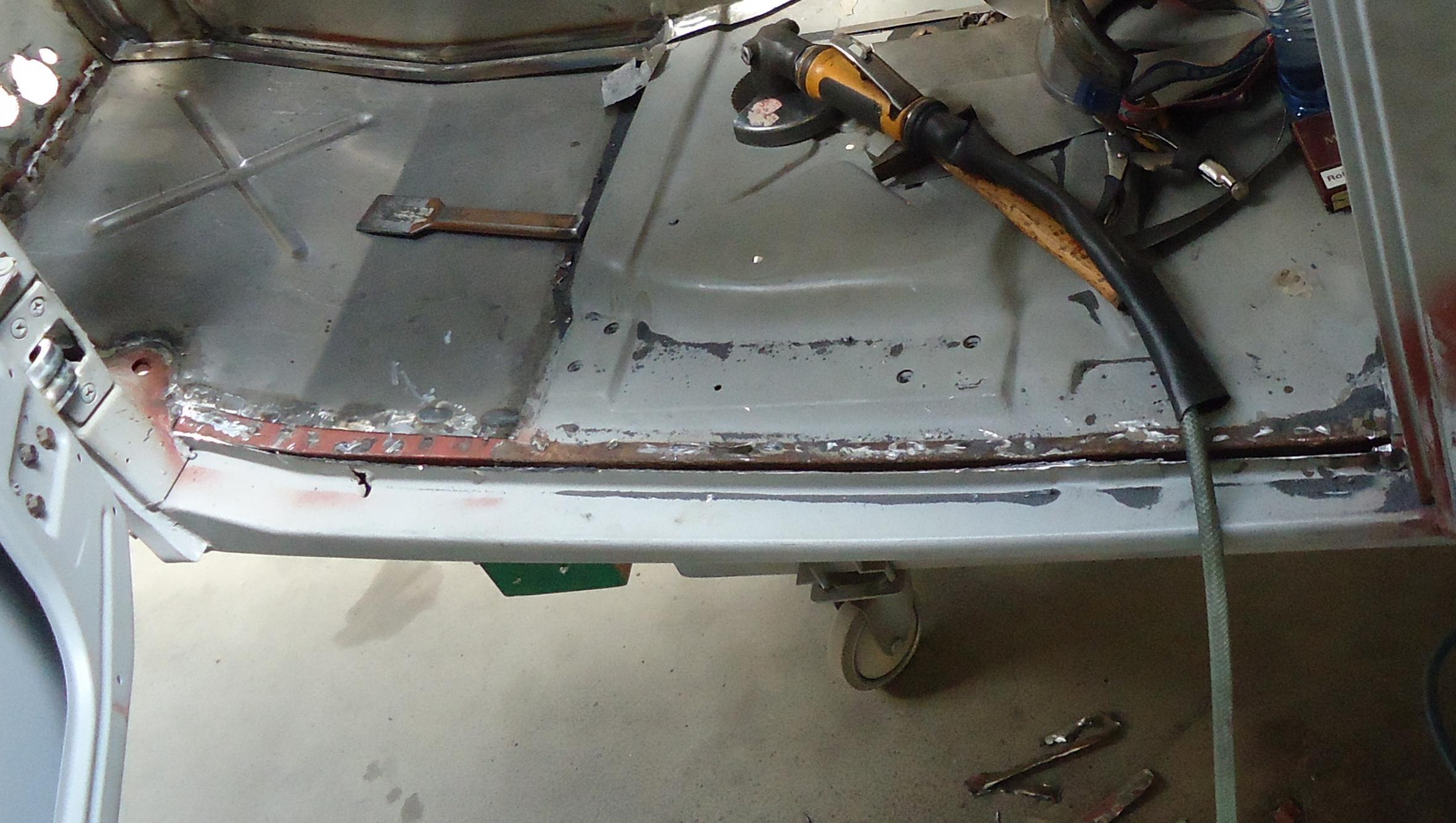

    farmer12

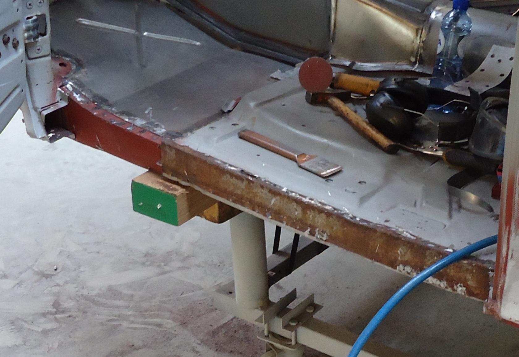

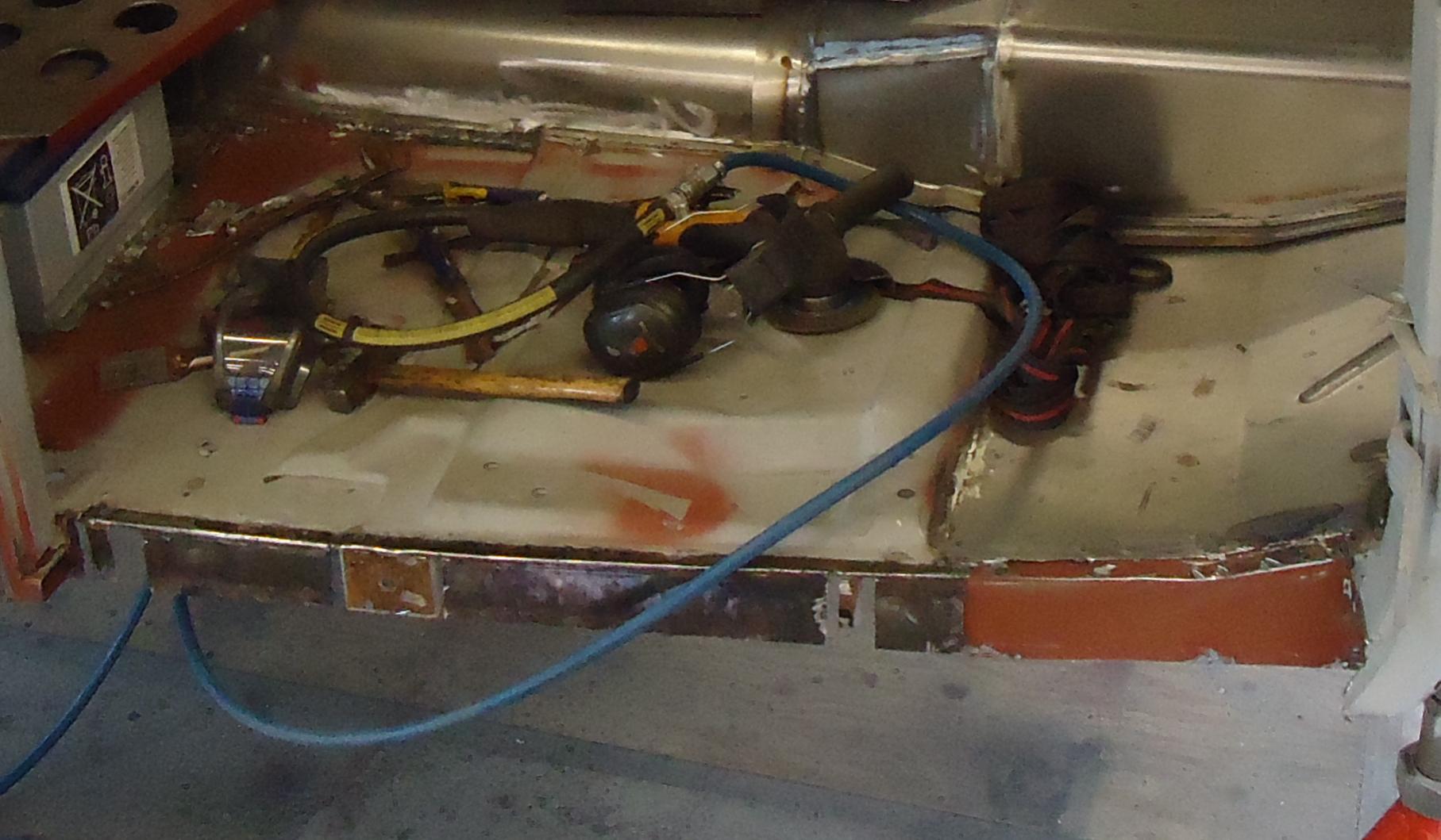

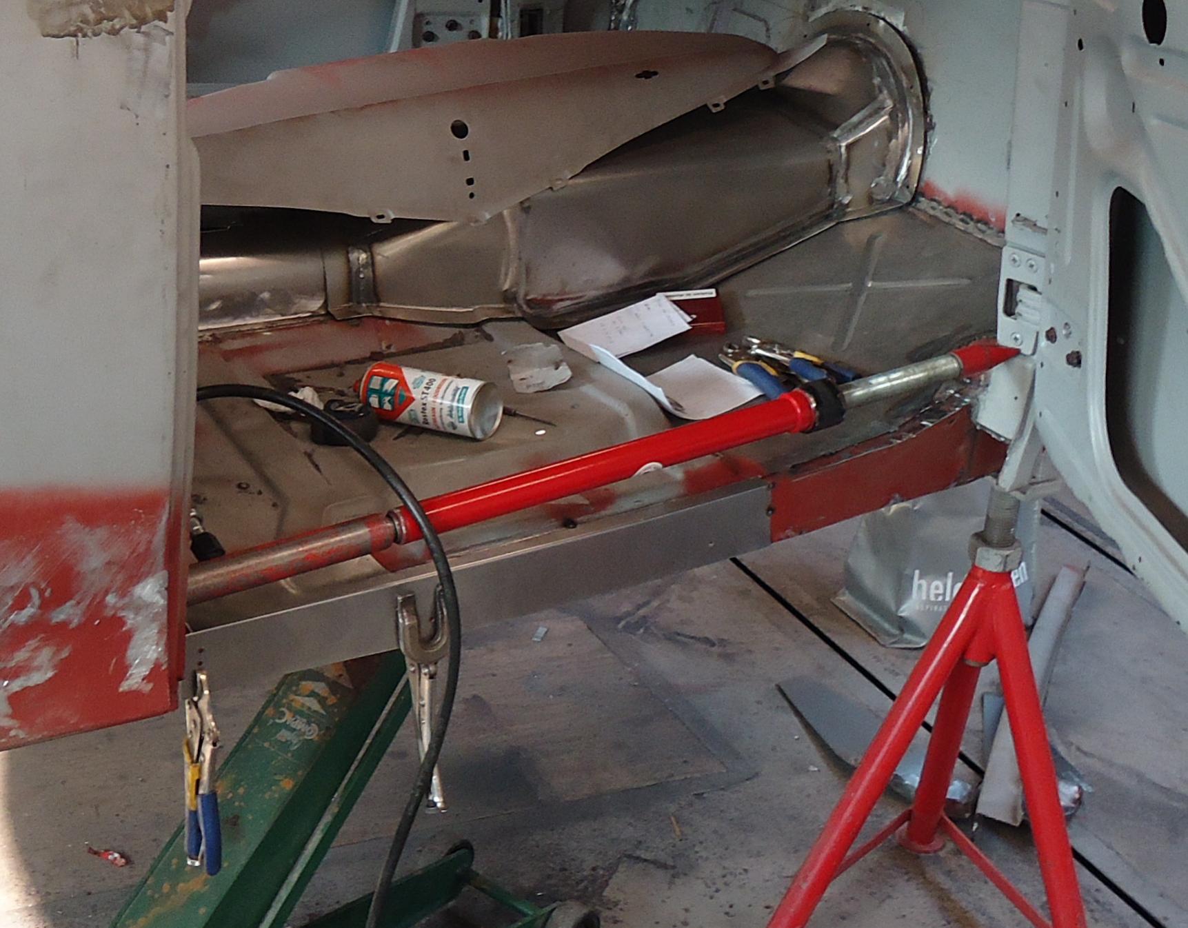

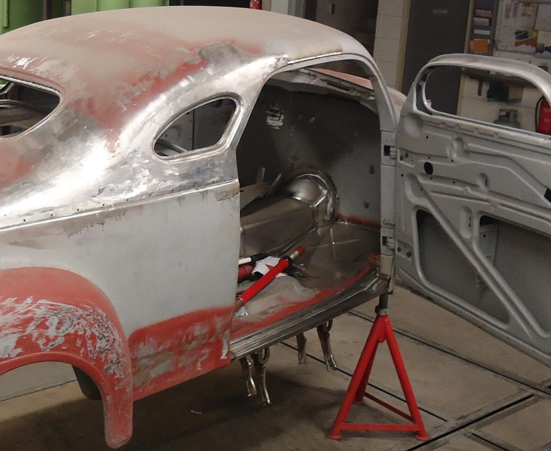

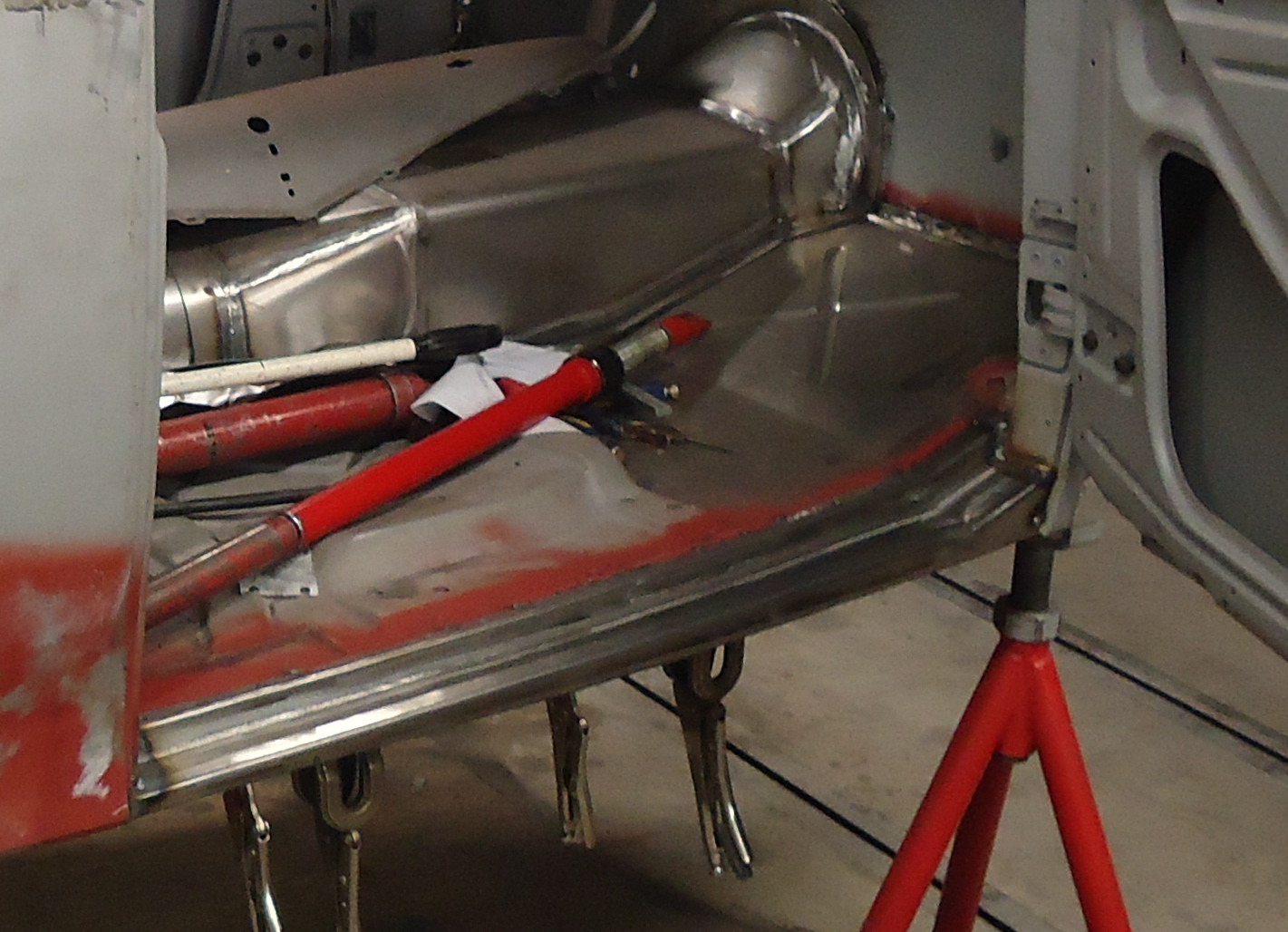

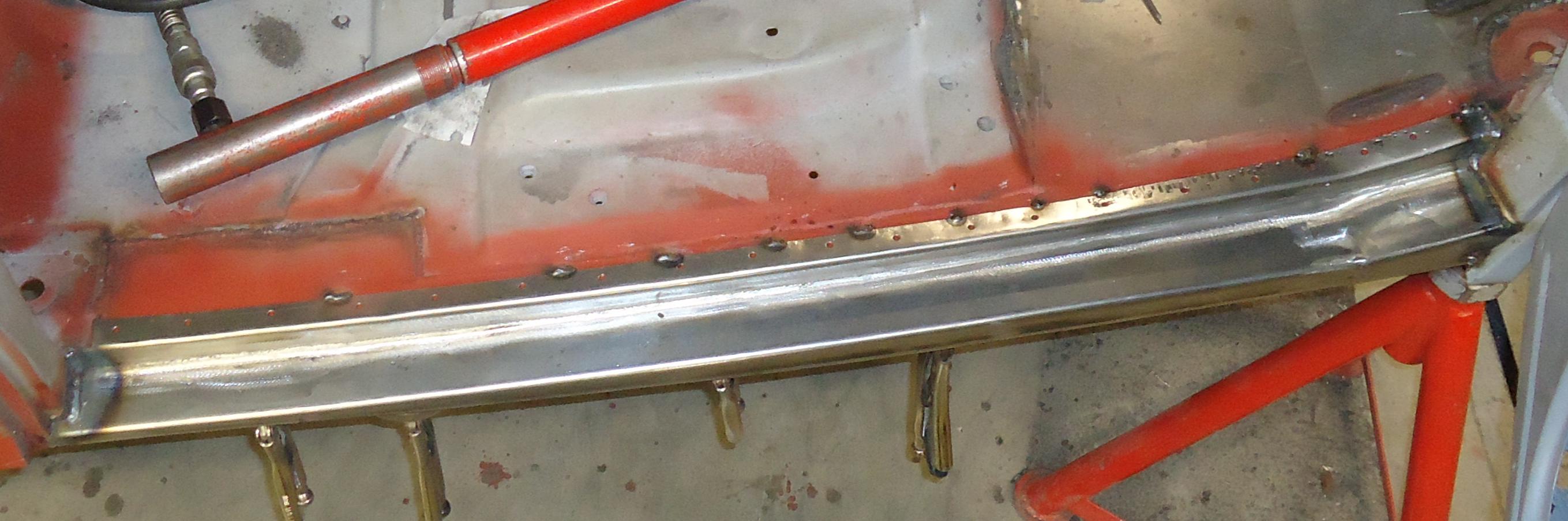

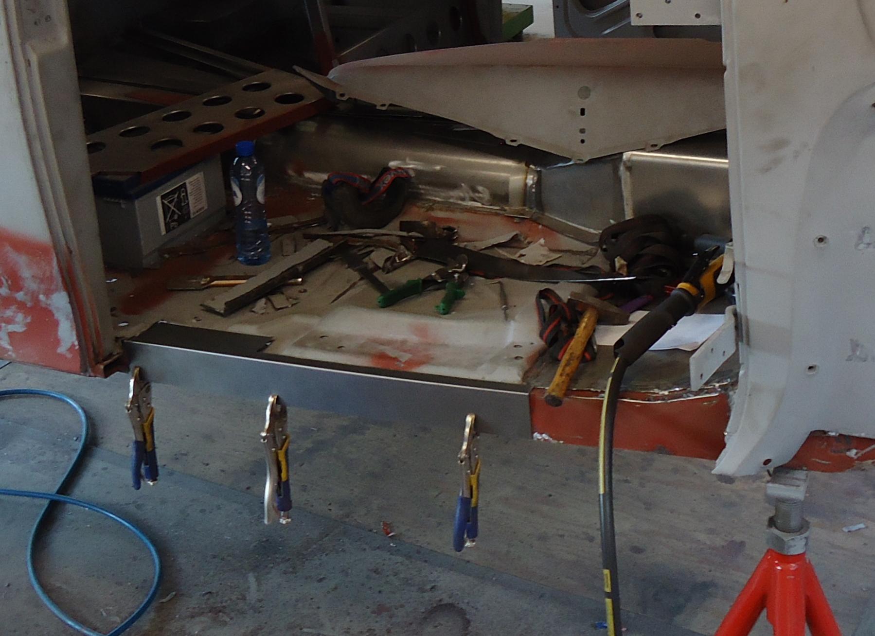

    The initial plan was to install the inner and outer rockers on the drivers side, instead I attacked the right hand side first today.
    I started with grinding out the old welds, and removed the outer rocker. Then cut around 3 floor mounts and remove the inner rocker panel. Considering the floor had some small rust, I decided to incorporate this in the inner rocker and clamped down the newly fabricated steel. More fine tuning required....the front part of the inner rocker had already been replaced when I did the floor.
  20. farmer12
    Joined: Aug 28, 2006
    Posts: 7,723
    farmer12

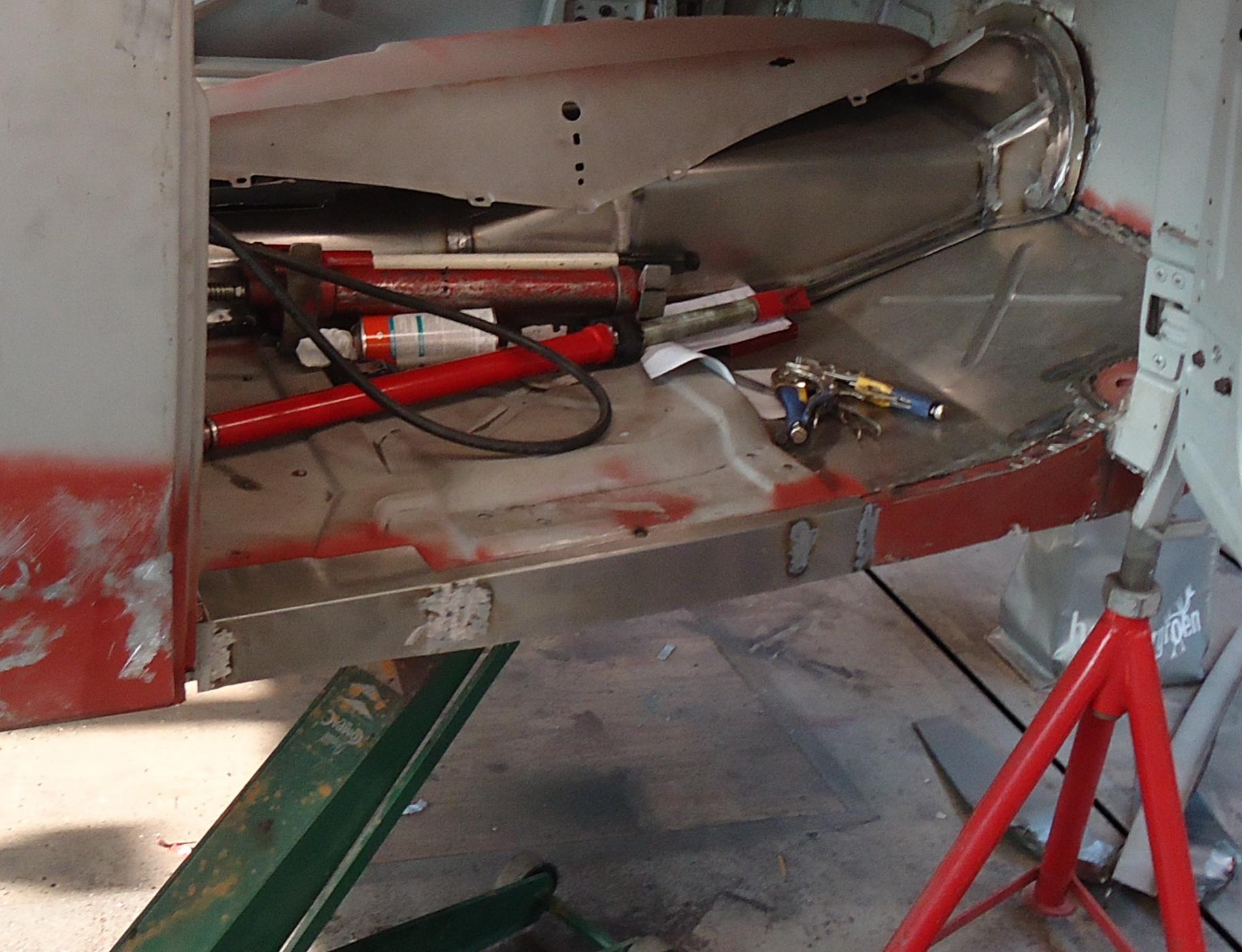

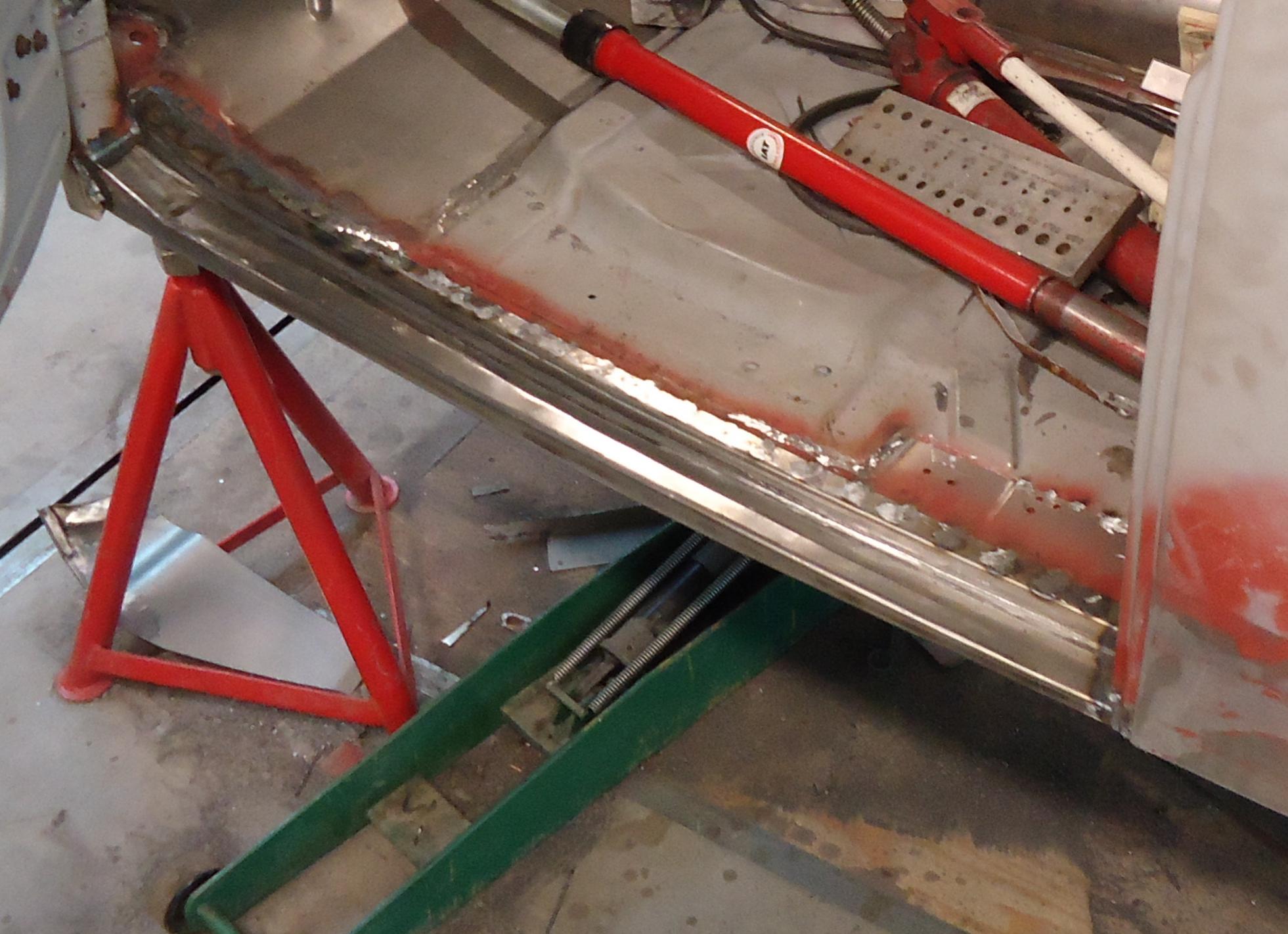

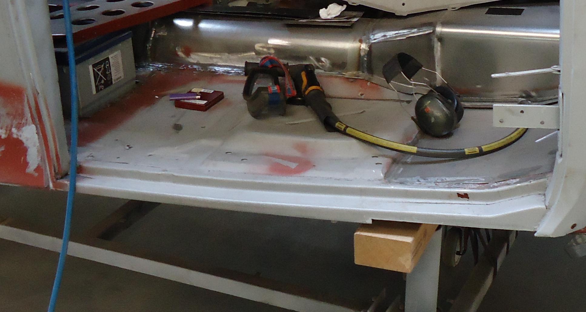

    But wait, there's more! After minor adjustments on the inner rocker, it is now welded in place and the usual grinding done.
    Next was the outer rocker panel, ordered from the Plymouth Doctor. After a test fitting, we (Martin and I) found it did not follow the contour exactly. Especially the upper part, it came out half an higher above the floor in the center. We probably spent close to two hours reworking it before we had the desired shape. Then used the horizontal hydraulic jack between the a and b pillar to ensure no changes would occur during welding. Going to finish off the welding tomorrow.

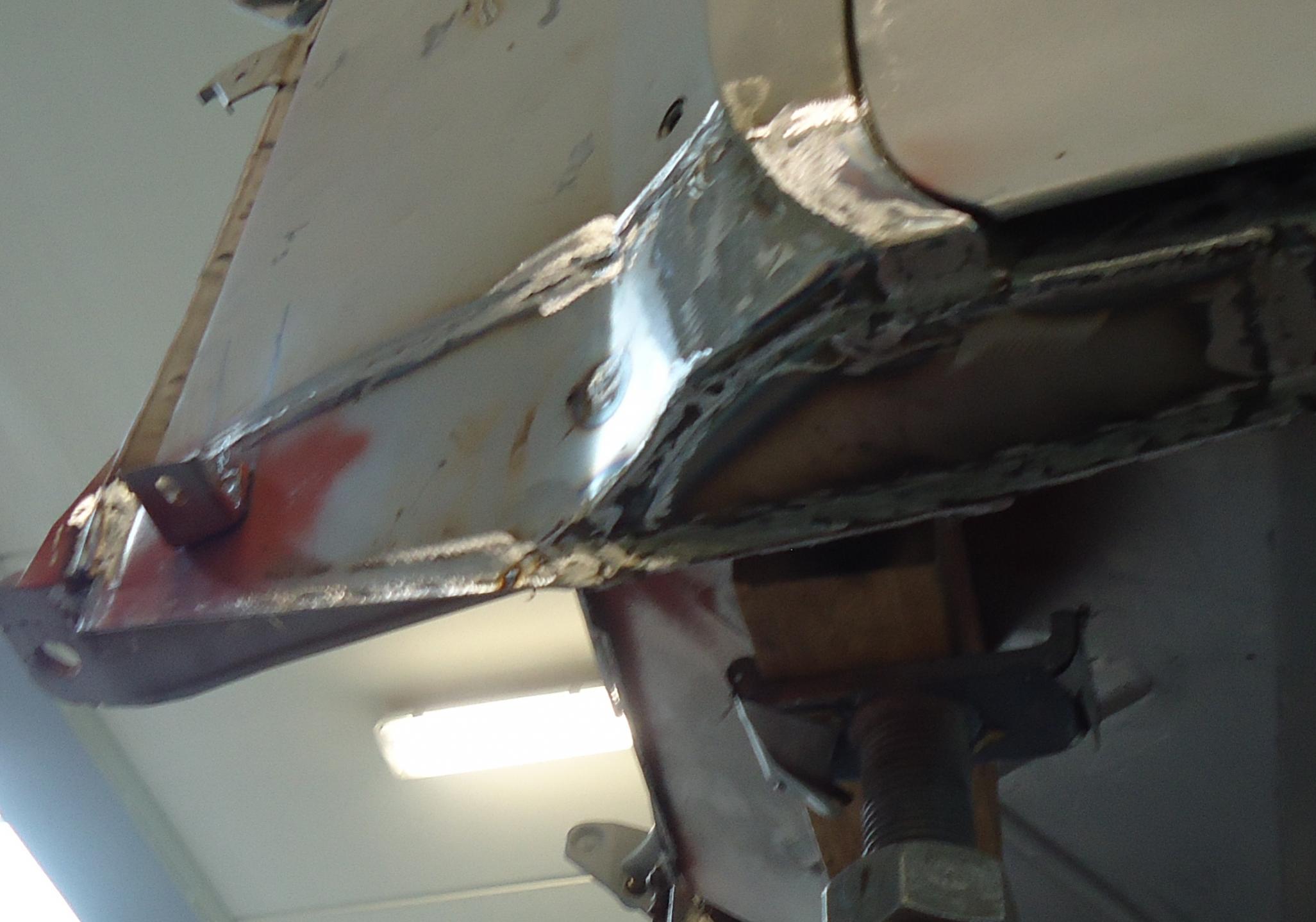

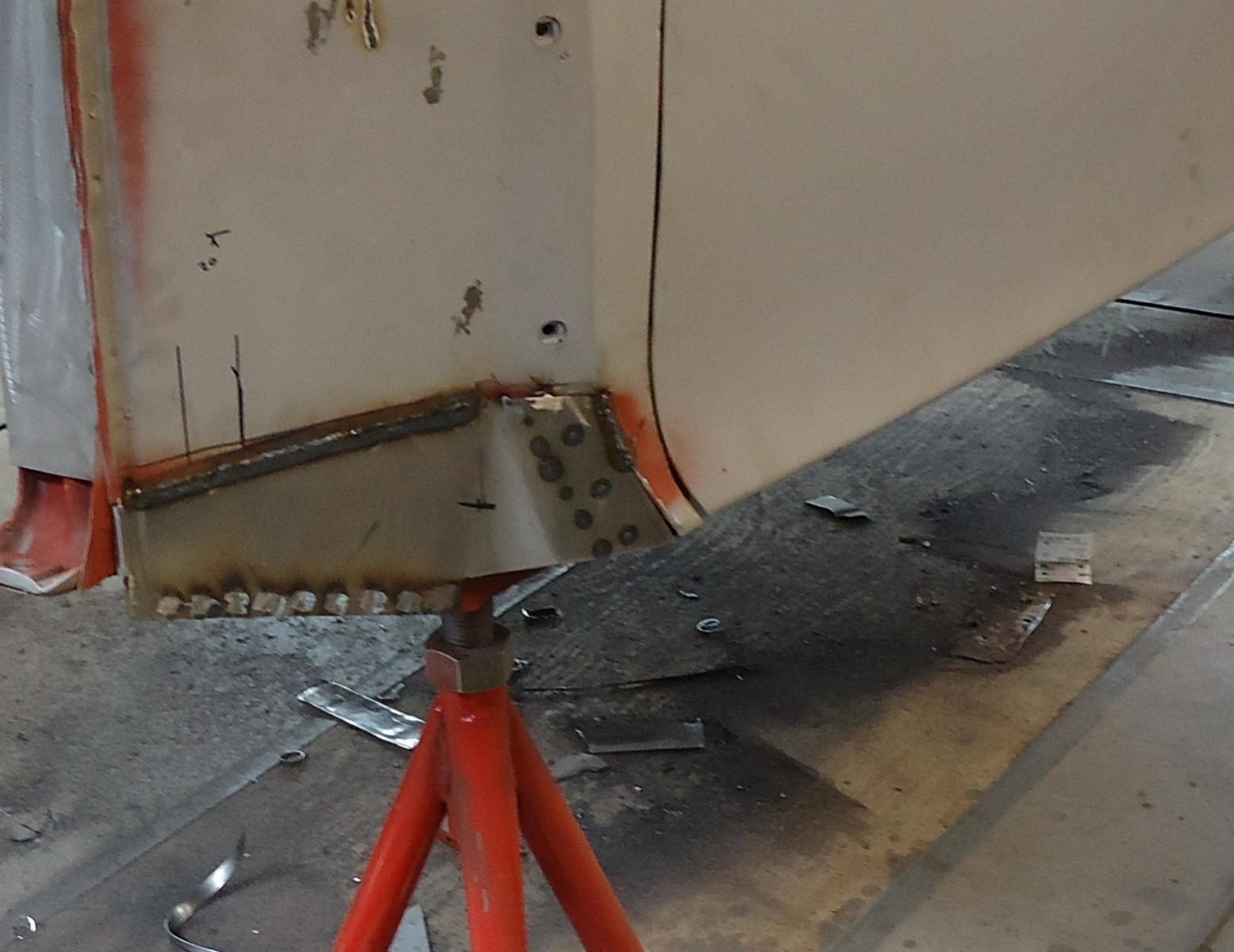

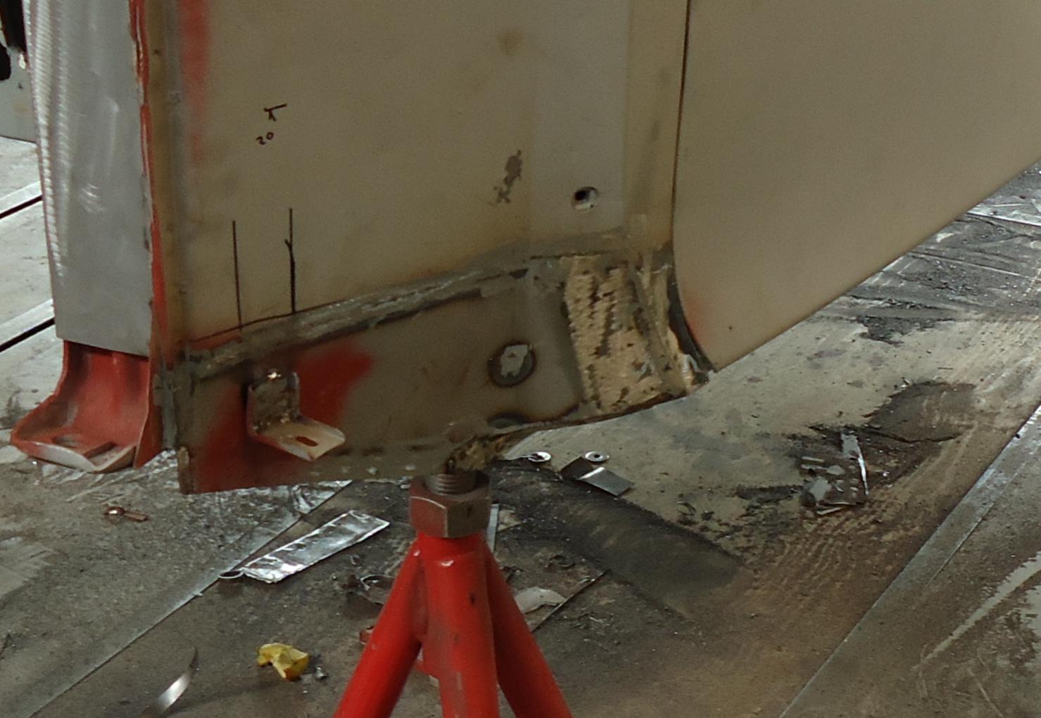

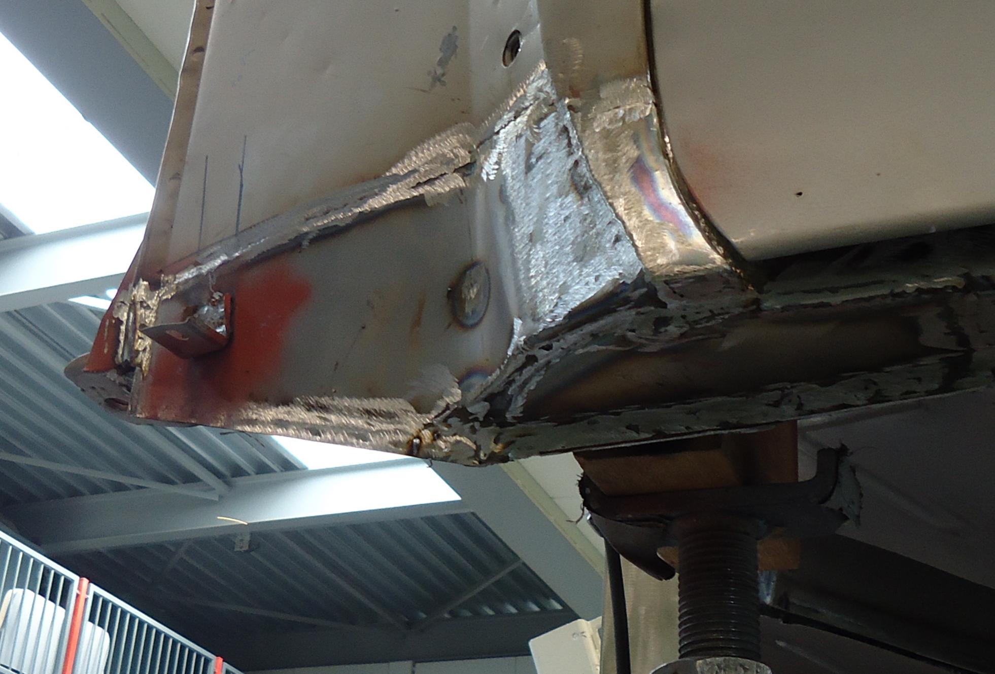

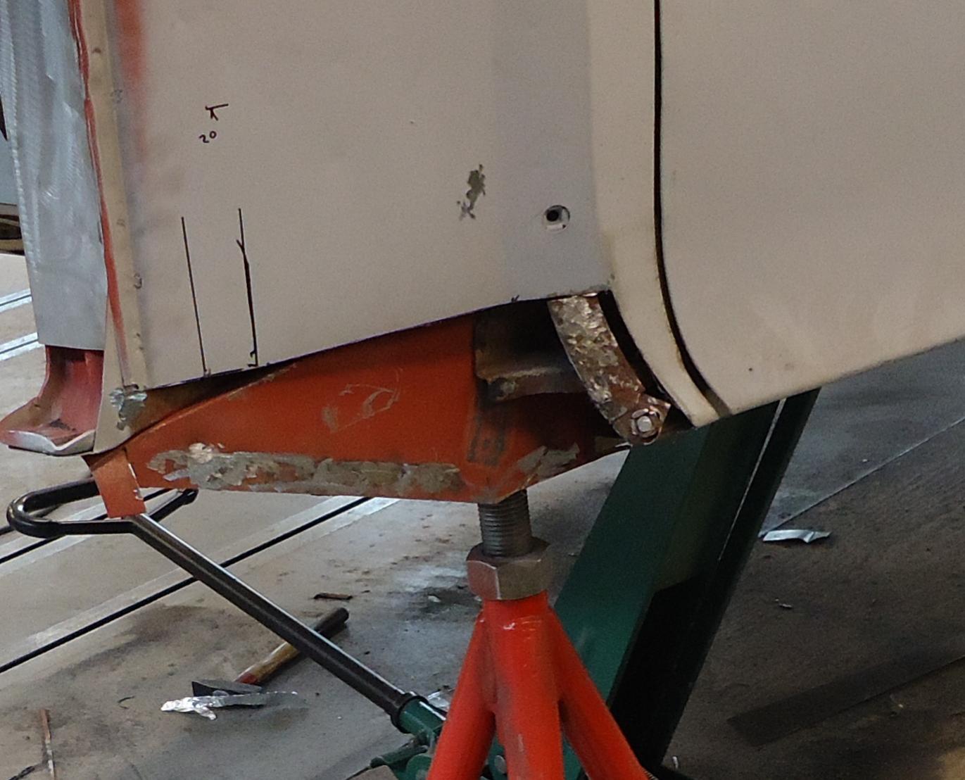

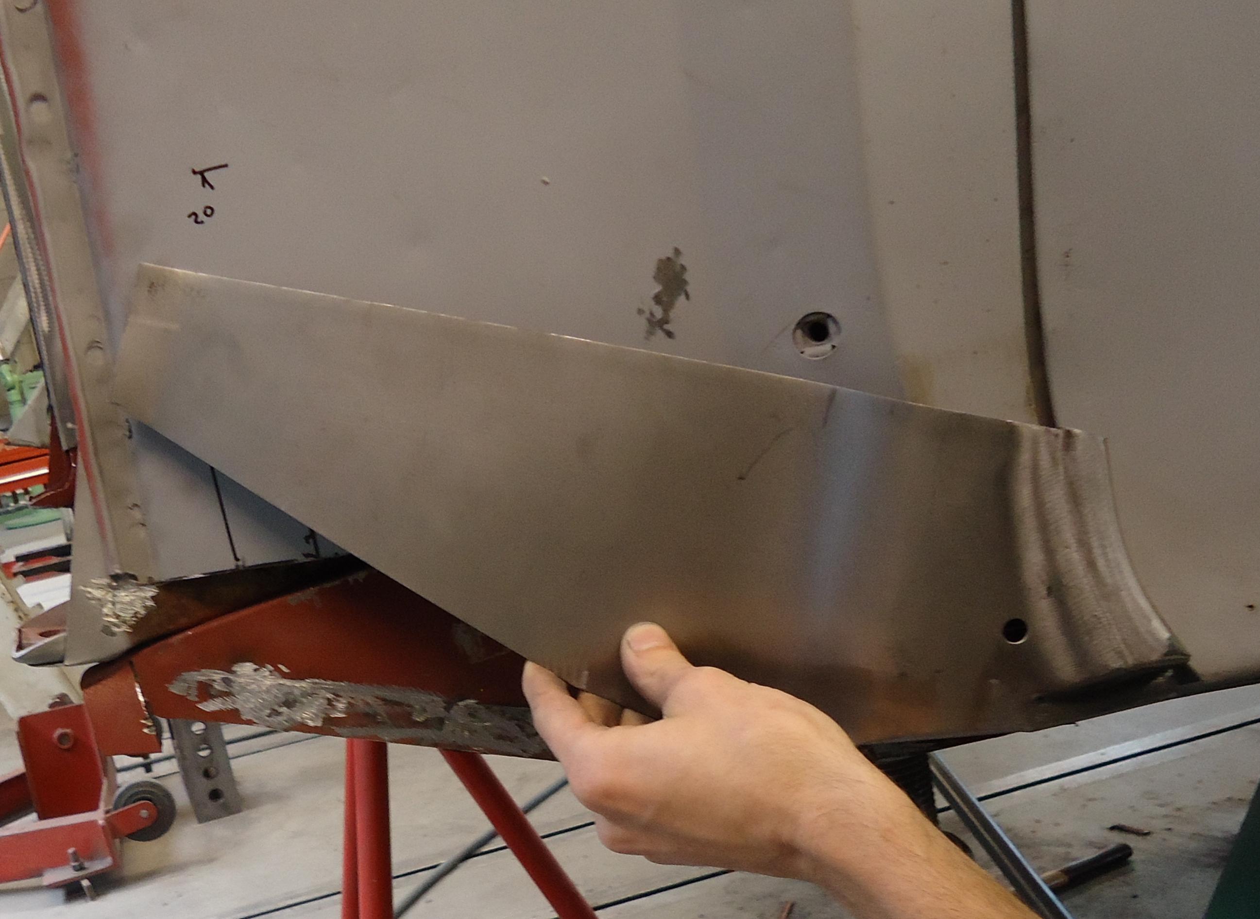

    Finished off the left hand rocker panel, after a bit of modification.
    Next on the list was the lower cowl. I ordered the cowl repairs from the Plymouth Doctor, but there was no way they fit. I'm the last person to say it can't be done, but the shape was all wrong. Even the holes were in the wrong location.....These parts will be returned to sender.
    Nothing else to do but make your own. My buddy Martin and I went ahead and fabricated them ourselves.

    Continuing on from my last post, welded the cowl patch panel in place. Now underneath the front of the rocker panel still needed some attention. Martin and I incorporated this with the small piece between the door and cowl. Came out looking good and giving added strenth to the whole structure.
