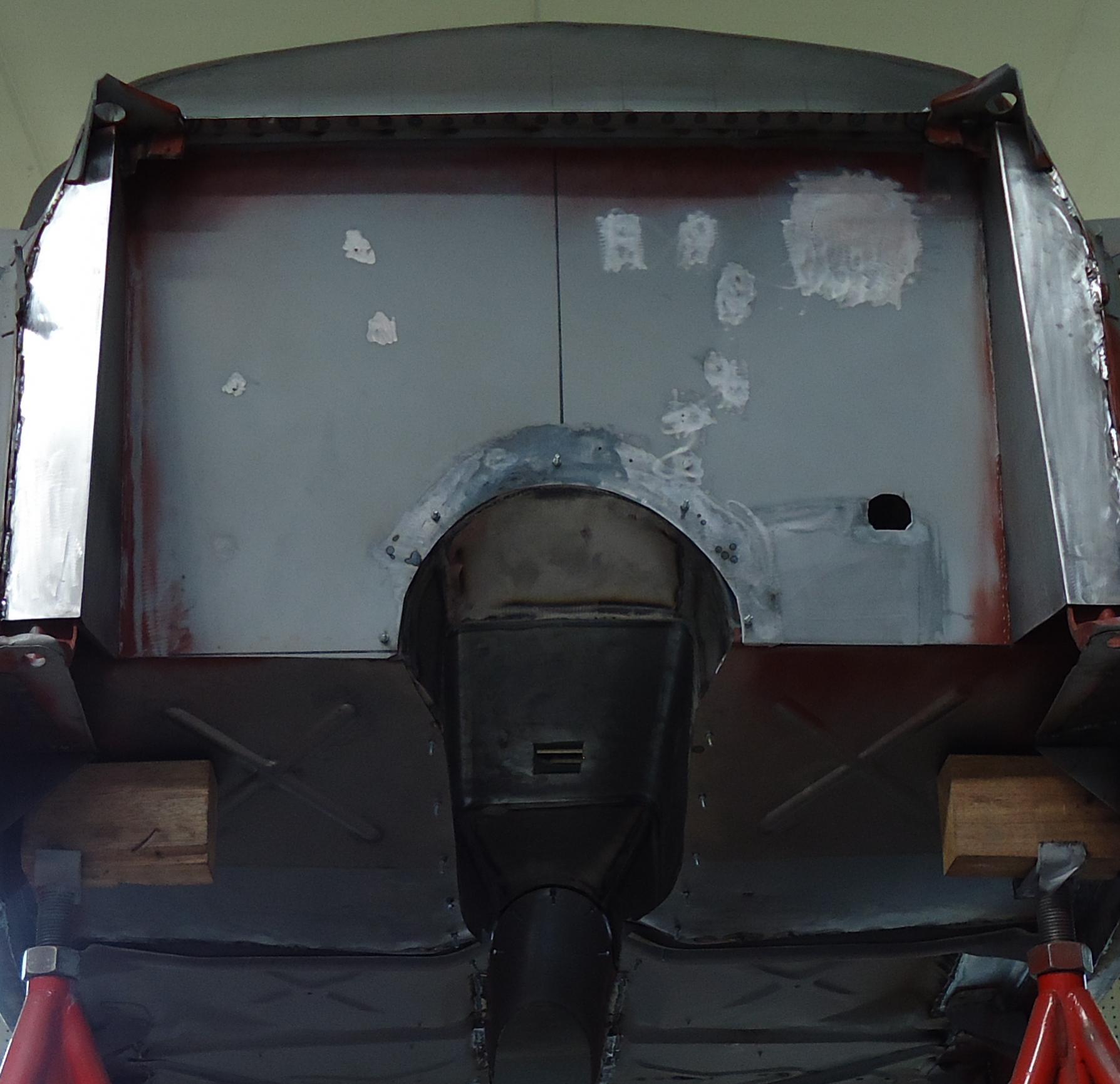

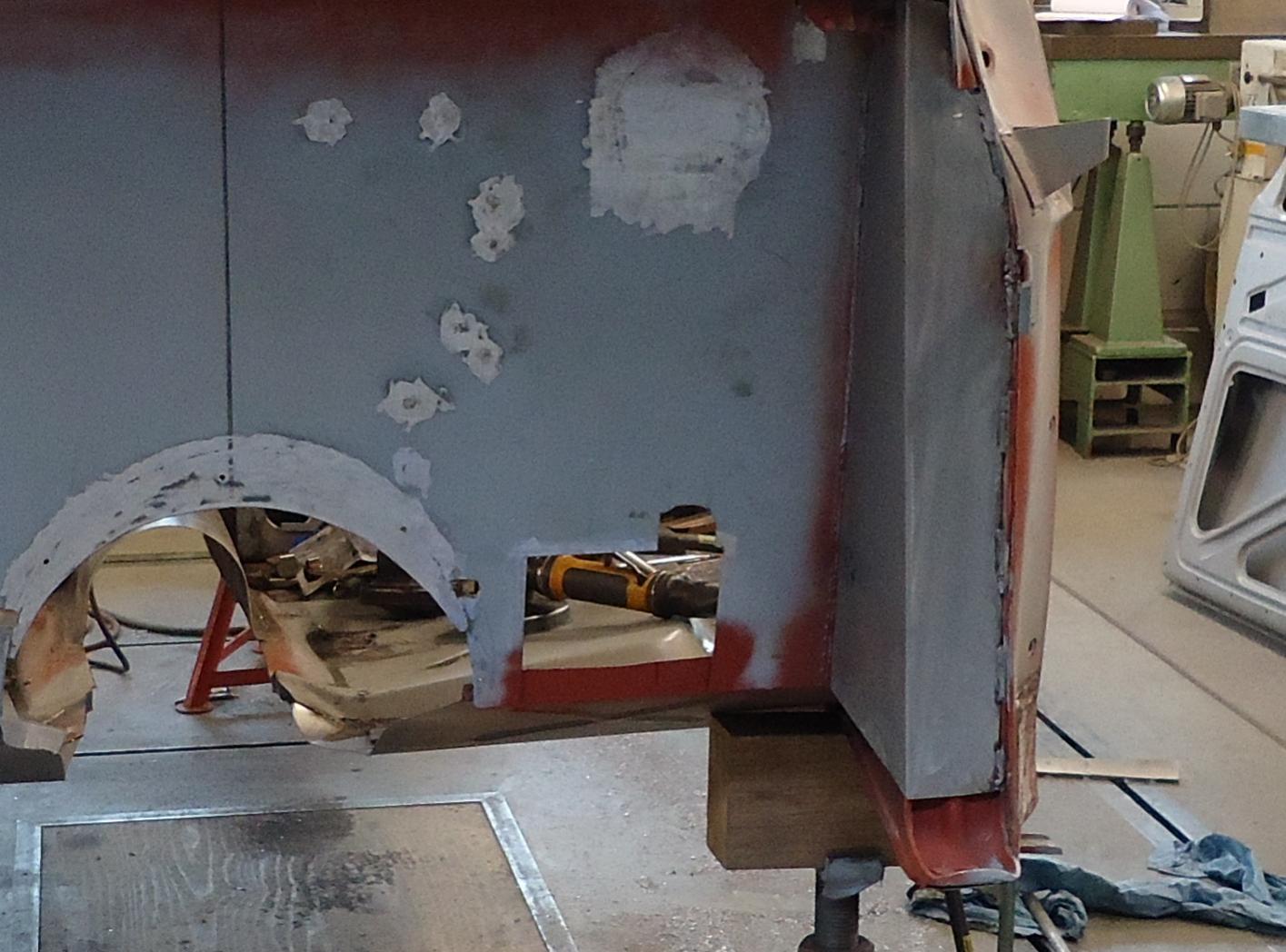

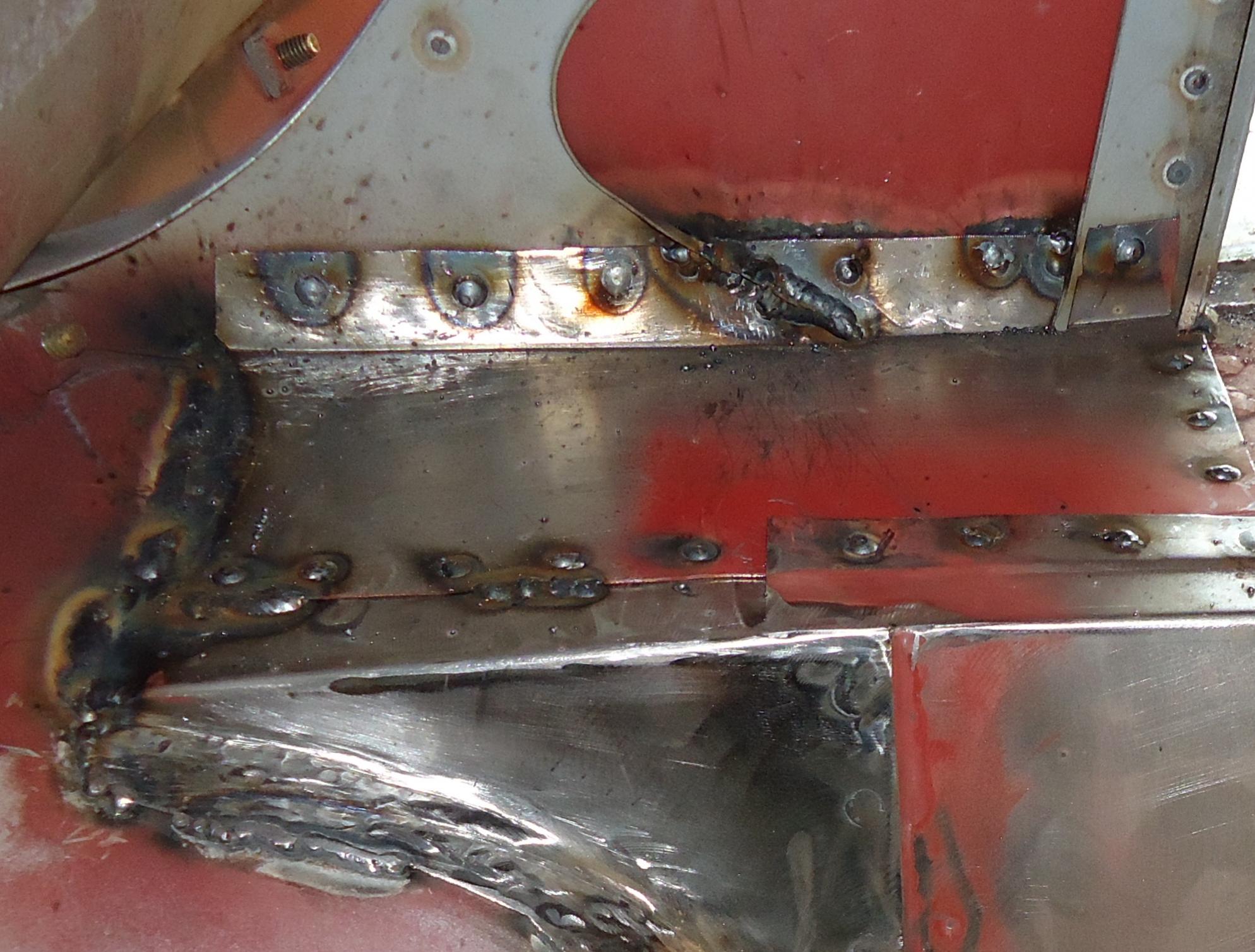

    Next on the list was the lower part of the firewall, in particular around the steering column hole. The previous owner had welded on an extra piece(?) to cover some holes. From the inside I cut the welds and opened it up. Then cut steel 3mm to size and welded it in. There is still some welding to do on the firewall and will finish that tomorrow.

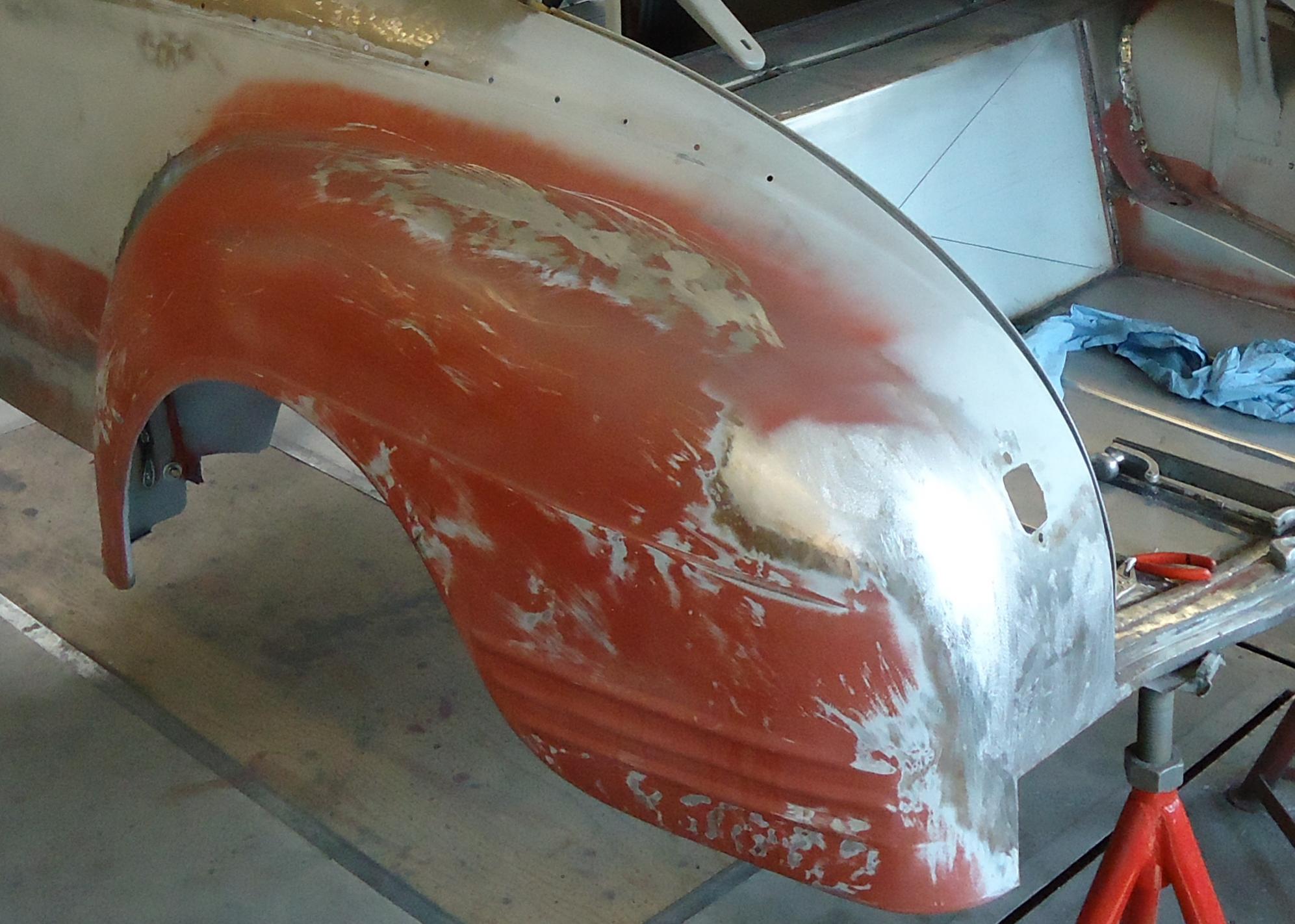

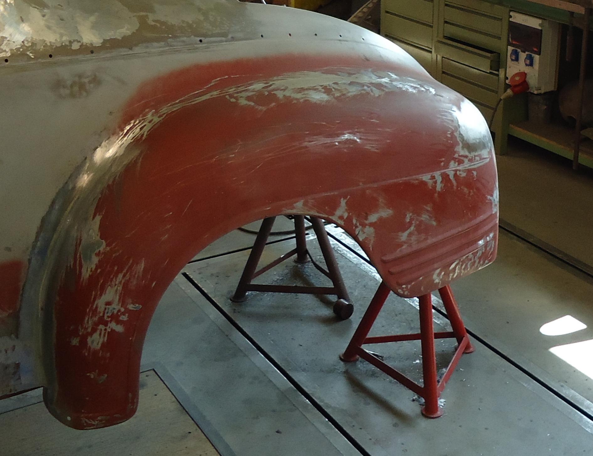

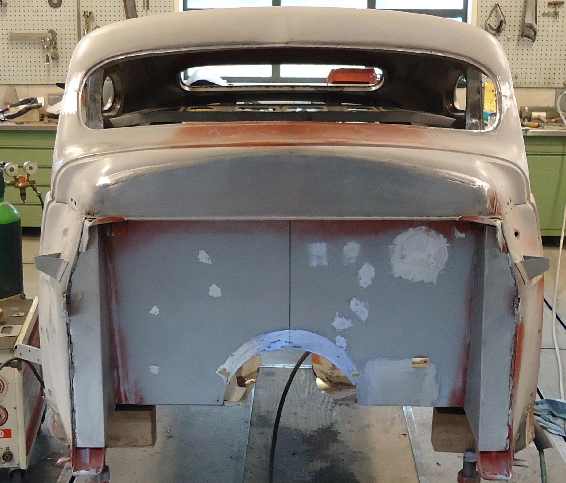

    The lead work on both rear fenders are now done, including the small area below the tail lights. Going to smooth it out with 180 grit before I remove the red primer. I'm very happy with the end result, much better than before. It creates a very nice flowing line which compliments the overall shape of the car, in my opinion.

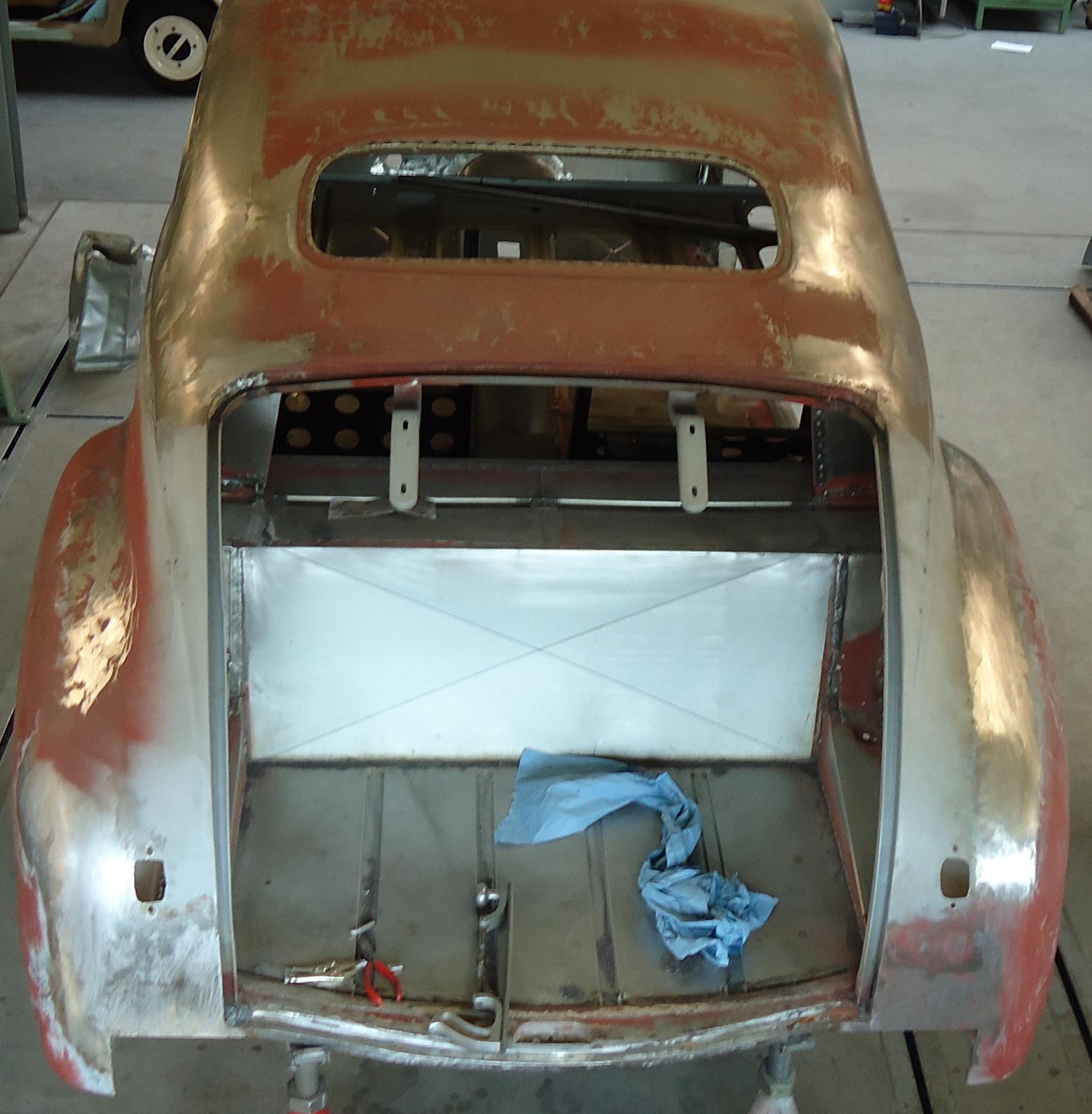

    Finished off the final welding on the cowl. Next on the list: getting to fit the removable tunnel properly. Considering the floor has changed slightly due to a fair bit of welding, I needed to bring the two back together. I started by bolting it to the firewall, lining it up with the fixed tunnel. Next I drilled holes on the rear of the removable part and bolted it to the fixed tunnel. From there I progressed from the firewall backwards, one bolt at a time while shaping it to the floor. Took me close to 4 hours before I had it looking the way you see it here in the pics. Another job done!

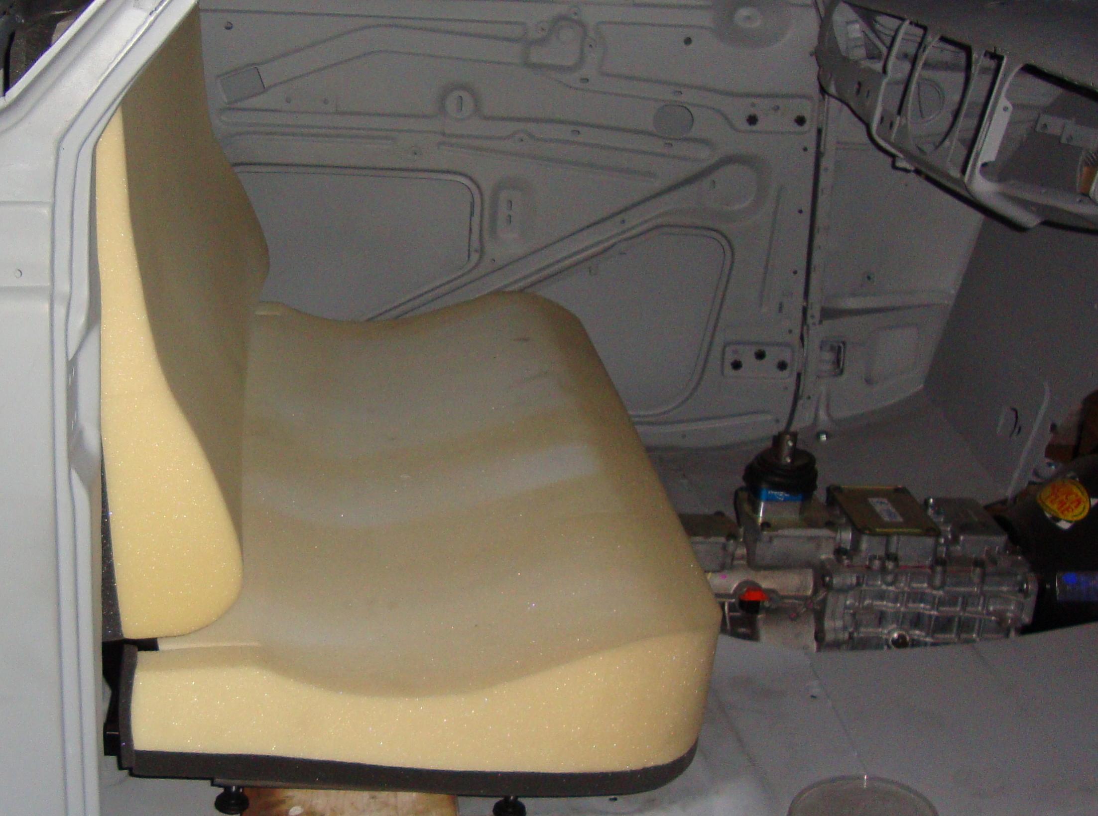

    Thanks powhatan42! Taking a few days off metal work, as regular flying duties are calling.
    To answer your question: I'm going to use a bench seat. Here's an old pic from a year ago.

    Throw a mexican blanket on there and call it good! :D

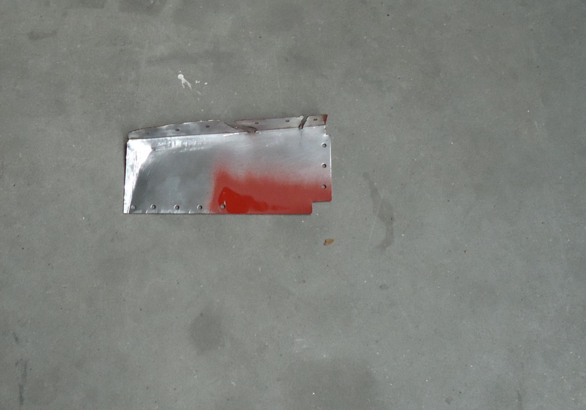

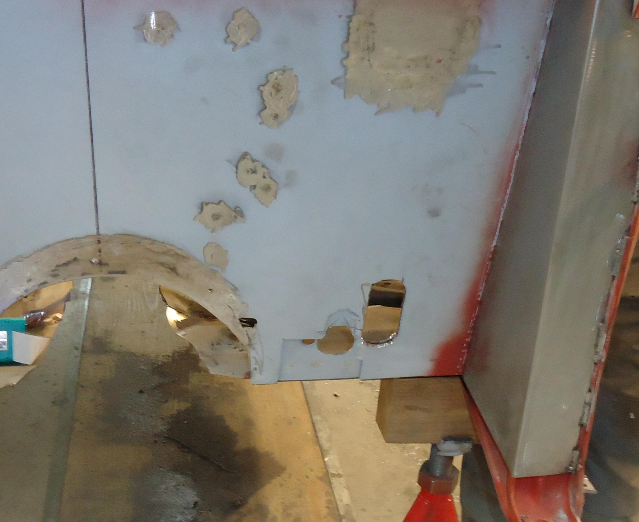

    Got to work on a few small things today. Fabricated a piece to go in the top corner of the c-notch and welded it in place. While I had the welder in my hand, I finished the welding on the tunnel and some smaller area that still needed attention. Then got the old grinder out and smoothed the welds. Pretty tough work while laying on the ground.......my arms are killing me right now. Oh yeah, and finally got a pic of me next to the car. About time!
