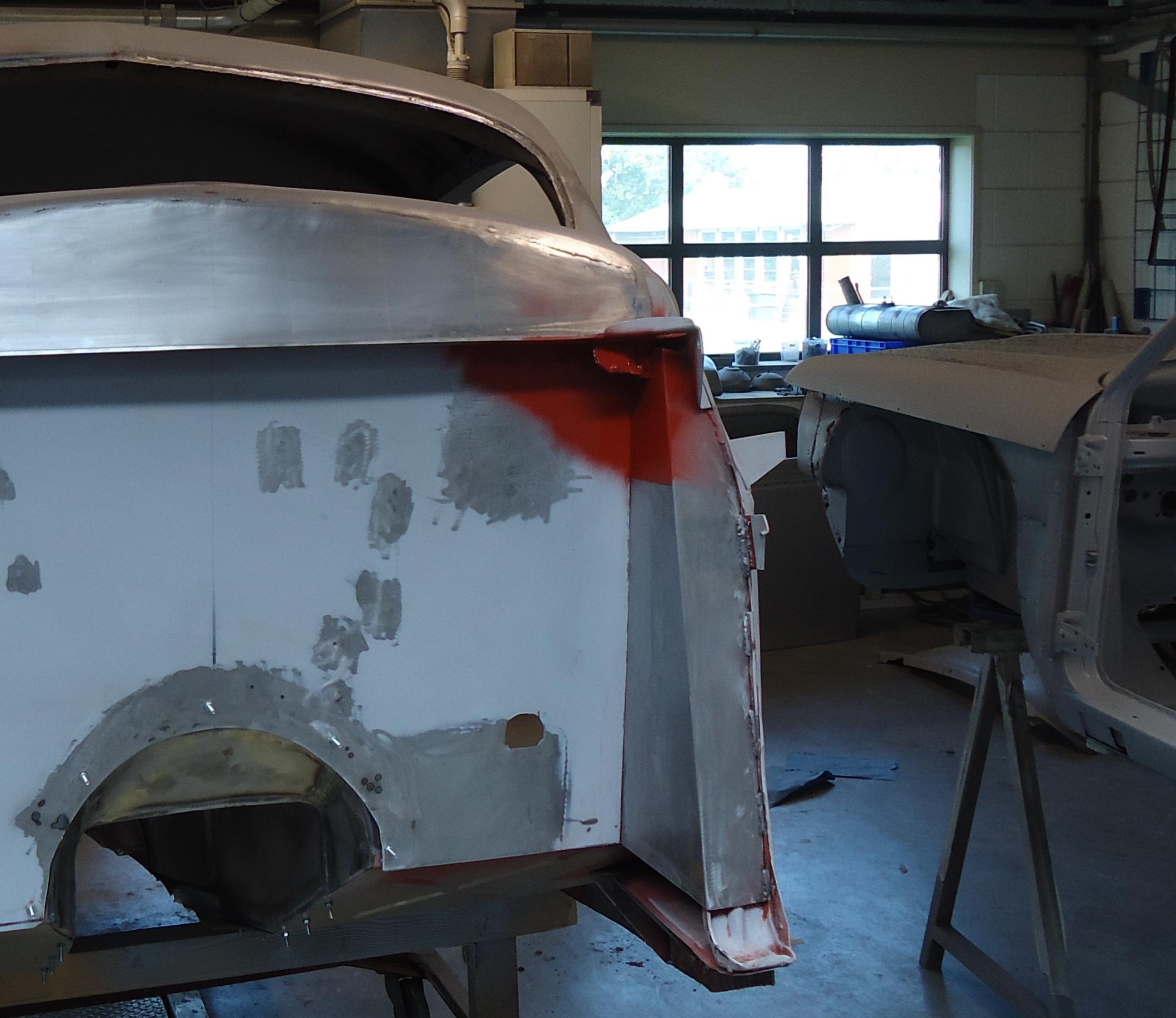

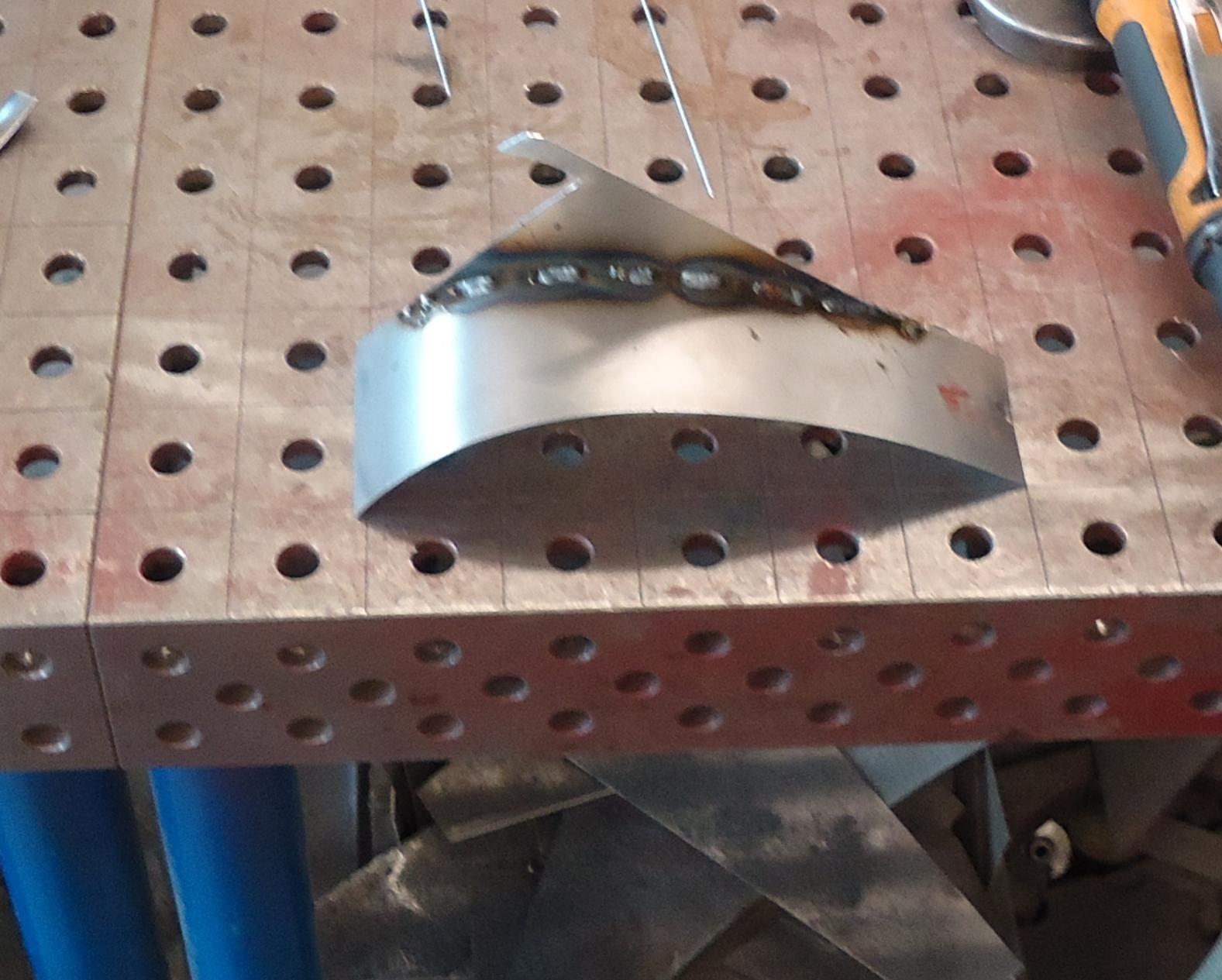

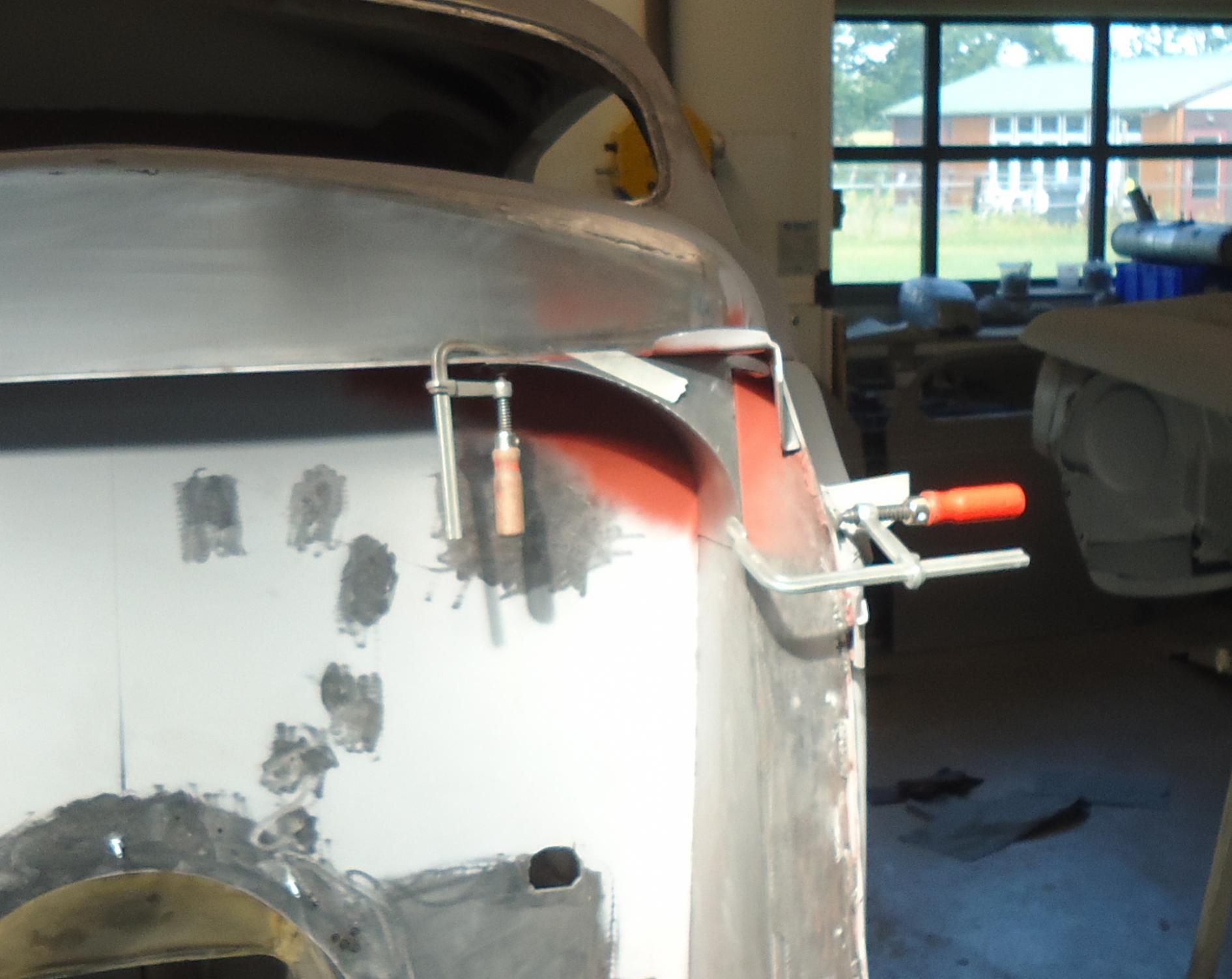

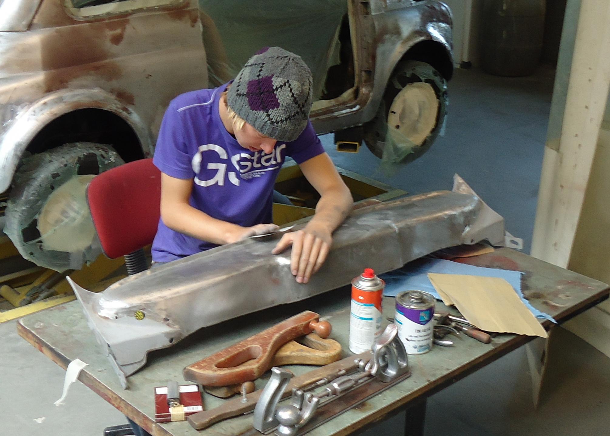

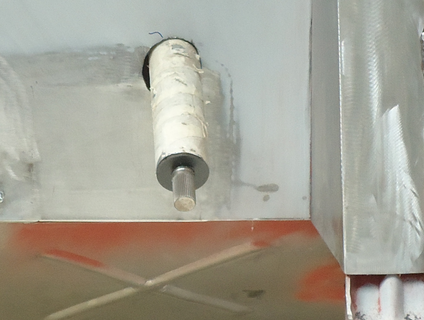

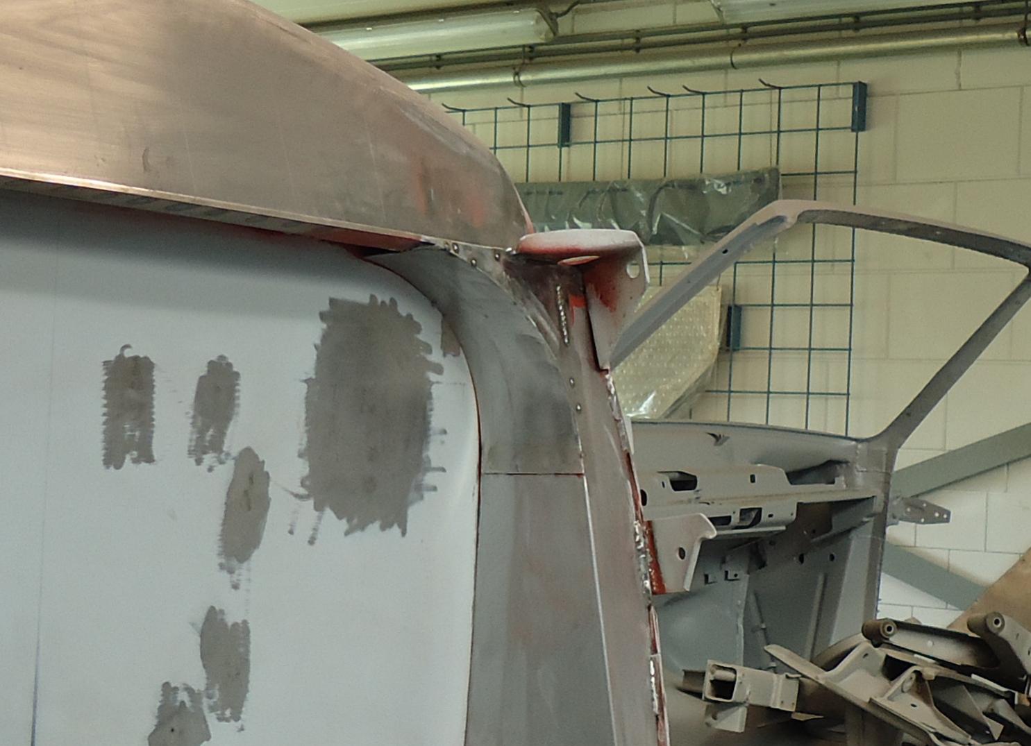

    It was time to get back working on the car, after a 10 day holiday. My son came with me to help out. He started sanding the dashboard and cutting out the necessary metal to fill in the remaining holes. I then welded them up and ground them smooth.

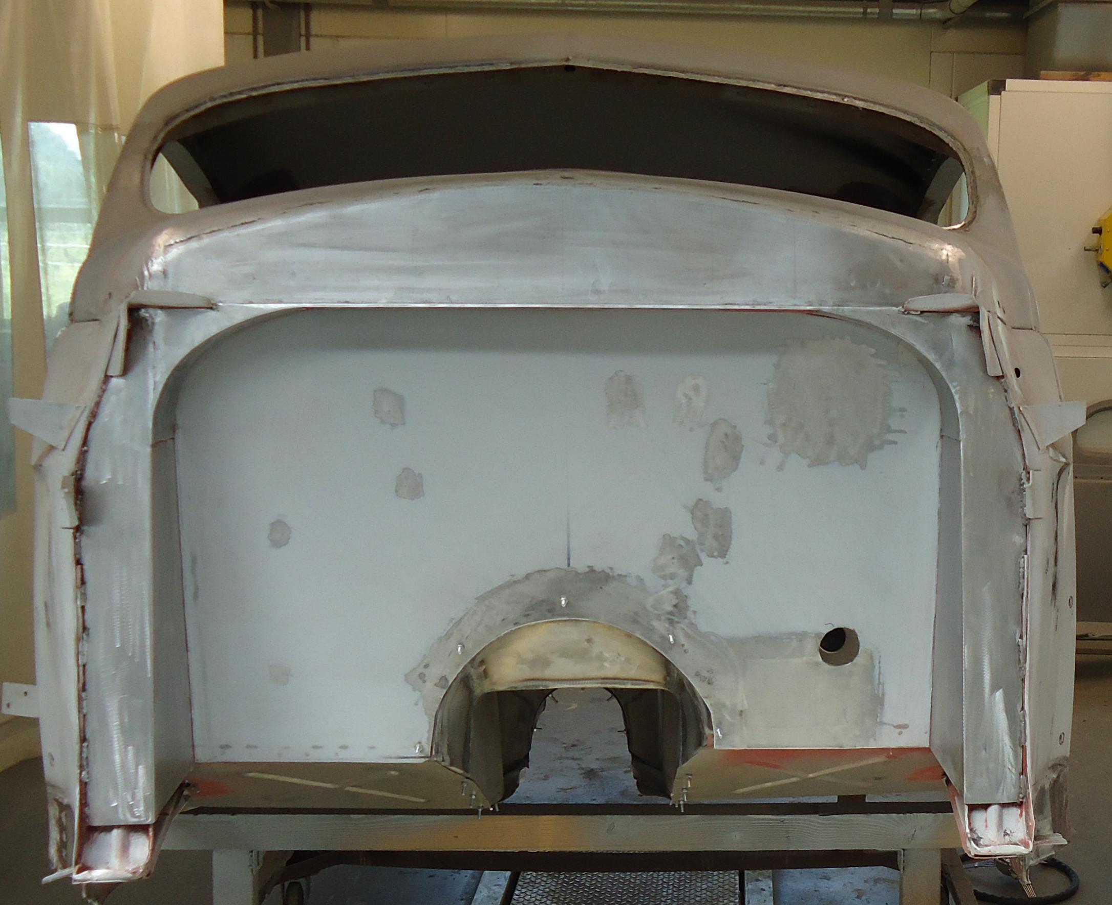

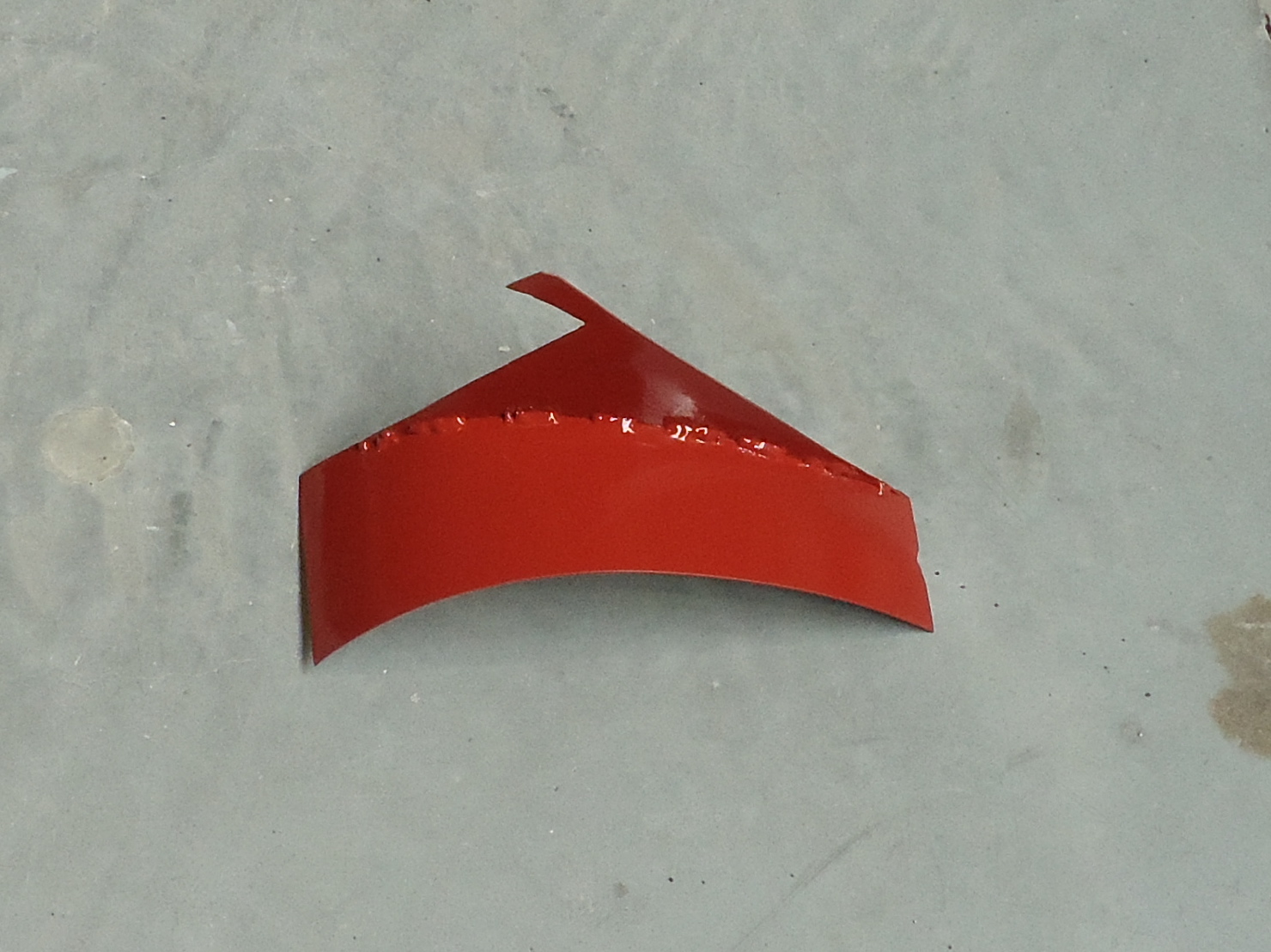

    One of the last things left to fabricate on the body was something to cover part of the hinge system on the firewall. This was my task today.... After fabricating a piece for the drivers side, I made a mirror image for the other side. I was able to show my son how you can be busy with this for the good part of 5-6 hours. I still need to finish off grinding a few welds....unfortunately the sanding pad broke and was not able to find a replacement.
    Here are a few pics from today.

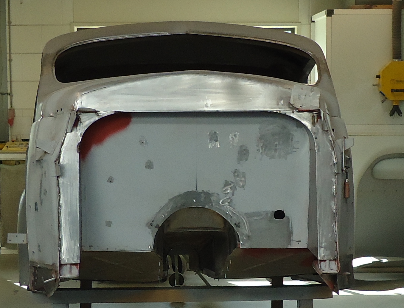

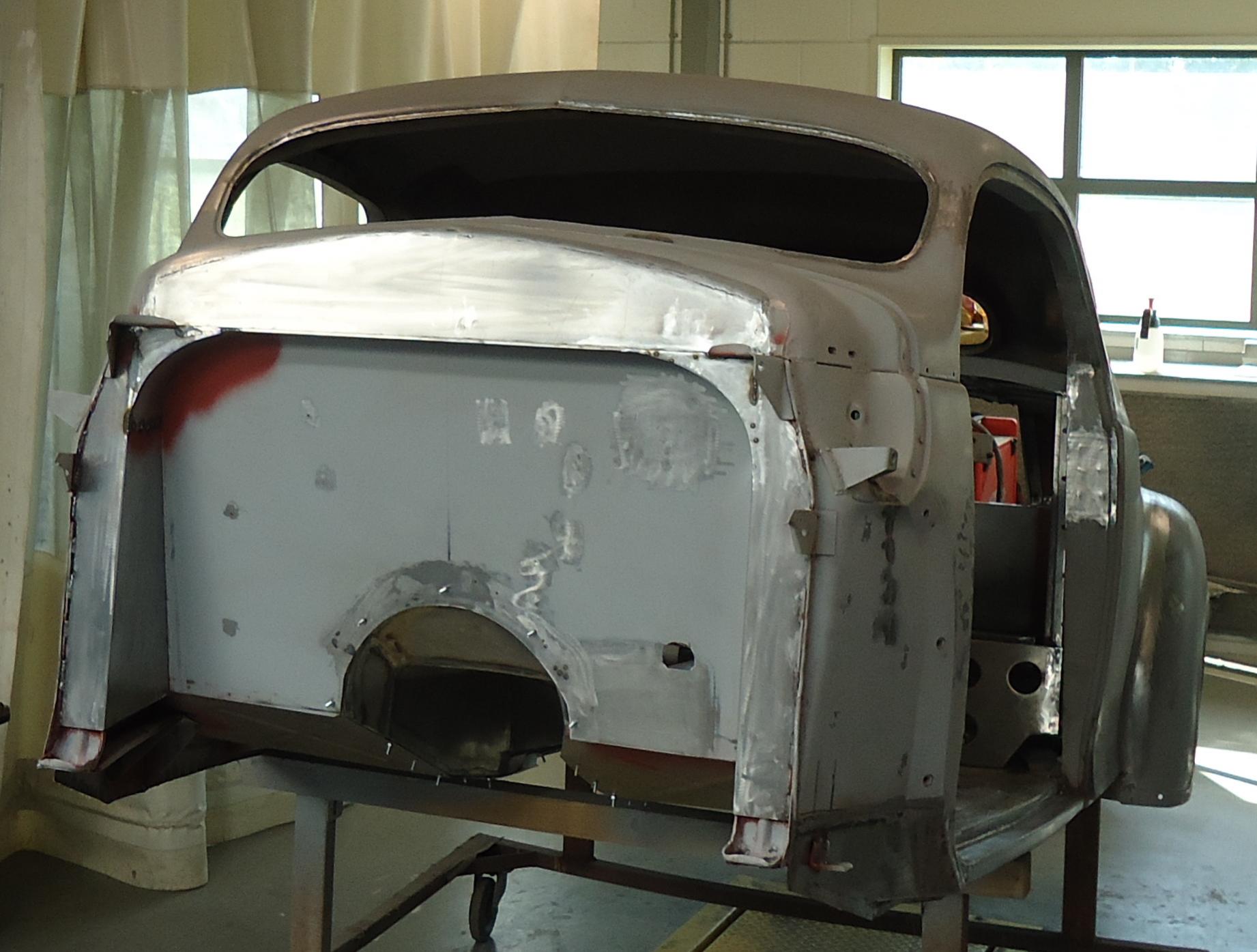

  15. farmer12
    Joined: Aug 28, 2006
    Posts: 7,723
    farmer12
    And a few more pics of the "nearly" finished product.

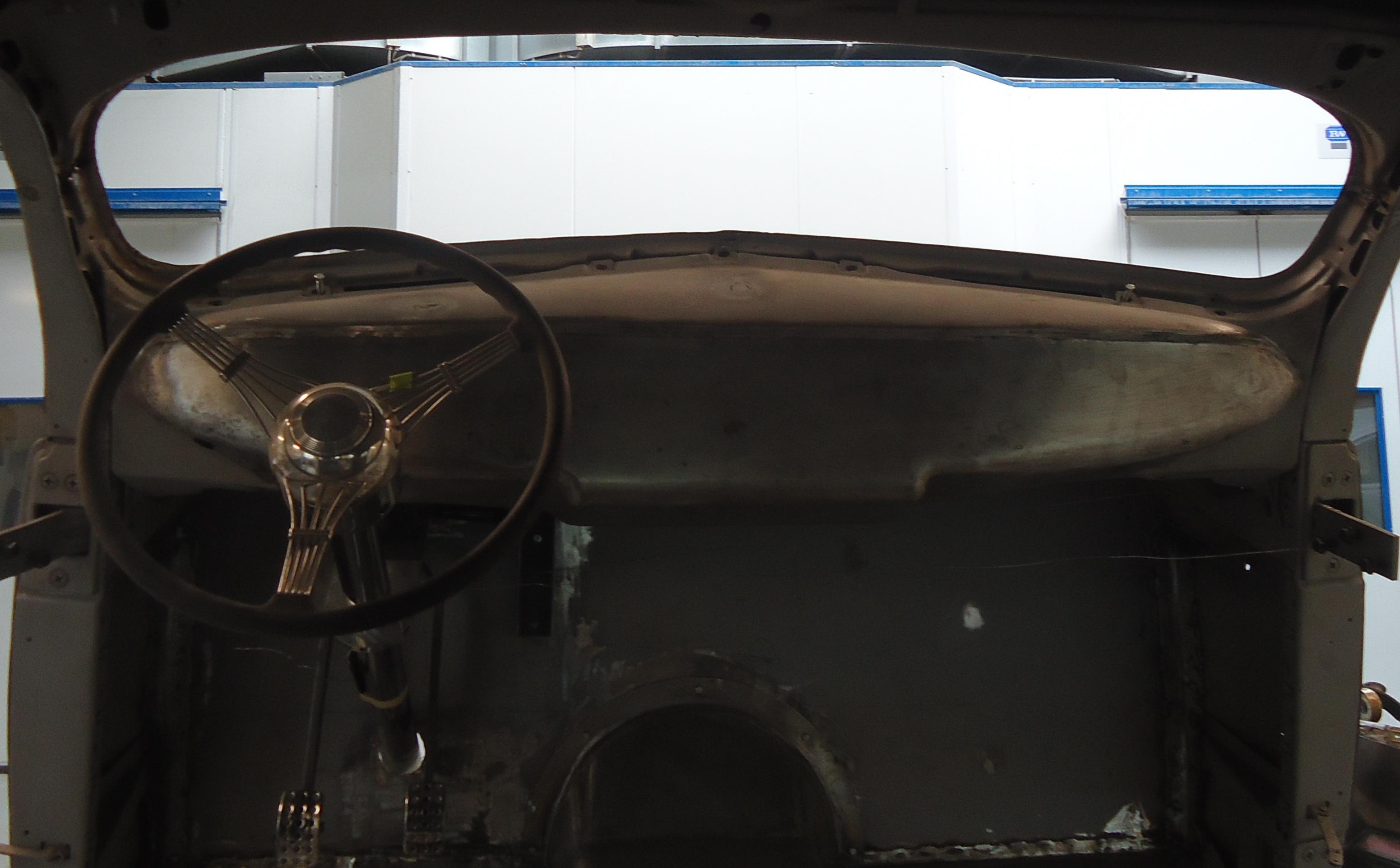

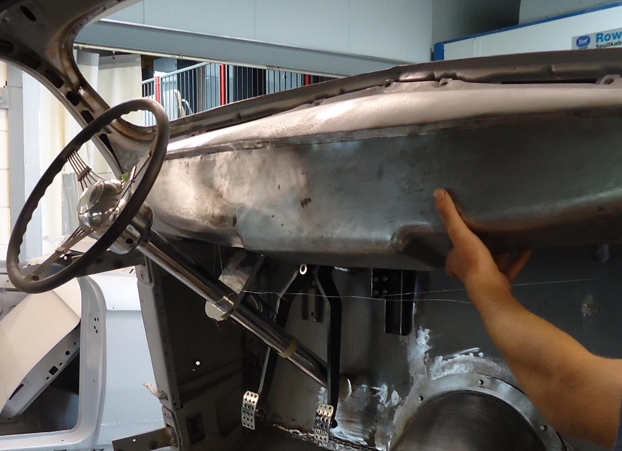

    Finished off the firewall today. It required a few more welds/grinding, but it's done now.

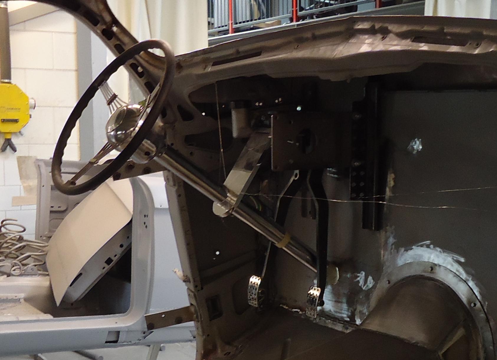

    Increased size of the hole where the steering column goes through. Had to make a slightly oval to allow the column to be at an angle. Got the pedal ***embly out and mocked that up too. I've decided to move it slightly to the left to allow a little more space for the gas pedal. I also shortened the ***embly bracket on the bottom as it was too long. Sat on an empty plastic crate of Heineken to get a better feel for the correct driver postion. Felt pretty good!
    Apart from all of the above, spent a good deal of the day sanding the body (together with my son Julian) and cleaning up some welds. Going to sandblast/primer the body at the end of this month. Can't wait!:D:D:D (but there are still quite a few things that need to be done....)

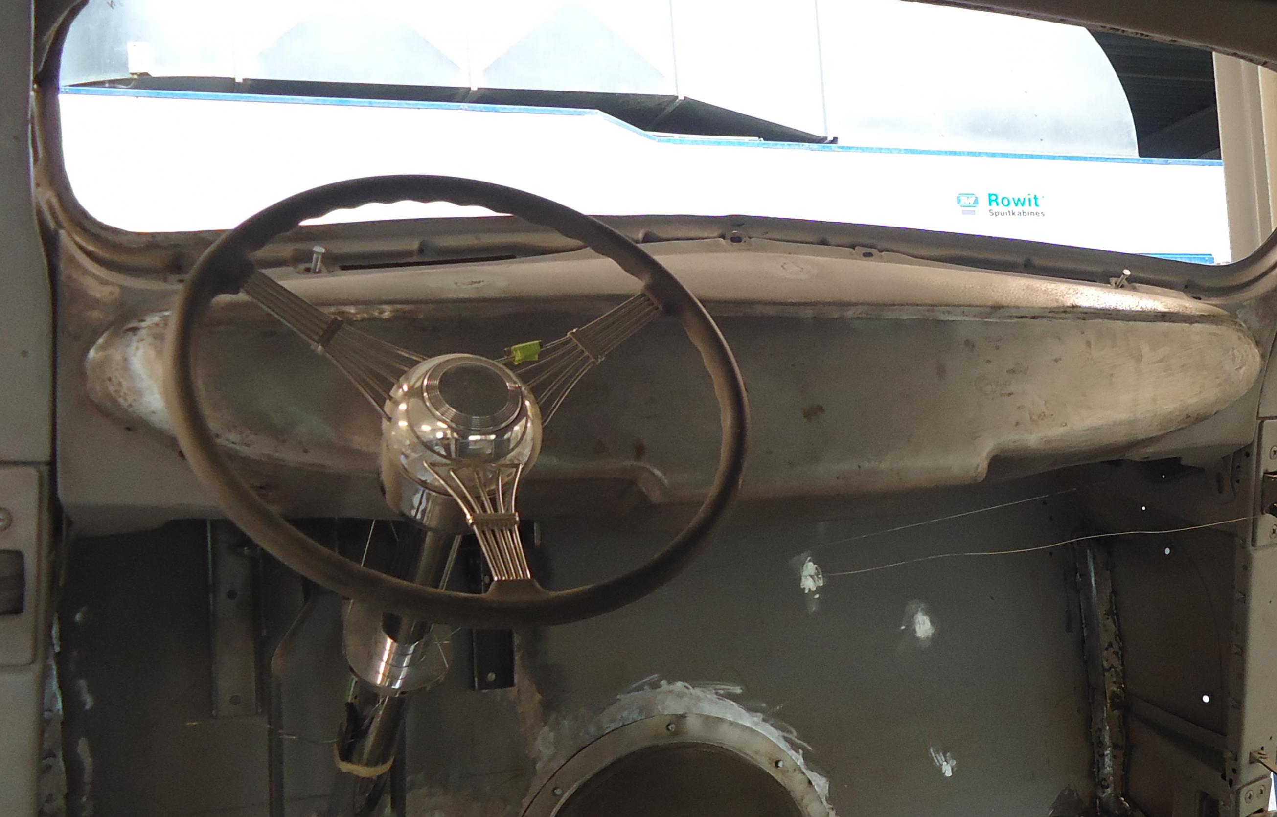

    Also went ahead and loosely mounted the dash in order to make sure my brake booster would fit. Even the gauges will fit without intervering with the booster. The steering will need to come out further towards the driver, but that adjustment can be made later. I now only need to figure out how to mount a bracket holding the column drop.....I'll do that once the pedal ***embly is welded in place. It's starting to look like a car again, don't you think?

    Eric, it looks like a car for sure! No tilt on the column? The column drop should mount just like the stock one. How many inches did you drop, it is hard to tell from the photo? Good luck with the blasting, I have been hand grinding, and it is no fun, but great exercise.LOL We are still going to get it blasted, because like you said earlier in another thread, you can't see all of the potential problem areas.

    I decided against a drop column as I want a "clean" as possible interior. I feel that if the steering wheel is in the correct position to start with, there is no need to change the angle. The old column drop was removed from the car before I got it, so I could not tell you the exact drop. I've postioned the steering wheel/column so it is in a comfortable postion, while still being able to get on the bench seat without any problems.

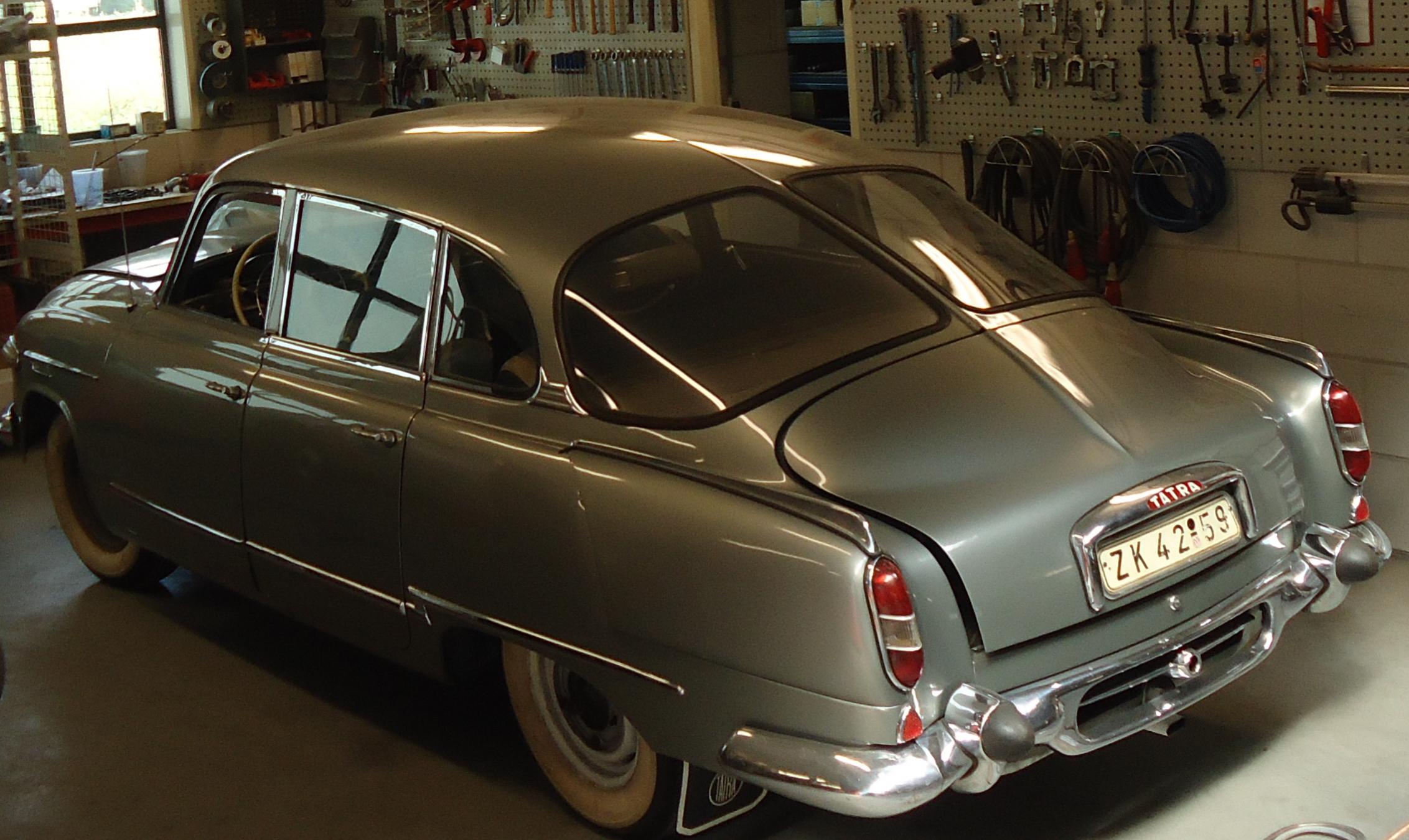

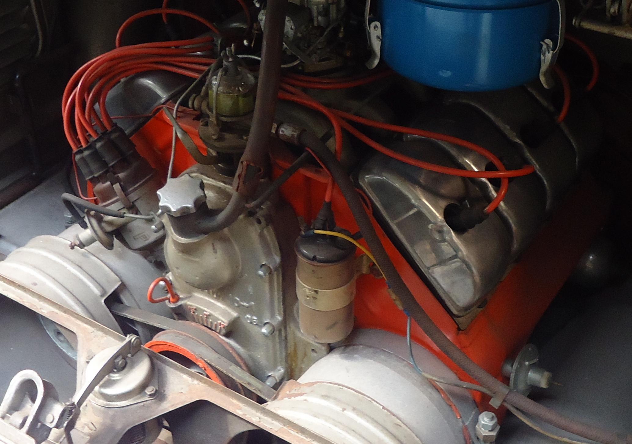

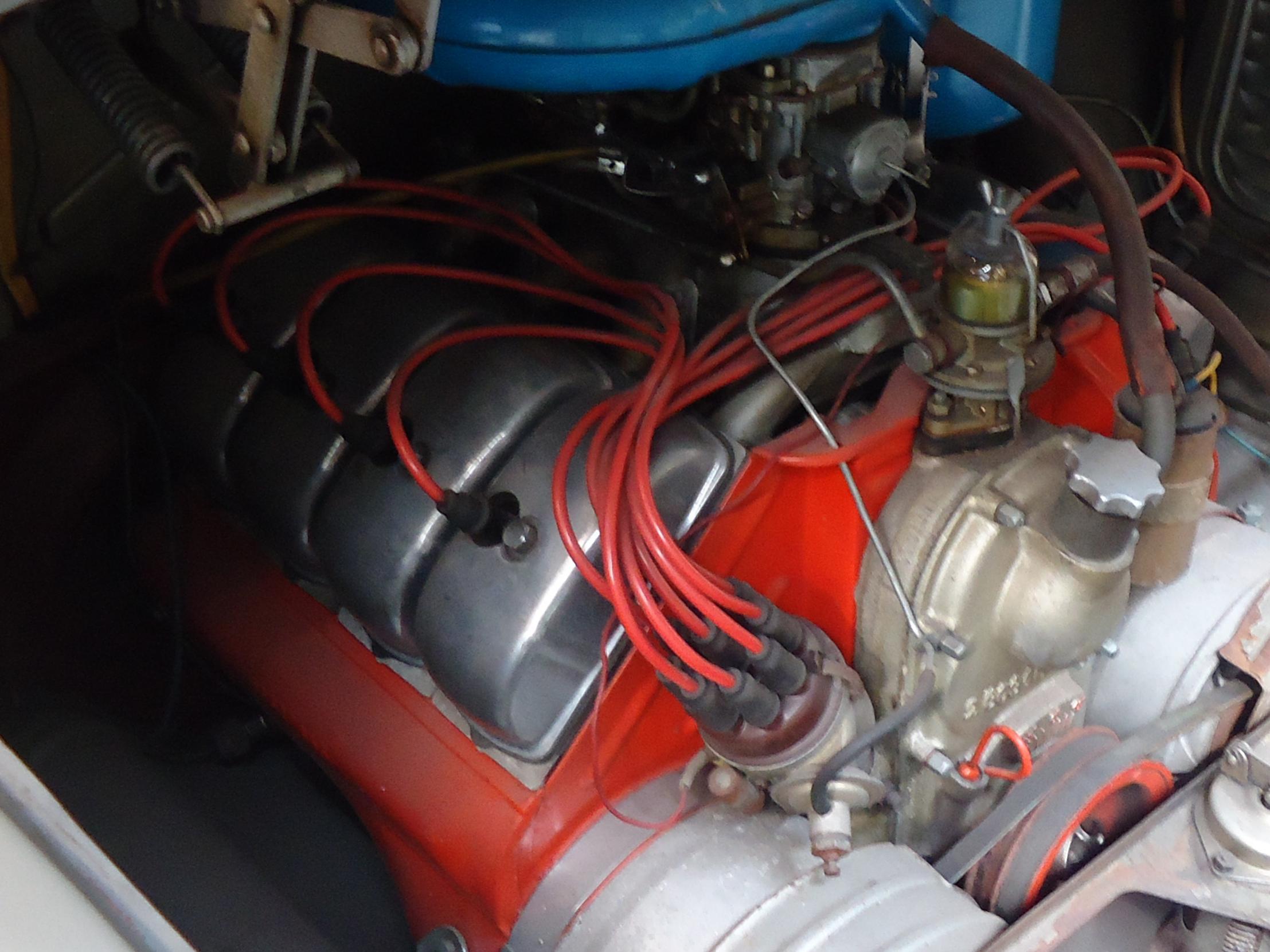

    Nearly forgot.....there was this rear engined Tatra in the workshop today. And yes, it had a Hemi in the back. Not the one we all know and love, but it was cool to see all the same!

  23. OahuEli
    Joined: Dec 27, 2008
    Posts: 5,243
    OahuEli
    from Hawaii
    I never heard of a Tatra. Who made it and whats the displacement? Bet it'd be fun to drive!
  24. farmer12
    Posts: 7,723
    farmer12
    I did a quick search on Google. It's a T603, made between 1955 and 1975. The displacement is about 2.5 liters and made between 95 and 105 hp. It's made by Tatra in the Csech Republic/Checoslovakia. The engine looks impressive, shame about the numbers.....

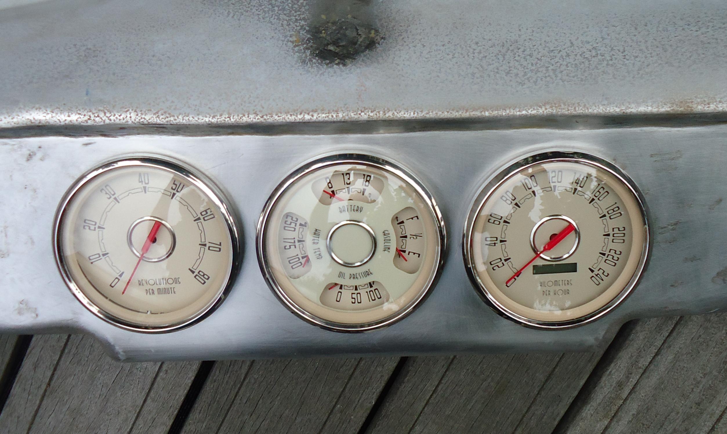

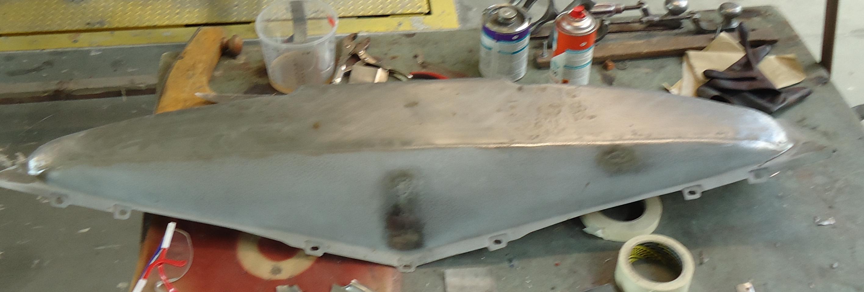

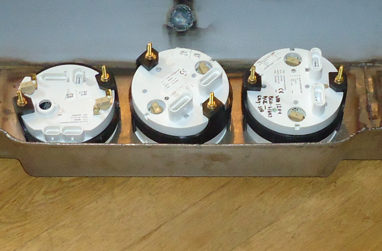

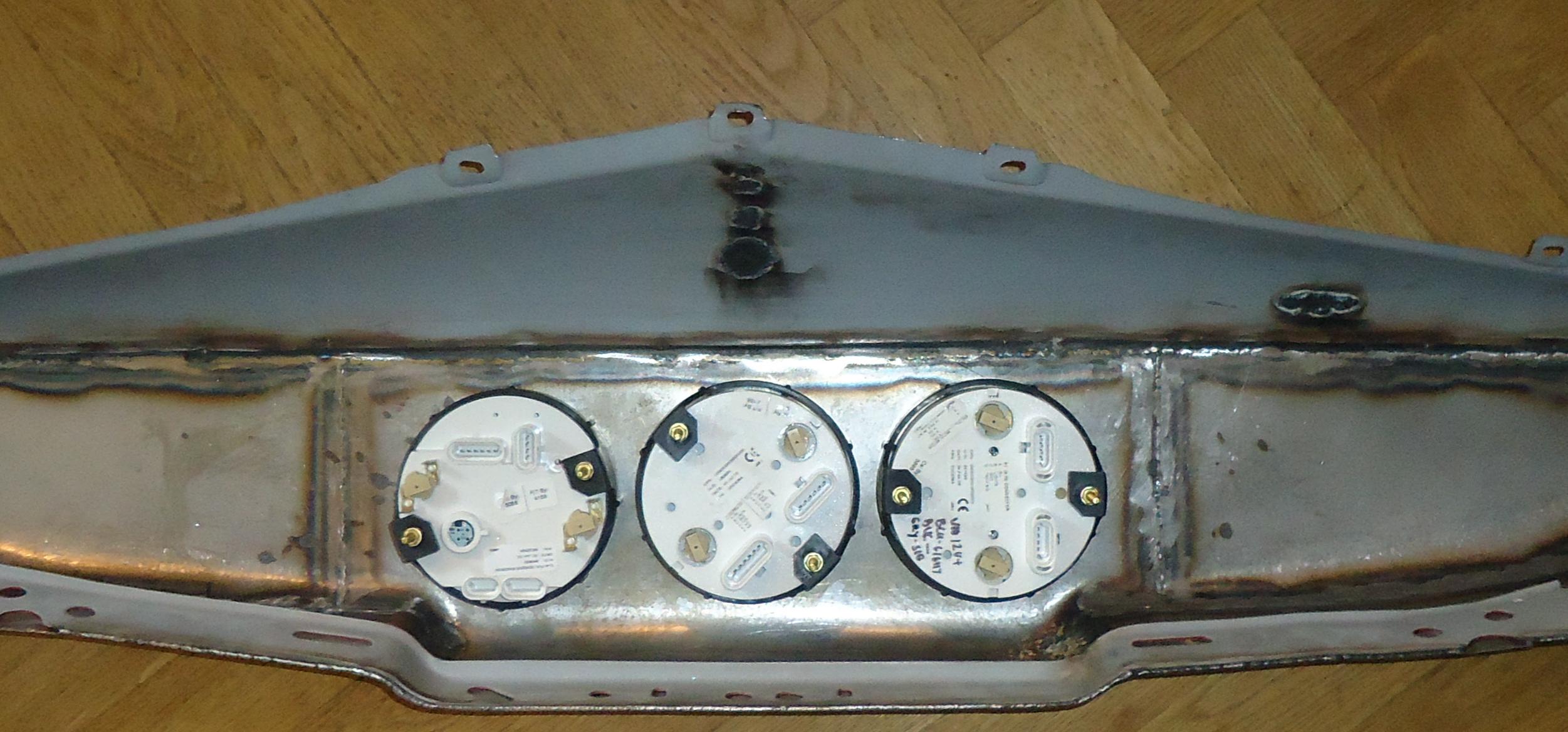

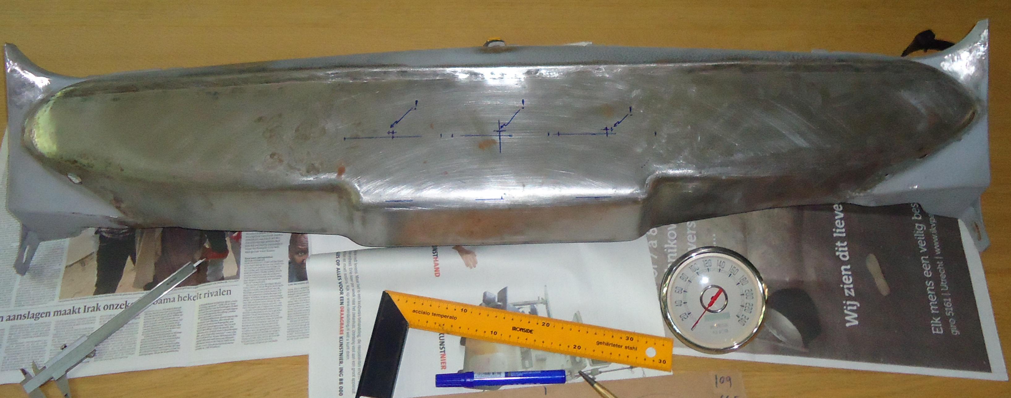

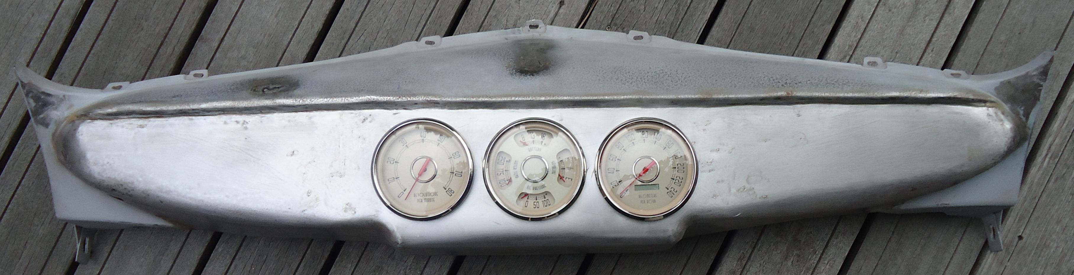

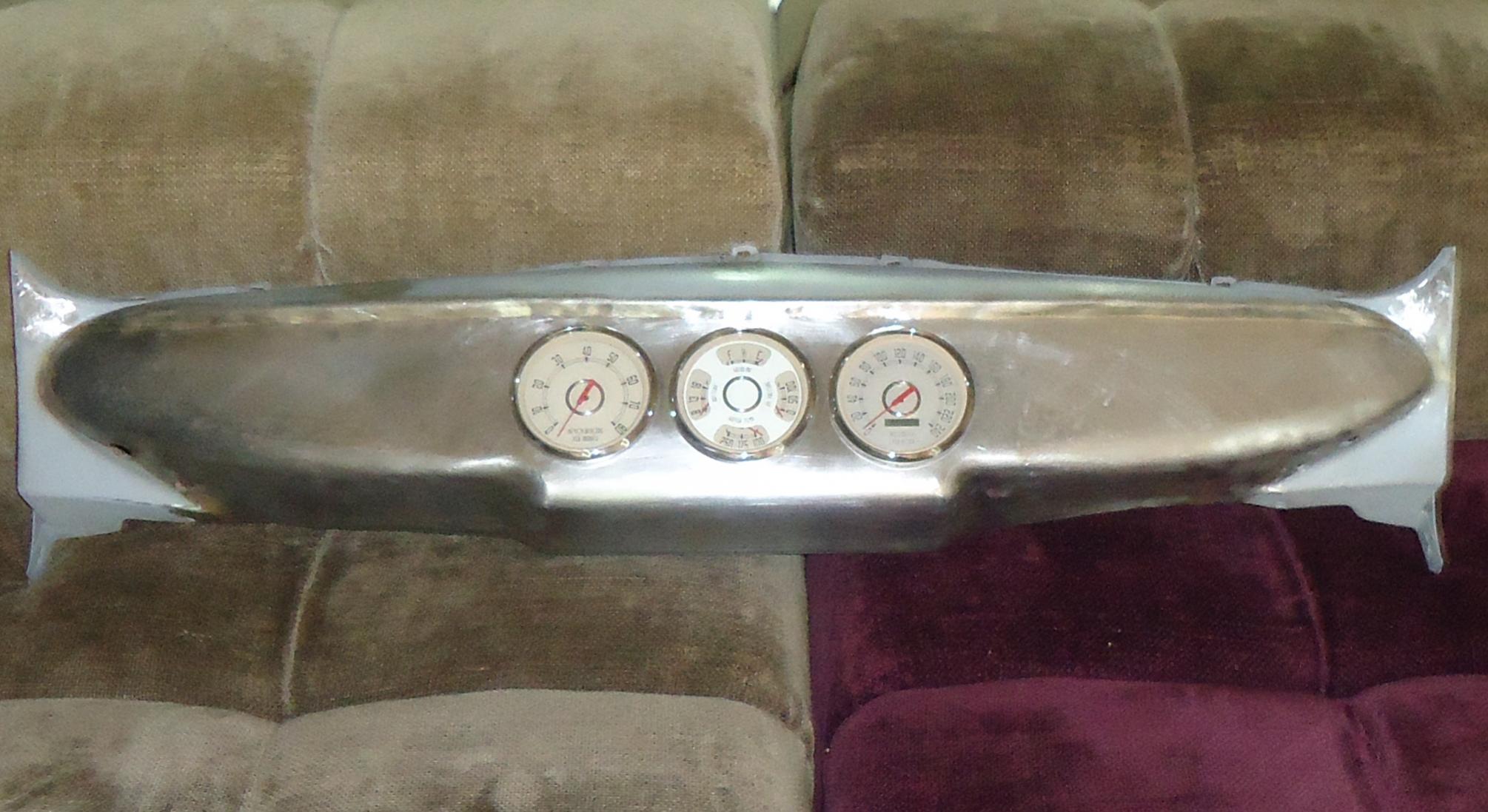

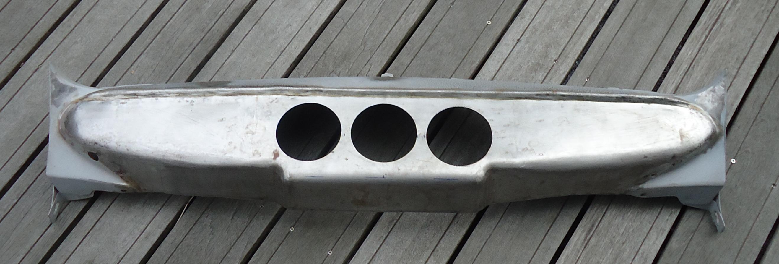

    Back on topic now. Considering I'm on standby the next few days, I got started with the dashboard and gauges. After spending an hour of measuring, I went and bought a round 111mm saw and started cutting away. (with my son holding the dash in place and my youngest daughter pouring water on it to keep it cool) The back of the gauges are 109 mm in diameter, giving me 1mm play. Unfortunately, the saw is not really that accurate, so I had to hand vile/sand/dremel before I had the gauges lined up.(last pic) Couldn't resist mounting them in position and take a step back.....Life is good! :):)(just curious what the missus is going to say when she finds a dash on the couch.....:D)

    Thanks Glenn. I still need to get some lead on the top of the dash to smooth it out completely, but then it will be ready for some minor sand blasting and epoxy primer. I'm toying with the idea to have the top covered in leather and the rest painted. But which color:rolleyes:........still got some time to think about this one.

    Those are some pretty cool looking gauges. Who makes them?
  29. farmer12
    Posts: 7,723
    farmer12
    They are made by New Vintage USA. They even made the speedo in km/h for me!
