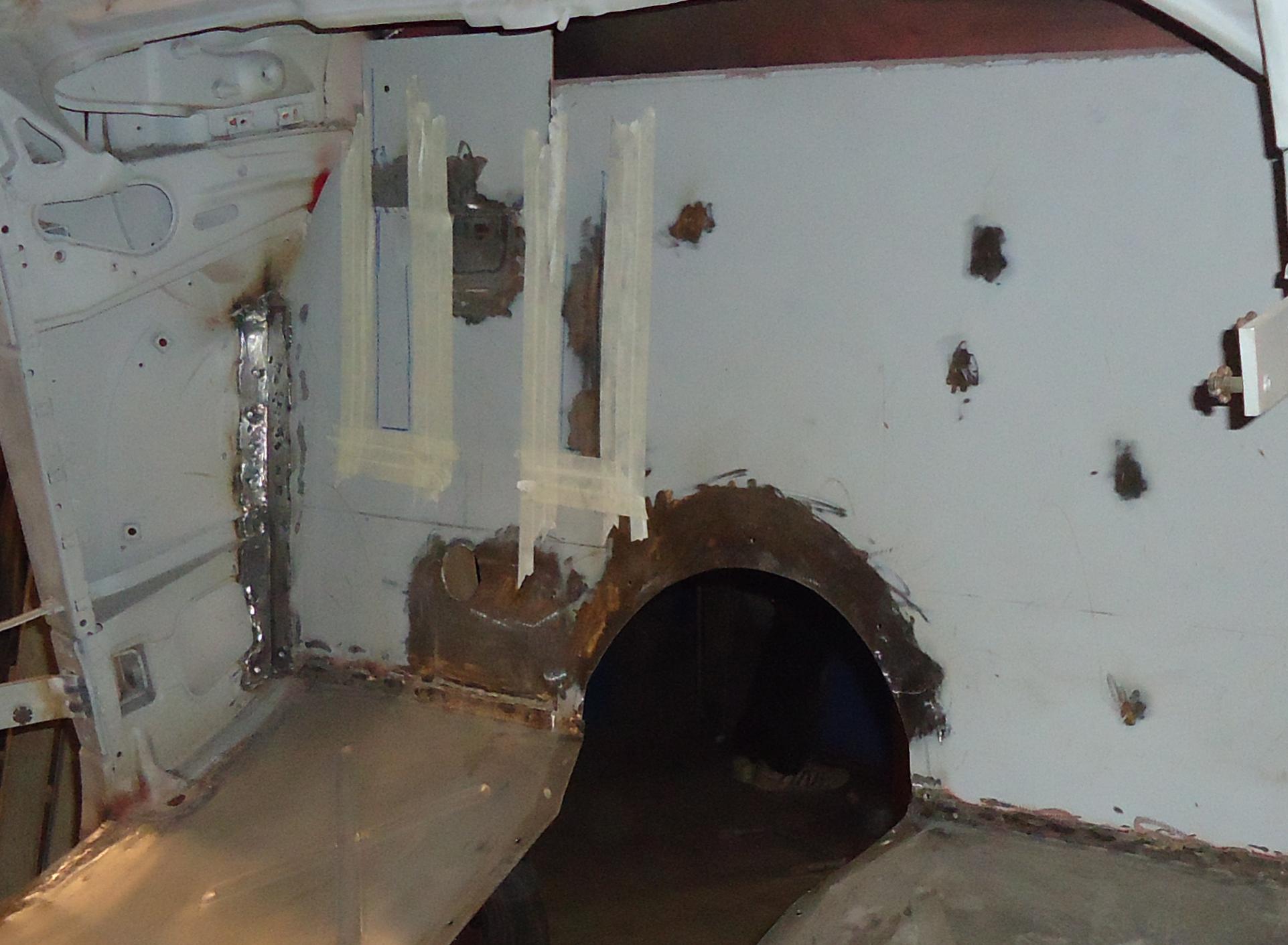

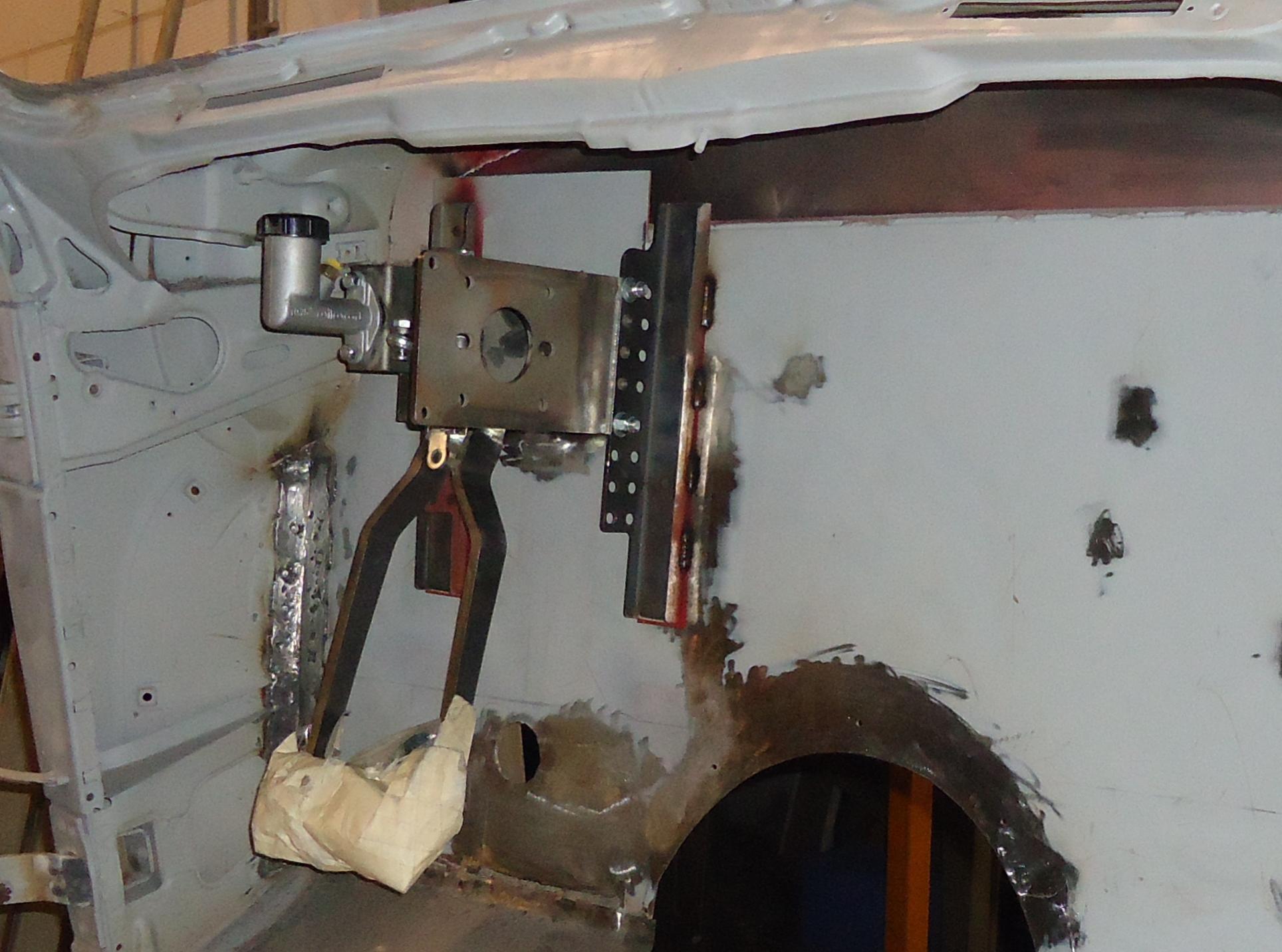

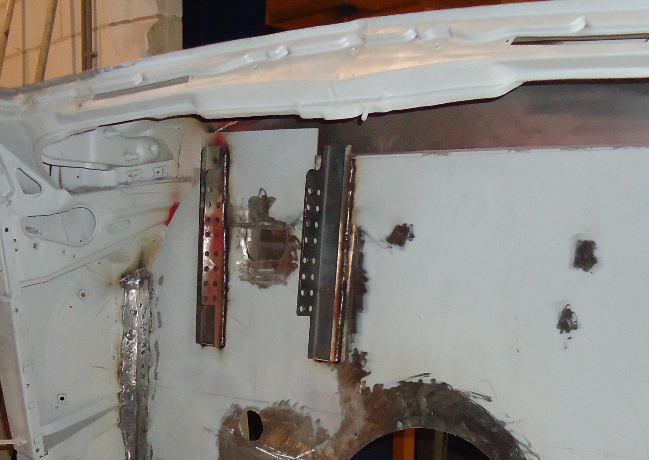

    Today was the last day for me in the workshop. Started unbolting the tunnel so it can be sanded and also give me a little extra room for the welding I needed to do.
    I positioned the support brackets in place, masked it off, sanded the area and applied red welding primer. Then tacked it in place with the pedal set mounted to them. Finally took the set out again and fully welded it all up. Came out perfect!

    Gonna be tough to check the fluid in that reservoir after you get the dash in & wired huh?

    I did think about that as well. I want the car to be mechanically running before I start the electrical system. There will be enough space behind/inside the dash to allow me to use a simple little dipstick and add fluid if necessary. By using a small oil pump cannister and hose, I can add the fluids. The dash is held in place by 7 small bolts and 2 larger ones, so removal is not that difficult either, if worst comes to worst and major surgery is required!

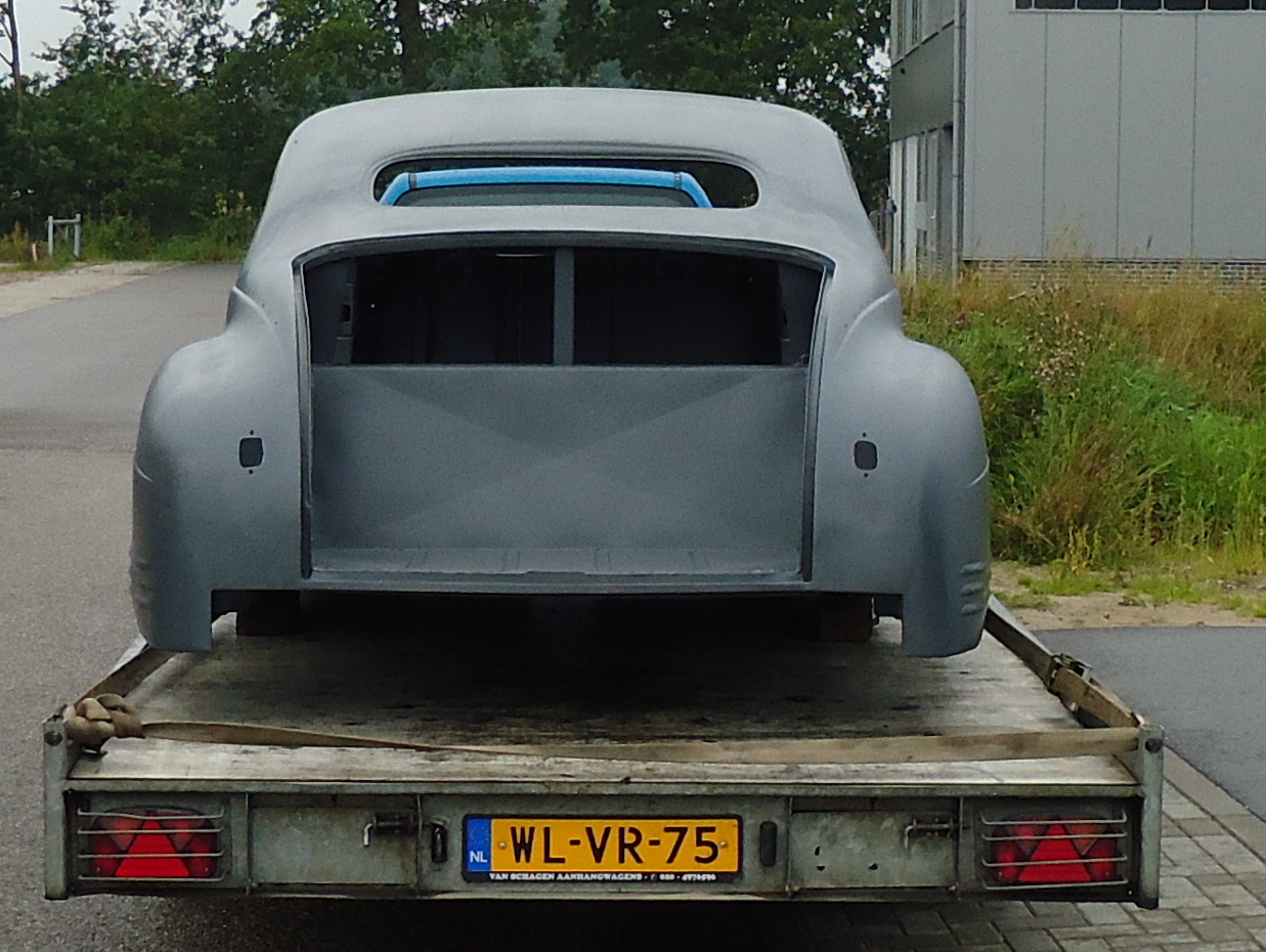

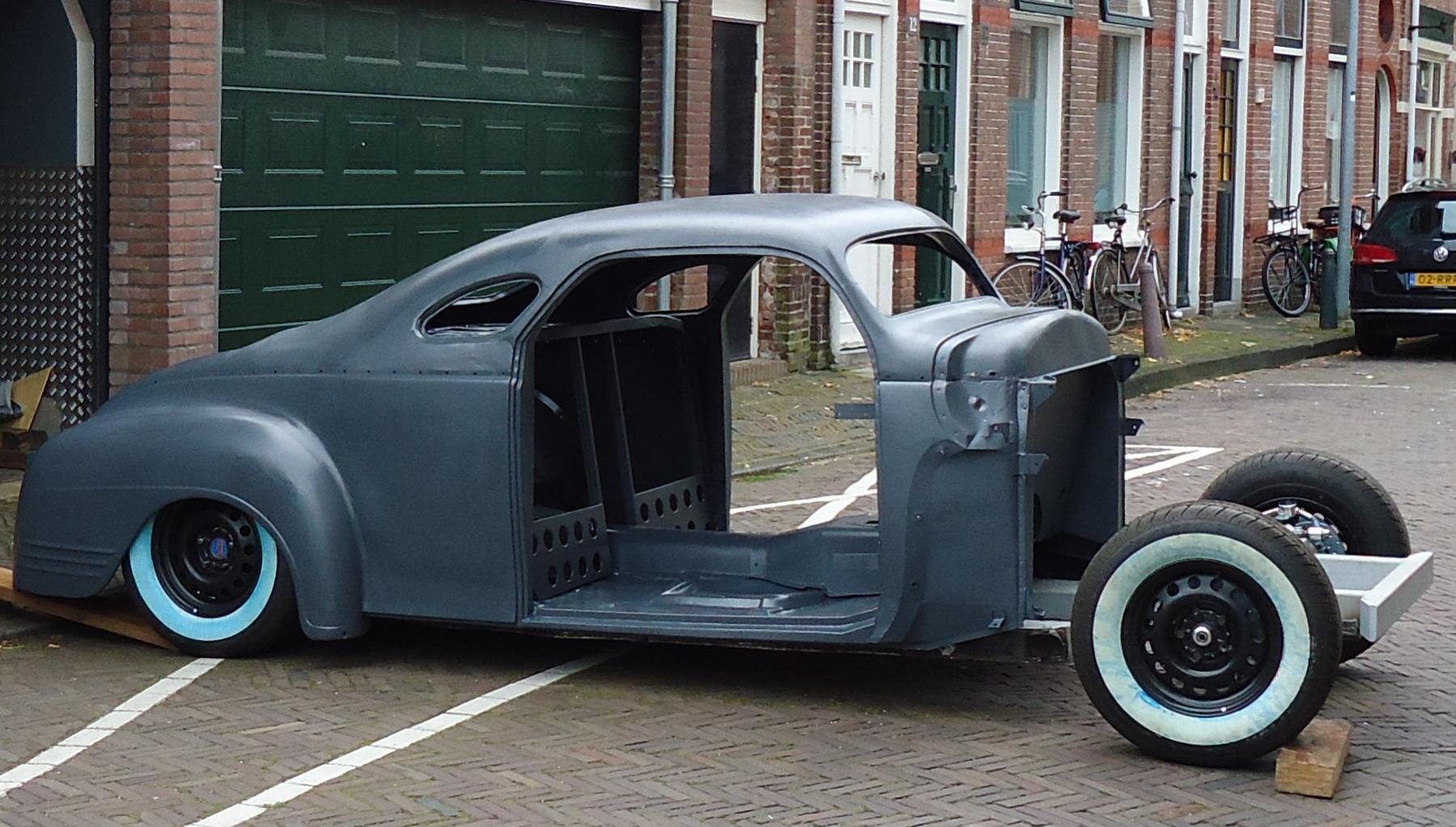

    Me neither Rob! These are the last pics before final sanding, sandblast and primer. The second pic shows the dash and tunnel in the trunk and ready for treatment.
    I asked the painter (Peter) to add a few drops of black to the epoxy primer. That way he knows he's covered everything and I get a darker colored body! Picking up the body on sunday. Can't wait!!!:D:D:D

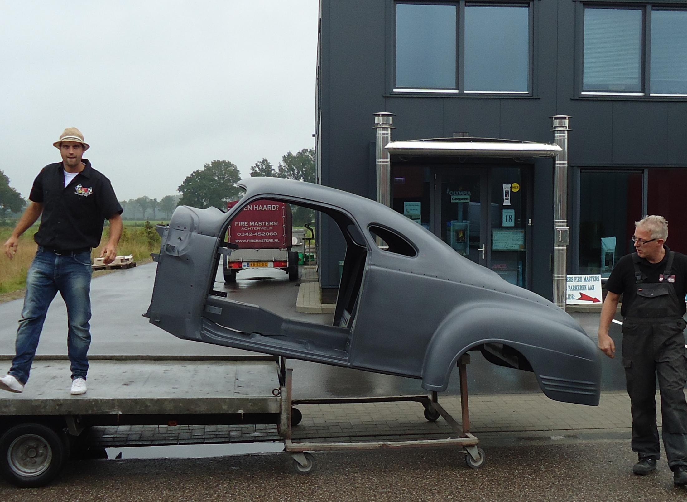

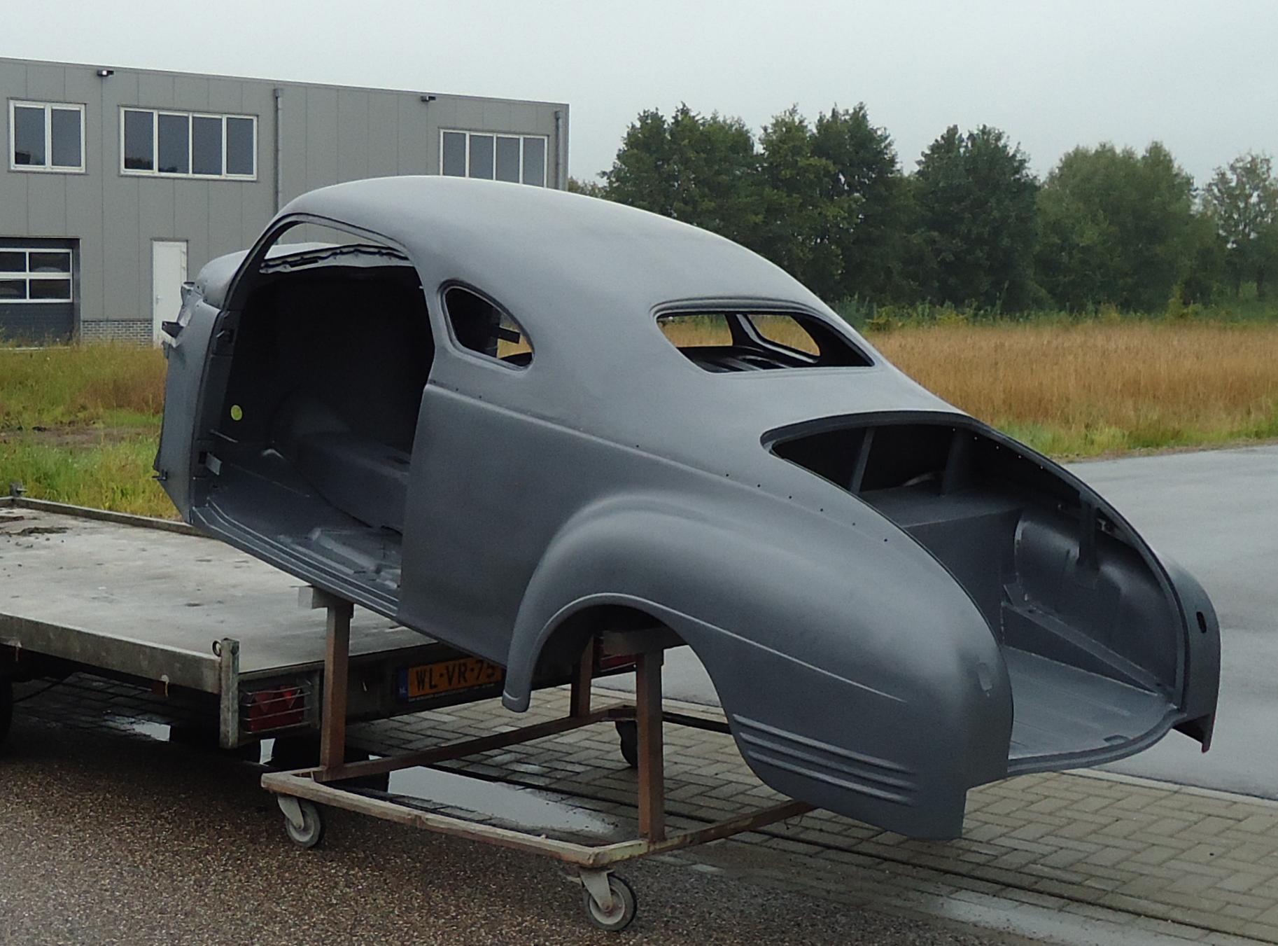

    Well today was the big day! My buddy Bart came by early this morning with his pick up and trailer, and we drove the 60 odd miles to pick up the body. I've just got myself the worst cold but took a hand full of pills which made me feel a little better. Nothing was going to stop me today!
    We arrived at Martin's shop around 11 and loaded her up. It took 4 of us to get the body on the trailer and tightened the ropes. I had asked the painter to add a few drops of black to the primer so it would darker than the usual light grey. Came out looking great! There are still a few small areas that need minor work, but remember at this stage all you see is metal,lead and primer.:D

    Looking Good! I really like the profile of that side shot, that chop is perfect. Whats next?

    Yeah,the profile is perfect.
    And i think its a milestone in your project to get the body primered,congrats!

    Continuing the story......I was surprised at the amount of thumbs up and people twisting their necks as they p***ed us on the highway. I thought, "man, it's only primered..."
    After a quick lunch at McD, we drove the last 20 miles to my place. Rounded up some neighbors and my son, and started to work out how to get it off the trailer and place it on the ch***is. The body has increased in weight considerably compared to 9 months ago, so it was wise to use 5 people in total to offload it.

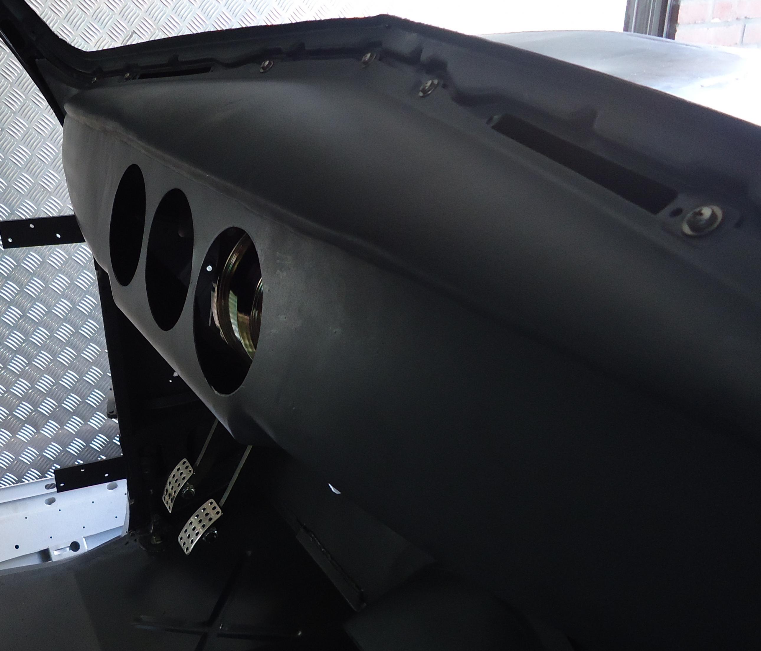

    Thank you OahuEli! To answer your question.......see below.
    Despite feeling very average today, I pursued on. Got the pedal set mounted, including the brake booster this time. Next was the dash. Considering I want to use SS screws/bolts/rings/nuts as much as possible, I had to re-thread the holes in order to accept metric stuff. Bolted it in place and it clears the brake booster and leaving enough room for the gauges. I think I will have to install the speedo on the right of the three holes due to the limited space for the cable.
