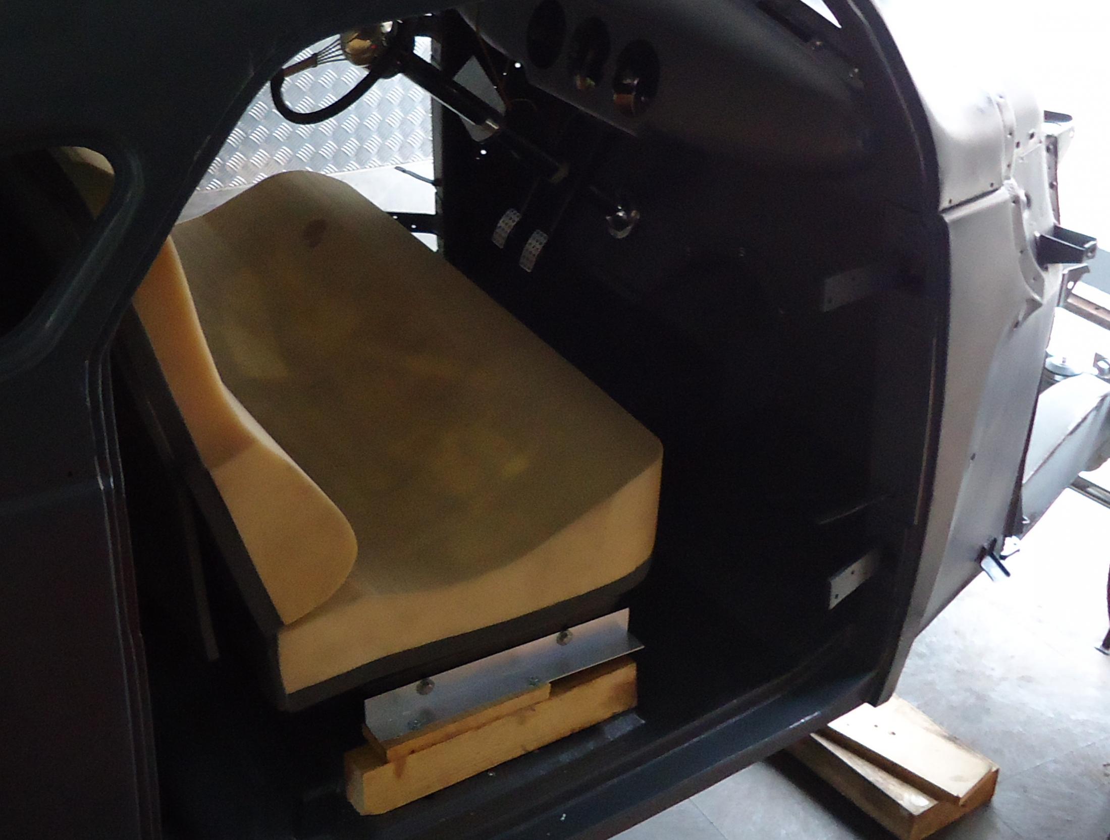

    Got working on the bench seat today. I wanted to test fit it so I know which brackets and supports I need to weld. First had to re-thread so it can accept metric ss nuts and washers. Next I got very creative with aluminium and wood.
    I learned that in it's present postion, the bench seat will need to move up 1/2 an inch and that this postion right now, is the most forward one. (otherwise there will be interference with the gear stick) The pedals will need to be moved closer to the firewall and the seat can be widened with foam by 2 inches on either side. Not a very exciting day, but it just needed to be done.

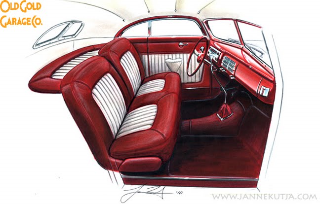

    Looking good dude, are you thinking tuck and roll apholstery? Thats a little far down the way, but just wondering

    Not sure yet...I like something like this, not so much the color, but the style.

    Ah, yes! Roll ( the fat part around the edge) and Pleat (the center).
    The traditional and best looking design for that type of car.

    I have to agree with you RodStRace. These pics give me some inspiration with regards to where I want to go.

    eric, I like the interior concept drawing in your post above. I think a 2 tone interior looks alot better than a single color interior(unless it's black). Are you going to chrome the interior window garnishes?

    I quite like the two tone as well. The interior is not going to black as I want some "light" in there due to the minimal light coming through the chopped windows. The interior garnish will probably be the same color as the exterior. Choices choices.....
