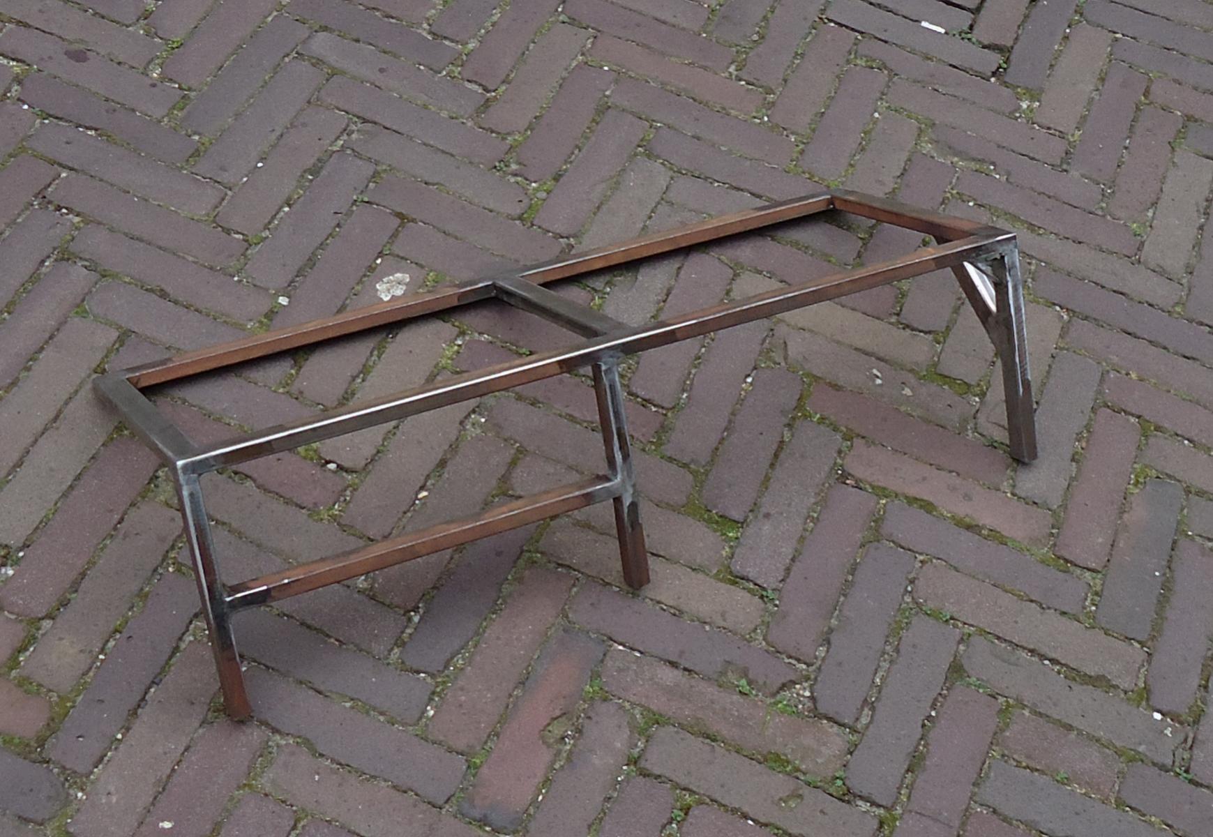

    Considering it was going to be a sunny day today, I set up a little "work bench" outside. Made a frame for the fuel cell and welded it up. It's quite a funny shape as it needs to clear the tunnel and a high section where one of the 4 link bars is hidden. Hope to finish it off tomorrow. It will eventually be powdercoated together with the ch***is and some other parts.

    What size and type of fuel cell are you using? Nice welds.

    Thanks Glenn. It's a RCI aluminium fuel cell (19 gallons) which I bought through Summit. I also bought the mounting brackets, but I will mount them upside down so as to be able to mount the cell completely rearwards against the c-notch. This should save me about an inch or two, creating more room for the airride compressor.

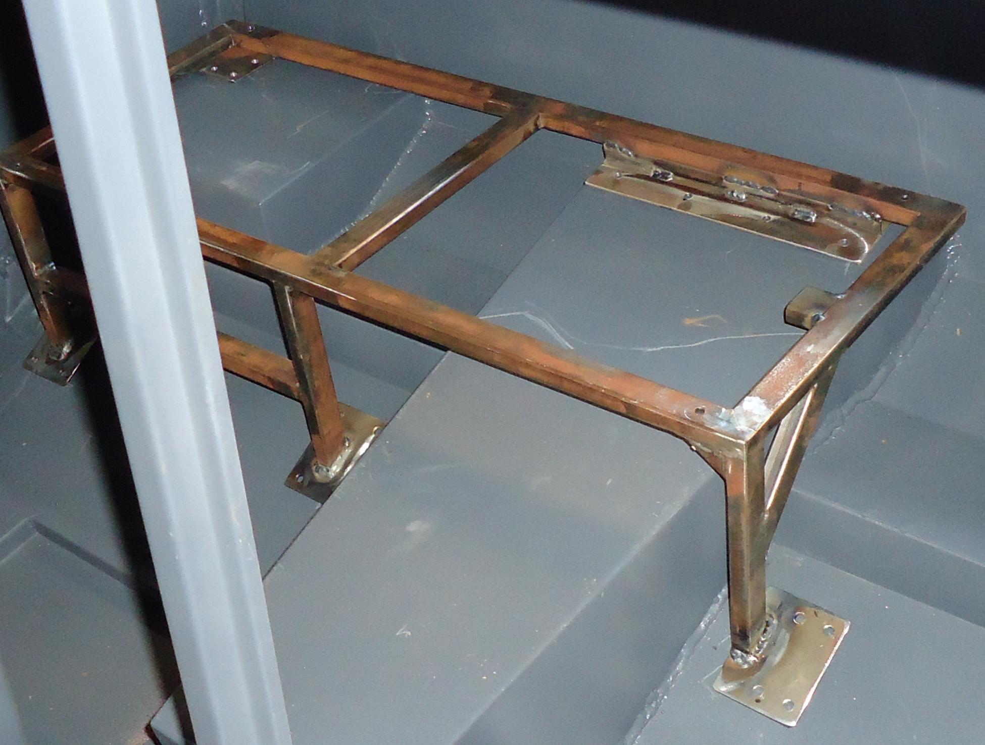

    Made a few alterations to the frame, cut of the legs at angles and did a test fit. I'm going to create some extra supports for the fuel cell and weld a plates to the legs so as to be able to distribute the weight even better. This has taken me longer the anticipated due to the constant test fitting and grinding. I hope to complete the frame this week and move on to the air-ride frame after that.

    Looks good Eric! I think the plates on the feet are a great idea.

    Thanks Rob. I'm even contemplating making some plates underneath the body so the force will be distibuted even better.

    I think plates on the ends will be good enough, depending on what gauge you used on your floor. I cant see that fuel tank staying full very long anyways!:D

    The gauge on the floor is 1mm, so basically strong enough.....with regards to the subwoofer/stereo, I'm still not sure, considering I've tried to make the car as light as possible (no a/c, no heat, no pwr steering, etc) it somehow does not seem right to build the car full of speakers and amps. Maybe I'll just I'll just listen to my iphone with earphones.........;) Give me some time to think about this one.

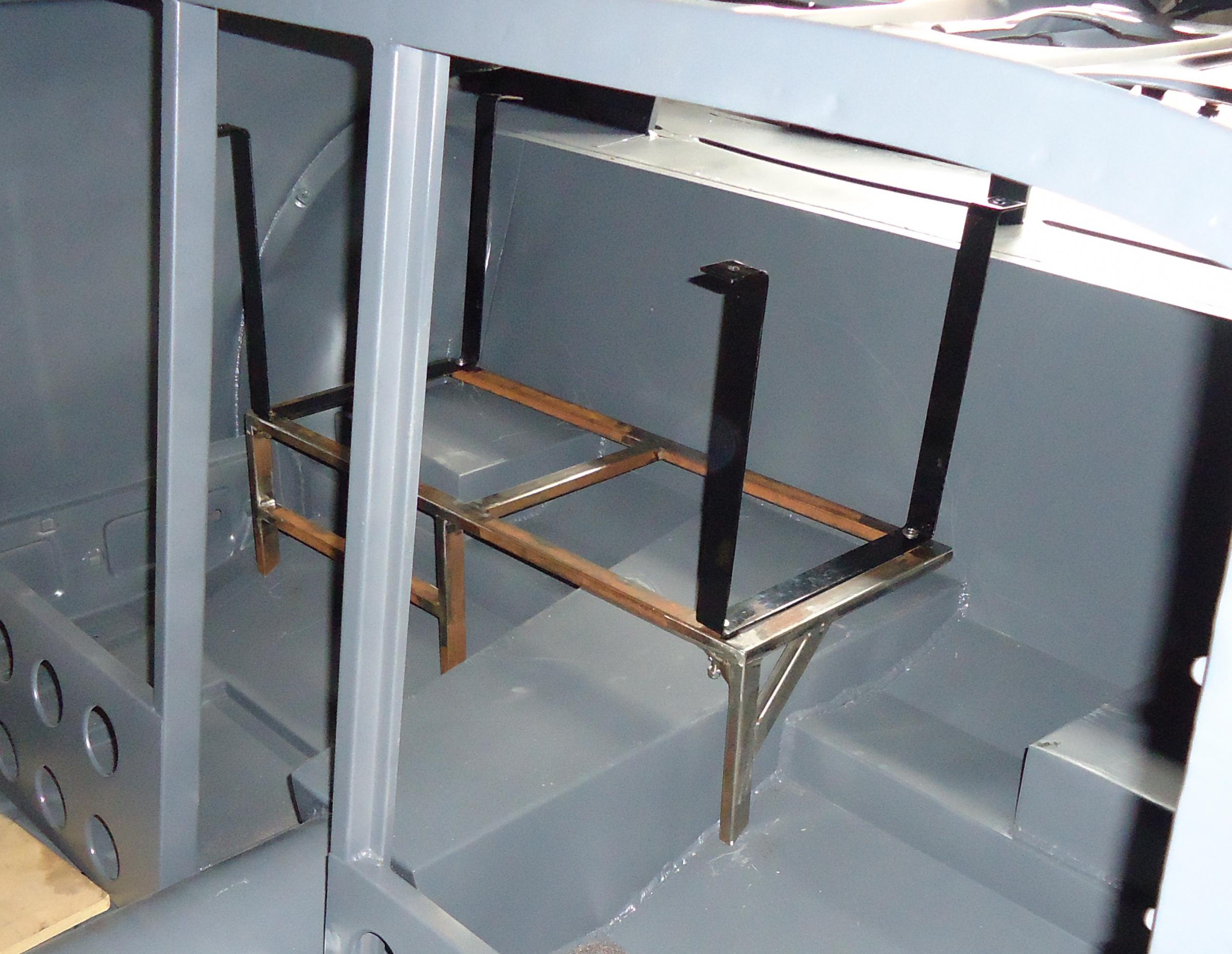

    The fuel cell frame is finished. (more or less) Test fit worked out fine. Going to start on the airride frame tomorrow.
