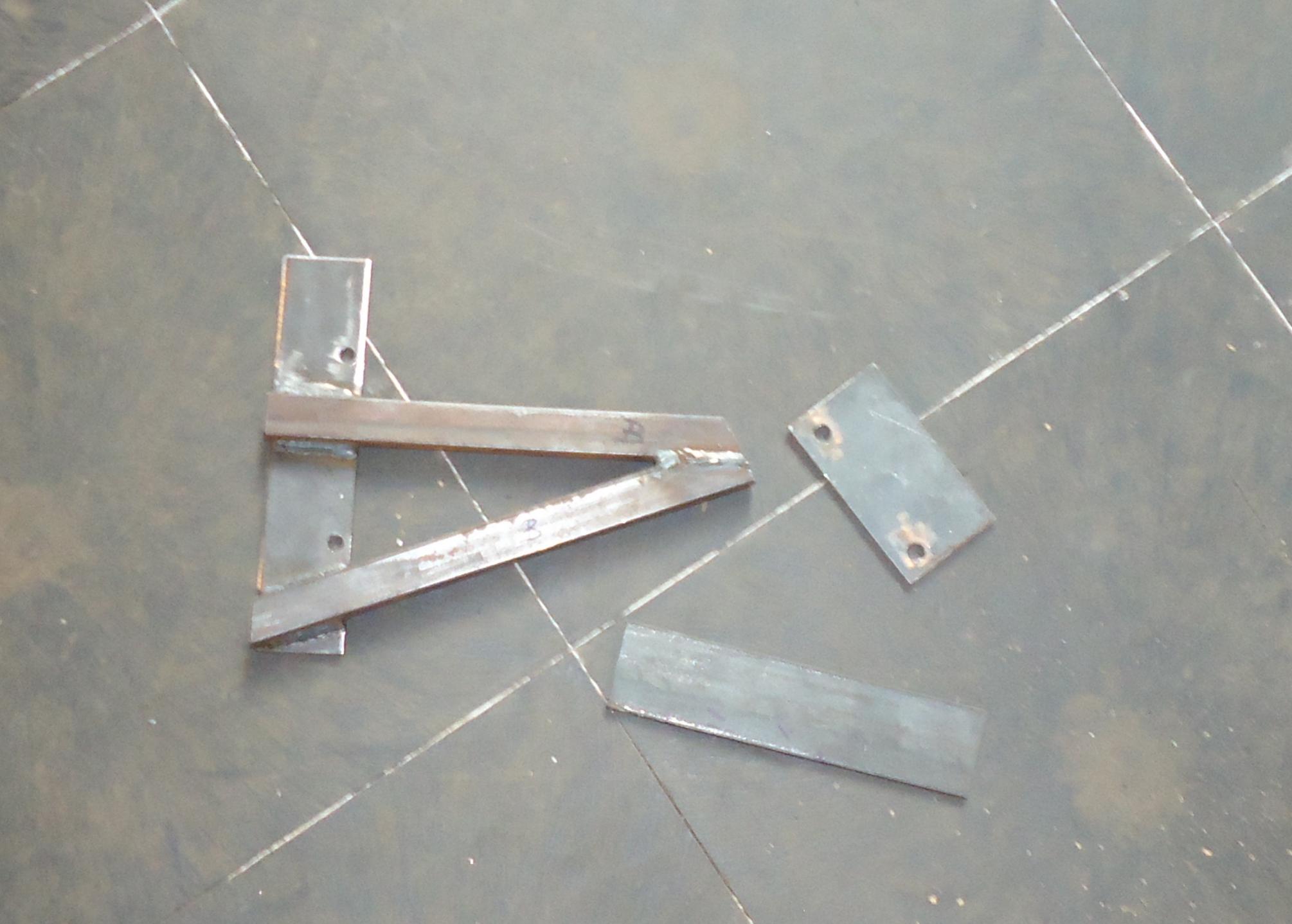

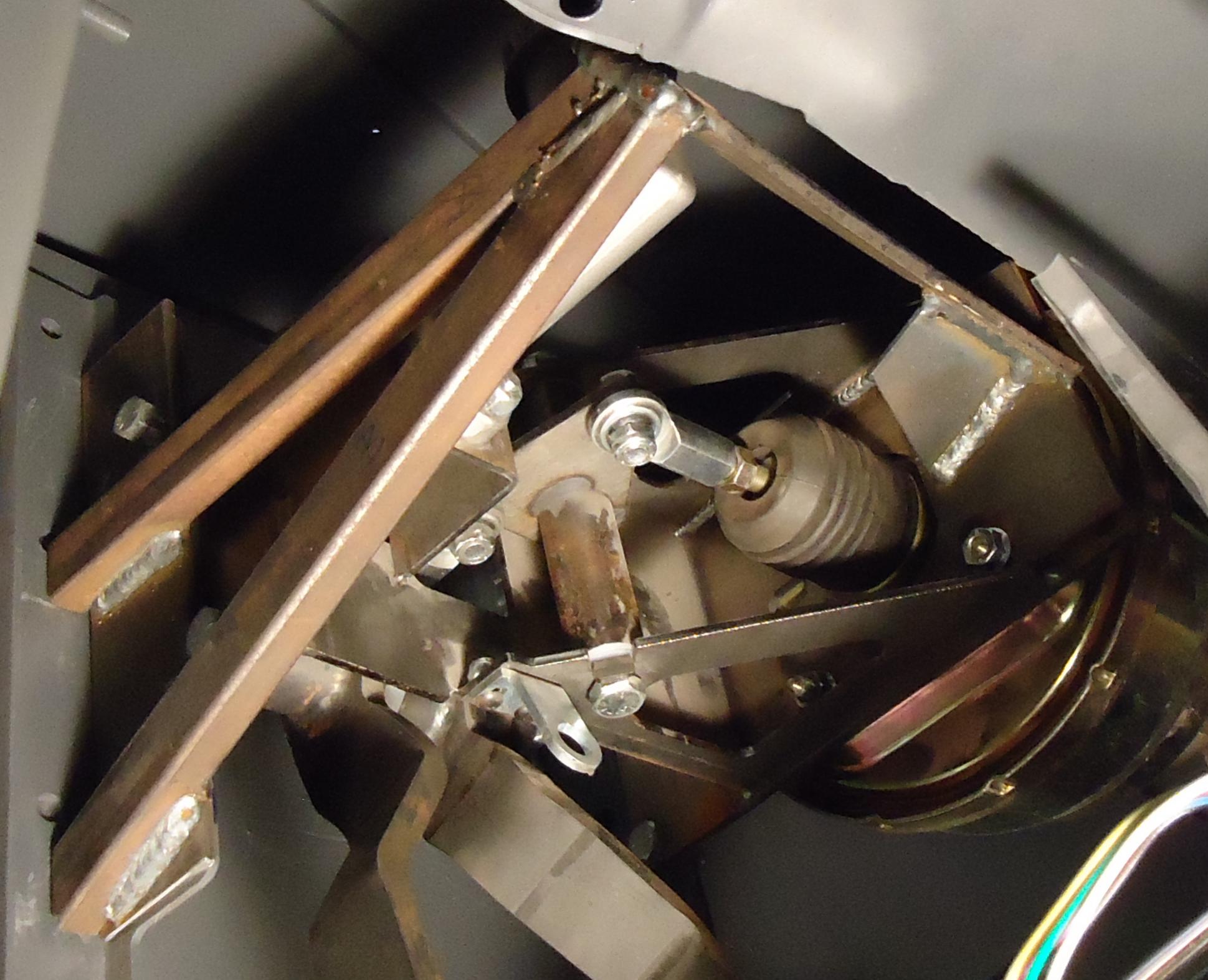

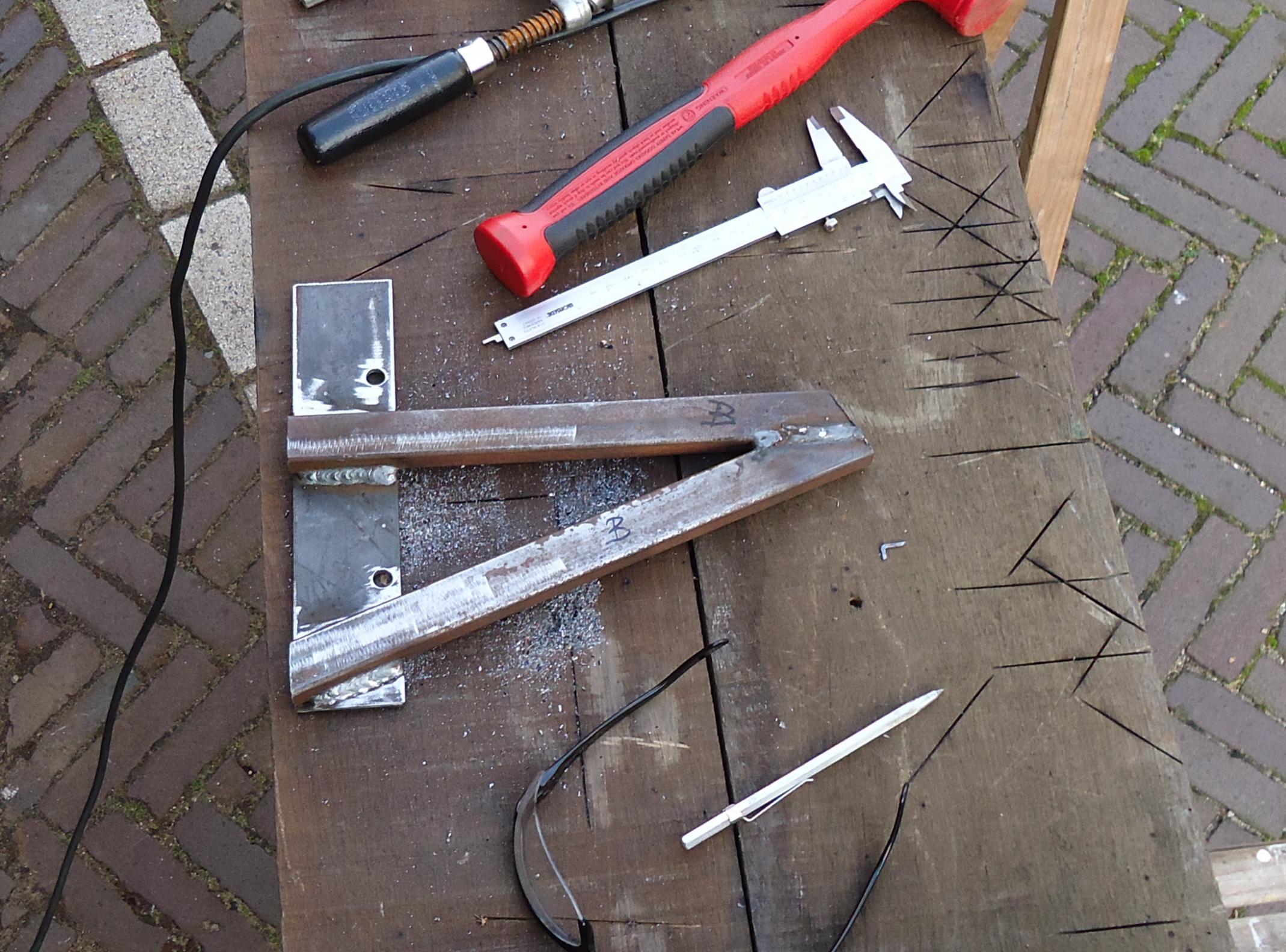

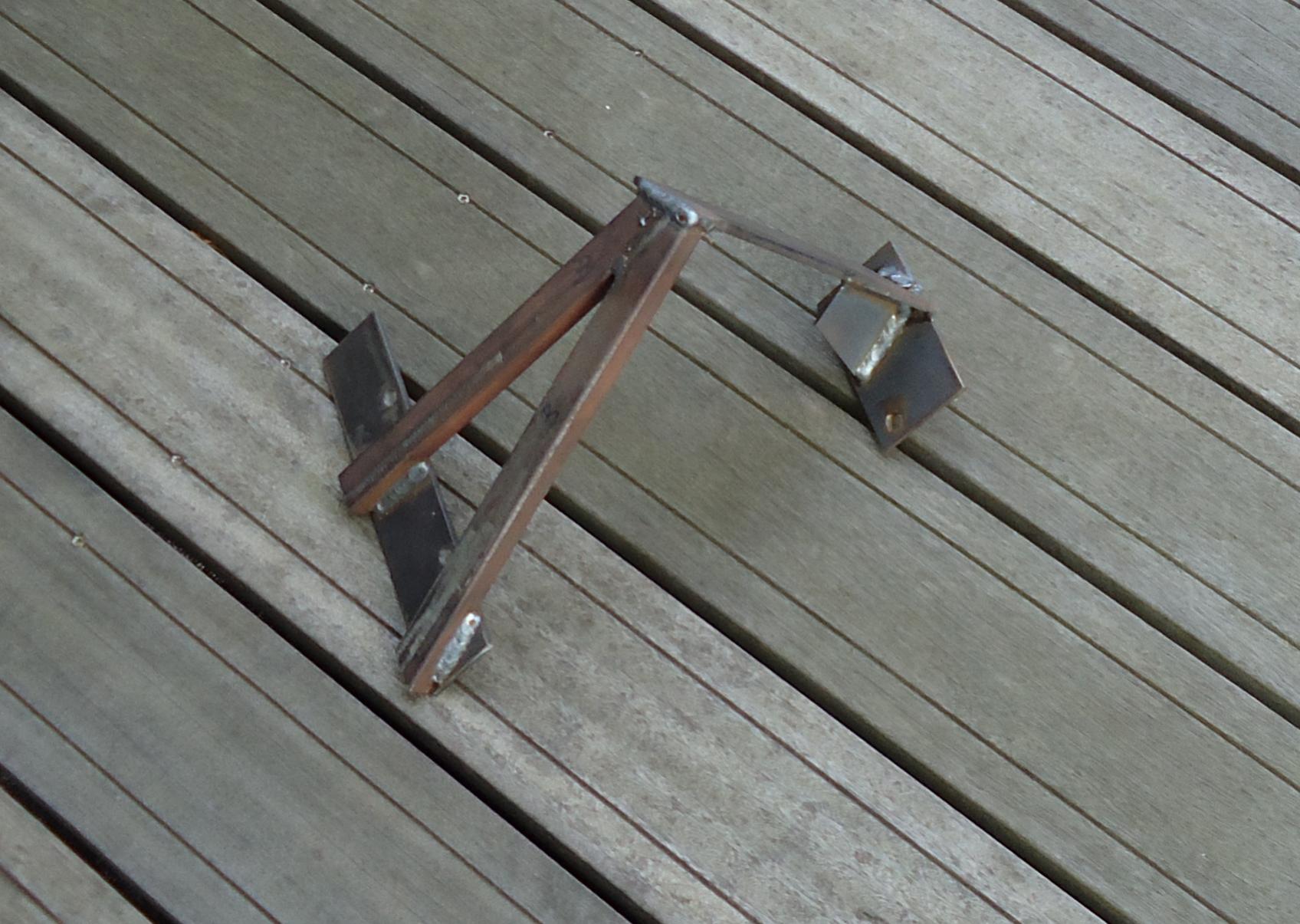

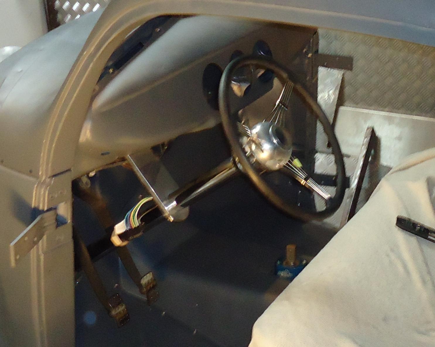

    Had a good day today! I went ahead and started fabricating the frame for the steering column drop. I'm using the frame of the pedal set to attach it to, considering this is completely welded to the firewall which is nearly 4mm thick. The right side is bolted on to the rear of the brake booster frame.
    After all the welding was done,(I know,it's an odd shape, but its very strong), I got it to fit except for one bolt which was 1 mm offset. The column drop is going to be bolted to the thick flat piece, but it looks like I'm going to have to shave a mm or two off the bottom of the dash for it to clear it.
    It's off to work for me now. Monday I'm going to clean up the frame and install it completely, including the column drop.

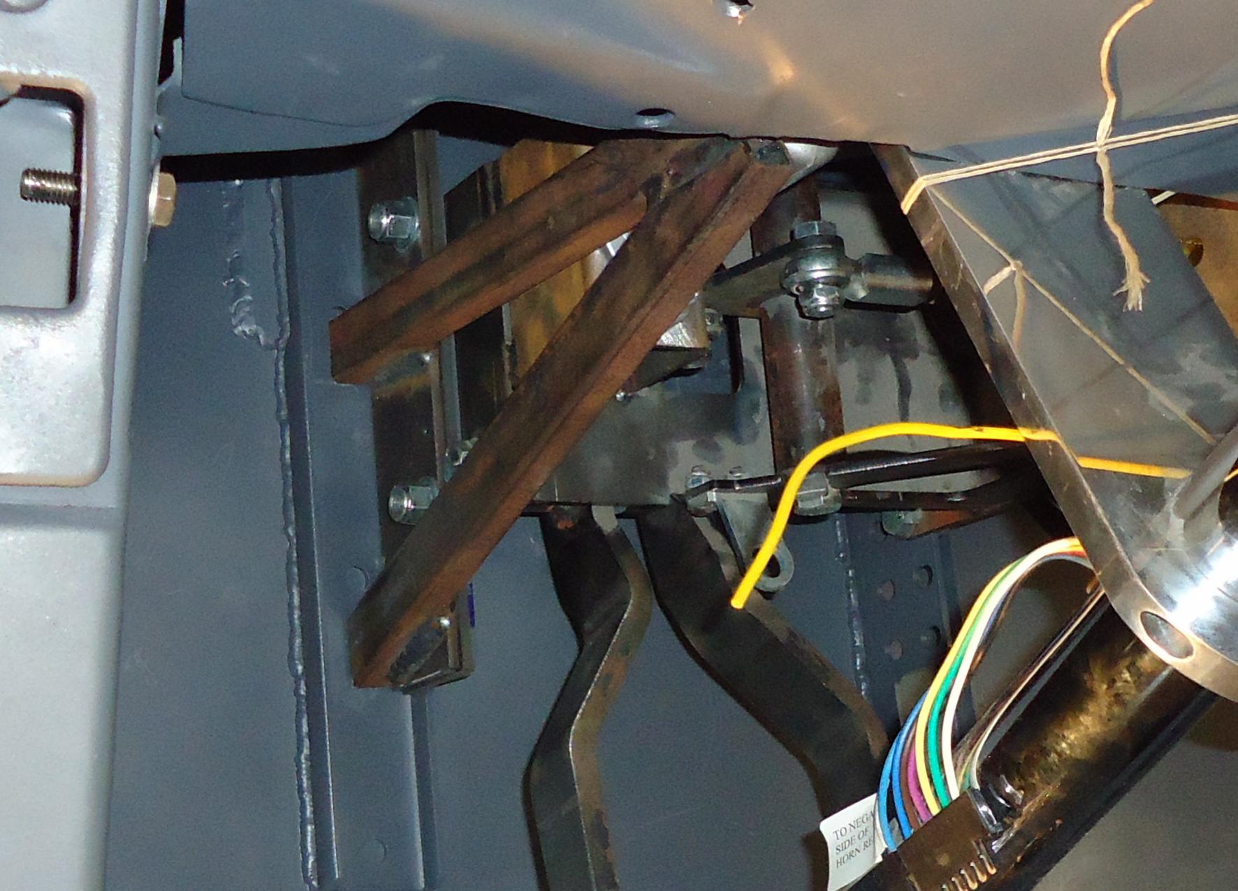

    It took quite a bit longer than anticipated, but I got the column drop bolted in place. It now looks like I will need an extra coupling in the steering linkage in order to clear the engine mount. The column drop will be painted black, by the way.

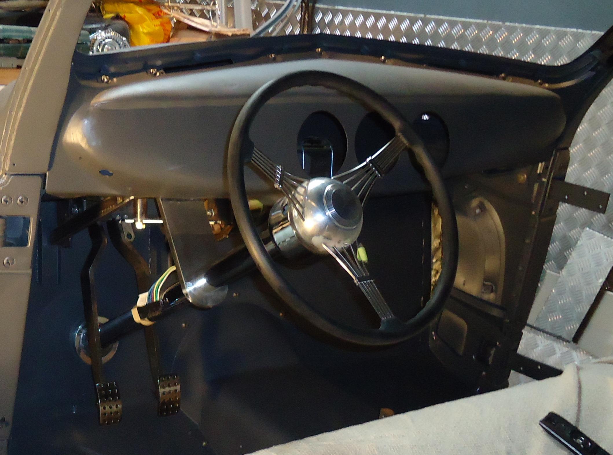

    Installed the gauges in the dash to make sure they're visible and that's there is enough clearance to the brake booster and reservoir behind them. All ok.

    looking good Eric. Are you sure you want to paint the column drop black though... It kind of goes with the gauges and the steering wheel/column. I would leave it be, but that is me. It is looking nice though. So are you going to drive it around to work everything out before tearing it down for paint. I am sure someone has asked that at some point, even me, but have the plans changed?

    Thanks 1959apache. I just feel that the column drop has quite a large polished surface. I'll leave it for the time being though. Maybe I'll cover it with some black paper to see how it looks later on in the build. To answer your other question.....I won't be driving it until she's completely finished.

    Just a thought, you could have someone maybe pinstripe Sinister on that part of the column drop or somehow make a bolt on badge out of letters and have it bolt on right there to hide it (that way you can still paint it). I agree it is pretty large.
