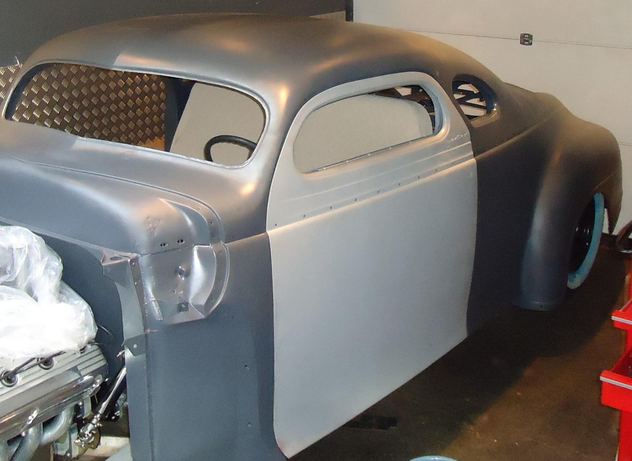

    Retreaded the holes in the pivot plates for the door so I can use stainless m8 bolts. Mounted the drivers side door and spent a good while adjusting it in place. The bottom half is perfect now, but as you can see, I'm going to have to rework the top half. First on the list though is the installation of the bear claw.

  13. 1959apache
    Joined: Nov 22, 2009
    Posts: 2,635
    1959apache
    nice work so far. Are you going to be cutting the inner part of the door to bend it down to the right place? how are you planning to tackle it?

    The initial idea was to cut the top half of the door and bring it up towards the roof, but I sat in the car last night and saw there is little room to move it up further on the inside. So the plan is now to align the top of the door with the roof (vertically) and then see how I can close the gap. I may weld a piece to the top of the door or bring the roof down lower. (or a combination of both.) I just want an even gap all the way around without ruining the lines. Hope this explains it.

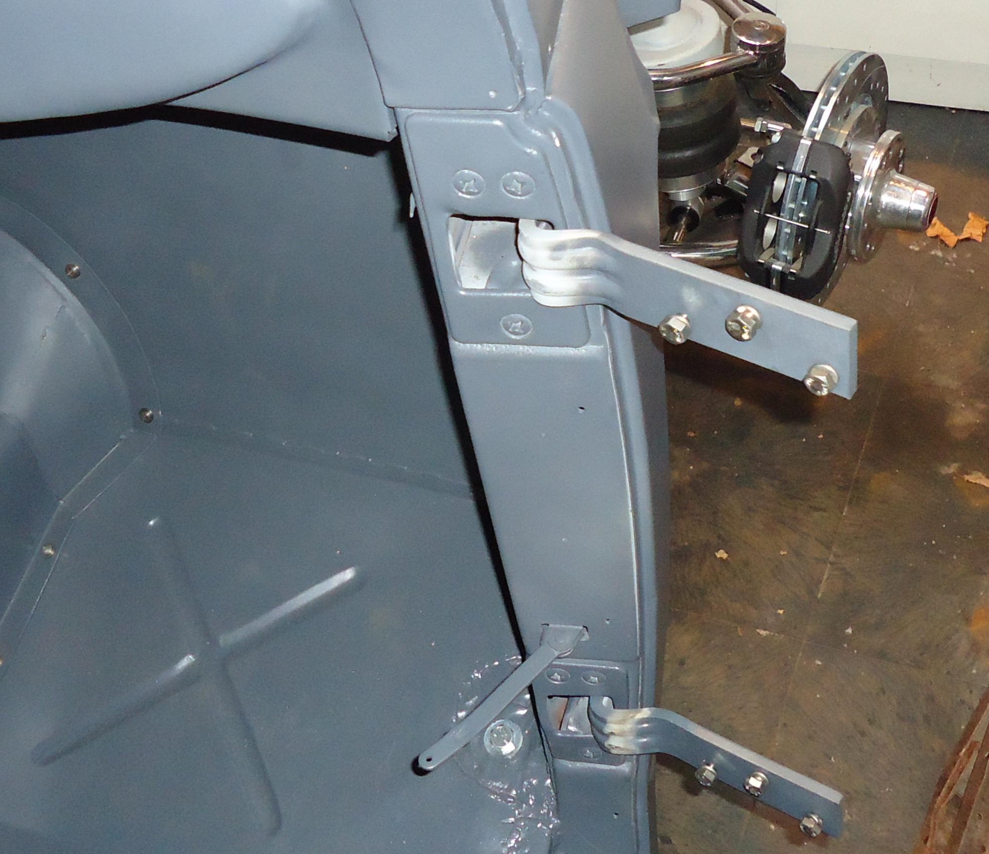

    Started on the bear claw installation on the driver door. It was another case of measure, cut, weld, grind and paint. Came out looking good. Going to position the bolt tomorrow, amongst other things.

    Looks good, I would like to do the same for the Plymouth, where did you pick them up.

    I got the bear claws at Juliano's.
