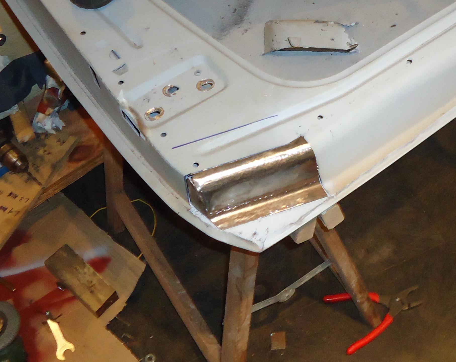

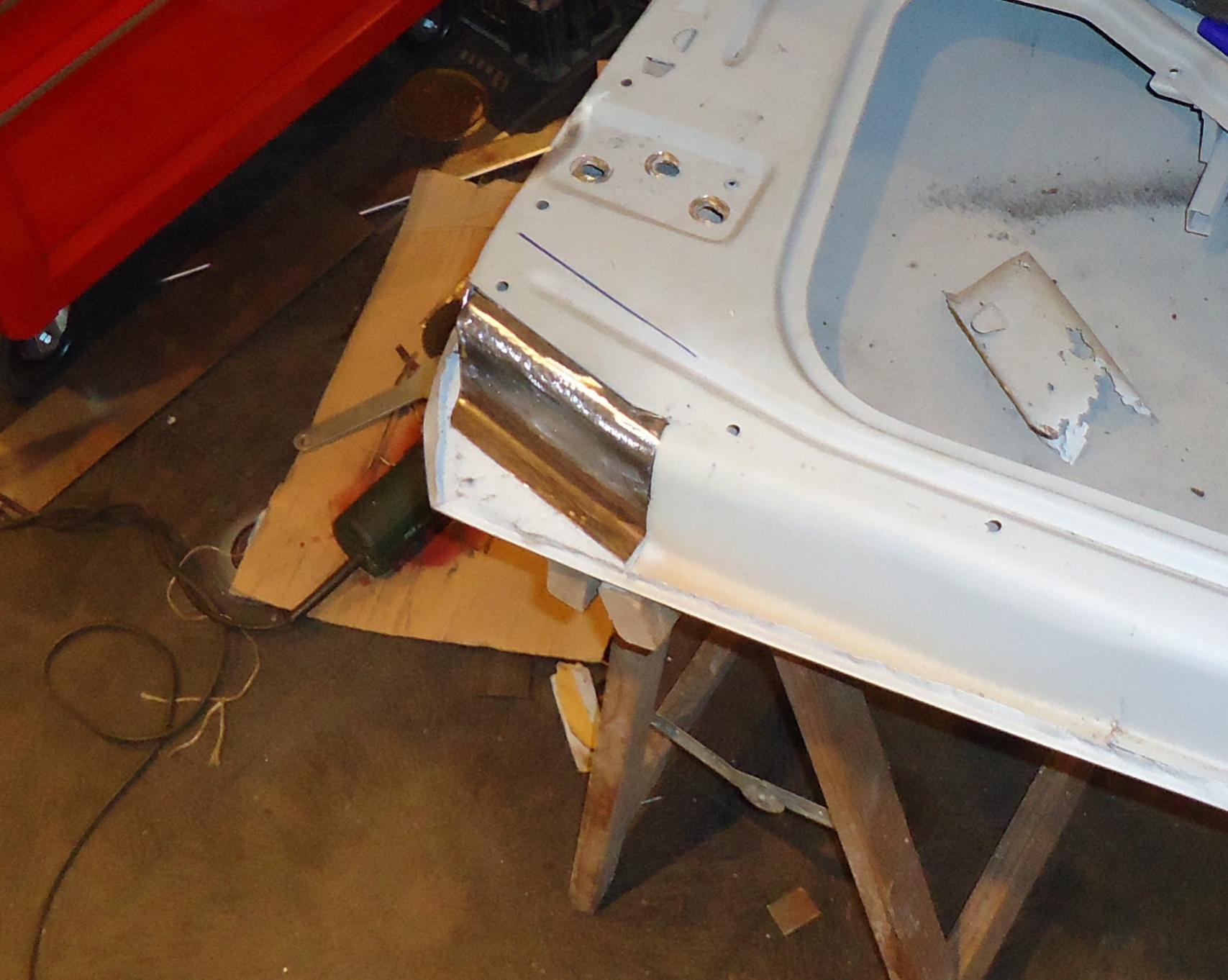

    Today was one of those days where I had lots of plans but got interrupted soooo often, I only managed to do half of what I'd planned. You guys must know what I'm talking about.
    Anyway, attacked the lower corner and fabricated a new piece. More tomorrow.
