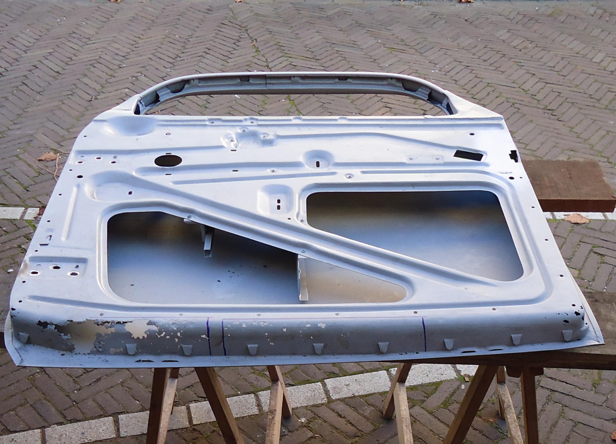

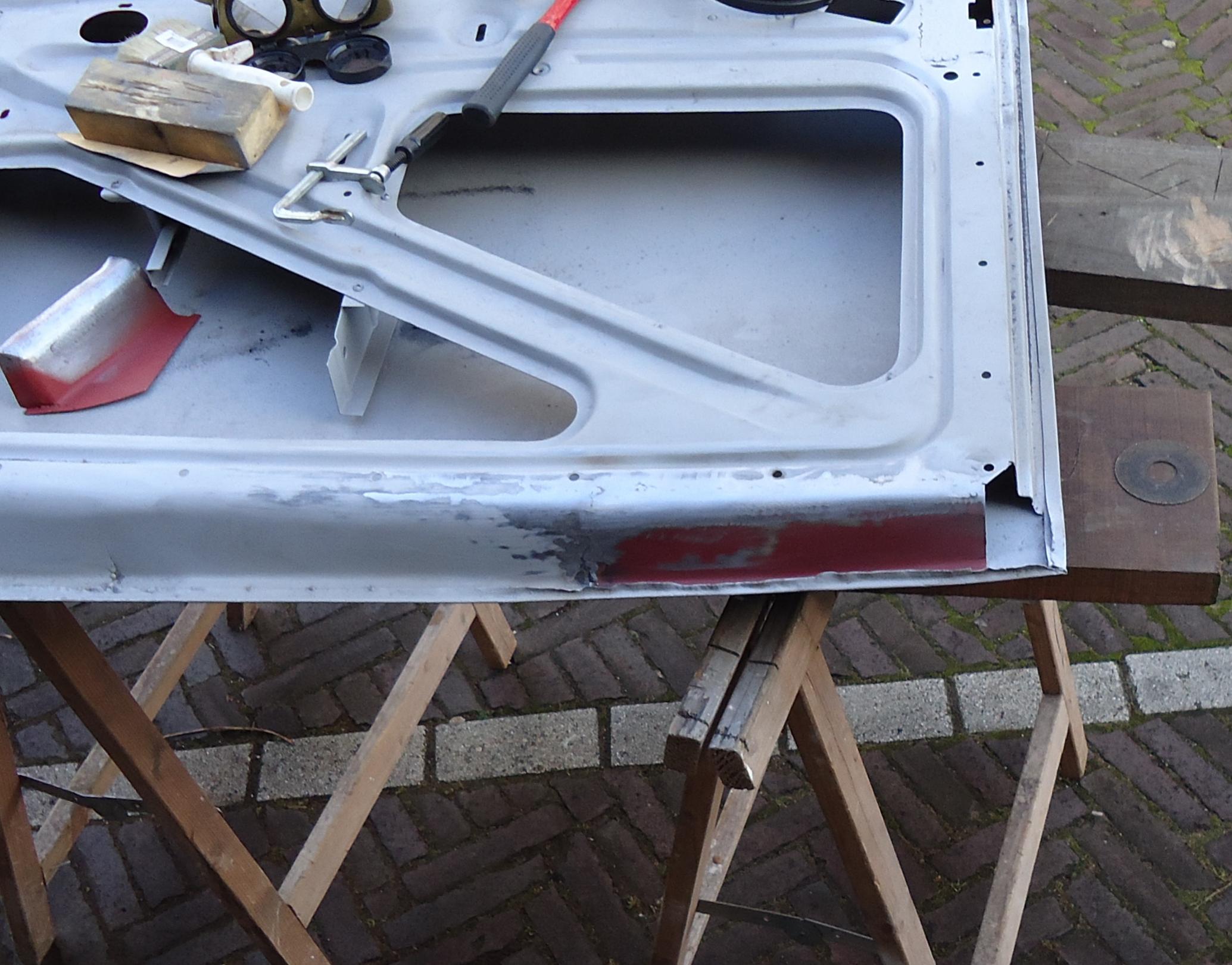

    What are you doing to clean the lip of that door skin (where it rolls over)? are you going to seal it? Just wondering, my doors are not as bad as yours so I won't have to do the same thing you are doing, but you never know when I am going to have to use that skill. How much more do you have to tackle on that door?
  5. will you have to put any drain holes in your patch panels??? It's hard to tell from the photos where the factory drain holes were. Just curious. As everyone else has stated, you're doing a mighty fine job.

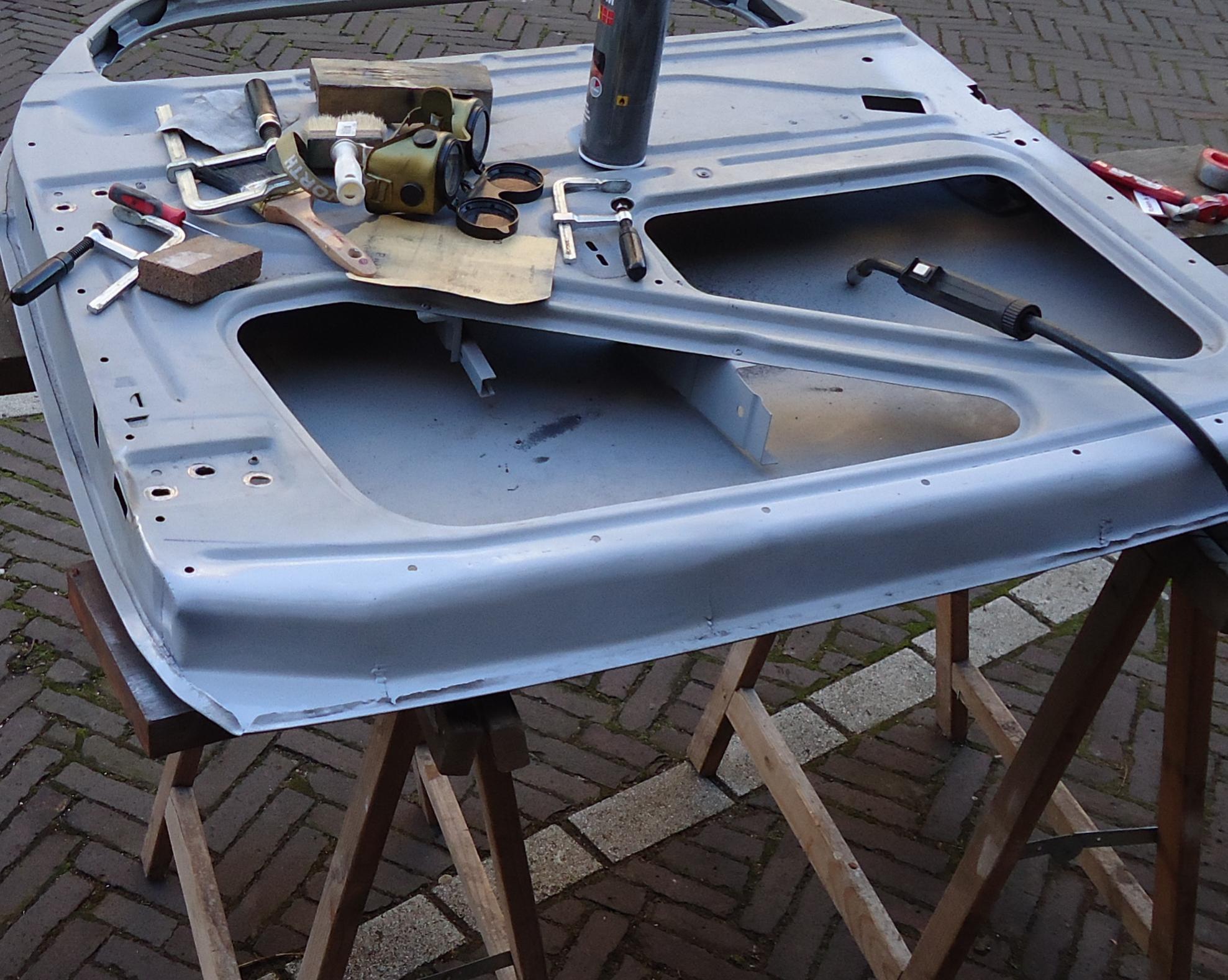

    The lip surprisingly is not welded anywhere, it just holds the inner and outer panel together. I basically bend the lip up, remove the inner panel piece, clean/sand the dirty area and spray it with an anti rust primer. Once the new piece is fabricated, I slide it down, and bend the lip back into place. Once the lip is hammered straight again, I place a weld on the top of the lip every inch, which will connect it to the inner panel. Grind the welds smooth and you're done.
    With regards to the whole door, it will still take some time as I need to re-do the welds where it was chopped, remove the vent window brackets, move the window track forward and see if the whole thing needs strengthening. Then I need to figure out how I'm going to make the bear claw operation work and where to place the electric window regulator. And I need to install the electric window as well. So as you can see, I ain't finished with this door soon.:)

    Did not notice any drain holes, but did not look closely I must admit. I presume that the 9 or 10 "clips" on the bottom are to retain a rubber of some sort. I'll have a look at the bottom of the driver's door to find out if I can locate the drain holes. Maybe the drain holes are the two louvered sections? Thank you for pointing it out.

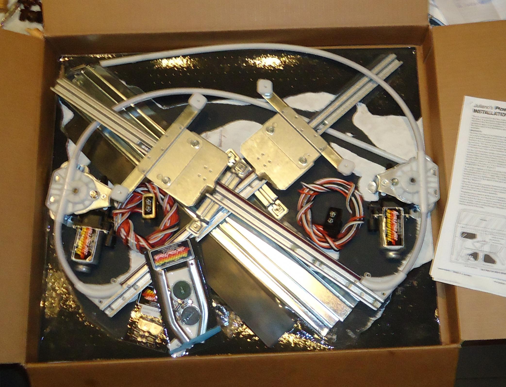

    Eric, I would say yes the louvered spots are your drain holes. What power window set up are you using? I've seen ones that use the existing window tracks but replace the crank portion with an electric motor or the universal type that includes all the tracks? nice work lookin great. shawn
  14. milwscruffy
    Joined: Aug 29, 2006
    Posts: 4,172
    milwscruffy
    If you look closely there are four slots formed for drainage right where the door skin crimps onto the frame at the bottom edge. Not very big and that's why theres rot.
  15. farmer12
    Joined: Aug 28, 2006
    Posts: 7,721
    farmer12
    Shawn, I think you're correct. the louvered panels are the drain holes. I'm trying to think of something else I can use instead of these louvres.......
    With regards to the electric windows, I opted for a general use setup from Juliano's. I still had the box laying in my office, so I thought it was time to unwrap it and take a closer look. I will need to customize it a little but they should work. I will get rid of the ugly switches and use a normal window crank with an electric switch behind it.
  16. farmer12
    Posts: 7,721
    farmer12
    100% correct. So I'm going to work out something else for the drainage probelm, just don't know what yet.........if someone has an idea, let me know.:D

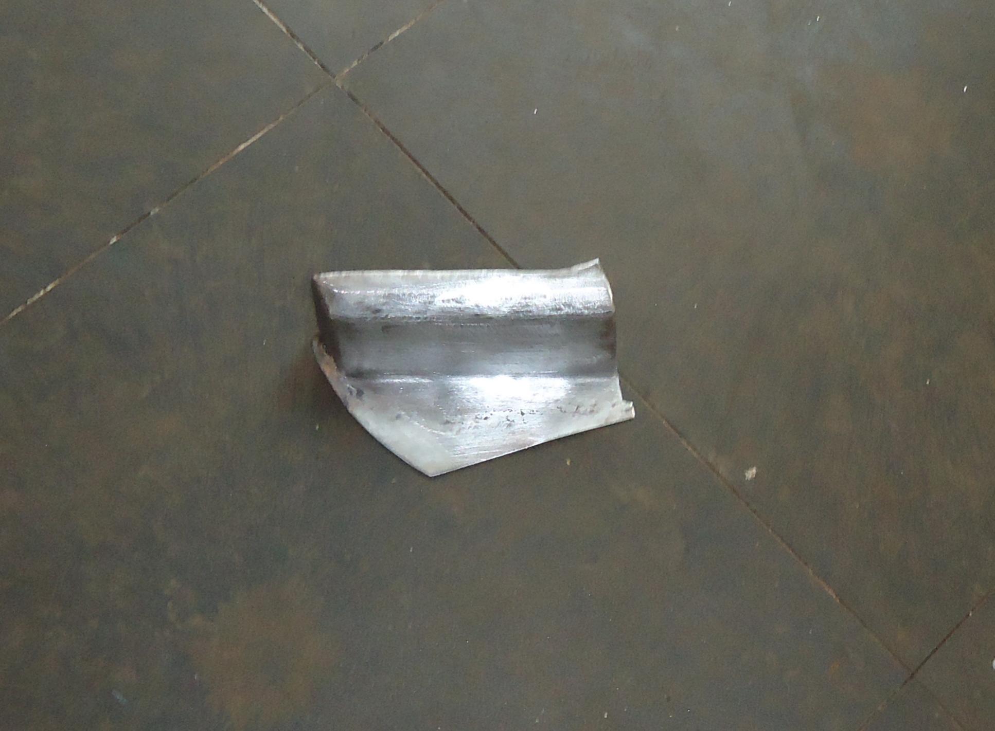

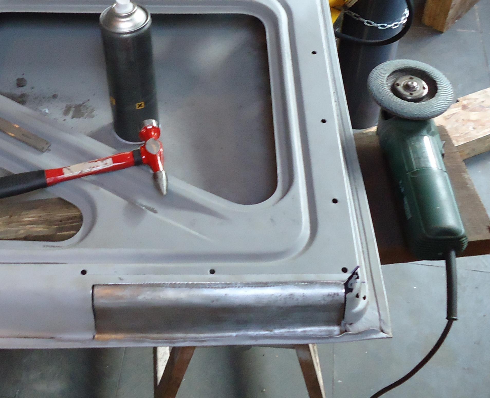

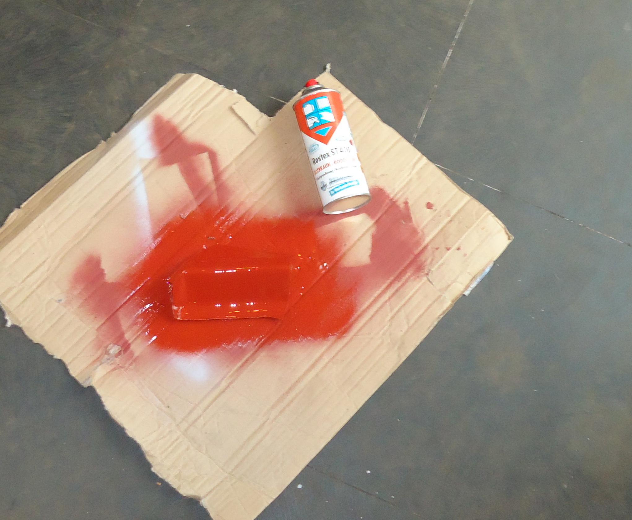

    It was back in the garage today. Removed the next piece and found quite a bit of surface rust. Cleaned it up, sprayed it with primer and fabricated a new one. Quite a challenge as it's slightly rounded and tapers off towards the end. A welding session is planned for tomorrow.

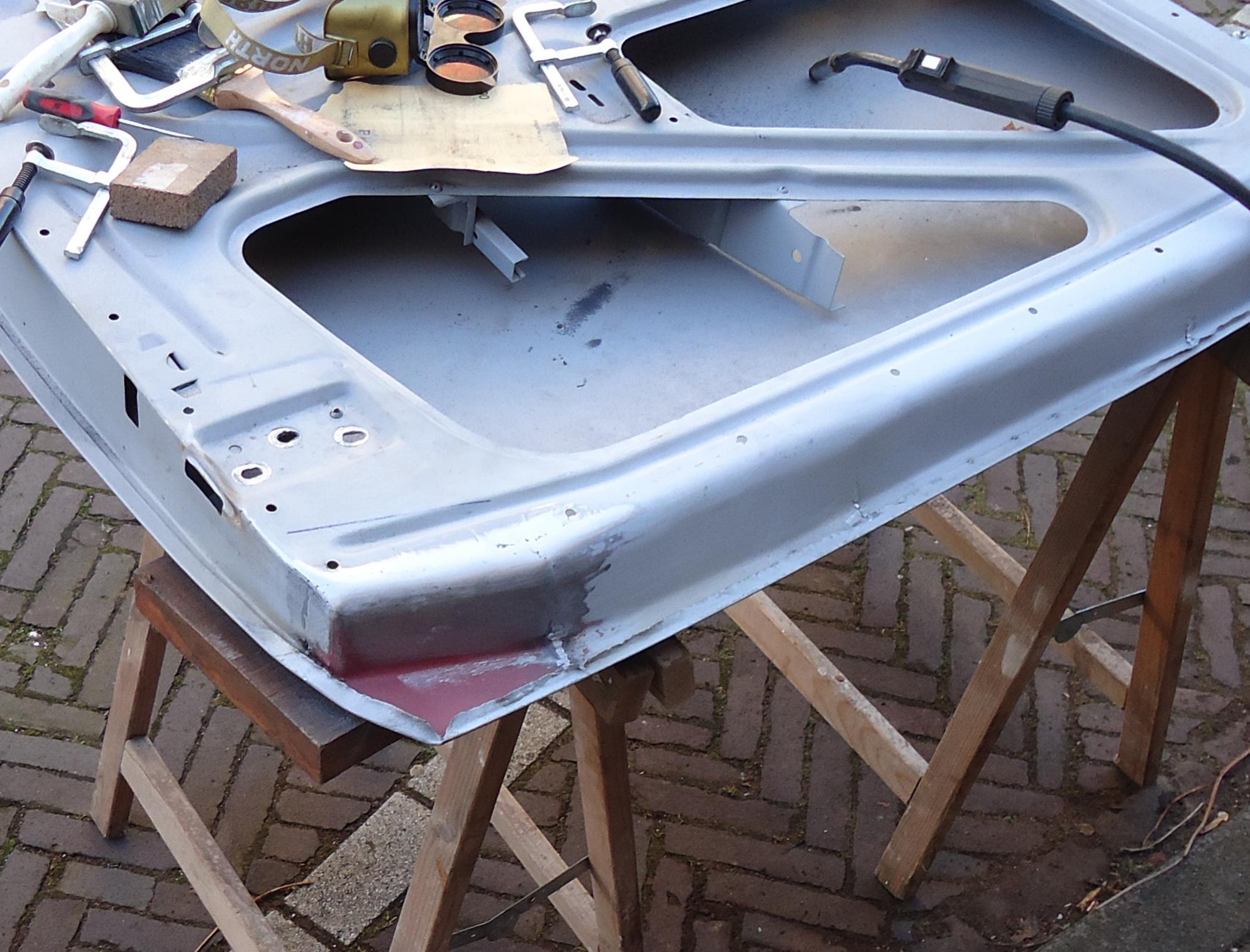

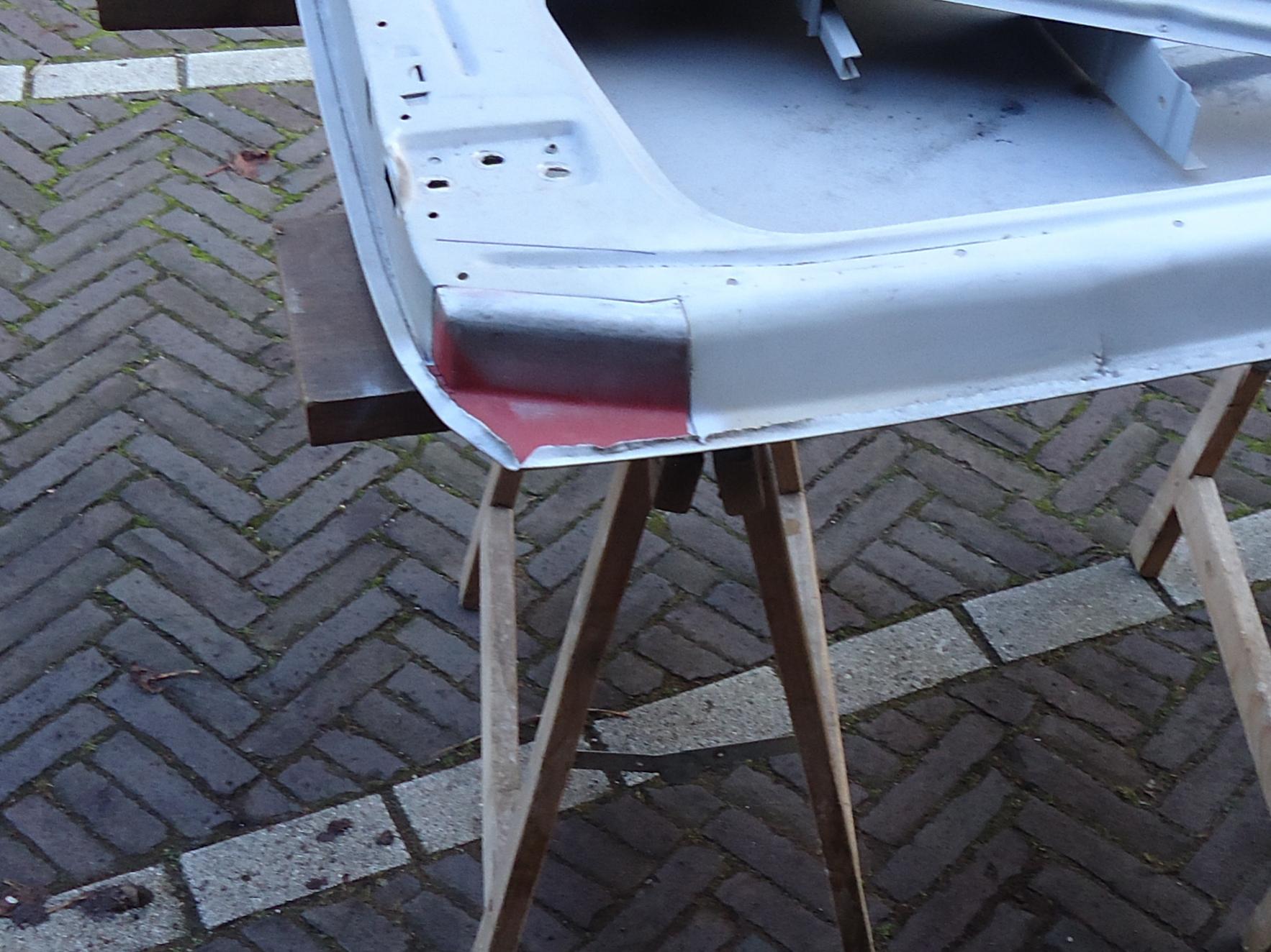

    Welded in the last "straight" piece. Then it was onto the corner piece. I welded the flat piece on and gave it some primer. Then welded this in, cleaned it up and painted it. I still need to to the other corner, bend the lip back/spot weld and get the Dremel out to clean up the welds where the pieces meet at the bottom. All in all, got quite a bit done today.:D
