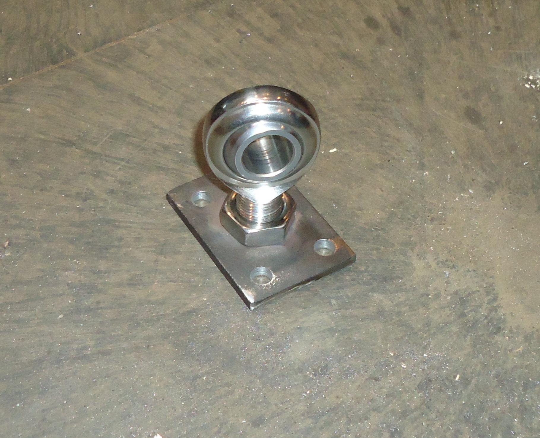

    It's time to show the progress on the rod end bearing. I've decided to mount it on a steel plate, rather than just in the frame. Cut a piece of 5mm steel and drilled 4 holes. Then cut the bearing to size, drilled a m***ive hole in the middle and welded it from below. I left one big nut on there which will act as a show piece and perhaps stabilizing the thing as a whole. The bearing is welded on an angle, (still perpendicular to the steel plate though), so I can follow the line of the ch***is. (see last pic). I clamped it in place and works perfect! I marked the edge of the plate so I can drill and tap the 4 holes once the engine is out again.

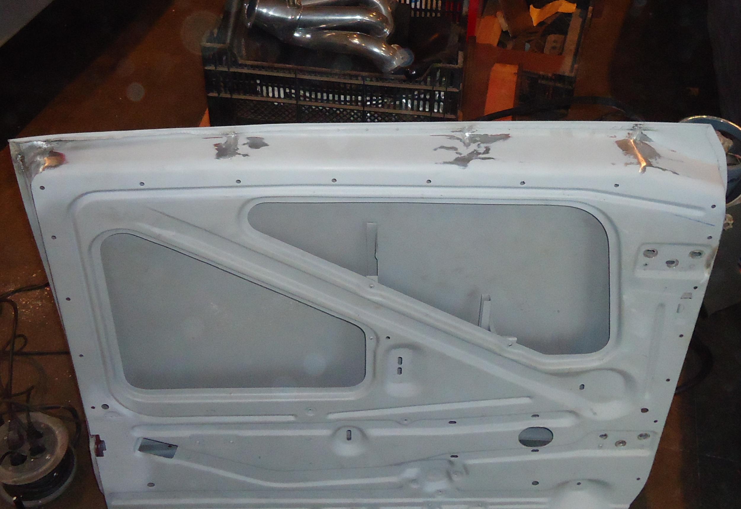

    Spent the rest of the afternoon with the Dremel to clean up the welds of the bottom of the door. Painted it with primer. All that's left to do is bend the bottom lip back, spot weld, grind and primer. Then that part of the door is done!:D:D:D

    ..And add drainage holes, right? :) Looking great!

    My only concern,and someone correct me if I'm wrong, is would the heat from the header ruin the bearing? Nice work on the door.

    Good question, but I don't think thats going to be an issue.

    Thats a pretty slick solution on that bearing mount Eric, looks good too!

    Thank you for your concern plmczy. Even though the rod end bearing is fairly close to the header, I don't think it will be a concern as the shaft moves through there freely. If problems do arise in the future, I could make a heat shield between the bearing and the header. I think I'll leave it as it is for the time being.

    Eric to get the best feel and to make the steering smooth the bearing needs to be as far away from center on the long shaft as you can get it, as close to the middle u-joint as possible. The closer to center on that shaft you are with the bearing the heavier the load will be on shaft and the center u-joint as it rolls. If it has the slightest "wobble" it will give you a "tight then loose then tight then loose" feeling in the steering wheel as you turn with a load (car on the ground). One other option might be to shorten the long shaft and put the bearing on the other side of the center u-joint. That center joint don't care which side of it the bearing is on, just as long as it is firmly positioned.

    Thank you Ford blue blood for your advise. I did try a shorter shaft but I could not clear the top and inside of the ch***is. I figure that if I do encounter problems with the steering as you described above, I'll have to fit another rod end bearing between the column joint and the middle u-joint.

    From what I can see, you will be fine with that rod end bearing position. Looking good Eric! Awesome work once again.
