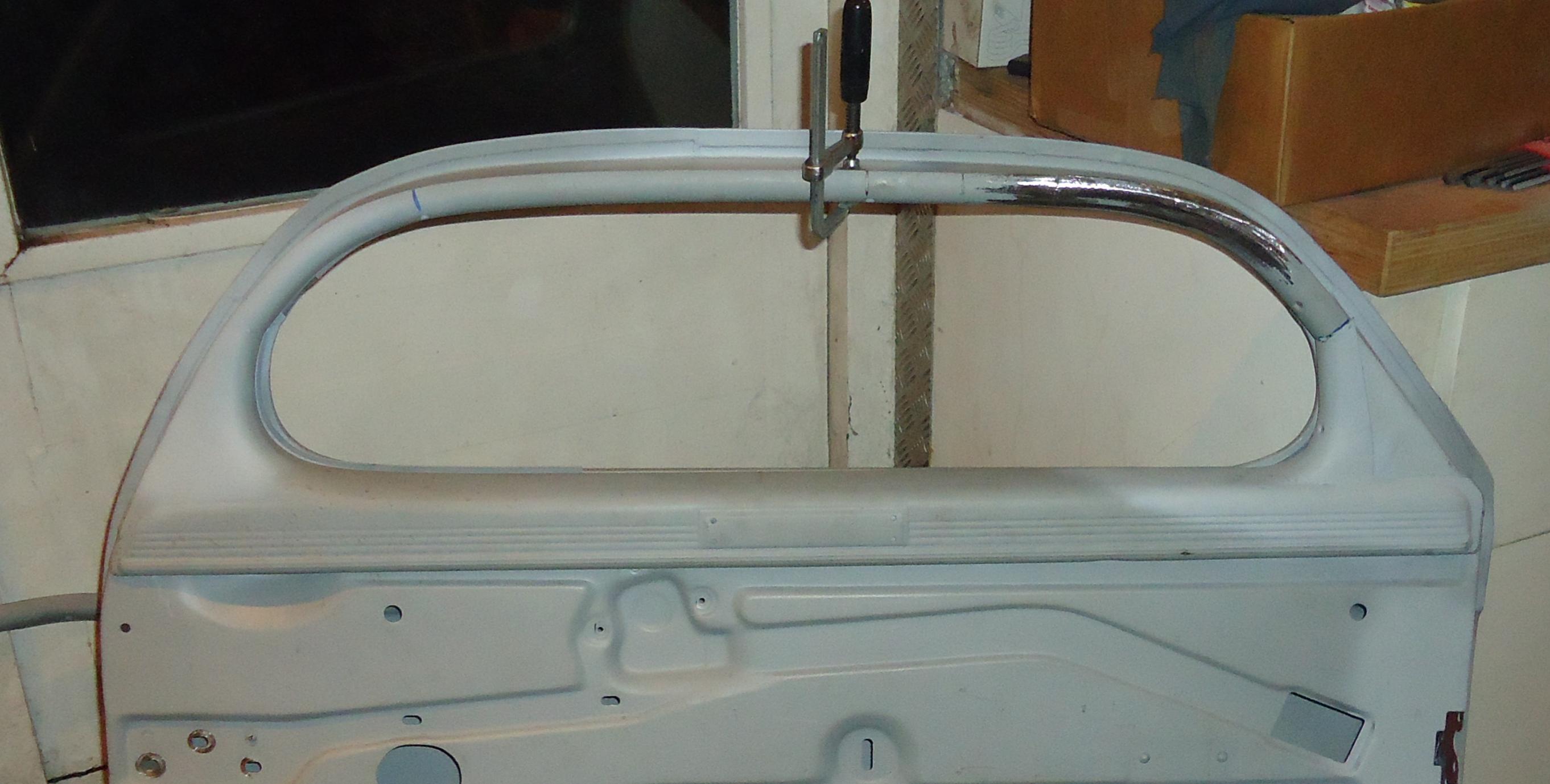

    how is the window molding coming along? It sure looks nice so far.
  5. farmer12
    Joined: Aug 28, 2006
    Posts: 7,723
    farmer12
    Funny you should mention that......just returned from the hospital to get some metal splinters removed from both eyes. After the last post of the window molding, I decided to get rid of a few small welds left on the inside with the Dremel.......and wore no gl***es....very smart, I know. All is ok now, the eyes are recovering well. It was a serious case of blood, sweat, tears and metal splinters in the eyes. (and yes, I've learned my lesson.;);))

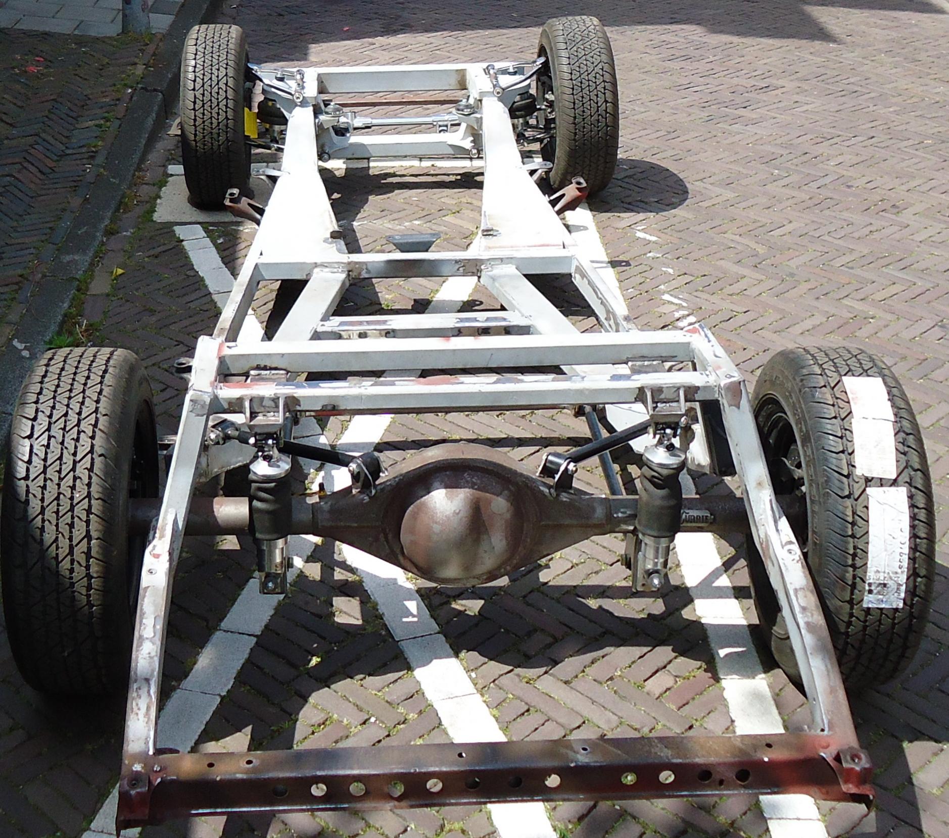

    It looks like we have similar tastes in rear suspension.
  26. farmer12
    Posts: 7,723
    farmer12
    Certainly looks like we got great taste! :D Just a question, why did you angle the bags/shocks?
  27. BACAGrizz
    Joined: Aug 27, 2009
    Posts: 201
    BACAGrizz
    When I talked to the guys at Ride Tech they told me that setting the shocks at a 20° angle would help with the handling. It may eliminate the need for an anti sway bar in the rear. We'll see. I did get the internal height sensor shocks front and rear. Master series, single adjustable.

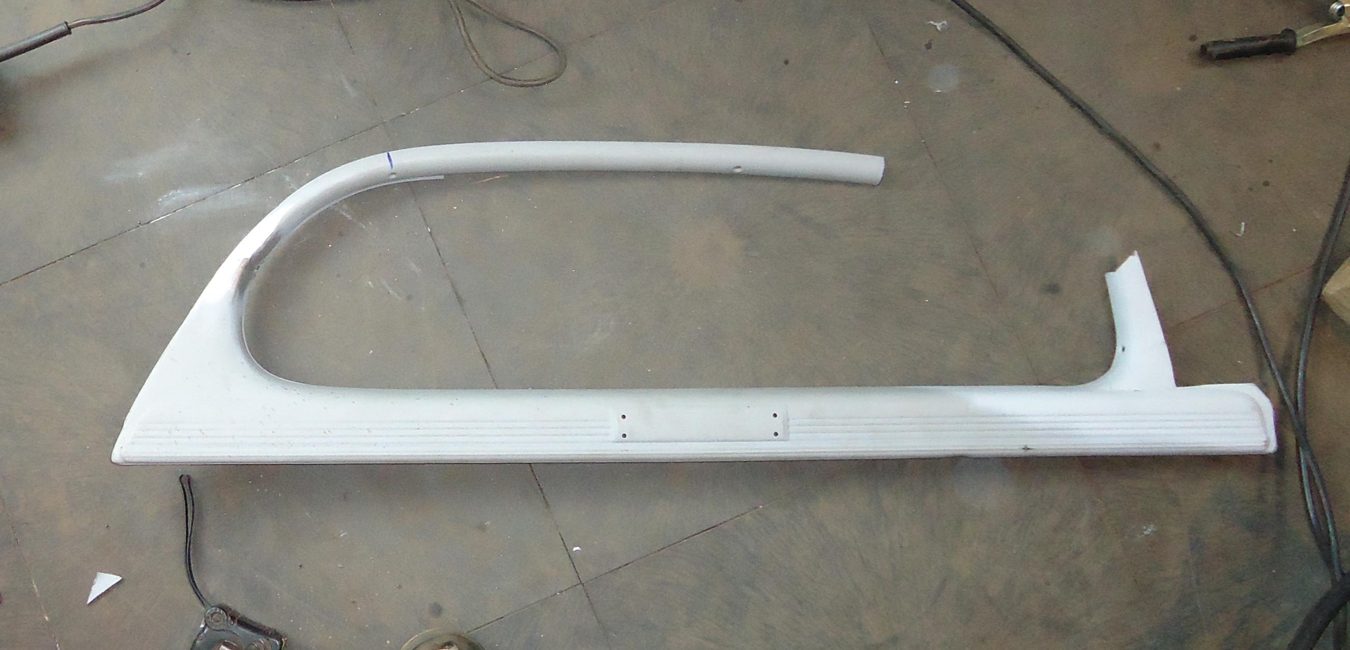

    Conitnuing on with the window garnish. A lot of cutting and welding. Had to splice the last piece in order to get the right curvature. I guess another couple of hours tomorrow and she'll be done! So next time someone says it takes a day to chop a window garnish, I believe them!:D
