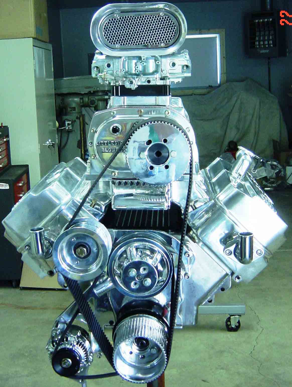

    Thanks Bored&Stroked for the in depth explanation. Now I see why its such a tight fit. The only issue I'll probably have is with the mini alternator, which probably won't clear the narrow x member. Haven't test fitted the real engine yet, but I hope I will only need to fabricate a new bracket to bring it slightly closer to the engine. If possible, I want the alternator to stay low and not on top of the engine. Do you know if there is an alternator that can be reversed? By that I mean, have the back of it towards the radiator i.s.o. the firewall? (not even sure if these things exist) Just trying to look at all available options.
  4. I created a custom bracket to mount it low and in the front - so you can't really see if very well and it is out of the way.
    Here is a picture - mocked up on the stand:

    Thanks for the pic. This may be an option as well. I'll give it a try once I get the engine mounts welded in and mount the engine in its final position.
