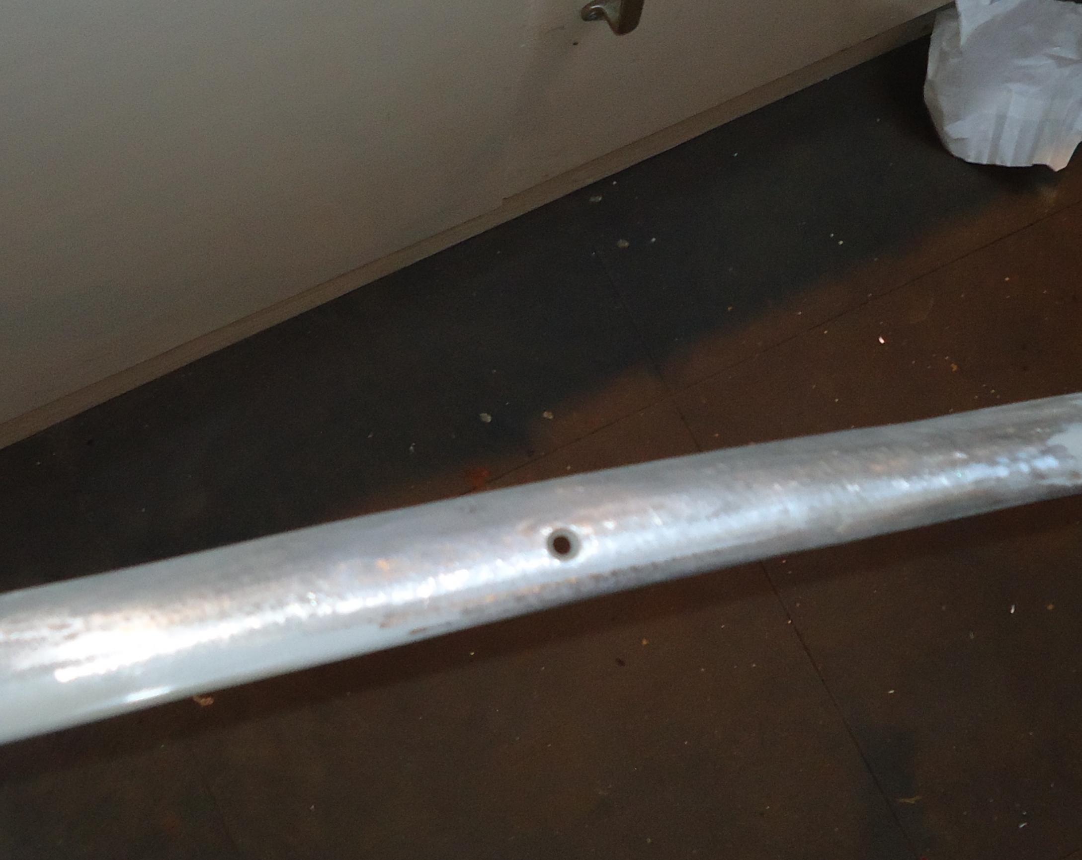

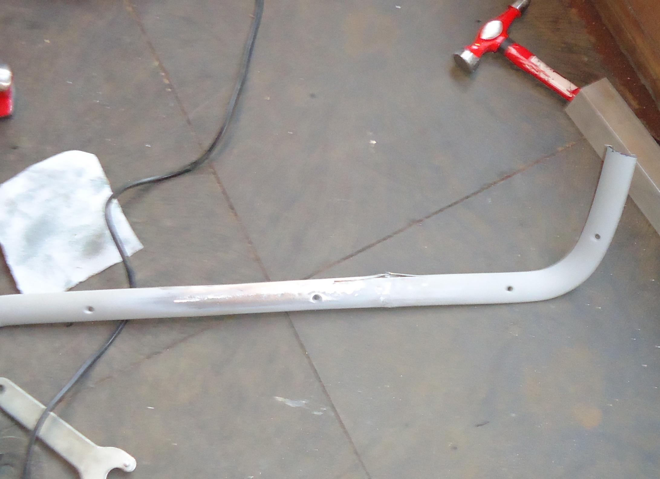

    Today I started on the front window garnish. I'll do it chronological order, just to do something different.
    pic1 This is a pic from the seller. (I think it was ebay)
    pic2 This how I received it from UPS after they probably used it as a frisbee.....

    Was it hard to weld the garnish molding up? I'm not sure how thin some moldings are.. I'm thinking about incorporating some in my A build.

    The moldings are only 1 mm thick, it's strength is realised by bends, curves and lips. When I weld a molding I clean it first, use my grinder to make a 2 mm wide cut, weld and grind smooth. I weld a maximum of an inch to an inch and a half long, then let it cool down before I grind, then re-measure and continue. Hope this helps.

    ouch, looks like seller folded the end to fit it in a box. nice save, your not keeping the defrosters?

    The seller said it left his home perfect and UPS have only replied with their standard emails. I figured it needed modification anyway, so I'm not going to get into the "negative energy mode" and waste my time trying to sort out who did it. To answer your question: the defroster slits were so badly damaged that I welded them up. I may just make a single cut there to allow the air to p*** through......haven't decided yet.

    Continued on with the front windshield garnish moulding today. Finished off the top and bottom halves. Did a test fit and did not go too well. (probably due to the fact that when UPS bent it, the whole frame got out of shape).I don't know how far it's situated from the windshield /weatherstrip, so I'm going to order one before I continue. It also looks like I'll need to cut the mouldings in half again in order to get it lined up properly. Maybe it will work once the rubber is installed......we'll have to wait and see.

    I couldn't stand the fact that my windshield garnish wasn't straight, so I went out and bought a little torch to see if a heat treatment would work. And it did! I clamped it to the wood from the engine stand (I know, very smart) and heated it, cooled it and hammered it and........I got it straight!
    Now the only thing bothering me, which hopefully this can be answered by one of you guys, is that the radius of the bottom garnish in each corner is too much. Now I can apply heat and shrink the outside, but want to make sure first. (maybe if I bought the weatherstrip first, this would give me a clue as well.)
    In the photos it looks like the radius of the top garnish is too tight as well, but this is due to the overlap.

    If I were you, I would cut the moulding at the bottom just outboard of the mounting screws and then use pieces from your overlap extra material to fudge it all together.
