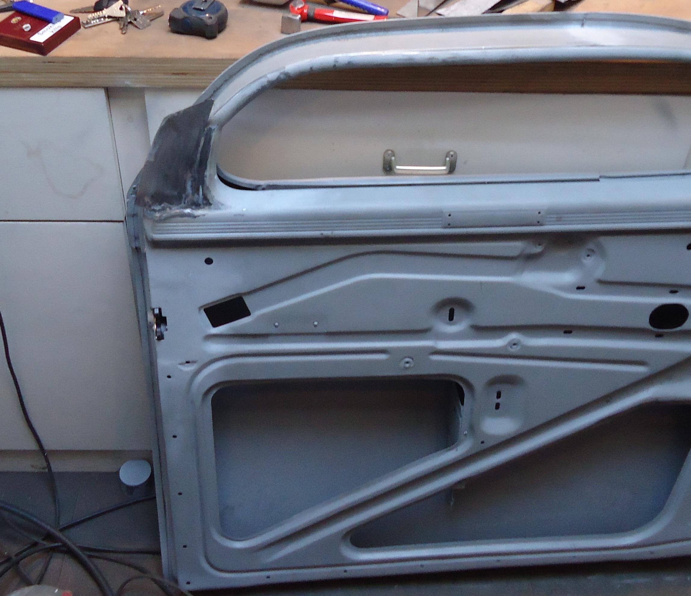

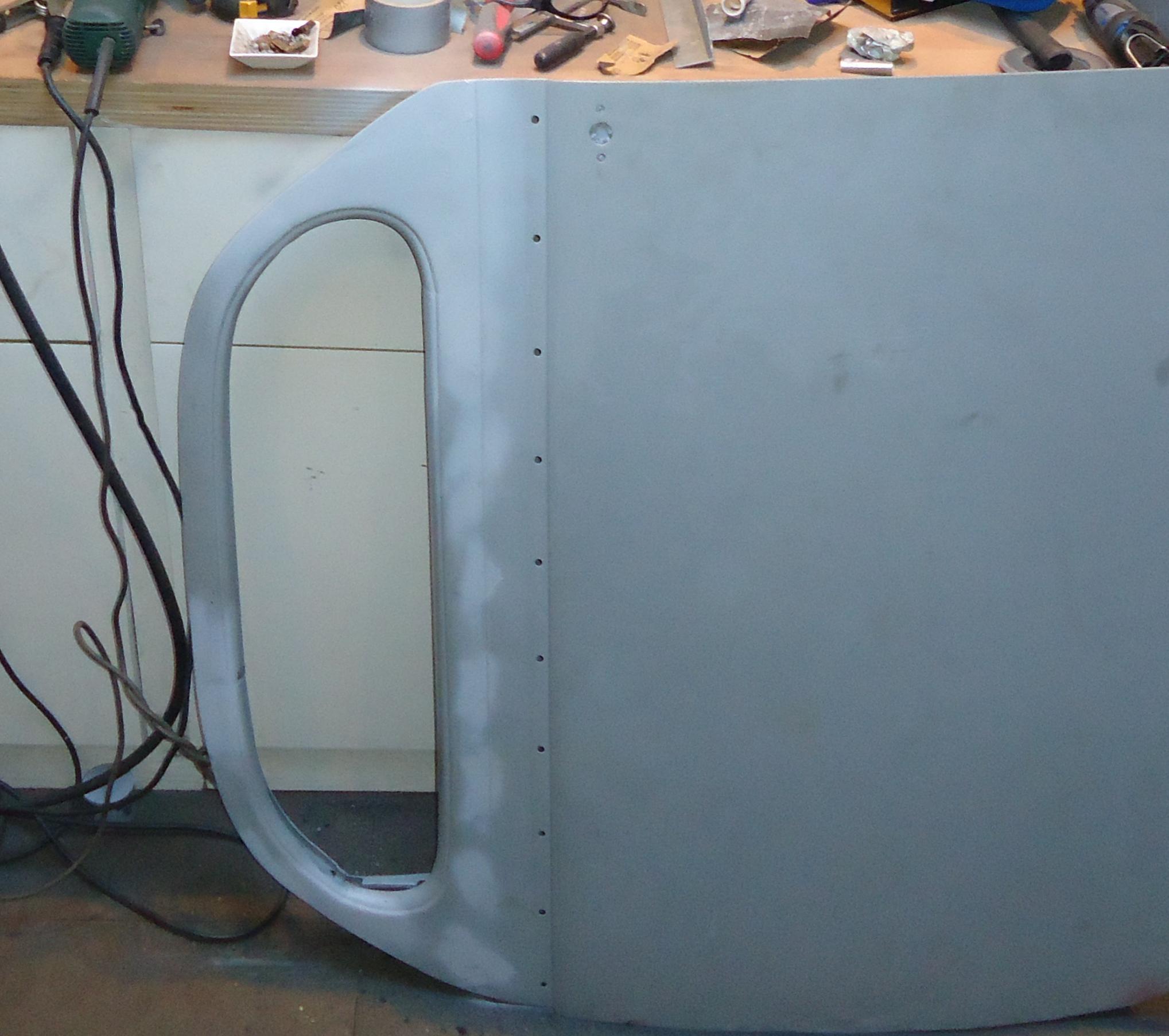

    Finished off the "sail" panel on the driver side window garnish. The contour of the door came in handy in order to form the upper part. Going to grind it a little more and then give it some primer. The plan is to have both garnish mouldings done by the end of the week.

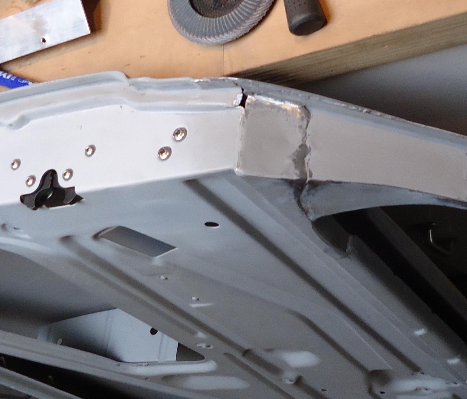

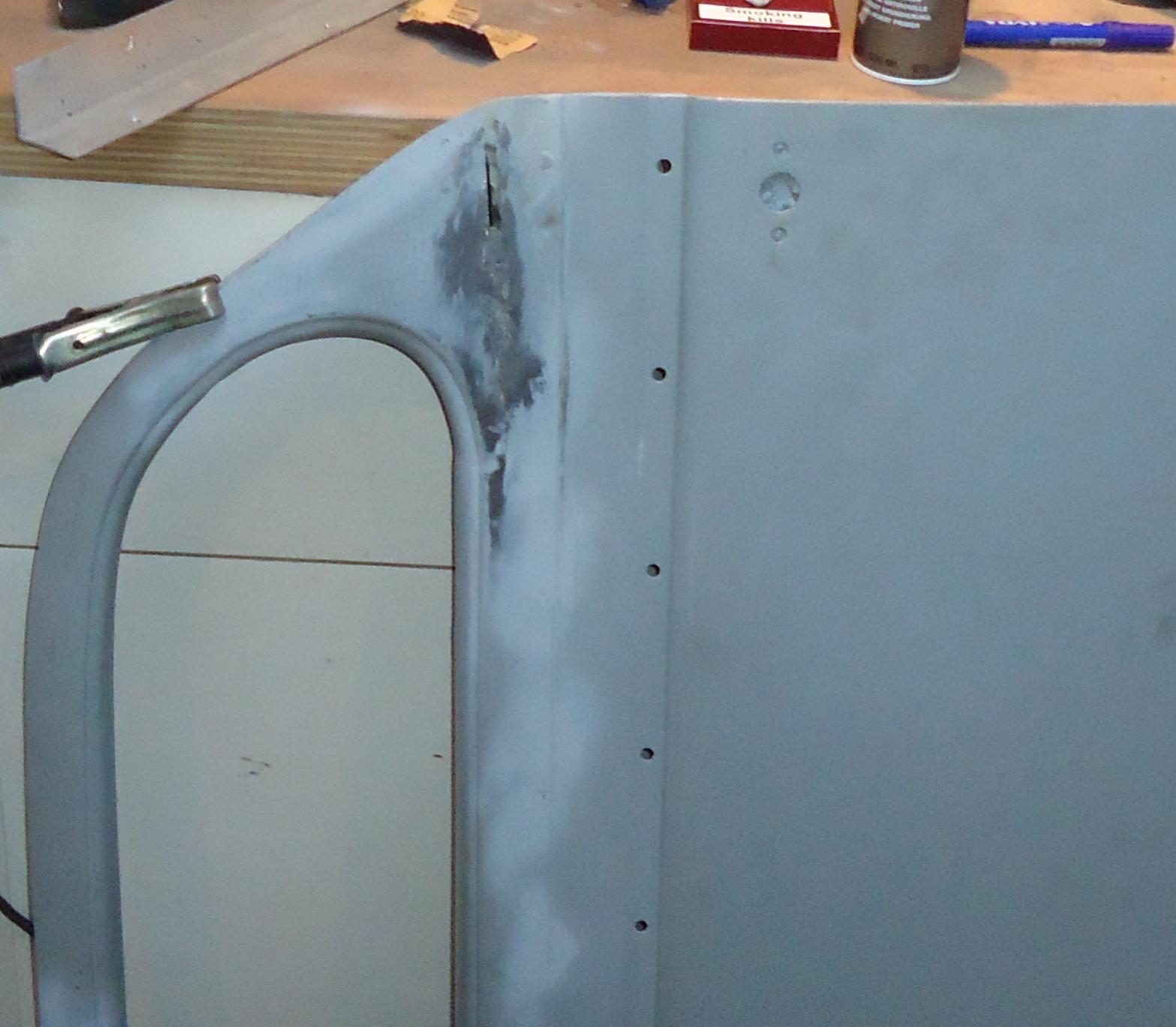

    Sanded the garnish moulding and gave it some primer. Next it was on to the driver door. The PO had left his "scars" here, so it was time to rectify them. Just above the lock, there was still a big gap. So I spliced it carefully, hammered it down and welded it up. On to the front of the door in the next few hours.

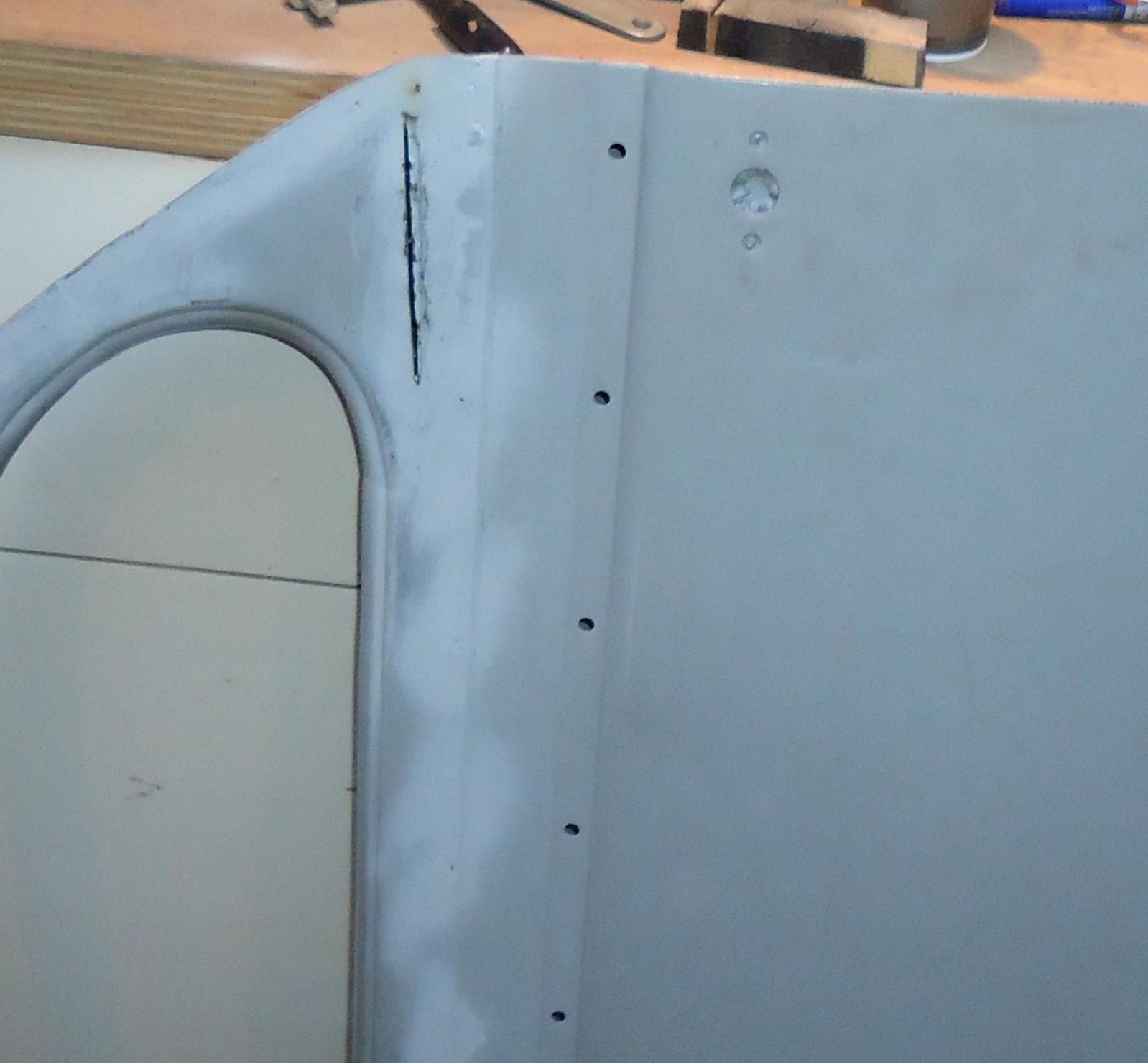

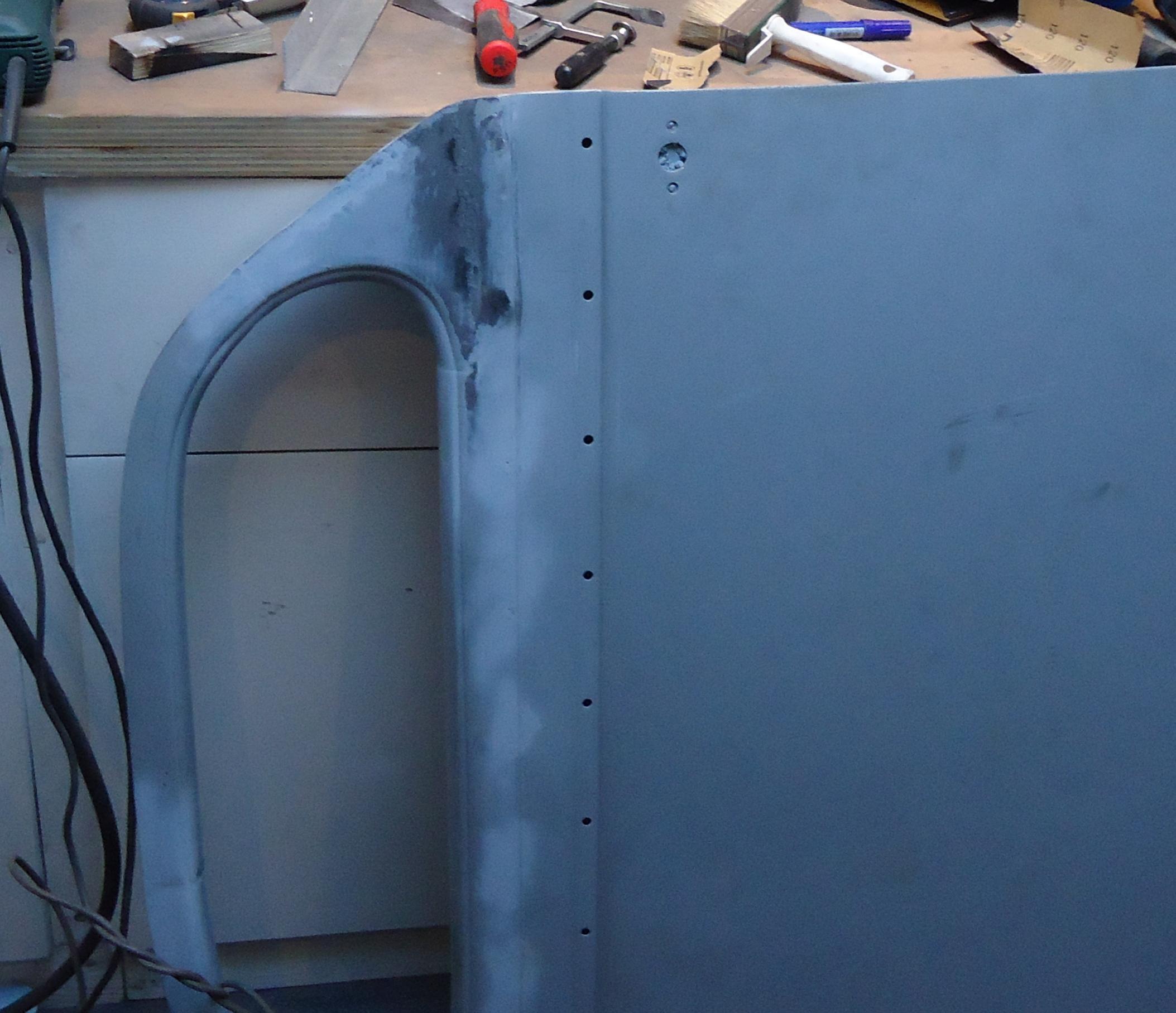

    On to the outside of the door. There is an ugly cut and weld on the outside, near the door handle, which did not follow the contour of the door at all......so I started cutting, hammer and weld. My little heater in the garage could not compete with the freezing temperatures outside, but still got a fair bit done before my body went numb....

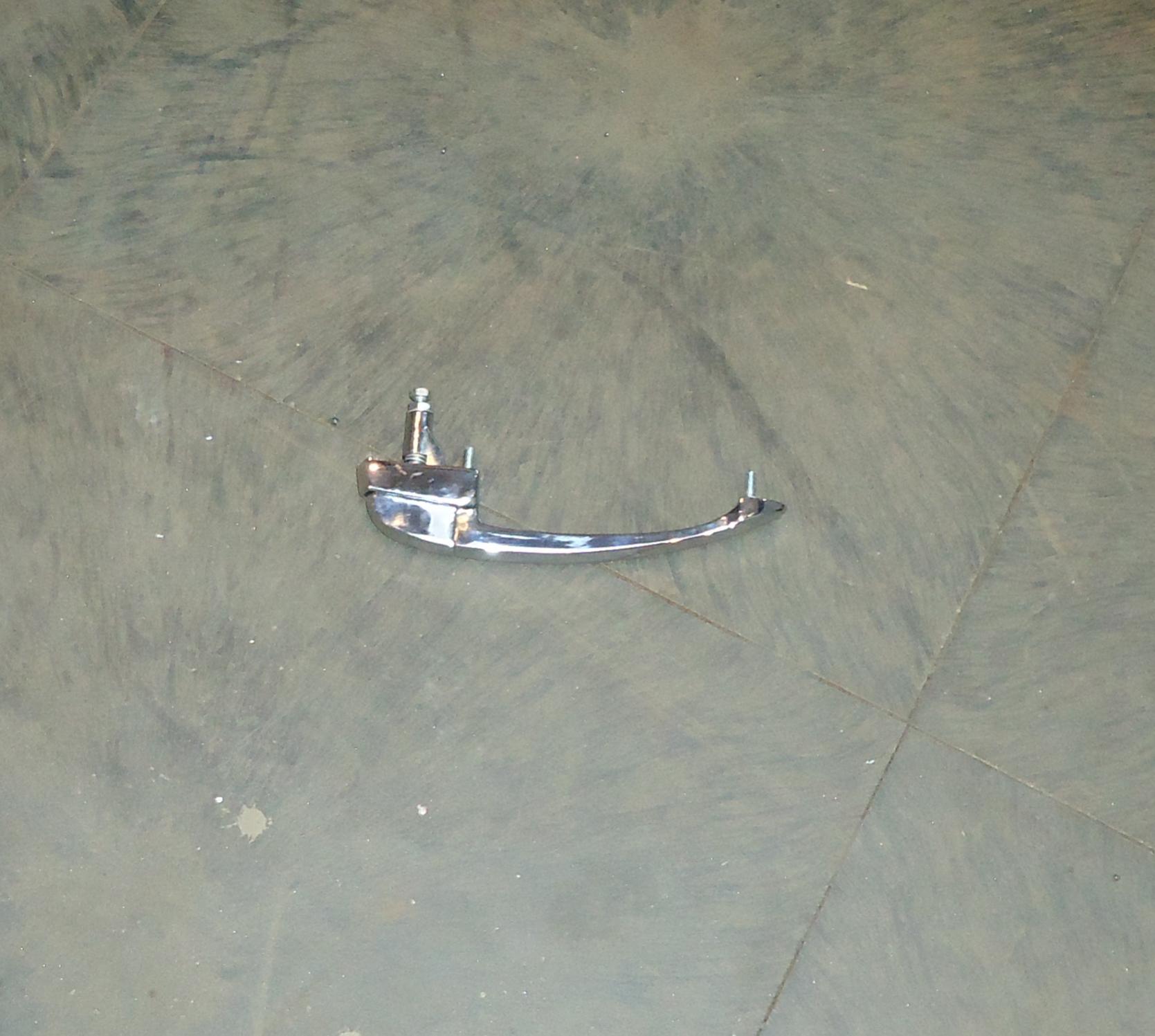

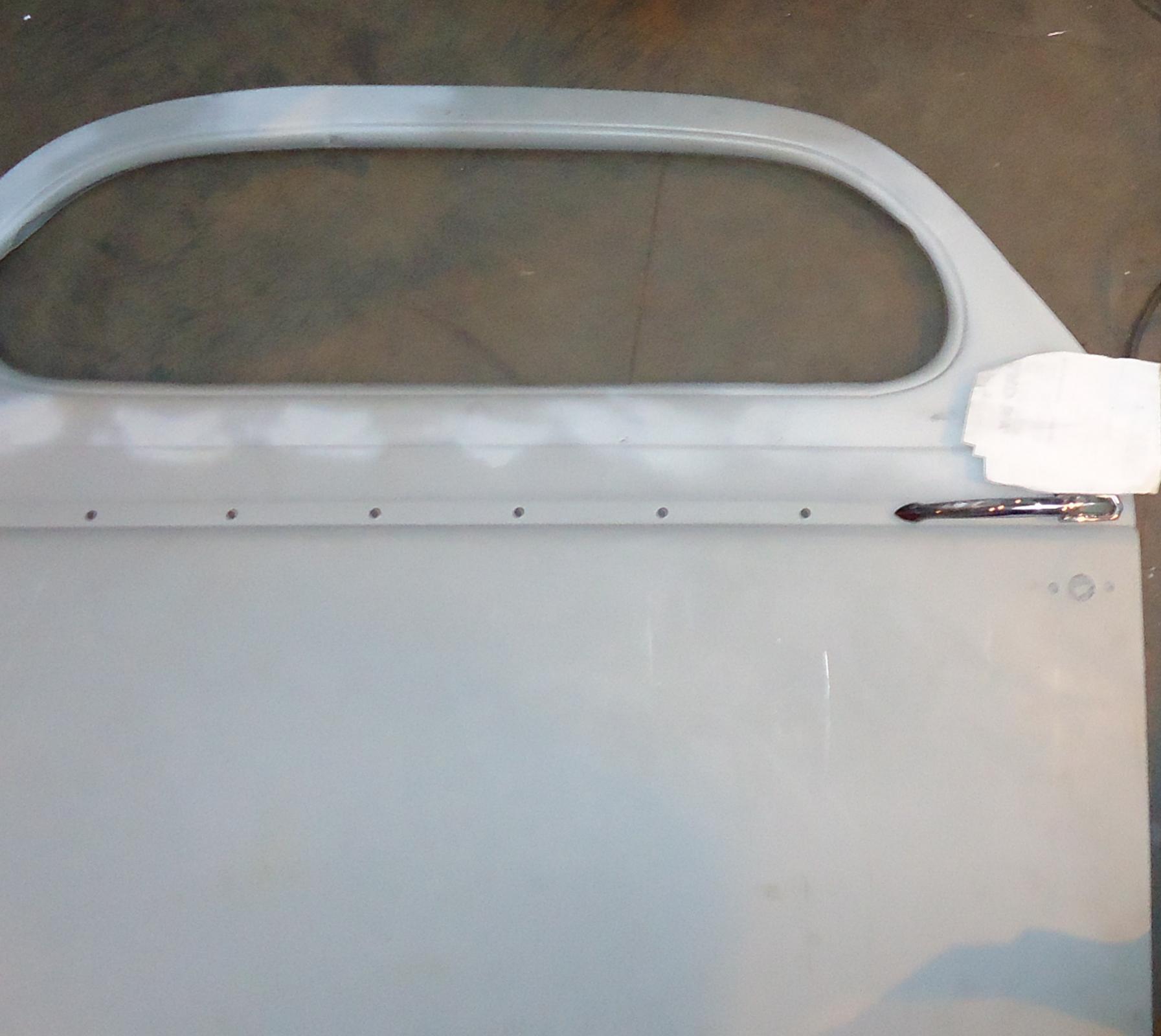

    Finished off the welding on the front of the door.....Next thing are the door handles. Now here in the Netherlands, "officially" you need to be able to open the door from the outside in a normal manner. Meaning no fancy remote opening gadgets. In order to customize it slightly, I thought it would be cool to have the door handle incorporated in the trim, instead of below it. This way, when looking from a distance, it still has the clean look. The door handles are from a MG and nearly as wide as the trim. I was thinking of making two holes in the trim and recessing the two bases of the door handle into it. Anyone have any thoughts?
    (the last picture may look a little weird, but I layed the door flat on the ground, used a tape measure to hold the door handle upright and the covered it with a piece of paper so as not to distract too much. You get the idea.....;))
  27. Love the idea of "hideing" the door handle in the trim. I know the early '60s T-birds did something similar to that and you are right, it really cleans up the side of the car. Good luck with engineering how to do it.
    Just one question, do you have to have a handle on the outside or could you use a push ****on to pop open the door?

    Thanks Hivolt5.0! The law states that the door must be able to be opened from the outside in a normal way. This basically means a door handle with a ****on, pull handle or the "twist" type. Not sure if they would allow just a single push ****on though.........thanks for the input.
