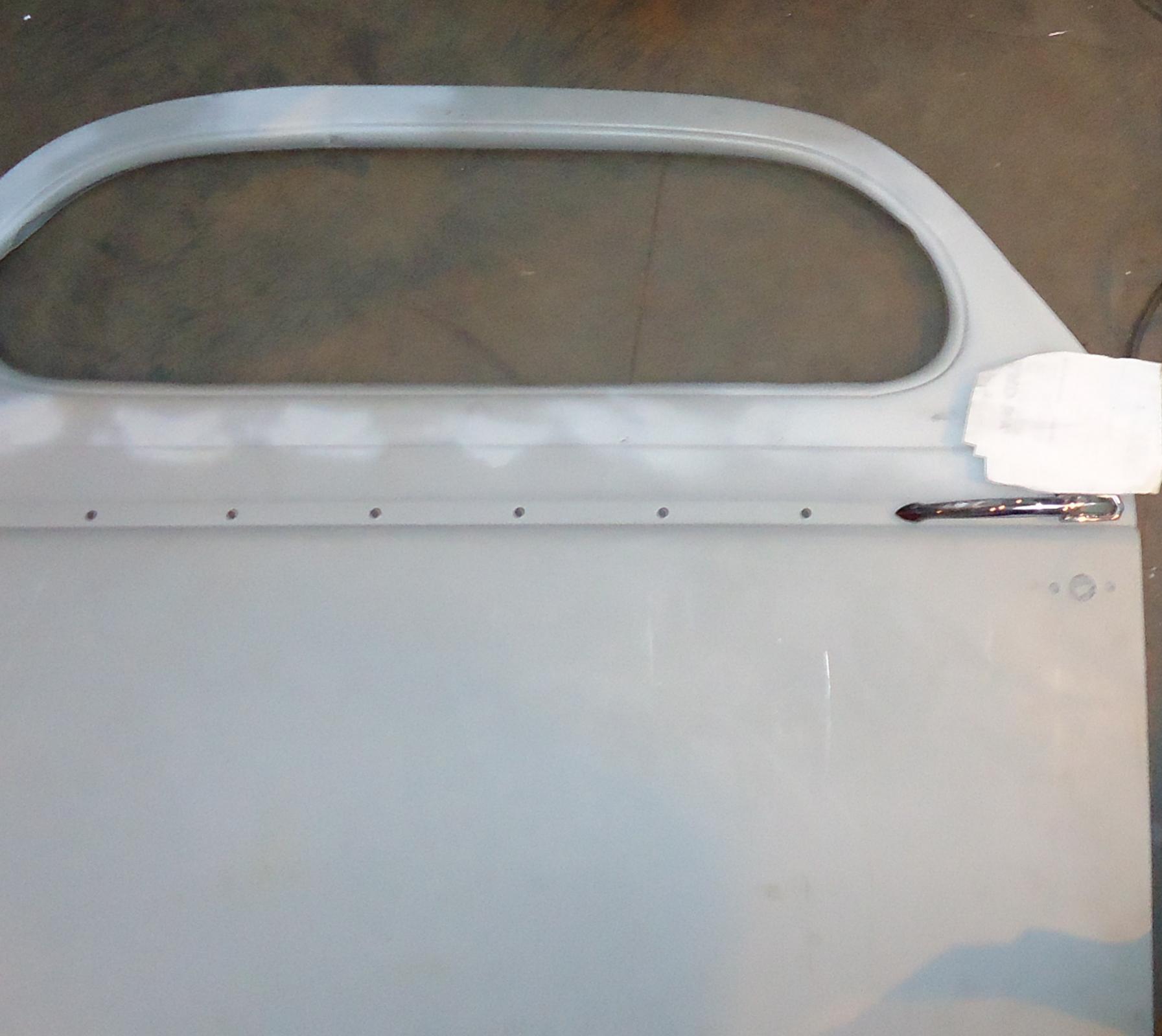

    The other door handles I'm considering are from an Austin Healey. I still had an old one laying around which I thought may work. The only problems I see here is the required indentation in the door, limited space inside the door for the operating mechanism and the wrong width/shape........a****st others.
  18. plmczy
    Joined: Aug 3, 2001
    Posts: 2,408
    plmczy
    That is what I was talking about, see how that has a nice curve outwards away from the car. The width looks good from your pics. The shape I see it has a slight peak, wonder if you could grind it smooth and have them rechromed? What about making up your own mechanism and handle (like a piece of flat stock) and use a piece of the stock trim to cover the handle so it blends in with the rest of the trim. For the indentation, find a used door with a nice shallow belly in towards the door and graft them into your doors. This is going to be cool, I like the idea!

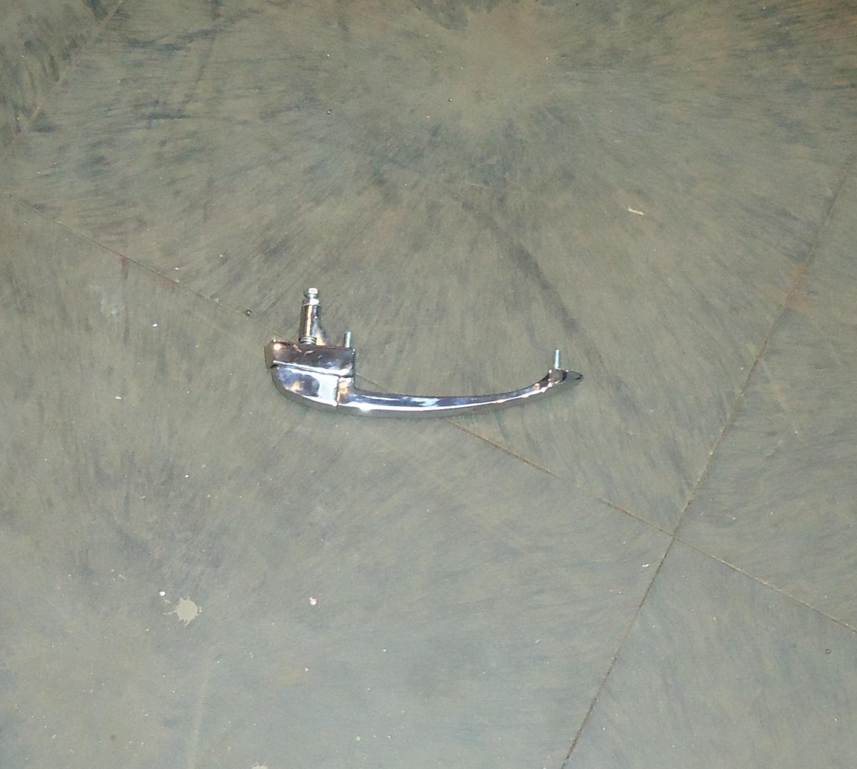

    Thank you for thinking along plmczy! Considering it was snowing here this afternoon and tooooo cold in the garage, I decided on a little brainstorming session in the kitchen with coffee and cigars. The problem with the Healey door handles is as follows. The indentation and mechanism will interfere with gl*** as it moves inwards considerably. There are also the window guides that will obstruct the free movement.
    I've decided to go with the MG door handles and do a trial fit in the coming week(s). The advantage of this one is that the mechanism is more of less above the bear claw, only requiring a linkage of some sort. Also, I can cut two pieces out of the trim and hopefully recess it without the handle sticking out like a sore thumb.
    There are two small buts......
    1) the space behind the handle and trim is going to be limited. (but the bear claw exerts enough force to open the door).
    2) after polishing the trim, I will only get once chance to cut the trim with my faithful Dremel. (going to be fairly nerve wrecking I would presume.)
    Going to do some more measuring next week before the test fit. You know me, measure, think, measure, think and measure again.:D
    Here are two pics of the MG door handles I'm probably going to use.
  21. langy
    Joined: Apr 27, 2006
    Posts: 5,730
    langy
    They look good Eric, will work the bear jaws off a small bell crank nicely.

    Thanks Steve! The slight problem is that the "big" bear claws levers have an up or down motion, while the door handle mechanism goes "into" the door. Maybe if I connect the two with a rod at 45 degrees, this should work I think as long as there is no play.
