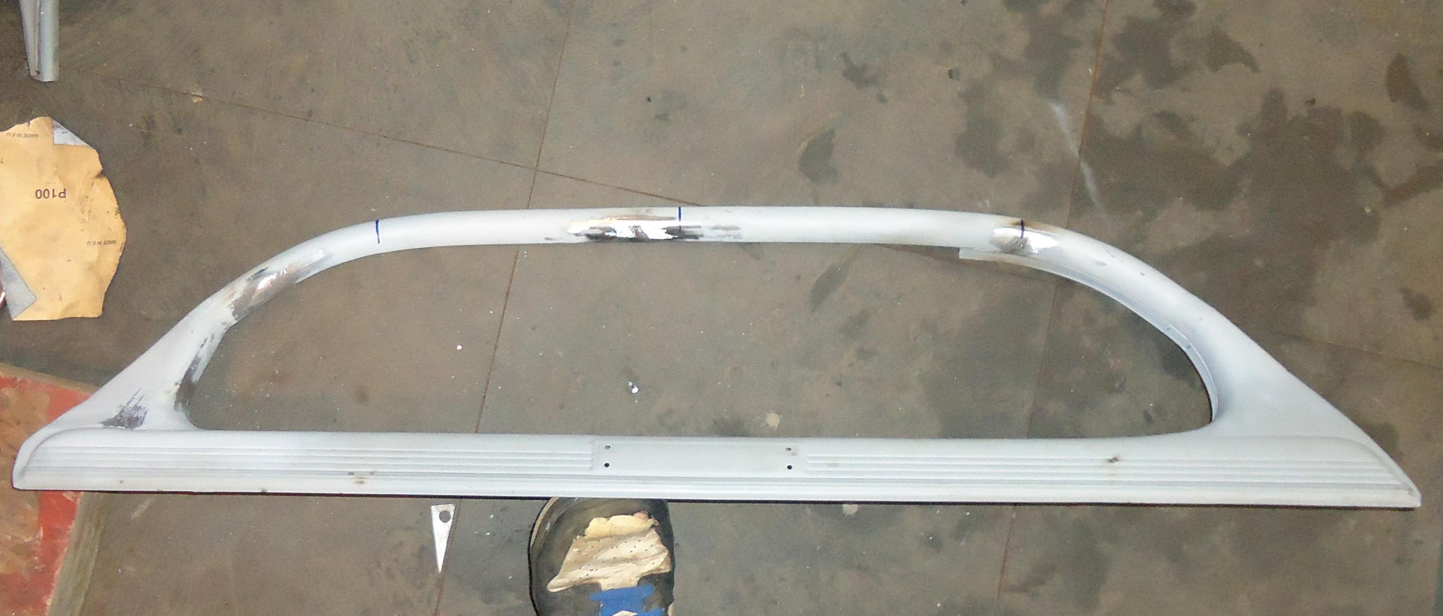

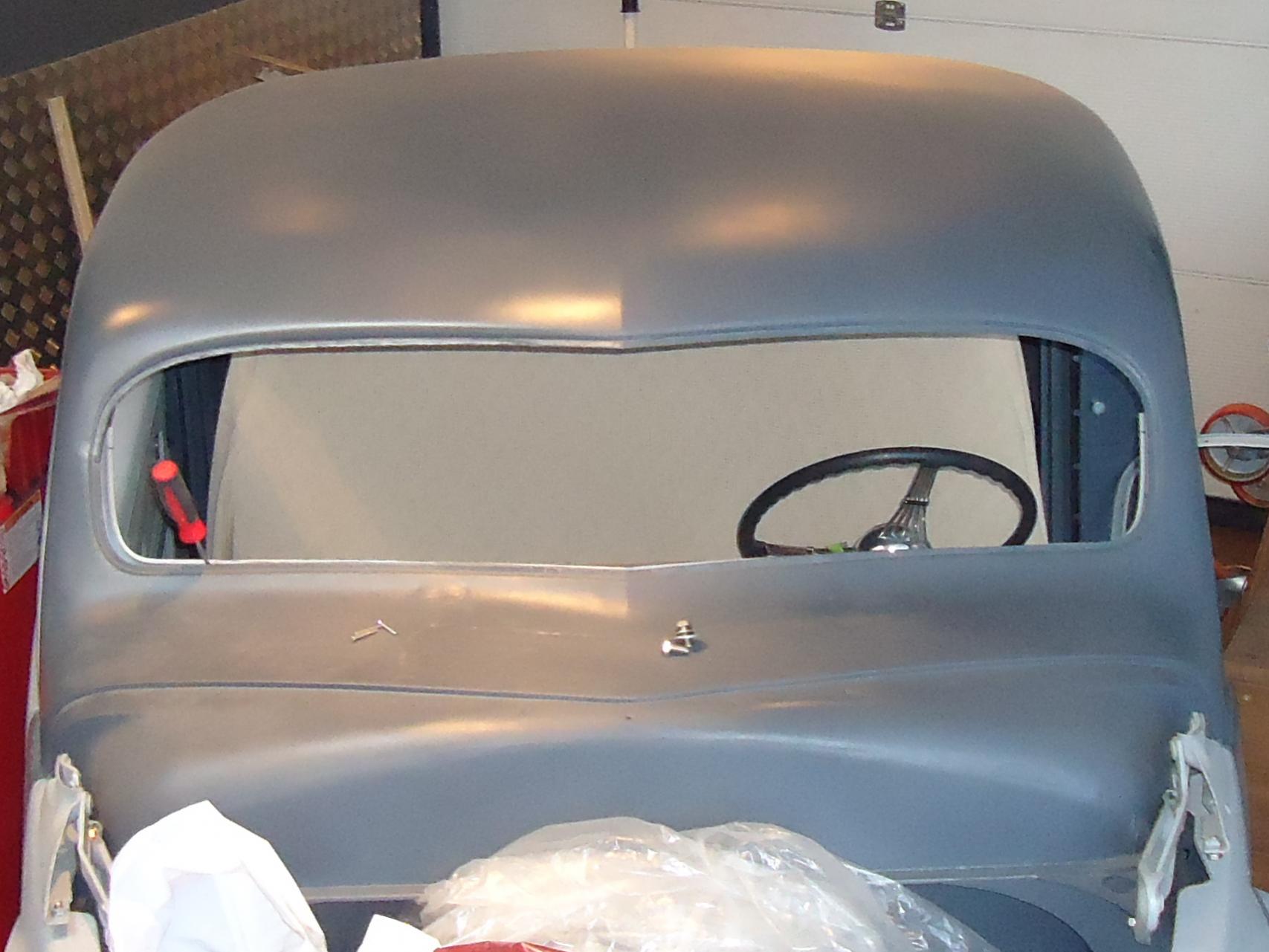

    Had a couple of spare hours this morning to spend in my freezing garage.......welded up the original holes in the window garnish and gave it some primer. Tomorrow I hope to finish this one and move on to the other one. These items just seem to eat time.

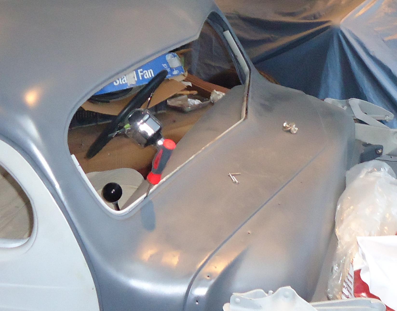

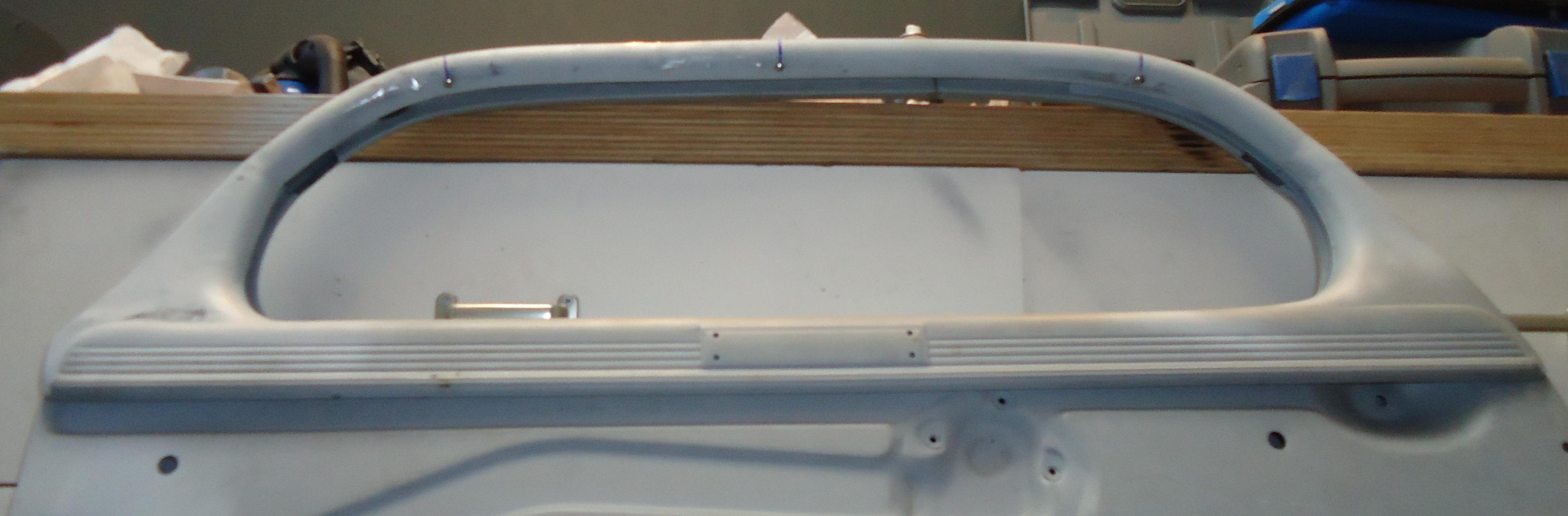

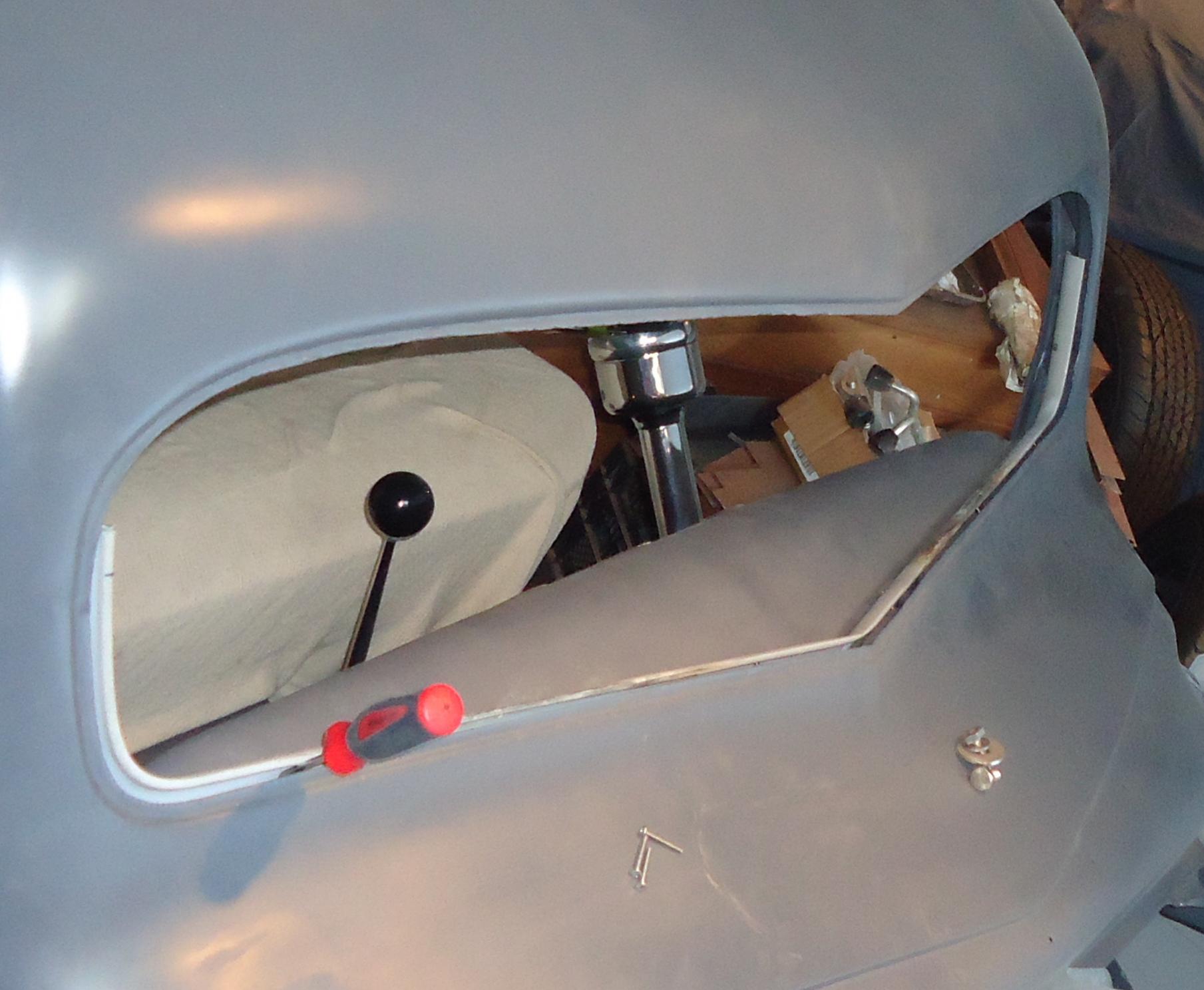

    Finished the driver side garnish today. Found the exact location to drill and the used a bolt to get the indentations so that the screws would be sunken. Then gave it a quick prime. (again)

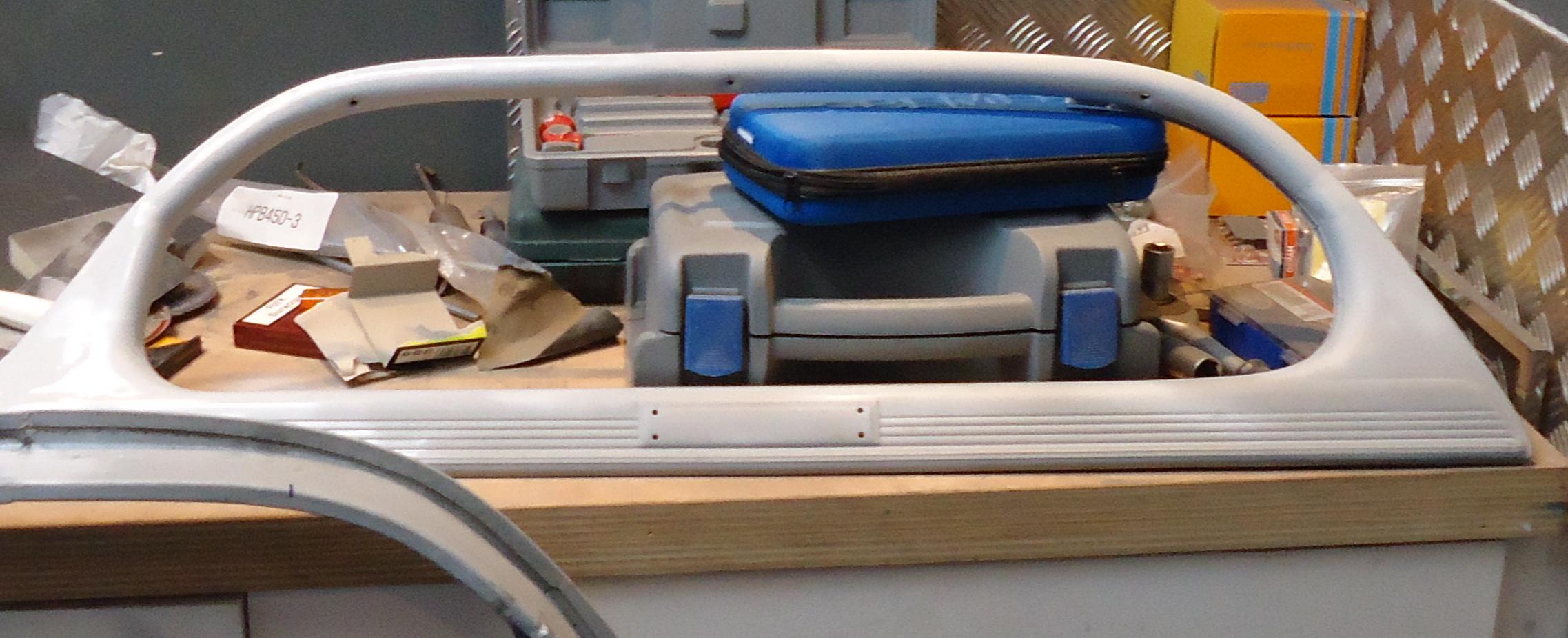

    Instead of finishing off the other garnish, I wanted a slight change of scenery and started on the windshield moulding. With a little heat treatment I got the lower corner of the drivers side to line up perfect. Unfortunately, the p***enger side is 6 mm too short and sticks out like a sore thumb. After a bit more measuring, I cut the lower part in half, with the idea to add 6mm there, rather than trying to change the radius.

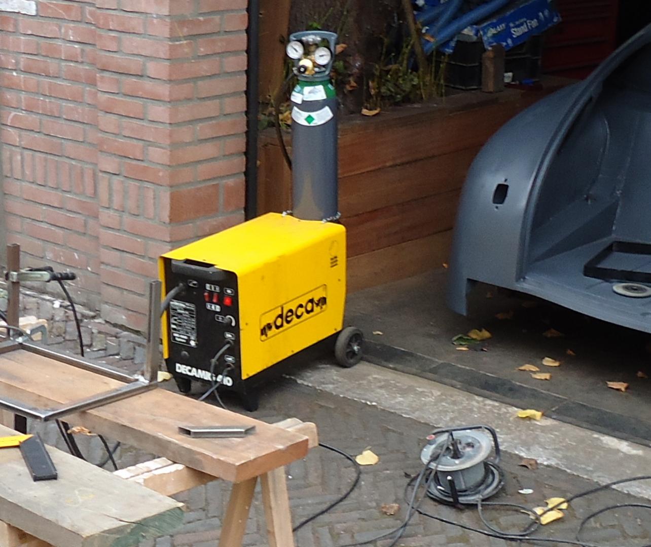

    When it was time to weld, my great little welding machine thought it was time to quit on me after months of fairly intensive use......it's off to a spe******t now to find out what's wrong with it.

  29. Finnrodder
    Joined: Oct 18, 2009
    Posts: 2,970
    Finnrodder
    from Finland
    What welder you have used...Just curious.
    I have mig and tig,both of them are Kemppi.Thats a finnish brand...
  30. farmer12
    Joined: Aug 28, 2006
    Posts: 7,723
    farmer12
    I'm using a Decamig 410. It was a gift from a friend and has served me well up until now......If the repair costs are going to be too extreme, I may just opt to buy a new one. We'll see.
