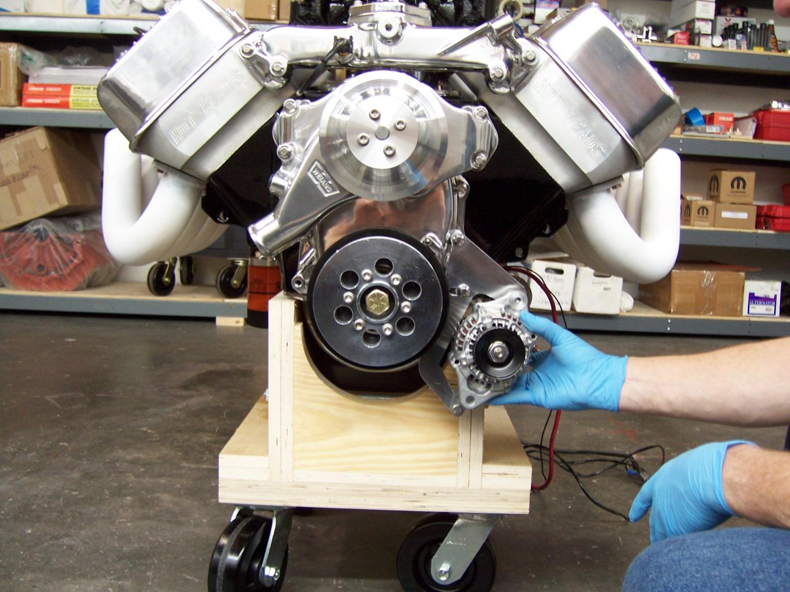

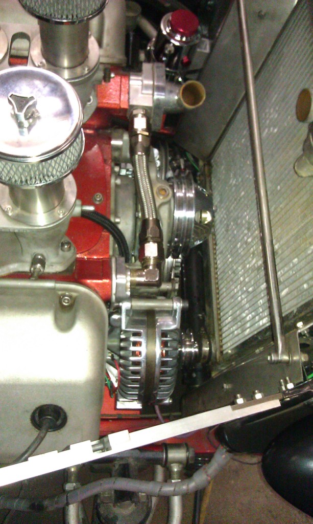

    Here is how I did the alternator problem. First I used a GM alternator, but it didnt look right. And there was a problem tightening the belt. So I mounted a MOPAR alterator this winter, and I had to turn it upside down to make it work. And you must use the outer groove. (inner groove is power steering)

    Thank you 37_plycoupe! That is exactly how I plan to do mine, great to see some pictures of how you did it. I also plan to run a dual groove pulley. The inner one will be useless for me as I'm not using power steering, so I'll machine that off. Did you make that alternator bracket? The whole engine looks great! Thanks again.

    Yes I have made the brackets. For the alterator its just a plate with a nut (M10) welded on it. Then grinded smooth. Are you going to use GM or MOPAR alternator??

    Thanks for the info 37_plycoupe. I'm going to use a GM mini 100 amp alternator. Here's a pic with the engine builder Eddie Haines and the initial idea of positioning the alternator. Unfortunately this isn't going to work as the frame is fairly narrow.

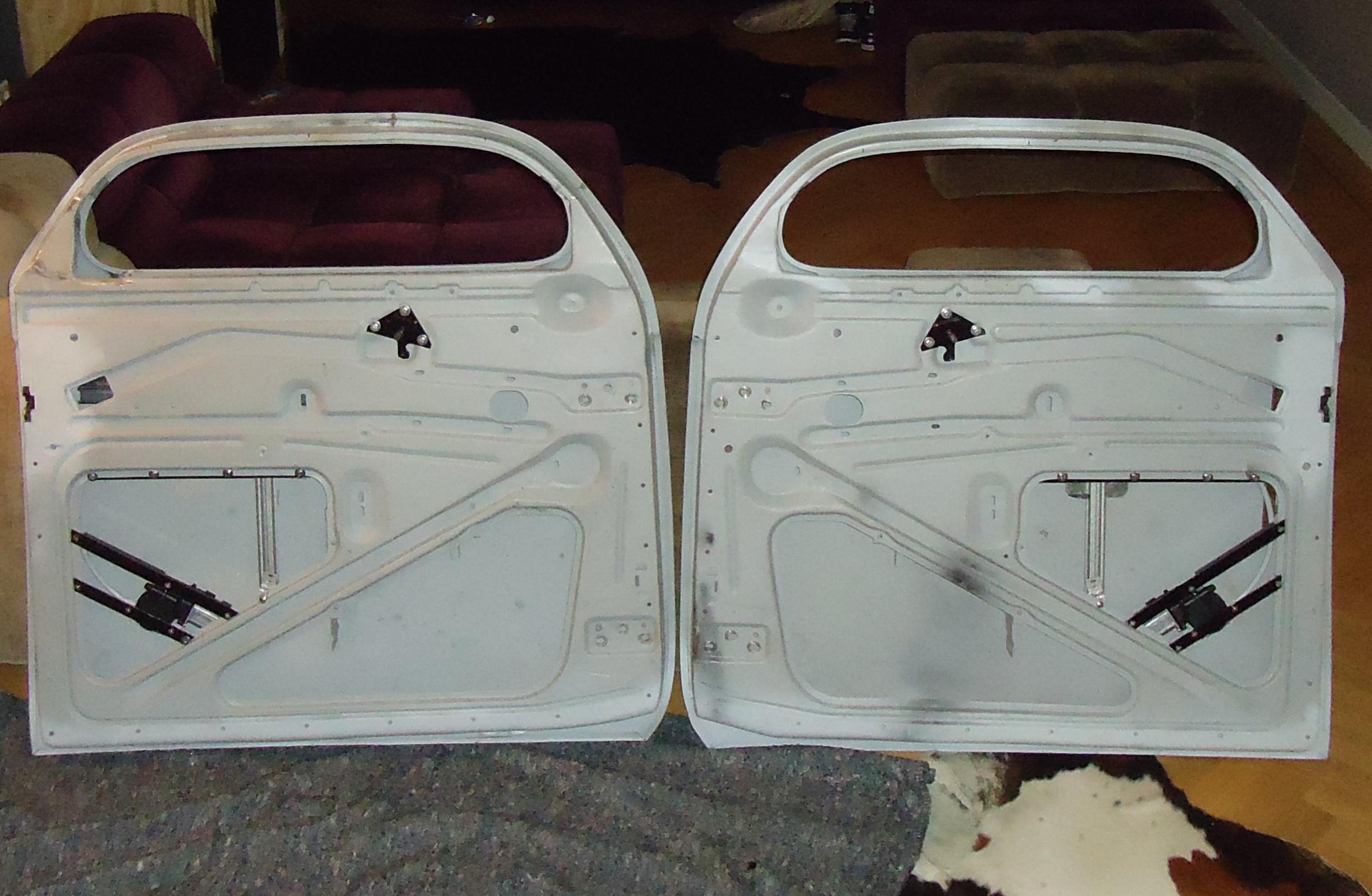

    Finished off the other electric window for the p***enger door today. Then had to cut a part of the running track and gl*** holder for both windows in order to make it all fit properly. Then tore it all apart again and painted the aluminium parts black. Installed the door handle mechanisms and installed the electric windows again when the paint was dry.
    Moving on to the running tracks and locking stuff tomorrow.
    :eek:BEFORE I FORGET, I'm missing the door link for the drivers side. (the long piece of metal from the door handle to the door lock). So if anyone can help me where I could find one, I would appreciate it. (it's a fairly difficult piece to fabricate myself.....)

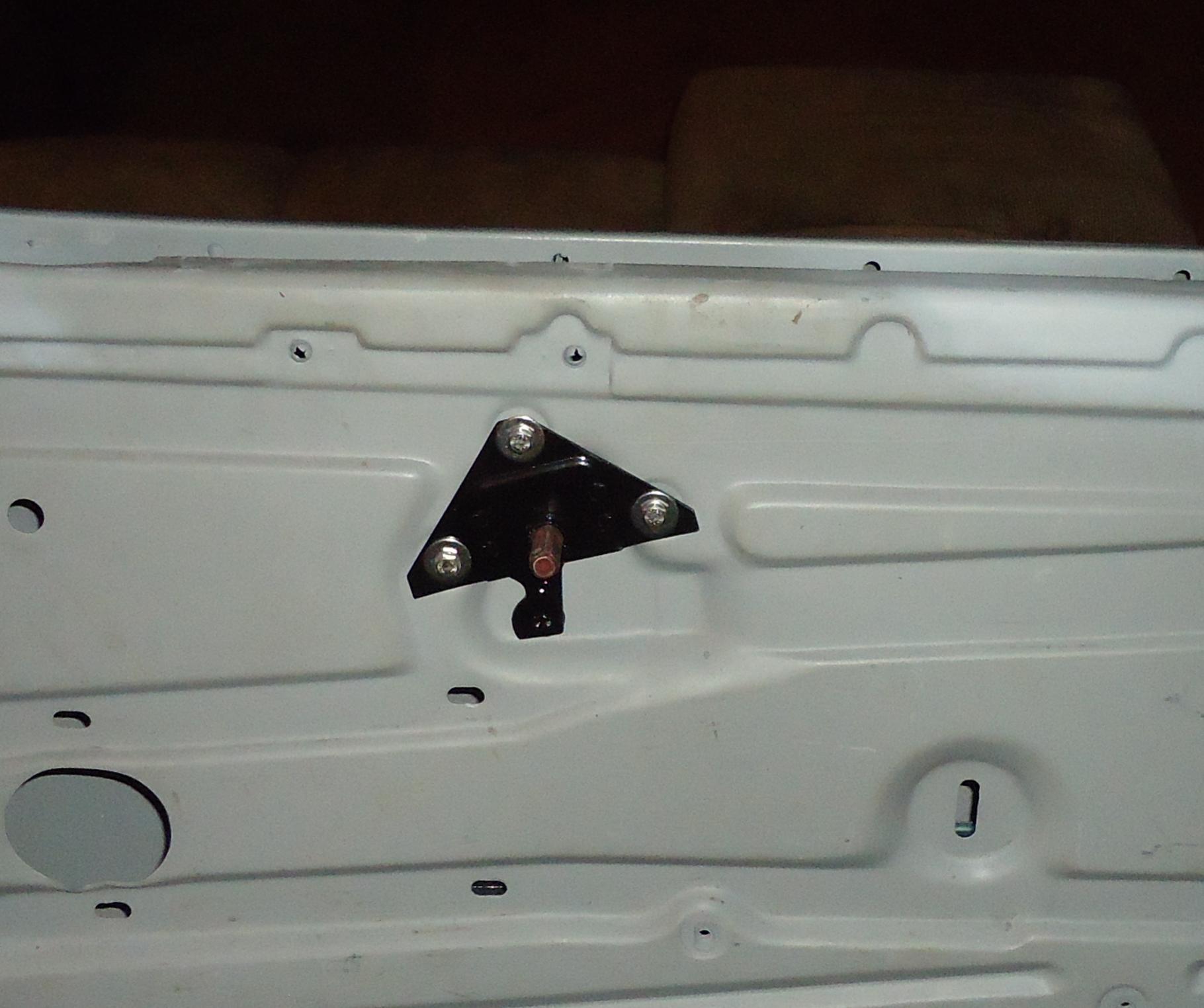

    After having installed the electric window the last couple of days, it was time to work on the door locks. After careful thought, I changed over the door handles and needed to bring the window running track more away from the lock. After a bit of drilling, bolting and fiddling, I got the mechanism to work on the p***enger side. (Still looking for a door lock link for the drivers side......) ;)

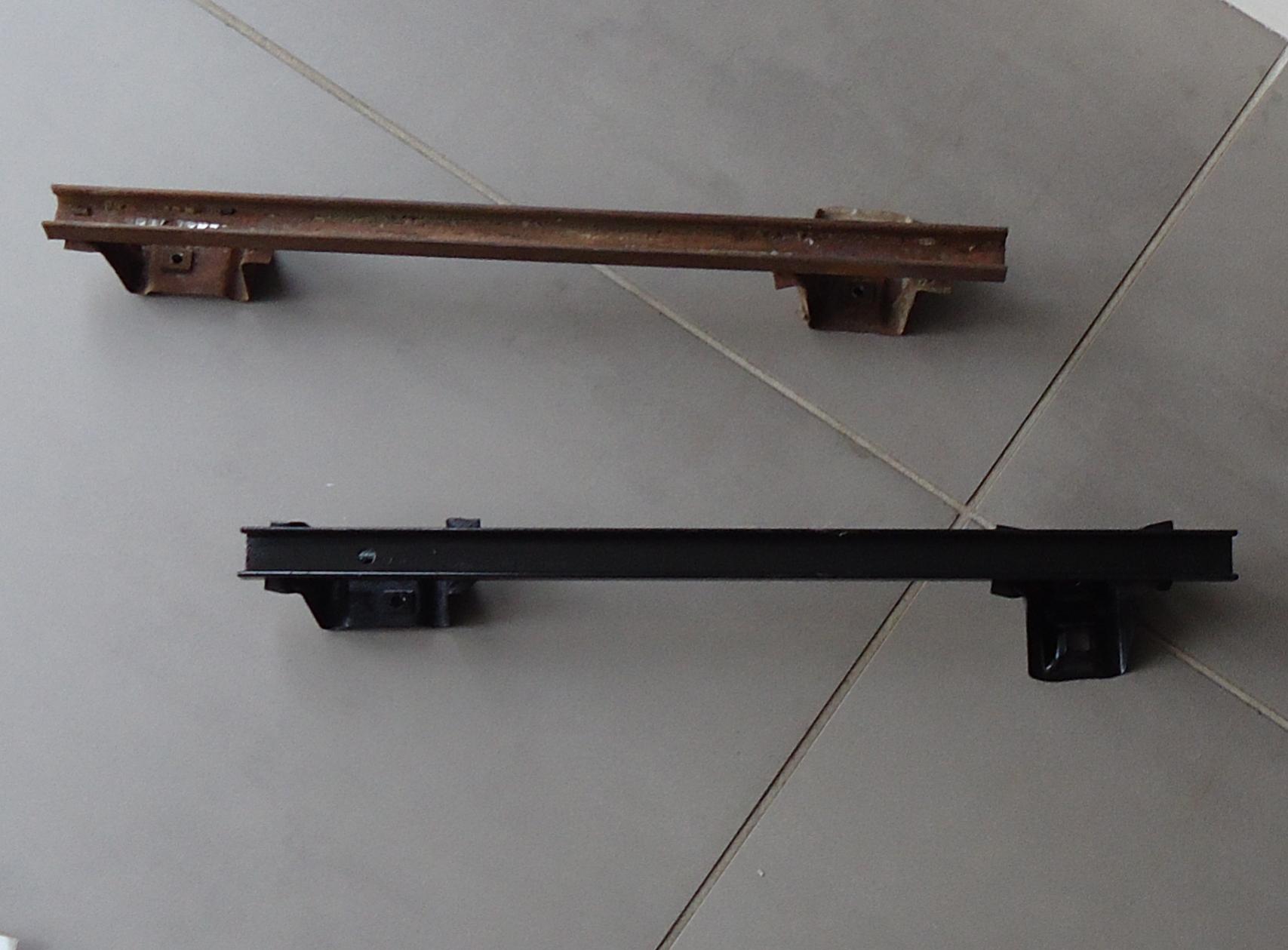

    Had a few hours to spare today and cleaned up/sanded the window tracks back to bare metal for both sides, including the spacers. A tedious and dirty job, but they came out looking great. (especially since no one will ever see them again when they're covered by the interior door panels....)

    I just posted a picture of my electric door lock install, Eric. I was pretty pleased with it. I didnt have to modify my window tracks at all.
    What I don't have is a "manual override" if something happens and I can't get the electrics and remote to work. Got any ideas?

    I just checked out your thread, and the electric door lock looks good. I won't be using them.
    With regards to the manual override: I'm going to be using these hollow door jam pieces for the wire of my electric windows. (from Juliano's). Why not run a wire through them connected to your lock. Then run the wire through the footwell exiting in your fender.......I would do that on the p***enger side (the door being used the least) and cover the wire with rubber where it goes through the door jam, so there is no abrasive action against your other wires running through it. Hope this helps.
