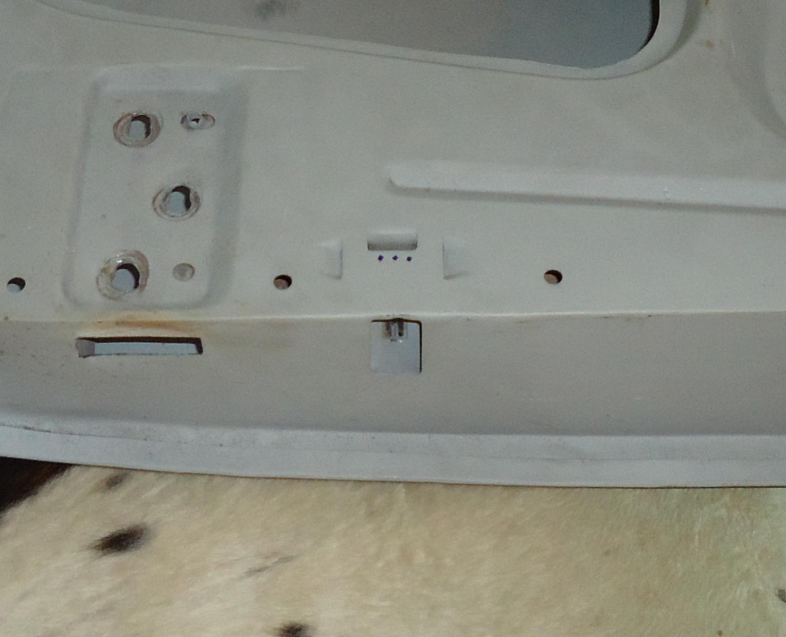

    Today I'm getting the door ready to accept the new door jam. Checked out the original piece on the body first. No major surgery required here and the added bonus of it being re-inforced. So that's fine.

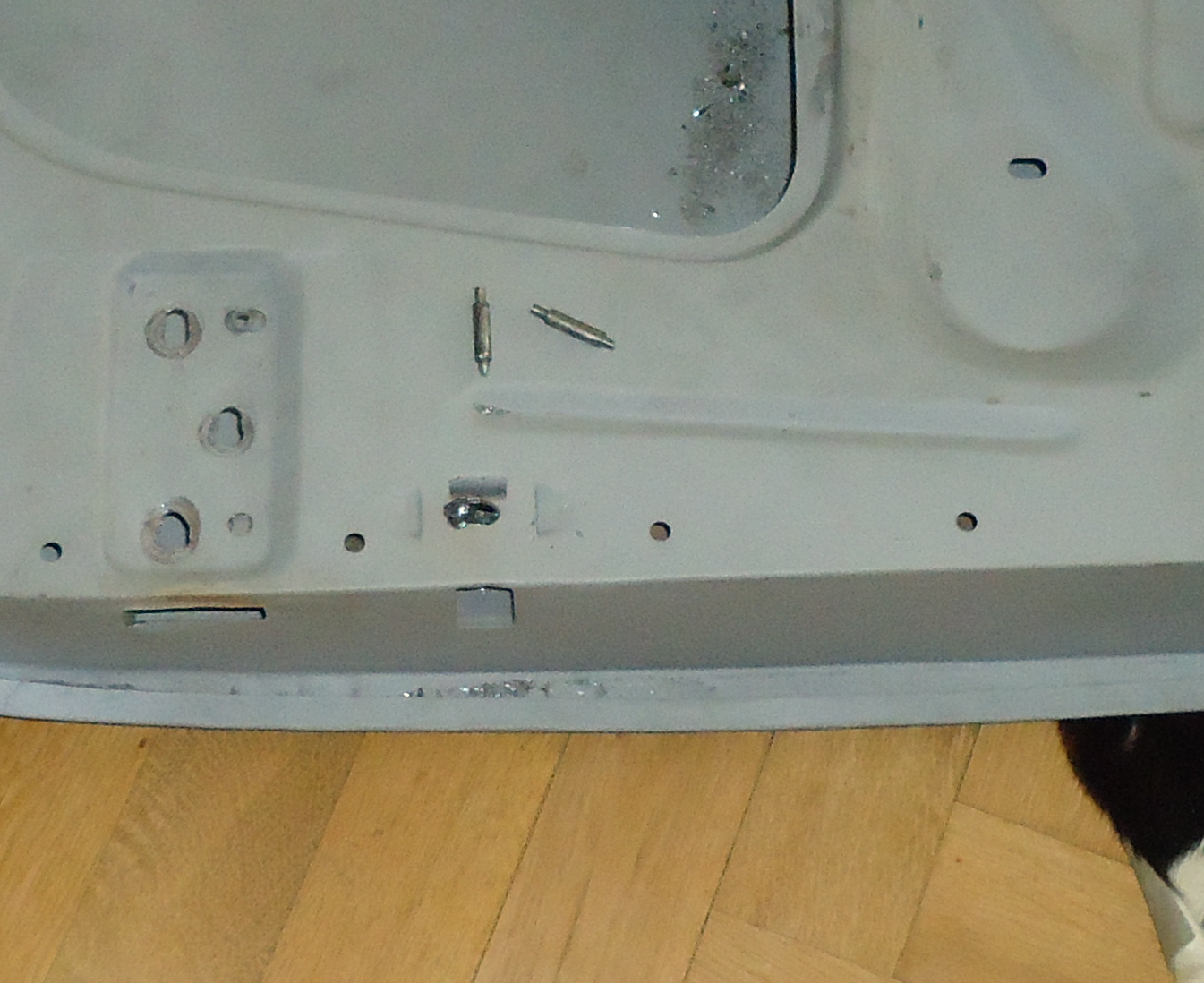

    Next, the door. At first glans I was just going to enlarge the small gap, located behind the big square one you see from the outside. The small gap is actually governed by two small pins that apply pressure to the door jam.(pic no.2). After a bit of thinking, I marked the position on the inside of the door. Then drilled two holes exactly above each pin, (breaking a total of two drill bits) and after a bit of force with a hammer and screwdriver, was able to remove them with tweezers.
    Then got the Dremel out and enlarged the holes so they would accept the new hollow door jams. Job done.:D:D:D
    Not very exciting work.....I know.....but I don't want to be doing these things once the doors are painted.

    Great work, Eric. I'm guessing that you no longer have a detent to hold the door open. Is that correct? The two pins you removed were the detent for the old door checks. Correct?

    Correct on both Rock. The detent is now non existend, which does not bother me. If it will open and close like it should, that's fine. I may need to add some extra rubber behind the rubber stop in case the door opens too far. At least now I can run the wires through the door safely. Having second thoughts?

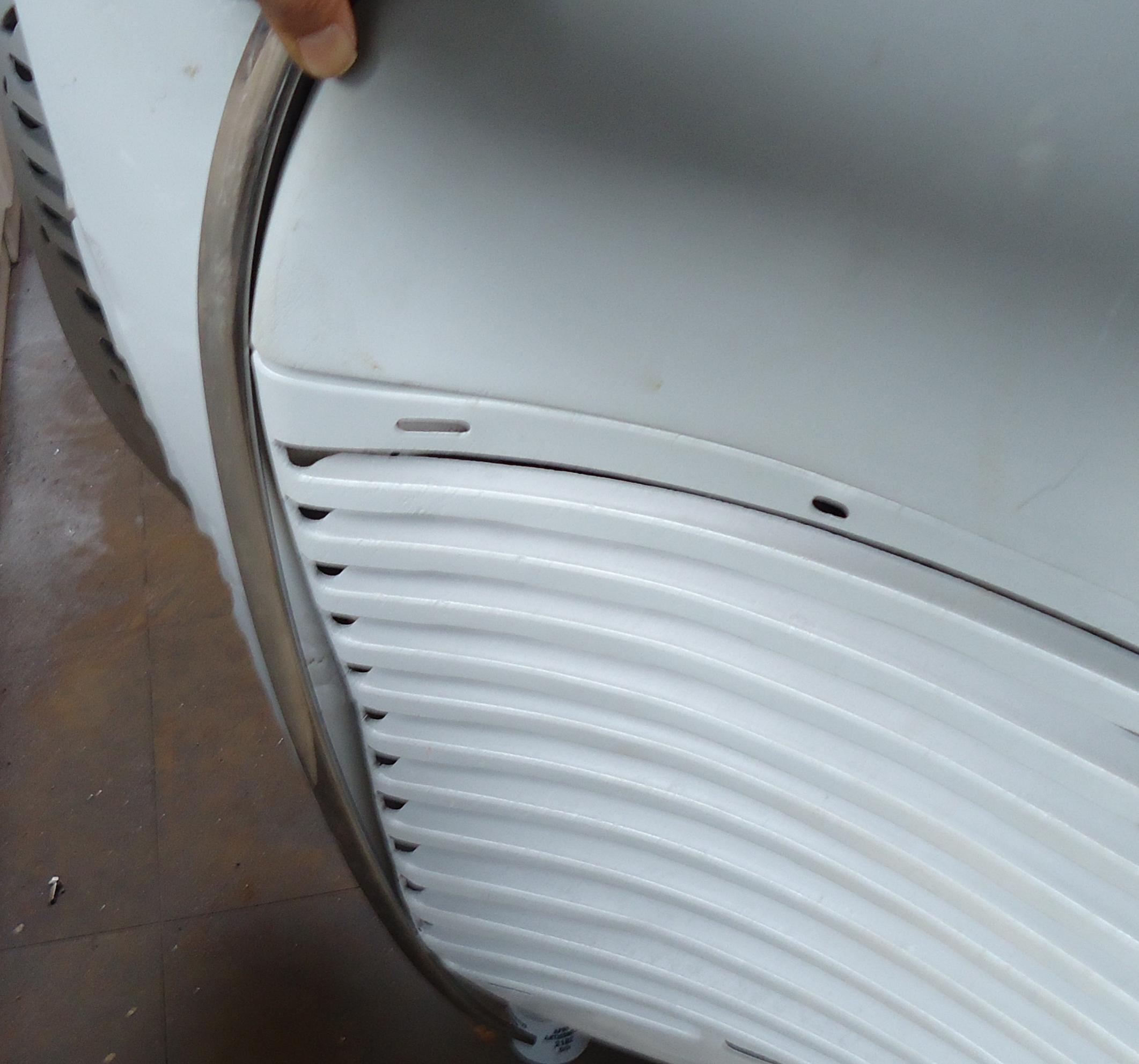

    How lost can you be without a welding machine.........just talked to the guys fixing mine and they're still waiting for parts. Considering I'm also waiting on a few ordered parts from the US, I thought I'd get started on the front grill. First I mounted it in position to make sure it would still fit properly after sandblasting. That was fine....
    Then got the 2 vertical trim pieces out and did a trial fit. Now I knew the car had been hit in the grill once or twice during the course of it's life. I also knew that the PO used a fair amount of bondo here as well.
    It may be difficult to see in pic #2, but the gap is approaching 1.5 inches. So I spent most of the afternoon working with the hammer and dolly. Got the gap to a bit less than an inch now, so there's still a fair way to go. Even though the metal in the middle of the grill(there where usually the emblem is mounted)isn't great in places, I'm going to shape it correctly first before I replace it with new metal. That way I can make a template for the new metal using the "old" metal shape........(I know what I mean:))
    Once again, a bit more work than initially anticipated, but hey, that's what its all about, right?:D:D:D

    Ugh. You might try a porta power to jack it into place. I think you'll have better luck that way than with hammer and dolly.
