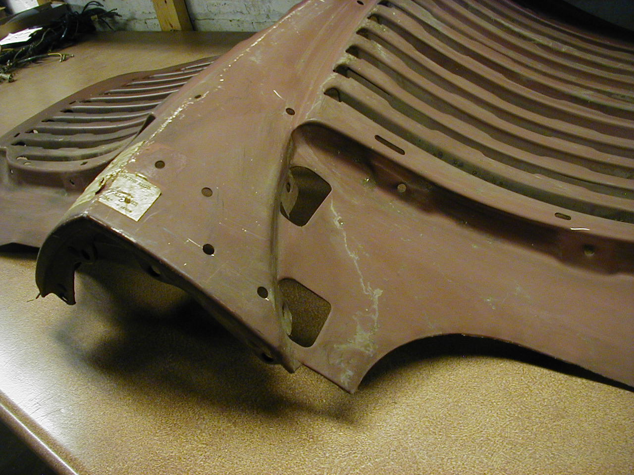

    Hi there Rob! The front clip was on there.......until I saw that the trim did not fit at all. (due to an accident somewhere during it's lifetime.)

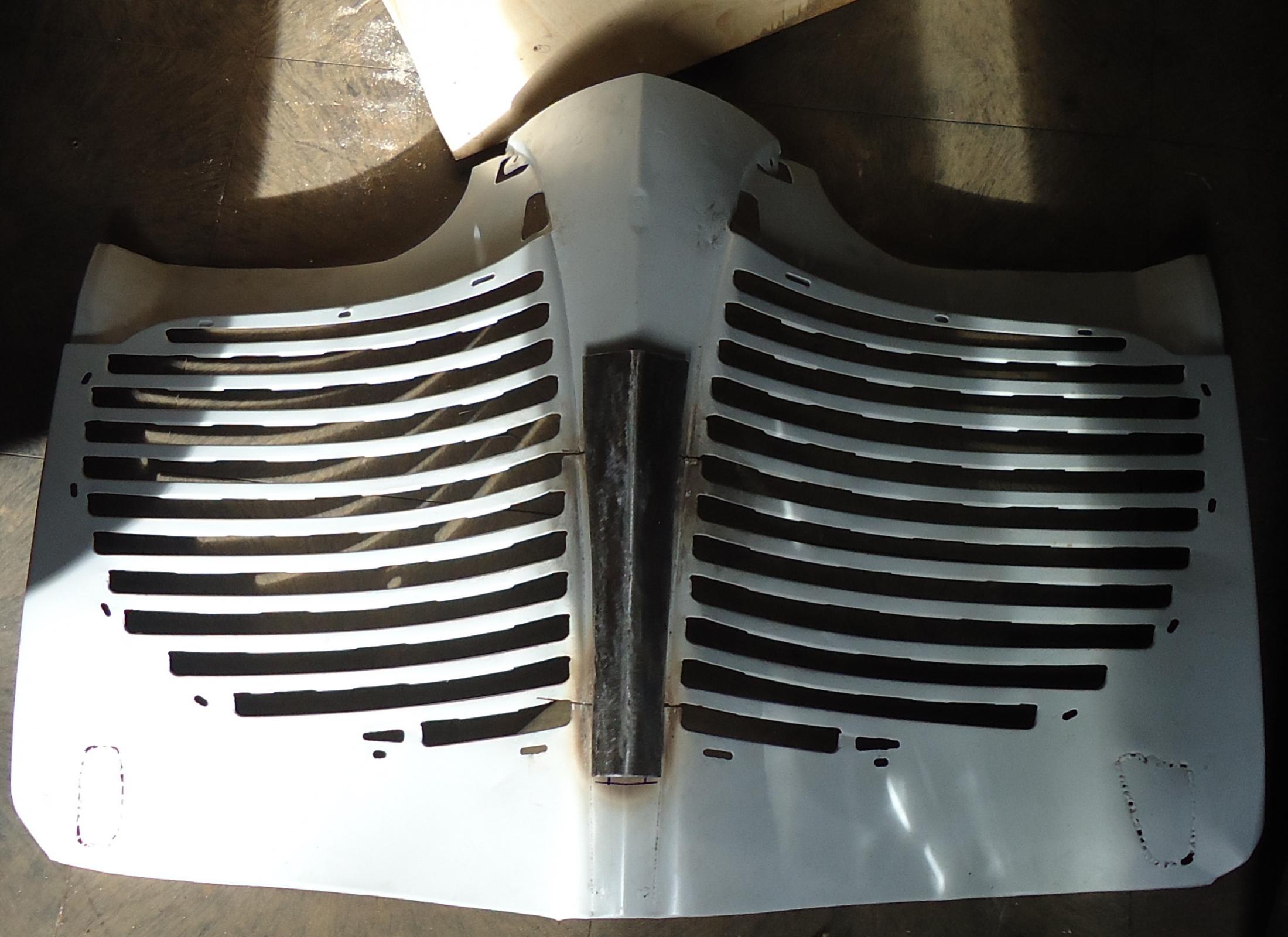

    As you can see, the front grill needs quite a bit of work. (it has only been sandblasted and primered.) The PO roughly welded new pieces where the front bump brackets used to be.(not a pretty sight.).I'll rectify those things after the centre piece has been done. Pic no1 shows how bad the grill has been pushed inwards, even after I'd been at it for an hour.

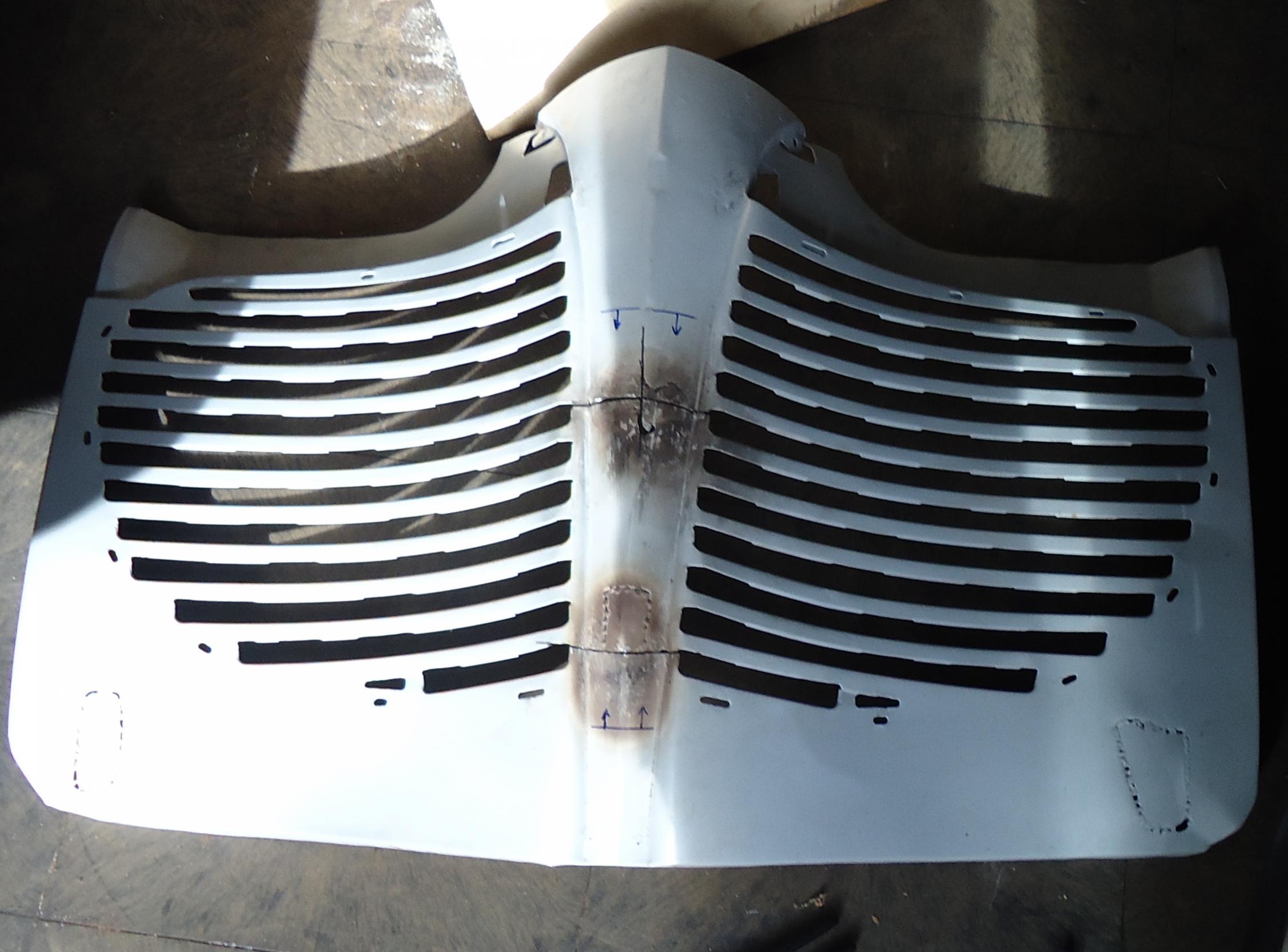

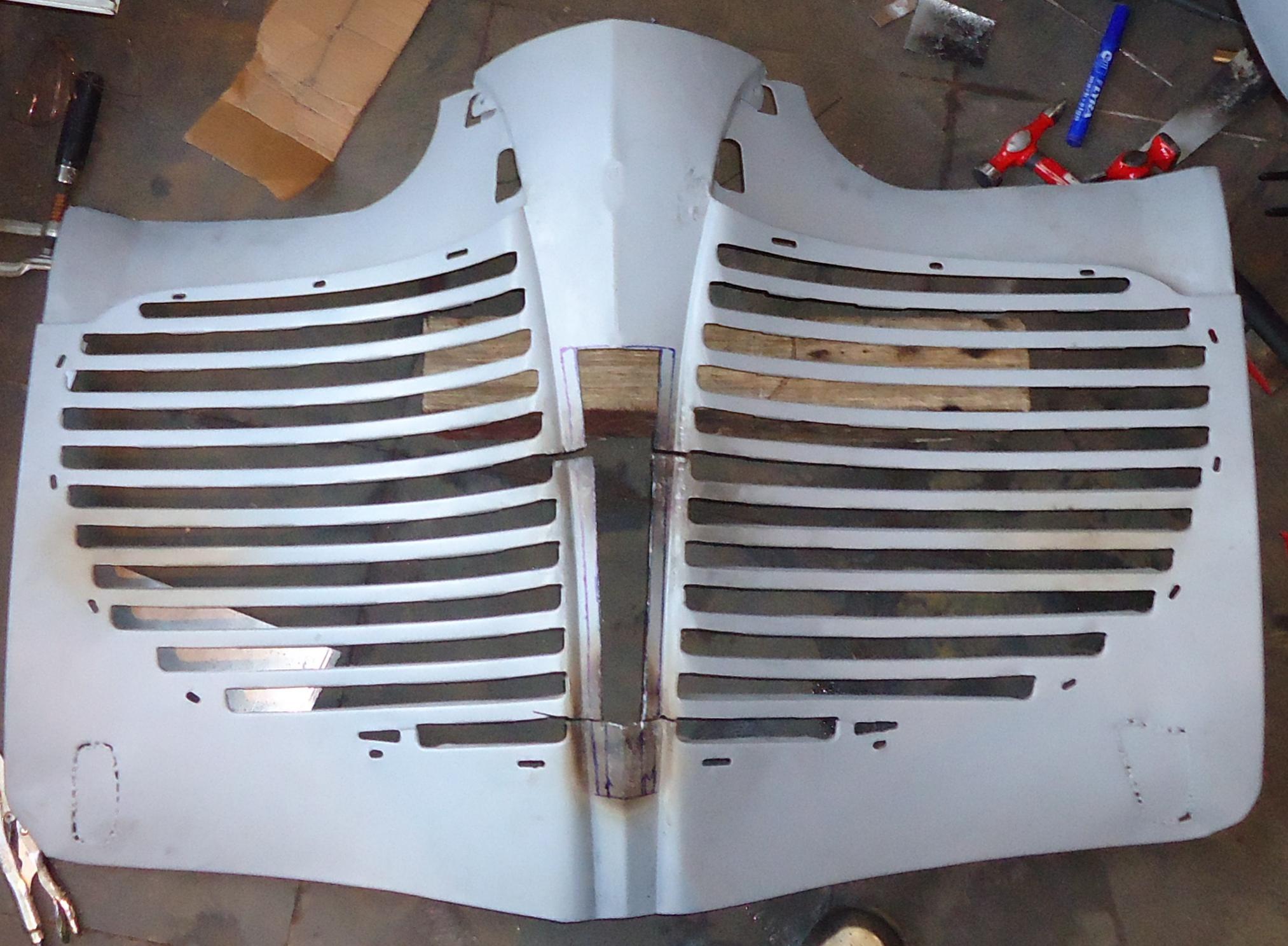

    Today I continued with it and fabricated a new centre piece with the correct curvature. This proved quite difficult as I have no stretch/shrinking machine in my garage, but with a lot of heat and cold water, I was able to get the correct shape after a few hours. Next I cut out a smaller piece than the fabricated one out of the grill and got to work with a hammer and dolly.
    Slowly but surely I'm reconstructing the old shape. Now I'm at a point where I need my welding machine........(which still hasn't been fixed) to get some initial welds in there.
