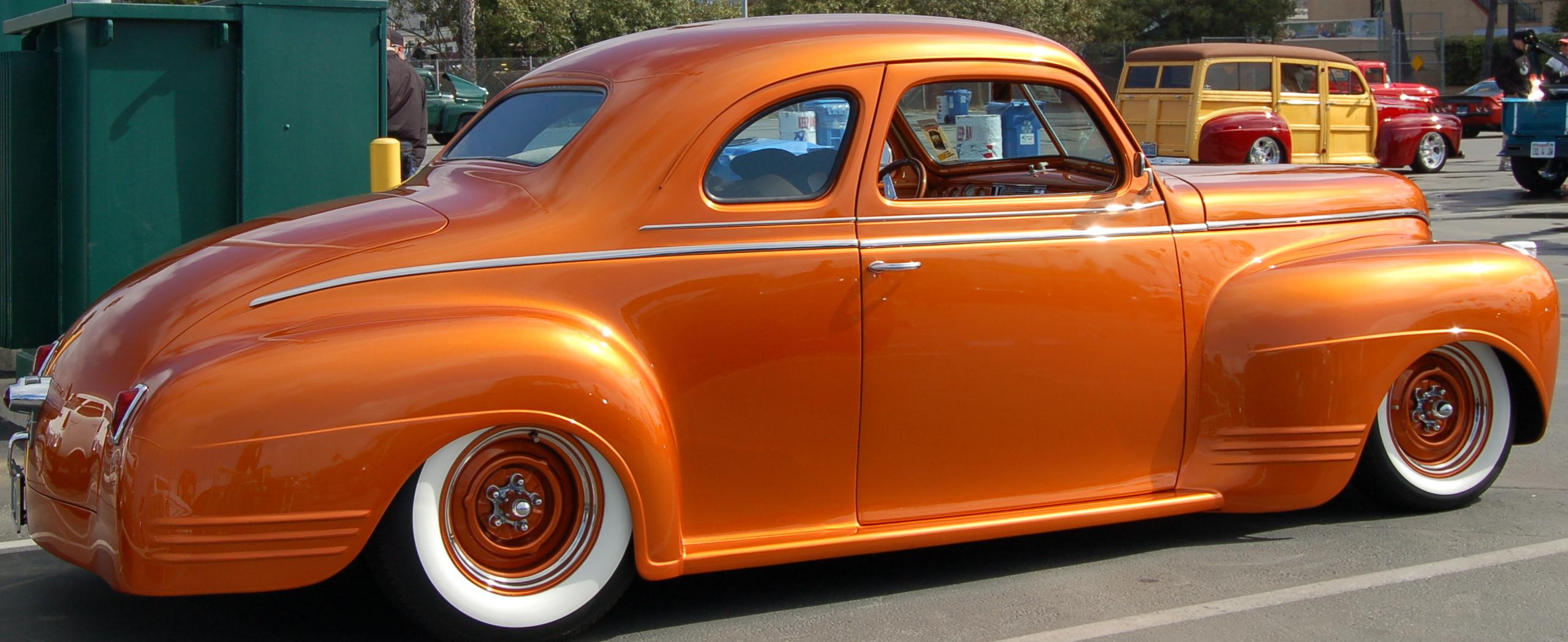

    Just got back to the Netherlands, with a great jetlag......Here are a few more pics from last weekend.

    The orange plymouth is really nice.

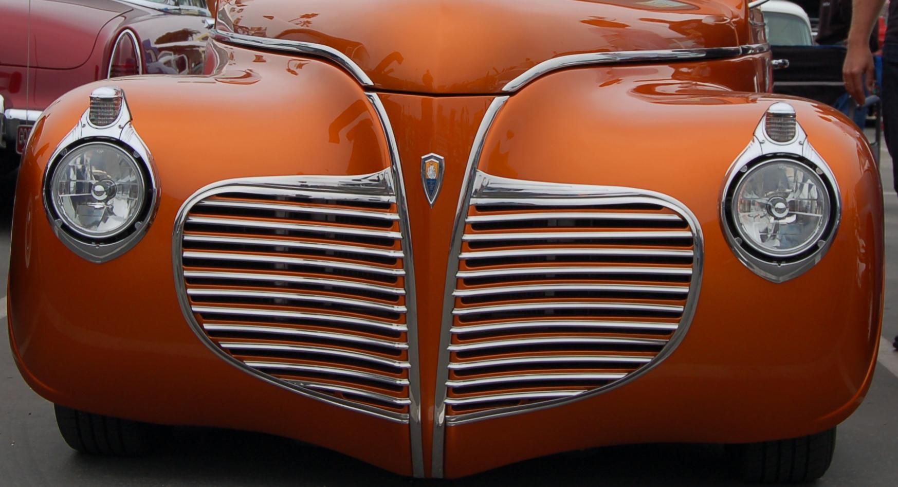

    Who does that Apricot 41 belong to, Eric? I like it a lot!

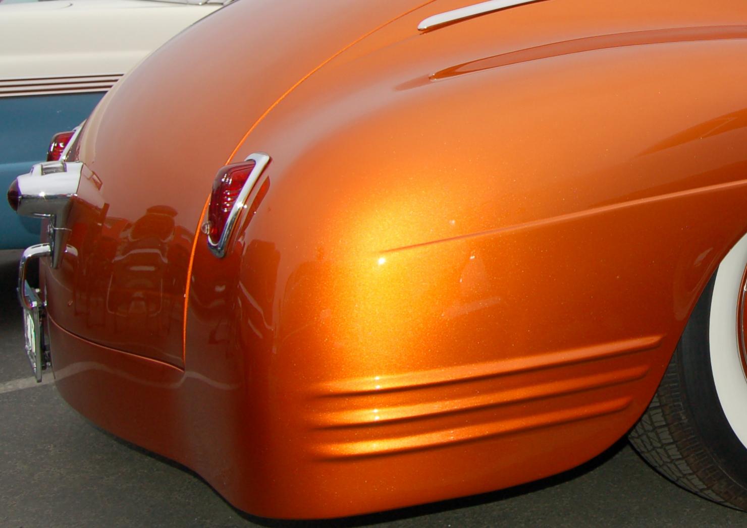

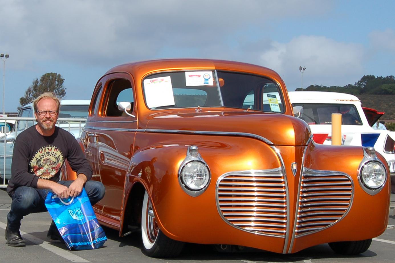

    It certainly is. It's the only one I'd seen, while apparently there was another one. This orange one belongs to Jeff Johnson from Carlsbad, CA. He was a very nice guy who took a lot of time answering any question while I was in and under the car.:D

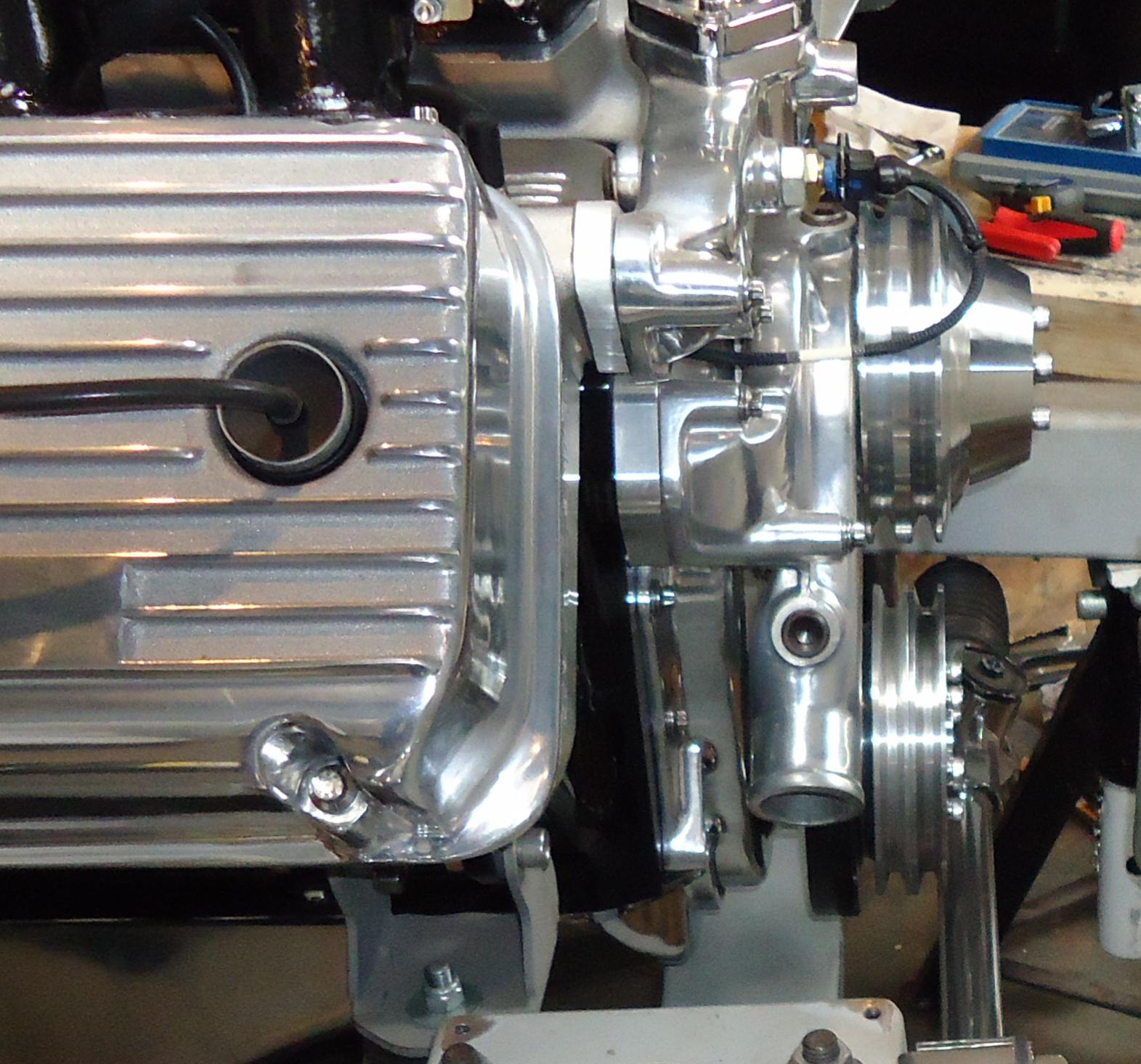

    Thank you for the thread link. I've just mounted the dual pulleys today (pics soon) and it looks like I'll be able to mount the alternator low on the p***enger side.

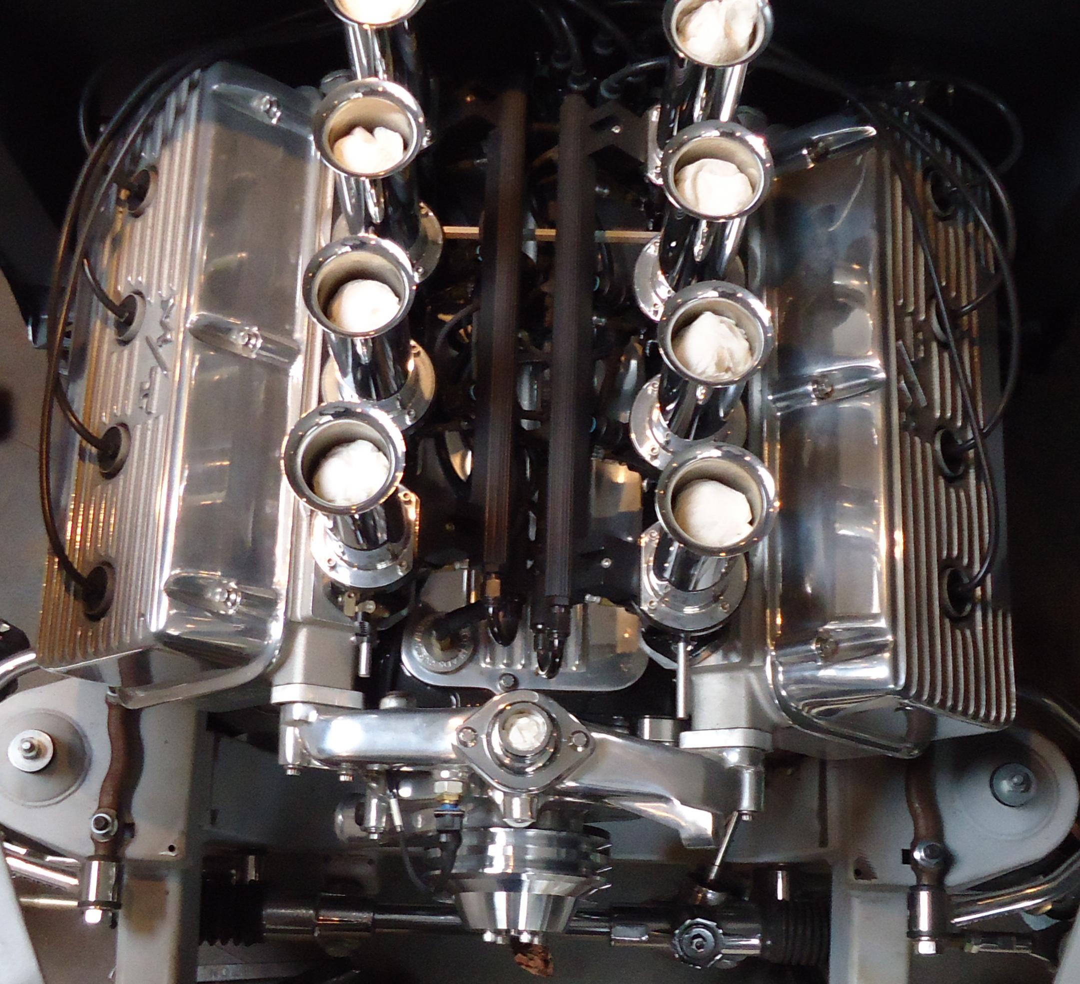

    I went ahead this afternoon and took off the top pulley and mounted the new dual groove waterpump pulley and added one to the crank pulley. The crank pulley clears the rack and pinion by at least half an inch, so that's fine. Then I held the alternator in it's position and I think I can make it work. Going to "test" fabricate some (probably weird looking) brackets tomorrow.

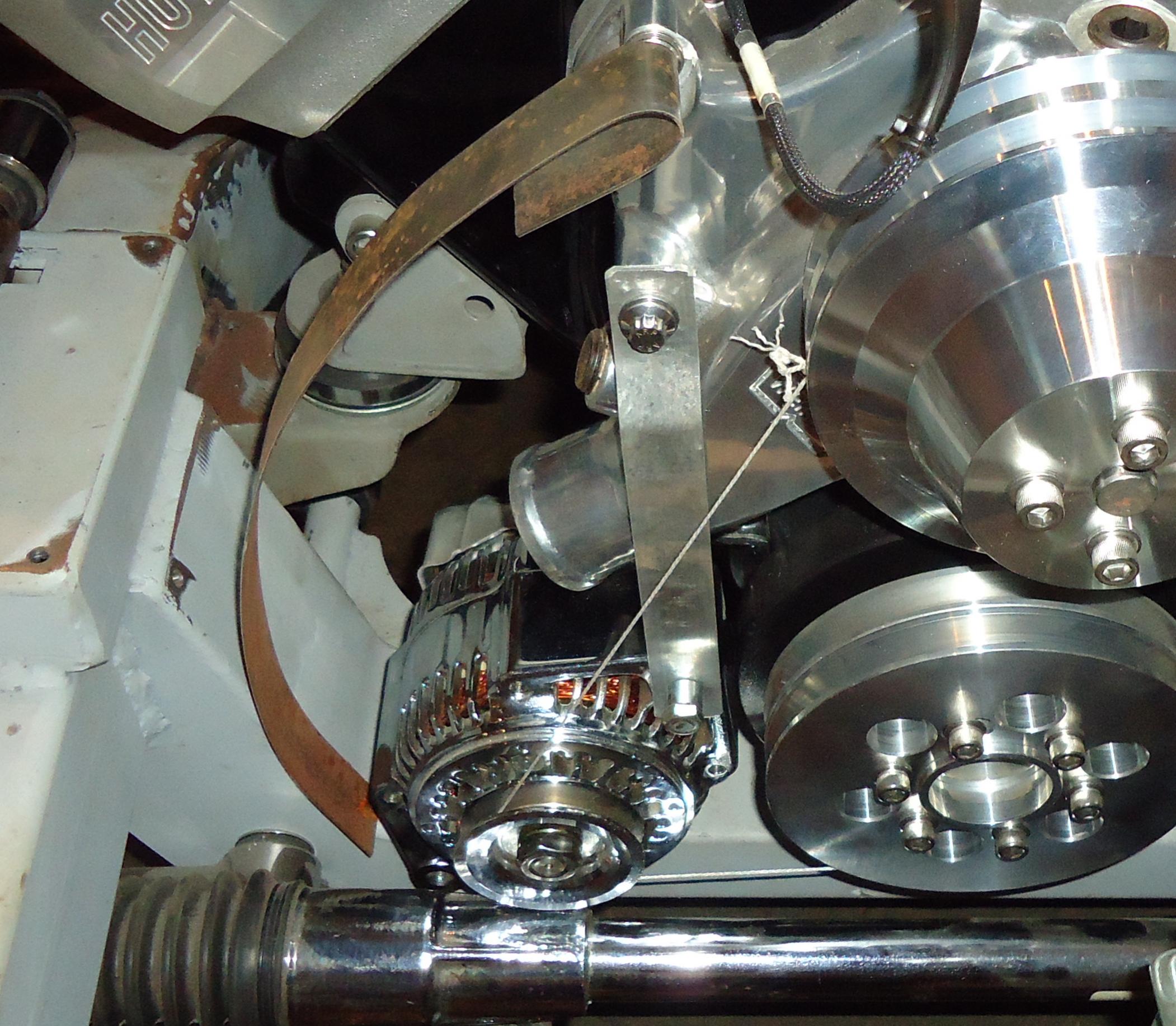

    Wow, isn't trying to work out an alternator bracket fun! After spending most of the morning trying to get the correct position for the alternator, I mounted it to the bottom of the bbc short waterpump. This will be the main pivot point. (held in place by a temporarily made piece of aluminium.) The alternator in this position will have an inch and a half of movement for tightening the belt before it either hits the rack and pinion or the waterpump hose. (I know a fairly sharp bend hose will be required). I then bent some sheet metal to get a general idea of the shape of the top bracket. I think I'll just order 2 plain top brackets and start welding the new creation. Any ideas and/or suggestions are always welcome!

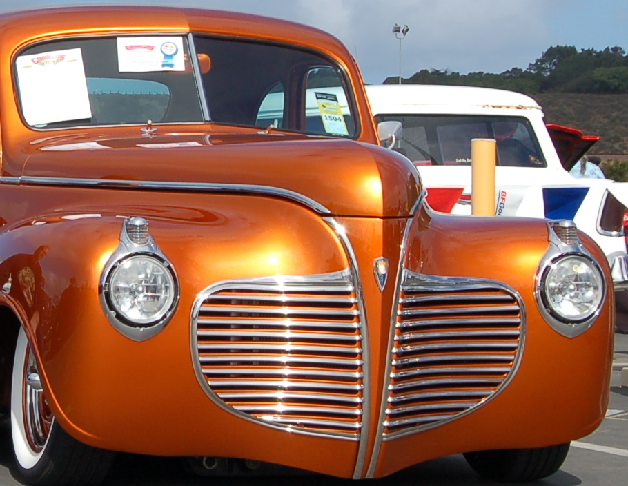

    Is it me or is he missing the thin trim ring that goes around the headlight to hold it in the bucket. It looks as there is a gap between the headlight and the bezel. That is one very smooth looking car. I hope mine comes out that way.

    Correct, he's still missing the trim rings. Still an awesome car though!

    Have you measured to see what the length of the belt will be before making the bracket? I would see what they offer before you spend all that time making that thing

    I going to fabricate a fixed alternator bracket mounted to the water pump. The adjustment of the belt will be achieved by using a belt tensioner. This way I can mount the alternator in it's relatively small but hidden position under the waterpump and still get the correct tension on the belt. The position of the tensioner is going to be determined by the length of the belt I can find. More next week. Happy Easter!:D:D:D

    Check lawn mower places too for v-belts, not just automotive places. Many, many sizes available.

    Eric don't know if it will help you but when i needed a belt tensioner for my Roadster i found a nice one on a Alfa Romeo 75, it only needed slight modification to work out nice.
