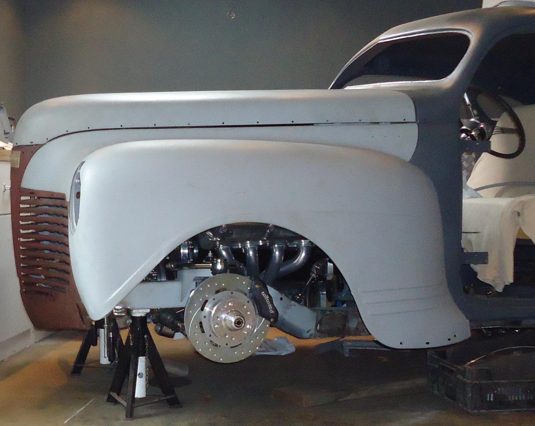

    Just spent the whole morning bolting/unbolting the front fenders/supports/etc. Finally got it in the correct position and bolted it all up again. The trim line is now equal from the front to the back. I'm going to have to reposition and re-weld the bar that supports the radiator support slightly, but I'll do this once the body is off the ch***is. The only thing I need to do is lower the hood a few millimeters, but this can be done by lowering the hinges slightly and hammer the bottom of the nose (hood) slightly.

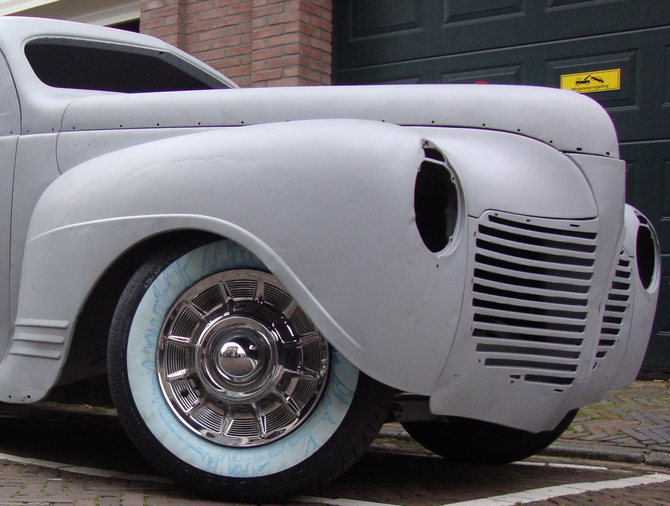

    Eric, never noticed before, but does the 41's grill hang lower then the fenders edge like it shows in your pics? My 40 the fenders and grill meet the same. Is your fenders chopped/channeled down or something?. But man the car is looking great!! love it..
  9. farmer12
    Joined: Aug 28, 2006
    Posts: 7,723
    farmer12
    This is the way it came from the factory. The grill is lower, probably so that the front bumper brackets can go through it. The lower part is also hidden behind the bumper, so normally no one would see it. Here is a pic of my car with the original grill and one pic with the lines I want to re-produce on mine.(be it with vertical lines between my grill and the fenders as I haven't yet found a way to weld aluminium to steel.:D)

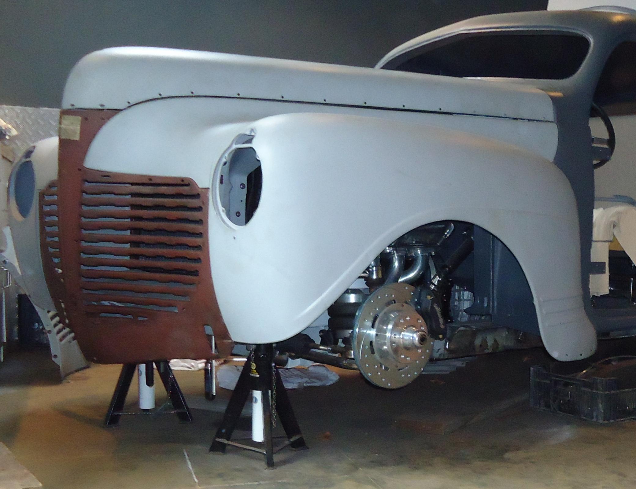

    T-shirt sounds cool,i'd take one. Are you going to fix the space between the lower edge of your fender and the lower edge of the grille? Most of the time guy's that want to make the front end a one piece, usually just use body filler to get rid of the seam. But after awhile of driving it tends to crack and break out.

    I'm not going to fill the seams around the grill, but I am going cut the bottom of the grill slightly so it will flow with the fender. This should prevent the grill looking fairly bulky, there where it meets the fender.

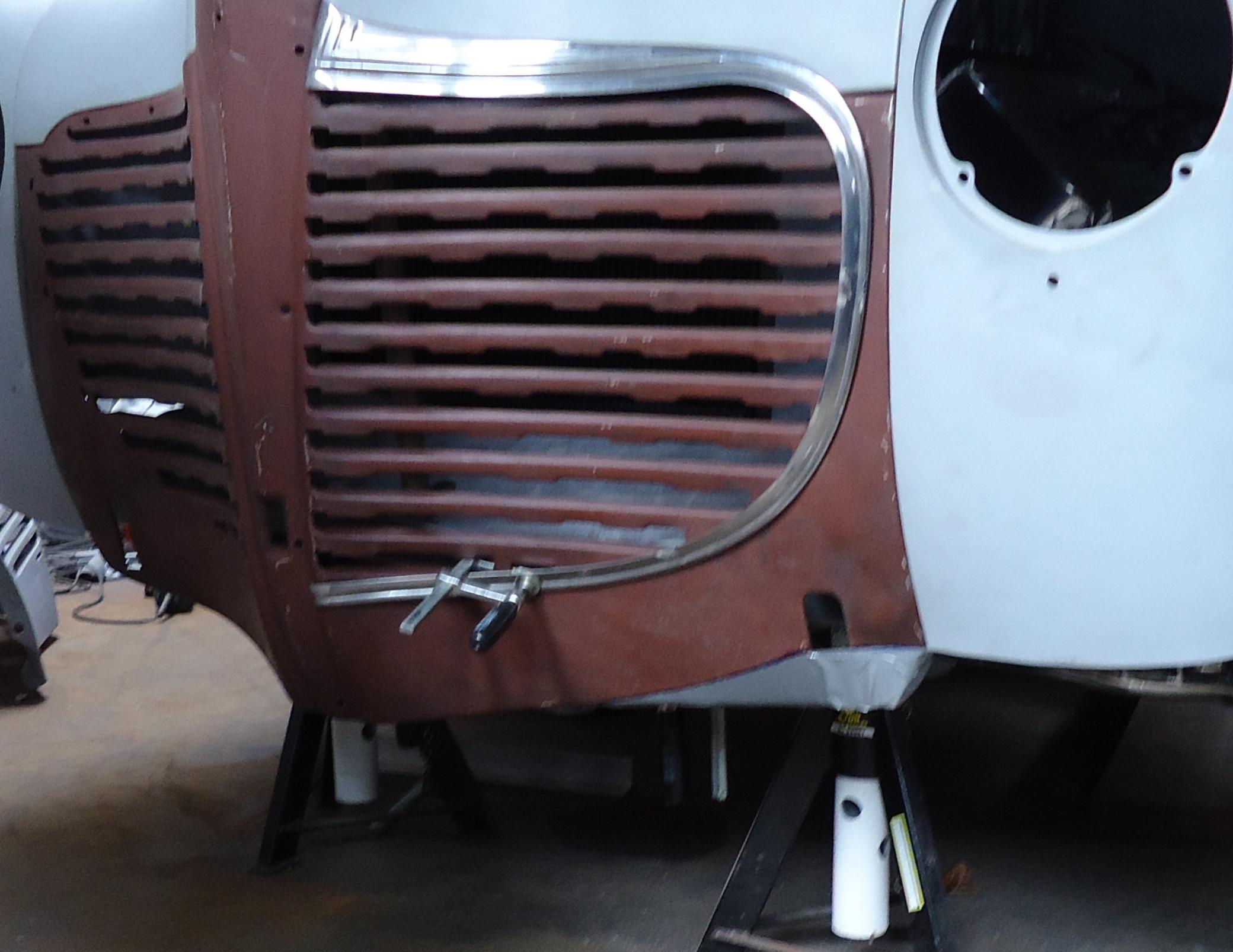

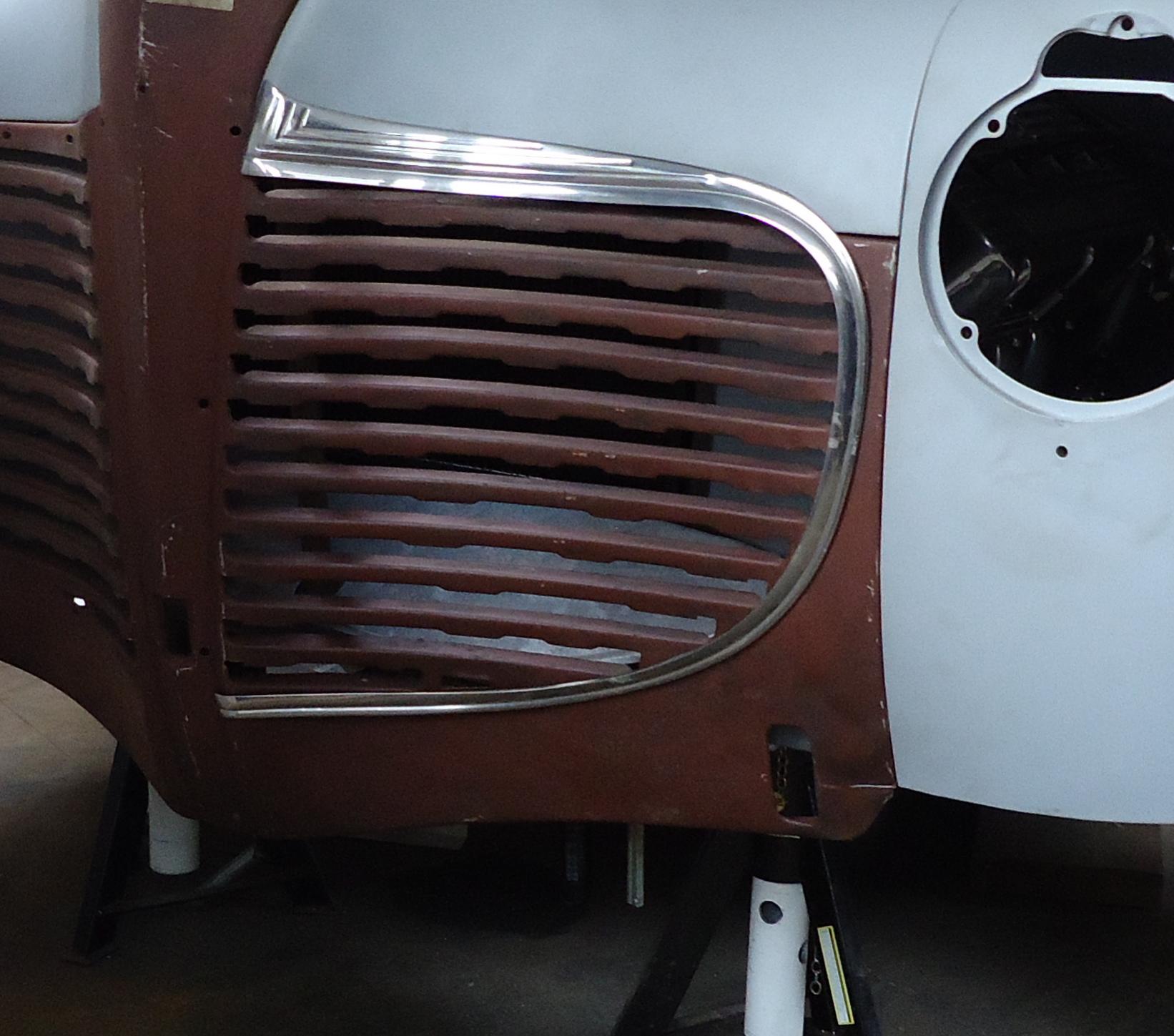

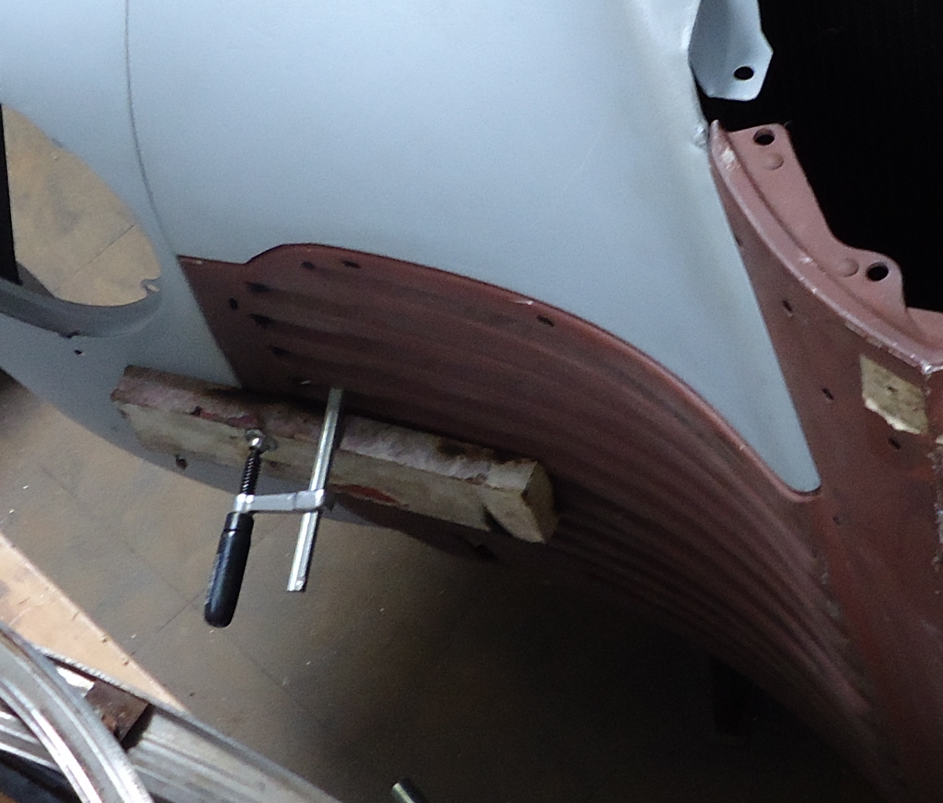

    Before I can continue with anything else, I needed to work out where I'm going to cut the bottom of the grill and do some initial straightening along the p***enger fender.
    I mounted one side of the grill trim and followed the line until it became horizontal with the bottom of the fender. I was unable to get the correct curvature where the front bumper bracket hole is, but you get the idea. Used some tape to get the outline.
    Next treated the aluminium grill with some heat to line it up with the p***enger fender. Time to think about the next step......and hope to have some more time tonight.
