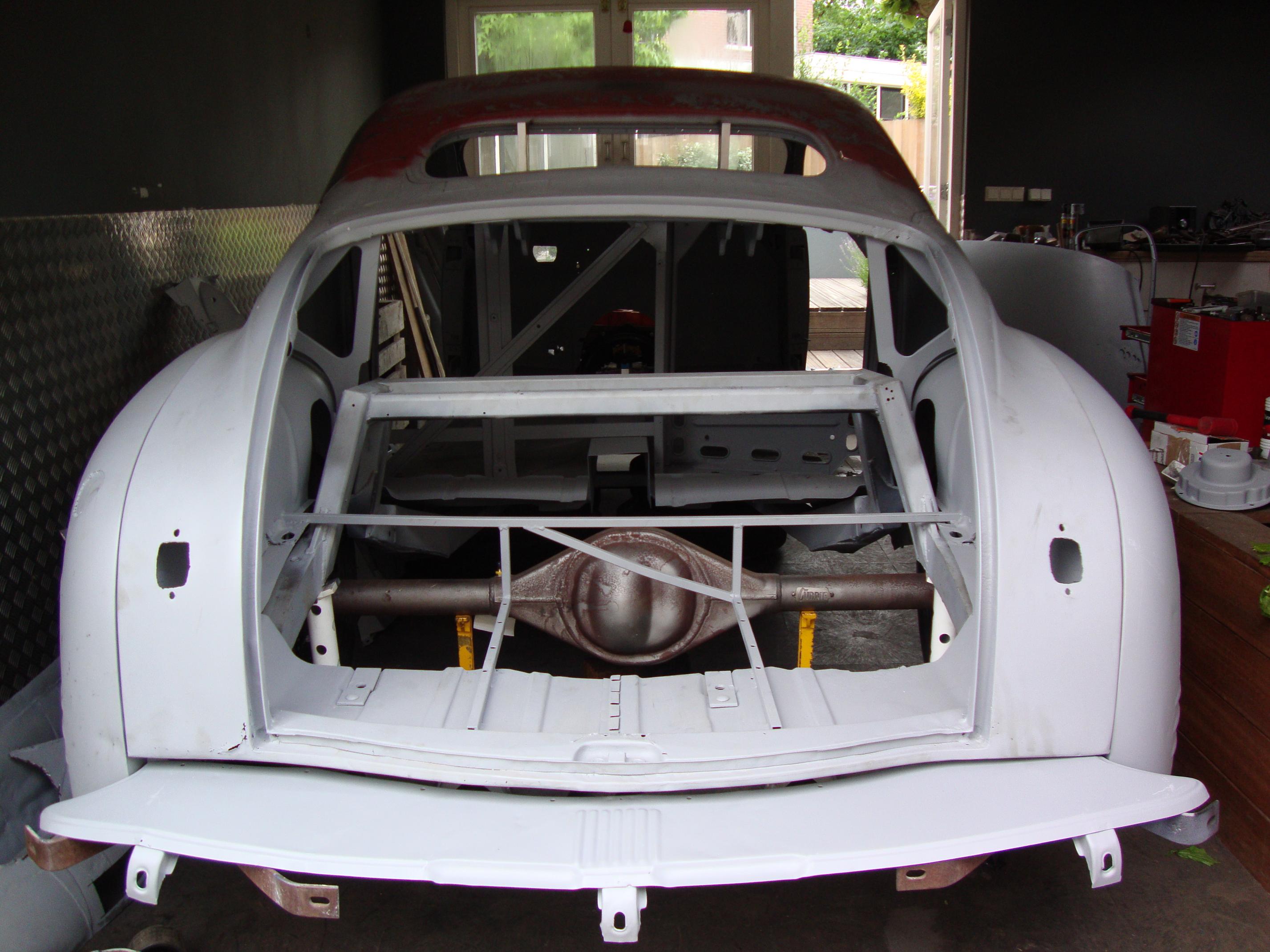

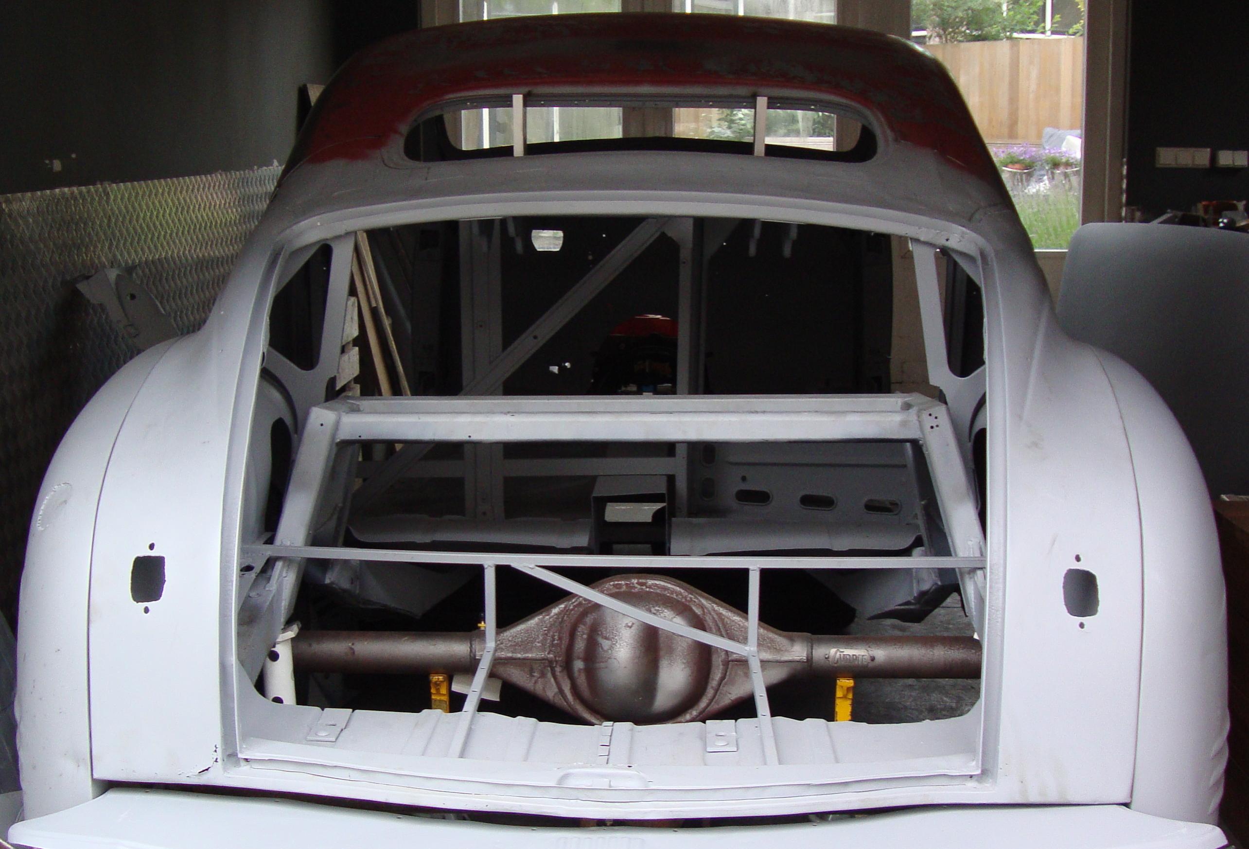

    Just picked up my new rear end from the harbor this morning. Damn these things are heavy. Its a Currie 9 inch rear end with 3.70 gears and true trac. Also installed are Wilwood brakes with 12 inch cross drilled ventilated discs. Plenty of stopping power here! Created a little ramp to get the crate out of my truck and installed the steel wheels I'll be using. Luckily the disc and caliper set up fit nicely. Raised the rear end of the ch***is and slid the rear end underneath for a first look. The exact position can only be determined when I get my body back on the ch***is, which will hopefully be the end of this week or early next week.

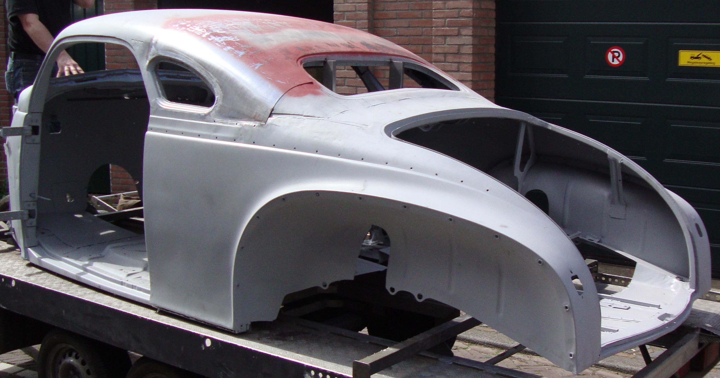

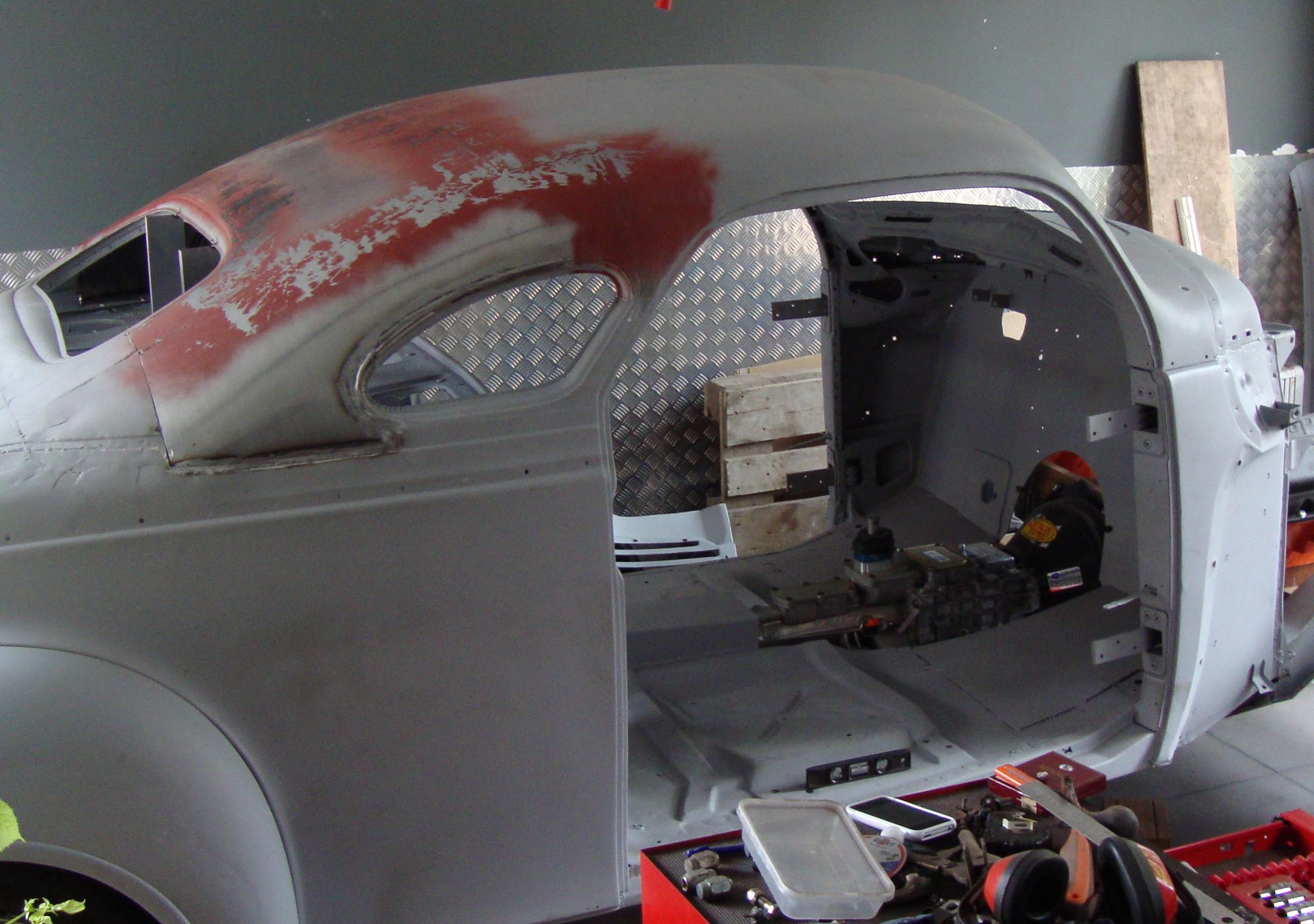

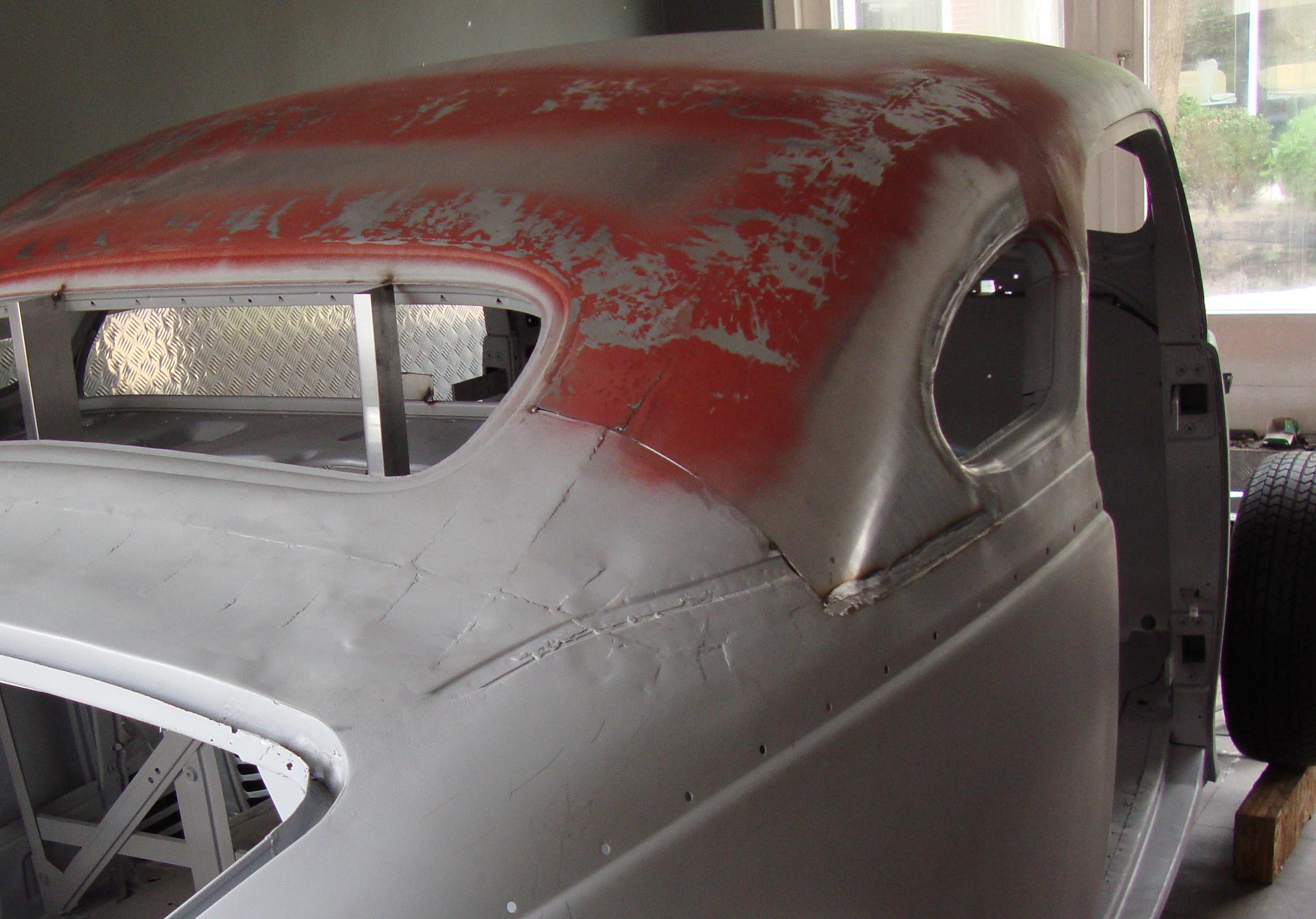

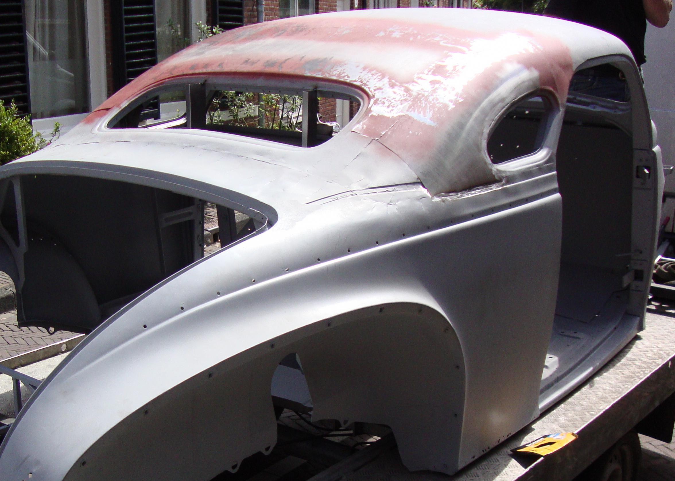

    Just been over to the guy doing the sheet metal work. The sides are now done and it looks great! The flowing lines are retained, just like it was.He spent a lot of time on the metal and it shows. Some further metal work will be required below the rear window.Will post some more pics soon showing the body.

    Here's some more pics of the brilliant metal sculpture. This guy has achieved some amazing work. I am really impressed. (just not with the bill:rolleyes:)

    Wow beautiful metal work ! Sure is miles above what was done by the previous owner!

    Thanks. Previous owner just had a different way of doing the metal work. I also understand that not everyone has metal shaping machines in their garage. I just want it done right, even if that means having to delay the build in order to get the funds together. Each to their own I guess.

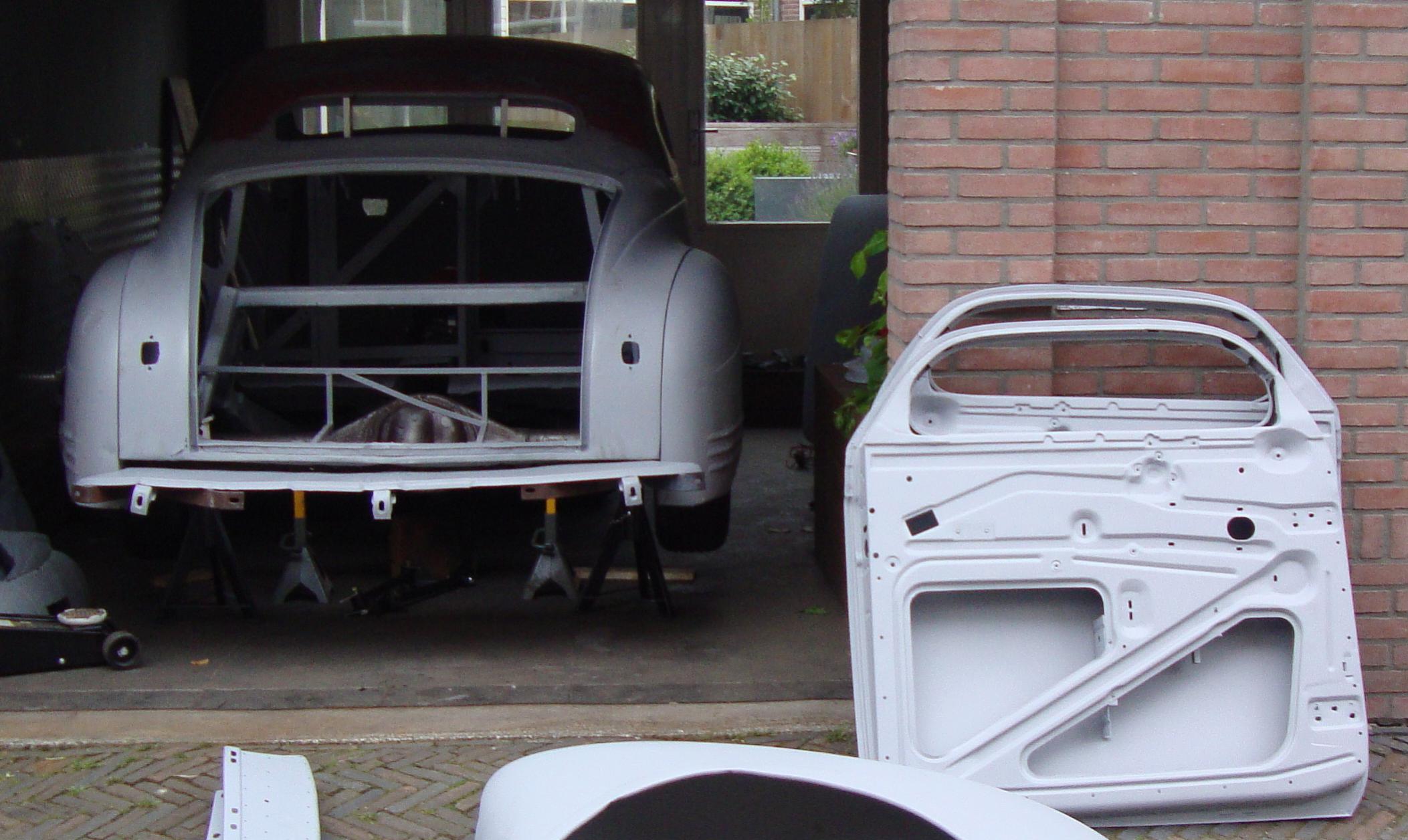

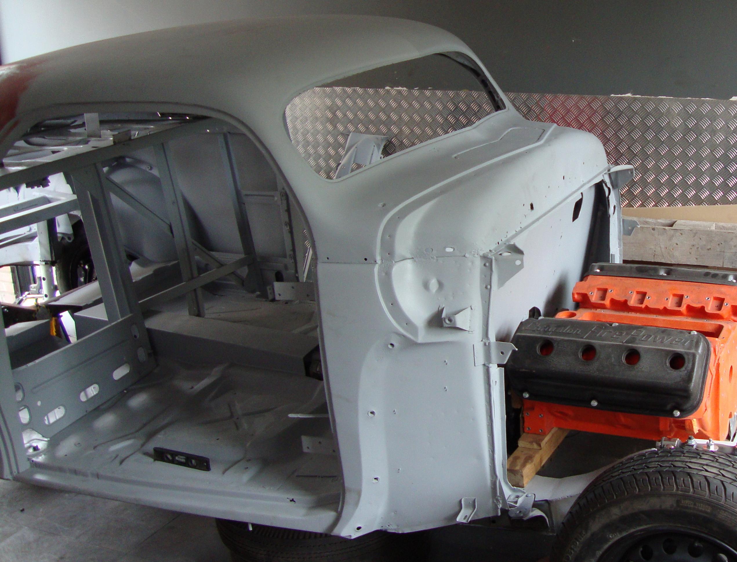

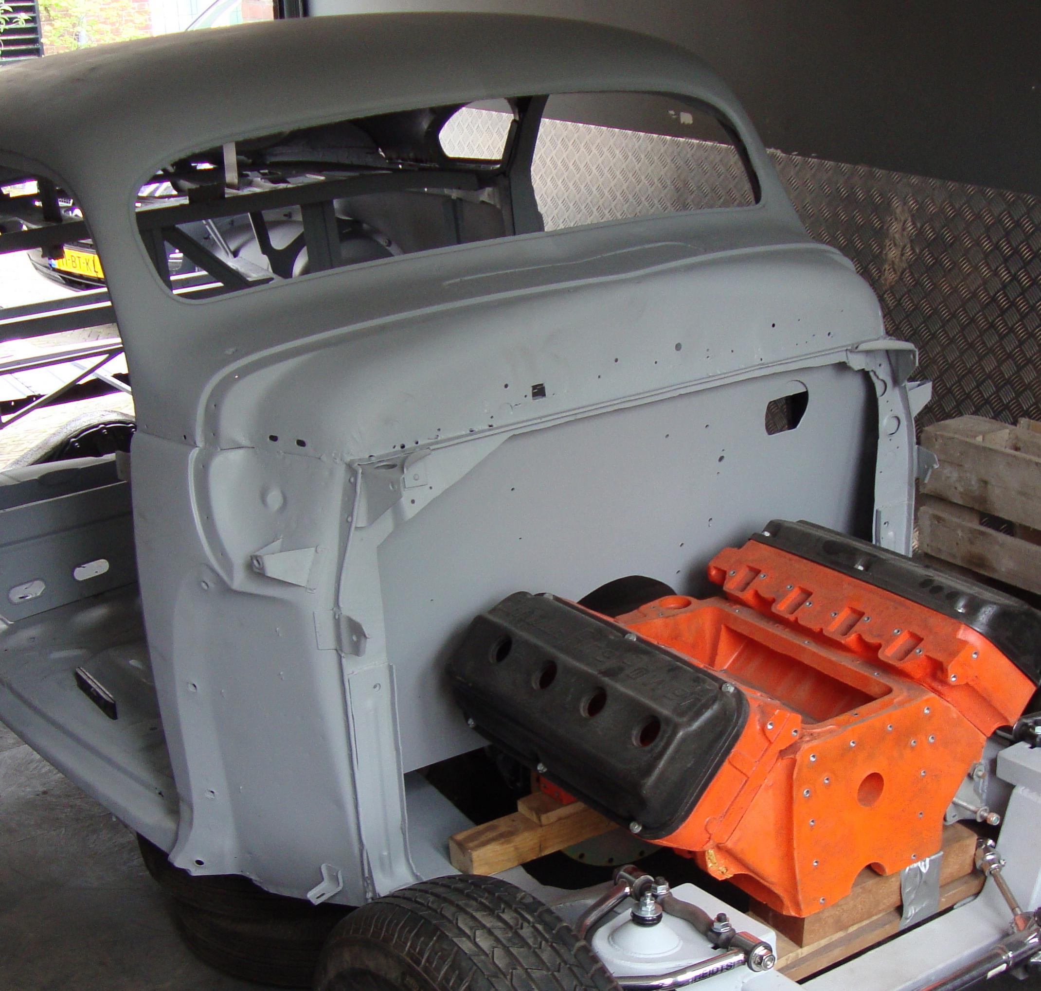

    Just got the body back this morning, lifted it off the trailer with just the three of us. Placed it on the ch***is but I'll need to do some fine adjusting myself to get it exactly in its correct position. Going to buy some new bolts, washers and nuts tomorrow. I mounted the rear fenders to ensure the new axle fits. It clears everything correctly, just like we measured. I placed the rear axle on some stands for now, having to do the final adjustment when the body is bolted to the ch***is. From there I can work out the position of the triangulated four link. Things are happening again! More pics soon.
