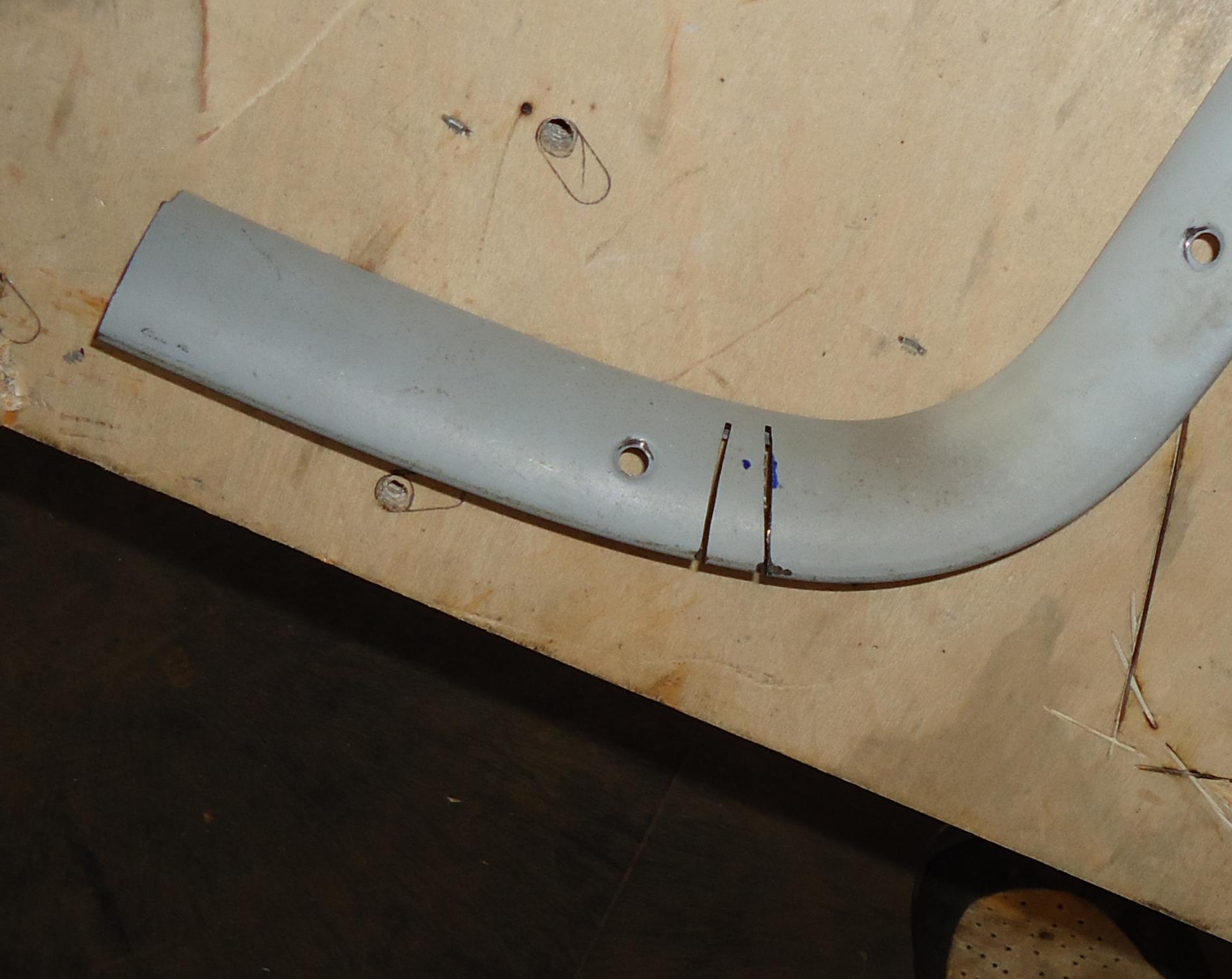

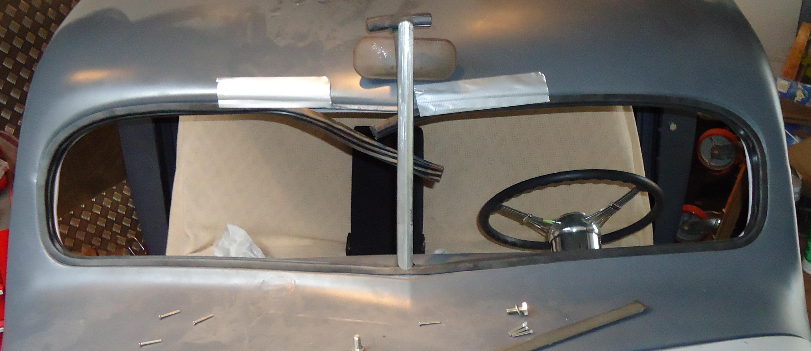

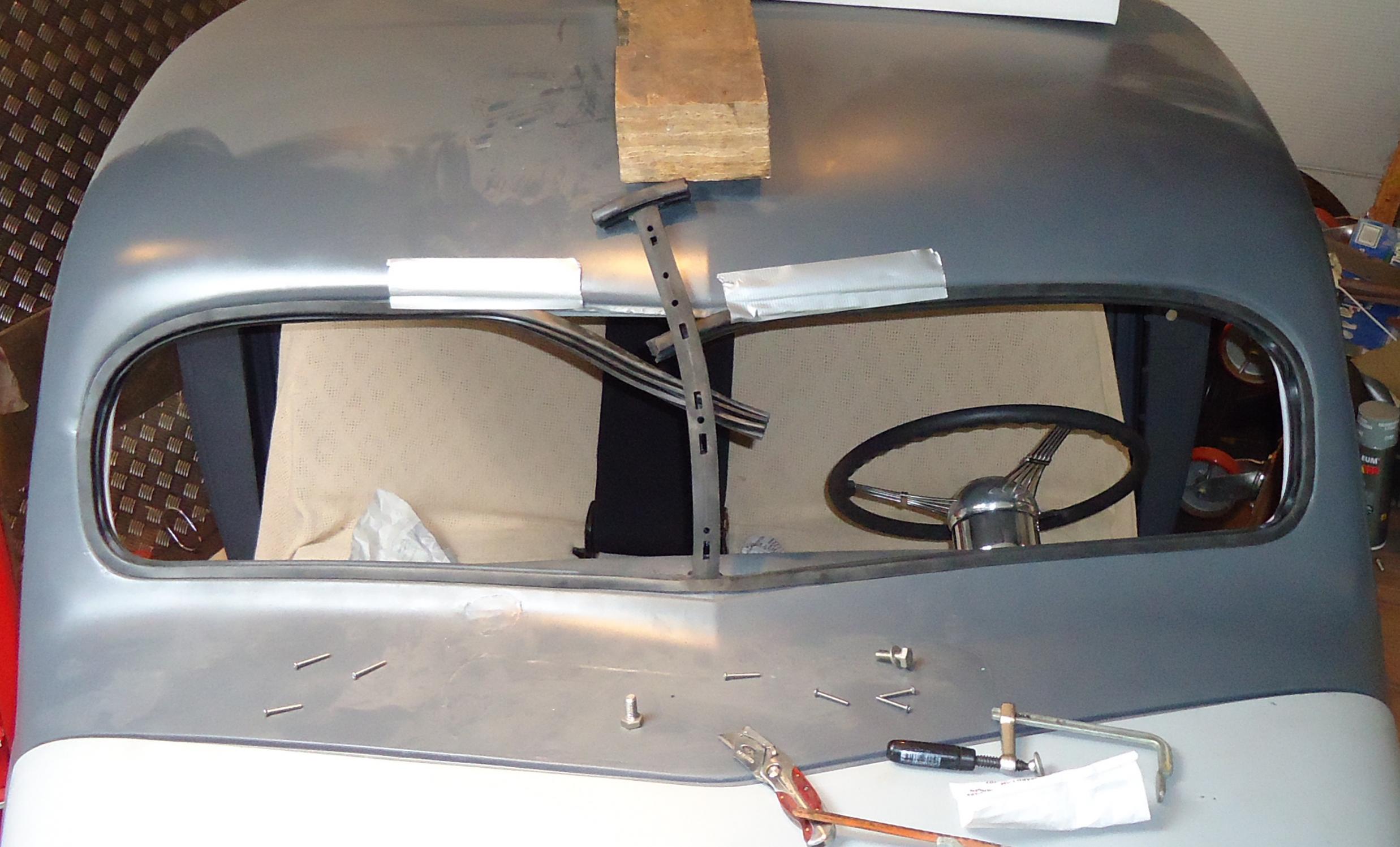

    Well I finally got my welder back! About time......Started to "loosely" install the front window rubber and got to work on the garnish molding again. I needed to make two extra cuts in order to get it to flow with the rubber. Welded and cleaned it up and installed it. The ss screws I'm using are just a little too short, so I'll need longer ones tomorrow. Hope to have a few more hours the coming days. It certainly feels good to be doing some constructive work again.:D

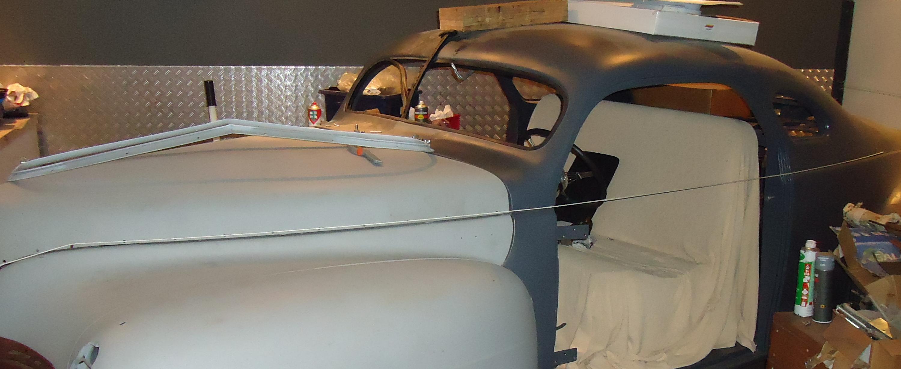

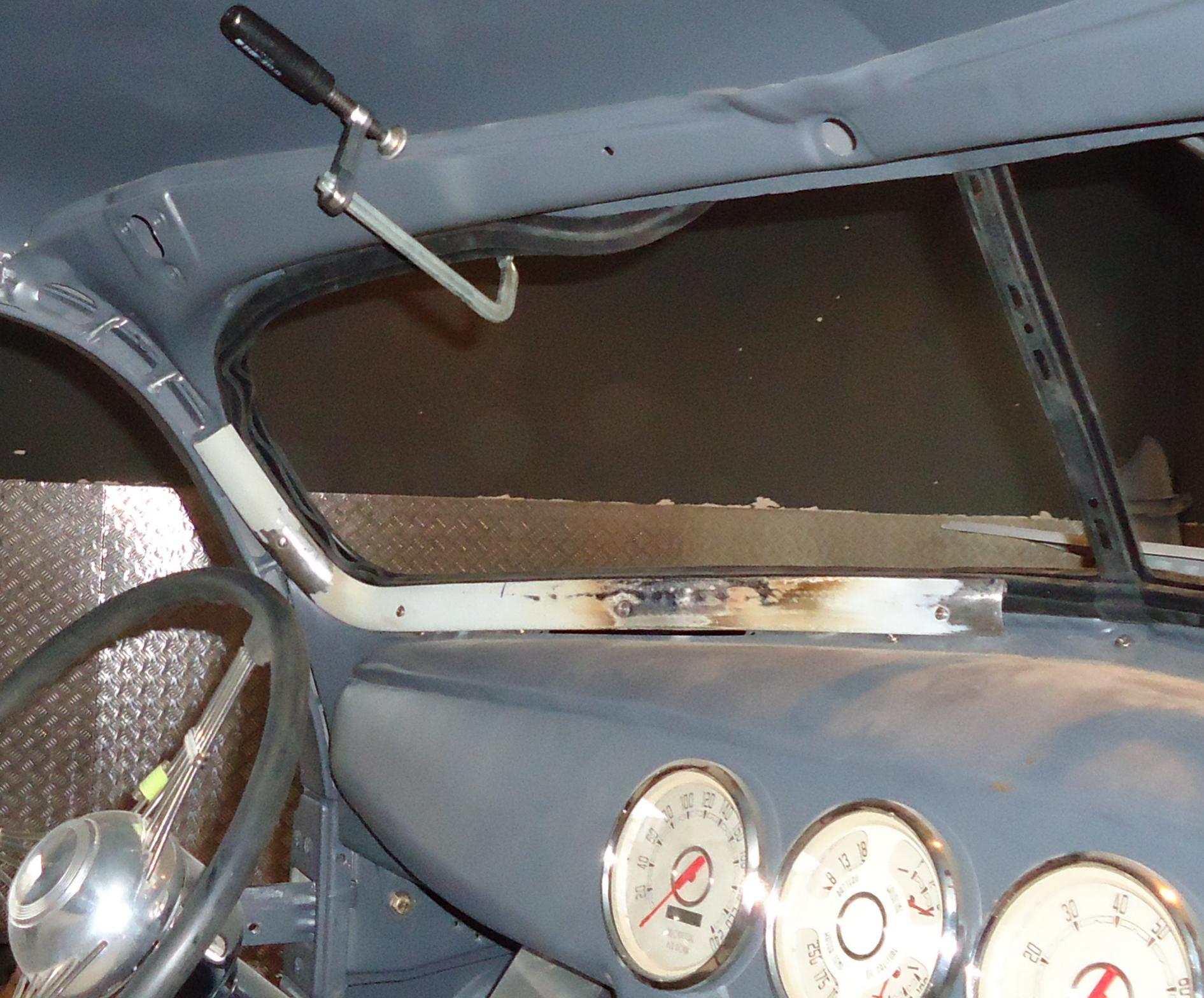

    Had a great day today! Took me about 7 hours of fitting, grinding and welding, but I've finished the windshield garnish. It was the fitting of all the pieces that took up a lot of time, then mark them off, unbolt and so on....In all my enthusiasm I forgot to take pics.....but this is the end result! Gave it a quick sanding, primered it and left it to dry. Going to fit it as a whole tomorrow.
    While waiting for the paint to dry, I got some string and attached it to the trim holes to make sure that the nose of the car is in the right position. Looks to be as straight as an arrow.:D:D:D

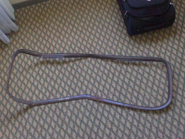

    Thats originally a one piece garnish moulding?
    I guess chopping that will be more challenging than shoebox windshield garnish,thats in 2 pieces..

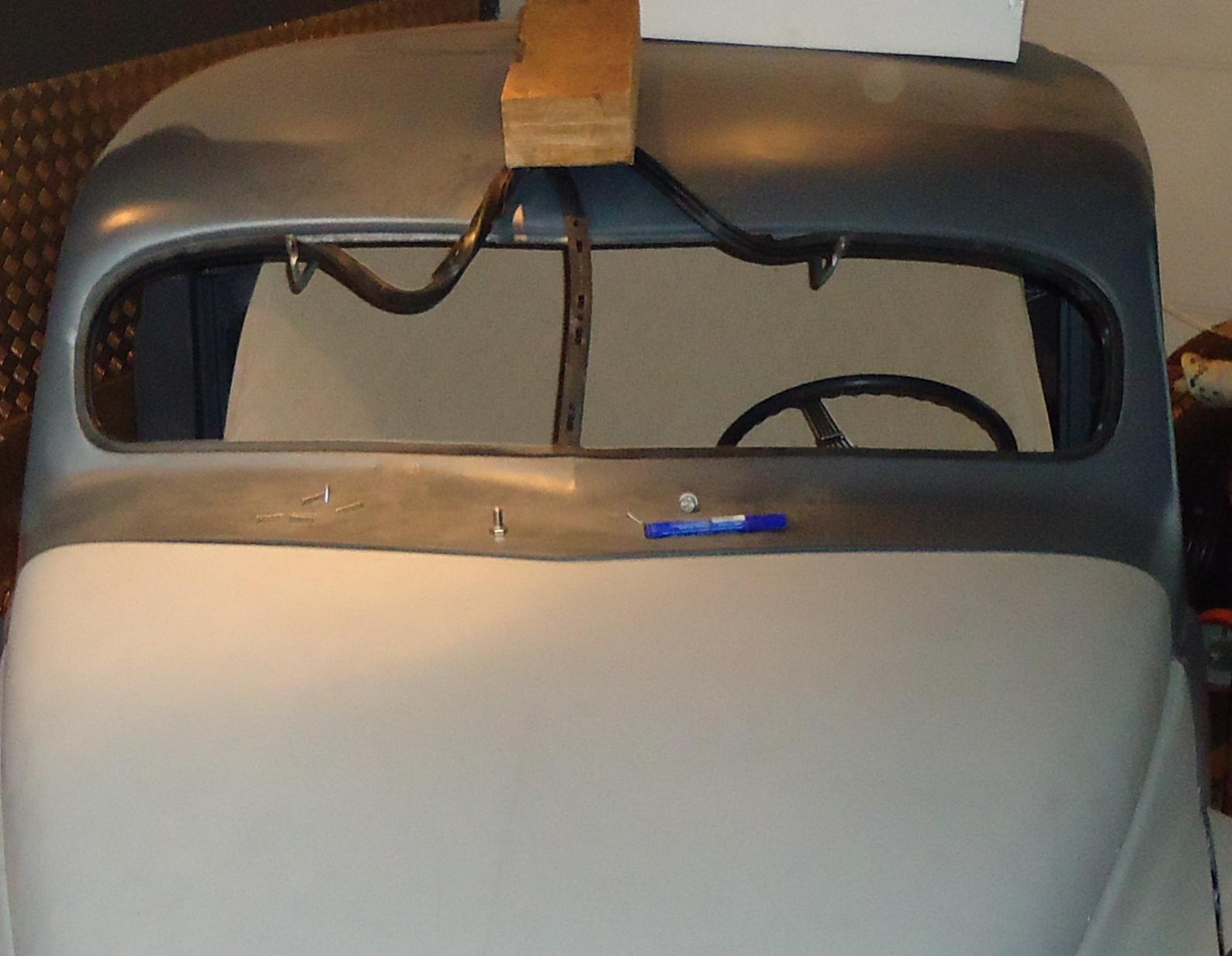

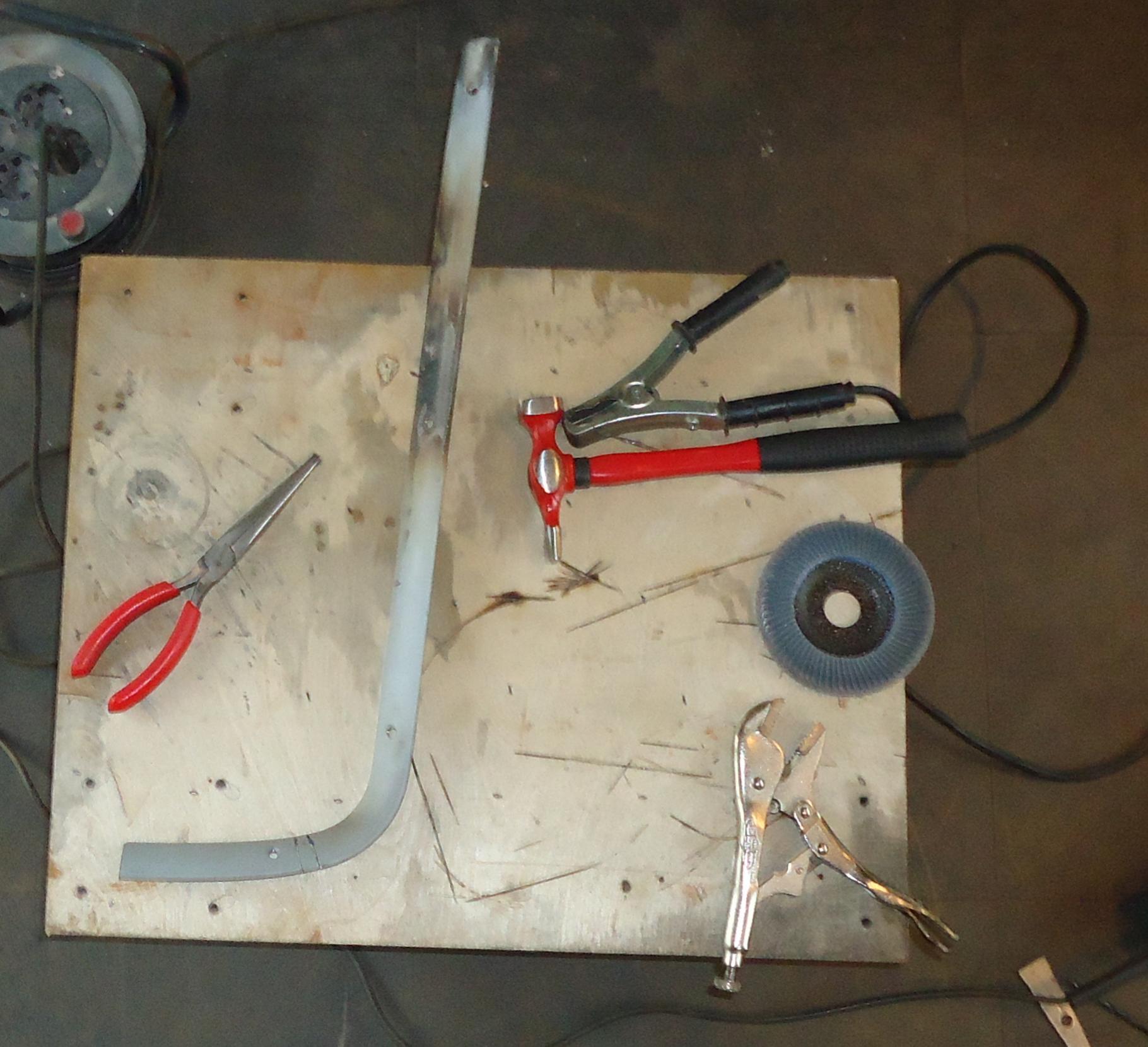

    Thank you Finnrodder. It originally is a one piece, correct. But the chop has changed the profile of the moulding dramatically. Here's the original piece I received in the mail (thank UPS....) and the end result, side by side.

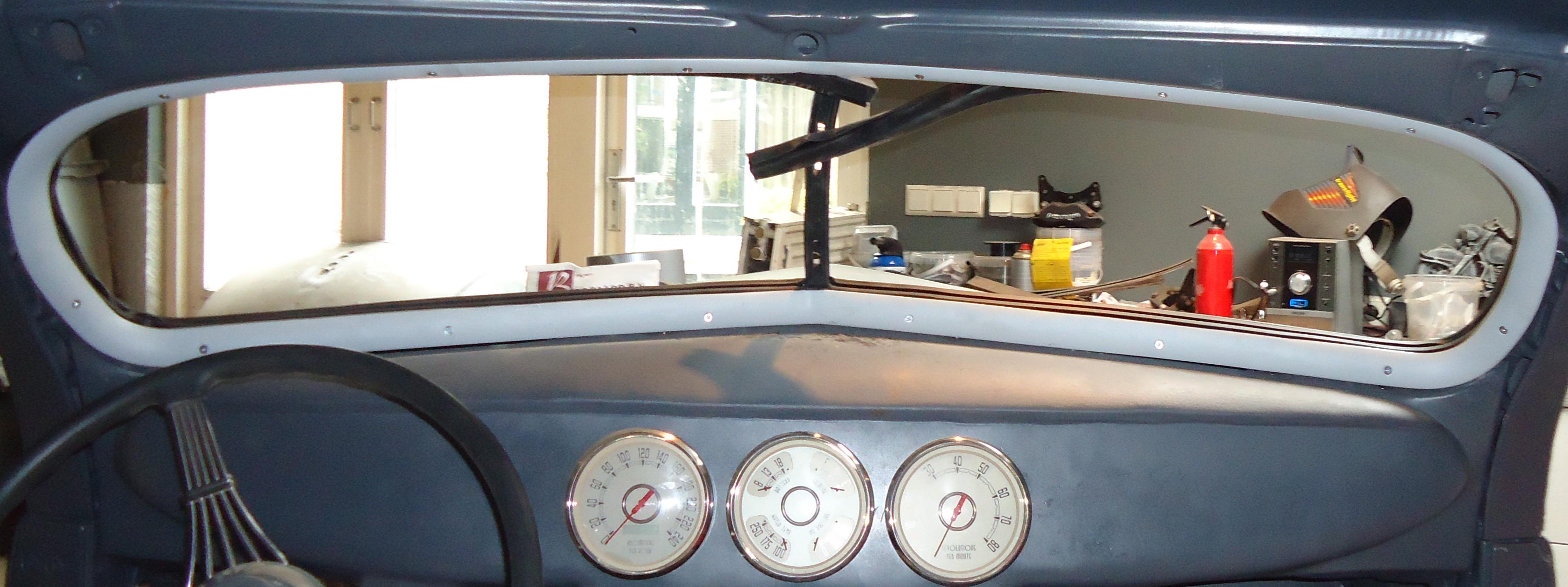

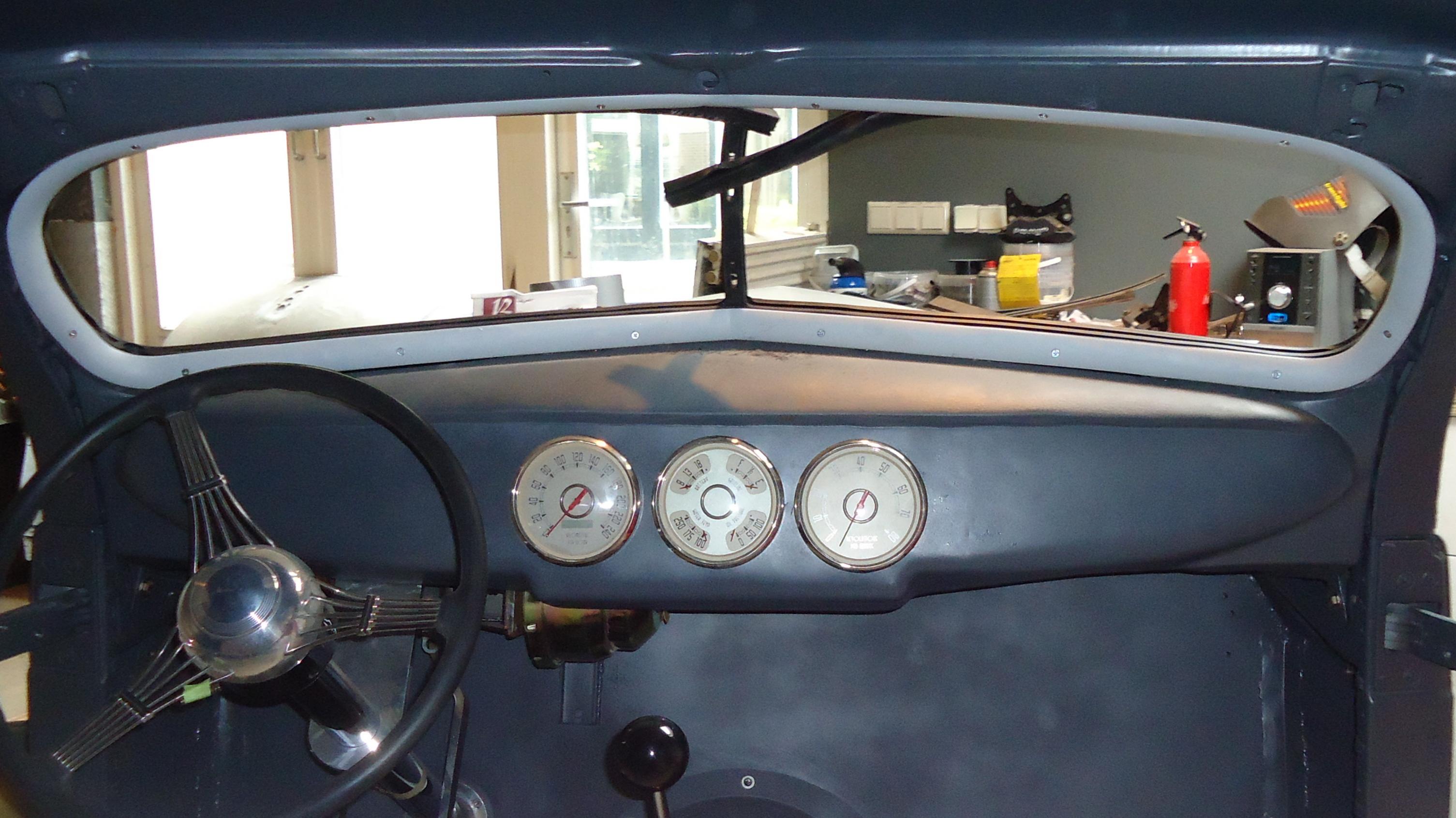

    After finally fitting the newly completed garnish moulding for the windshield, it required a little "adjusting" here and there. So out came the hammer and dolly and persuaded the moulding to take the correct dimensions. Finally: it fits like I intended and looks correct.:D Mind you, it did test my patience with probably close to 15 hours of "shaping" it.
    Next I mounted the center bar for the overall look. There's no better feeling than sitting in your car and looking at the work you've just accomplished.:D

    The car looks hot, nice work indeed. I like how you filled in the vent as well. That is a cool photo looking at the dash. Keep up the great work on the car and the thread!
