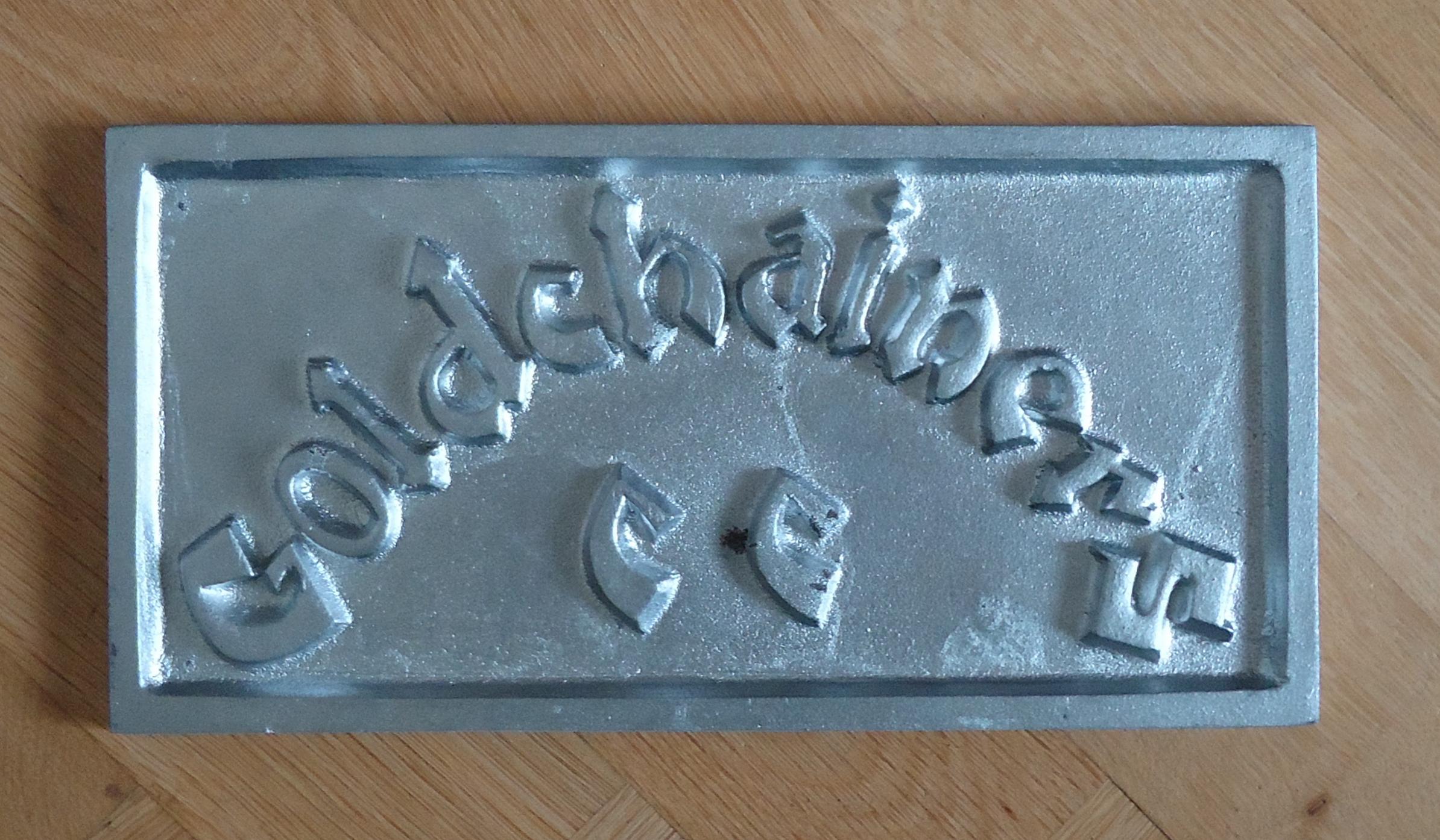

    Well Christmas has come all at once! Just received my GoldChainers plaque from KripFink and my garnish mouldings which I bought on ebay. Not that I require the mouldings though.....I just need the vent windows and the hardware that's included. Yes....I've decided to go with vent windows instead of the fixed ones! I realise that quite a bit of modification will be required, but I think it will look a lot nicer in the long run. (and more functional).

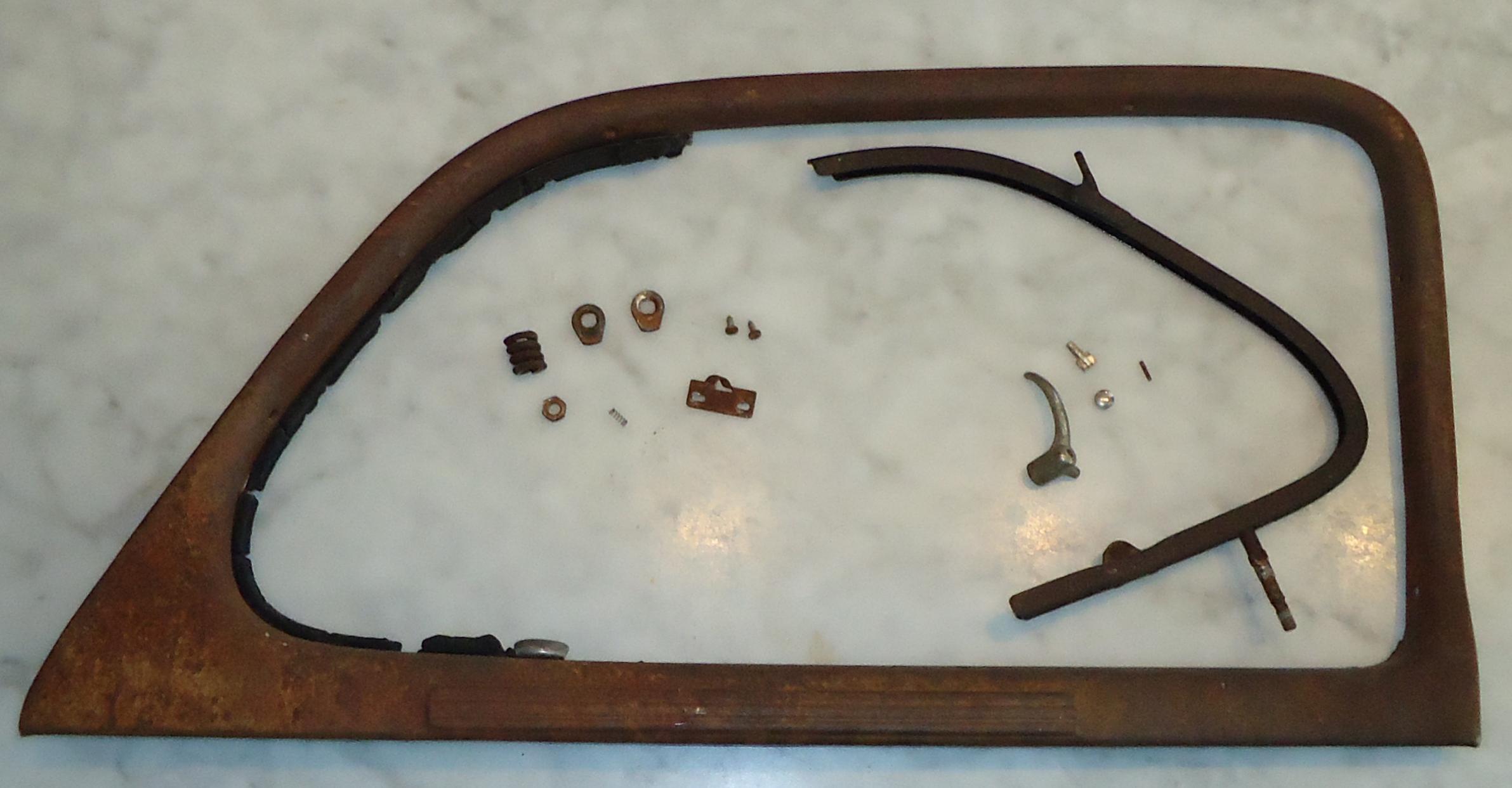

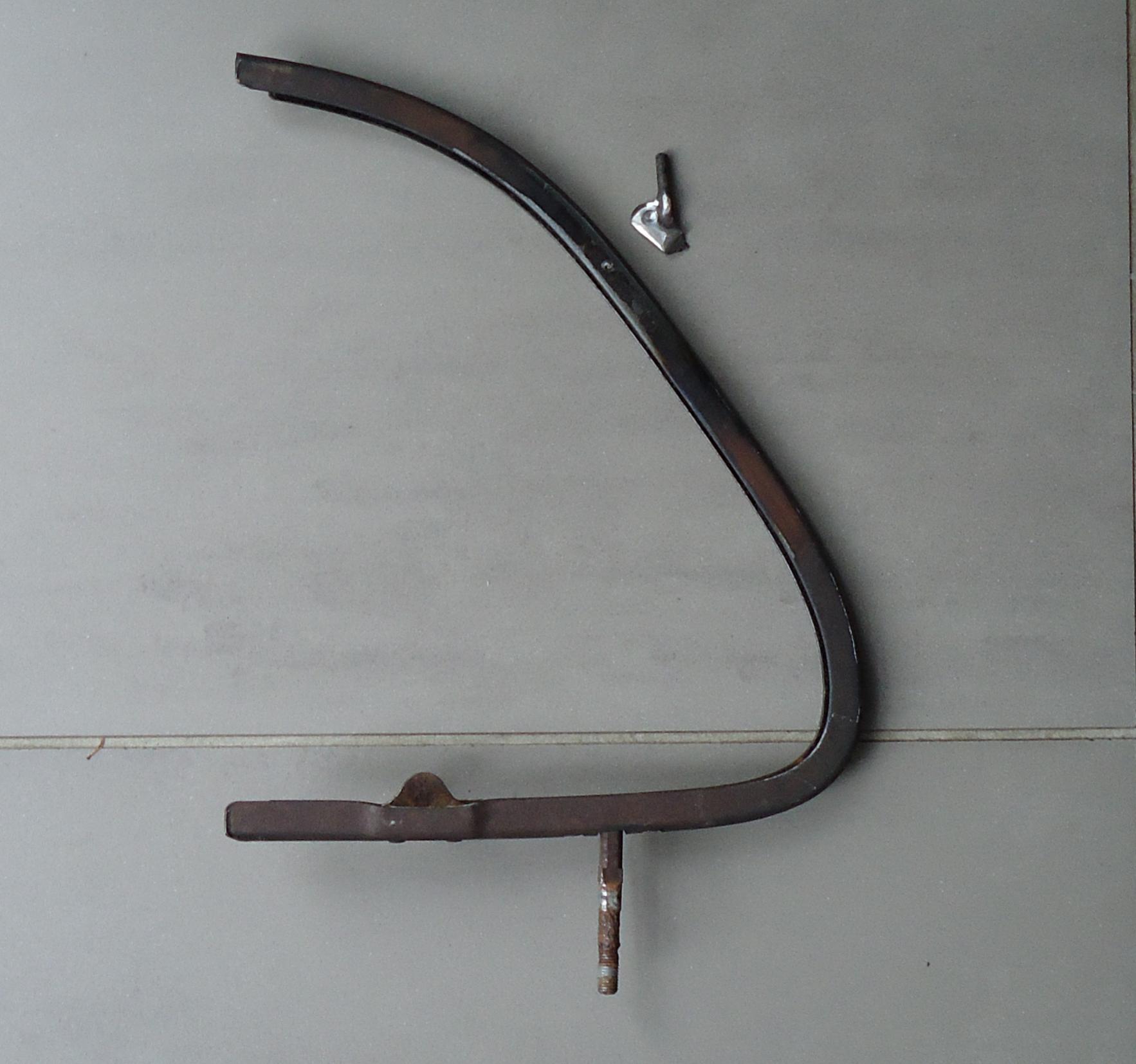

    I had a few hours to spare and dismantled one of the vent windows, which was good fun. Managed to get everything off without any major h***les, and it all still appears to be in good working order. But I will get everything re-chromed eventually....The only difficulty I had concerned the top pivoting pin. It is riveted on to the frame, so I had to grind one side in order to remove it. (I will need to re-position it anyway, which will change the angle and therefore a new base will be required.)
  27. Rebuilding those vent windows is a pain. I rebuilt two from an OT Blazer a couple years ago. Like you, I had to grind off the rivets to take it apart to replace the rubber seal. Fortunately I wasn't chopping it like you are, but it was still a pain. But, it's all part of the "fun". :)

    I don't have any pics to show you right now, but I am leaving the pin in its position and relocating the pin-set to fit. The pin is on a relatively flat surface of the vent frame, so when I need to remove material, I can do it below the pin... I have an old book by Tex Smith that outlines garnish mouldings pretty well. I can scan and email it to you if you like.

    Thanks Rich! I suppose that is one way of re-locating it. I figured that I'm going to re-shape the vent window frame first, then find the correct postion for the pin directly above the lower swivel pin. That way they are in line. The only foreseeably problem I think will be the vent window rubber stripping that will need to be cut....and rejoined.
