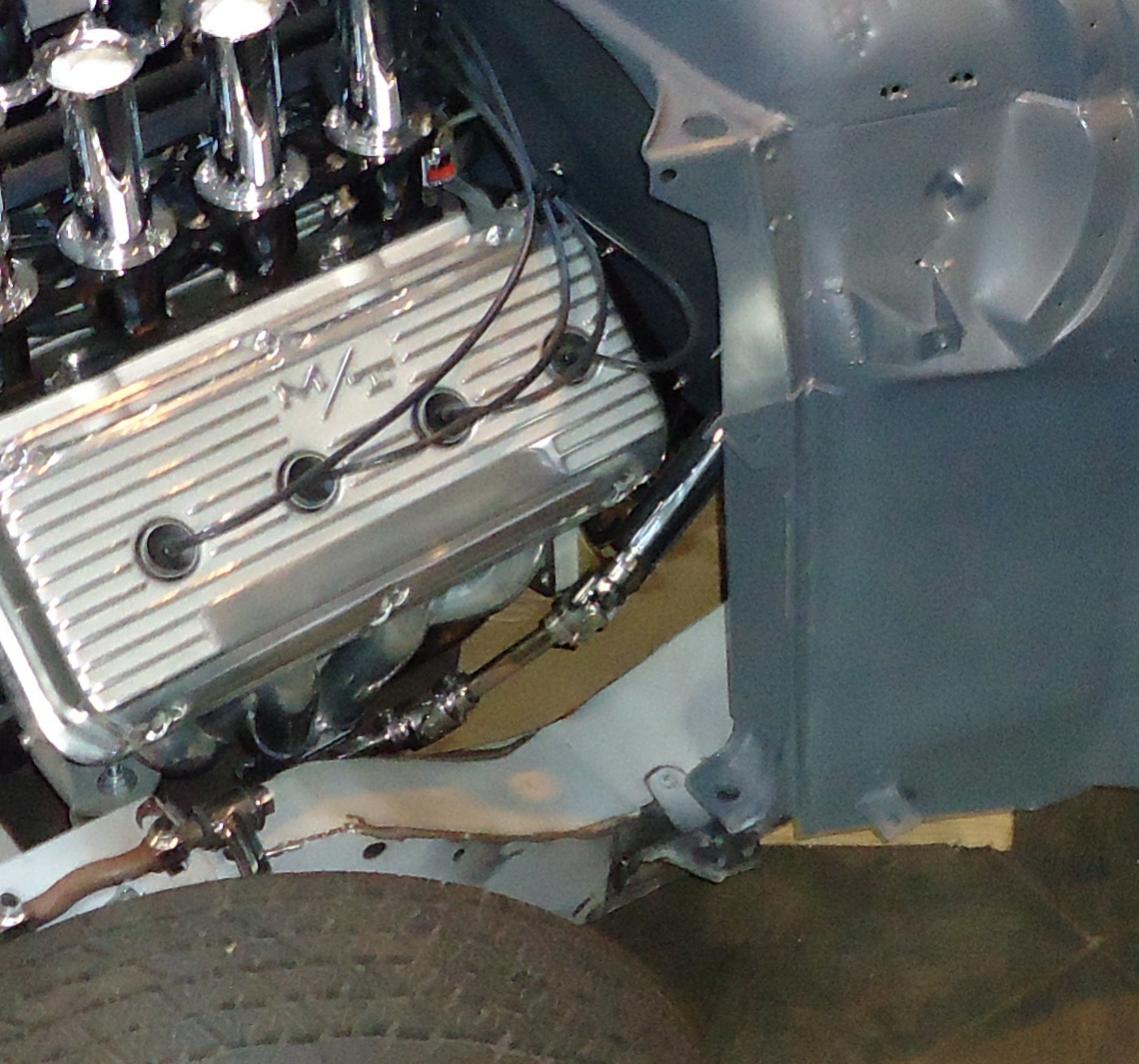

    A buddy of mine just milled these supports for me. They will be positioned under the most forward body supports, just in front of the firewall.(with rubber of course to prevent vibration.)
  8. SlmLrd
    Joined: Oct 27, 2007
    Posts: 999
    SlmLrd
    from DAGO
    Eric, are ya running brake lines through the mounts?
  9. farmer12
    Joined: Aug 28, 2006
    Posts: 7,723
    farmer12
    The only thing that will be running through the mounts are bolts. His photo also depicts a couple of brackets he made, but that has nothing to do with the supports.:D

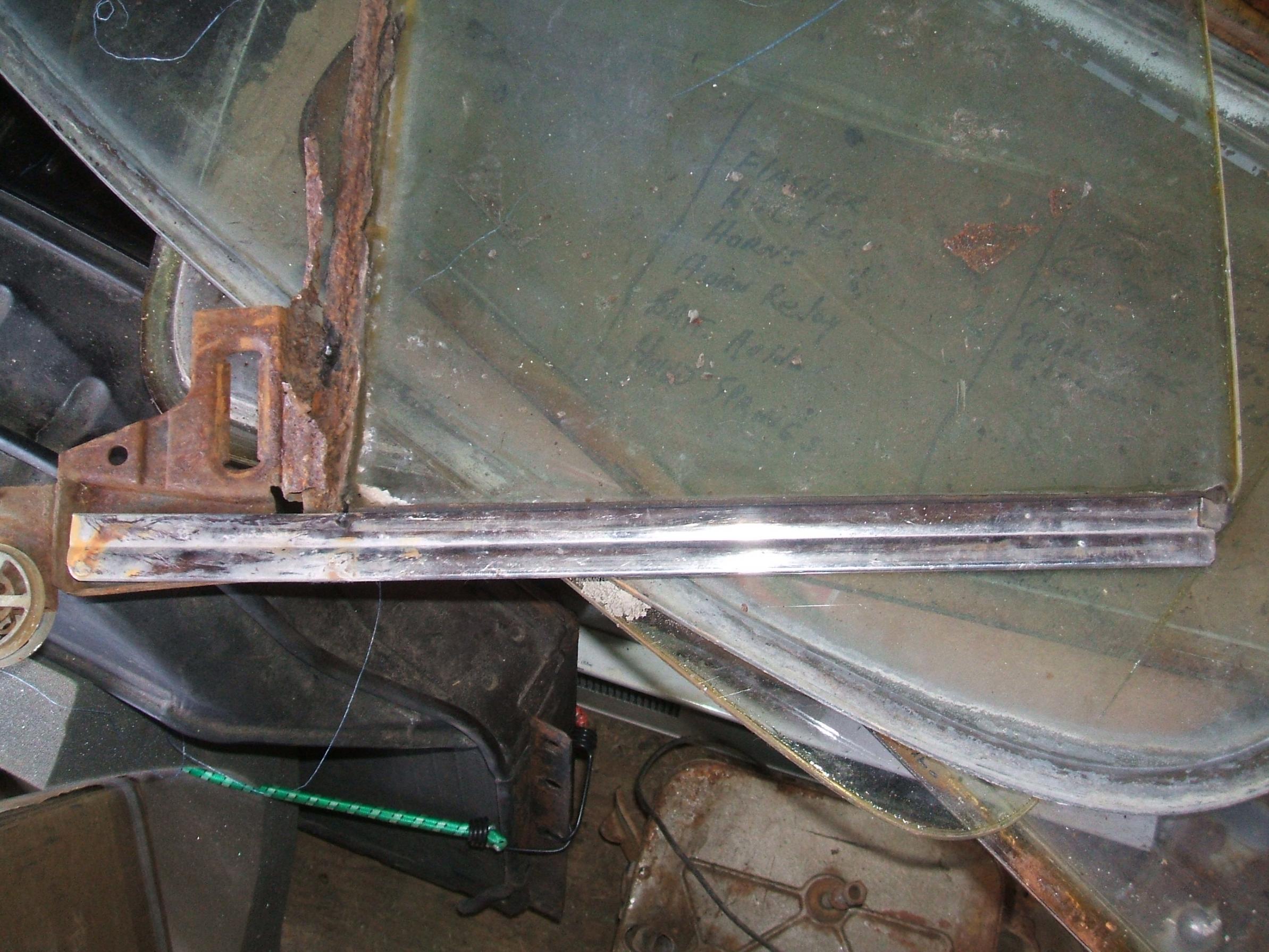

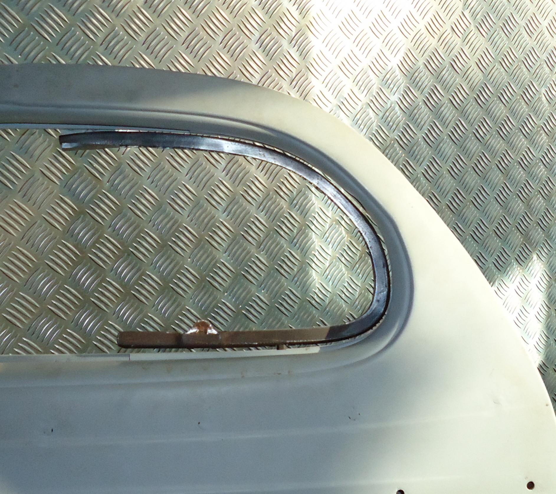

    I now know why a lot of chopped cars end up deleting the vent window.........I spent the whole afternoon trying to re-shape it with a lot of relieve cuts, welding and grinding, but did get a nice gap all the way around. I still need to re-shape the top part, but will do that once my dividers are in the mail. I will continue cleaning it up tomorrow. Fun.
  12. LeadSledMerc
    Joined: Nov 29, 2003
    Posts: 4,106
    LeadSledMerc
    Looking great, Eric.
    You'll be glad you spent the time when it's all done.
    It took me quite a while to get mine right before I had the chromed, but they seal well, and they even work!!:D

    Thanks for the offer Art, but the vent frames are plain steel. For some reason a lot more difficult to weld than the rest of my welding work so far, but doable.

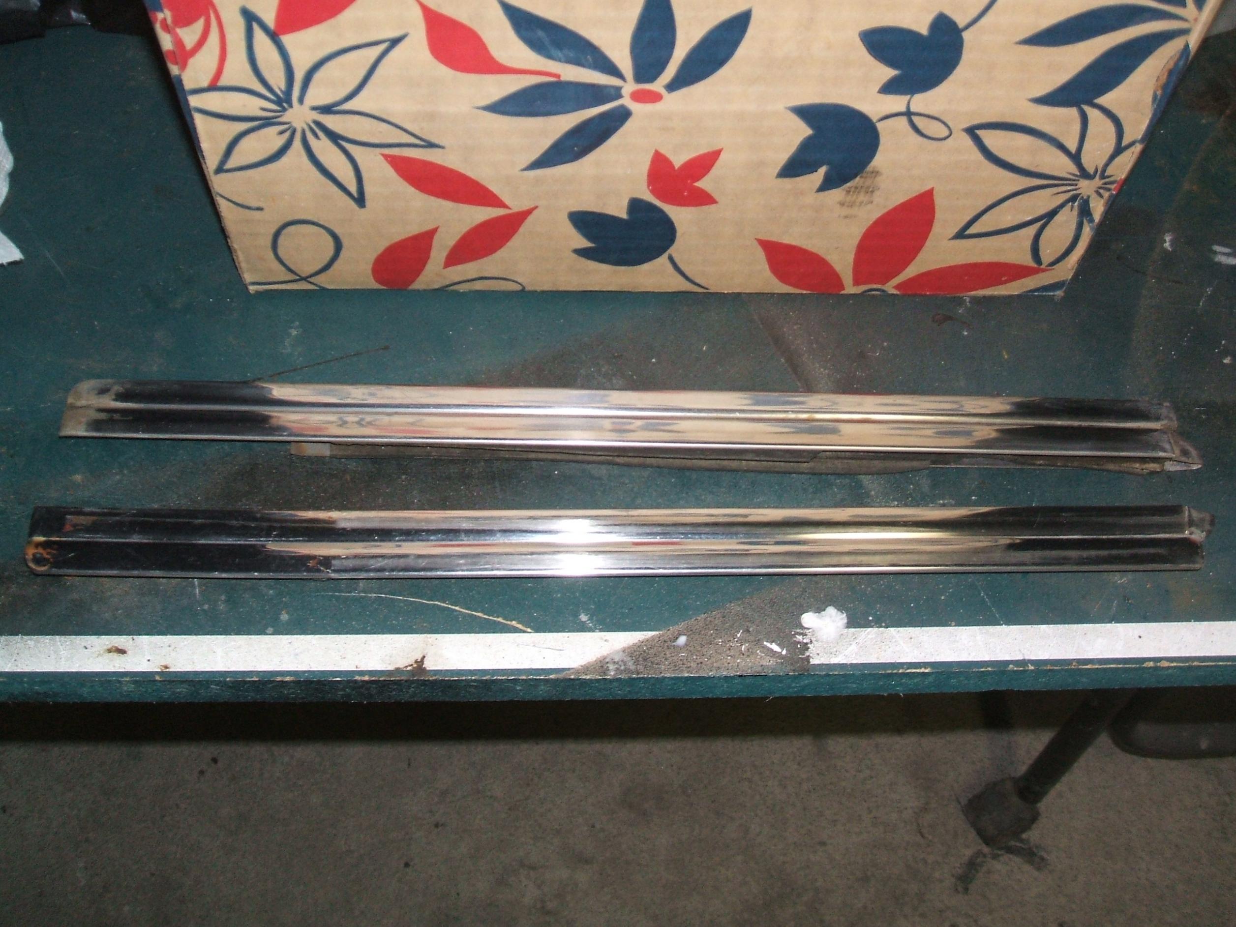

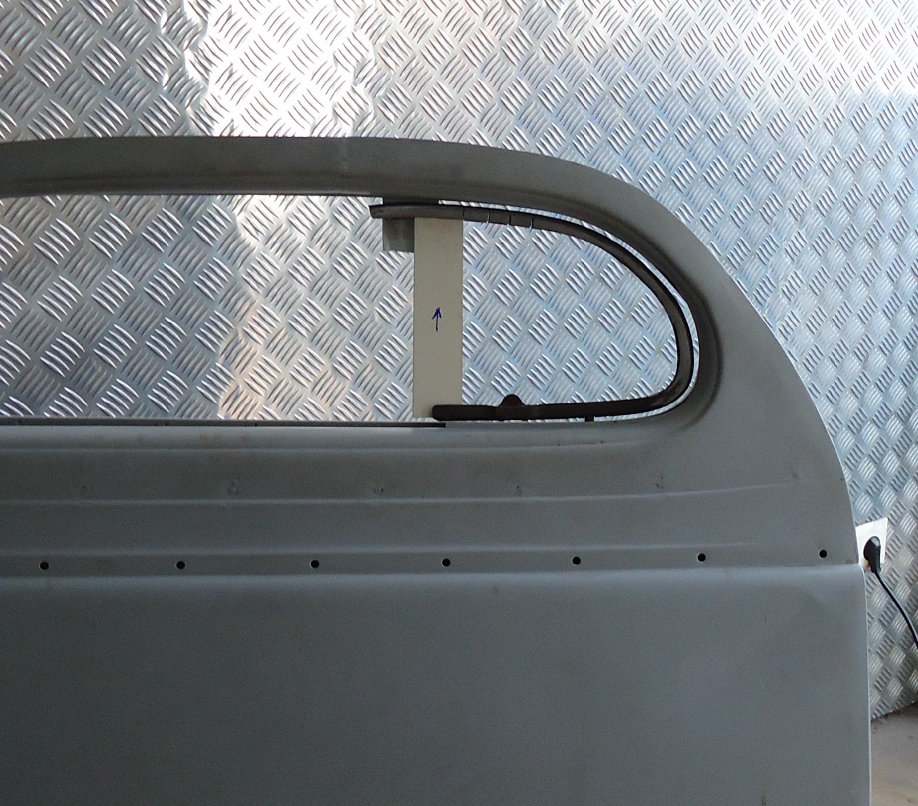

    Just bought these vent window dividers from fellow Hamber, Joe Cocuzza, for a very reasonable price. They appear to be in good condition and are without any dents. They will require polishing or maybe a re-chrome, but that is to be expected with parts that are over 70 years old. Thanks Joe!
  24. Plung
    Joined: Aug 15, 2011
    Posts: 165
    Plung
    from San Diego
    Good to see you found those vent window dividers, and that in record time! I presume some modification will be required....

    I certainly was lucky with the dividers. I think that the only modification requirements will be on the bottom part, obviously depending on how deep the windows will be. I'll try to make them as far down as possible, in order to get maximum stability.

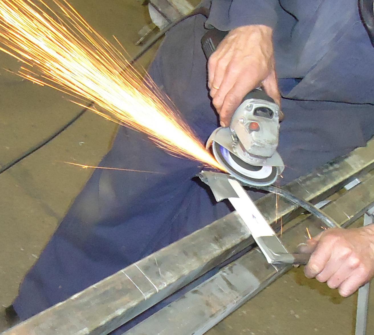

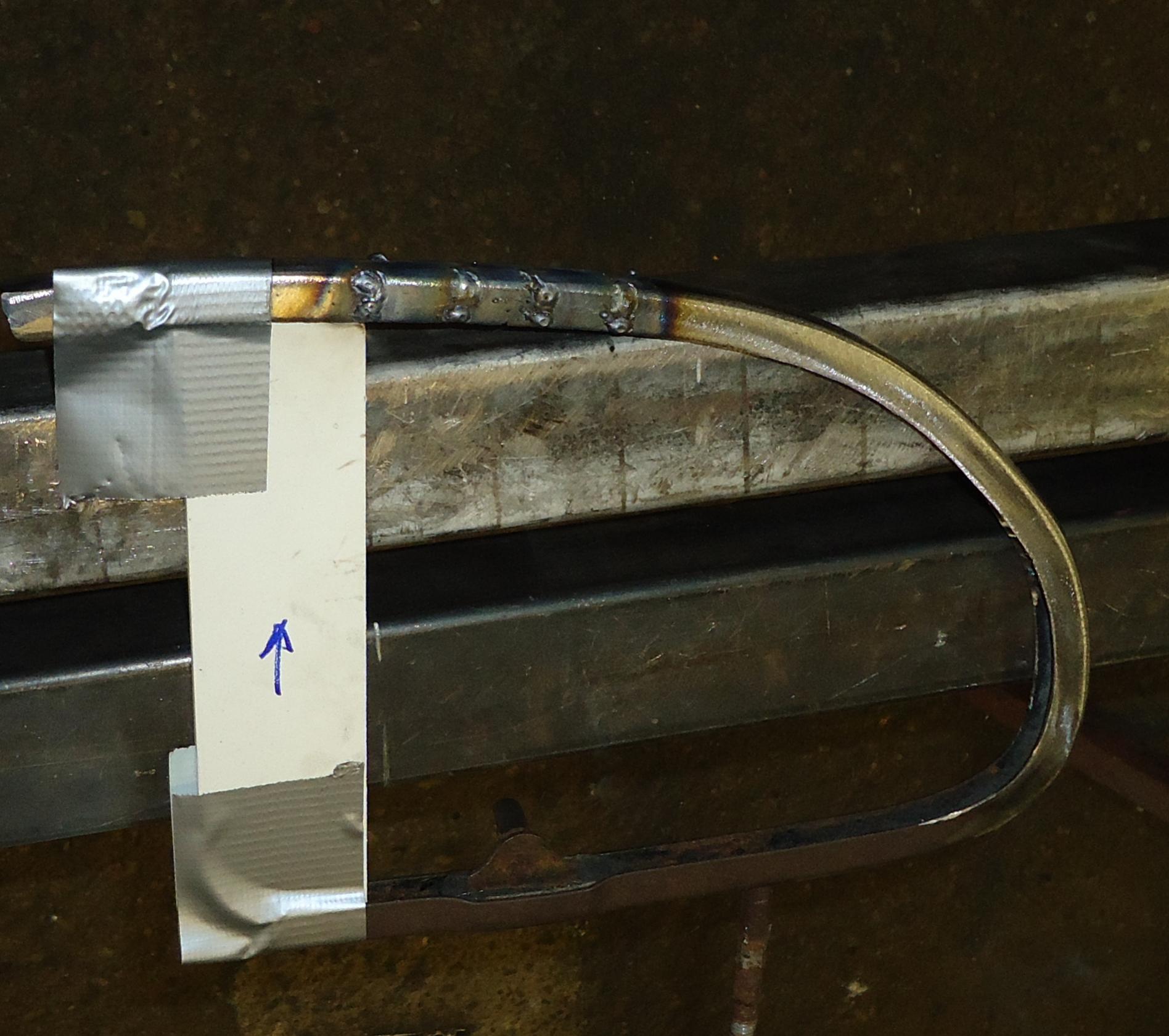

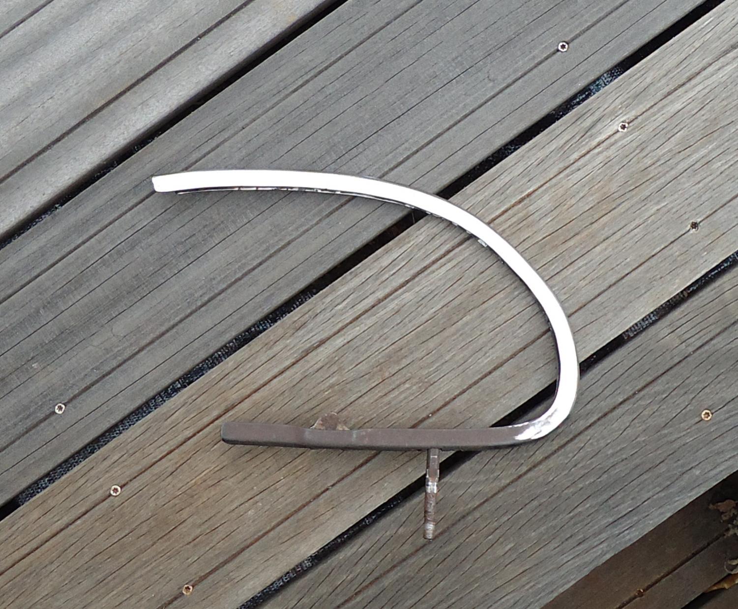

    Spent the afternoon on the inside of the vent frame cleaning up the welds. Also re-modelled the top part, welded and cleaned it up some more. Happy with the end result, despite taking a little longer than anticipated....:D
  30. Damn you're beating that vent window frame into submission. LOL
