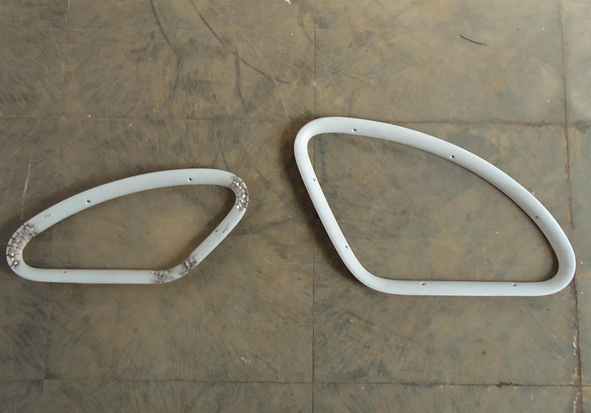

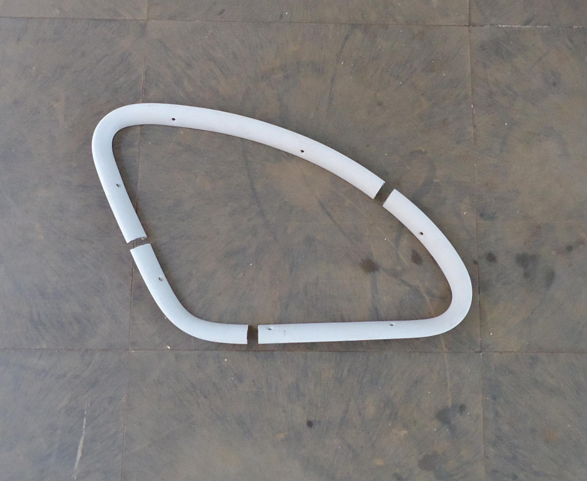

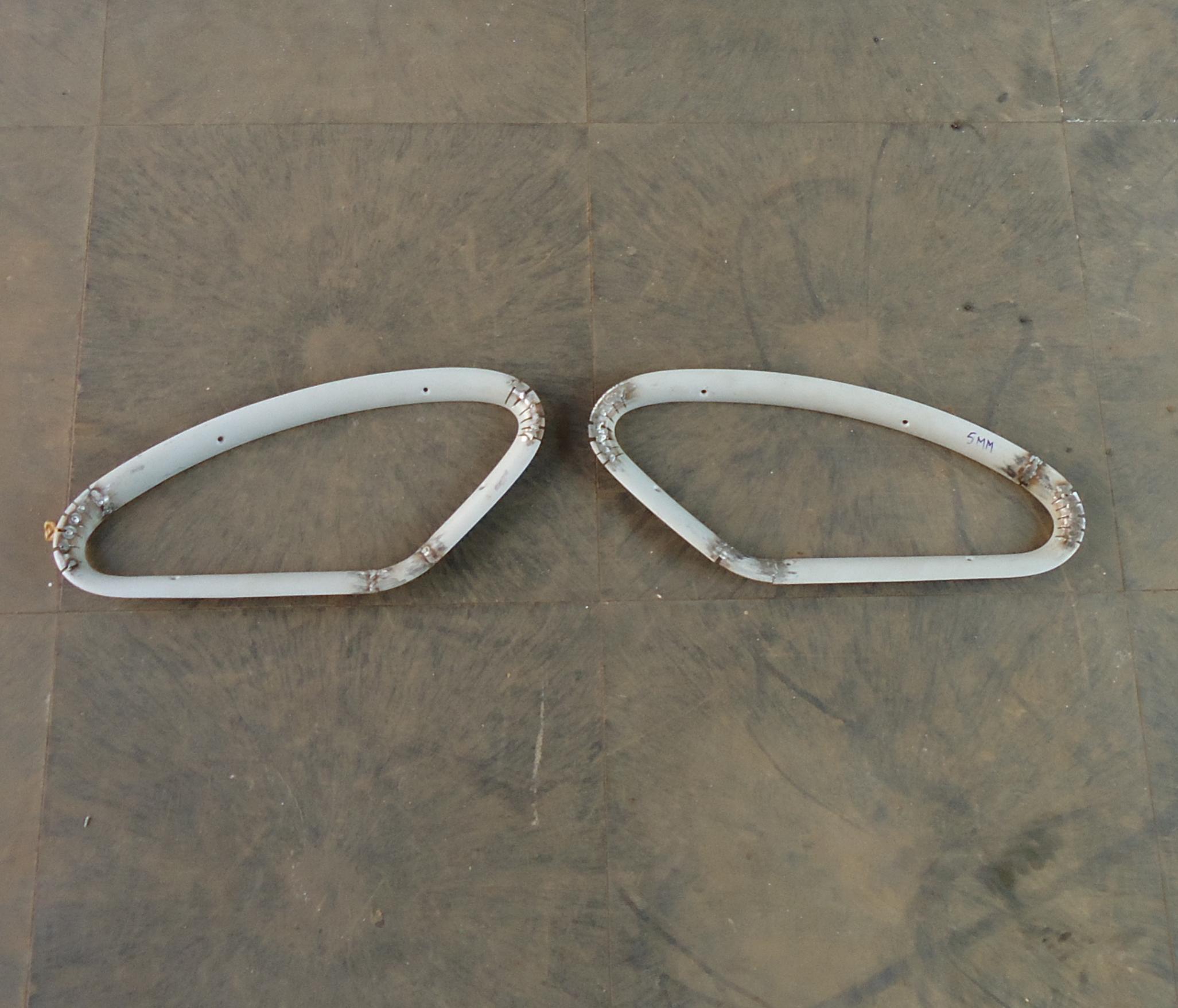

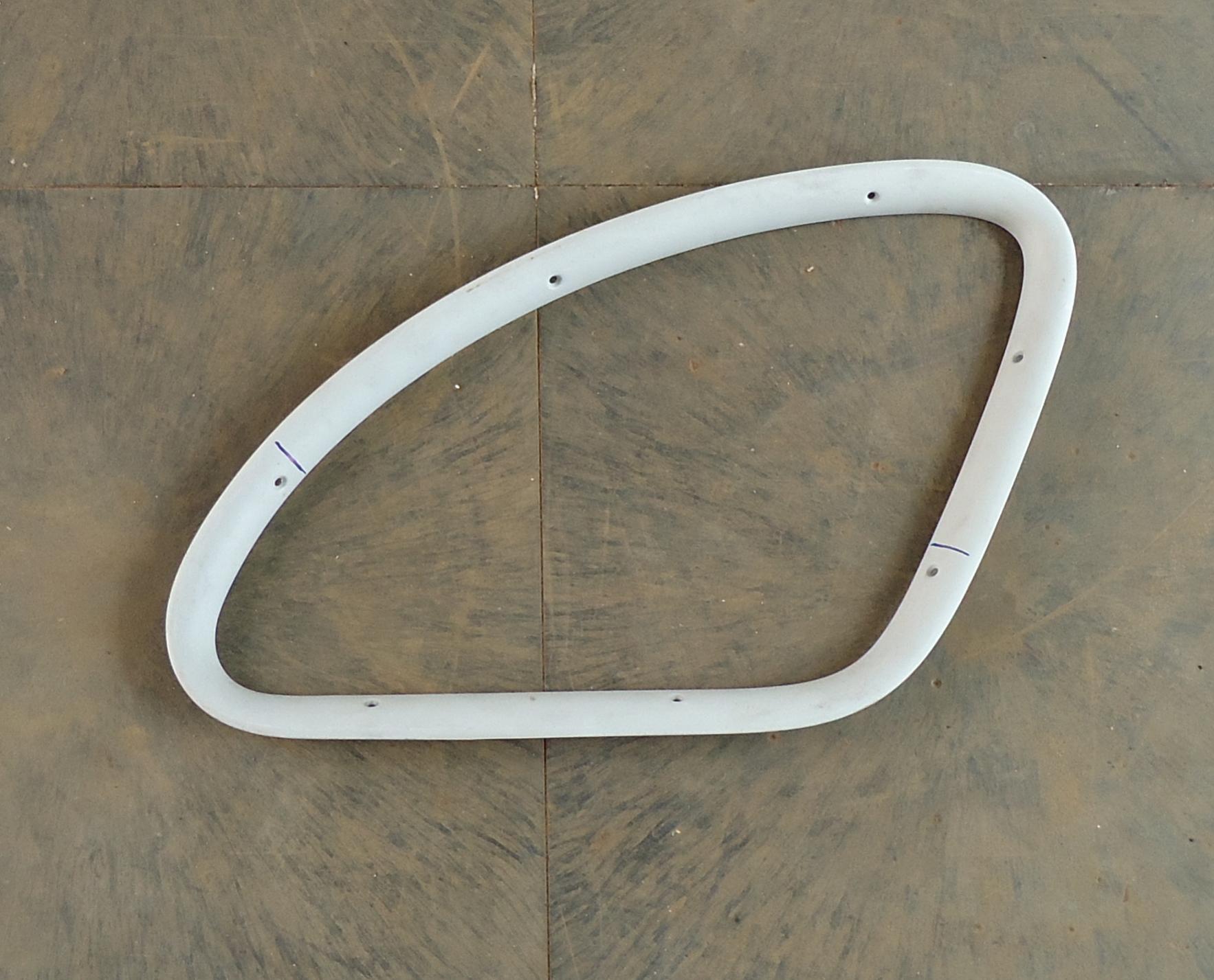

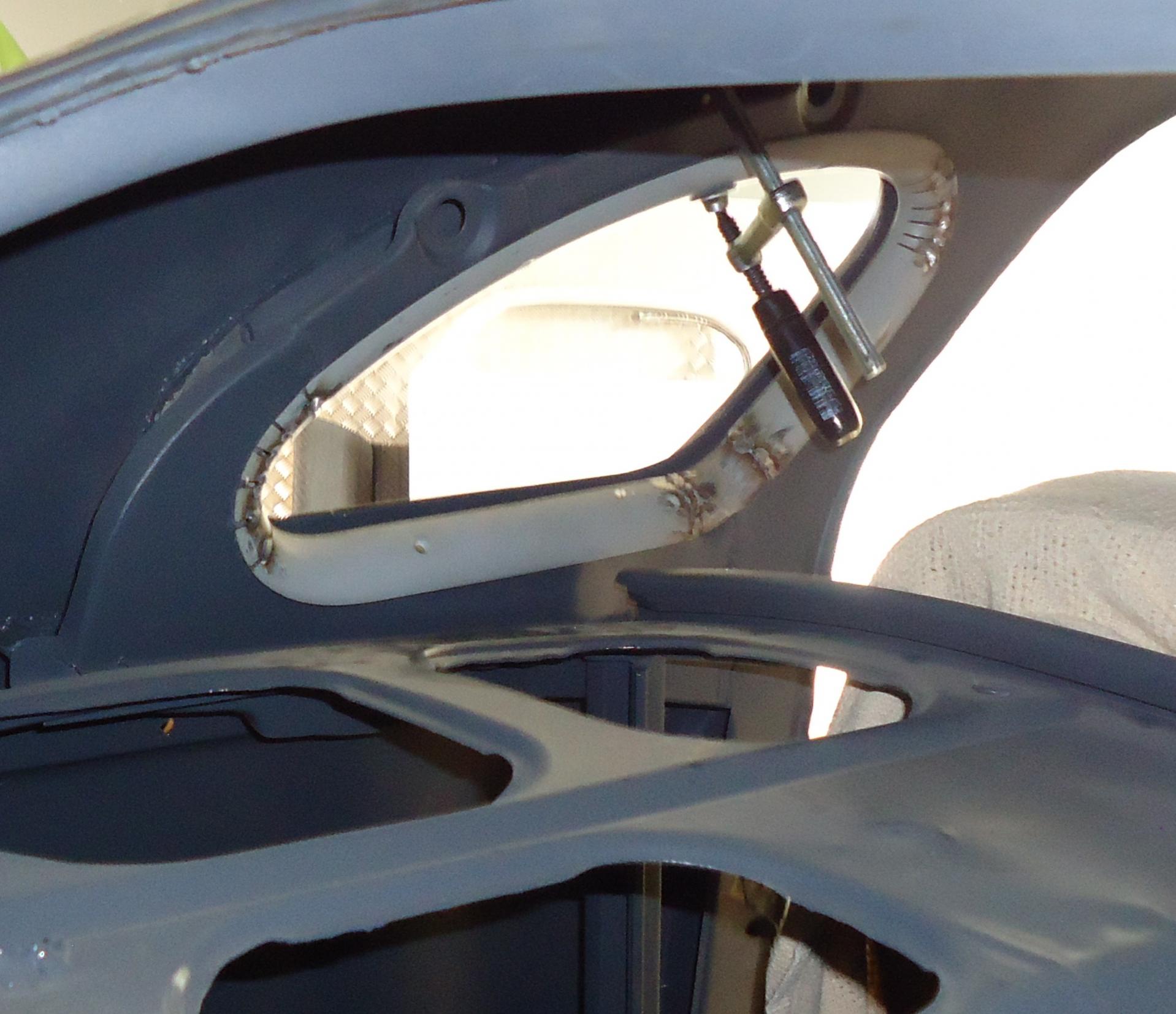

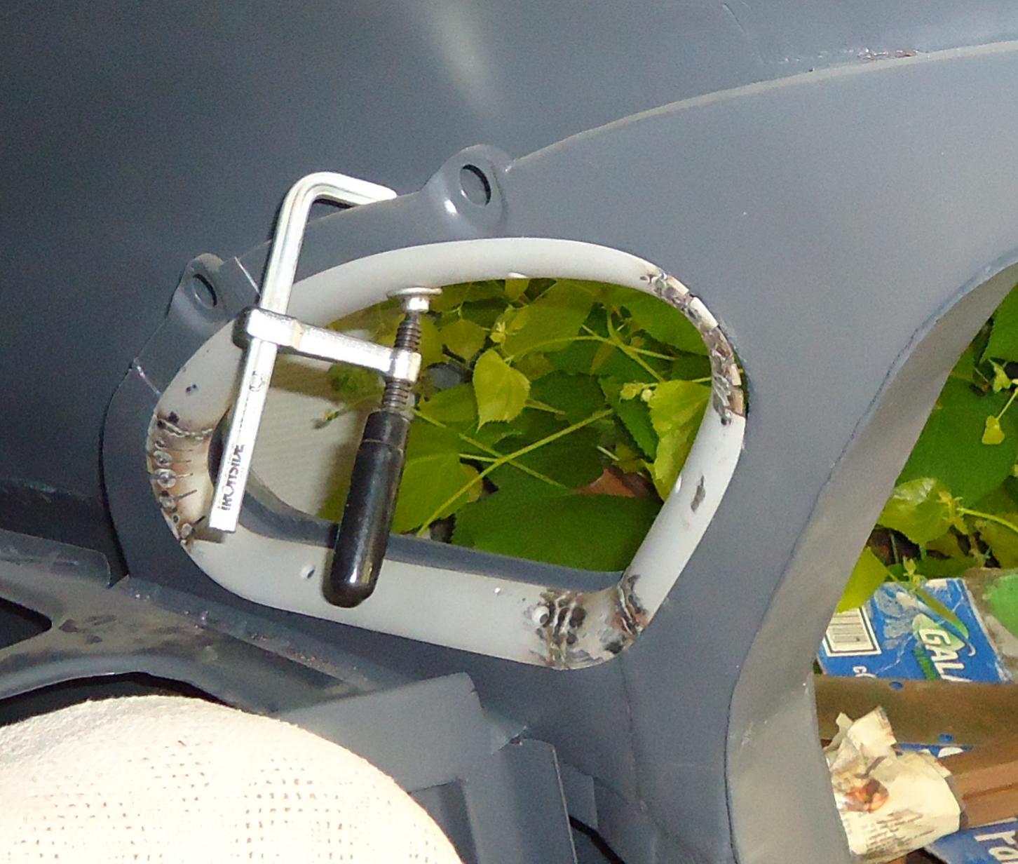

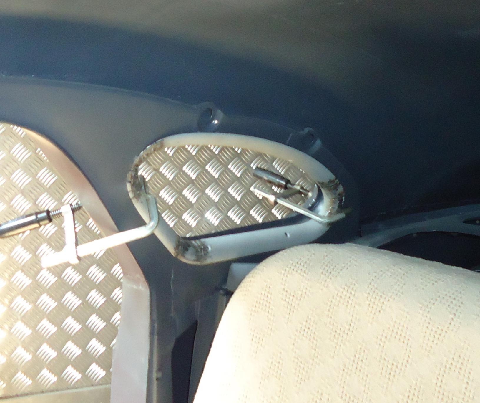

    Got stuck into the little window garnish molding today. I first cut it in three pieces and had to change the radius on two corners. Made quite a few relief cuts and just basically spot welded it all until I got the correct shape. Going to do the other one tomorrow and then weld them both up. In the last pic you can see the difference between the two.:D
  14. That's a quite a difference between the original molding and the newly reshaped one. As always, your work is excellent.

    Thank you Hivolt5.0, your comments are always appreciated. I believe that the original mouldings were painted "wood grain", I'll be painting them the same color as the exterior.

    Thanks milwscruffy. Even though chopping a roof correctly is not an easy task, I believe its all the small/interior pieces that finish it off. Everything from gl***, weatherstripping, mouldings, etc require modification. Fun but time consuming.

    You would think it was copy/paste when it comes to making the other window garnish, but there are subtle difference in angles between the two. Not that anyone will be able to see it......both now exactly fit the window they were made for.
    Unfortunately I ran out of time, so I'll be welding them tomorrow.
