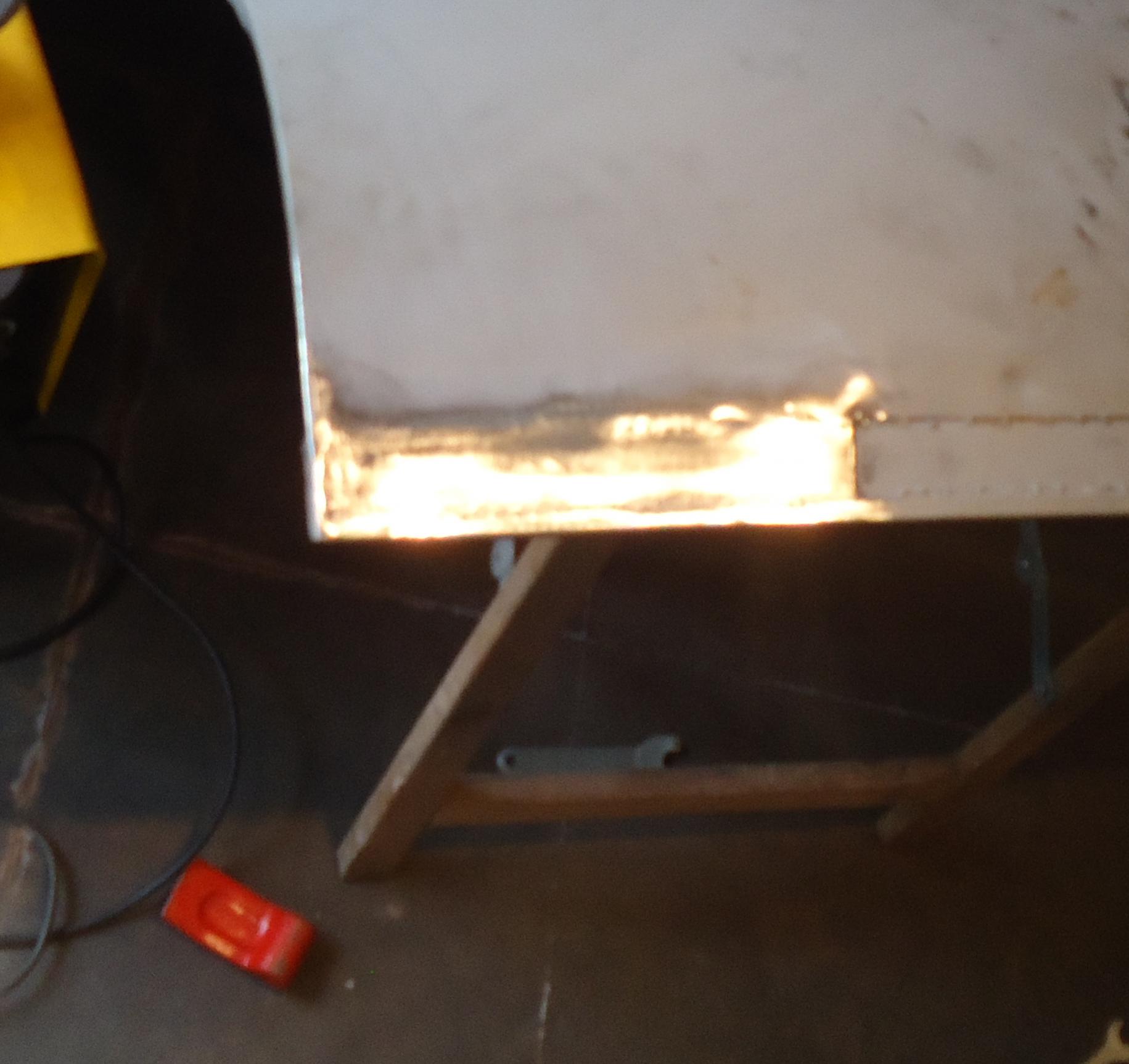

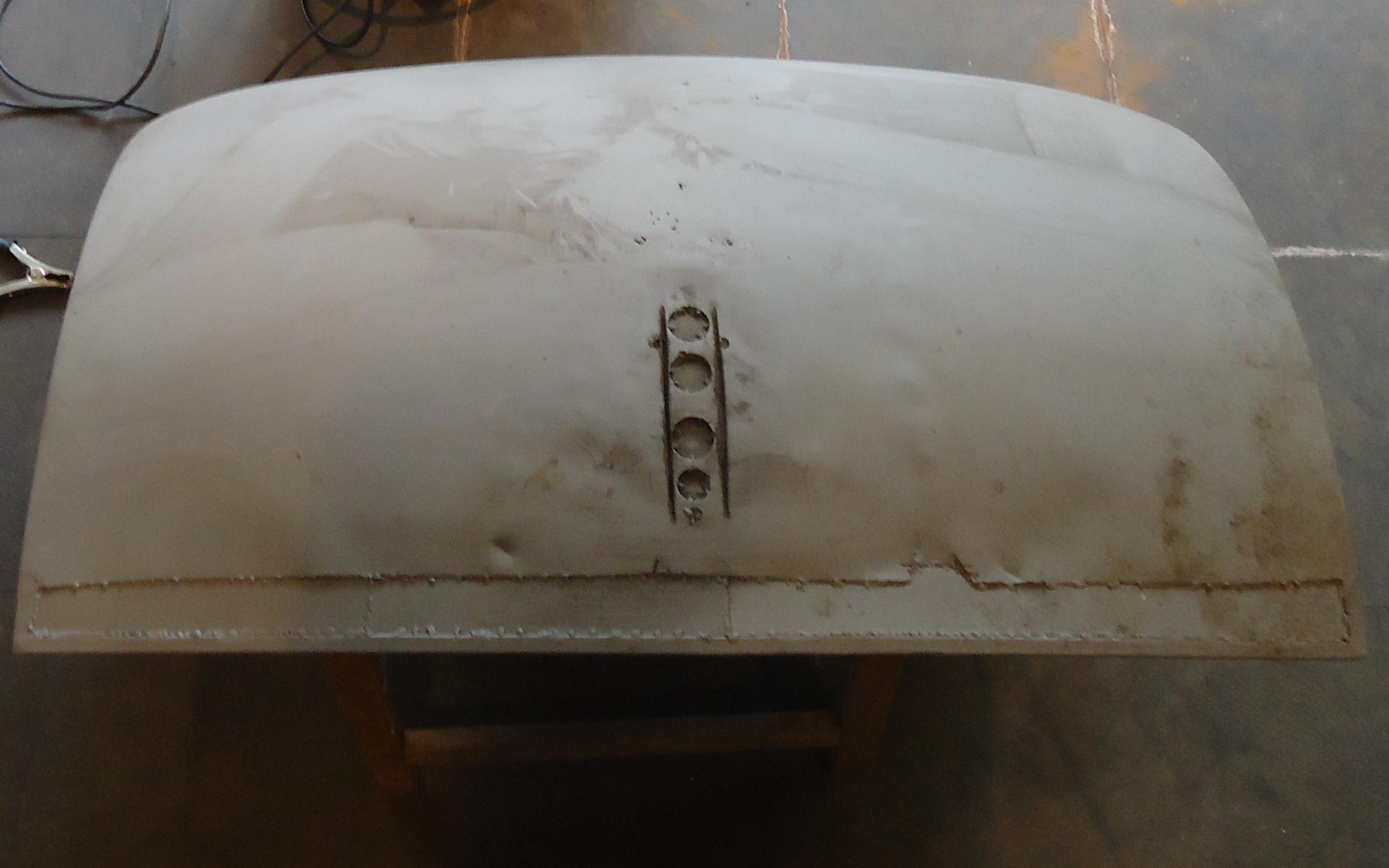

    Started on the rear deck lid. The PO (or whoever did it) did not take the time to do it properly.......Started on the lower left side, cut the old piece and got it in the right position. Then tacked it, hammered it and welded it up, one inch at a time to prevent it from warping. Then did the ajoining piece and repeated the same process. Got the grinder out and smoothed it all. Going to work on the bottom right tomorrow and work my way to the center.
    From what you can see from the first pic, I have a long way to go. Then it's on to the inner part, requiring a lot of work as well. Don't you just love it!:D
