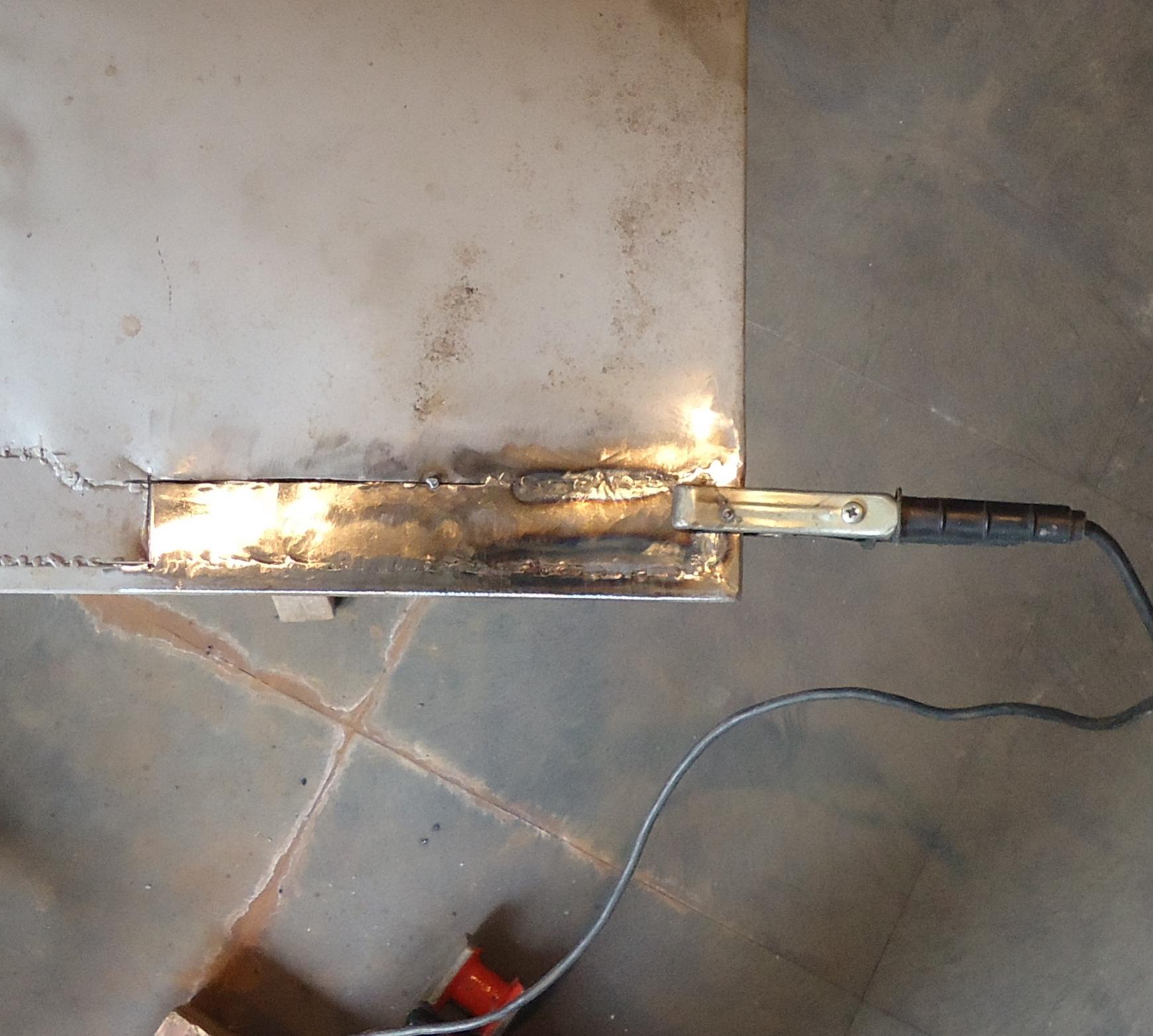

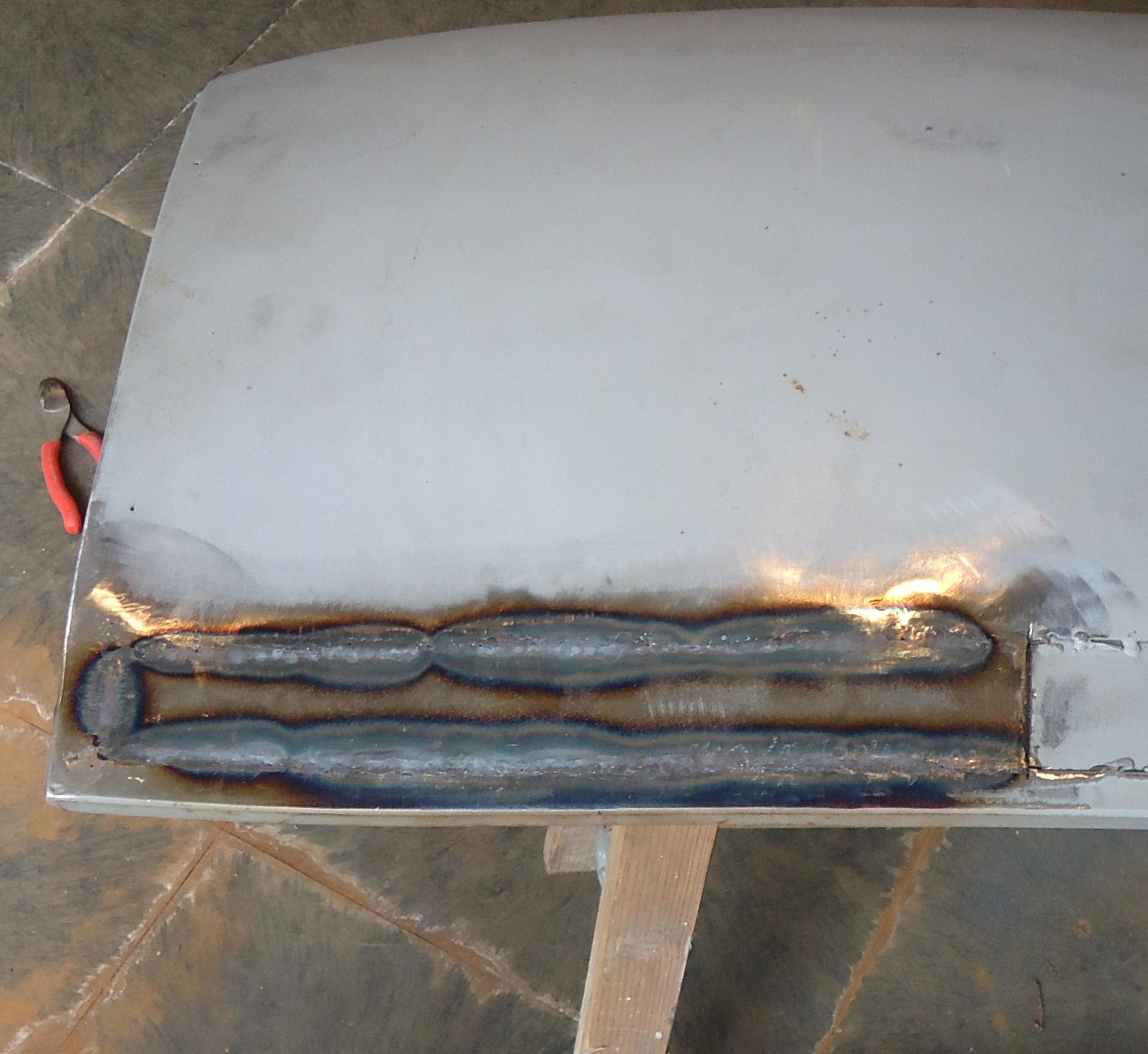

    Continuing on with the deck lid. Started on the other side and working my way towards the middle. Also welded it up on the inside for extra stiffness. Gave it a little zinc coating to prevent surface rust.

    WOW, what a ****py repair job!!! Dont you just love rust Eric!
    edit: I was talking about the previous job!!!!!!
  9. farmer12
    Joined: Aug 28, 2006
    Posts: 7,723
    farmer12
    I just don't know what the previous owner(s) were thinking when it came to repairing the rusty sections.......now I'm repairing it the way it should have been done initially. At least when I'm done with it, I'll know it was done properly.:D

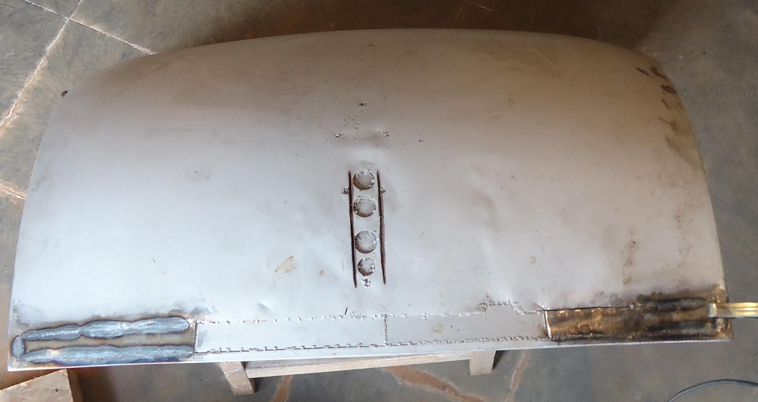

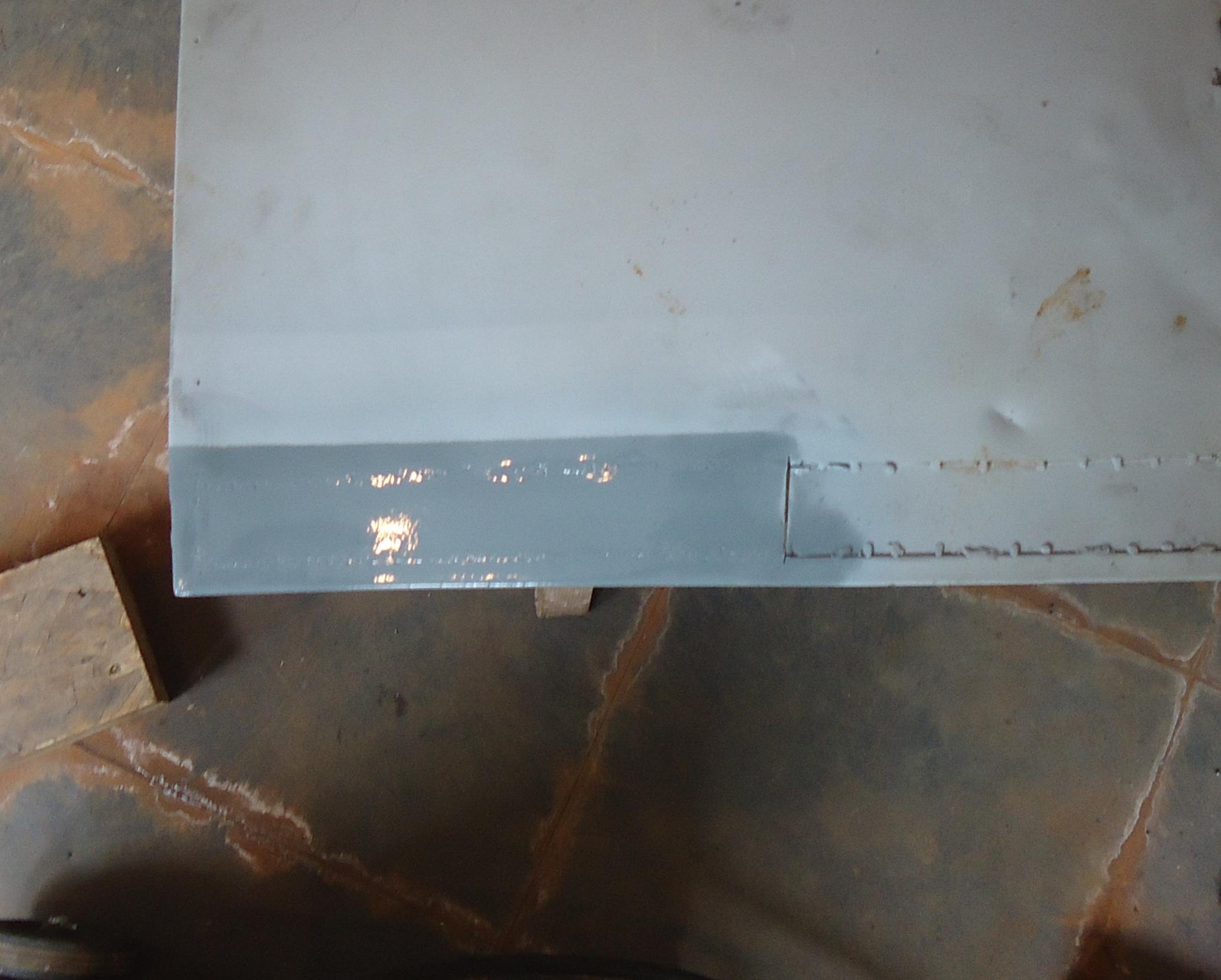

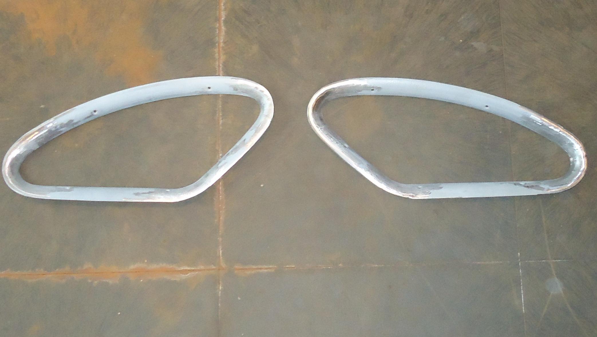

    Finished the welding on the small garnish mouldings today. Got the sandpaper out and then gave it a quick coat of zinc paint to stop them from getting surface rust. (the first pic is from last week, just to show you what I started with.:D)

    How many times do I have to say it? You're a very talented man farmer12. Thank you for showing and sharing your build thread. Awesome, just awesome.

  24. Hi Eric,
    i wonder if you got a rear window for your car or did it come without gl***? what are you gonna do with it for i think it is still curved gl***?
    your garnish moulding came out great, you're so patient and your patience really pays off.

  25. farmer12
    Posts: 7,723
    farmer12
    Thank you Carsten! It's always good to hear from you. Despite the fact the rear window looks curved, the gl*** is actually flat. So that's good! There was some gl*** with the car, but I'm going to replace everything with "modern safety gl***".

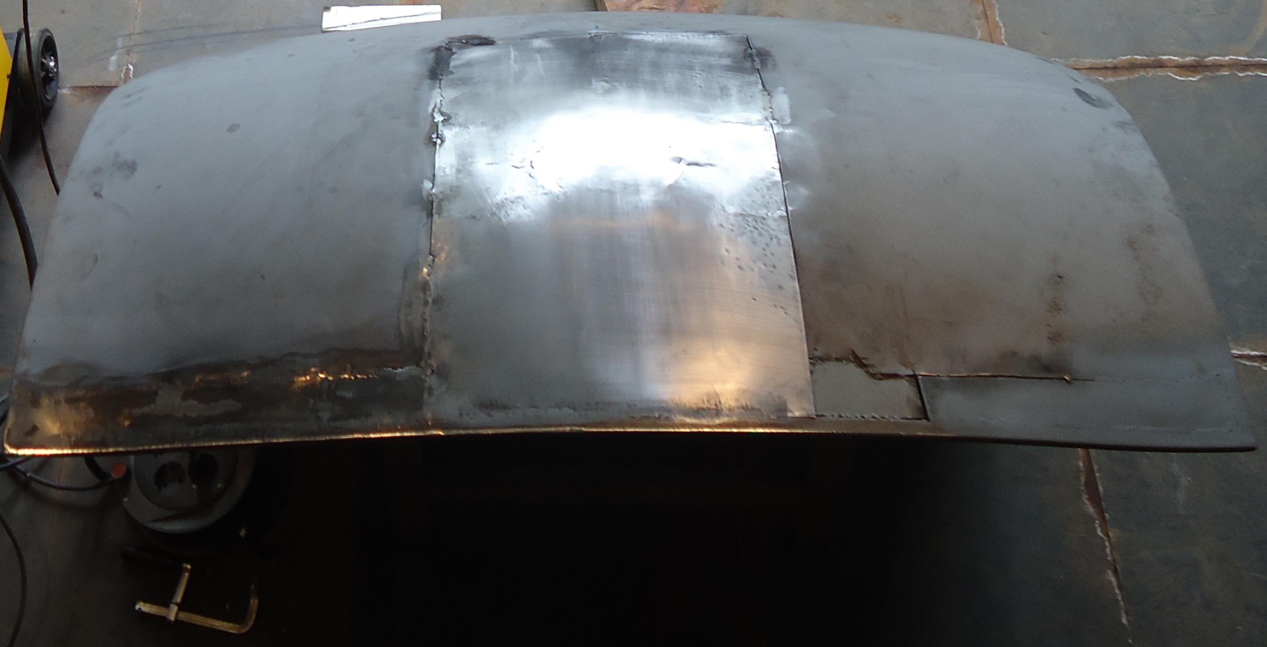

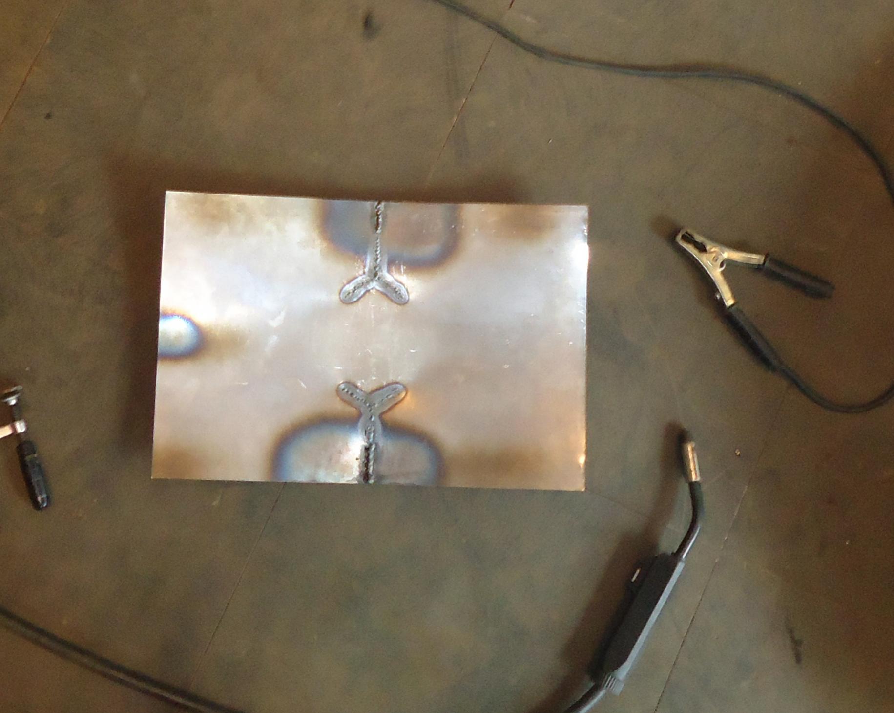

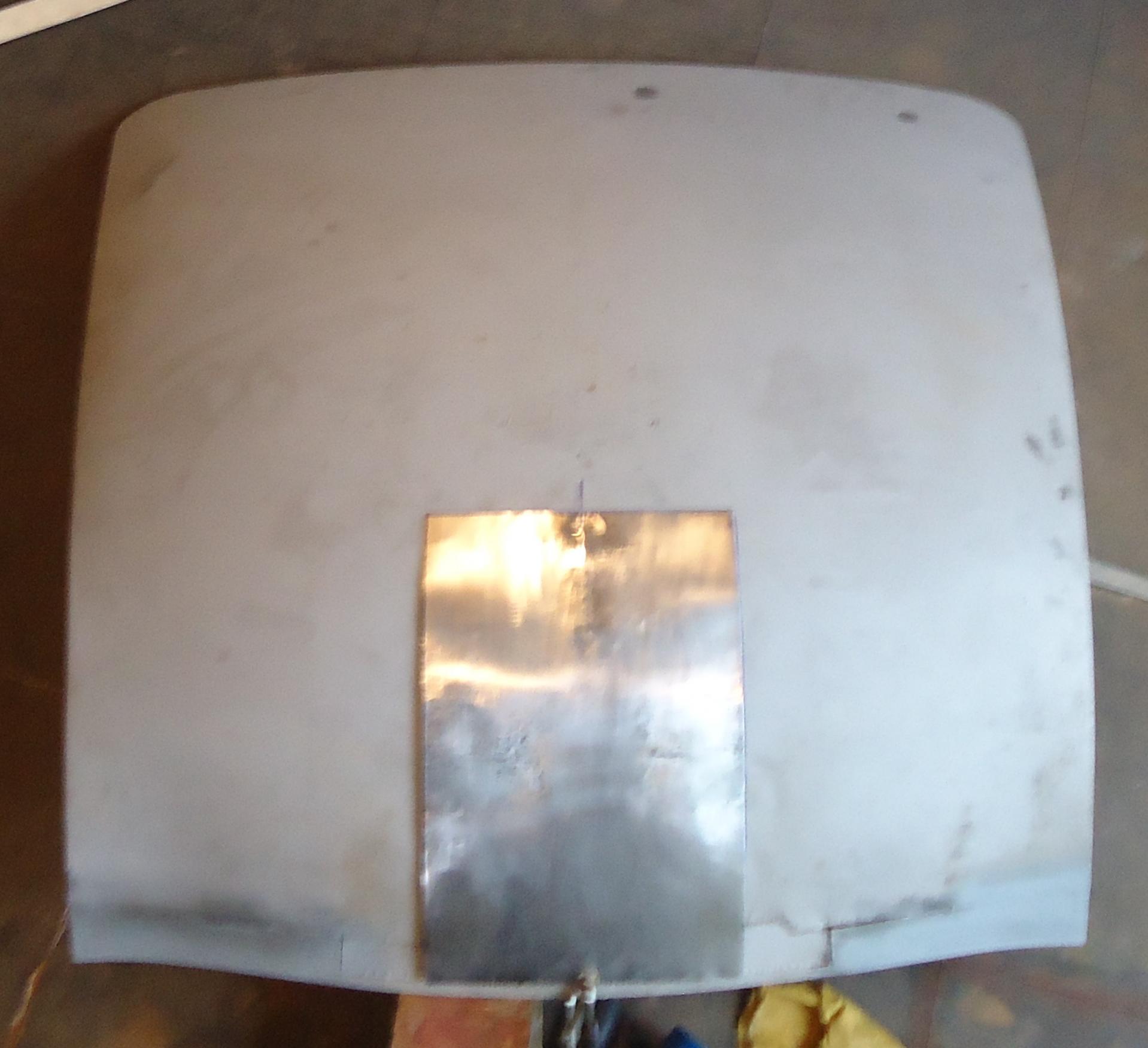

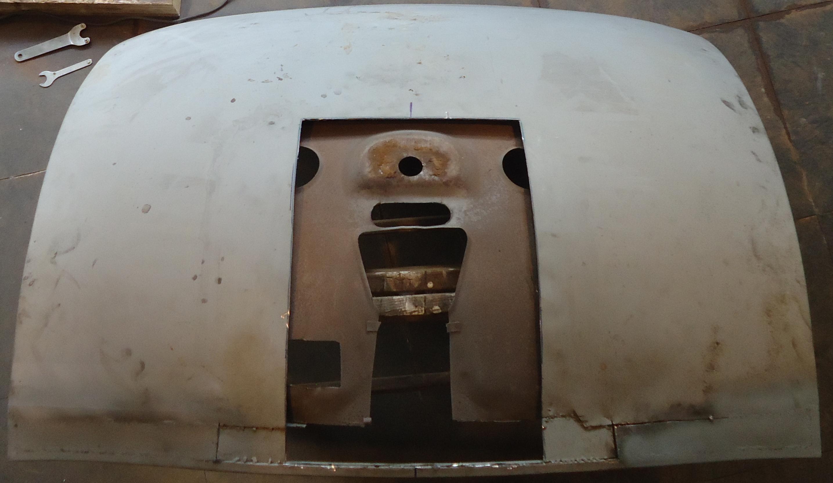

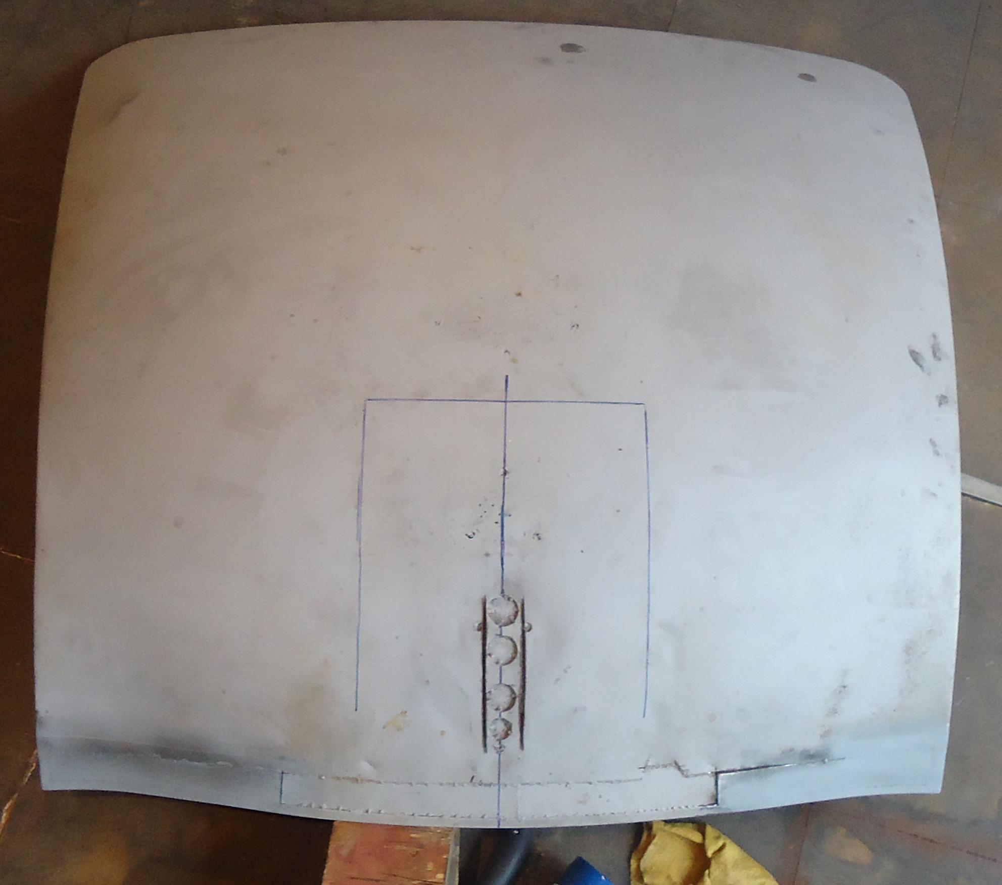

    Continuing on with the deck lid. Now what do you do if you don't have your own English wheel? You cut and weld until you have the correct shape! The first pic only shows a few cuts, but I can ***ure you, there were quite a few more in the end. Also used a bit of heat treatment in order to shrink the sides. I needed to replace the center section of the lid, which looked terrible. After spending a few hours fabricating the piece, I marked it off and cut out the old one.

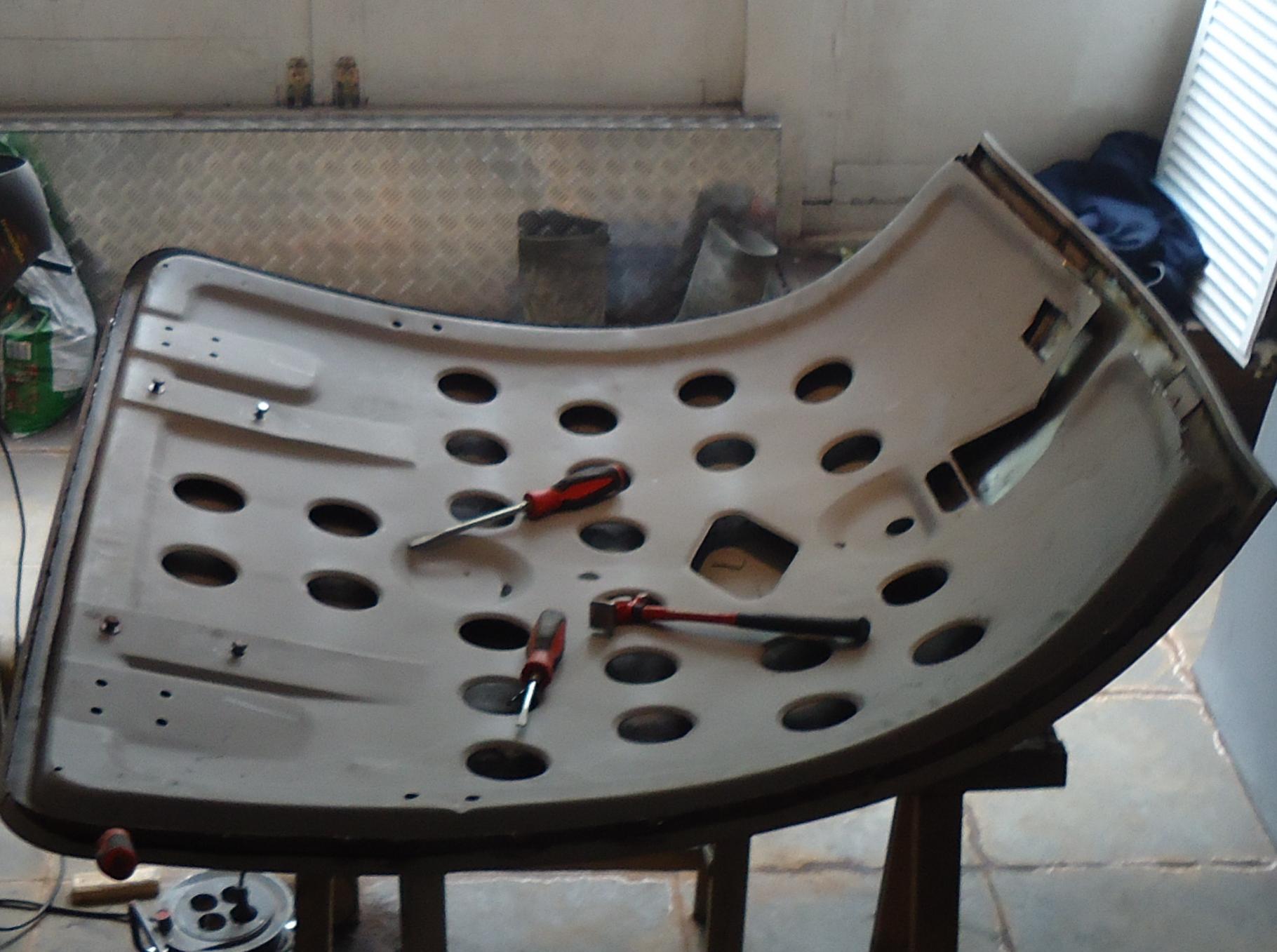

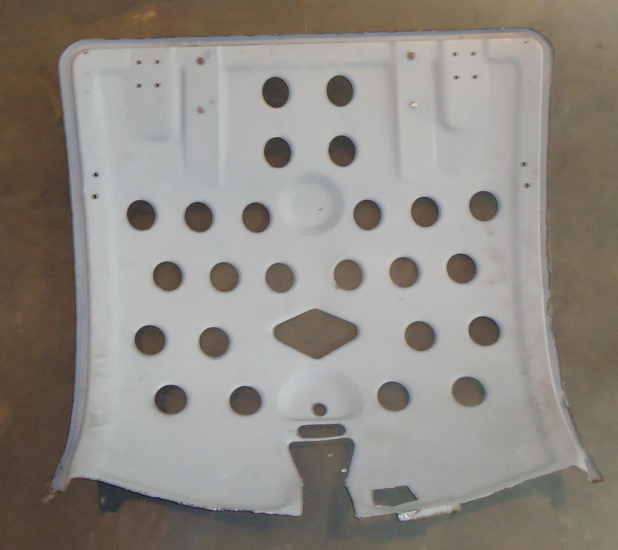

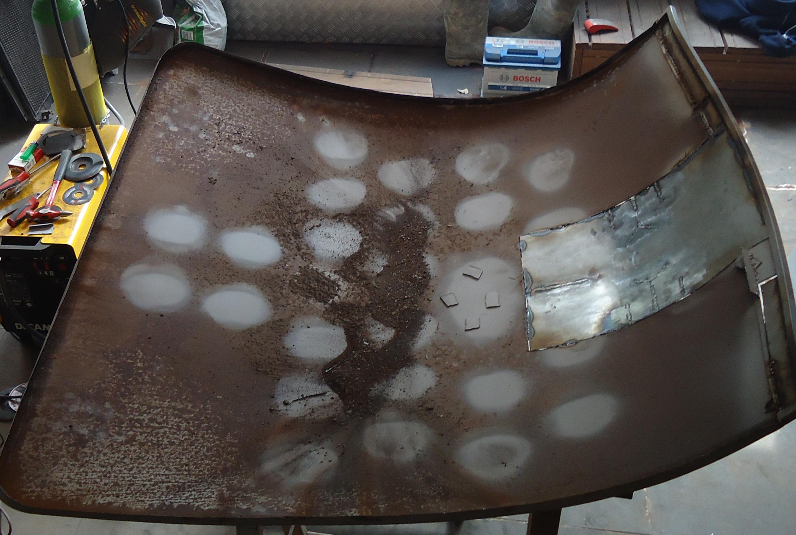

    I welded the new steel partially in place including a complete weld along the bottom. Now I already had the idea of separating the inner and outer skin, due to a fair bit of rust on the inner part. With the new steel positioned correctly and no chance of distorting the outer skin, I started the fun task of separation.
    I first used a screw driver to separate the areas that were not spot welded and then proceeded to cut the welds with my grinder. After an hour or two, I was able to separate the two. What fun!:D:D:D
